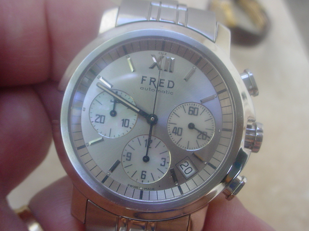

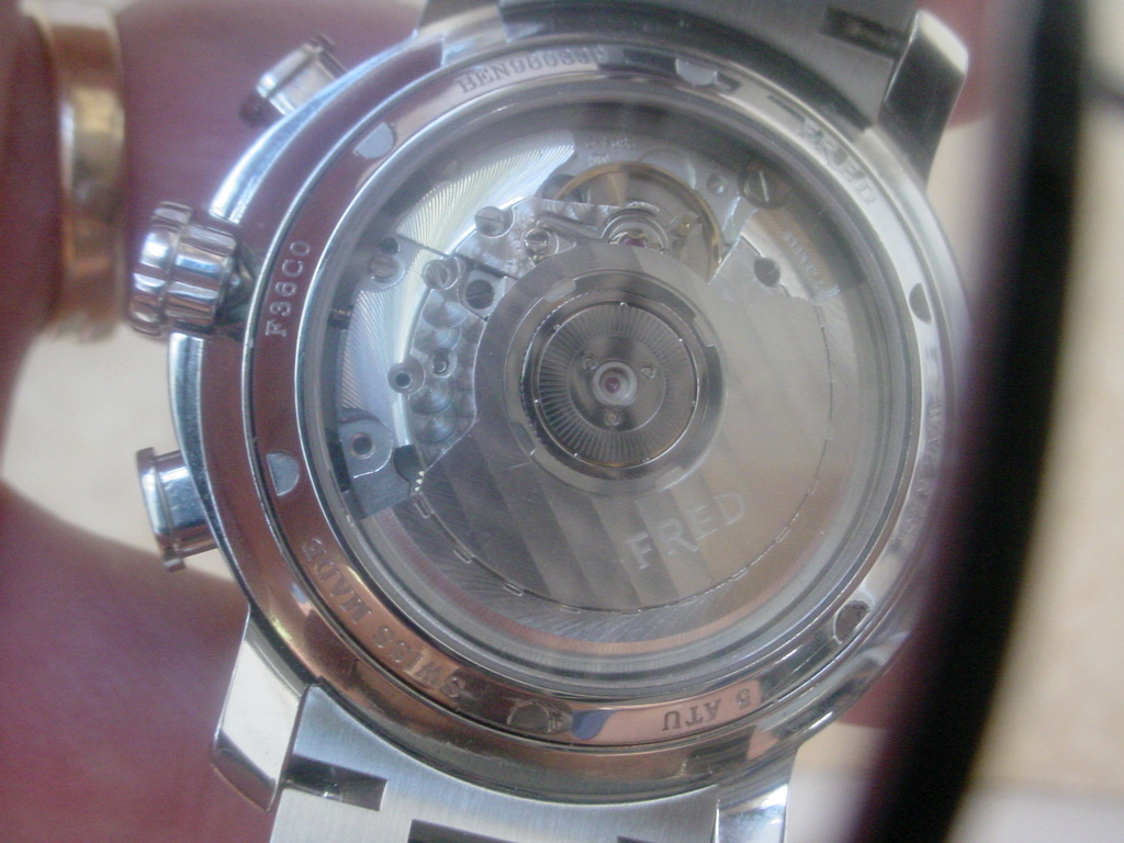

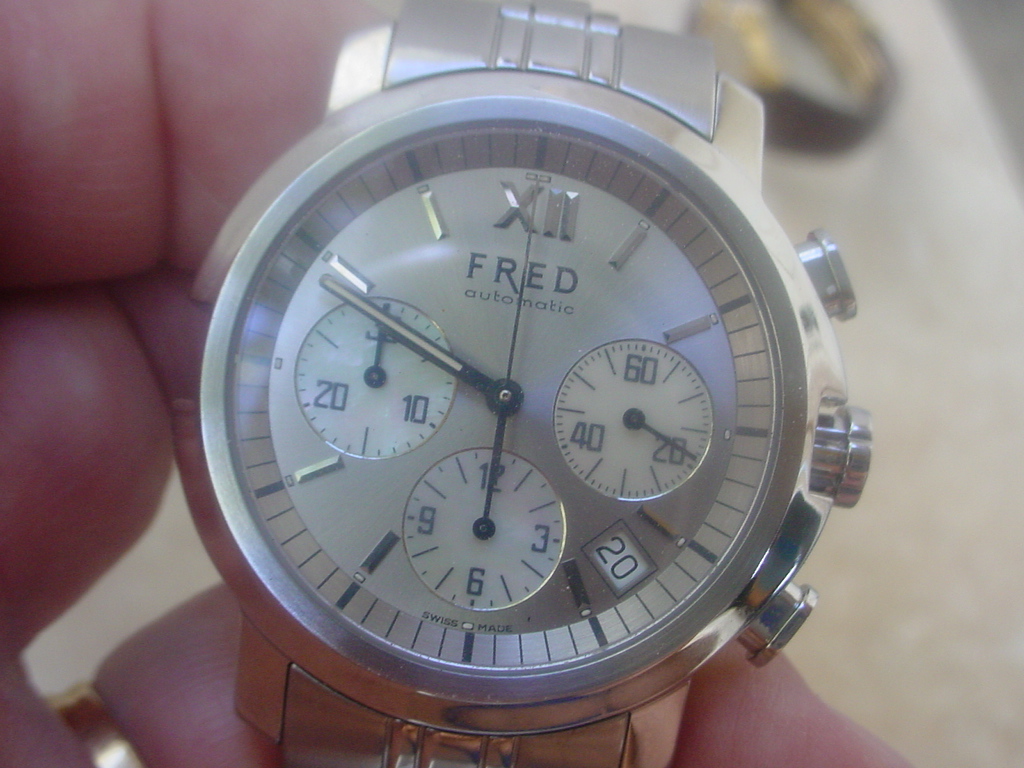

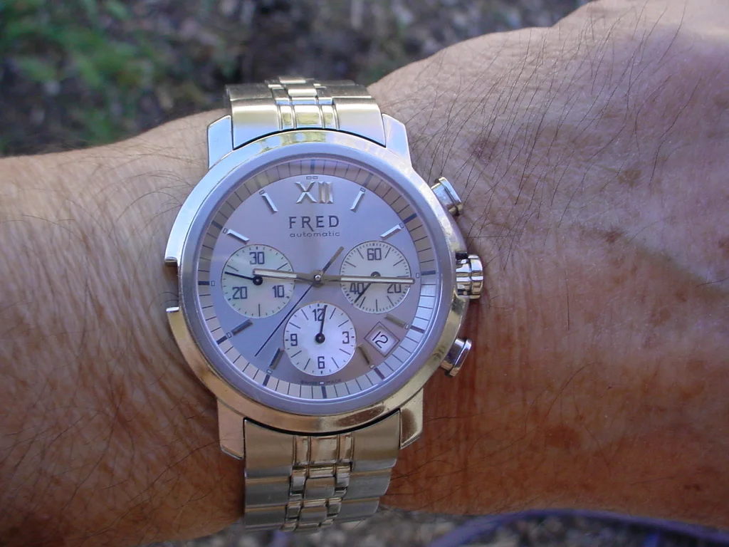

Here is the watch pic.

Not a brand I am familiar with...
But surely you get that warm fuzzy feeling with the name!
Seriously OP, FRED OF PARIS is the official company name and they are big jewelry retailers. Surely they have a service dept.
Yes, that's my brother in law's name, and he's a great guy...

It might be a challenge to find anybody to work on this. Does anybody other than Omega/Breitling/or anybody else who has ever used that chronograph module, have access to a either a serviced module, or parts for the module? Mikrolisk shows a number of possibilities re: the firms that use the FRED name. Perhaps there is help there?

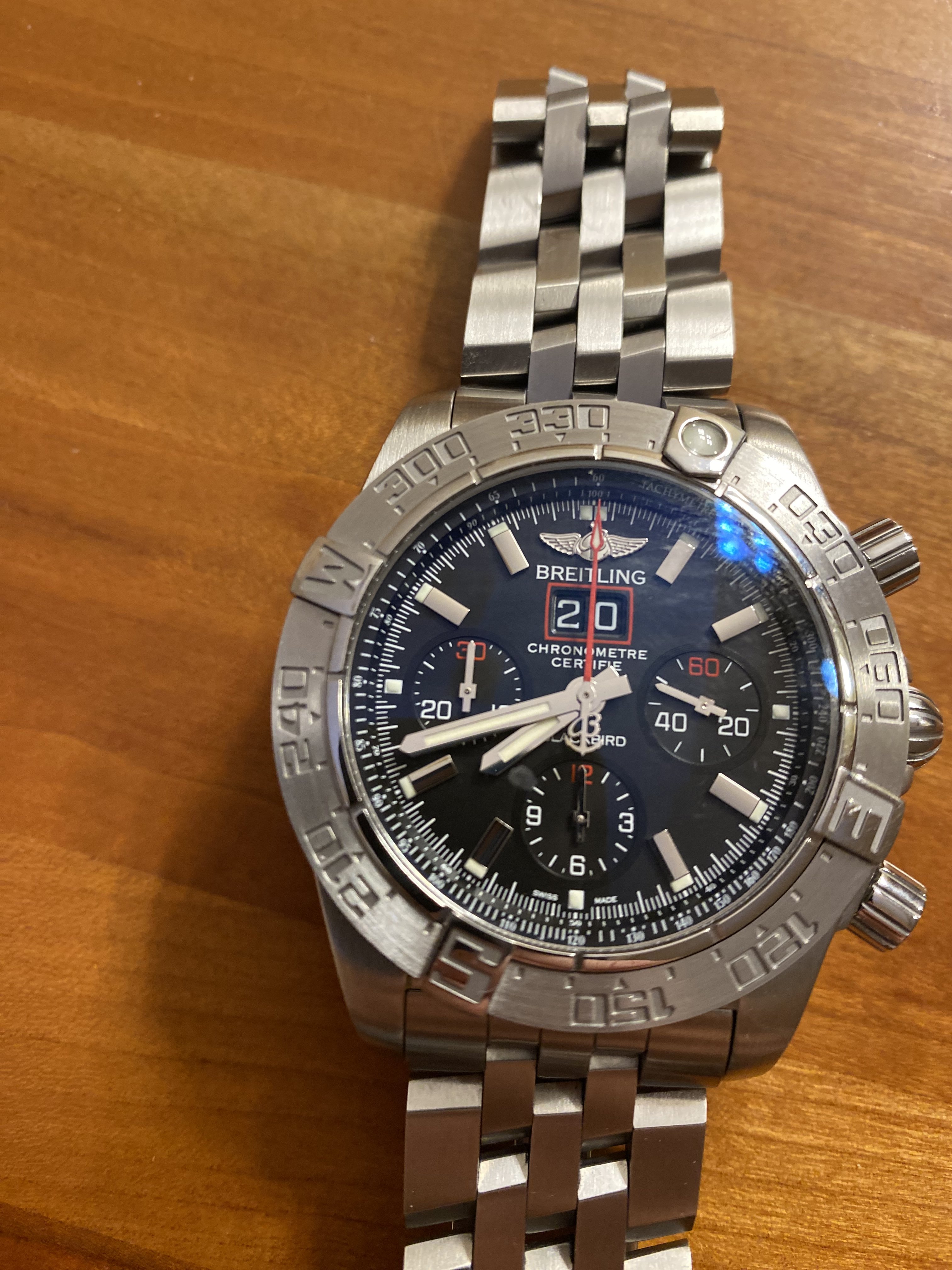

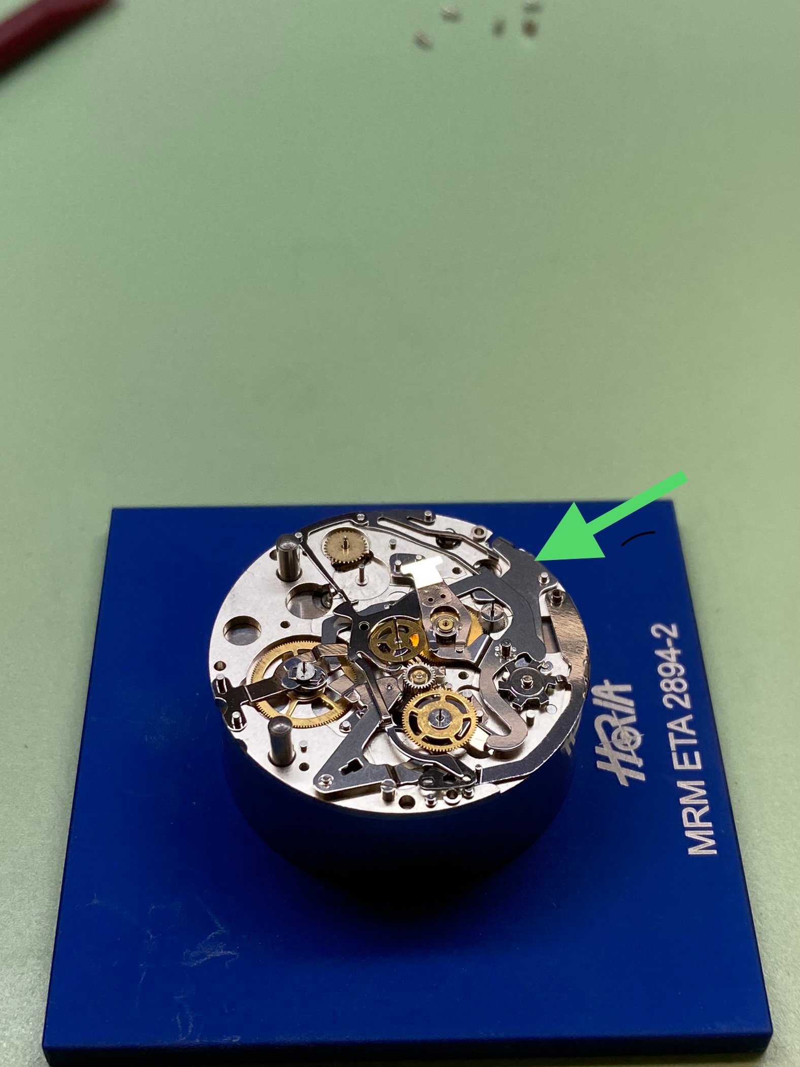

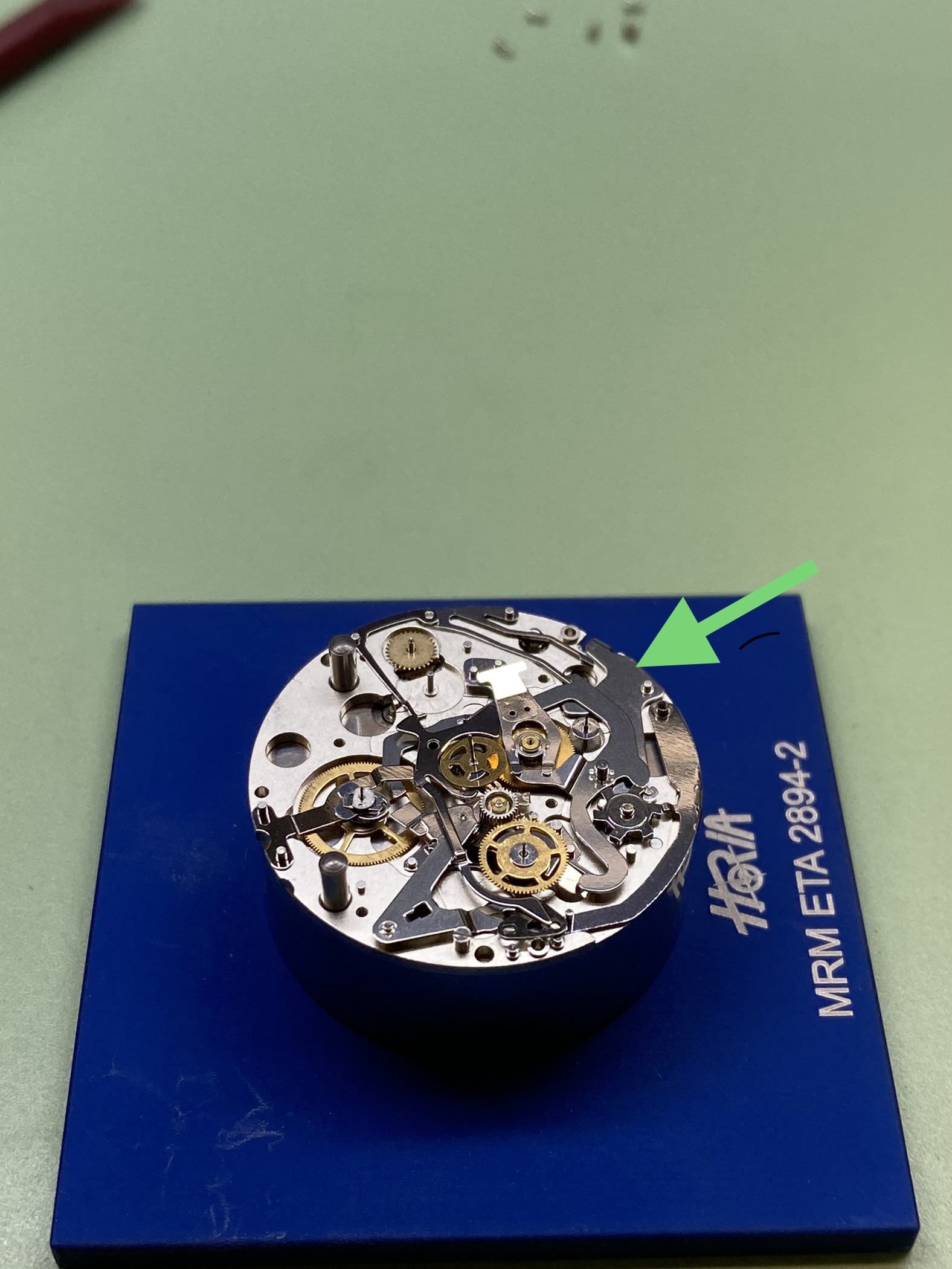

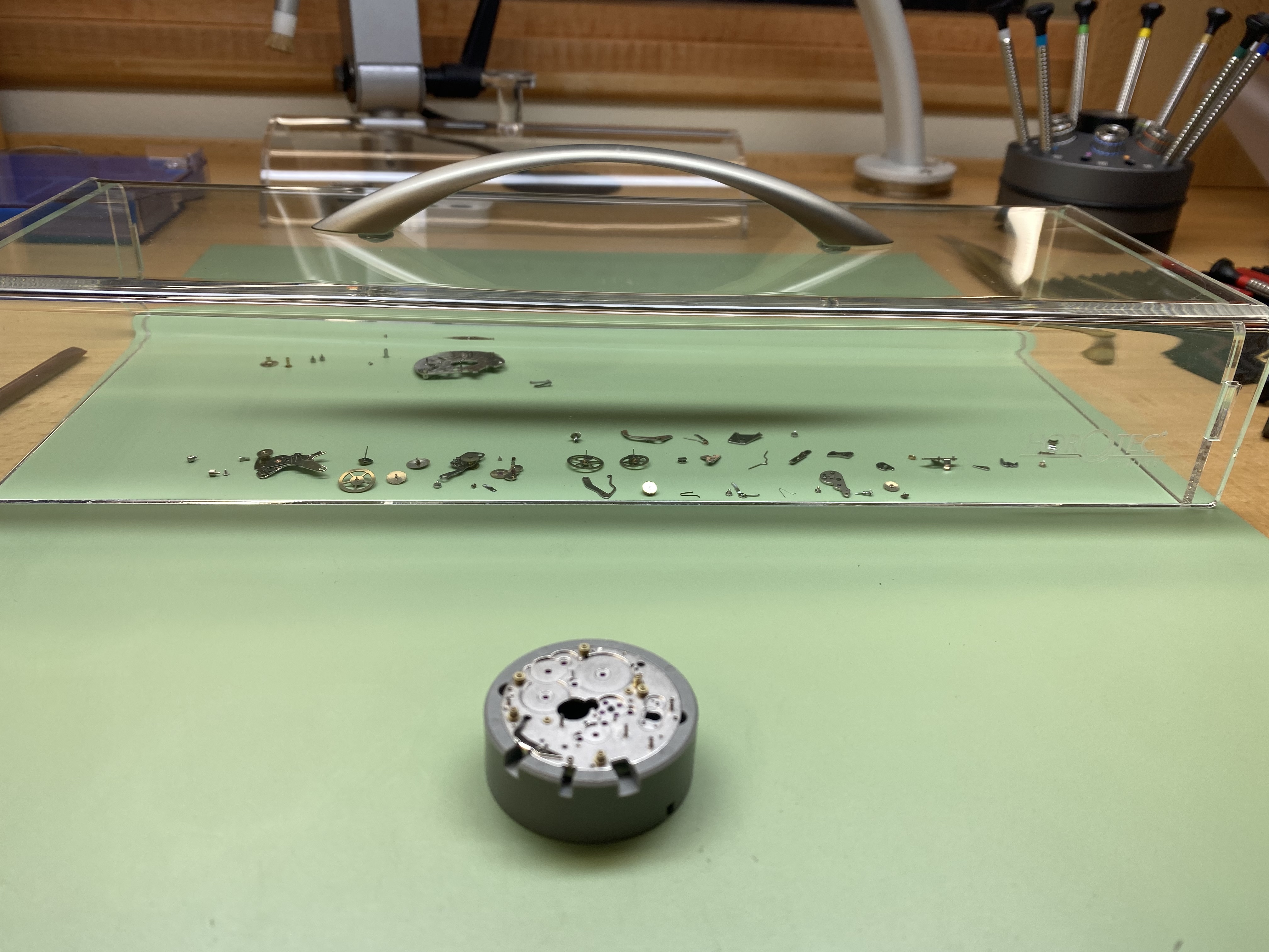

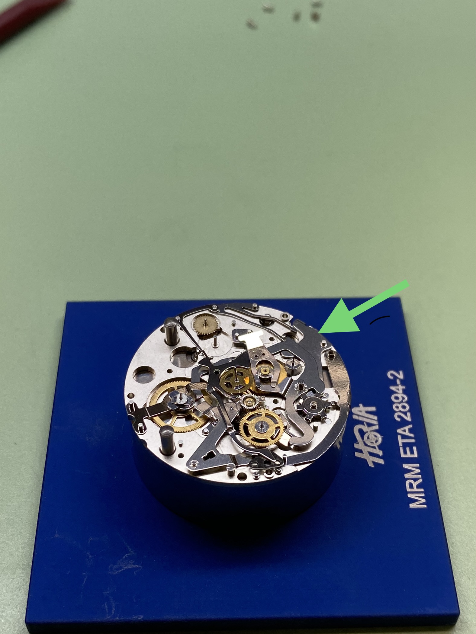

The 2894-2 requires a special holder for the module. There are three springs(technically 2, but one spring has two legs) that have to be unloaded with the tool for disassembly and reassembly. I don’t have many pictures from the last one I worked on. The arrow points to the stop/start lever. With the tools and training the 2894-2 isn’t too hard to work on.

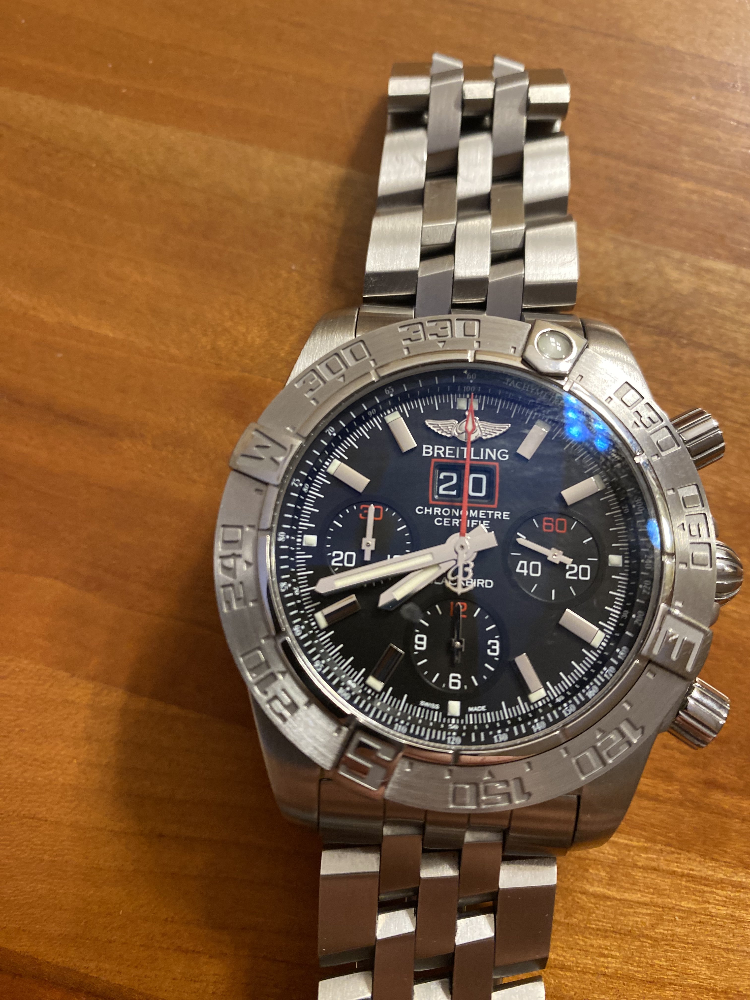

It’s simpler than the Dubois Depraz 2000 module that Omega uses. Below is a pictures of a 4500 module from a Breitling. It’s mostly the same as the 2000 with a big date:
