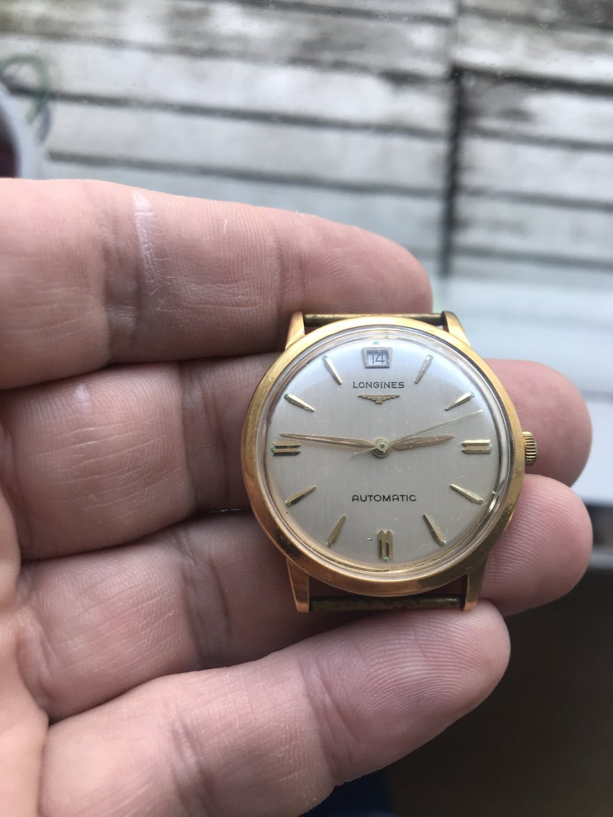

Acquired this one together with some others. Not really my era but basically a nice one. Question is whether this is a redial (I think so due to no swiss made at 6)? Anyone with the definitive answer? I'm a bit on the fence about investing or selling as is 馃槈

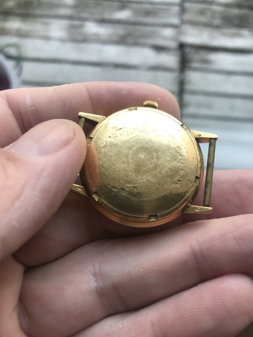

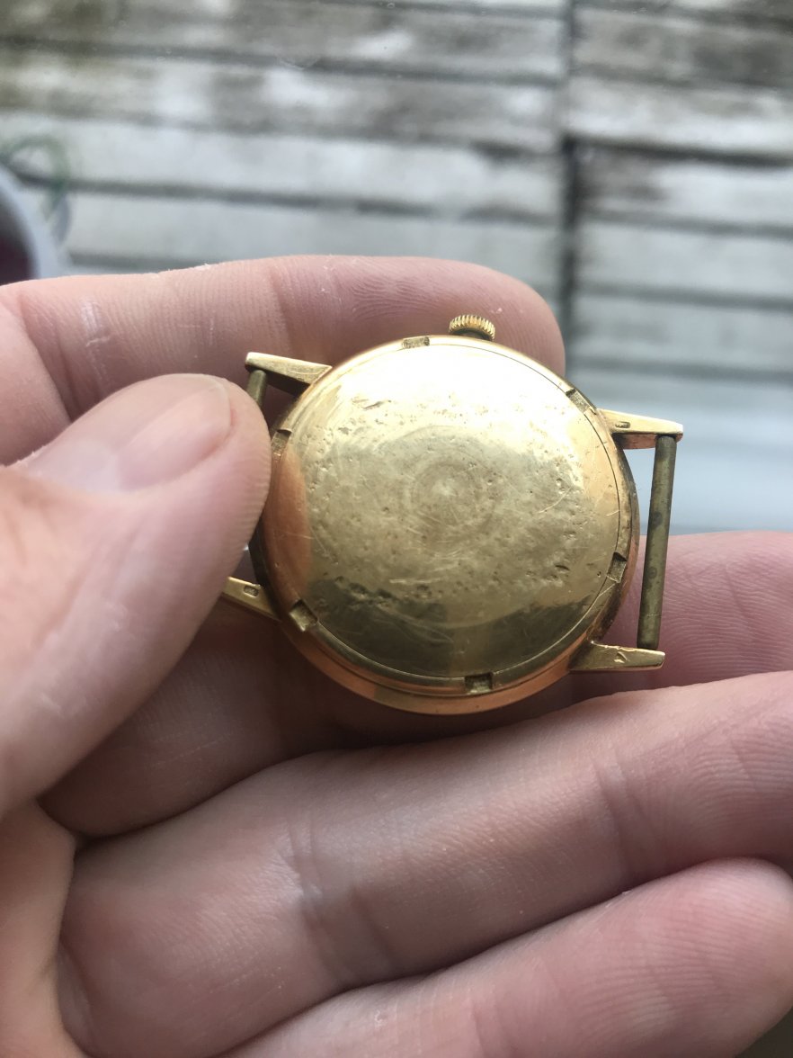

And the back shows why you should not wear a perlon on 18k gold..

Probably a redial, the "Longines" brand is too high from its logo and the fonts used, especially for "automatic", do not seem like those usually used.
Be aware that Longines sometimes redialed themselves some of their watches, so there's always a (slight) chance when a redial seems clean like yours that it was actually a Longines Redial. To be sure, you should open the case and send pics of the movement (a 341 I'd guess ?) to Longines.

The horrible green lume blobs should give it away too.

100% redial, and if you ask me, not a nice one at that. The fonts do not come close to what Longines used in those days.

PTo be sure, you should open the case and send pics of the movement (a 341 I'd guess ?) to Longines.
Movement is a 291
