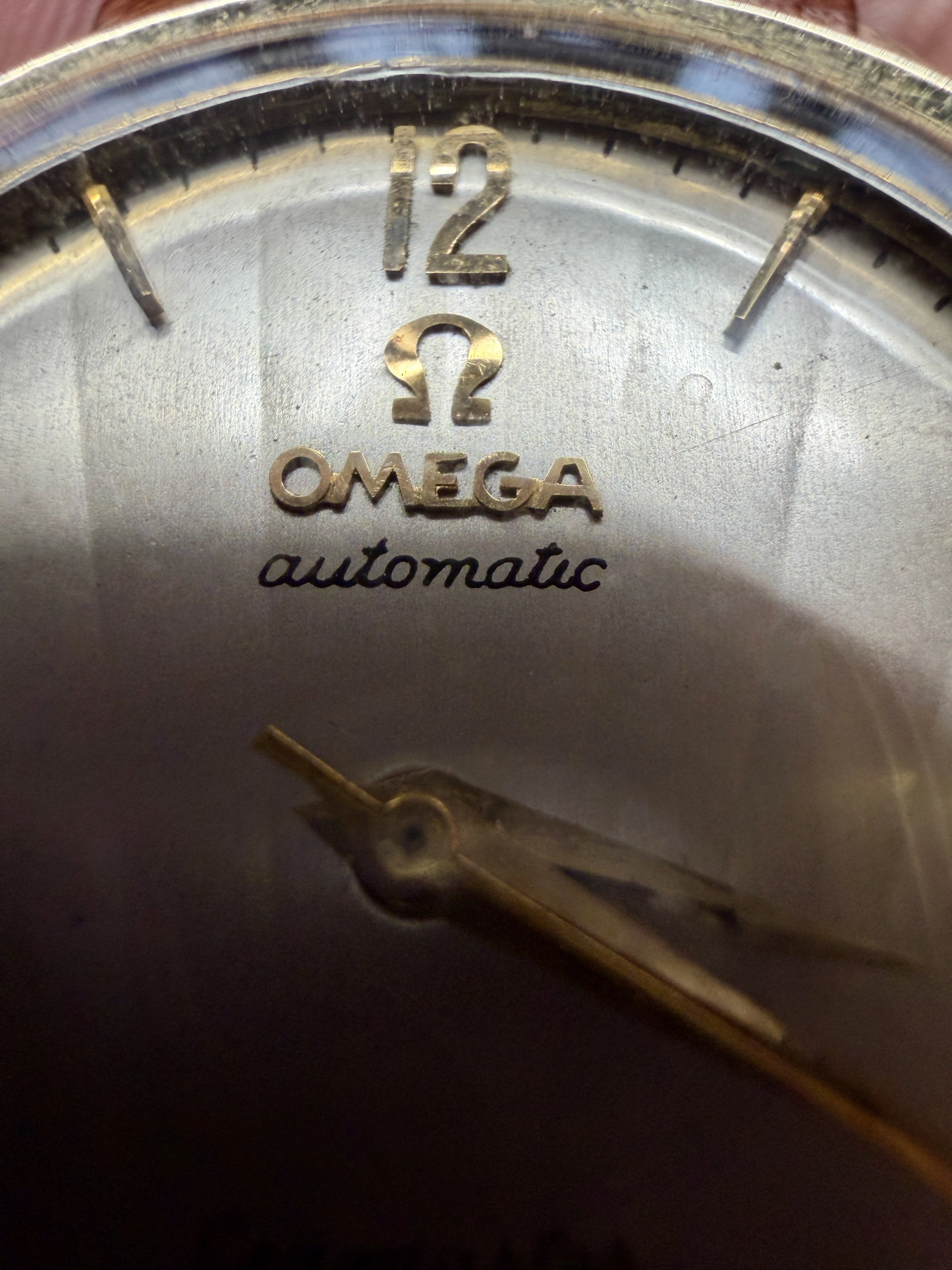

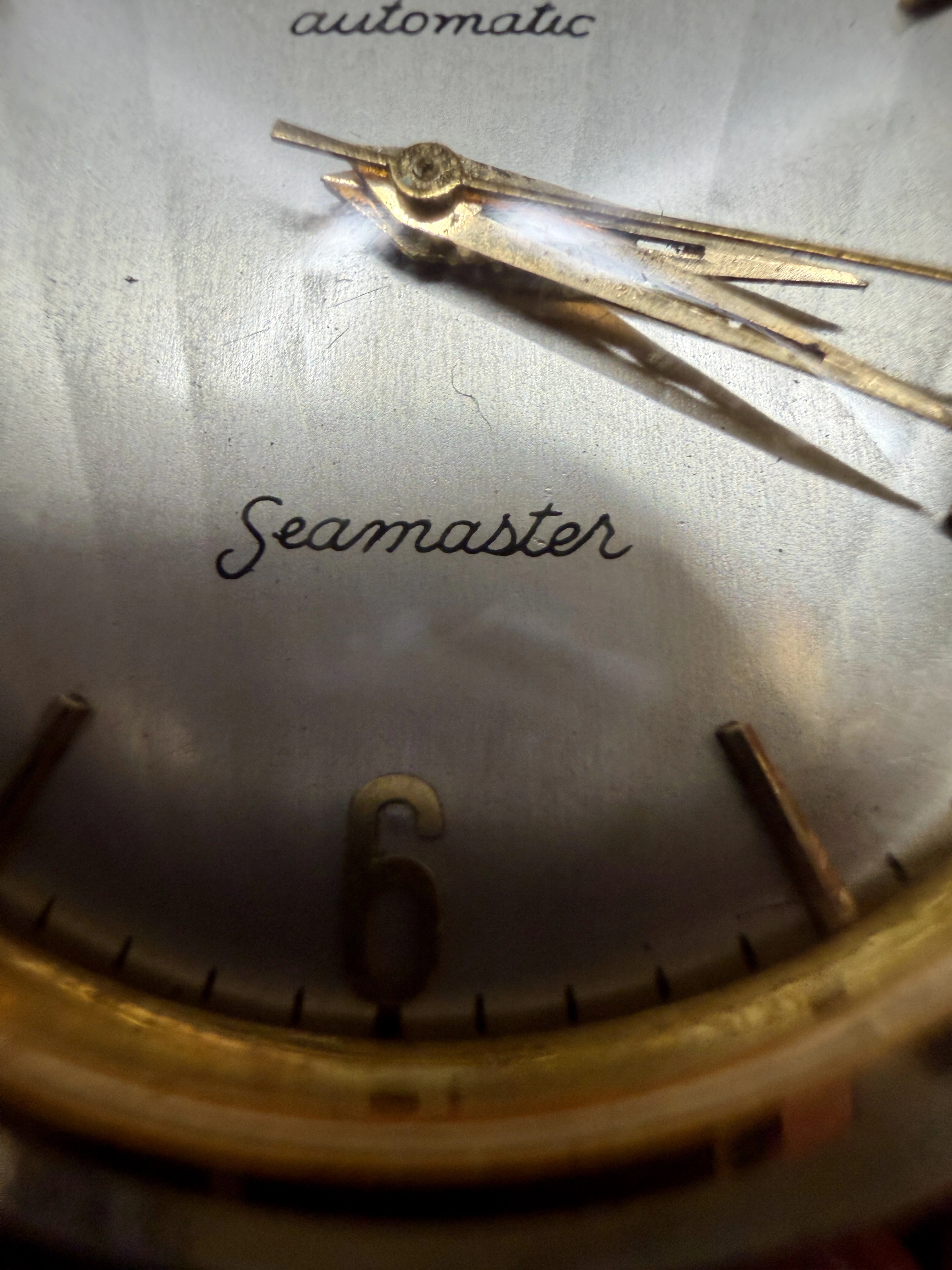

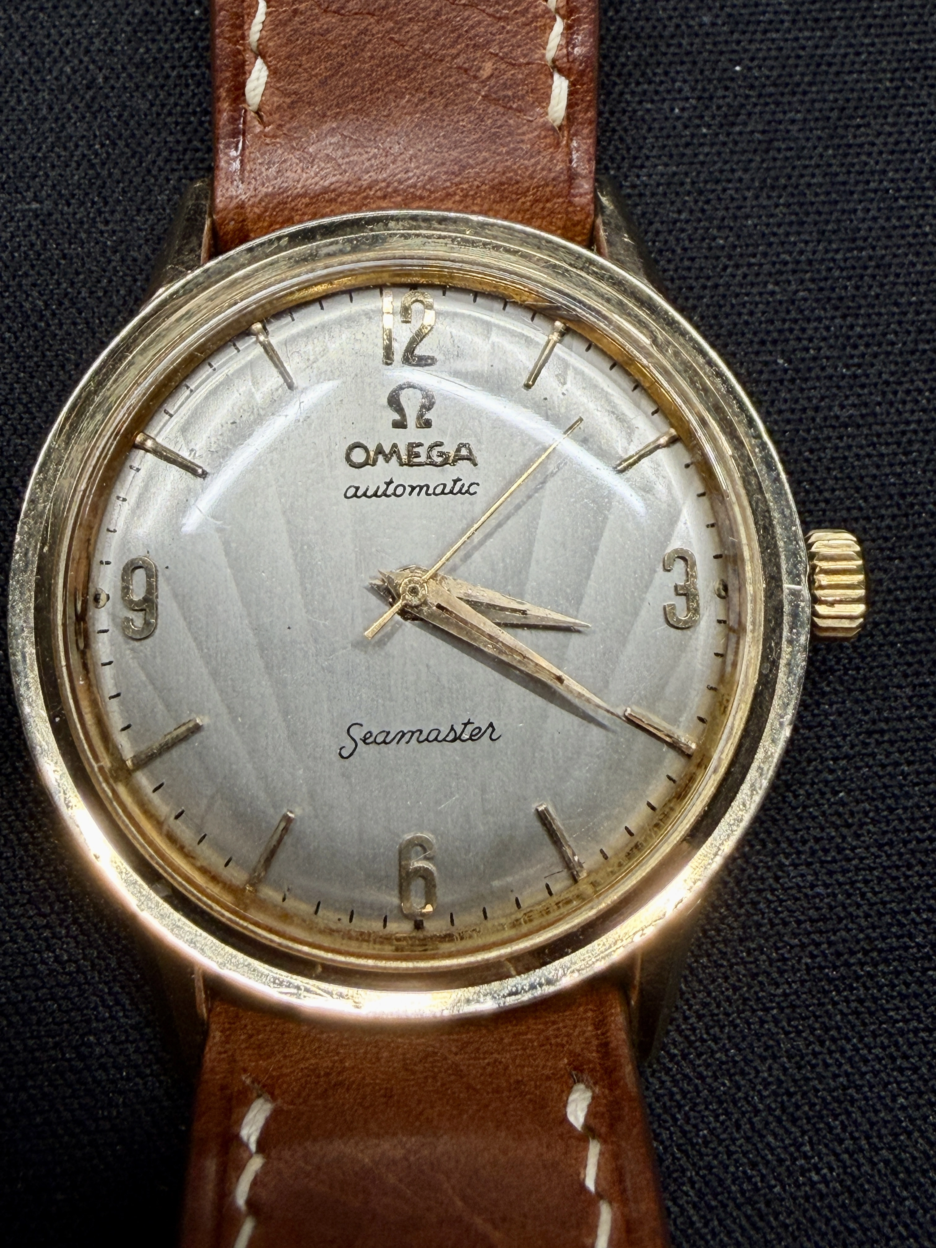

I recently picked up this Omega Seamaster with a caliber 550 and have a few questions about it. The watch is running well after a recent service, but I’m trying to determine whether the dial is original or has been refinished.

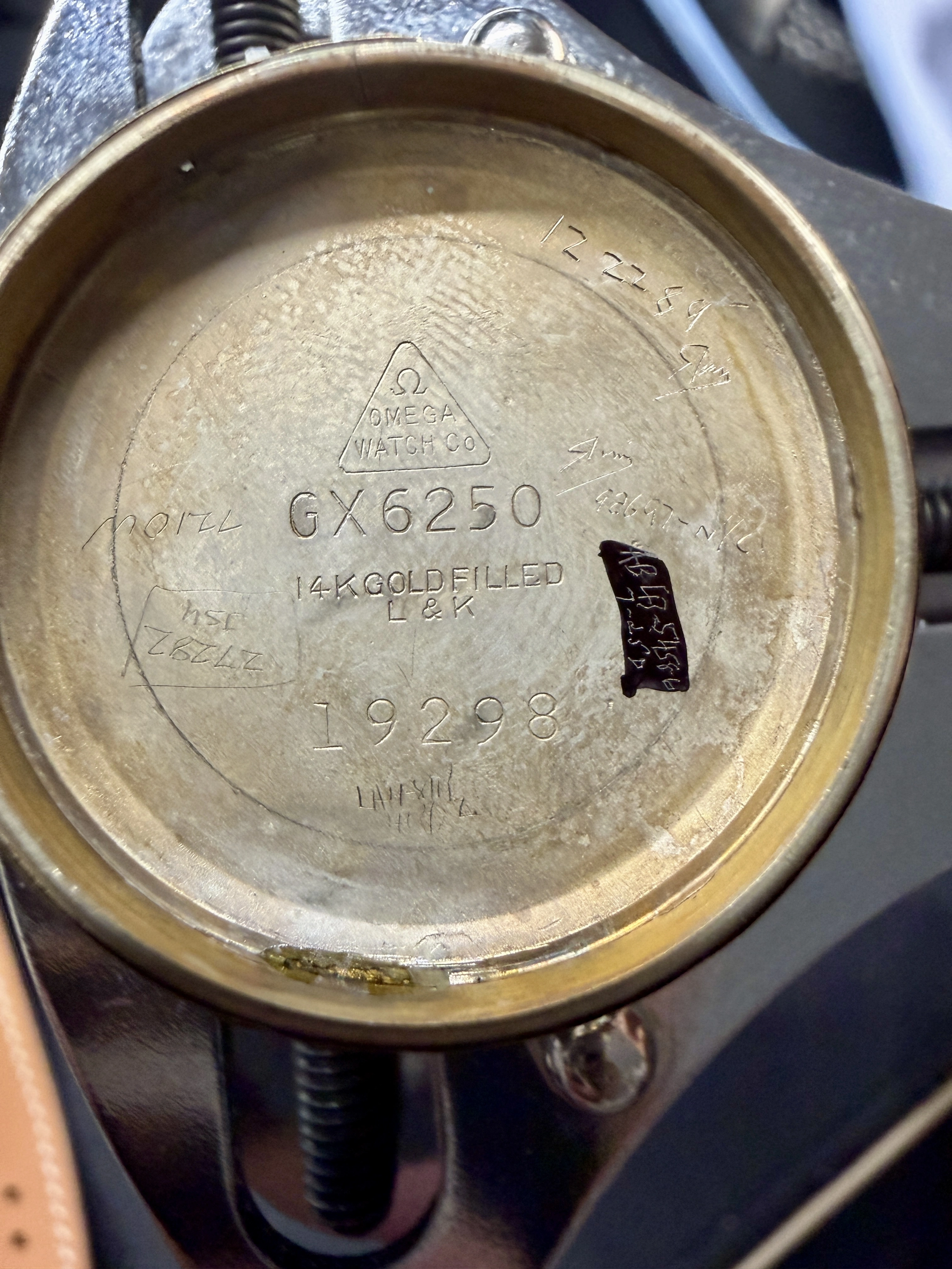

The dial has a “clamshell” texture, and there is no “SWISS” or “SWISS MADE” marking below the 6 o’clock marker. The inside case back is marked GX6250, which I believe is a U.S. market reference with an L&K gold filled case.
Has anyone come across this dial configuration before? Does it look original to you, or do you think it has been refinished? I’d also be interested in any information about the GX6250 reference, as there doesn’t seem to be much documented on it.

Refinished. The lower case automatic under the omega logo is a font they never used. Don’t have to look much past that

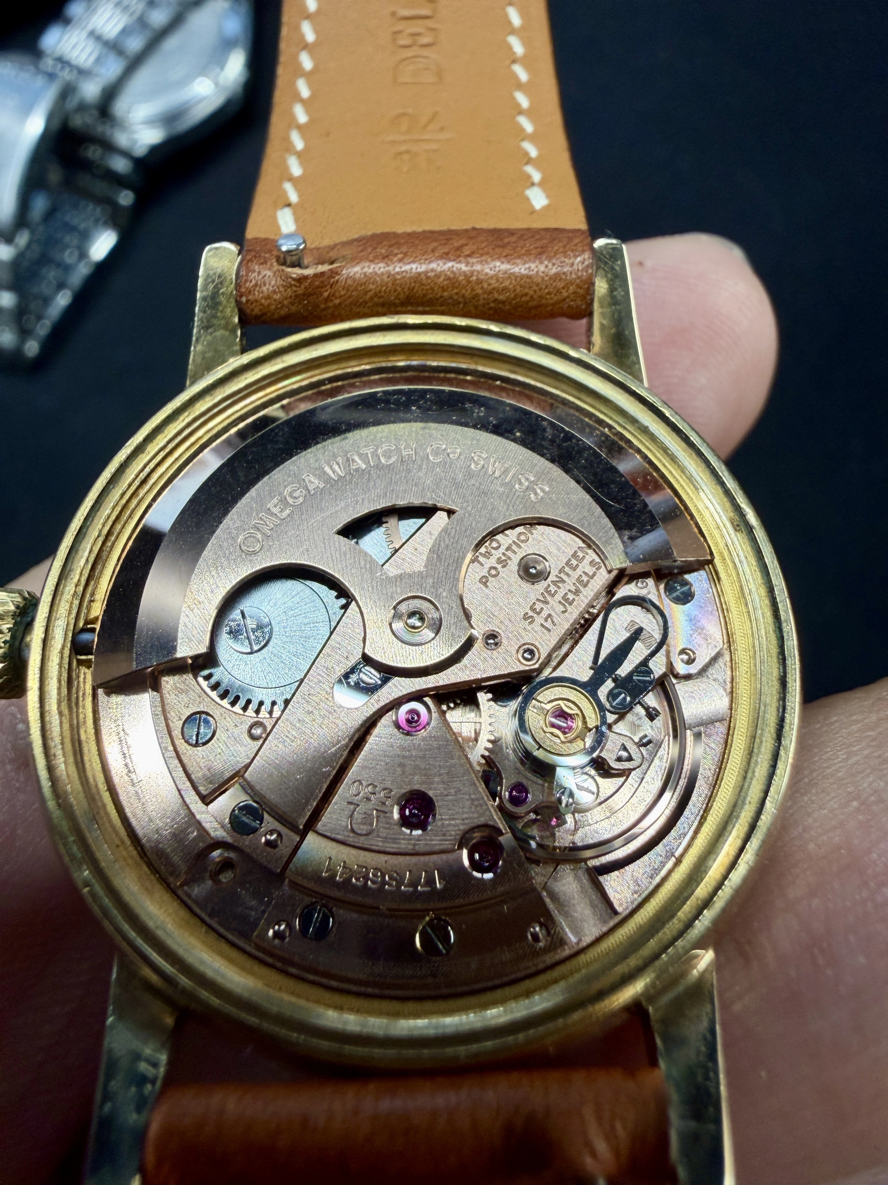

If you look at movement under regulator you see OXG which indicates it’s a US market watch.
This thread shows examples of special dials including clamshell style for reference. Including the original font styles.

Dial is refinished as noted above.
The watch is a US cased variant where imported movements were put into locally produced cases for the Omega agent, Norman Morris Corp.
Because of this, there's very little recorded information compared to that you would get with a Swiss production watch.
The best "info" would probably be vintage Omega catalogs issued by Norman Morris.
