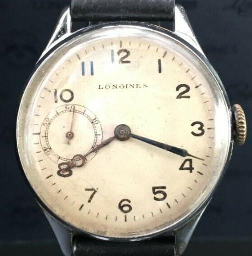

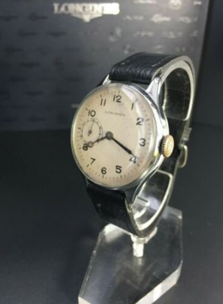

I stumbled upon this one with the following description: "Longines Jumbo 1917 cal. 15.25 for repair" and I found some things very attractive: 37 mm diameter without crown, hands and Longines logo. But the seller states "Unrestored dial in its original shape and nice condition" and I think there are several issues on this dial. But I lack the knowledge for a so old Longines if it ever existed in the first place.
In my opinion, the "8" printed on the seconds subdial and the distance from the printing and the edge of the dial show that its a re-dial. But there are a few questions I would like to ask you. Were there "jumbo" size Longines wristwatches around these years? I like the Longines logo font but, is it correct for 1917? What about the hands, including subseconds? Could the numbers and indexes have been printed on a dial with the original logo?
By the way, the case has no mark at all...

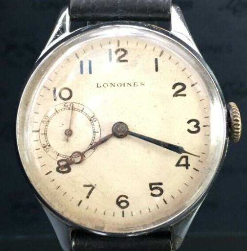

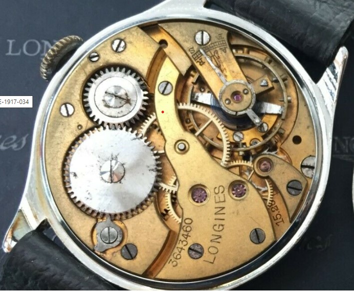

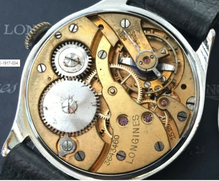

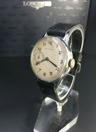

Pretty much all these large, early wristwatches are recently re-cased pocket watches; this one is no exception. When the first conversions to wristwatches were made in the early 20th century, most of the times it would be women's watches that were re-cased, as the fashion (sensibly) was in favour of smaller watches, not behemoths like this one.

@Flaco73, you need to be honest with yourself. Will you like a recased pocketwatch (recased recently, not 100 years ago) with mismatched hands, poorly reprinted dial, most probably overpolished case in a few years?

This looks really cruel with that dirty movement and poor dial, total agree with @Oku. It needs time for learning, looking and searching.
Still time passes on to find a pleasing and origin watch. Please let this one go 👎

Thanks for the comments but I wasn't even close to buy it and, after all, is a “for repair" piece. It's not working, not a "vintage" watch from 1917 and not an original Longines dial or case. By any means am I going to buy that watch. I already have a vintage Longines and I will buy some more in the future but I'm gonna spend my money only in original ones.
