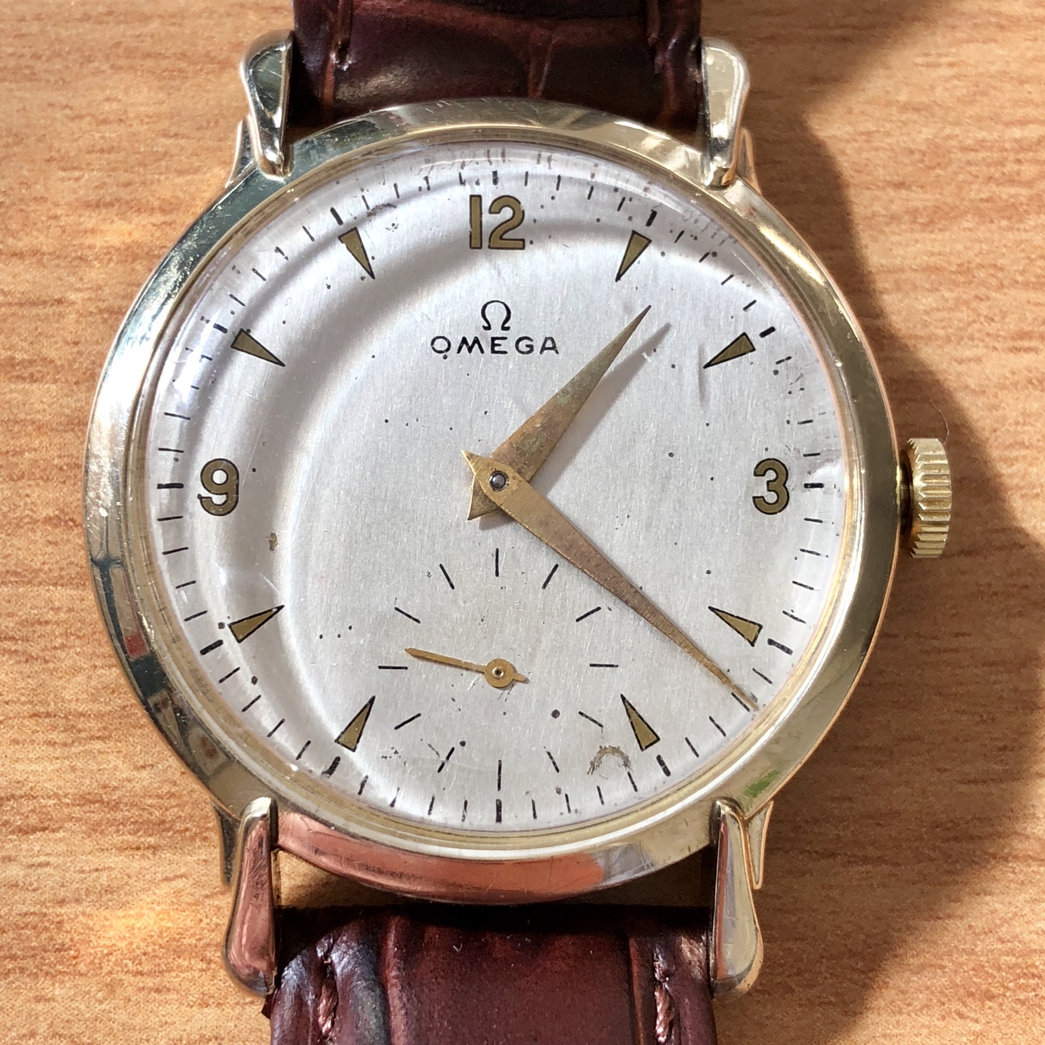

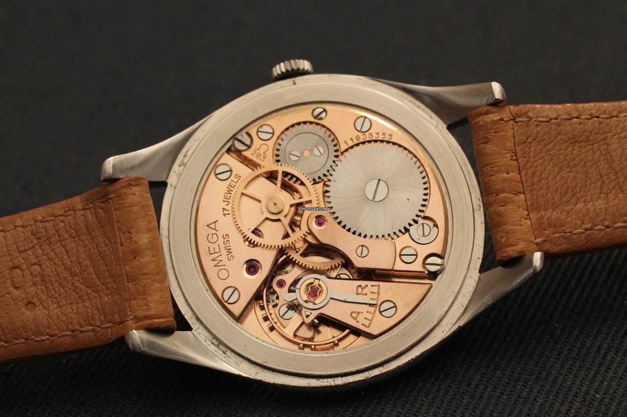

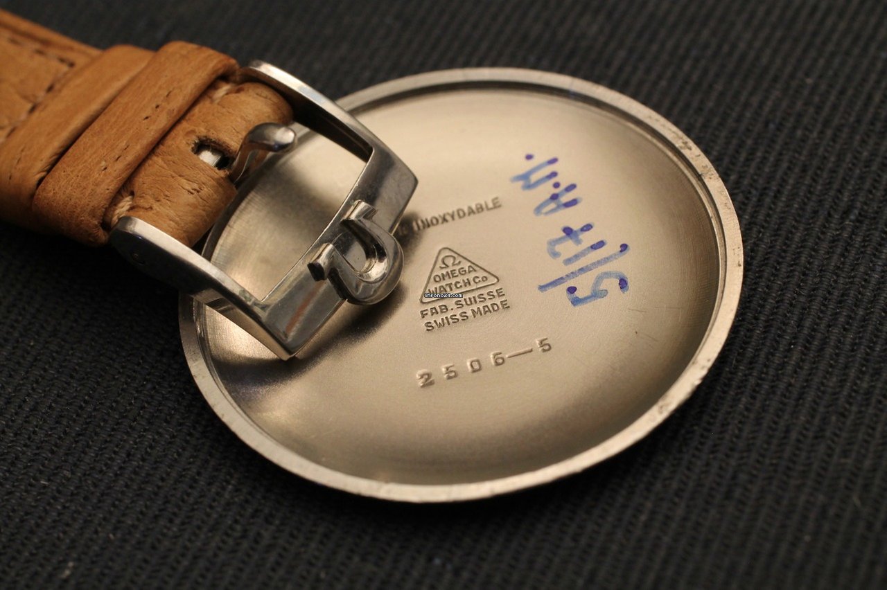

My Omega Jumbo 2506-5 cal. 283 (or 30T3 SC AM PC 17p) from 1949 (rosegold hands and hour markers)

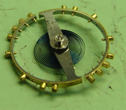

Could somebody please tell when 30T2SC started coming without compensation balance ? Thanks
3,653
7,770
AFAIK it was when 30 SC T2 changed to 30 SC T2 PC (aka cal. 280) with Incabloc - will have to look it up for certainty...

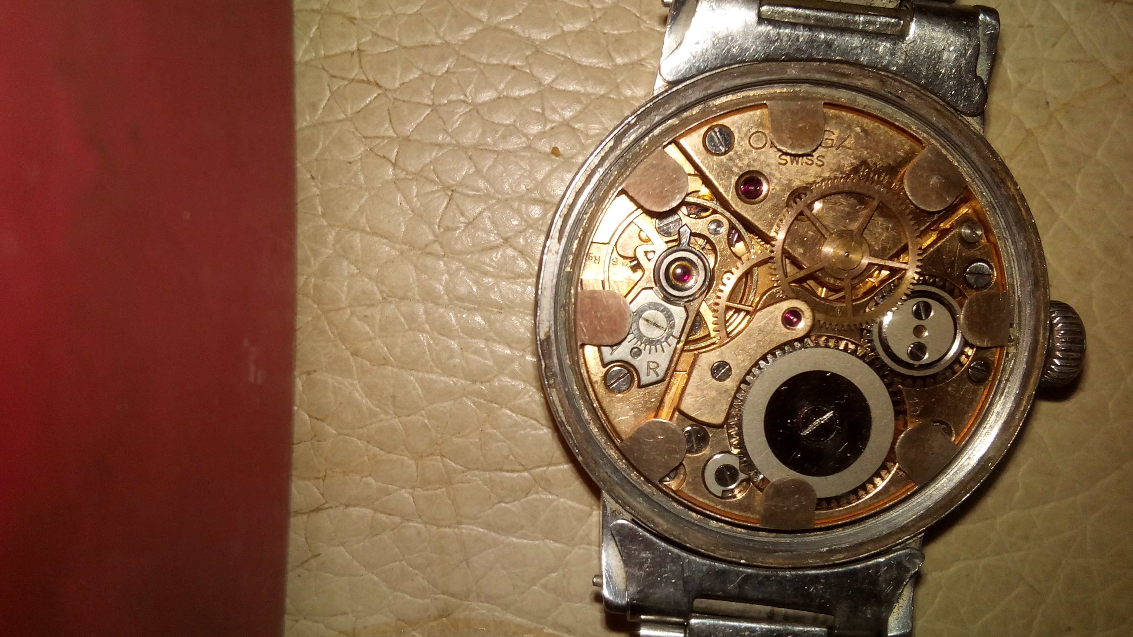

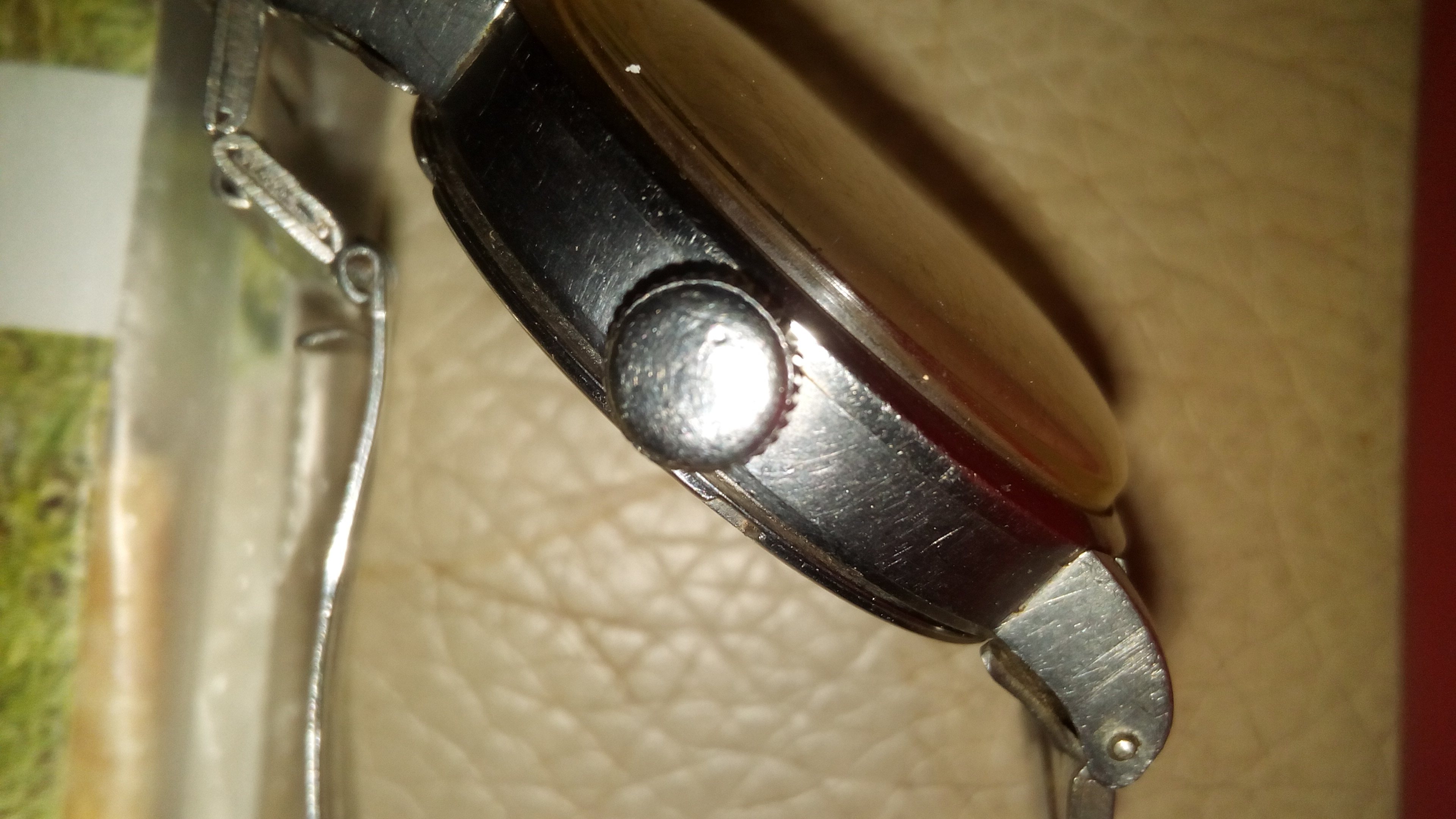

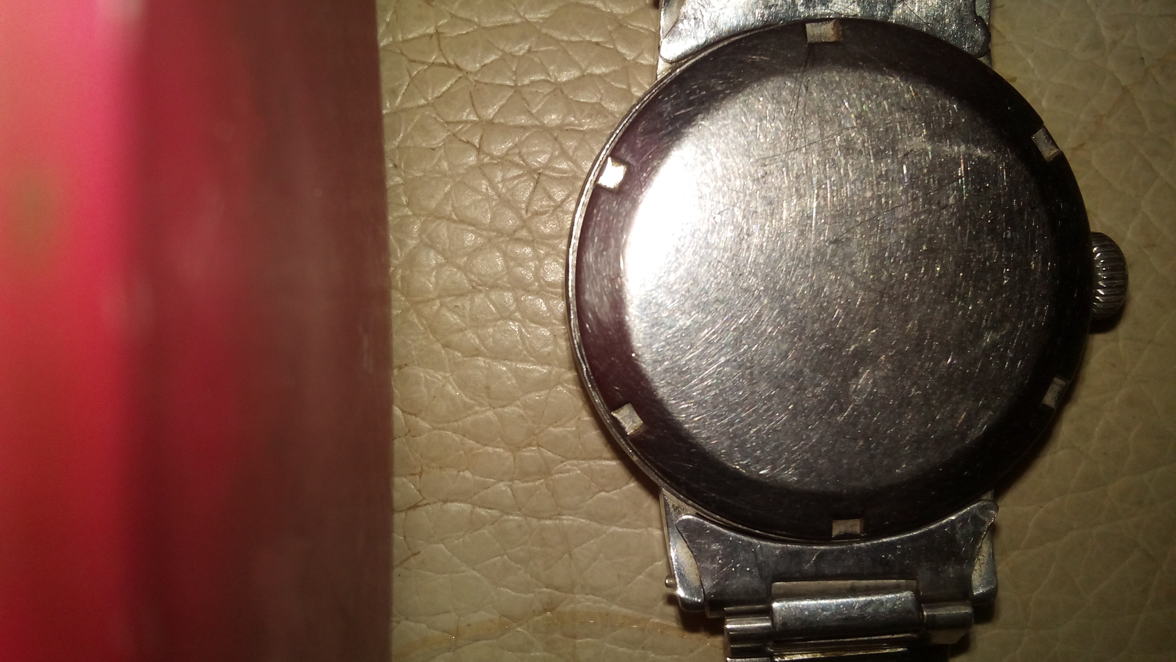

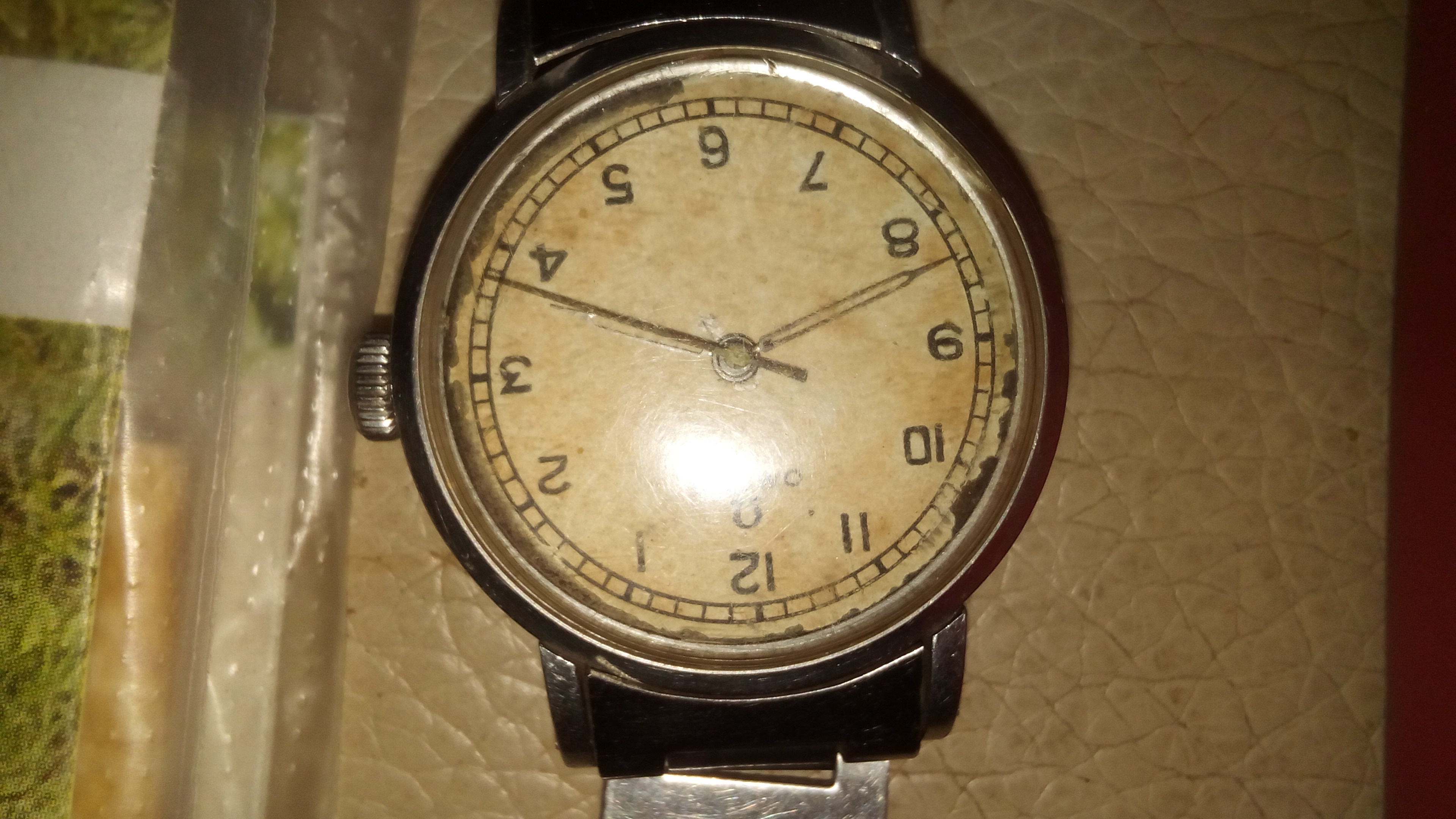

Posting some pictures of the 30T2SCRg I have. I had done the servicing myself some 40 years back. Please advise

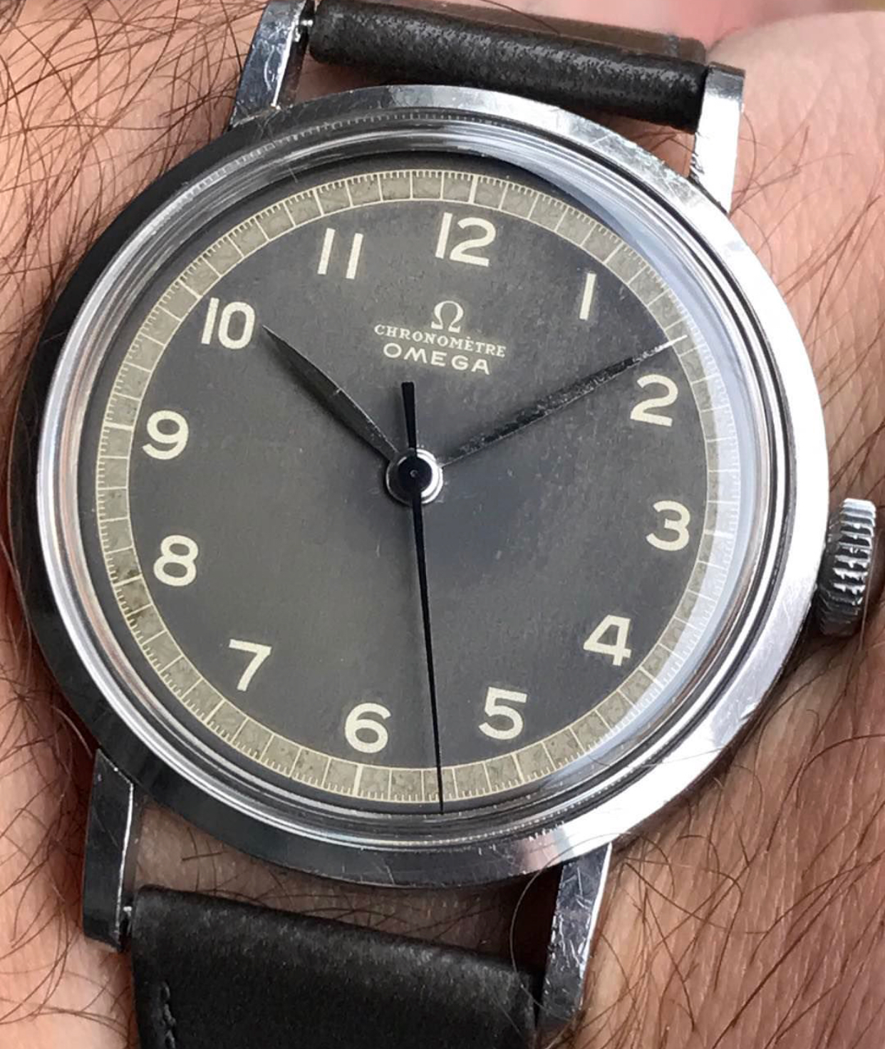

Next step in restoration is the dial. Could somebody please help me pictures of the grey dial that came with 30T2 SC Rg Ref 2410-1 563. Thanks & regards

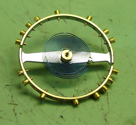

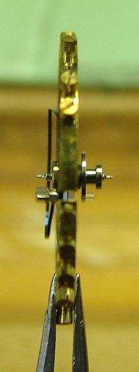

Serendipity ! Managed to get the balance !! Images posted
I hope for you that this balance will work - good luck.
To my eyes it looks as if the hairspring is terribly bent in the area of the end curve...

Thank you mac_omega. Yes it is ! But I feel it is correctable, working very very slowly and carefully. About 7 bends need to be corrected
Would you be able suggest what I should do with the dial ? It has already been repainted and badly

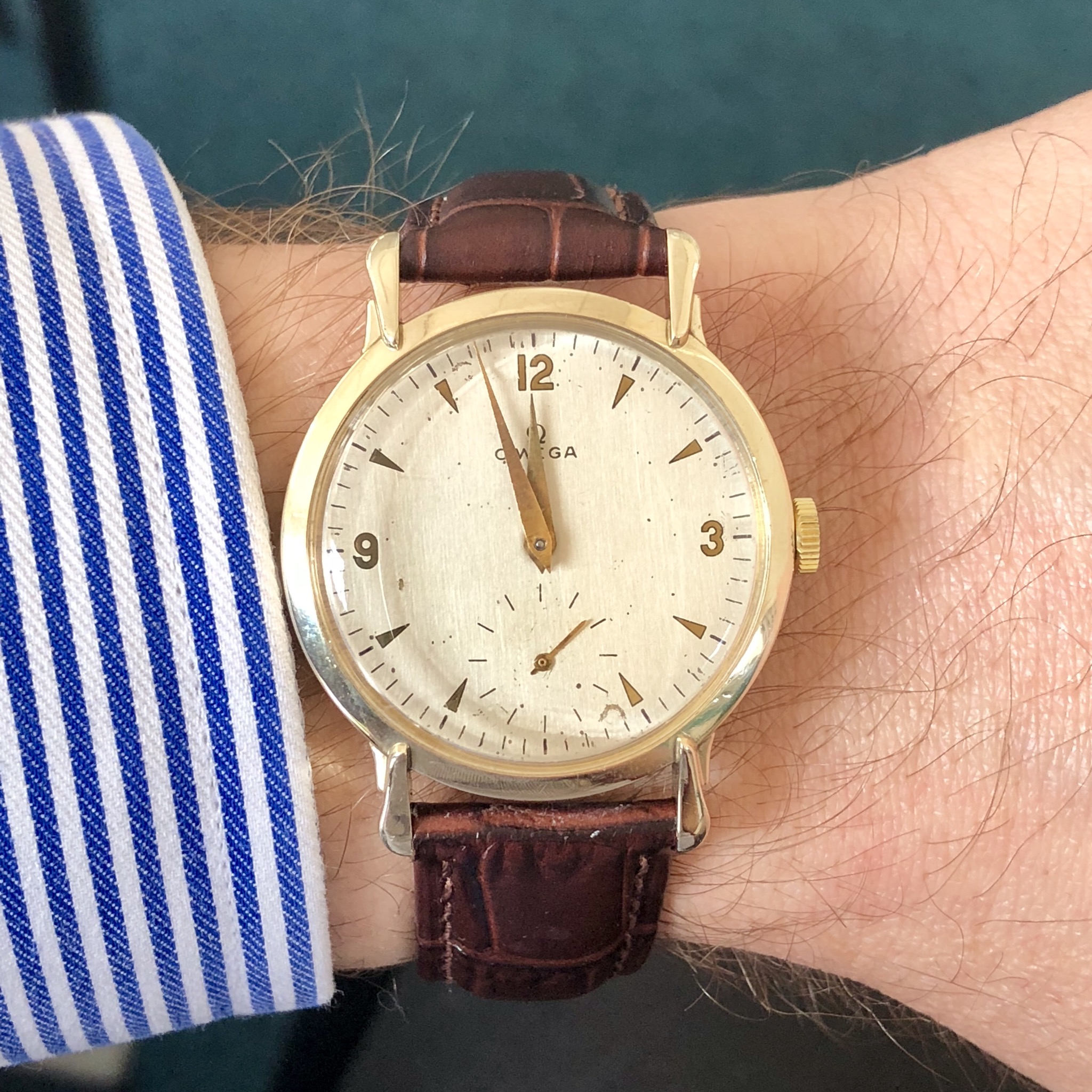

My first from 1943 - 30T2 in a D&A 10k gold filled case
Yeah that will need some work...but I have seen much worse!
Hope this helps. Good luck and please post the results.
Image borrowed from a very nice Swiss man.
Now, let’s get this thread back on display mode.😉
