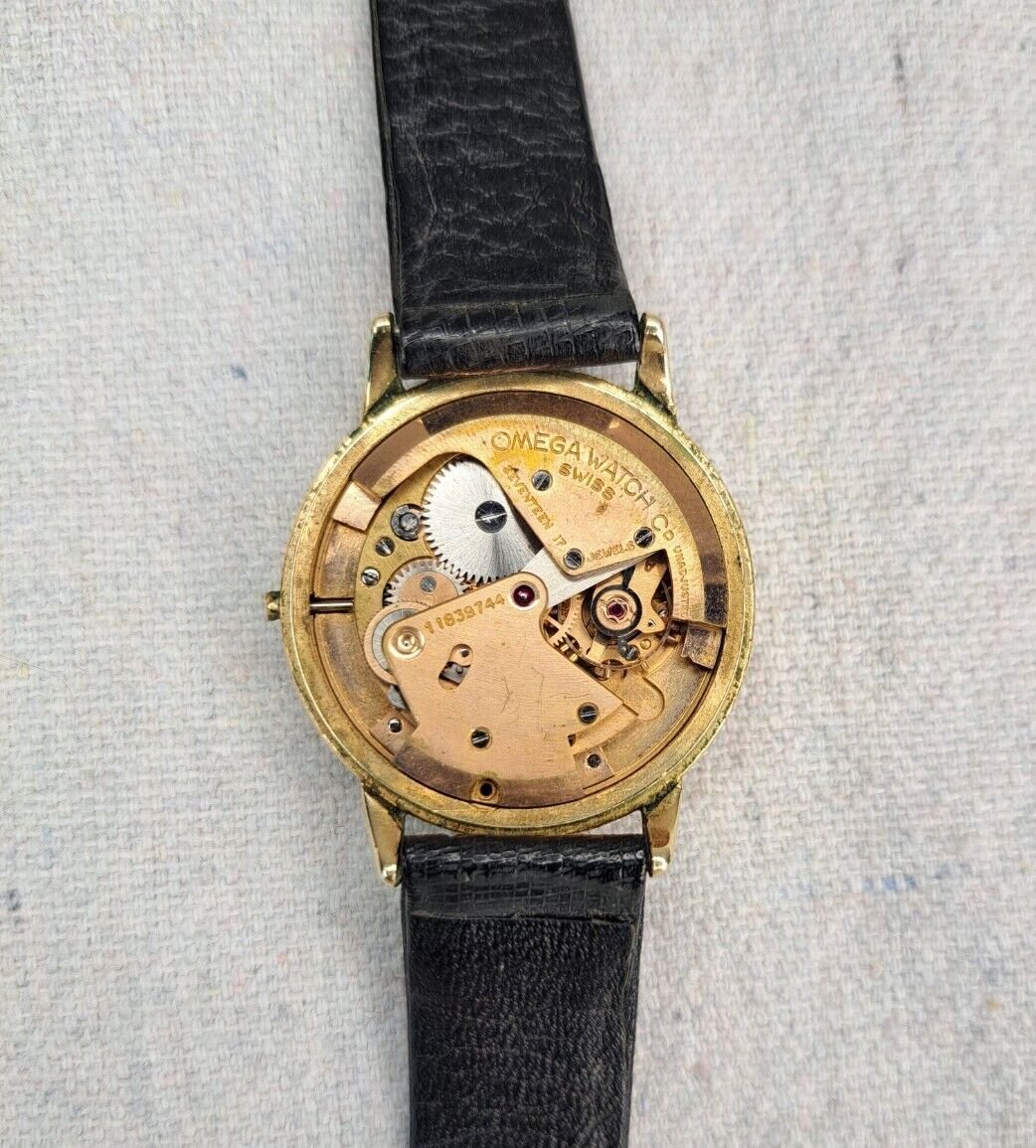

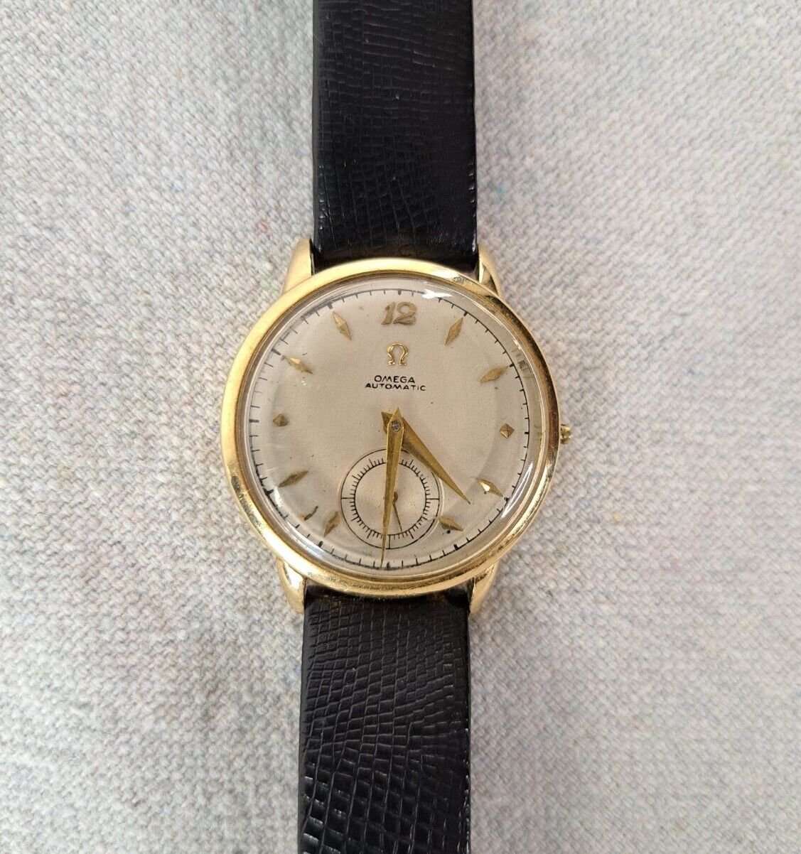

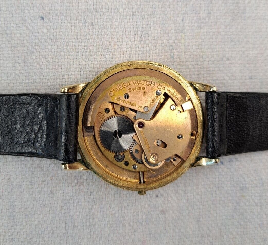

Hello everyone,
I am very very new to Omega, having made my first two purchases today. I had done some research beforehand but went out on a limb, perhaps even too much on this second watch. I ended up spending $200 on it, which while i know is low for an automatic, i wonder if eating it in repairs puts me upside down on it, at which point i should call it a learned lesson and move on.
I purchased this watch online, where they stated it was a Omega bumper automatic. The description said the watch was running (the photos suggested it) but that some things were missing, crown,screws and bumper spring. I also see one accent is off and the crystal is likely scratched. Having called an Omega certified location (and talking to a watch maker i trust, who is fair with pricing) I am thinking the bumper spring will be the biggest issue. I plan to take my time, save some money, and get this fixed up right. Based on the images what would you point to as missing, or problematic? I know the markings pointing to possible repair notes is not encouraging. I understand that a purchase of a watch like this could have been better thought out but we will call it a learning exercise as i get into watches further. Front.jpg s-l1600 (1).jpg s-l1600 (2).jpg s-l1600 (3).jpg s-l1600.jpg
16
It starts with a very badly repainted Dial. I would not touch it.
my initial thought was “variation”… now that you mention it and looking with that in mind I do believe this is leaning more towards the “lesson learned” category. Thanks for pointing that out.

If you had even one thought that this example was anywhere near original, and not a money pit, I would suggest spending 3-4 months reading through this Forum and looking at thousands of original pictures offered here.
welcome.............we all start out where you are right now......... and have the "learning experience" watches to prove it.

I appreciate the suggestion I will definitely spend more time here before I pursue another watch. it seems dial replacement and in this case painting are a common issue to look for. I have notes variation means problematic so second guess dials.
I figured being an “aged” watch it would not be all original parts especially not a vintage watch at the price I got it for with that many “service markings” But I appreciated the aesthetic and hoped that as a starting watch this is something I would be able to repair over time despite an Extensive “full service” as I was told that is $600+ before I even begin to consider parts. My plan as they state it was working was to address the bumper spring first, along with any missing screws. Then address the crown and stem and finally do a service and re-band it. Short of the service cost, from a purely cost of parts perspective would you pursue part replacement?
I plan to hang on to the watch, I hadn’t planned to re-sell it unless of course it turned out to be a true 100% non-starter.
I have also made a note that when it comes to watches like this fix-er upper = bad. I say this carefully as I’m sure this will invoke further judgement and possible chastisement. I take comfort in the fact that at least the second watch purchased was a fully working quartz watch. Although this one did need a new crystal. Thankfully we have a store with a former omega tech who has been doing this a while so maybe there is hope for that one.

If you "appreciated the aesthetic" and now you know it is an extremely poor repainting, I'd kinda think twice about sinking capital(monetary and time) and just find an original and use this one as a parts watch.
It may take a very long time to find a dial.
What you bought is a parts watch to most collectors......at best......
Good luck with your journey and post your adventure with pictures.

Thanks Tex since they state it worked i will likely look into a crown and screw or two (maybe the missing bumper piece if our store can get one) put it on a spinner i have and let it run until it doesn't and enjoy it while it lasts. I will definitely just buy a fully working watch in the future and post it this forum before making serious bids. If i do put any effort into the watch i will be sure to update here.
Just out of curiosity do you know of any good threads that point to good older vintage style of watches or starting points for new buyers? I would like to stick to vintage automatics but would like to make sure i avoid any problem calibers/years/models. Obviously i have a long way to go in my journey of learning so i appreciate your input. No future purchases will be made until i as you said spend some months learning

I'll just add that a nonworking movement can almost always be sorted but a refinished dial can't.

noted. And having read the article on dials and what to look for I see where I went wrong in this particular case on the dial. I don’t know if you all have had any experience trying this but since this is already a “refinished” I thought I’d ask. Is there a scenario in which one could find a remover that worked on the added finish that would not harm an original finish? For example could the large line around the minute markers be removed while keeping the original lines intact. I wonder if some of the shift is the missing crown. Hopefully it centers once added.

Another collector used your watch as a parts watch........crown, spring and probably others as you get into it.
No, all gets stripped, repainted and then markers added back( and they didn’t do a good job there, either)

Stop trying to convince yourself that it's worth spending any more on this watch.

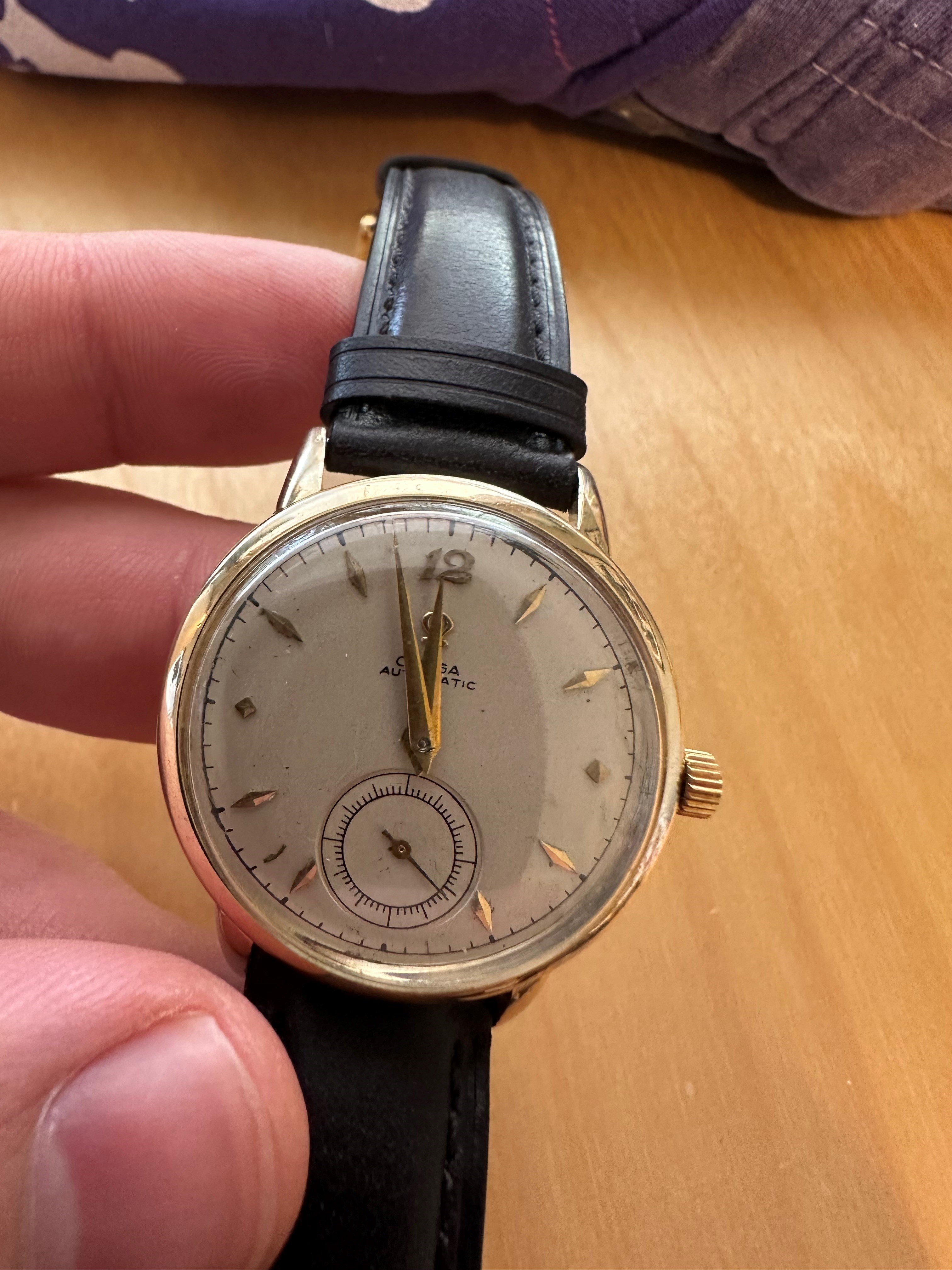

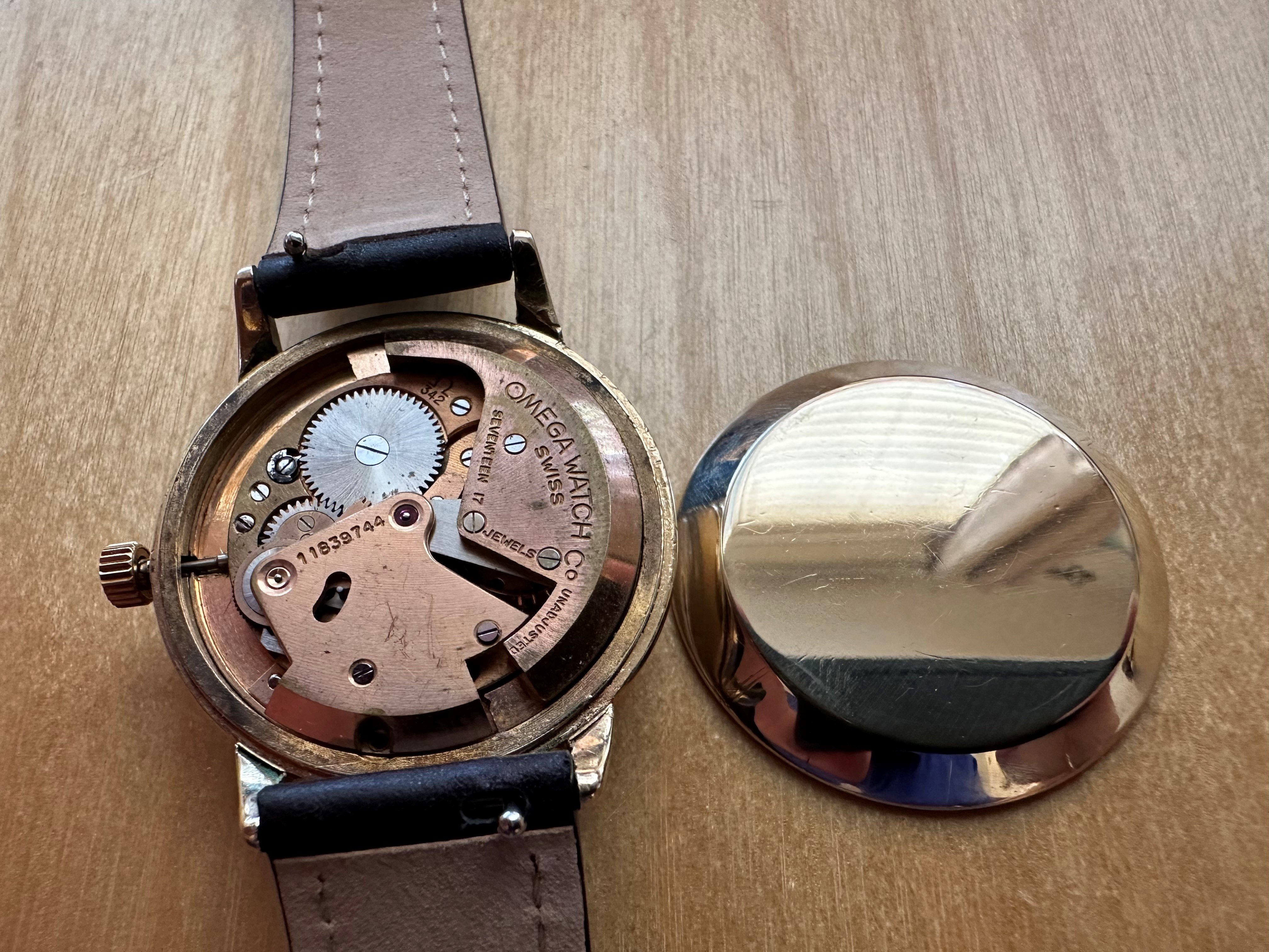

Hey! A fun ending to a way to long story for anyone who is interested several months later. Per the advice i left this watch sit in a case as a testament to poor choices. As it sat I found a friend who had a bag of watches he had found in a storage locker. He offered them to me for $25 and i bought them. There was a healthy mix Timex, swiss army, casio, etc watches. So over a few months I fixed, sold and bartered with those. In my journeys I met someone who bought and sold other things and knew a guy that repaired watches. This person regularly dealt with omega and Rolex watches. He fully services watches (replaces springs, oils etc) and he quoted me $160 to service the watch and repair it using non-omega parts over a longer time (so not a quick service) (or a lot higher for omega parts). The guy who introduced me offered a deal that included a few watches and items i had from the $25 unit purchase and he would cover the cost. So I agreed. It took 5 months to get back but here it is fixed time indicator and non-omega crown. Fully working and keeping good time all thanks to a $25 storage find.
