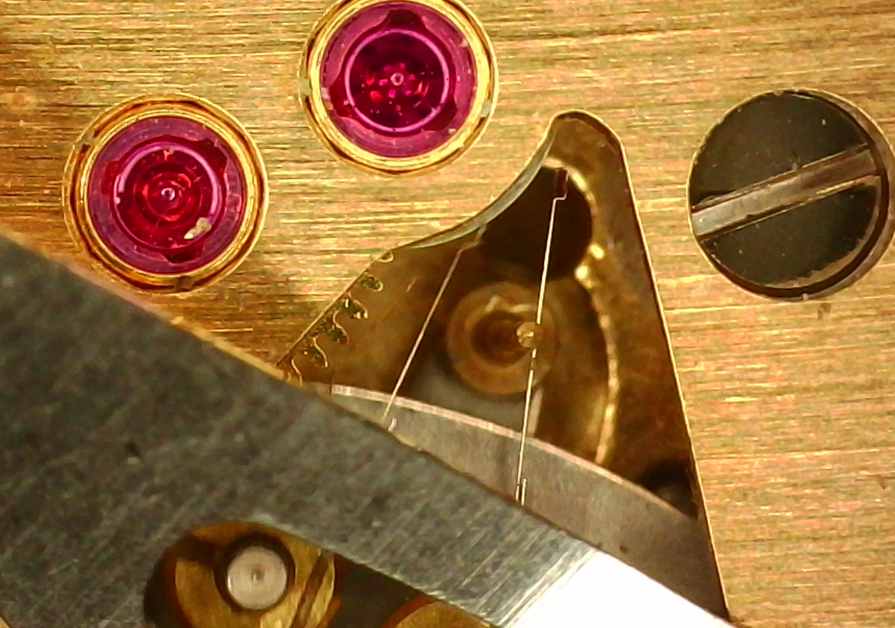

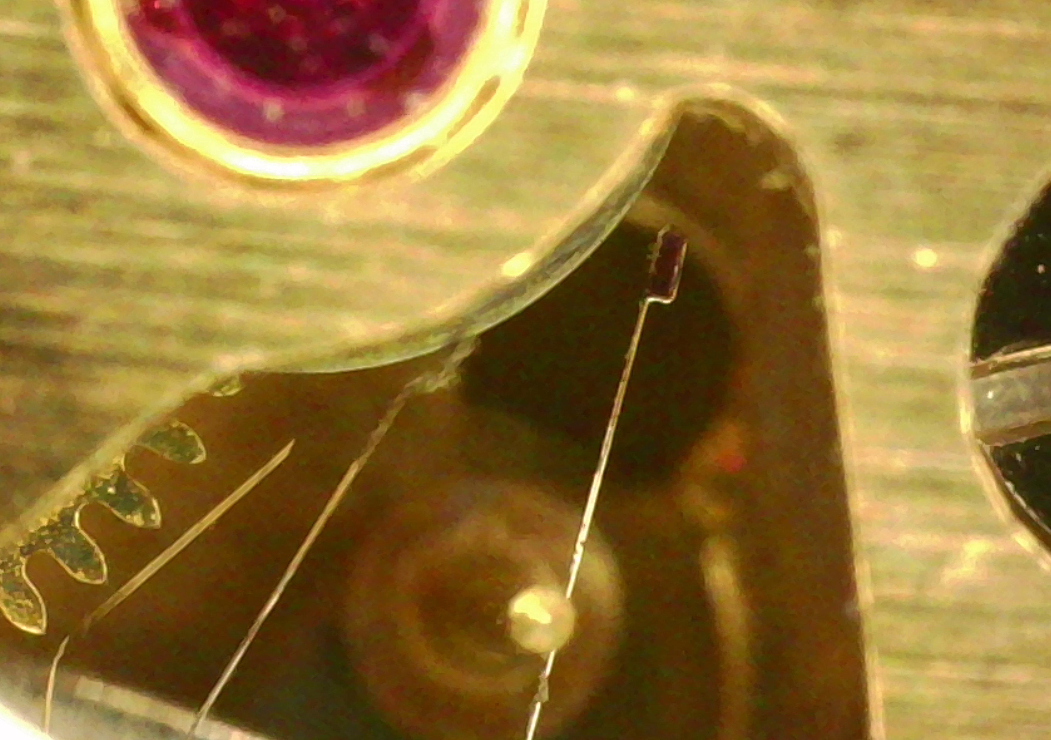

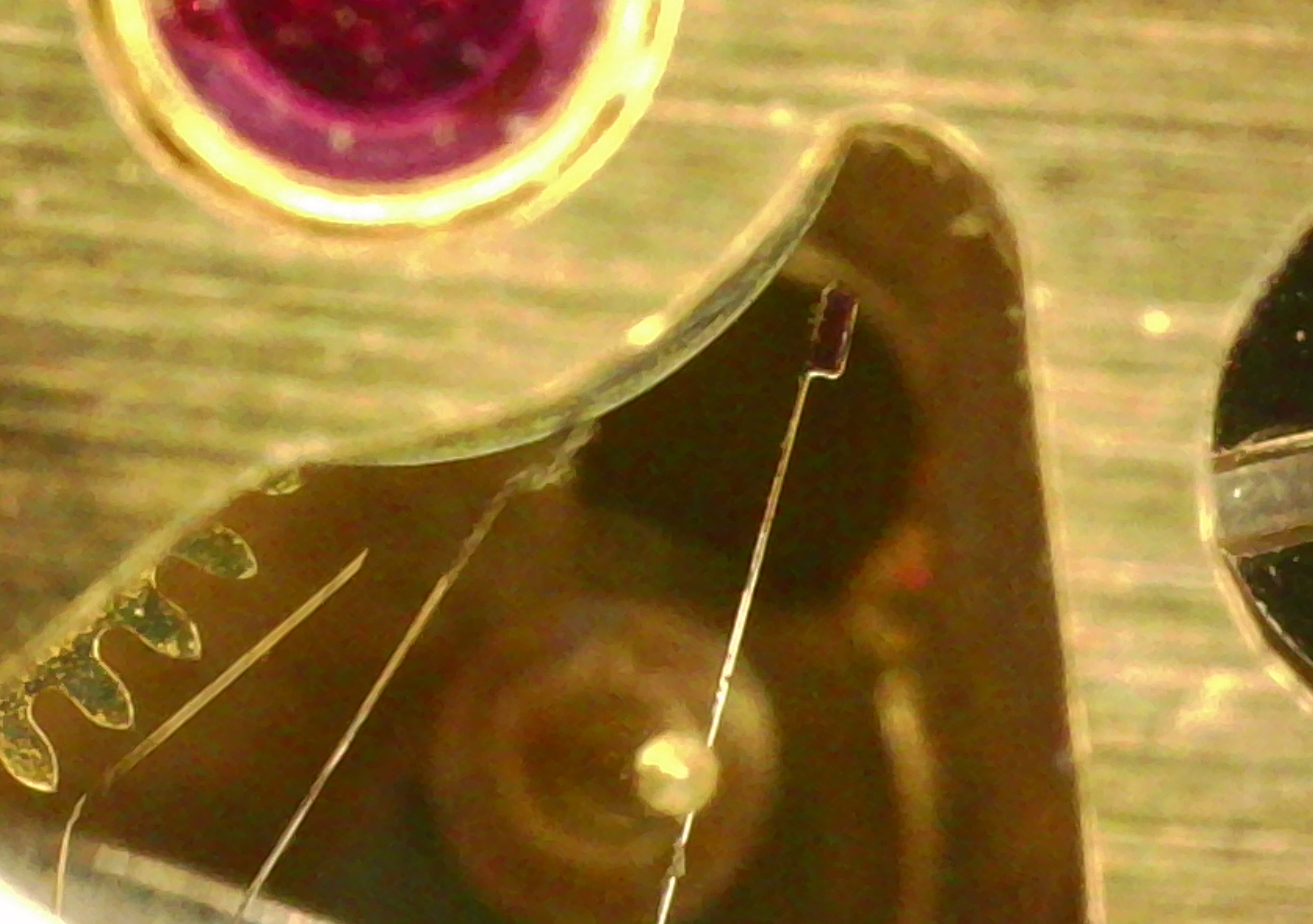

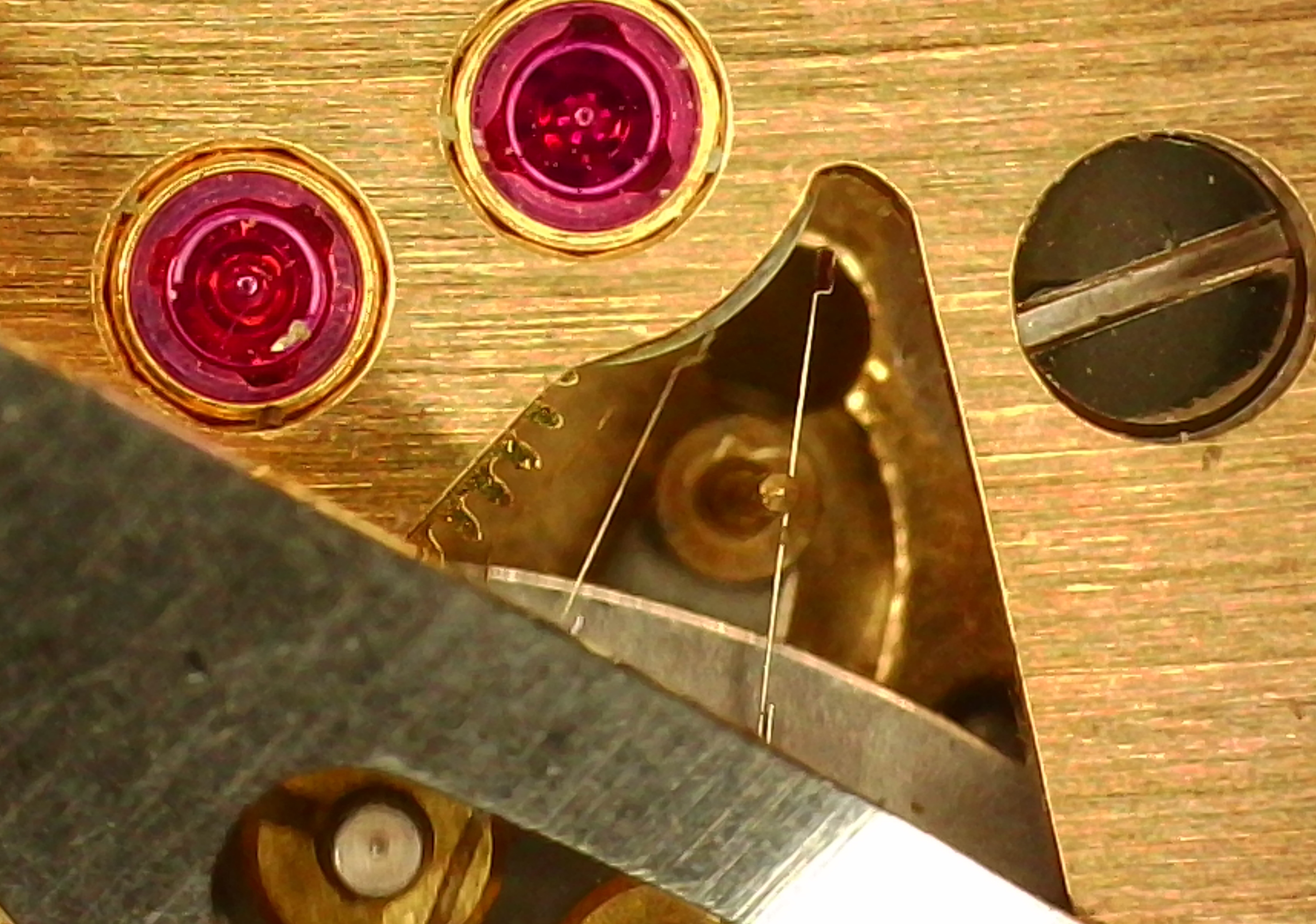

(1) Using a microscope, he showed me that the pawl jewel (the one that halts the index wheel) was missing, that's the reason for a "fast" movement.

An Accutron that ran FAST with the pawl jewel missing? It probably came to life with a new cell, all right, but that it ran AT ALL without the pawl jewel? To my way of thinking, this is not possible! I suggest you get another opinion,
Hi, I've seen the watch running without a jewel on one of the two indexes through a microscope. It could be that I'm wrong about the index/pawl missing jewel. I'm sure that one of the two is missing. Tee watch goes fast easily 5 minutes in one/two hours.
I suppose, if the beryllium spring that carried the missing pawl jewel was in position on the index wheel, it could happen. I was visualizing the entire pawl jewel assembly, or the spring and jewel both missing. Don’t expect the index wheel to last for very long, considering the missing jewel.
