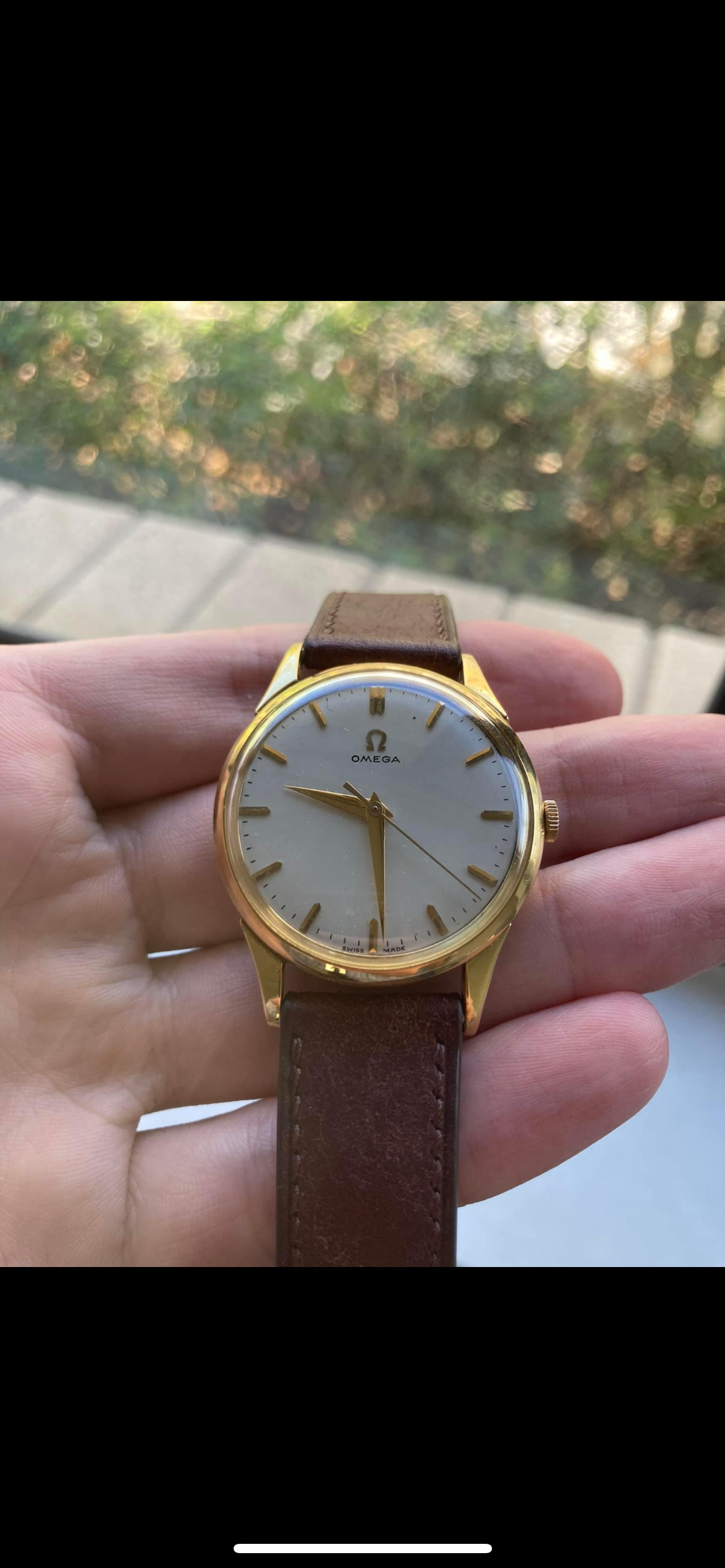

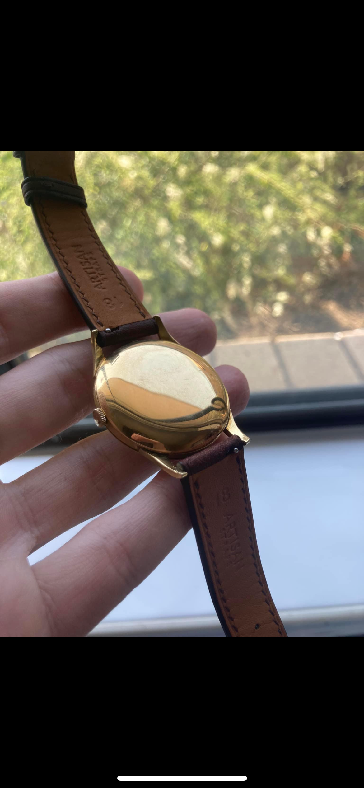

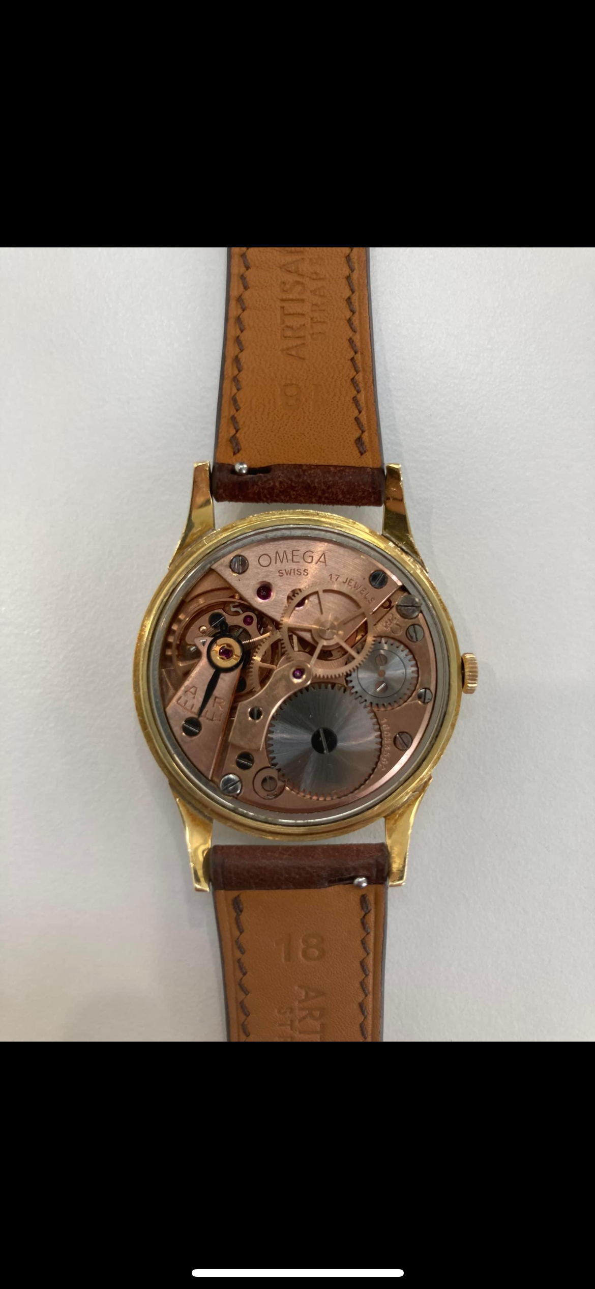

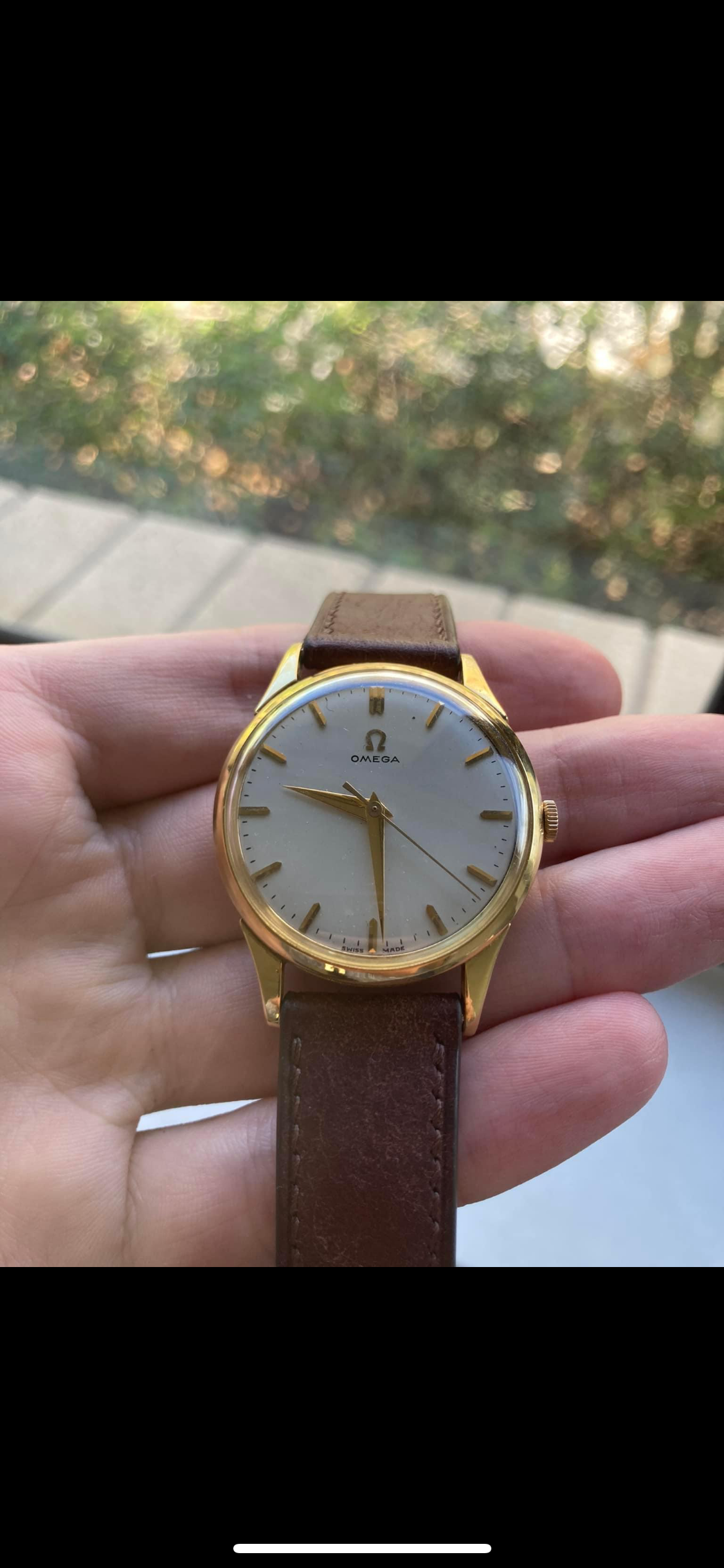

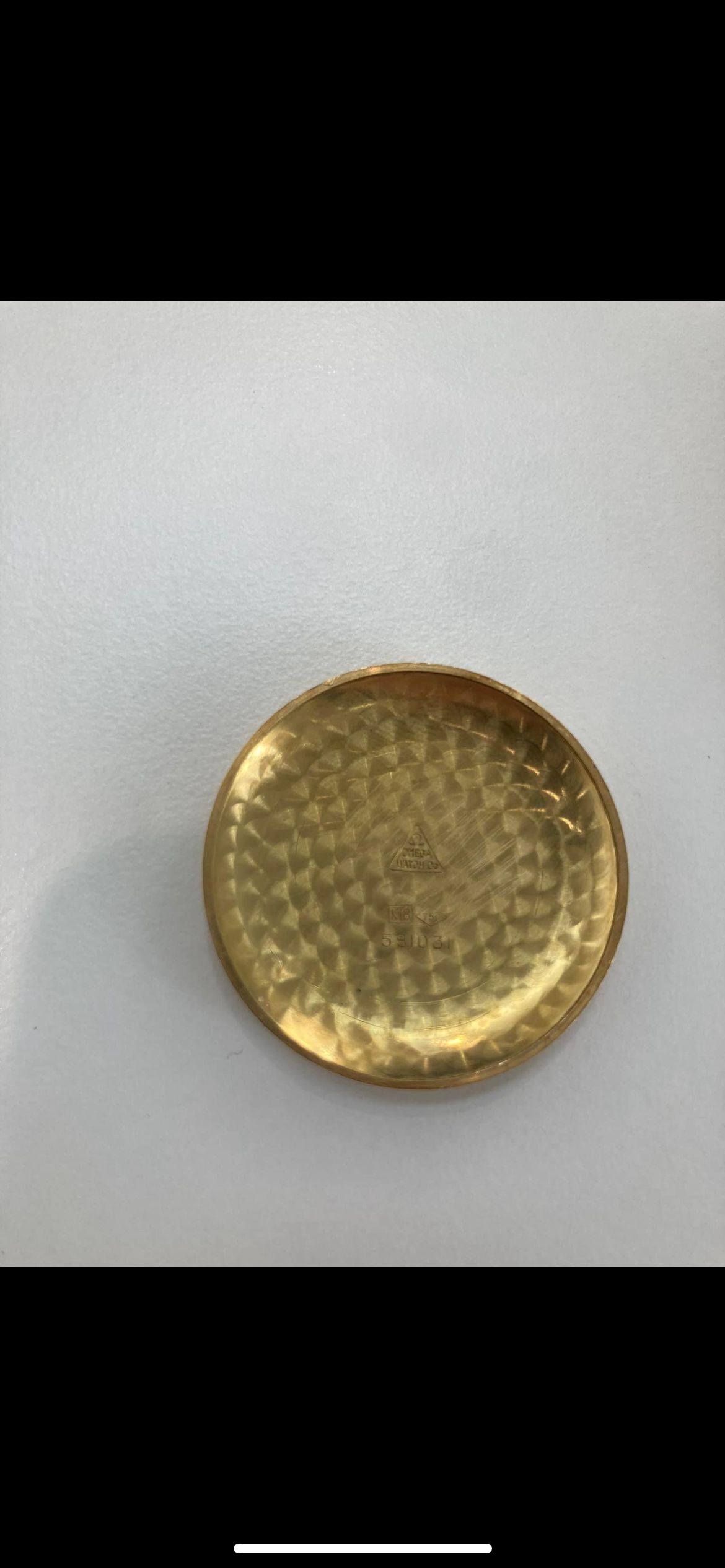

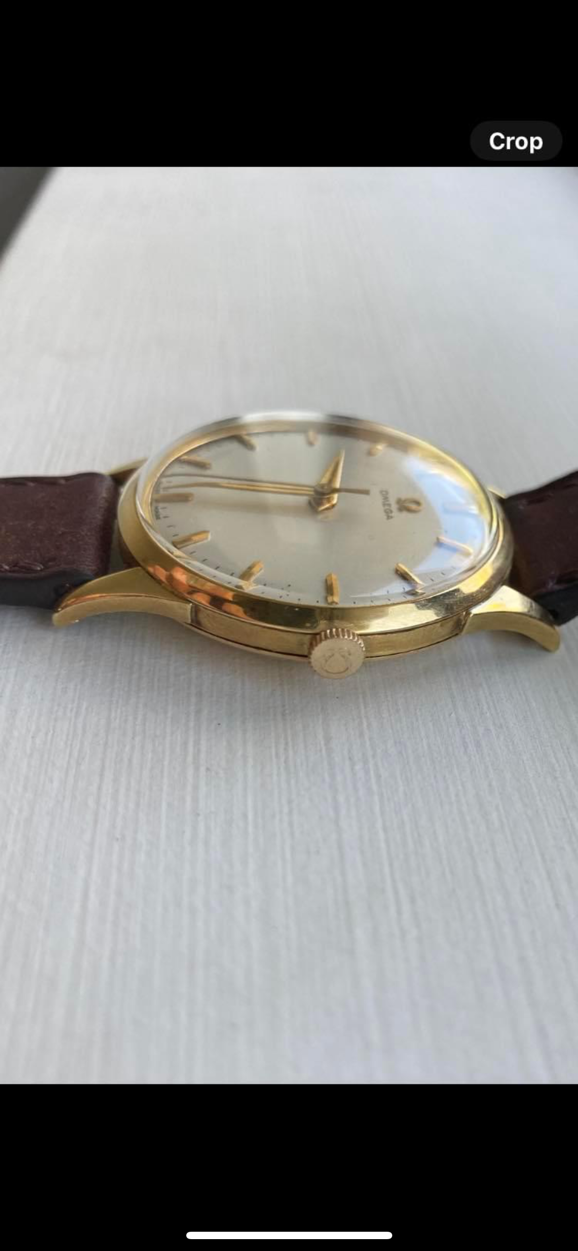

Hi everyone,

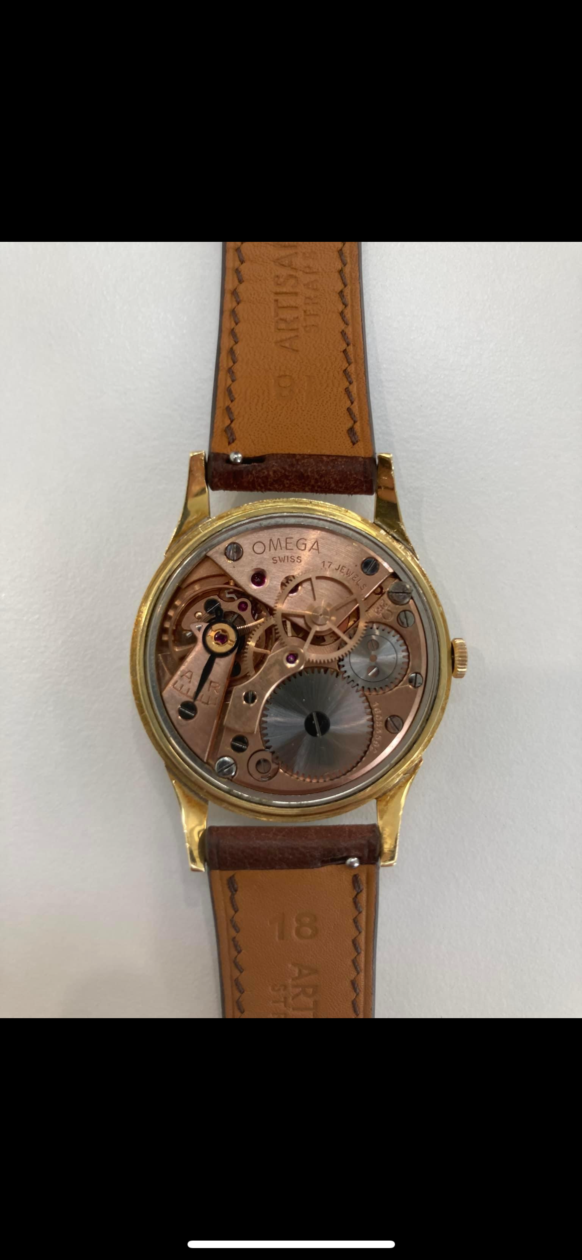

Looking at this omega from approx 1958, has gold markings on case back and seems to be a Cal 283. From my research it might be ref 2686?
Just wondering what people’s thoughts are on legitimacy? Any help would be greatly appreciated.
Thanks!

It’s always helpful to post the price, but in this case it makes little difference as the dial has been poorly refinished. Pass
13,532
23,475
Asking $870usd. How can you tell it’s been refinished poorly? Thanks
The font/print is far too think. Also, look at the spacing of the minute hashes compared to the applied markers, particularly around 10, 11 and 2. The spacing is terrible, a common issue with redials.
