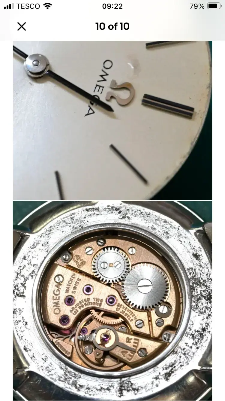

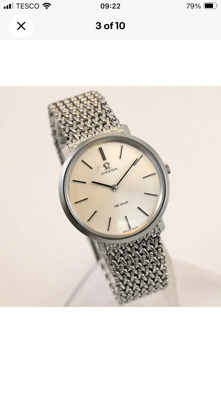

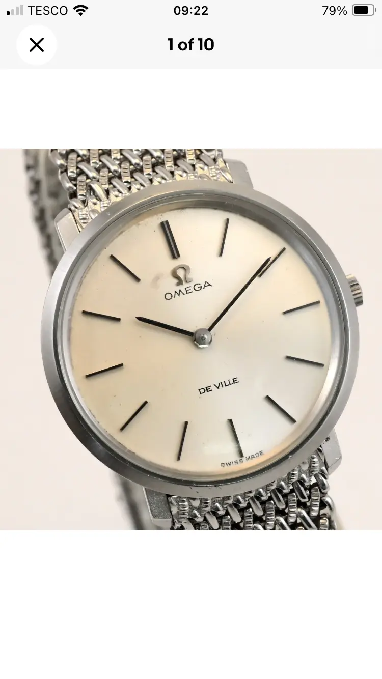

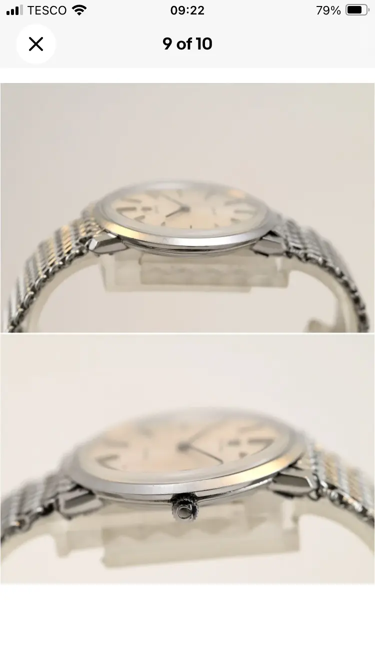

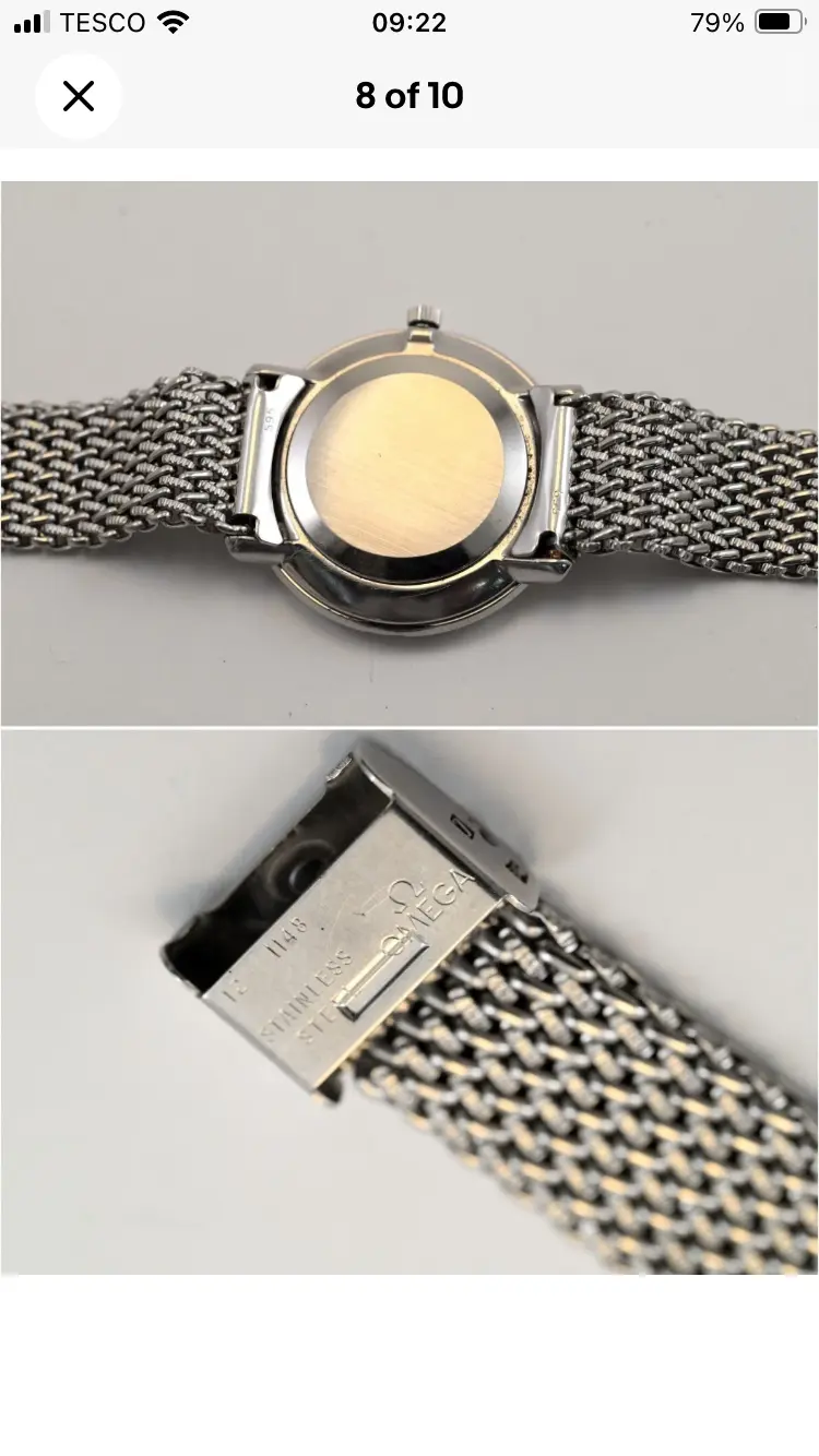

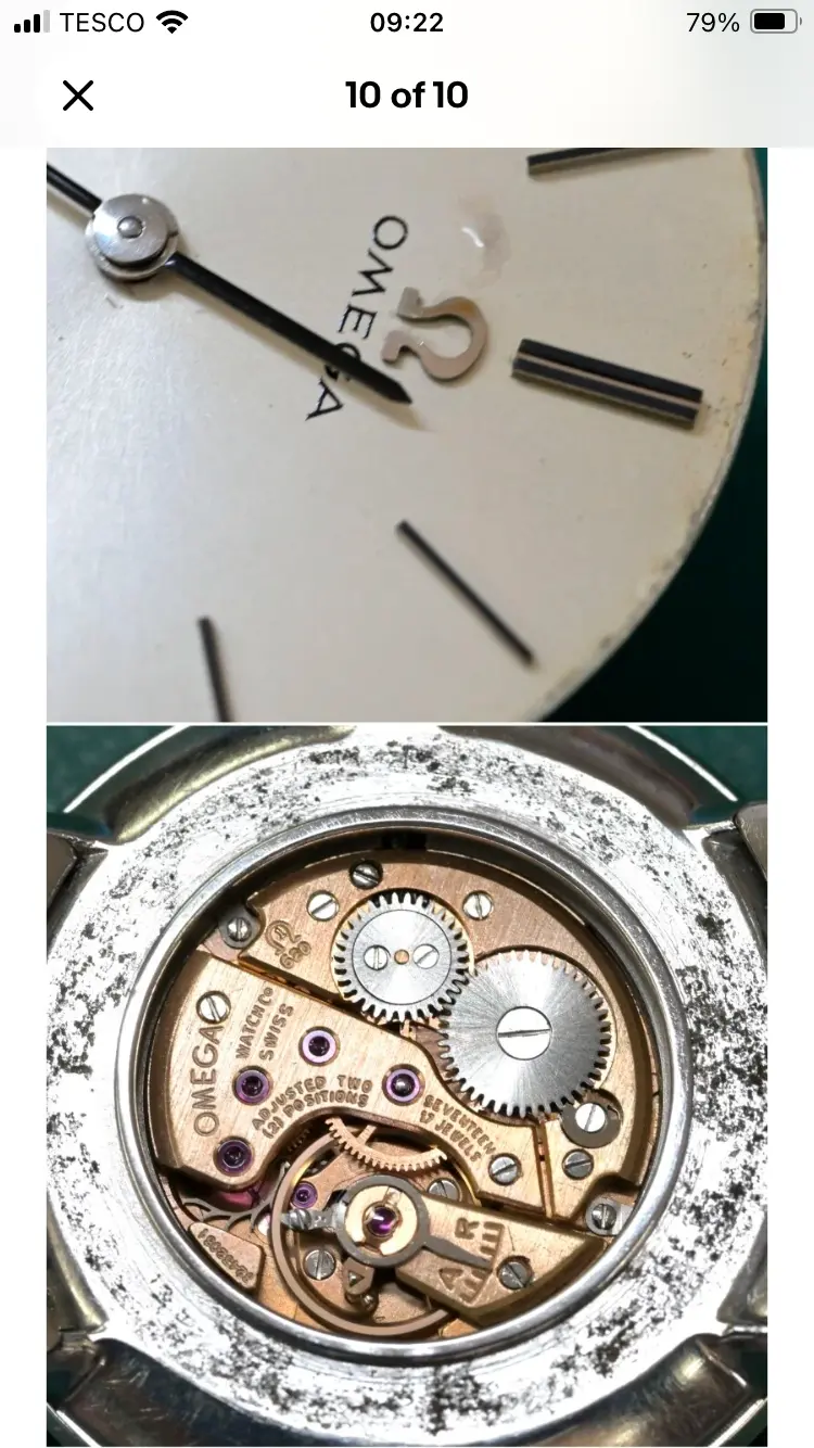

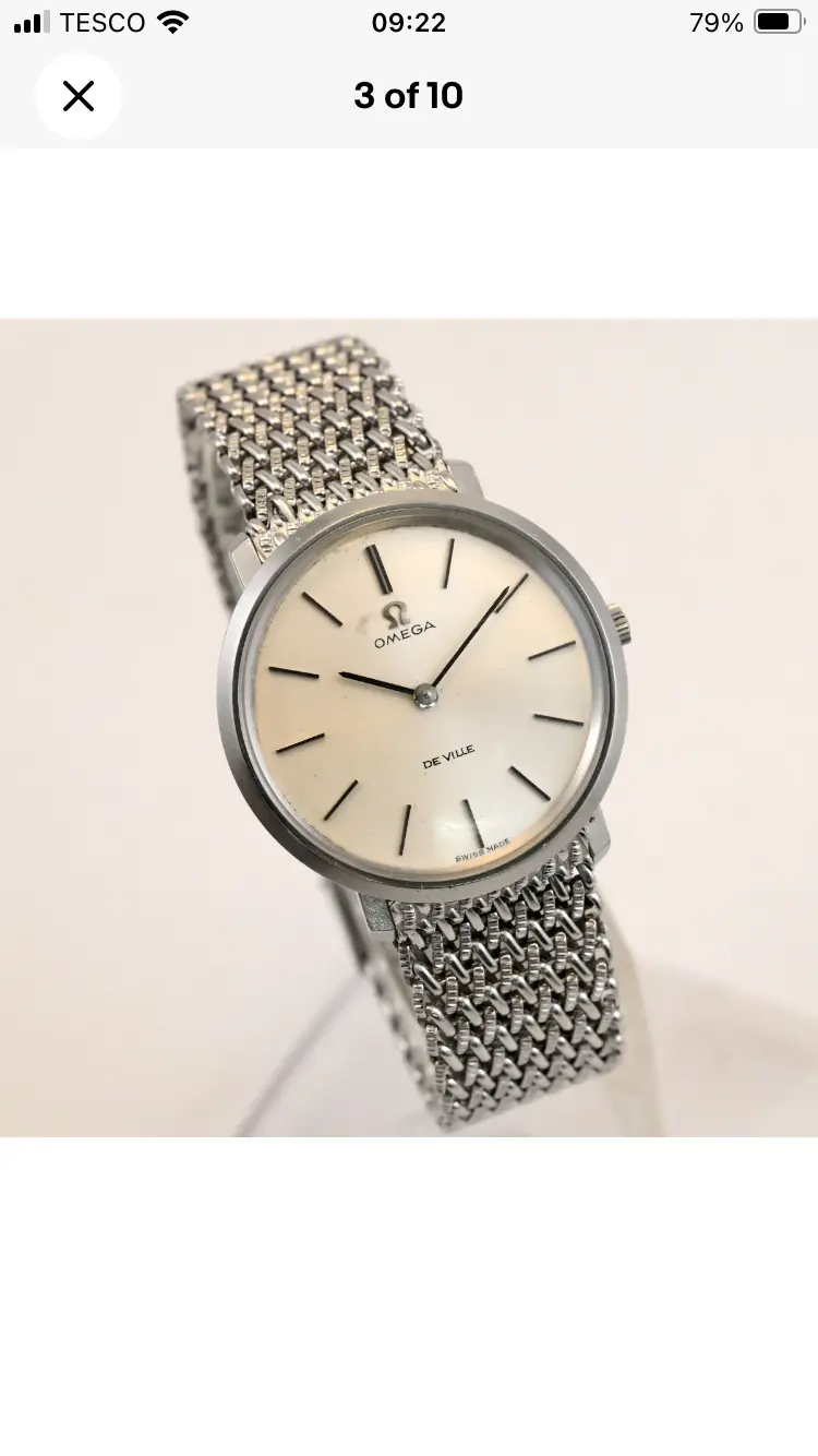

Hi all,
Please could I have some advice on the authenticity of this 1970s De Ville Ref.111.077.
The seller is asking £250 which is throwing me off. Please see attached pictures from the listing.
Thanks

I'll give you a considered opinion when you can be bothered to crop your photos.

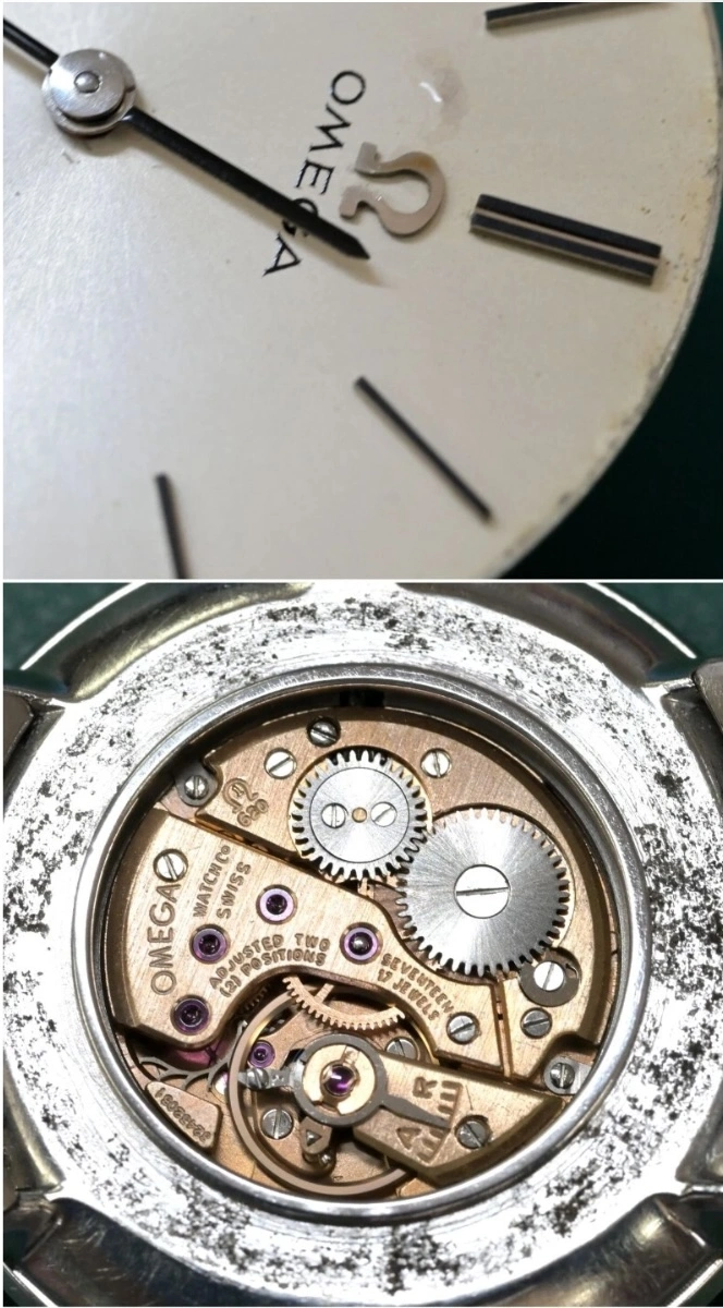

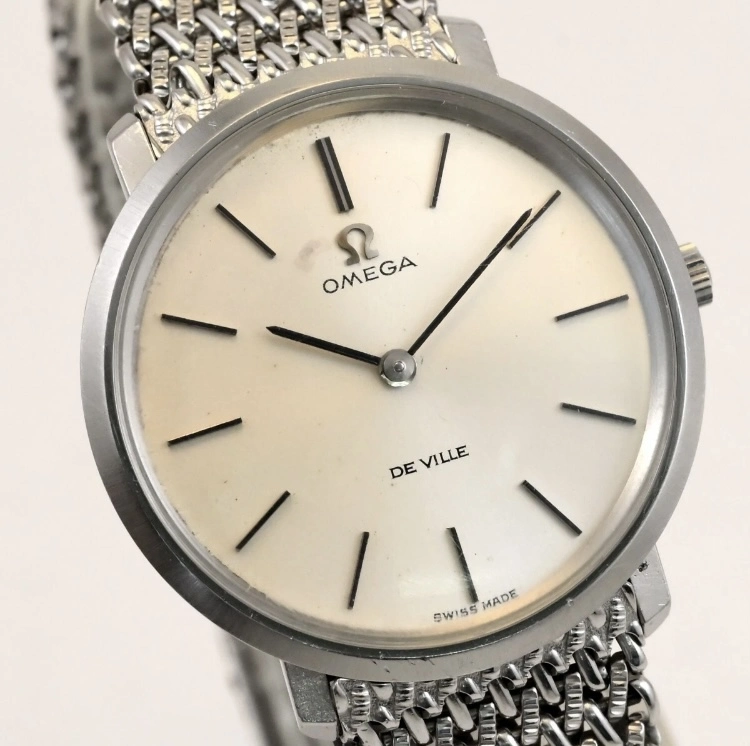

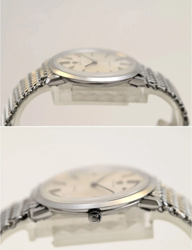

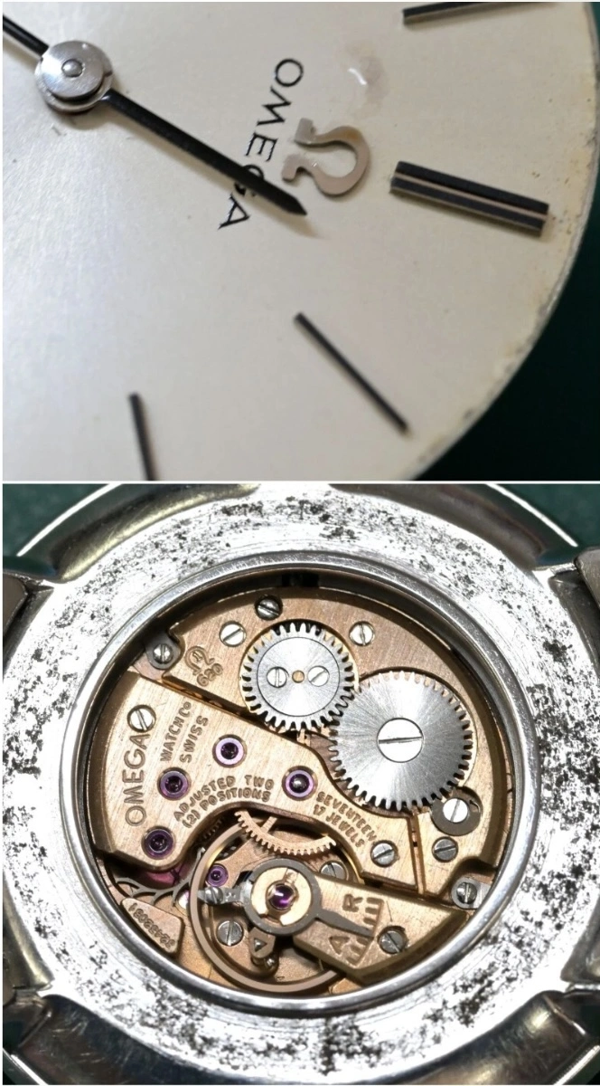

Apologies. I wasn’t aware that was an issue. Please see below
18,747
38,898

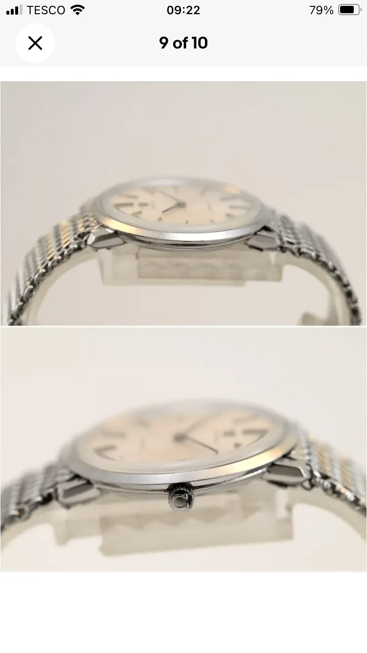

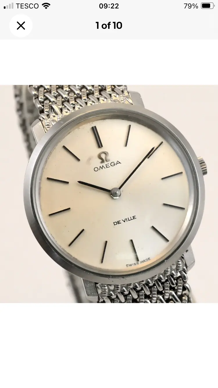

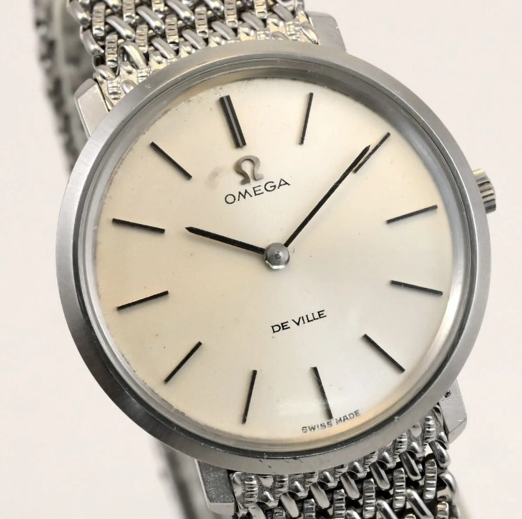

Well done.

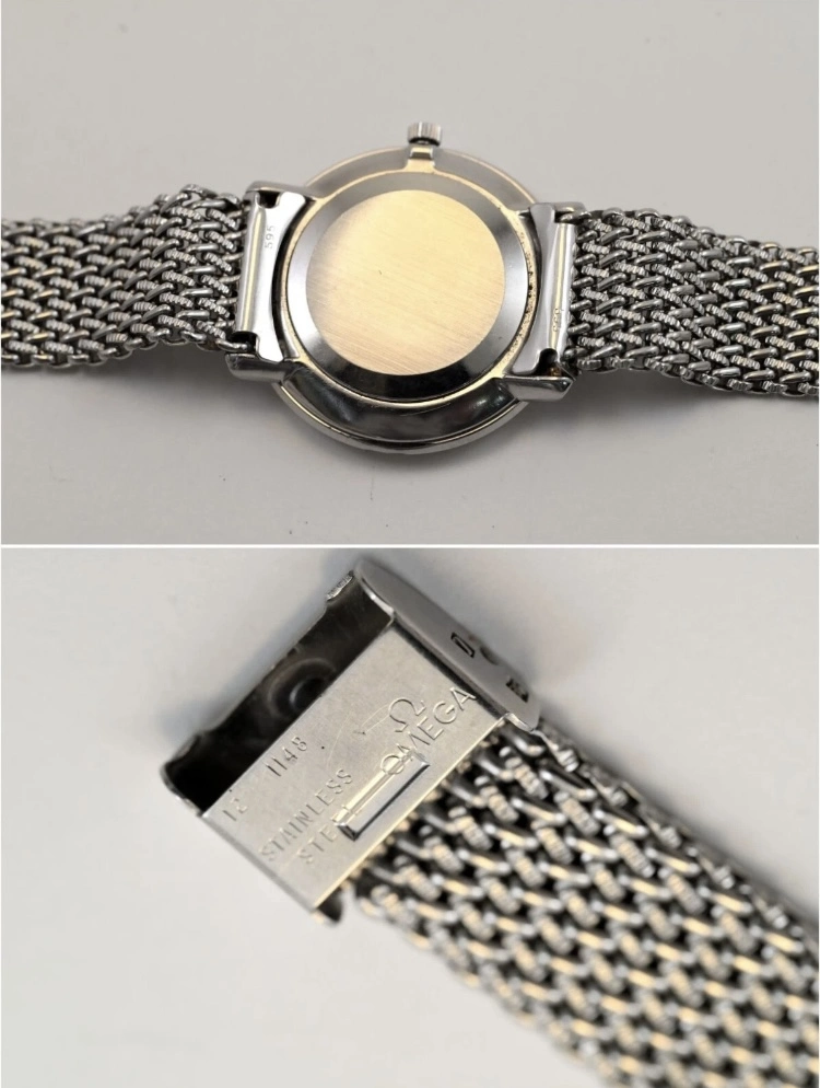

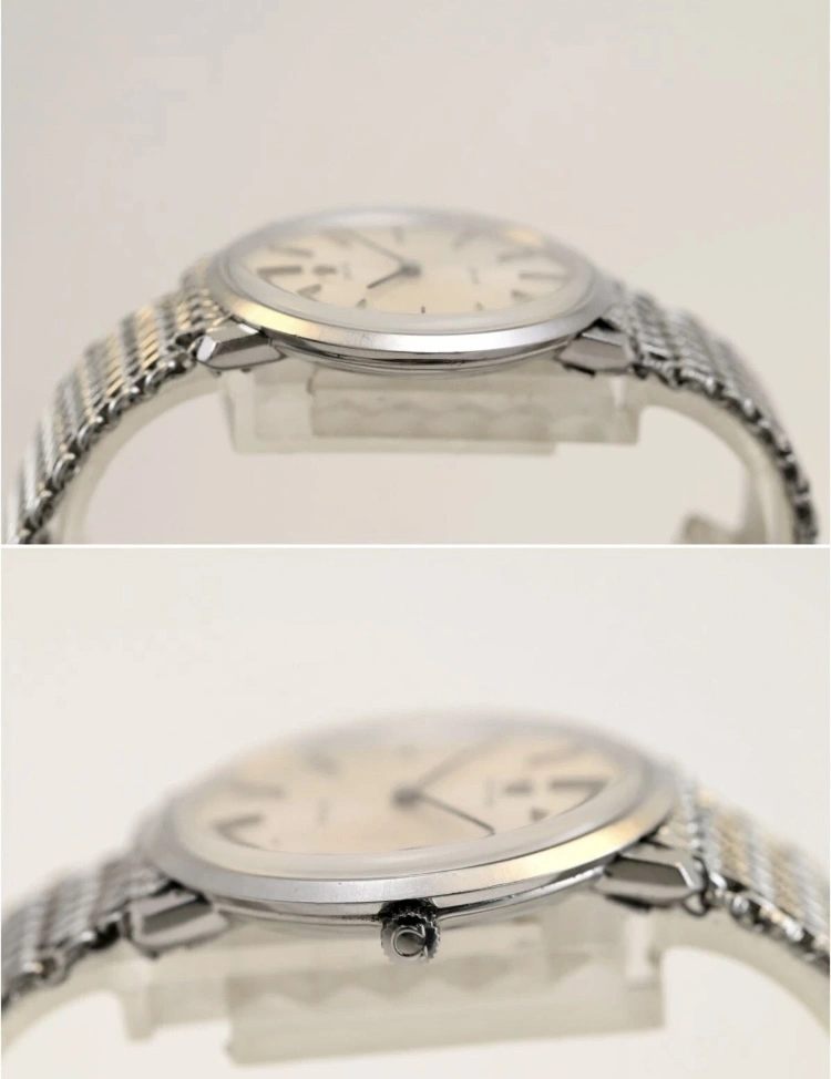

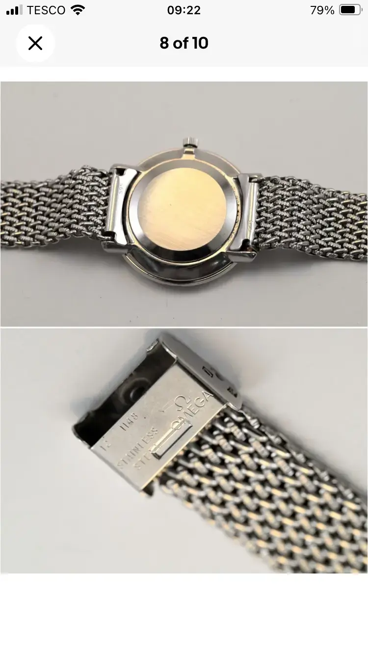

You are aware that it's a small watch as you noted it's 33mm and from all I can see it is completely correct.
The dirt or corrosion on the rear or the case is probably due to the ingress of perspiration over time, but it can be cleaned without causing damage.
The caliber 620 serial number dates the watch to approximately 1970.

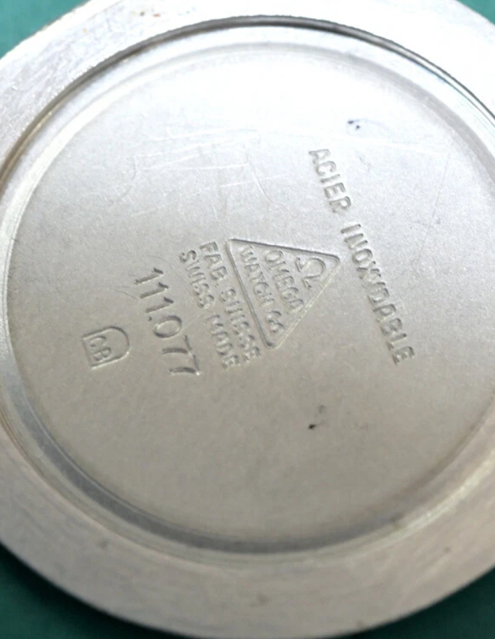

I'm not sure it's a reference 111.077 as this denotes a watch fitted with a strap, is there another number inside the caseback?
This is the ebay listing here, which has the 111.077 on the case back: https://www.ebay.com/itm/306281404353
IDK why OP didn't include it too.
All things considered, a nice watch, though being that small not much value to it. It is likely in need of a service in the near future, but otherwise looks pretty good/original to me.

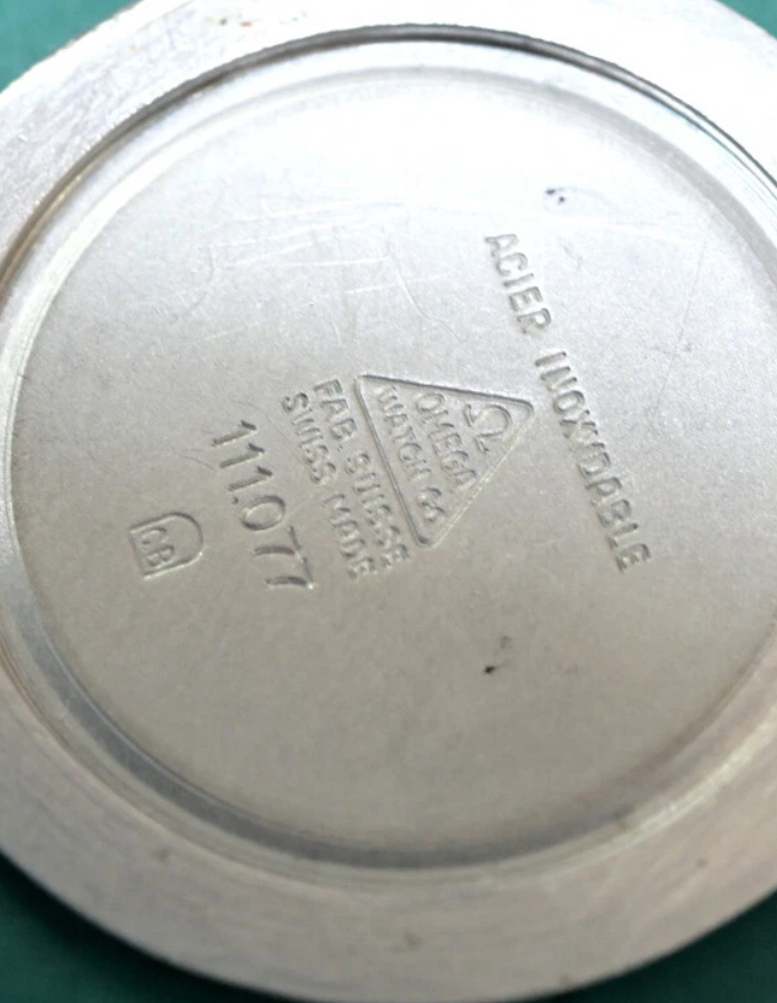

Here you go.
18,747
38,898

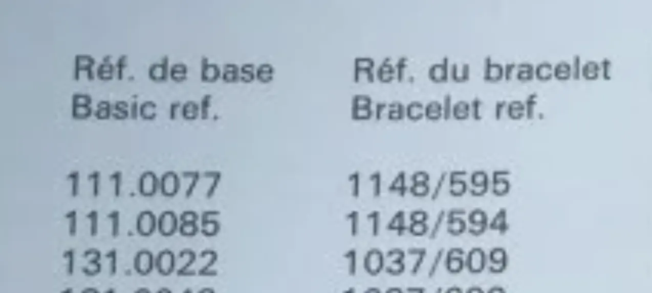

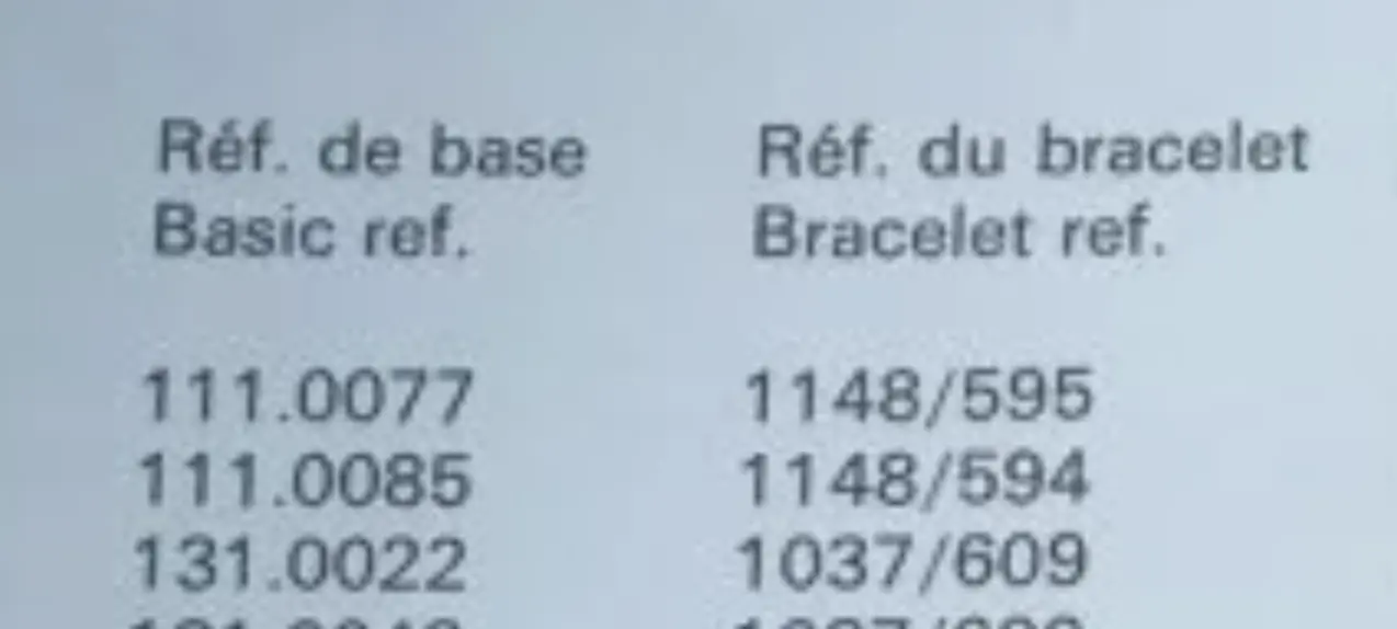

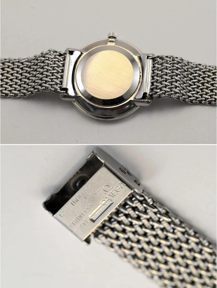

Definitely a strap watch originally.
The first or subsequent owner may have added the 1148/595 bracelet which was often done at the time.
Thanks to @michael e for the bracelet data.
9
Ah I see thanks for the insight.
