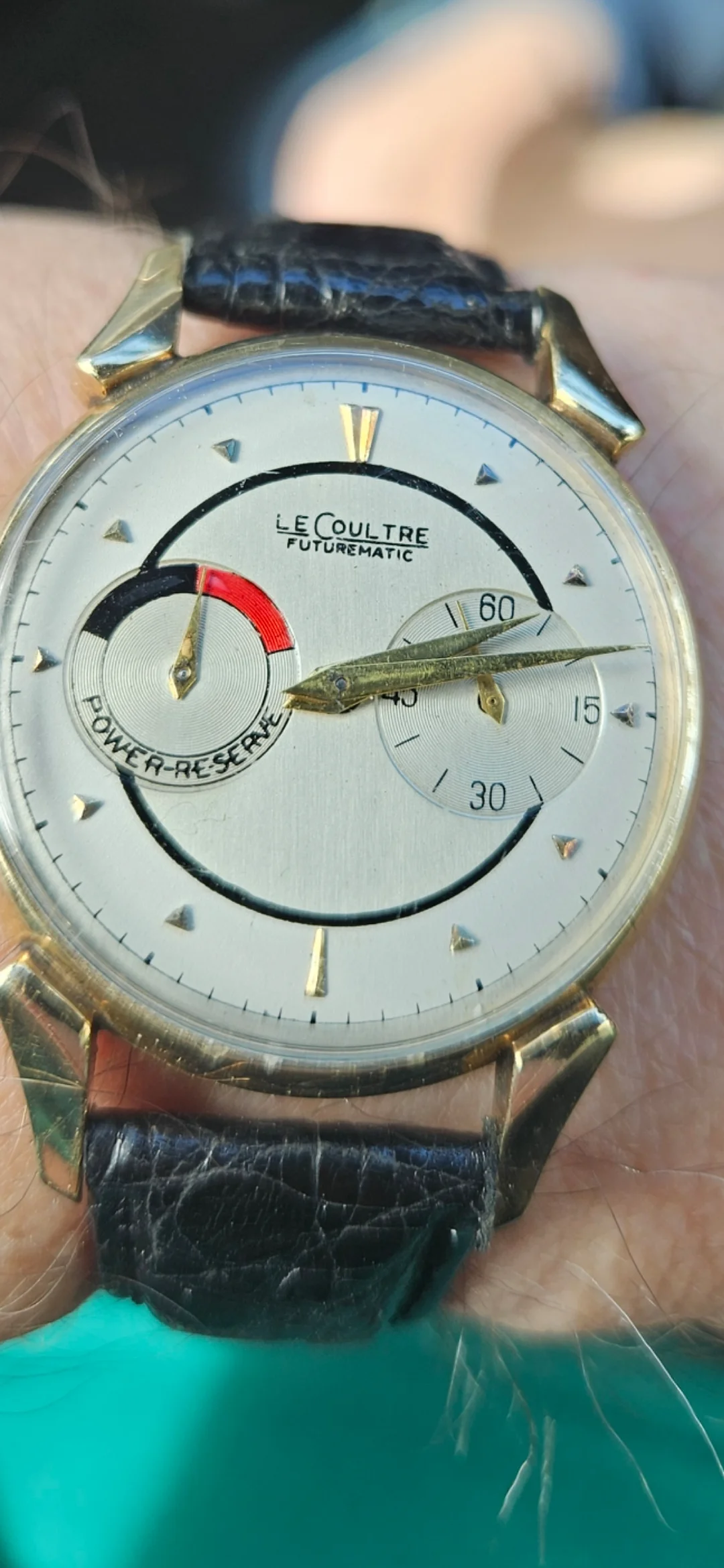

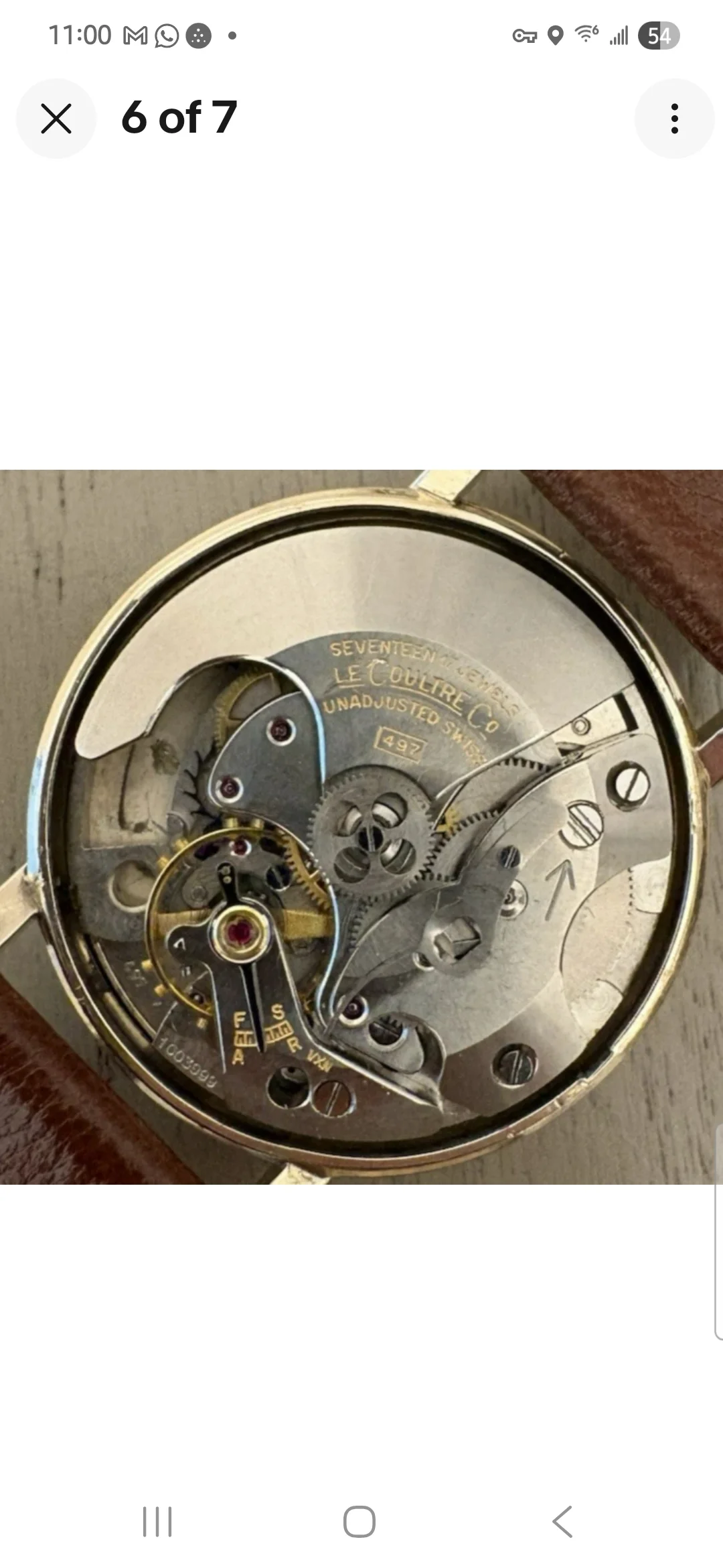

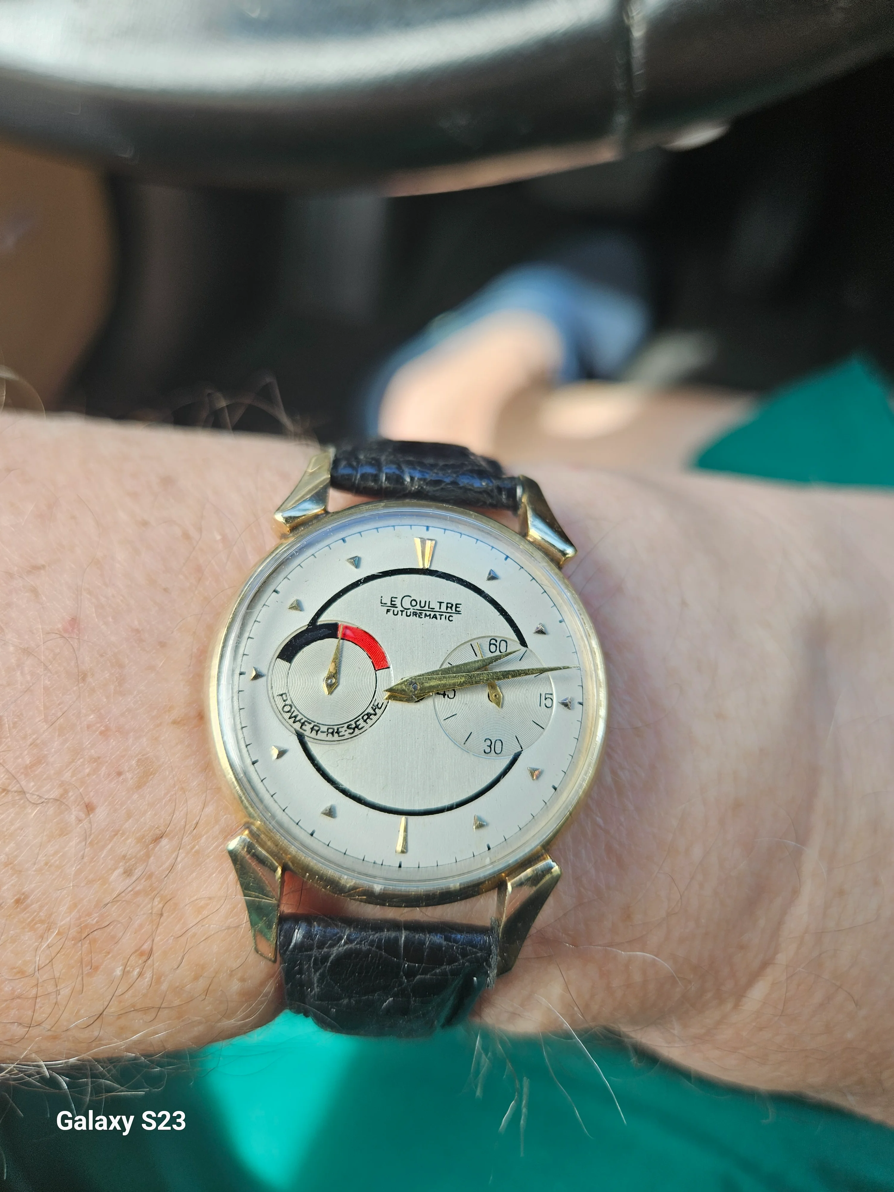

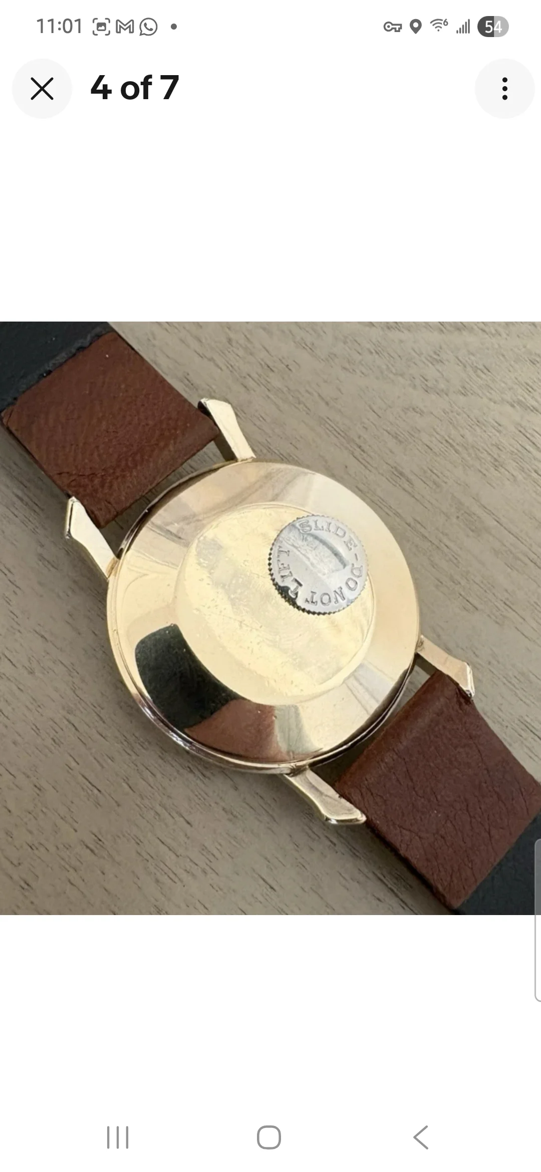

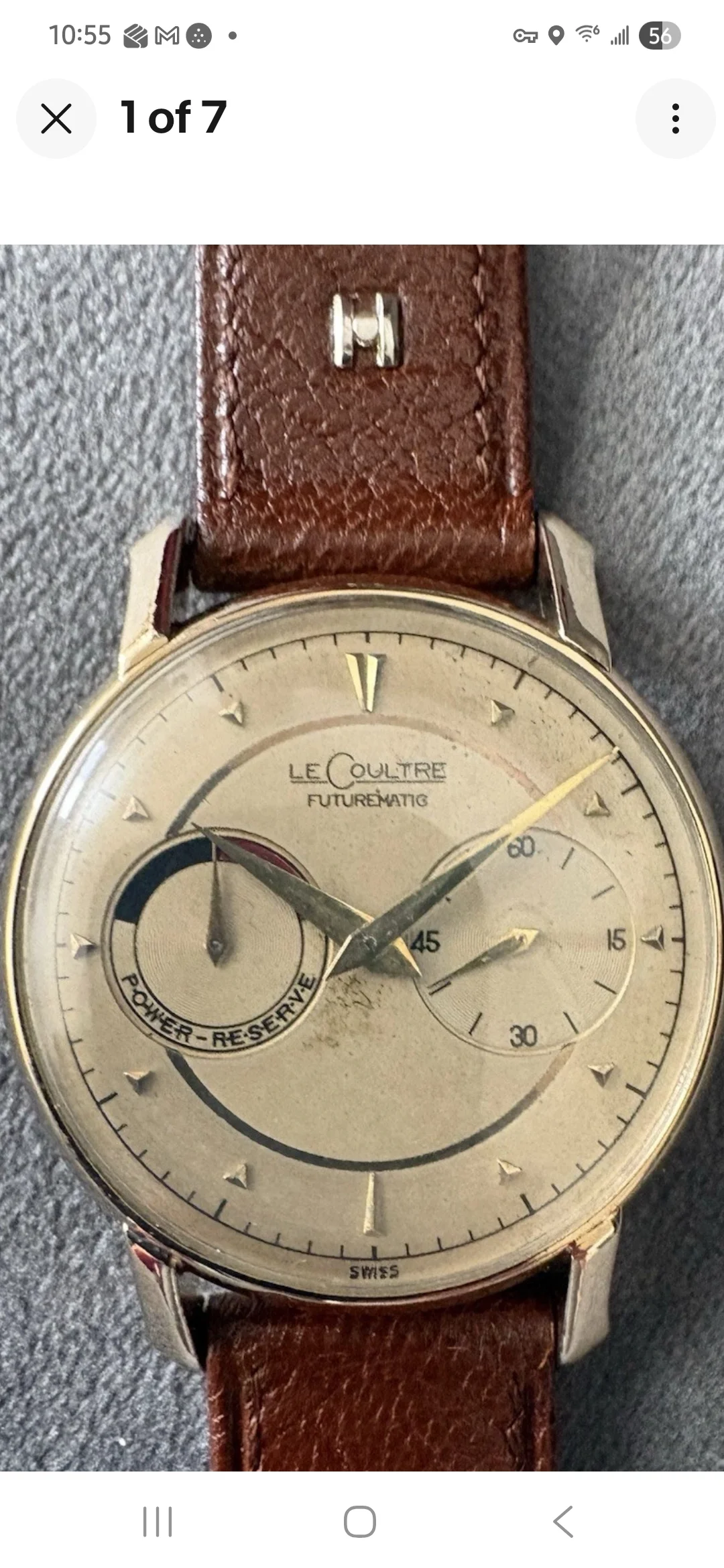

Looking for some input from the group on this LeCoultre Futurematic (cal. 497, gold-filled case). Movement looks correct and honest, but I’m unsure about the dial. The overall layout is right, though the printing—especially the “SWISS” at 6 o’clock and some of the text weight—gives me pause when compared to other known originals. I’d appreciate experienced eyes weighing in. Thanks in advance.
2,015
2,187
There is a lot of crystal distortion there, so 'swiss' is tough to tell.

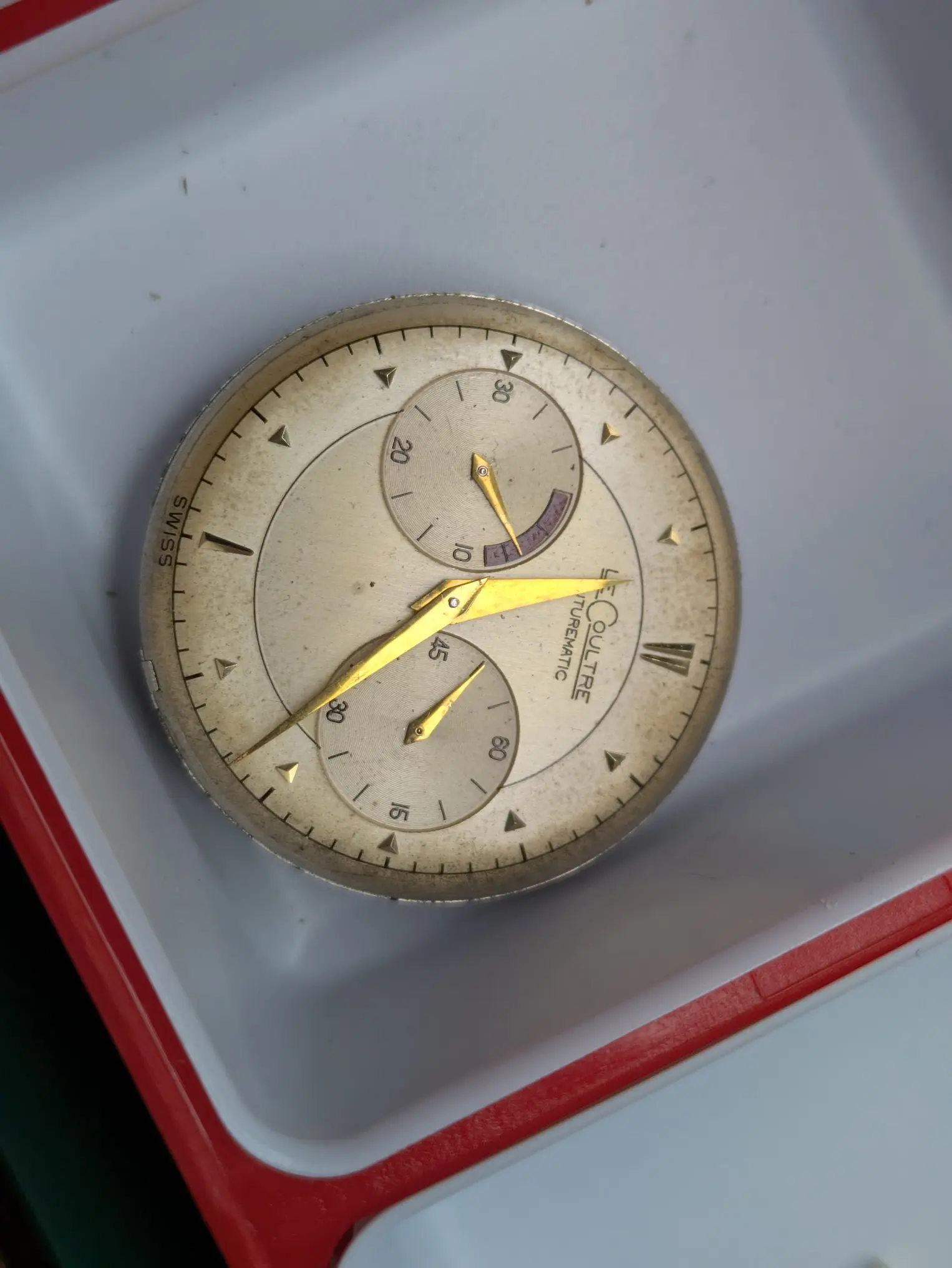

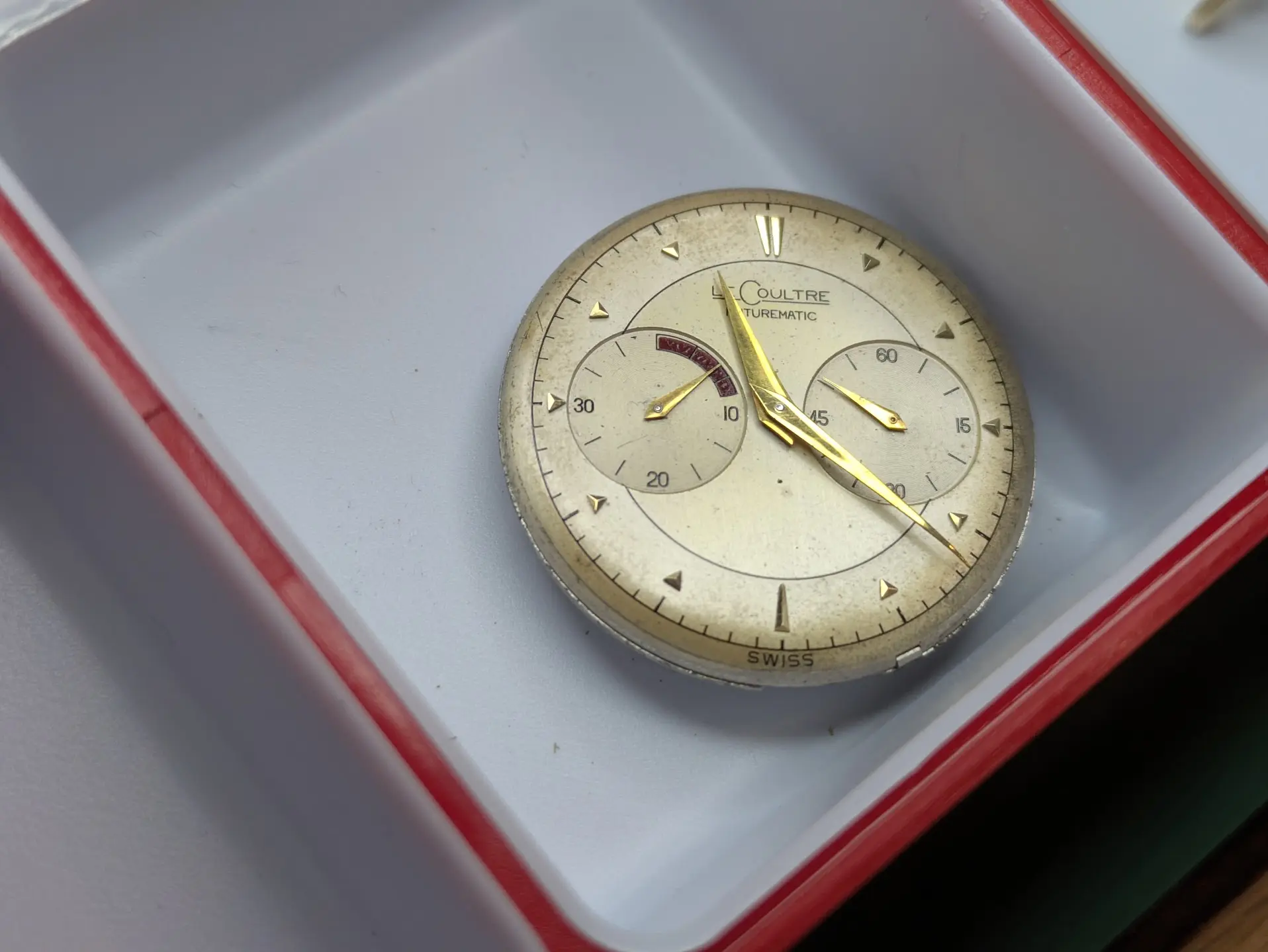

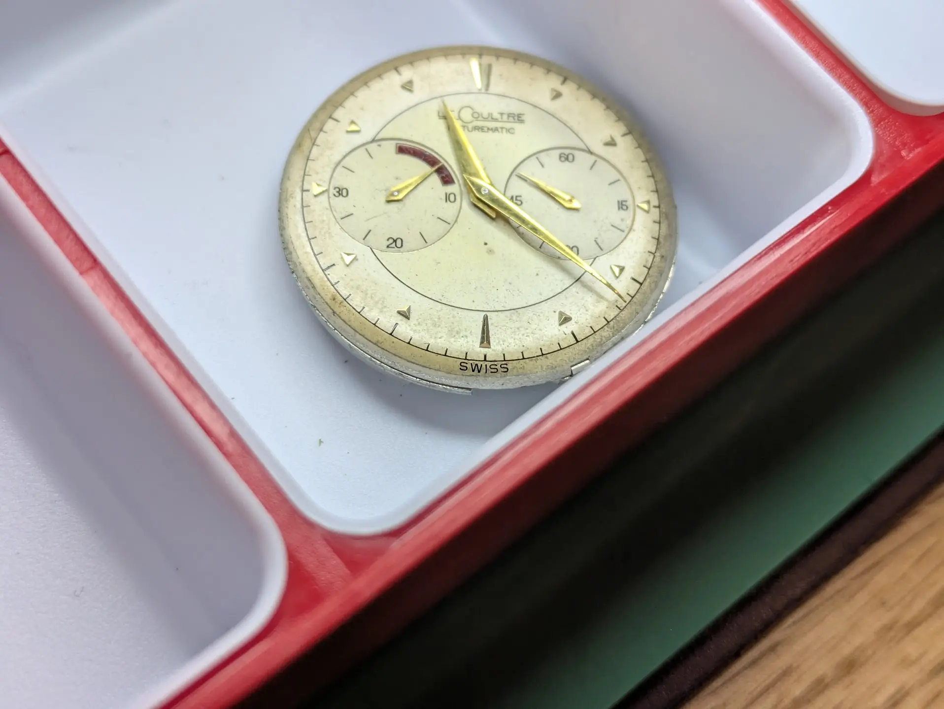

I've got one uncased in my repair queue right now. In a bit rougher shape, but very similar to the one above, and in, what I believe to be, authentic shape.
Thank you. Yes, it does look like yours, and you're right Maybe it's just the crystal distortion I will ask for better pictures. They're asking 1350 which is a bit high
I was thinking more like 1100 if decent timegraph numbers.
I definitely see the difference in swiss from the pictures, but I don't have enough experience on the differences of course.
I don't have a good feel for the value. TBH, I perhaps overpaid for mine ($900) as a barely-runner/losing a few mins a day. One thing to note: see if you can get them to 'wear' it for a bit to get it to 'charge' up near the top of the gauge. Also, see how 'low' the charge can get before it stops working. Mine won't run until ~11 on the dial, I suspect, if in good shape, it should still run pretty low into the red on the gauge.
Thank you that's good advice
I've got one that's a definite redial which I've posted here before and it runs well, and I probably also overpaid at 900 as well. I'm just trying to find one with an original dial. Thx again

TBH, you might consider finding a replacement dial. I see a ton of them on Ebay for sub-$200 (depending on the condition you want, as low as $10!).
This one: https://www.ebay.com/itm/176276991272
Looks like the one in OP, same 'swiss'.
This one is quite attractive: https://www.ebay.com/itm/175729521847?
Sad about the outside 'wear' though.

Beautiful watch...18k It looks like it was cased in Europe very nice..great dial!

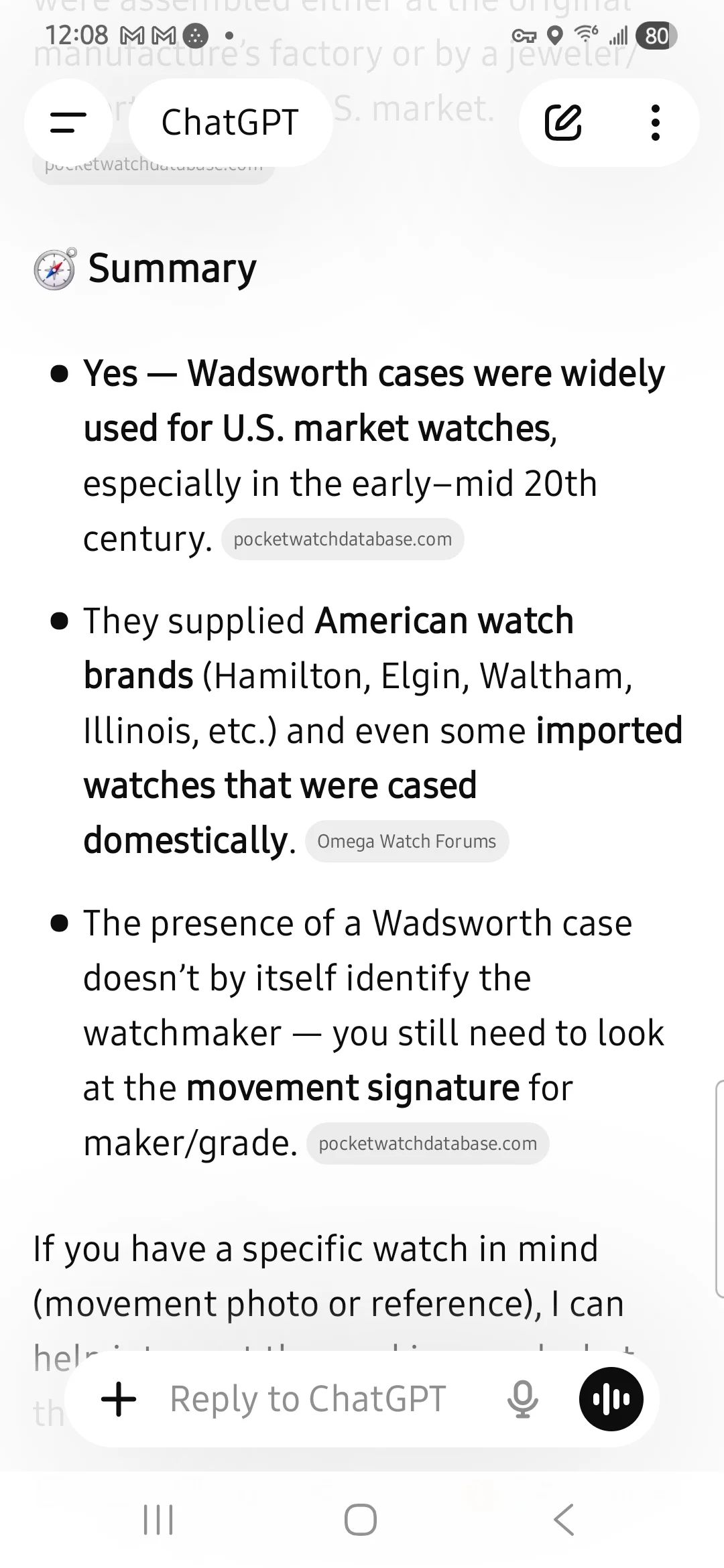

Were US market watches cased by Wadsworth?
Great quedtion:
Found this in chat:
Yes - Wadsworth cases were widely used for U.S. market watches, especially in the early–mid 20th century. �
pocketwatchdatabase.com
They supplied American watch brands (Hamilton, Elgin, Waltham, Illinois, etc.) and even some imported watches that were cased domestically.
I think there's also an omega form discussion which may have commented on tjis question in the past
