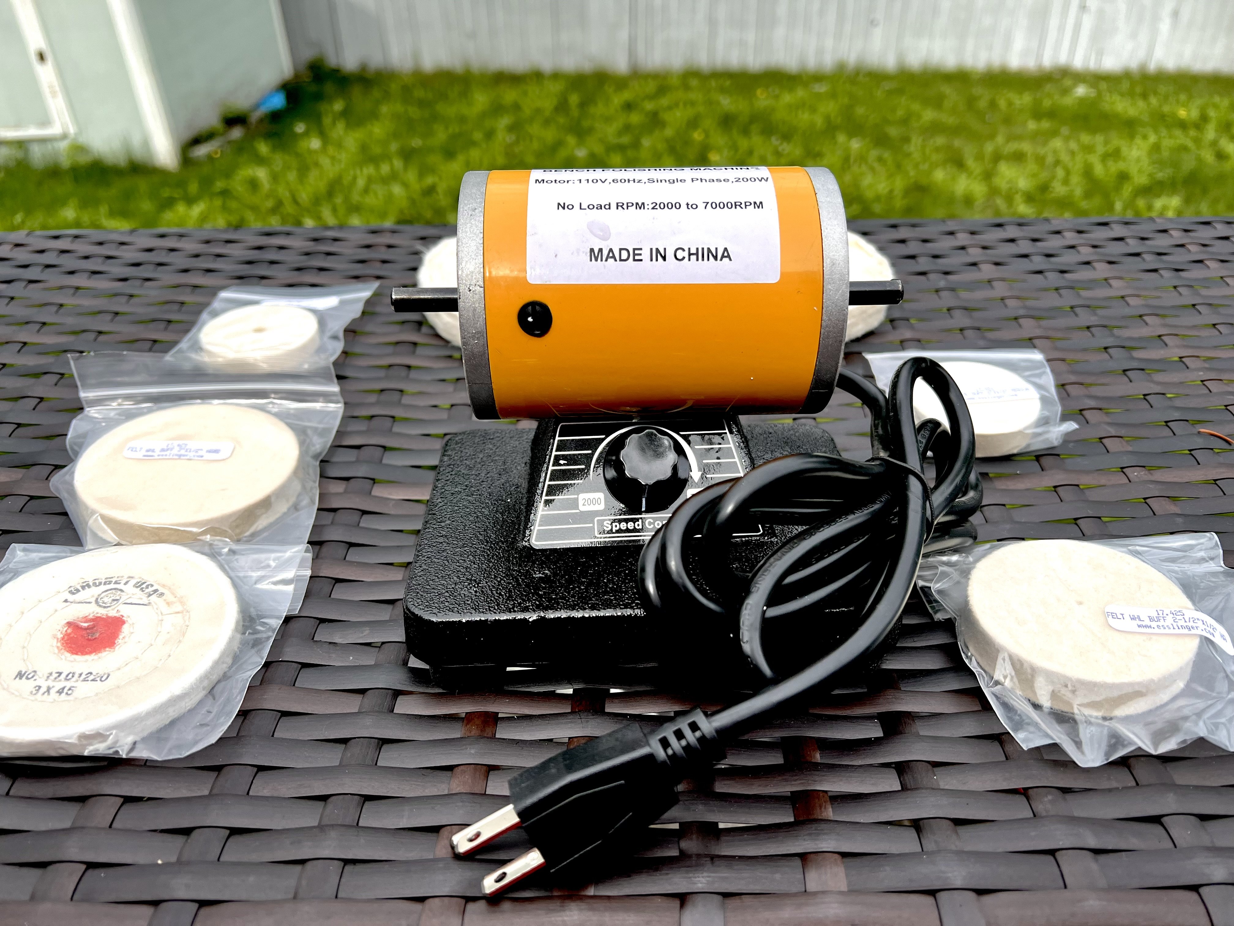

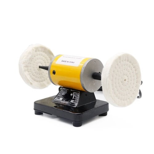

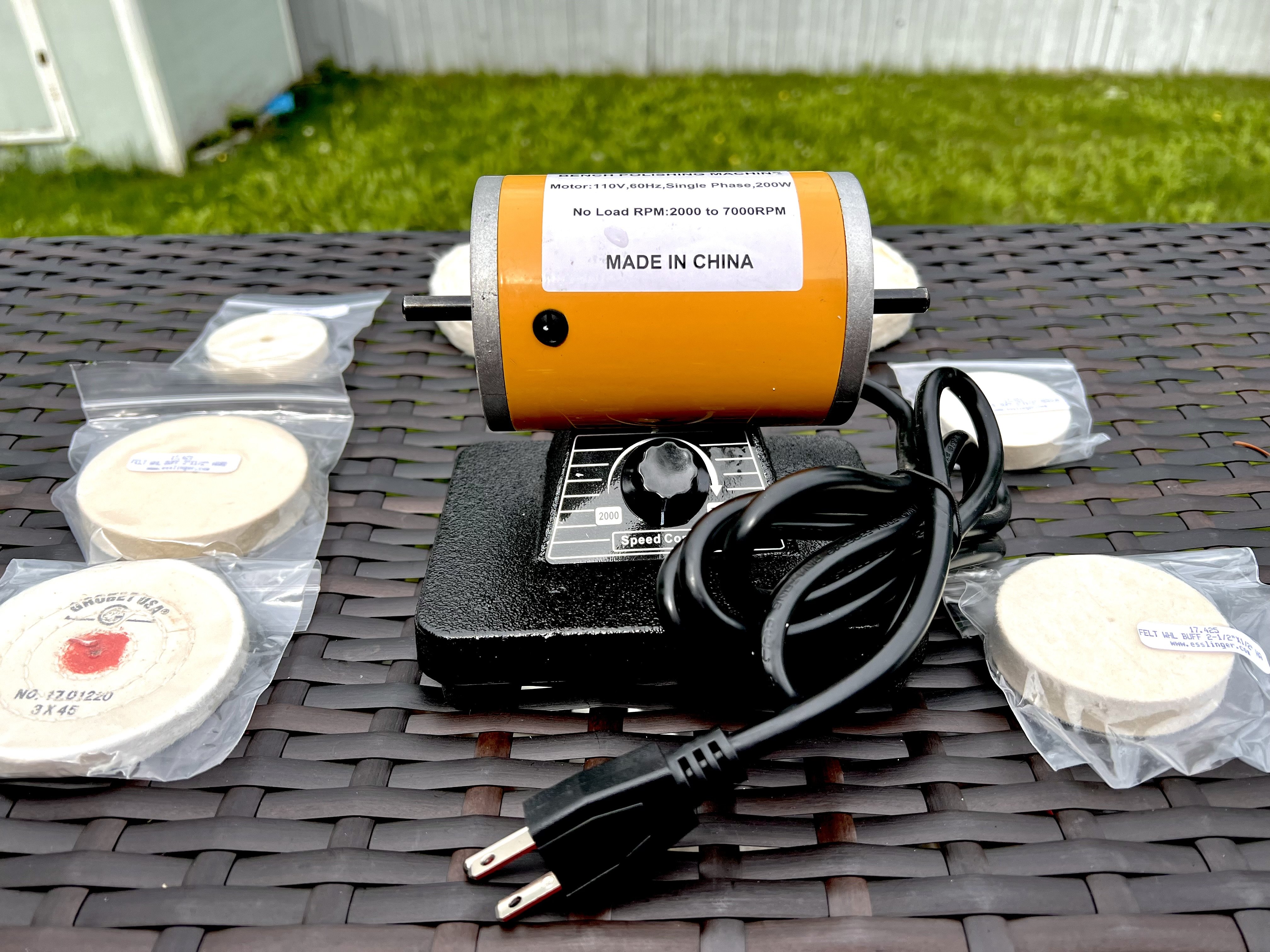

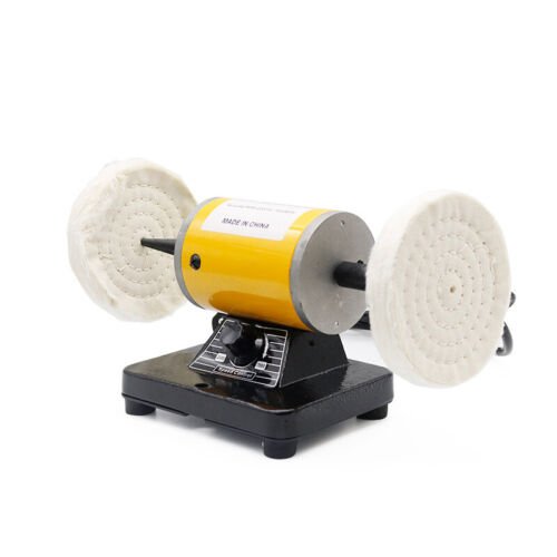

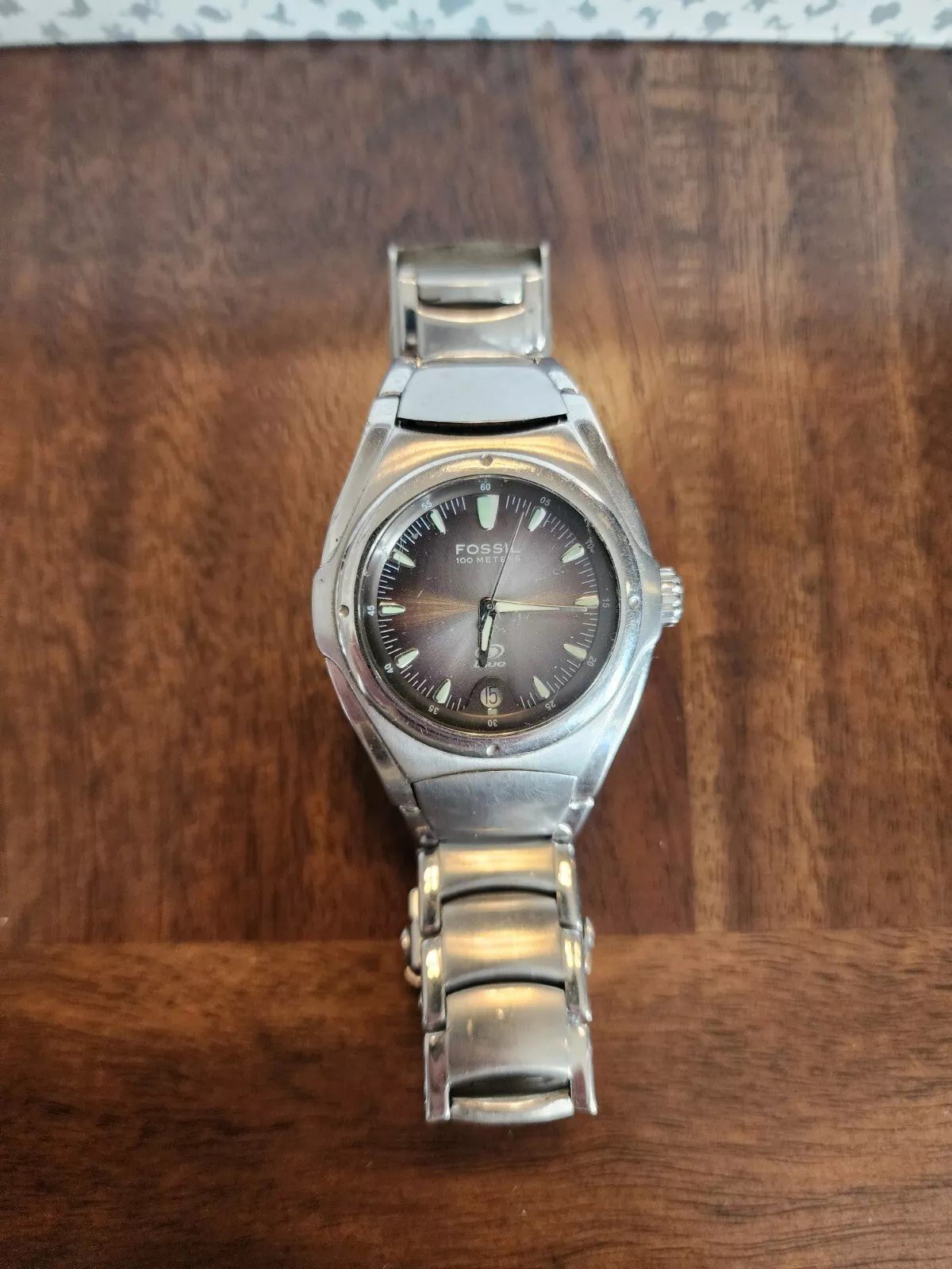

Thank you. Here is a photo of the cheap lathe that I purchased. I also have a lot of practice on a stationary grinding wheel, but not on watches, so I'll be prepared for flying watches.

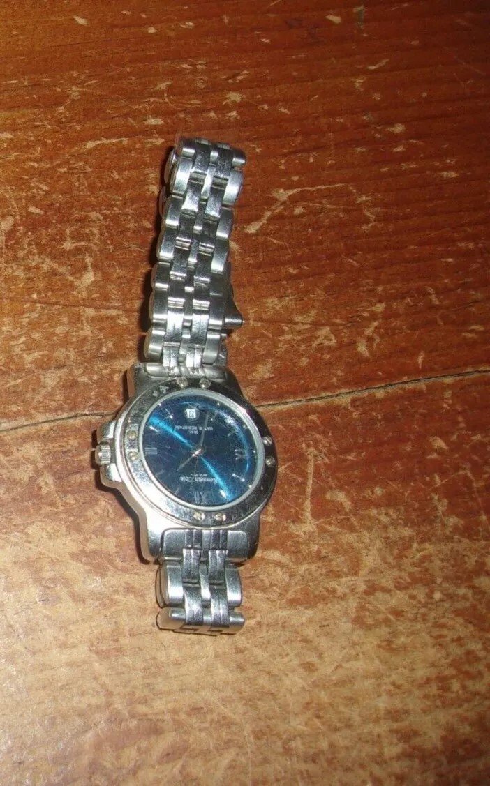

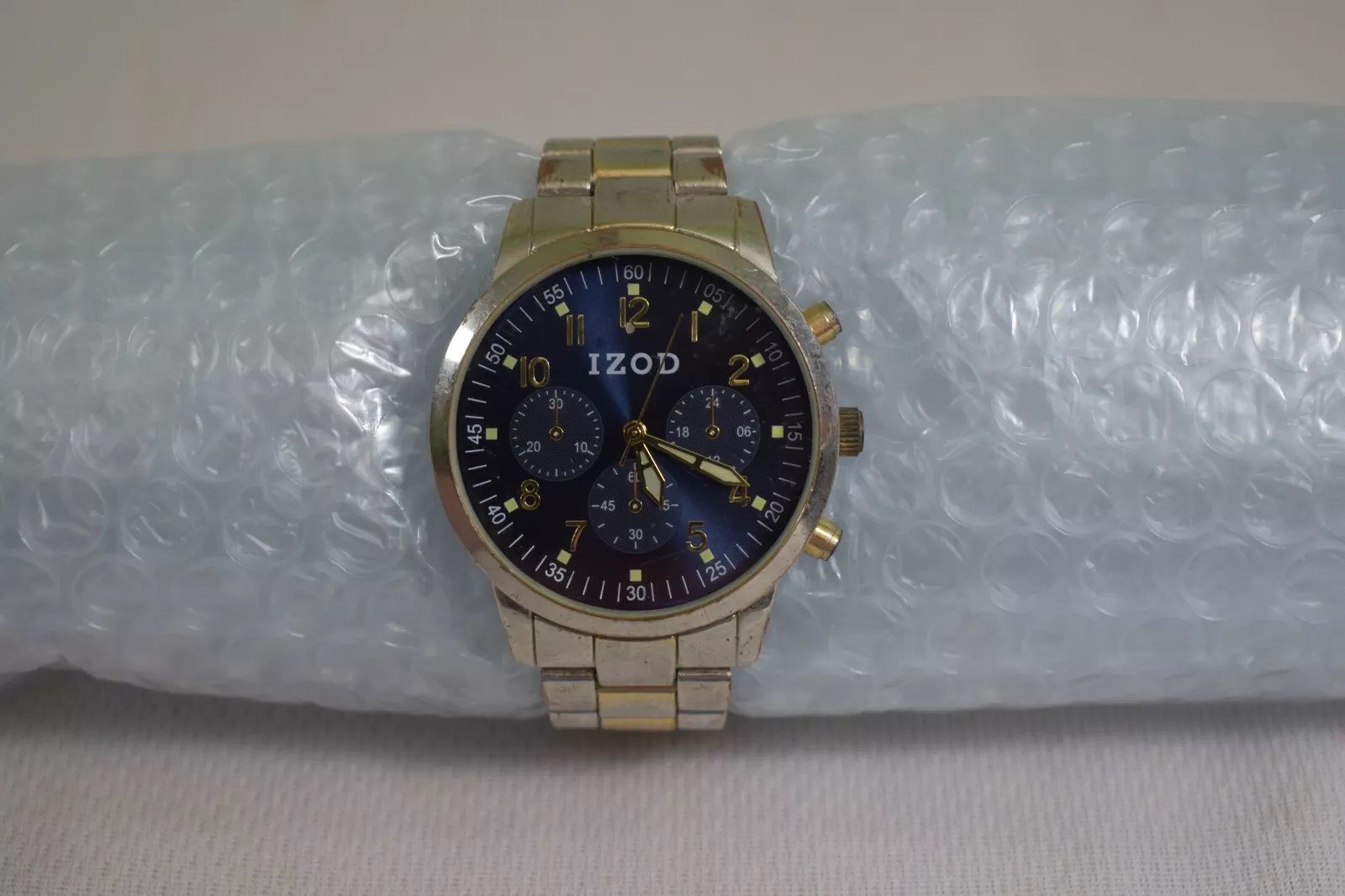

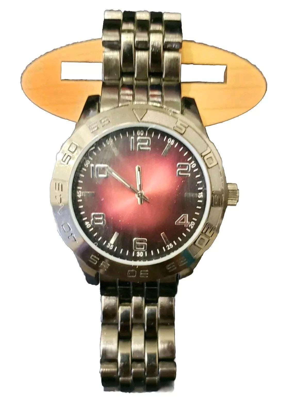

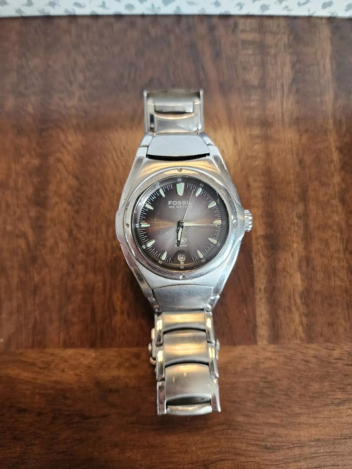

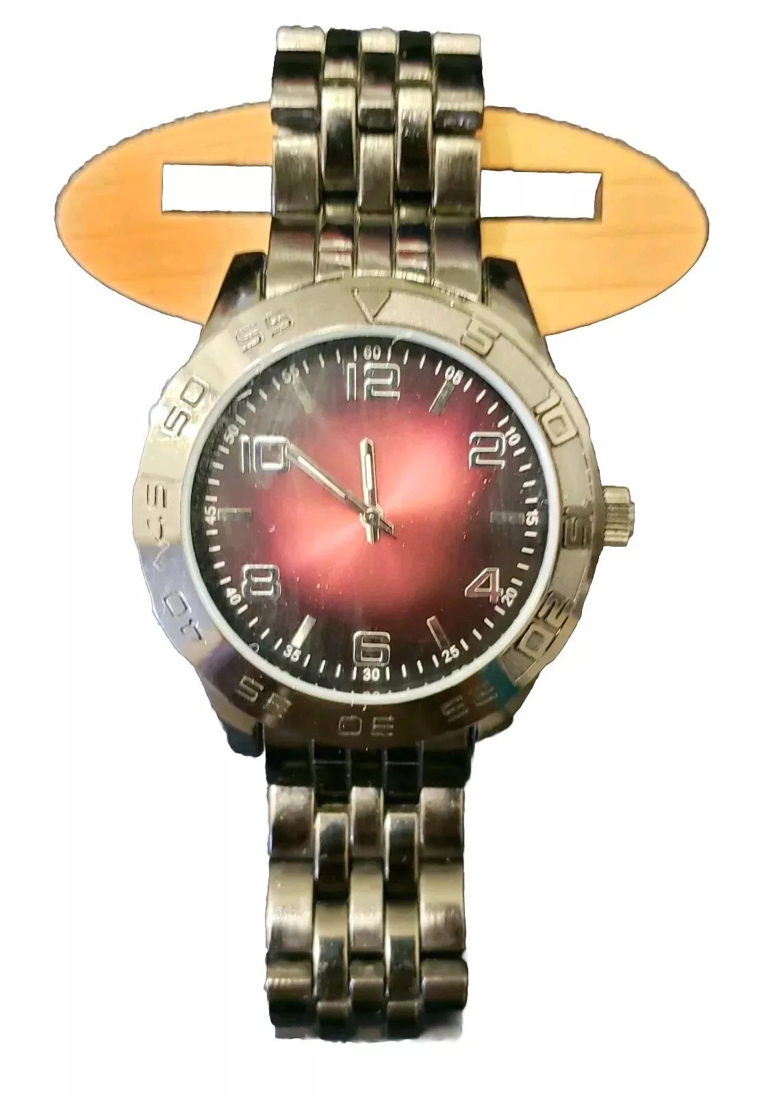

Ok, the lot of junk practice watches I ordered are all chrome plate and no use to me. I am going to do a WTB for junk stainless and GP to practice hand polishing.

Maybe those cheap redialed EBay monsters from India would be ideal for your practice sessions

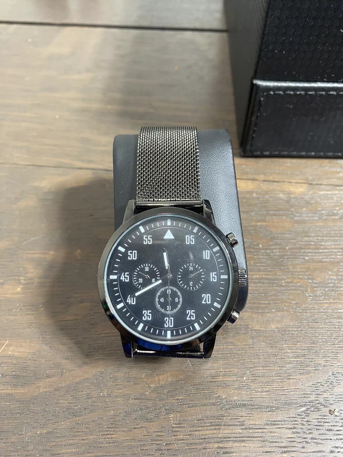

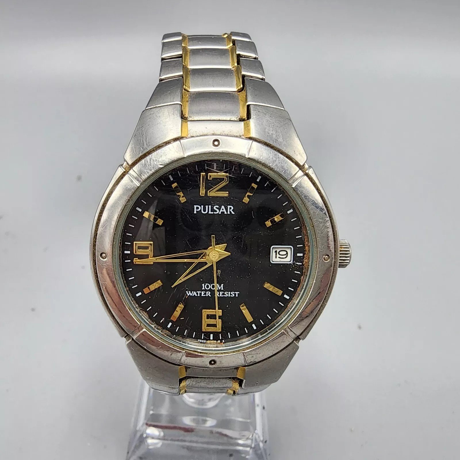

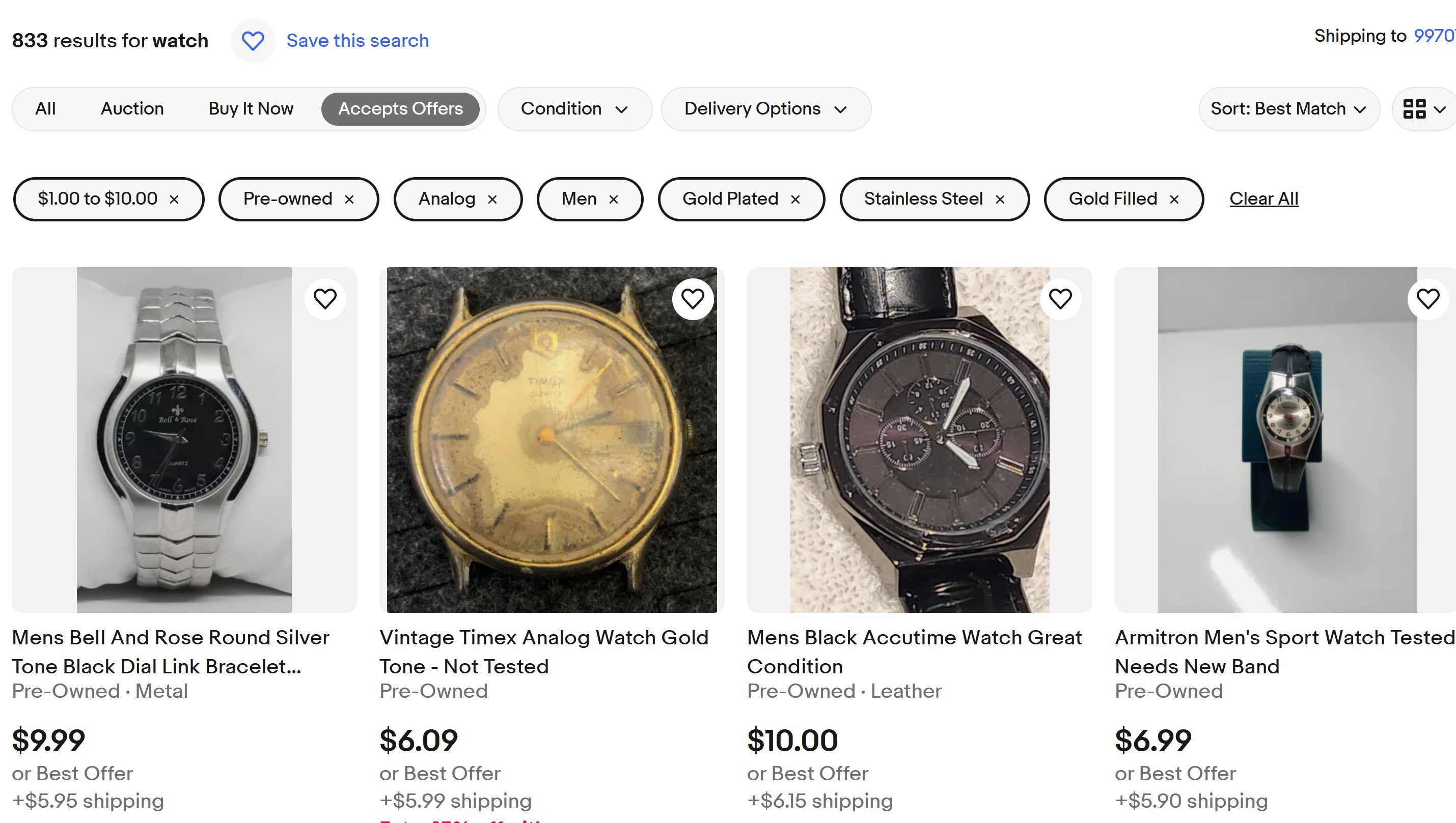

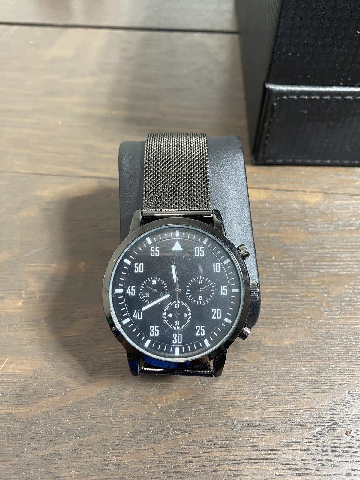

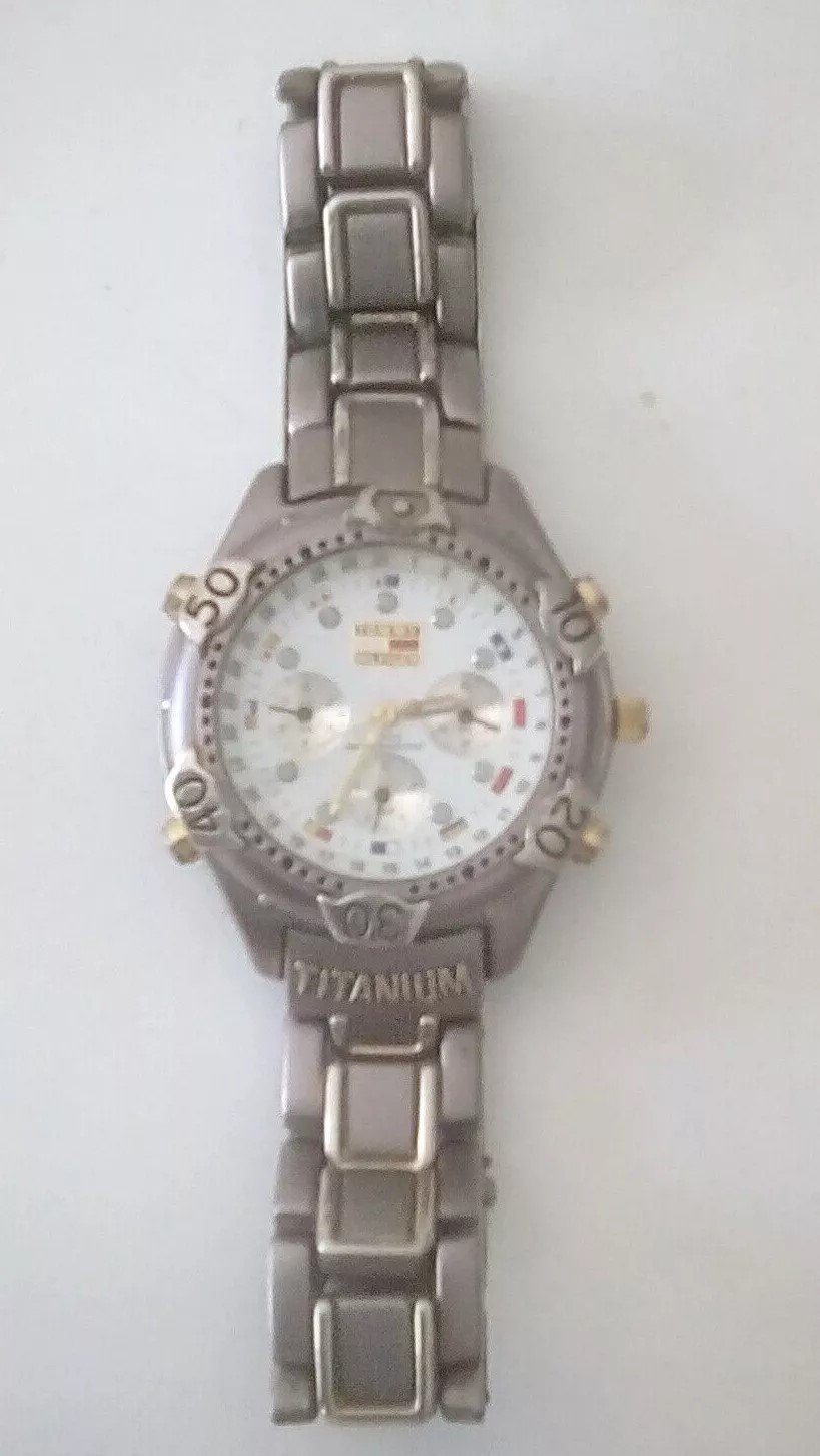

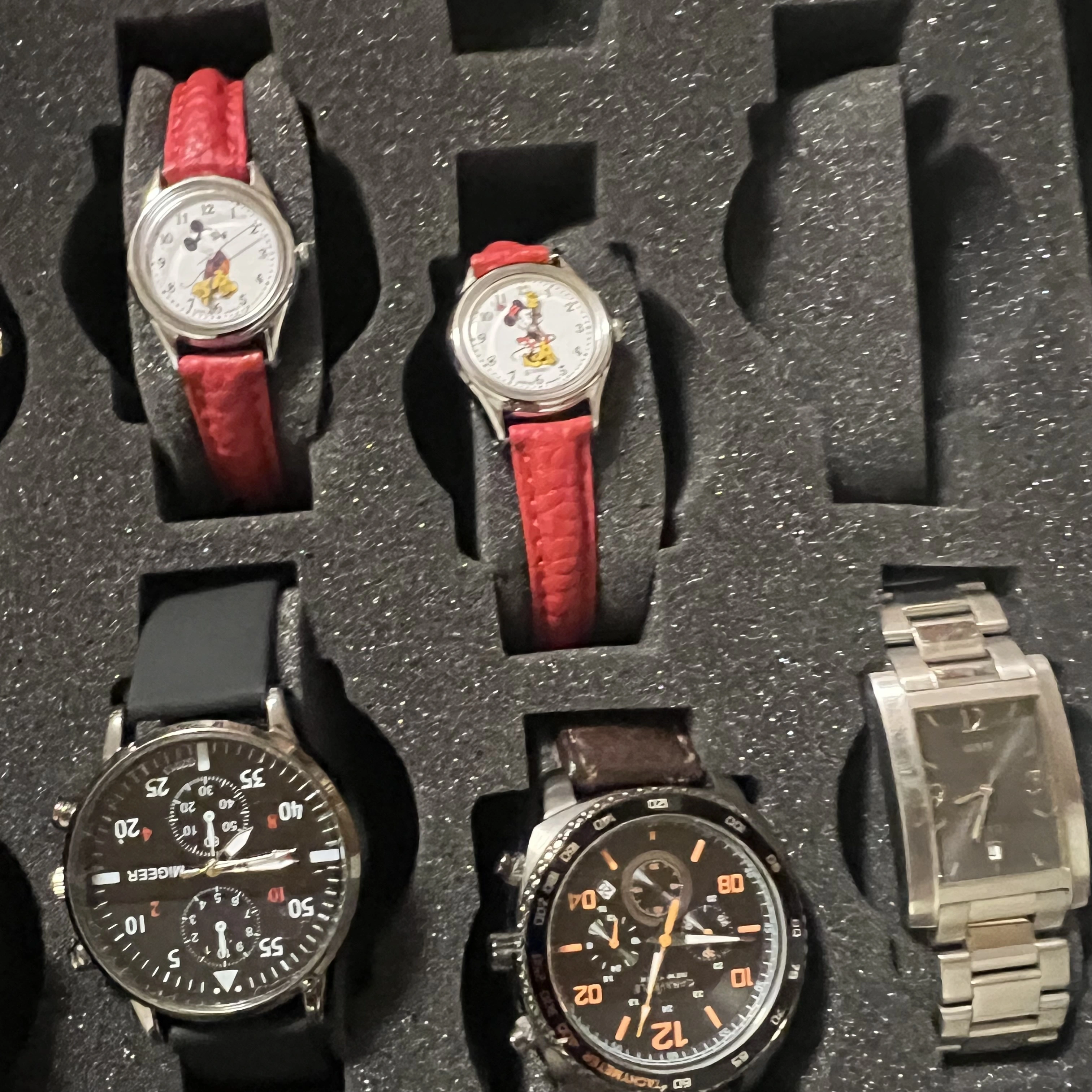

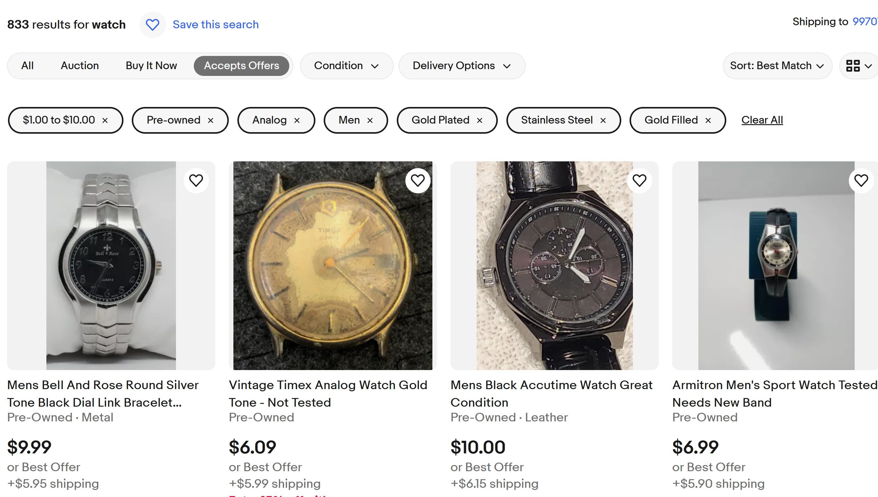

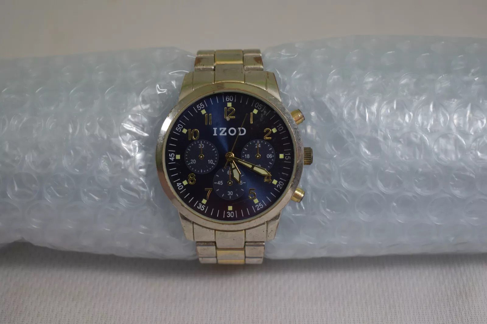

The $30 watches above are intended for family Christmas gifts. I took your advice in a roundabout way. We exchange gifts during the holidays at work, so did a search on eBay for $5 to $10 watches to practice on. Got a few extra for when I make mistakes. I enjoy shopping for watches 😗, so this has been a lot of fun. I'll post photos of the practice watches when all my offers come back.

Just for clarity, I wasn’t referring to your gift watches as hideous eBay monsters. Getting practice watches for $5 is even better! I’ve seen bags of watches at some thrift shops for $10 or so. I got a nice Seiko diver that way.

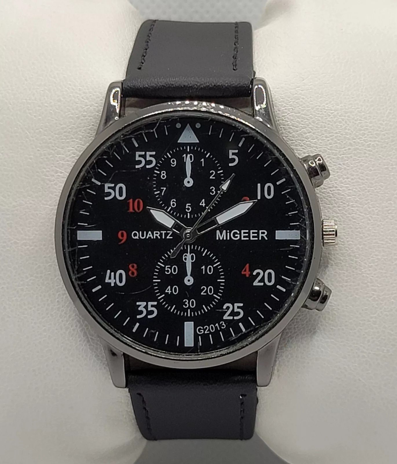

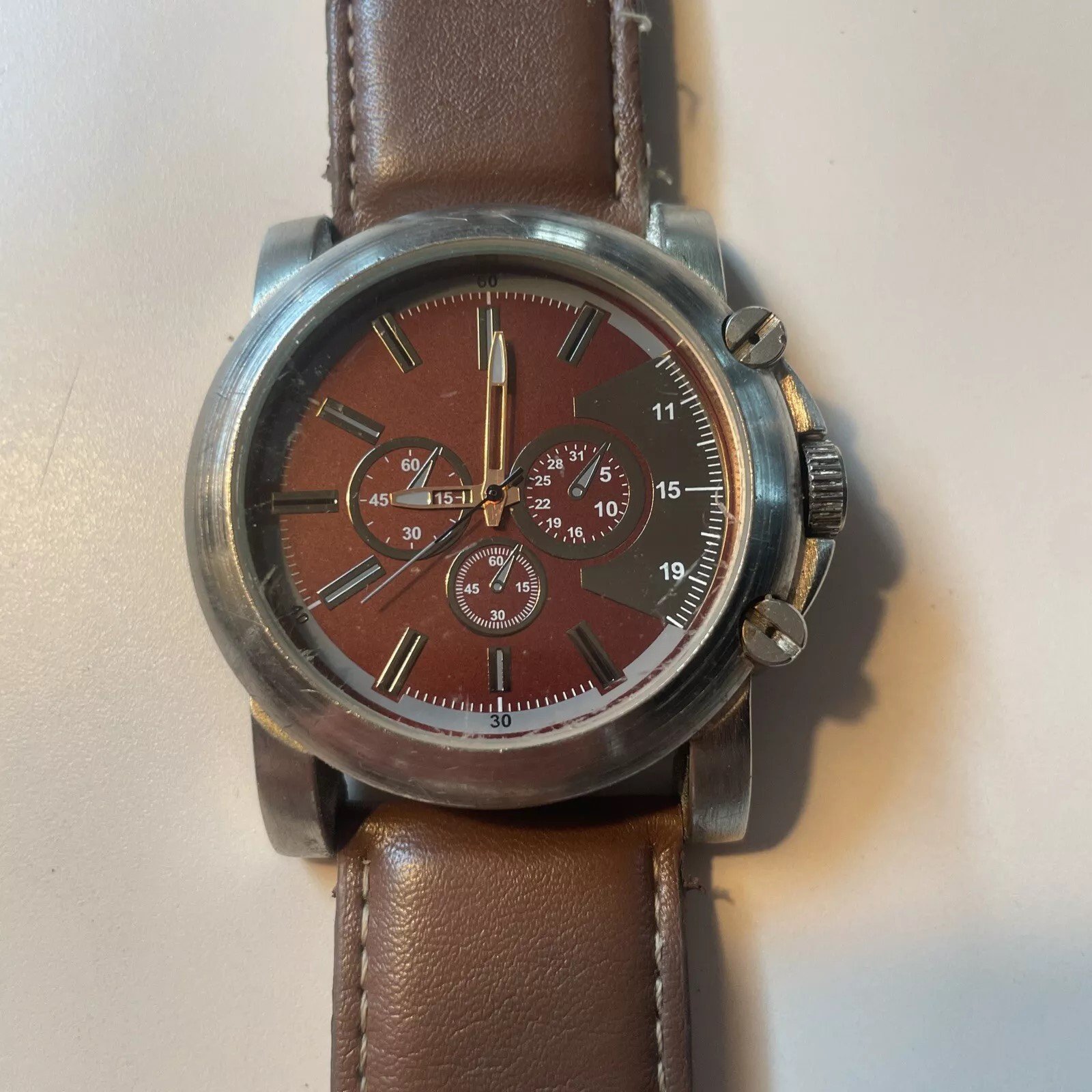

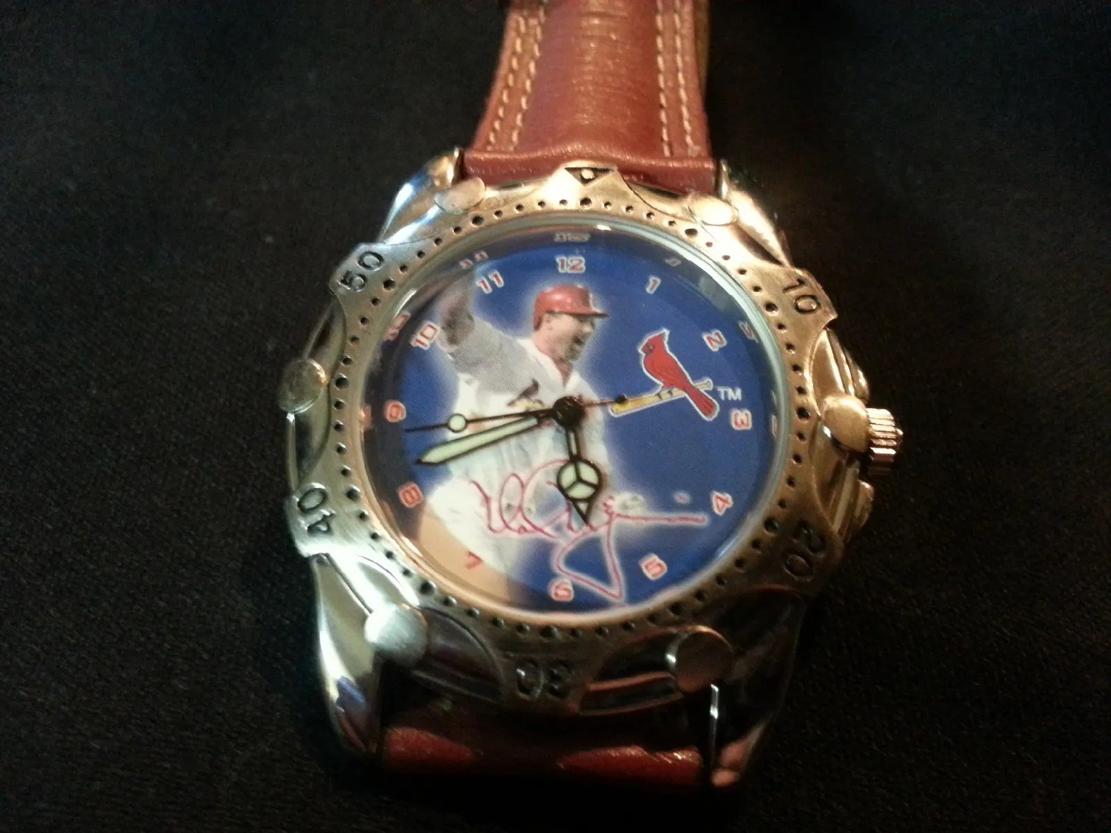

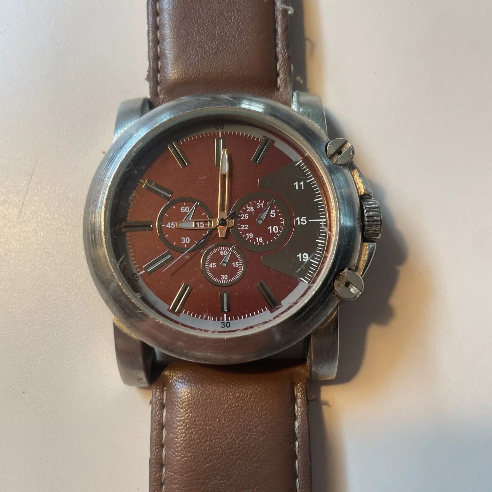

The journey begins. Time to destroy some cheap watches. Thanks again for all the tips. Sadly a lot of the cheap watch’s don’t need polishing. I still have plenty to practice on.

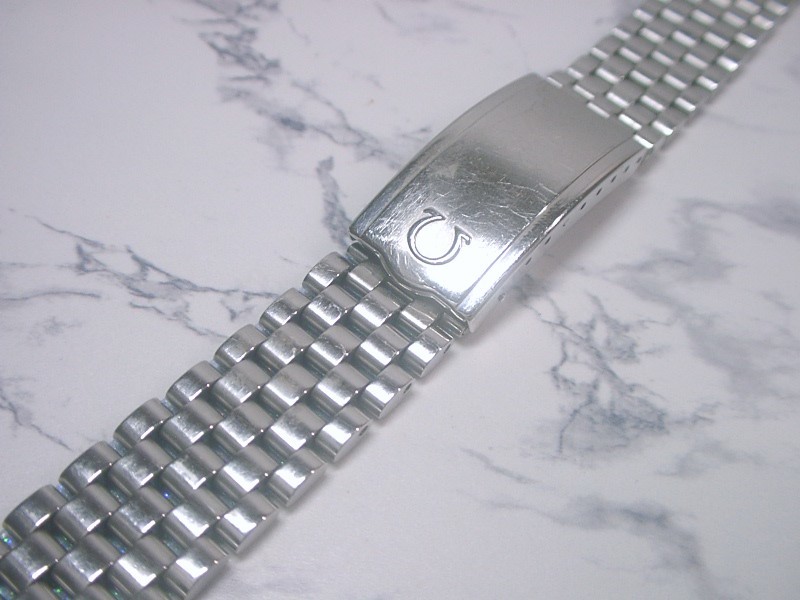

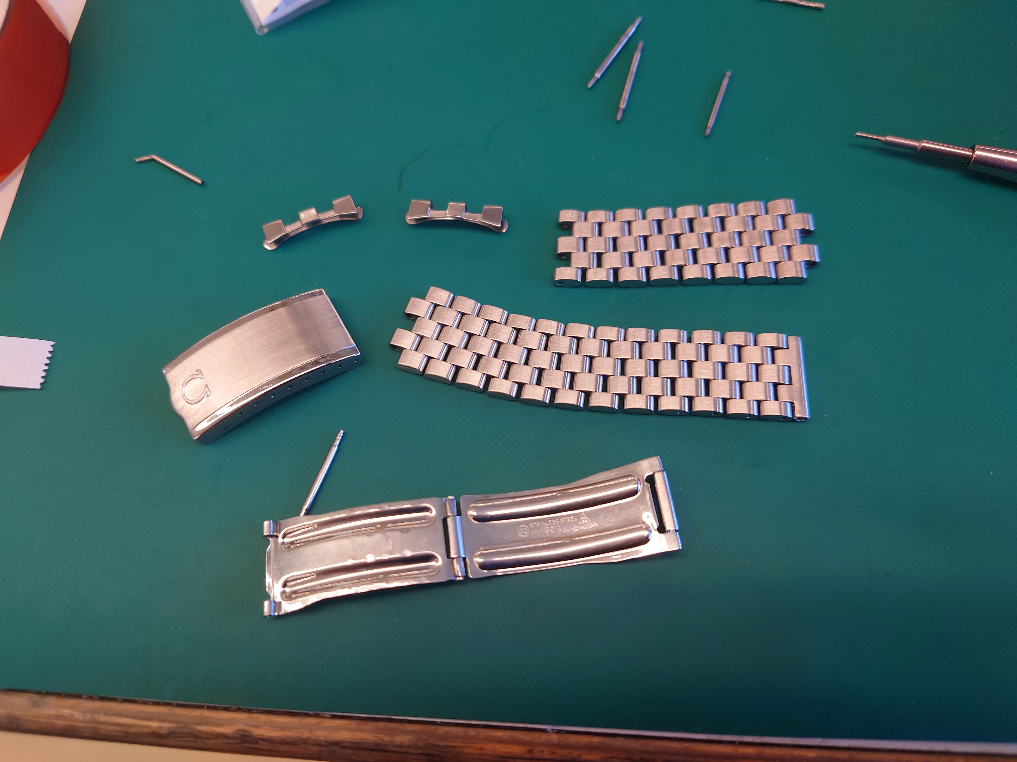

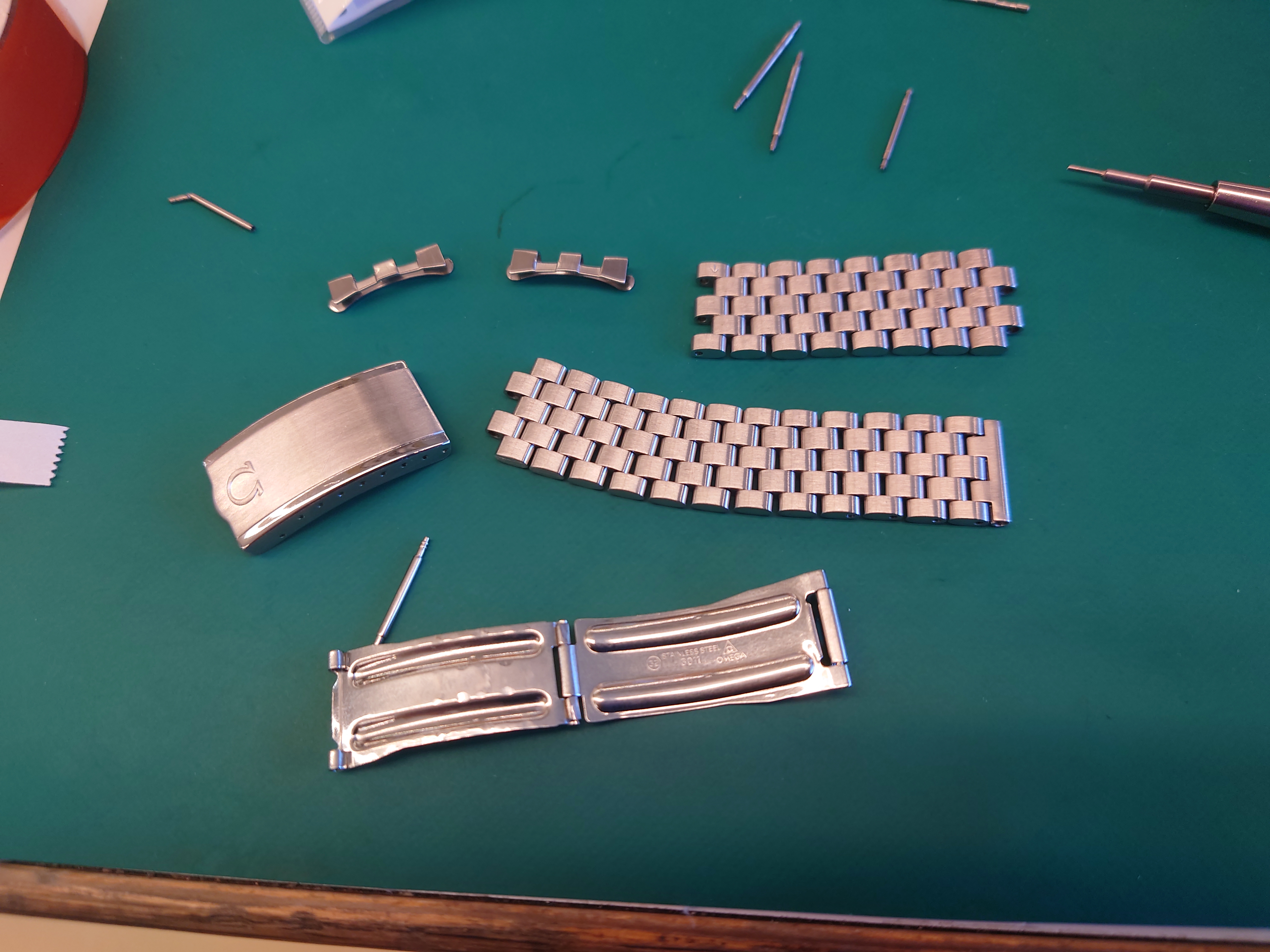

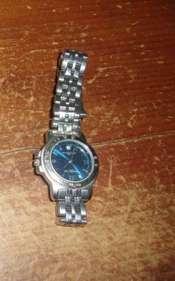

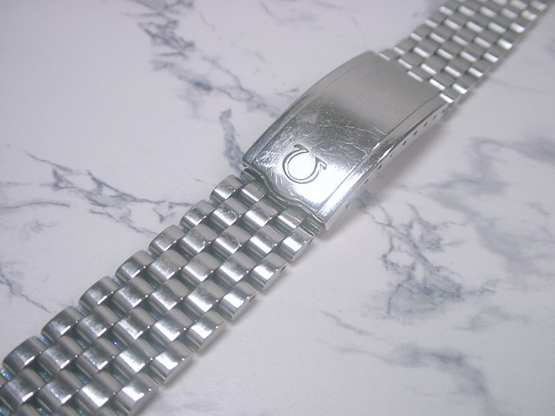

I recently had some assignments on case refinishing at my school, and since i finished my assignment fairly quickly I took the chance to refinish an omega 3011/518 bracelet for one of my c-cases.
this is the auction photo of the bracelet, unfortunately i forgot to take my own photos, but this bracelet has seen some years of use and taken a liberal hit with a buffing wheel in its past. Most of the original hairlined finish is very shallow now, and the sides of the clasp were polished till even the remains of the original hairlined finish was gone.
I pulling it apart, lightly buffed the polished lines on the clasp on the large buff, as this is a folded part I left the deep scratches alone. I then used some kapton tape to mask the polished section and put the hairline back into everything with a scotchbrite wheel. then put the hairline onto the sides of the clasp within some sandpaper on a block to keep the lines parallel with the base of the clasp.
a quick trip to the ultrasonic and reassemble.
very pleased with it, I can recommend having a go on bracelets or casebacks when starting out. at least that's what we did at school.

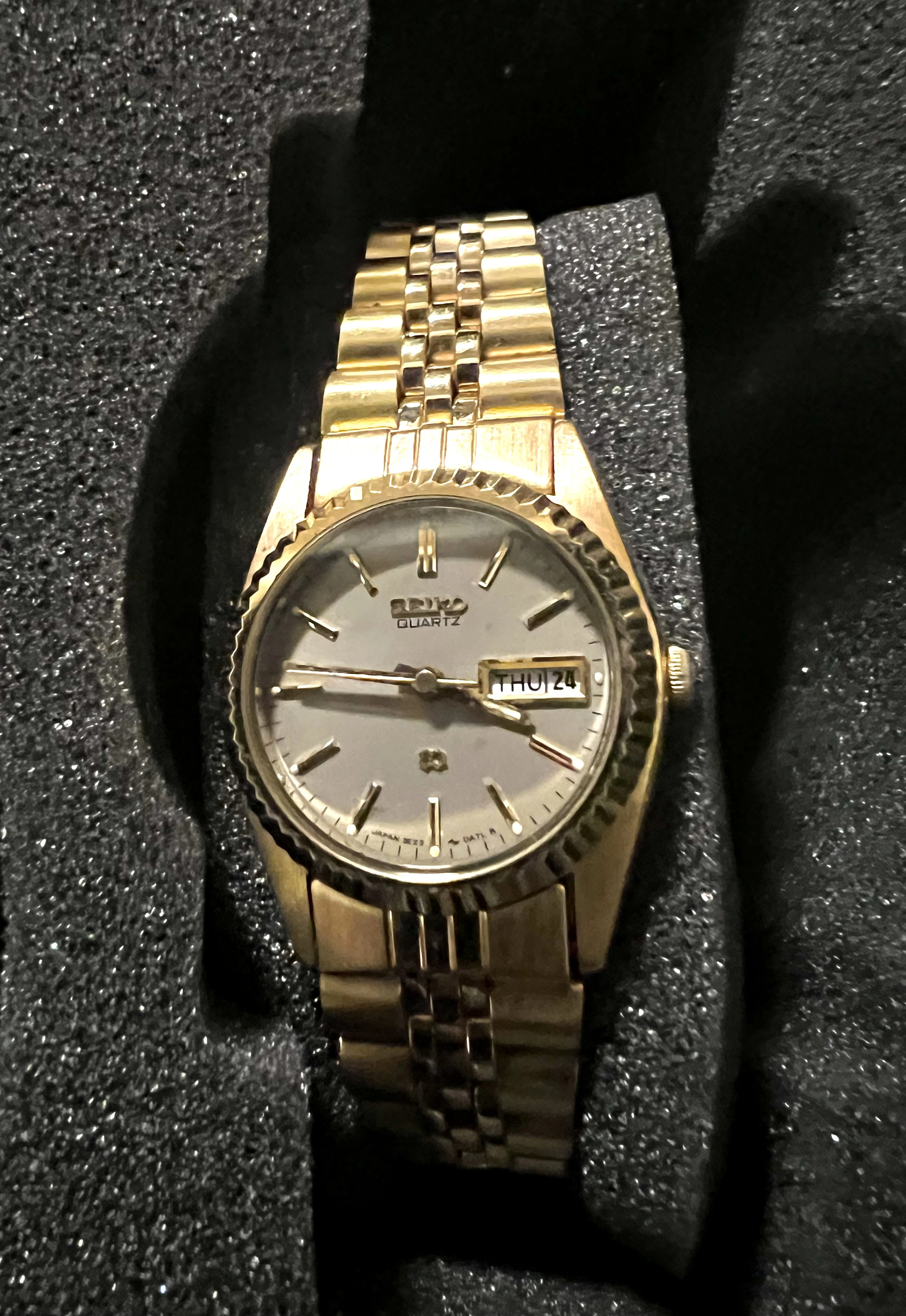

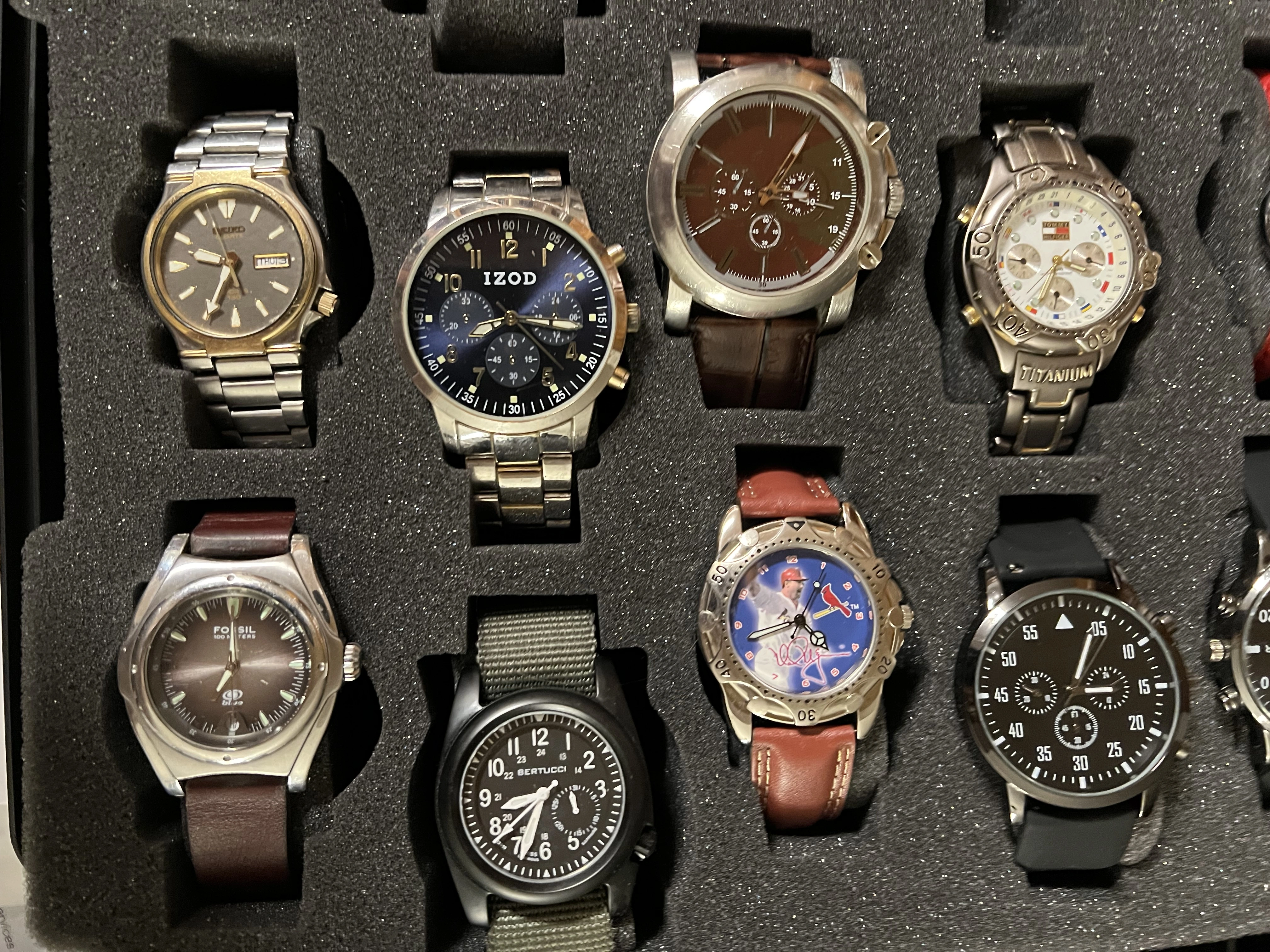

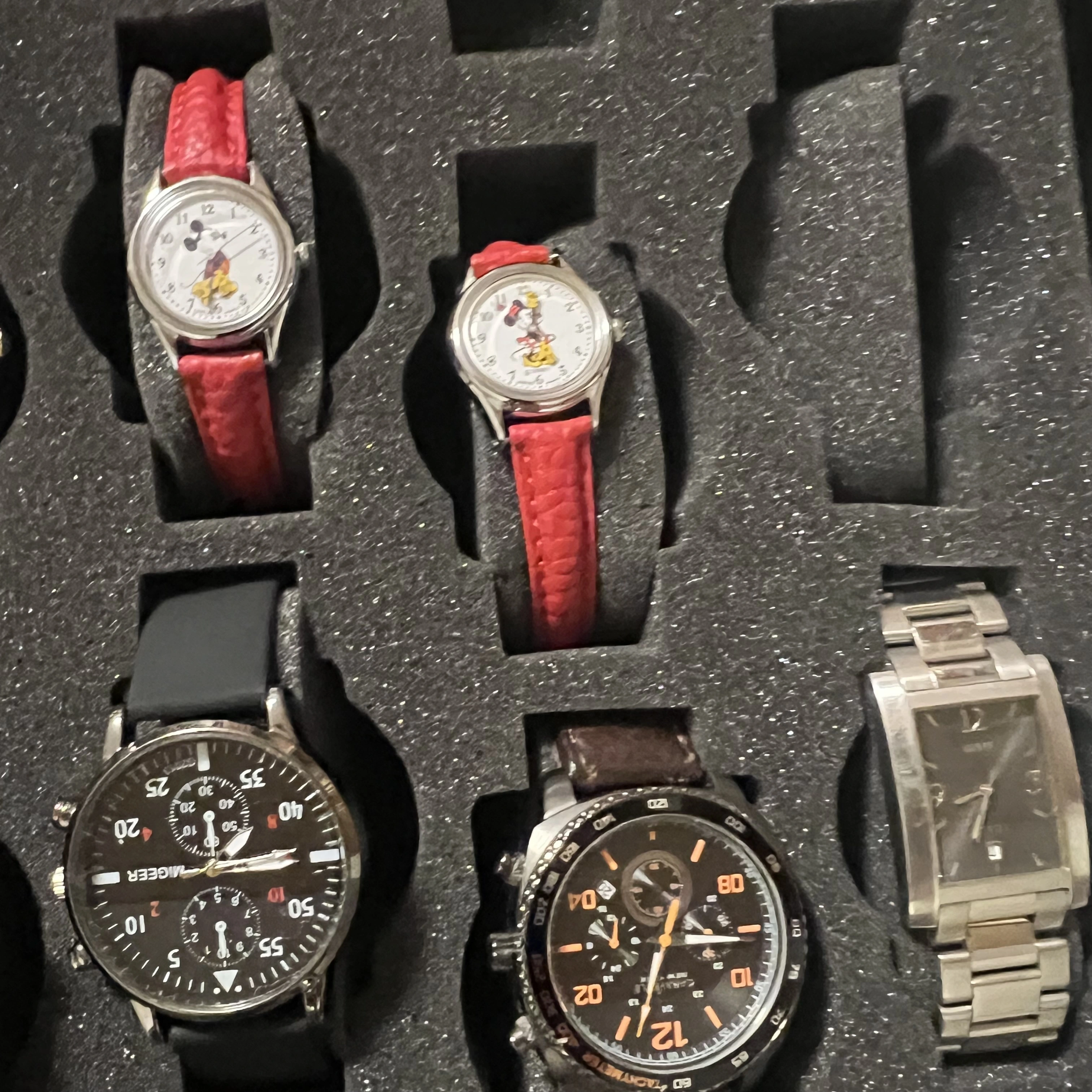

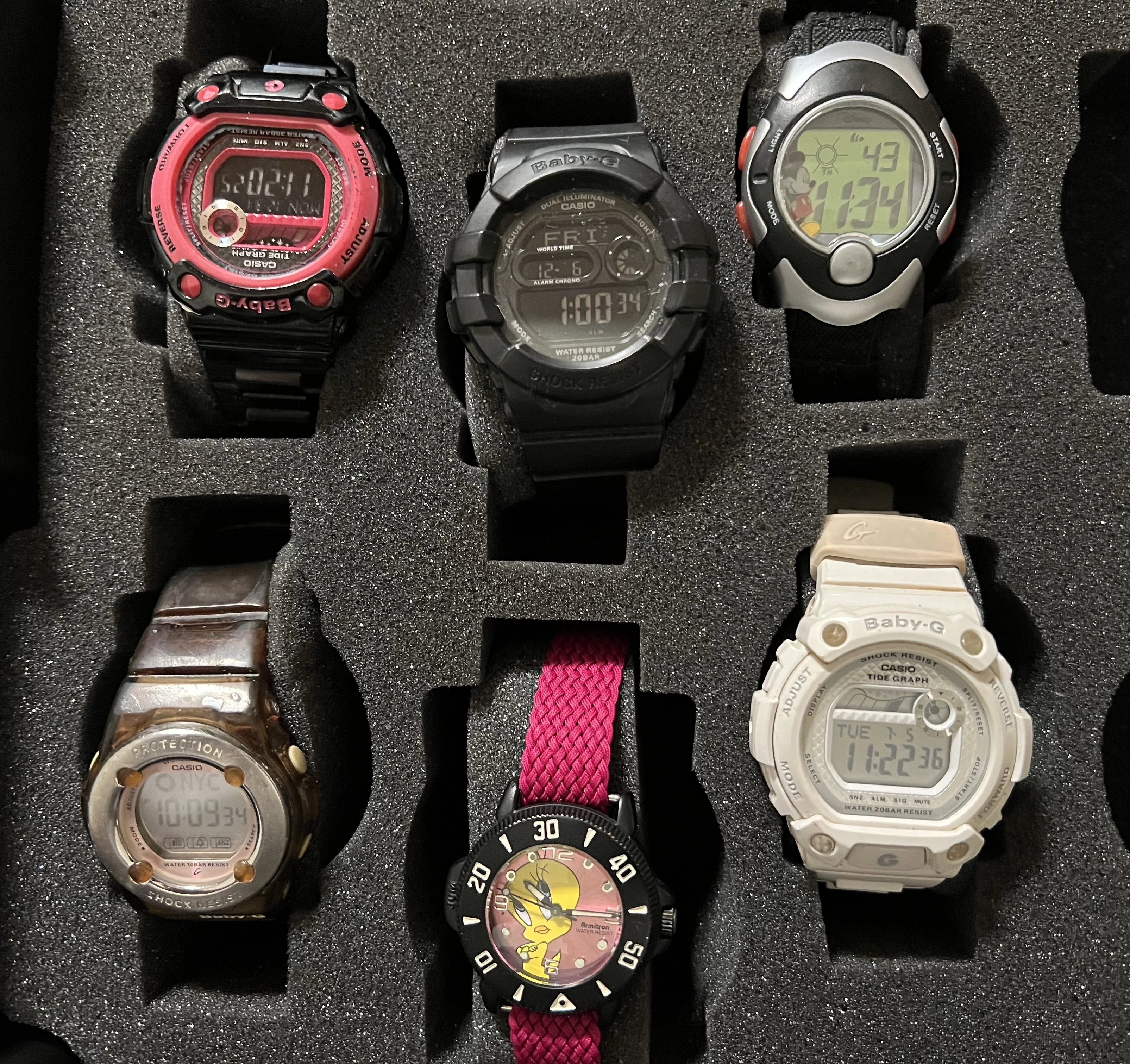

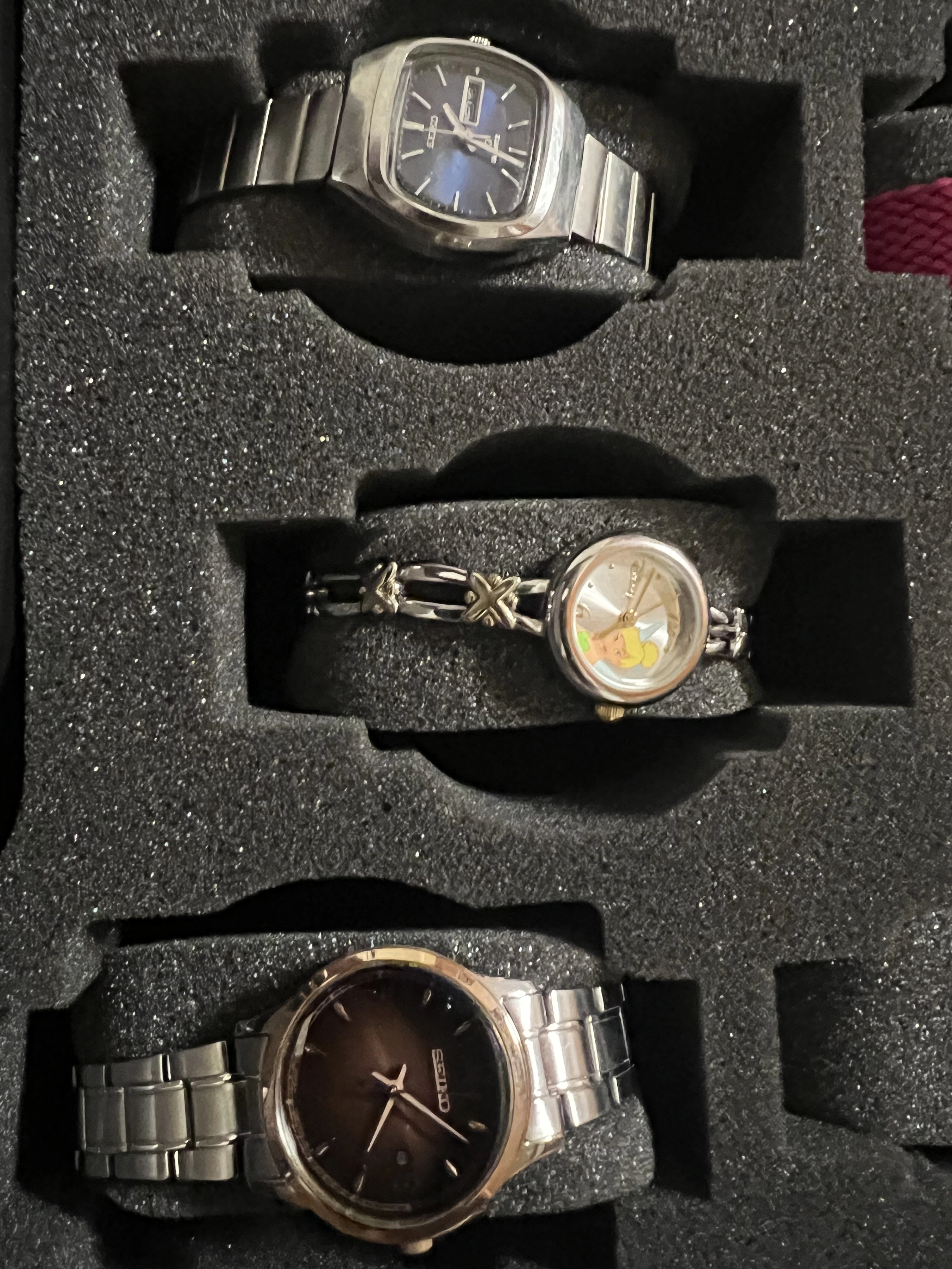

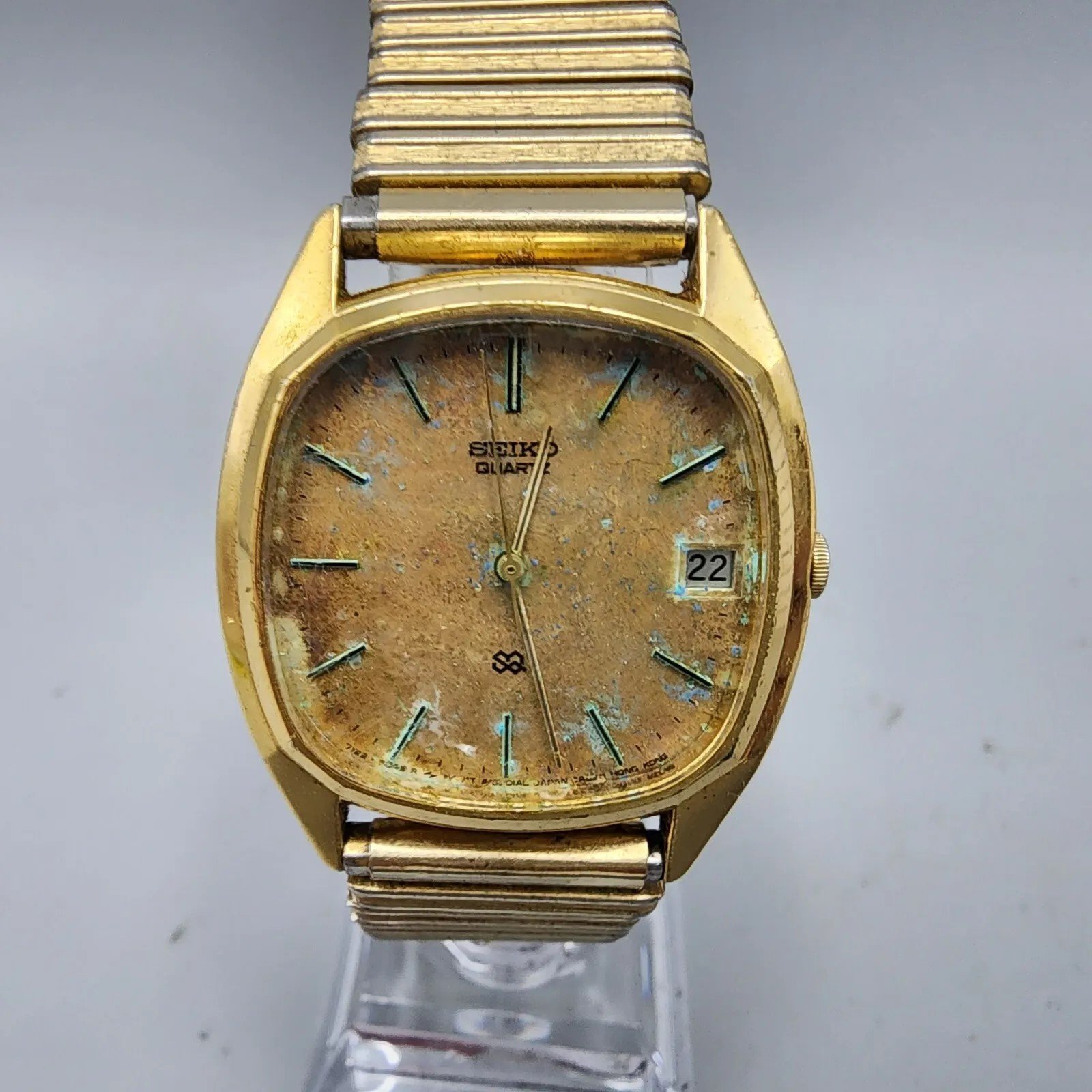

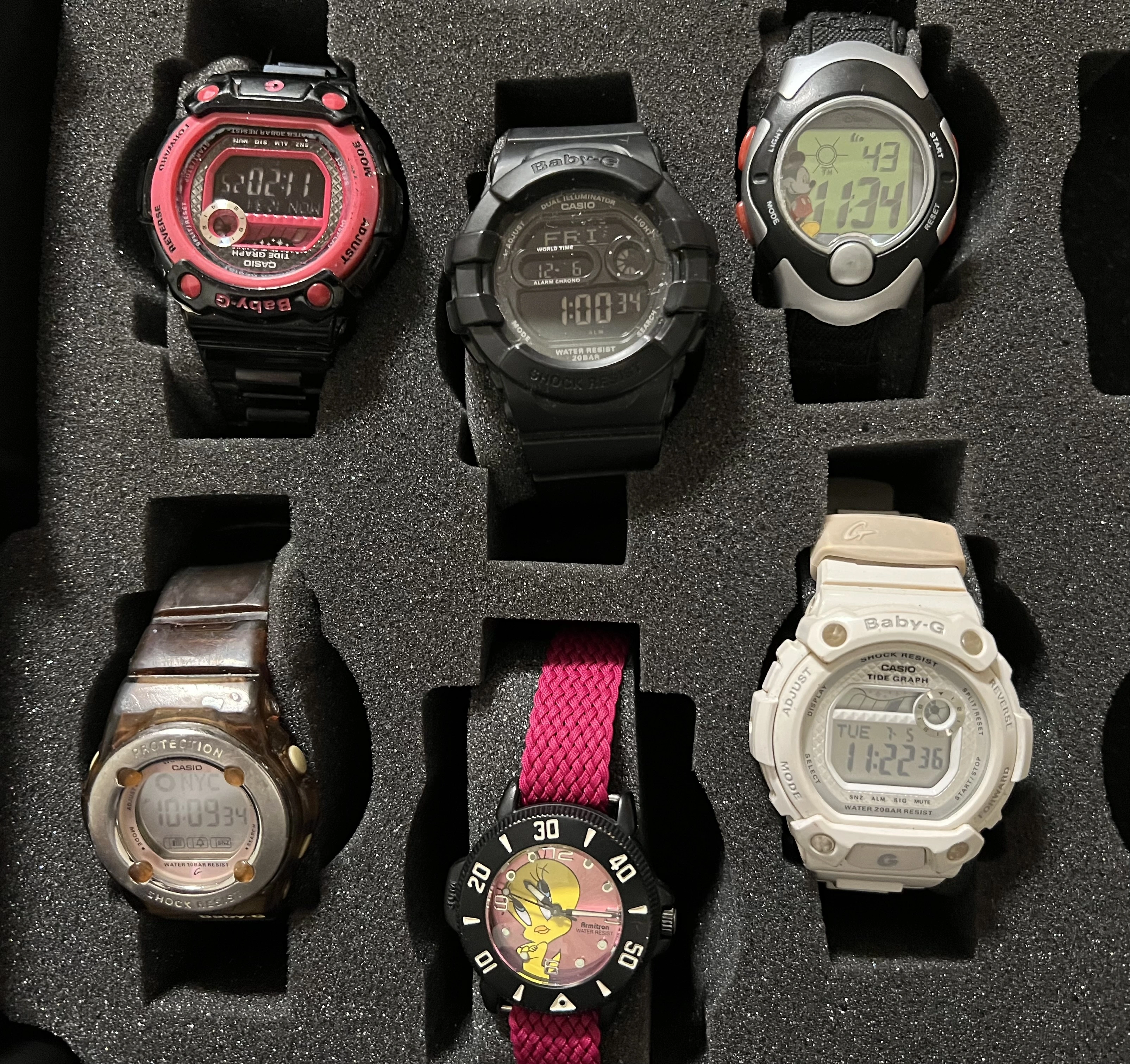

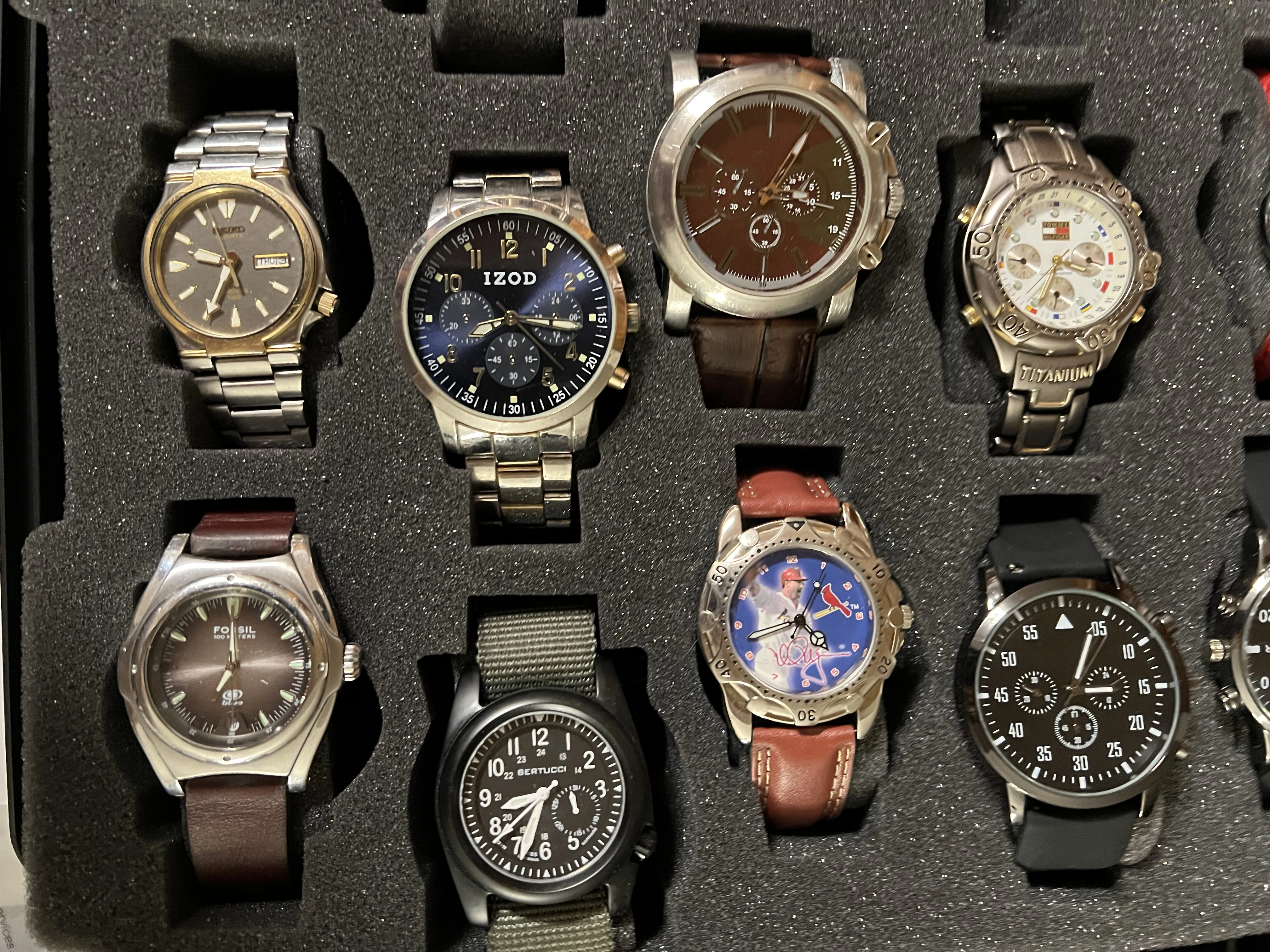

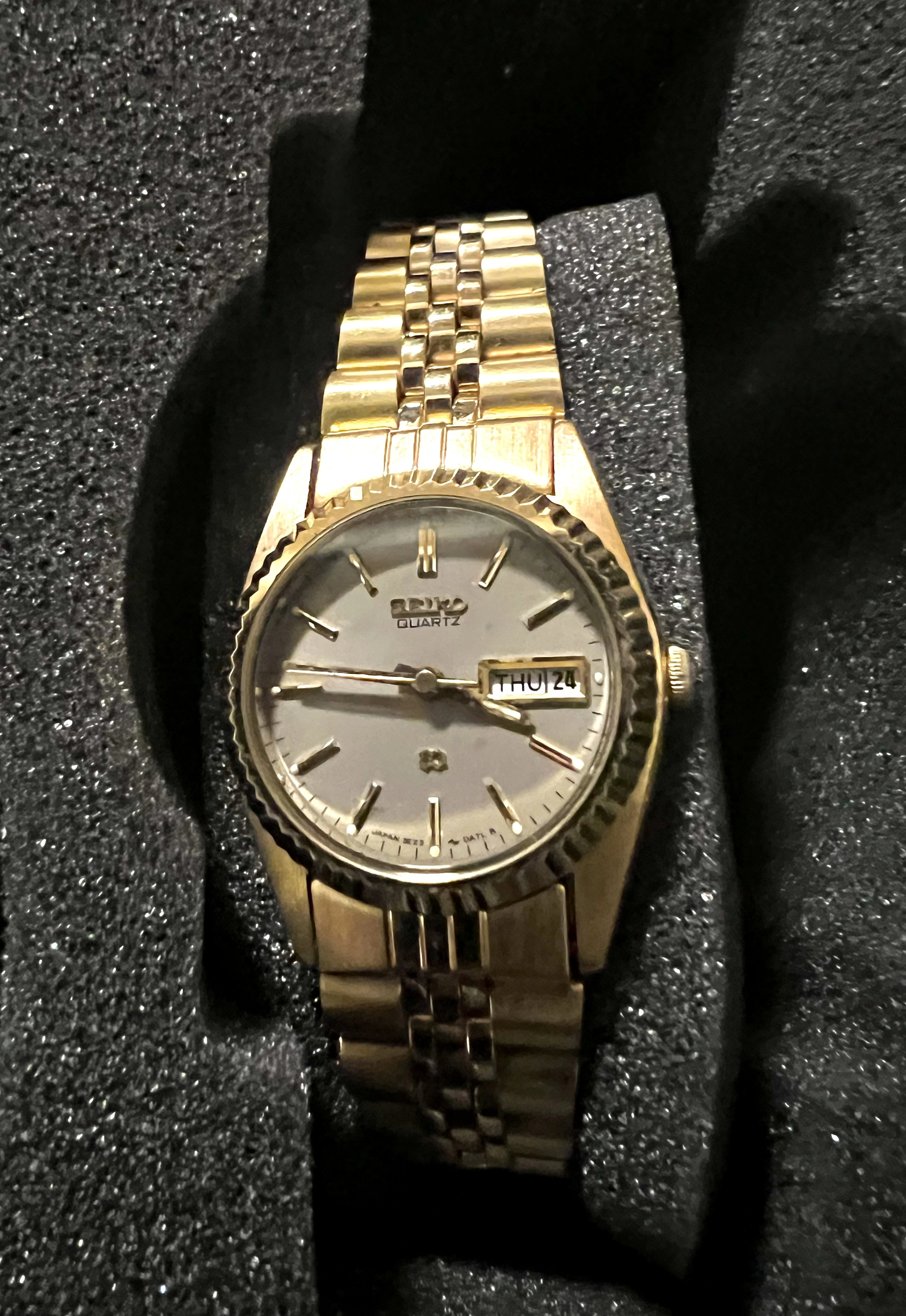

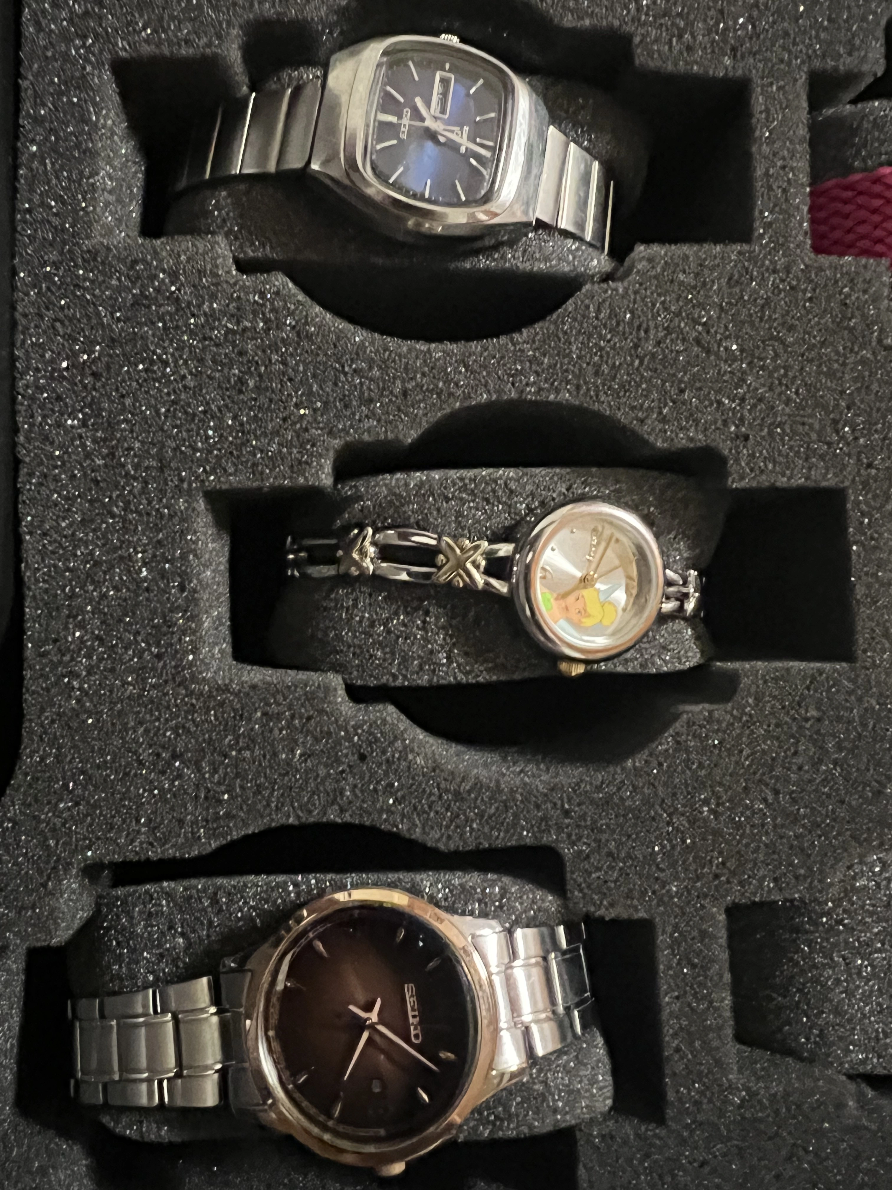

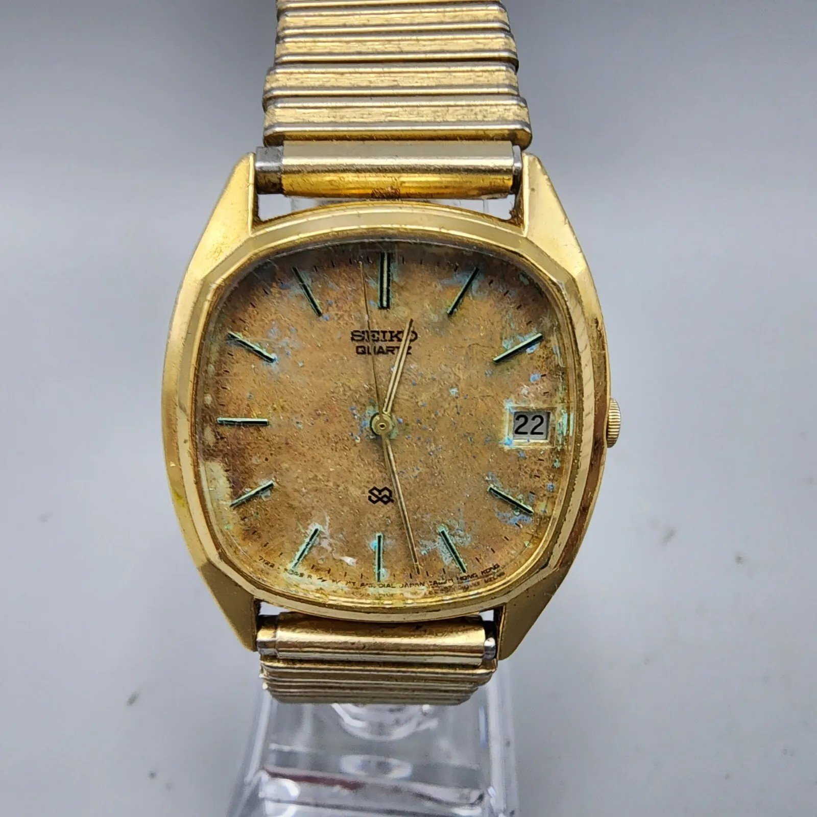

Hello all, after the fire I did not have time to do much polishing, but I am in the process of polywatch for all and all a good night (couldn’t help myself). Between sniping and offers I stayed within my budget. Rolling the dice on watches without batteries has netted me a few DOAs that will be great for polishing practice. New batteries, straps and a couple of NOS bracelets. The most fun was the gold lady’s Seiko on the last photo. I bought a two tone for my step mom and then came across a salesman’s sample. It had no clasp and hard plastic encasing the ends of the bracelet. Took a heat gun and lots of scrubbing. Donated the insides of the two tone to the gold one. The old dial was prettier and I kept that. Anyway I have a long way to go and much more learning to do, but thanks to your advice I have all the tools, compounds, and wheels to learn with. I also learned that all the quartz fashion brand watches I picked up were garbage under the hood. BTW, the nieces and nephews are getting the Baby-Gs.
