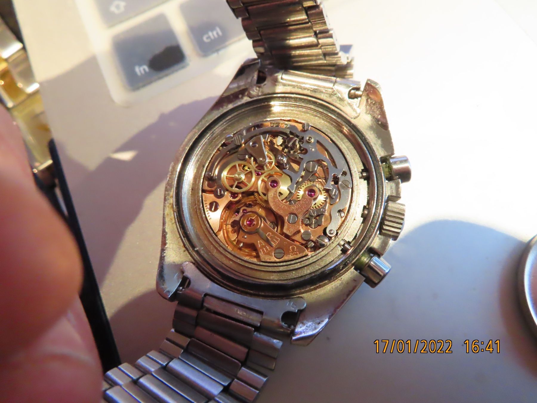

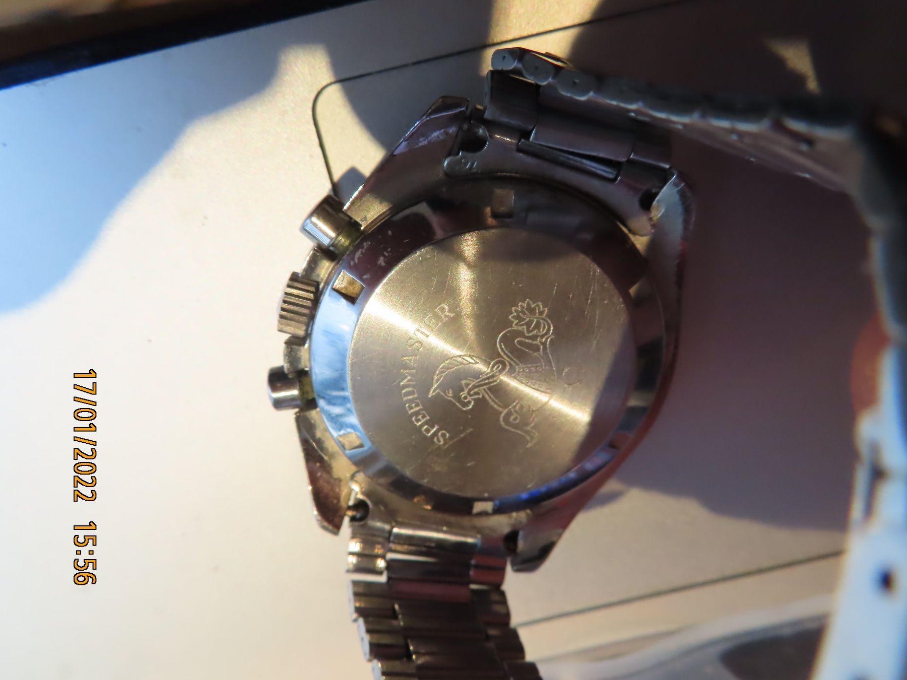

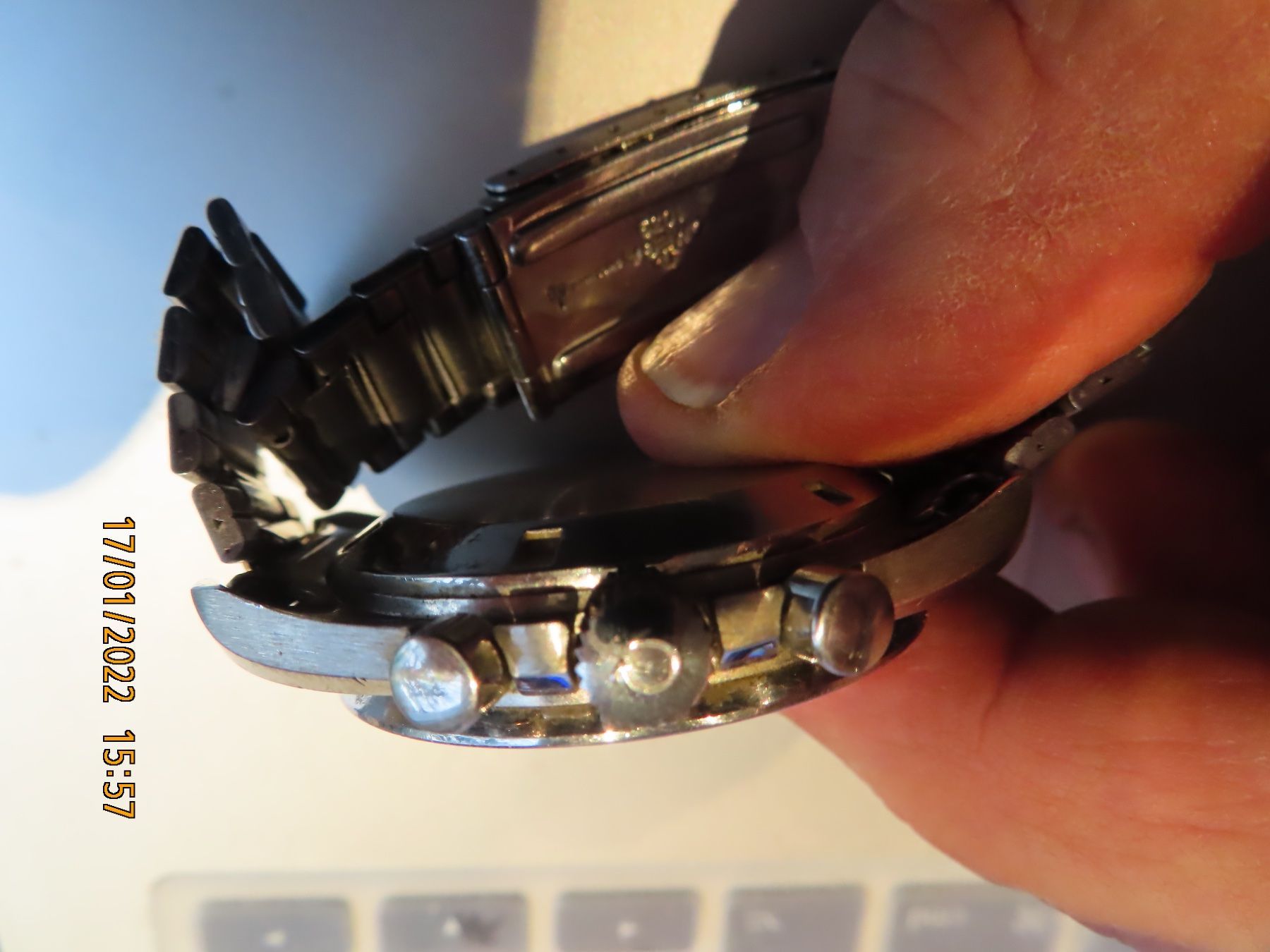

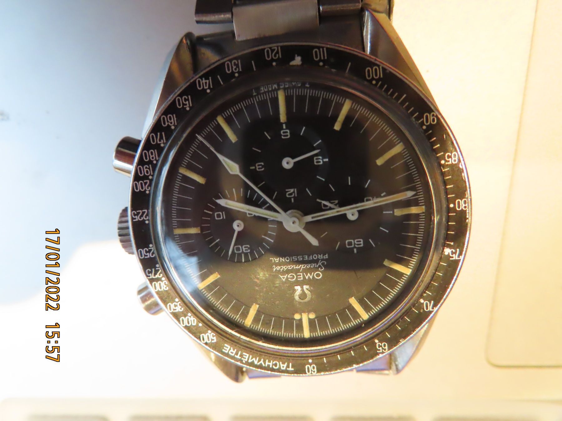

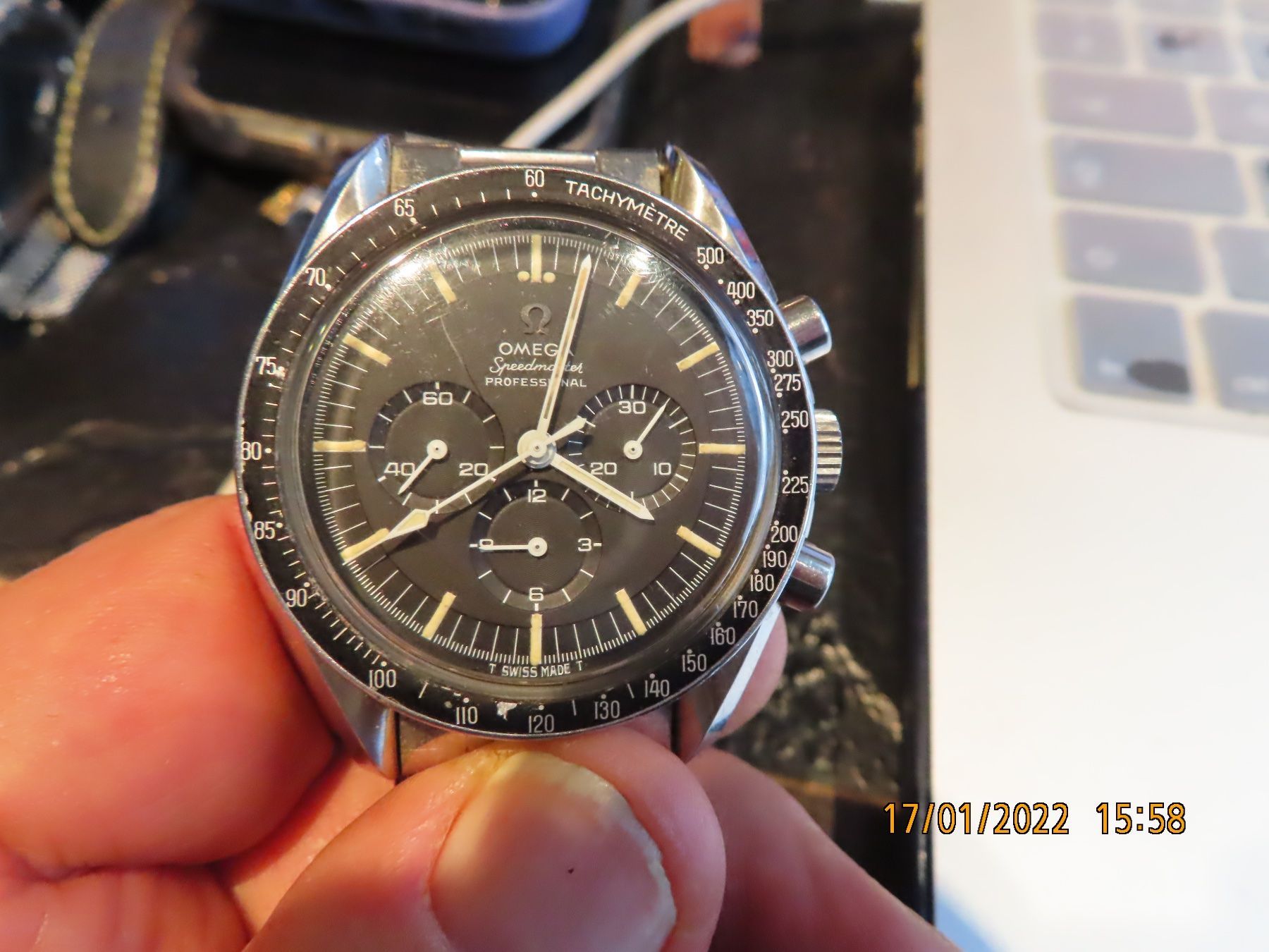

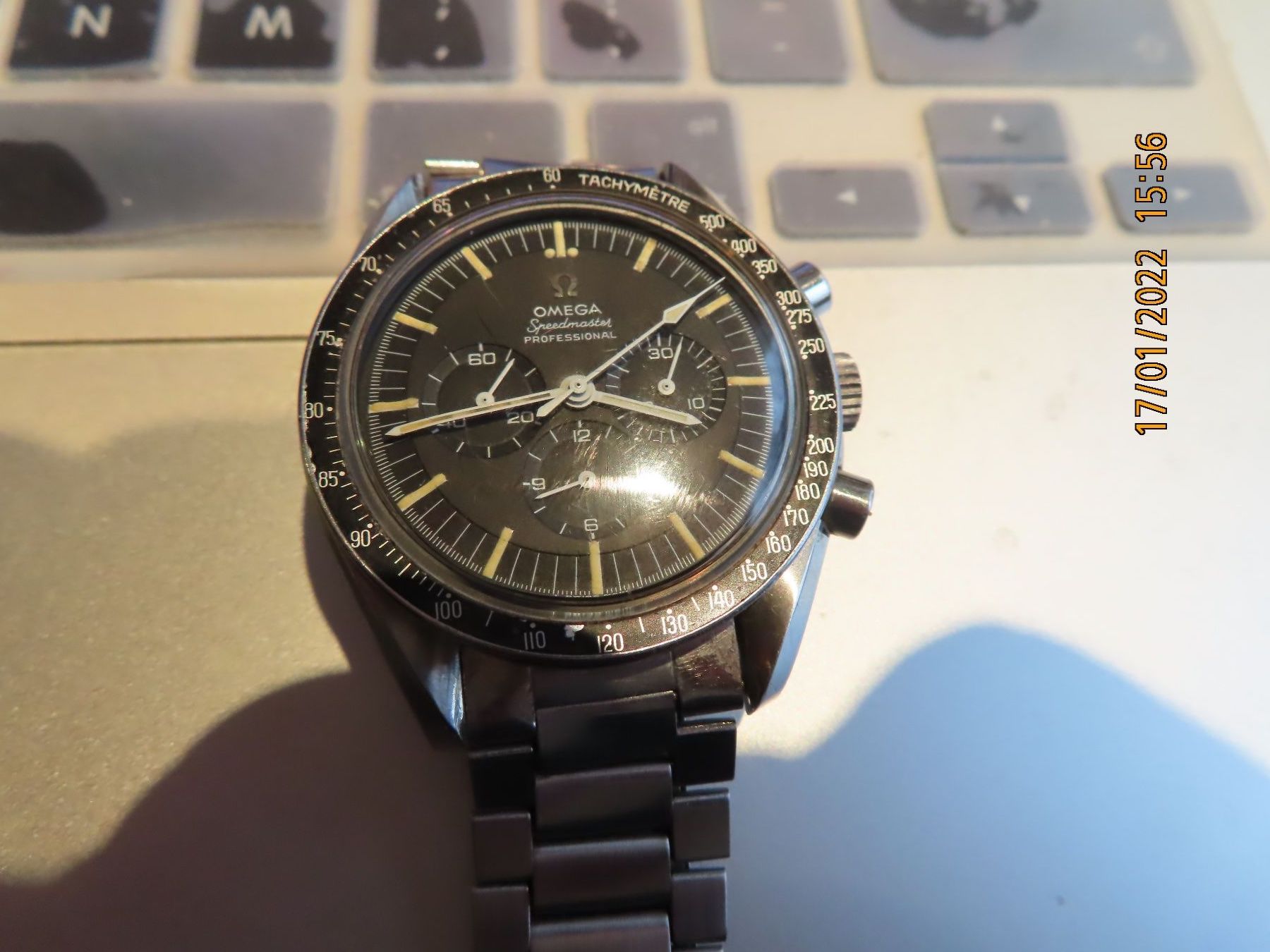

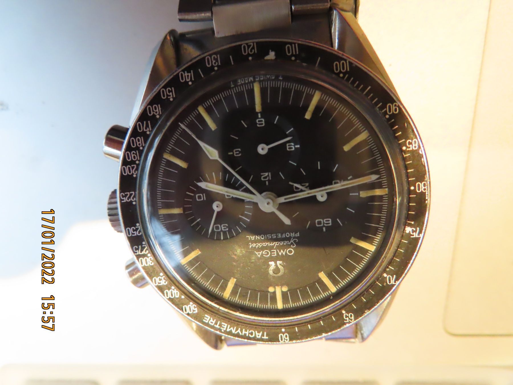

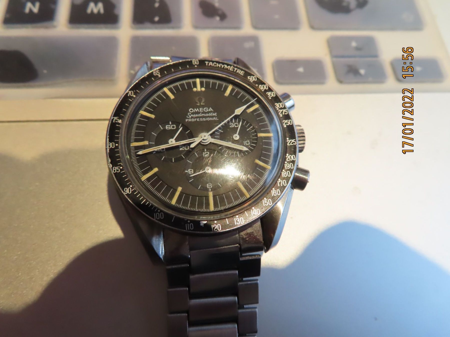

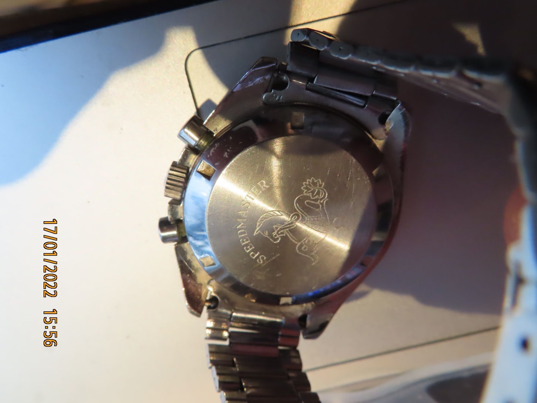

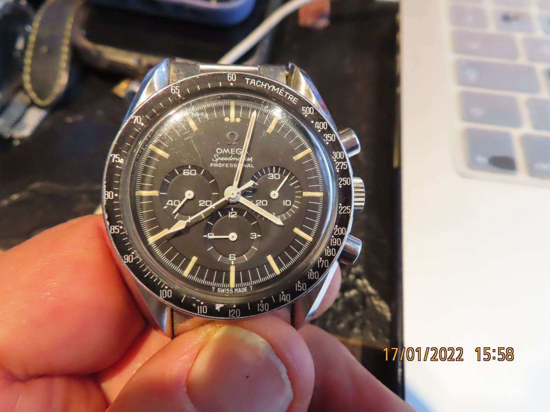

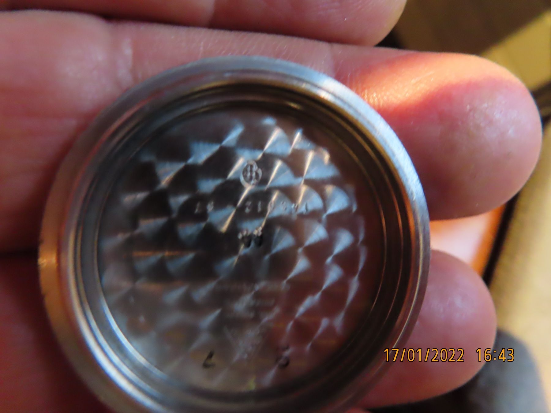

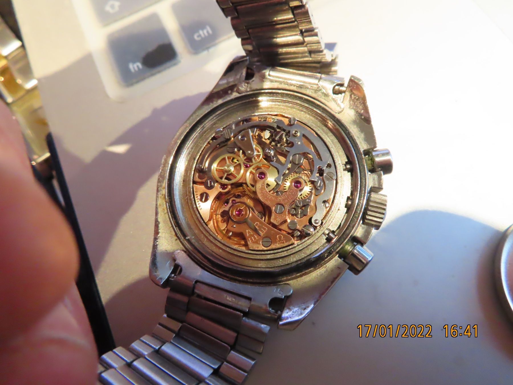

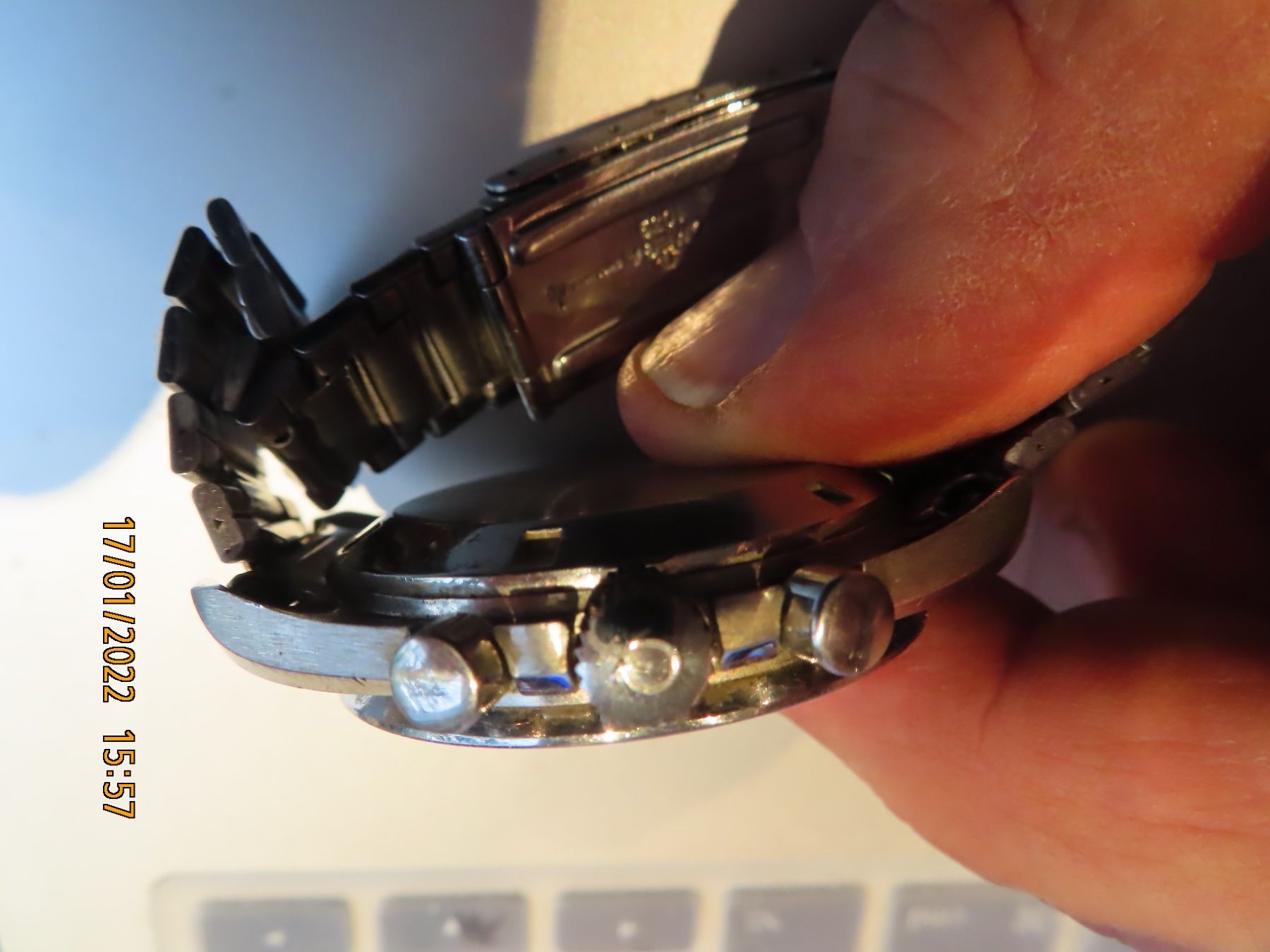

Let's first look at the seller's pictures, which are rather poor, but caught my interest, because if everything is correct with the watch, I thought perhaps competition would be lower.
The first step for me was to perform a basic hardware check to rule out an obvious Frankenwatch using the Moonwatch Only book, speedmaster101.com and of course examples on OF as resources and reference points.

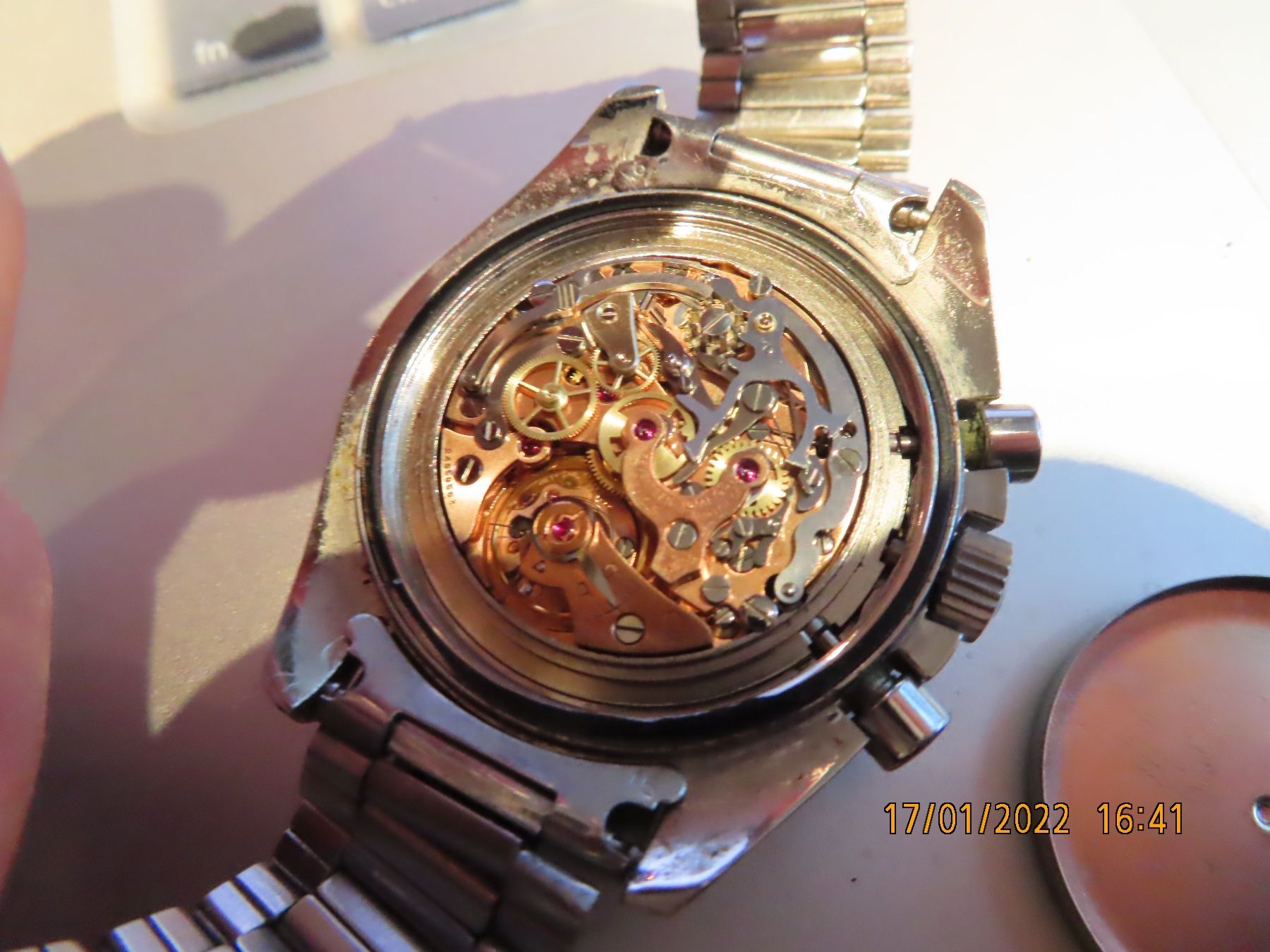

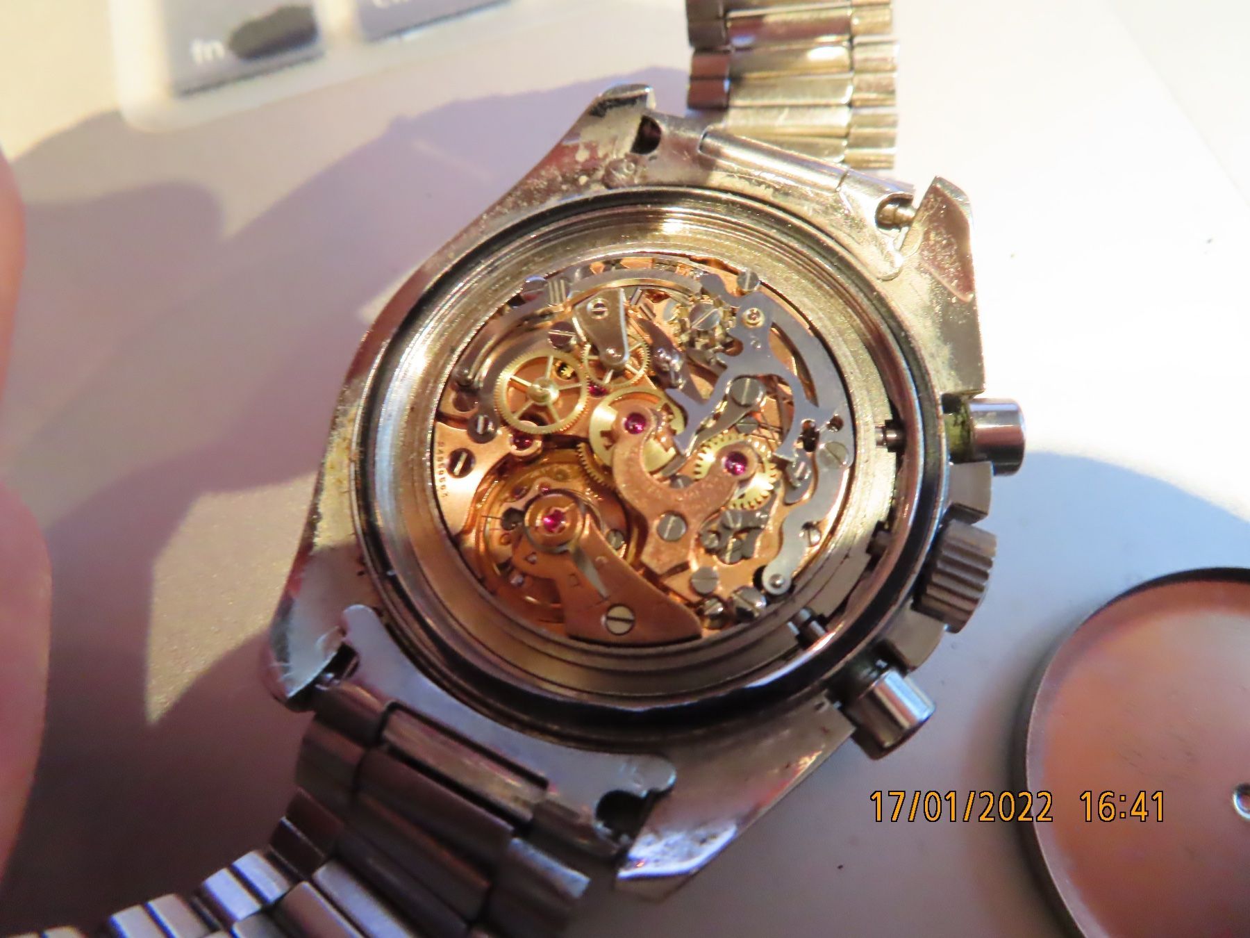

- Movement serial number: Though not clearly legible, it's for sure a higher 24mil number putting it at the rather early end of the movement range for a 145.012.
- Hands: Correct hands, the chrono sweep hand with the drop shaped end is correct for the earlier 145.012
- Correct dial
- DON bezel

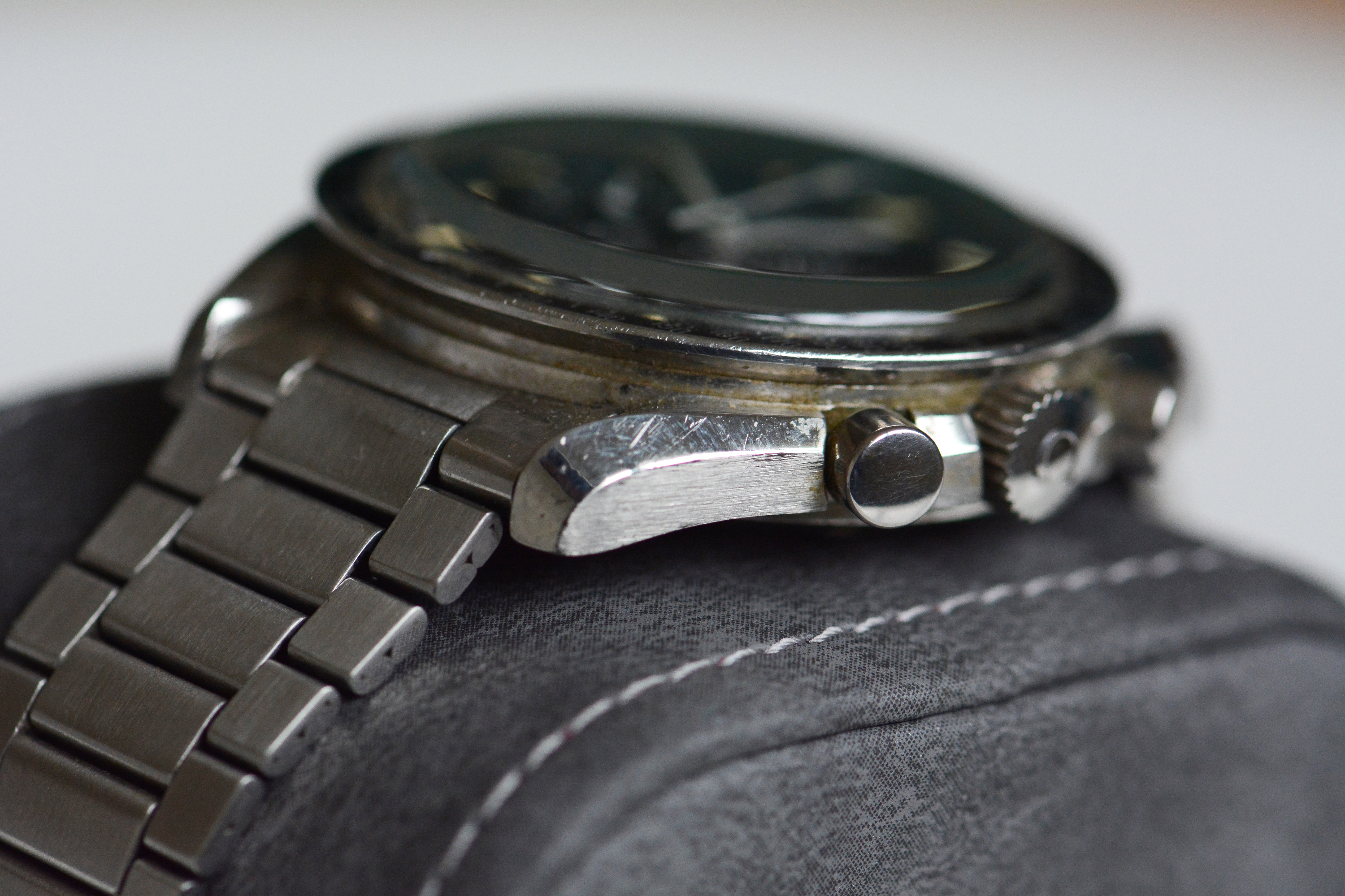

- Crown is a later replacement, but I don't mind.
- As for the pushers, I wasn't sure (but learnt later that the replacement would look exactly the same as the original)

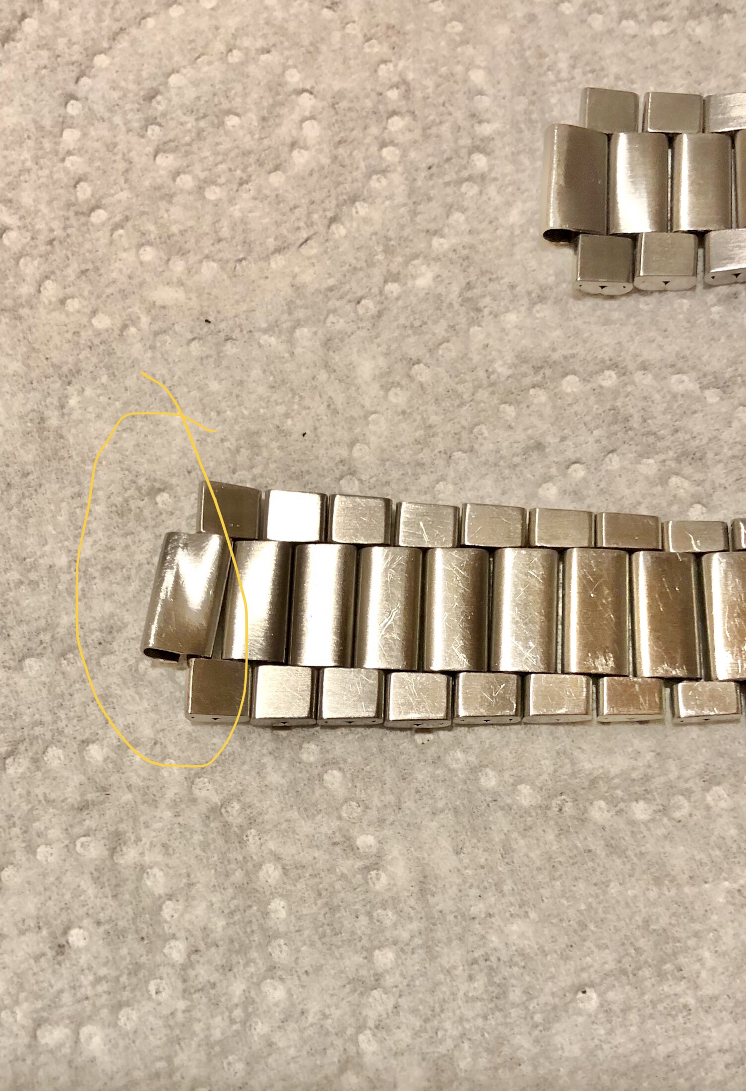

- The bracelet is a correct 1039, but as opposed to the correct 516 it comes with 16 end links. I (wrongly) assumed them to be identical or interchangeable (like the 70 and 570 end links for the BoR bracelets).
So for me, it passed the first basic check.

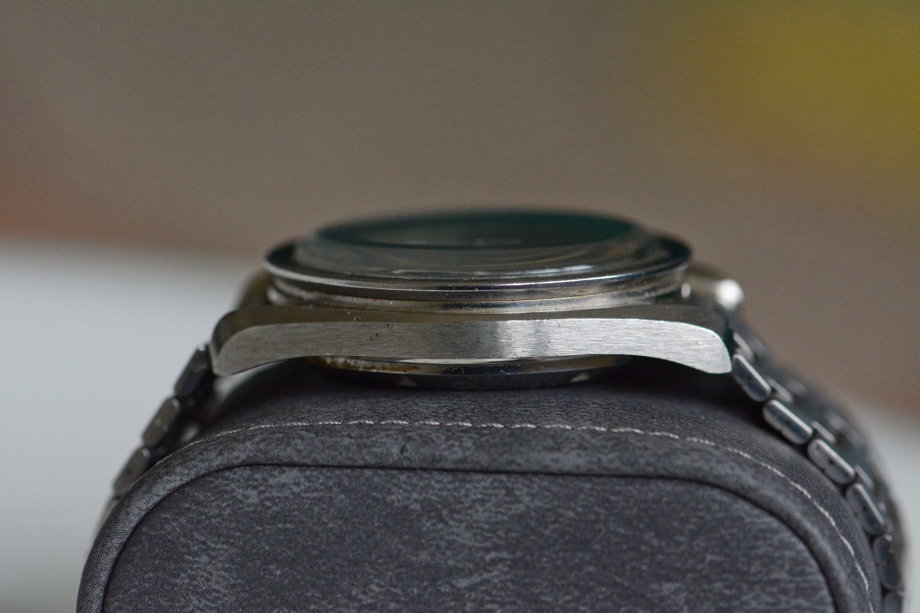

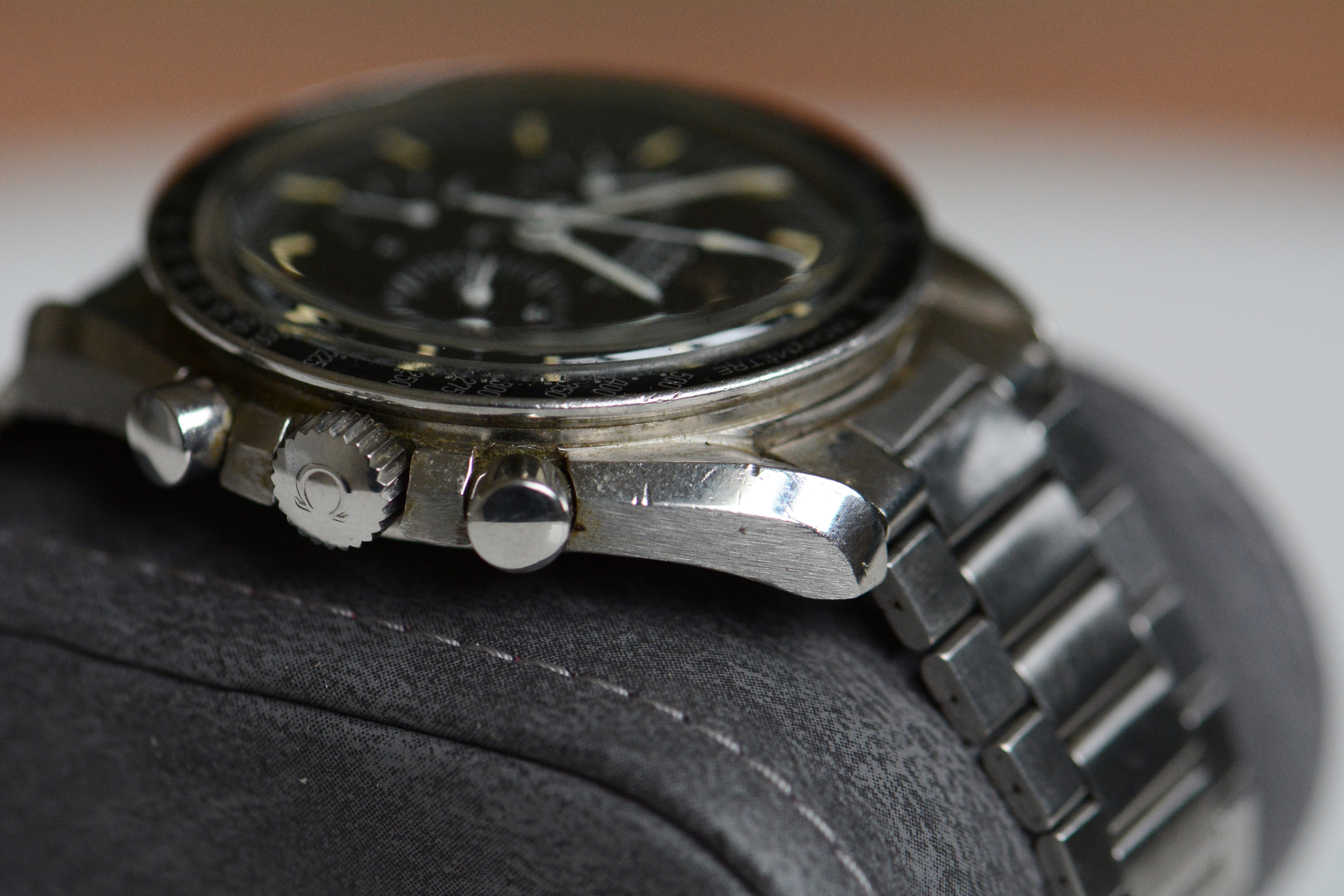

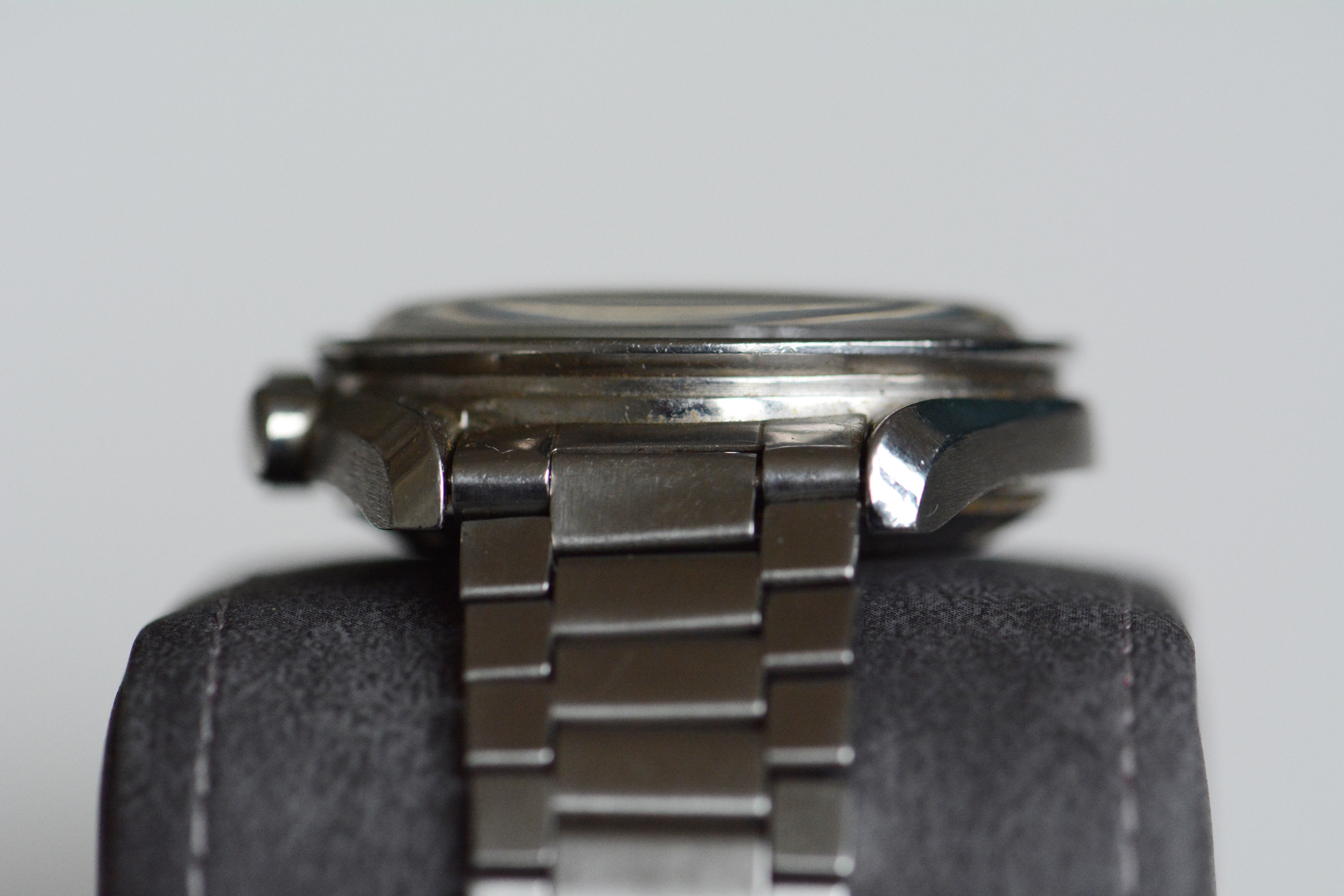

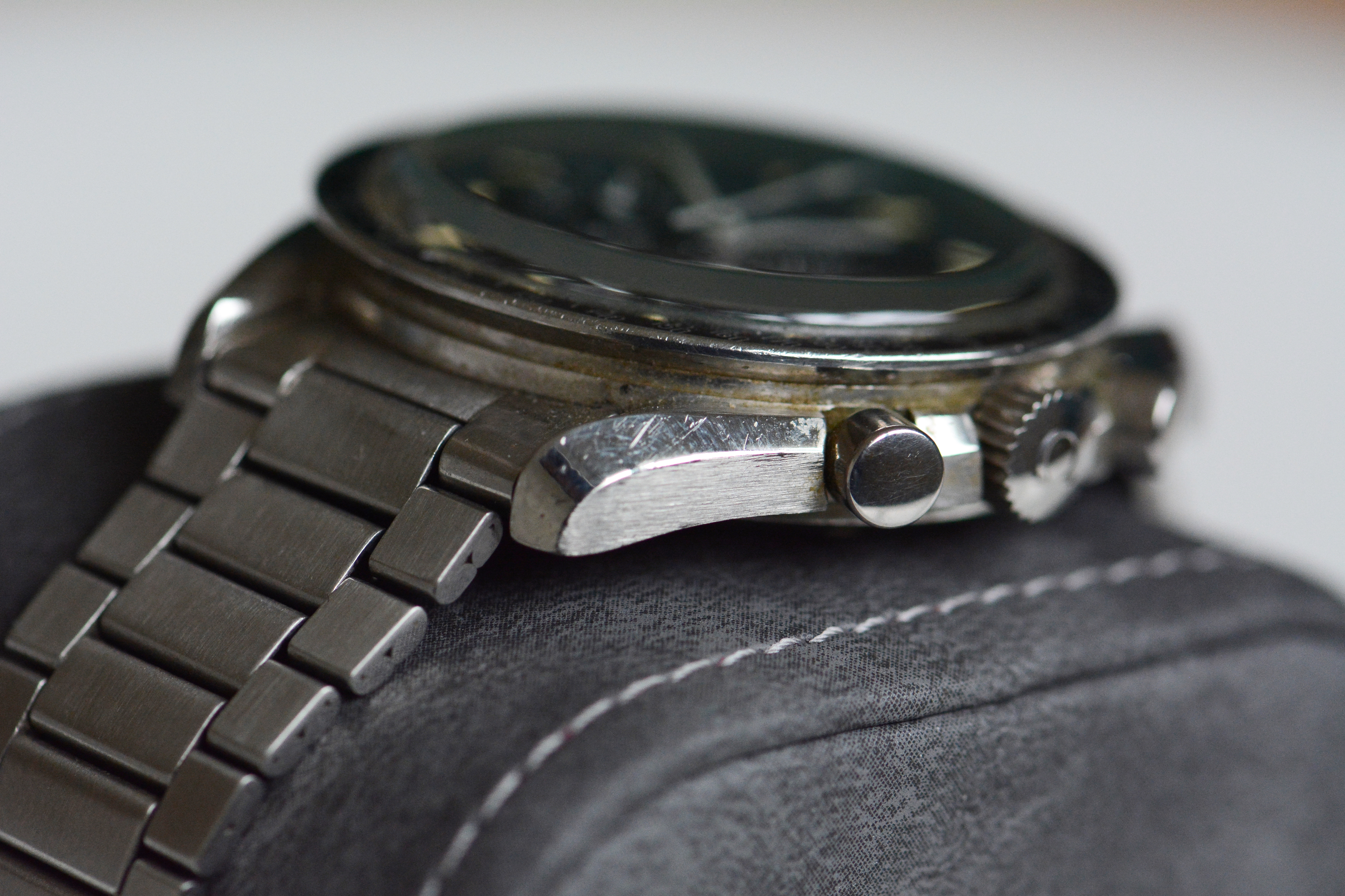

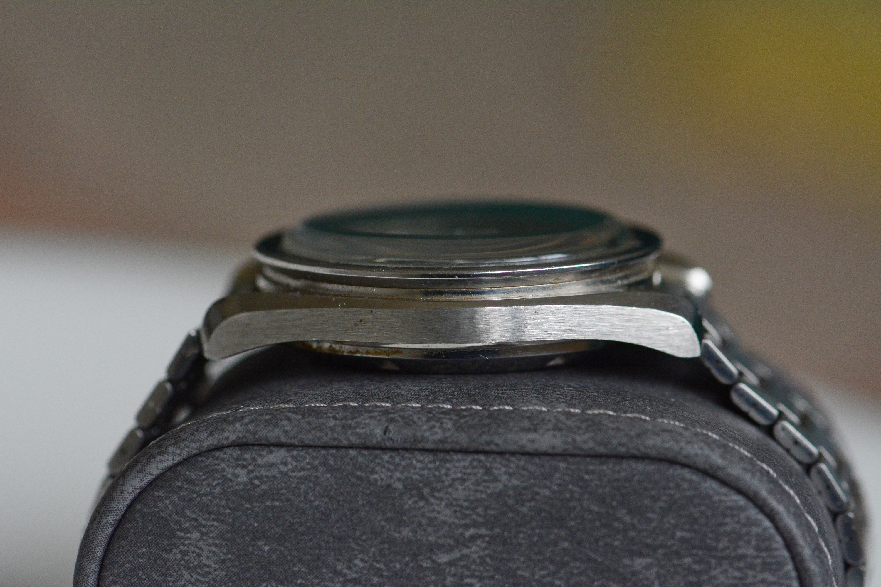

The second step, the assessment of the condition, was obviously a bit harder. I initially assessed the state of the DON bezel as OK or good, and the case as sharp given that the original brushing on the sides of the case is still clearly visible. I found the color of the lume attractive, but where I struggled and had to involve the seasoned members and experts was to answer the question whether the lume on the dial and hands was original. My concerns were the somewhat "wobbly" form of the lume plots, in particular at 9 o'clock and the non-matching lume color of the hands among each other, i.e. the minute hand having a darker, discolored lume compared to the hour and chrono sweep hand. I was leaning towards original, but wanted to have it confirmed, before spending a serious amount.
My thanks go to @Dan S, @Passover, @ndgal, and @Aludic, whose comments and insights helped form the decision to eventually go for the watch. I owe a special thanks to @Aludic who wrote me an in-depth assessment of the watch pre and post purchase, adding to or correcting my initial assessment. They inputs were very helpful, so should be shared publicly so others may benefit from them:

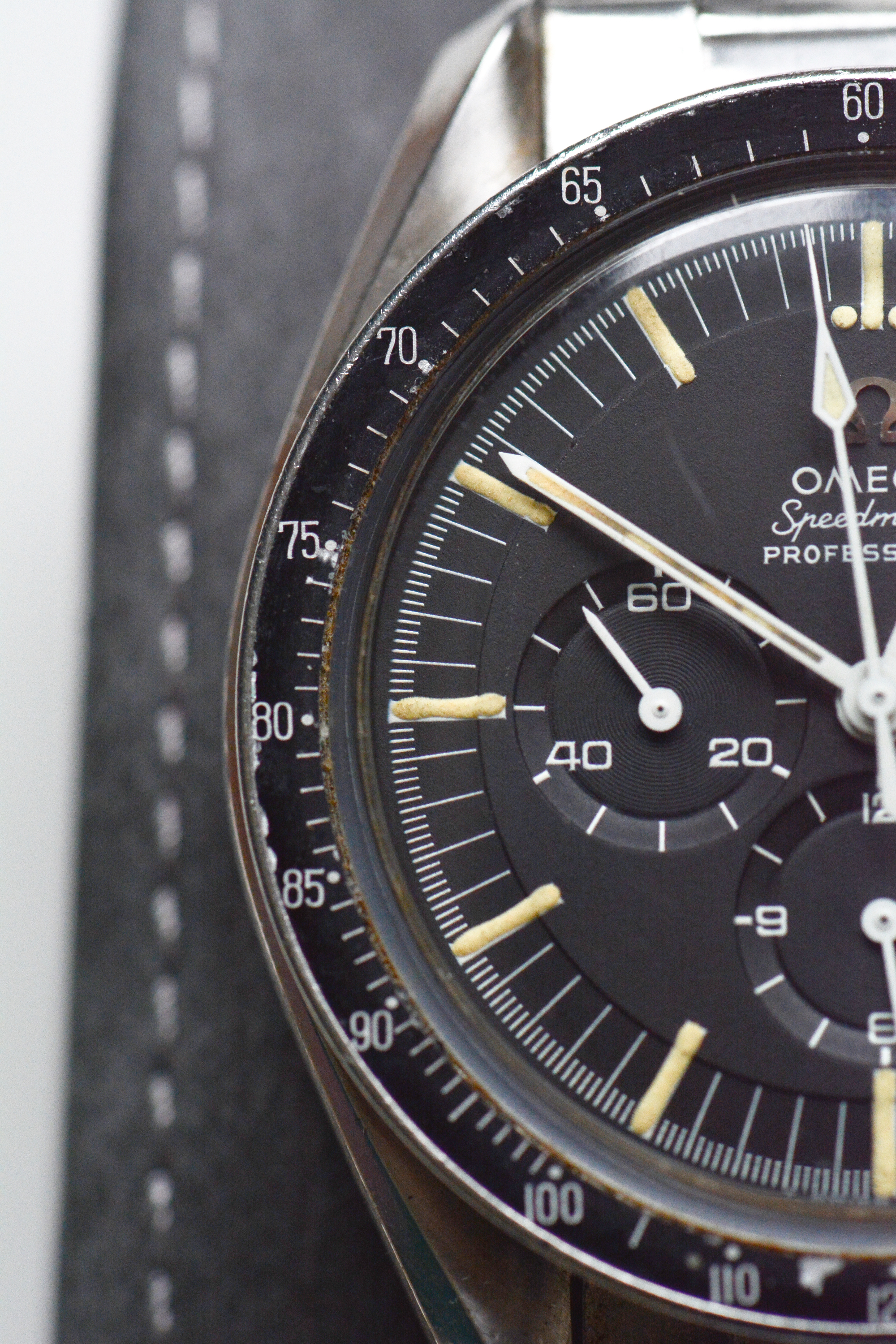

- DON bezel: Original but the condition is worse than "good" given the major flaking at btw. 110 and 120 and should be taken into account for pricing.

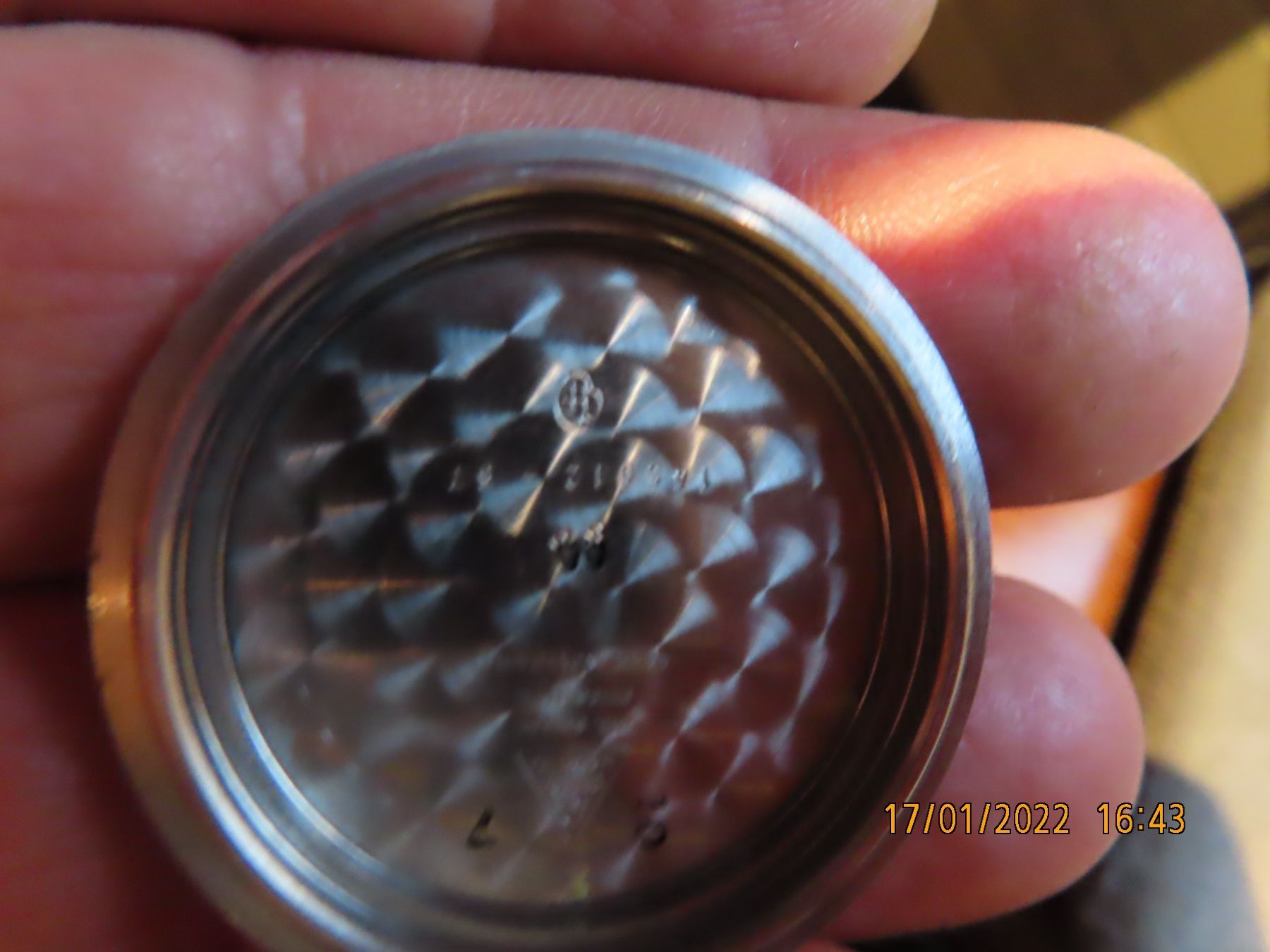

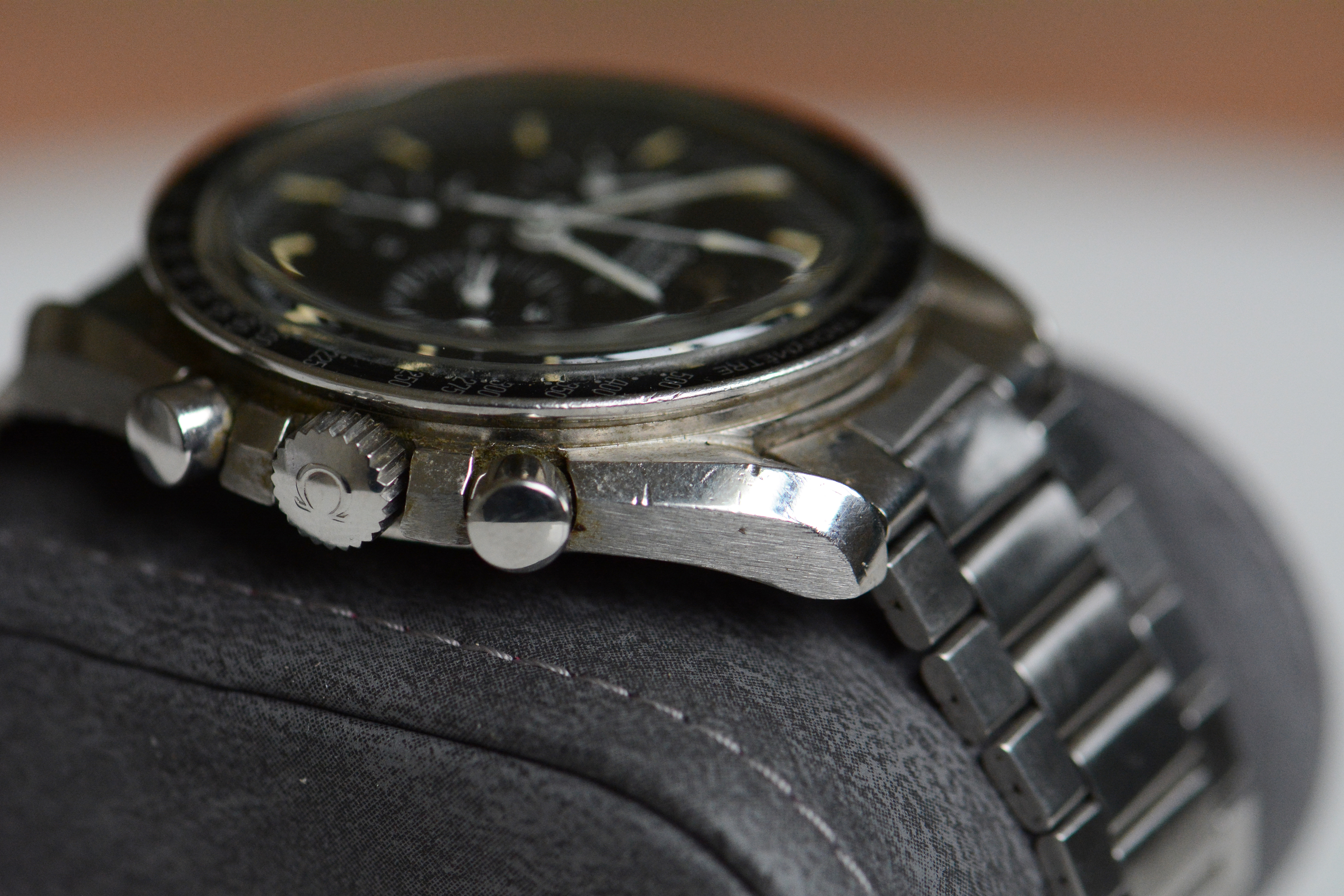

- Case condition confirmed to be sharpe with defined case lines and solid case back.
- Bracelet: yes, 16 end links are not correct and don't have exactly the same size, but are as valuable as 516, and should not affect the value much. So that was good news. (I found these threads about the Speedy bracelets later here and here for reference).

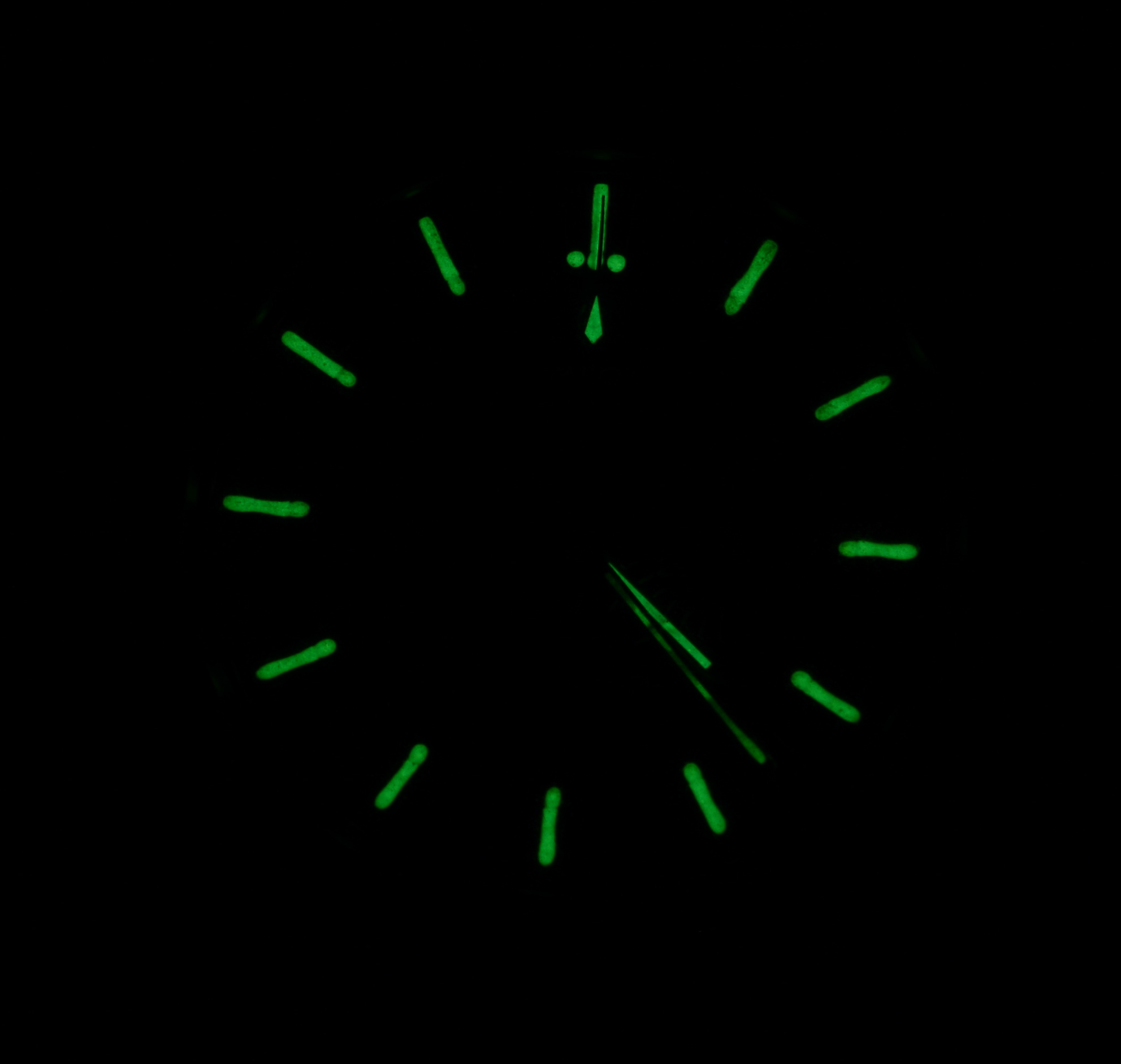

- Dial lume: It's hard to summarize the experts opinion in short, and I don't want to put words in people's mouth, but I nobody was in the strict relume camp, but the broader consensus was leaning towards originality with a various degree of caution attached given the poor sellers pictures. Better pictures in better lighting and preferably a UV shot would be needed to confirm with confidence. But hints mentioned for originality were: "wobbly" or recessed lume is not uncommon, non-matching lume of the dial and hands are a good sign (as they came from different suppliers), relumed dials often look too uniform and too perfect.
- Lume on hands: In fact more questions were raised about the lume on the hands than the dial given the difference in color. It was suggested that perhaps the hour hand and chrono hand were later replacement or there was a lume job done on the minute hand.

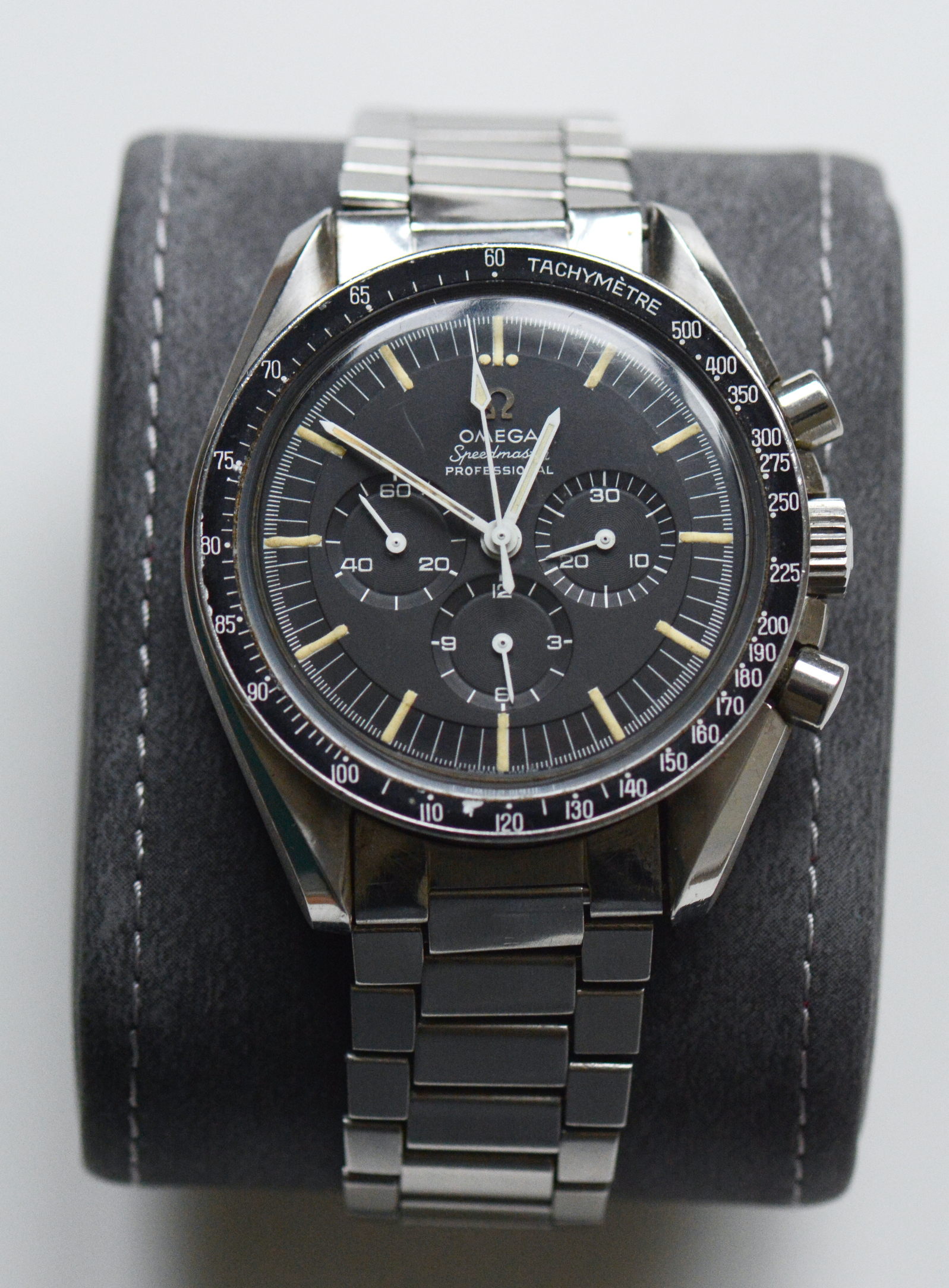

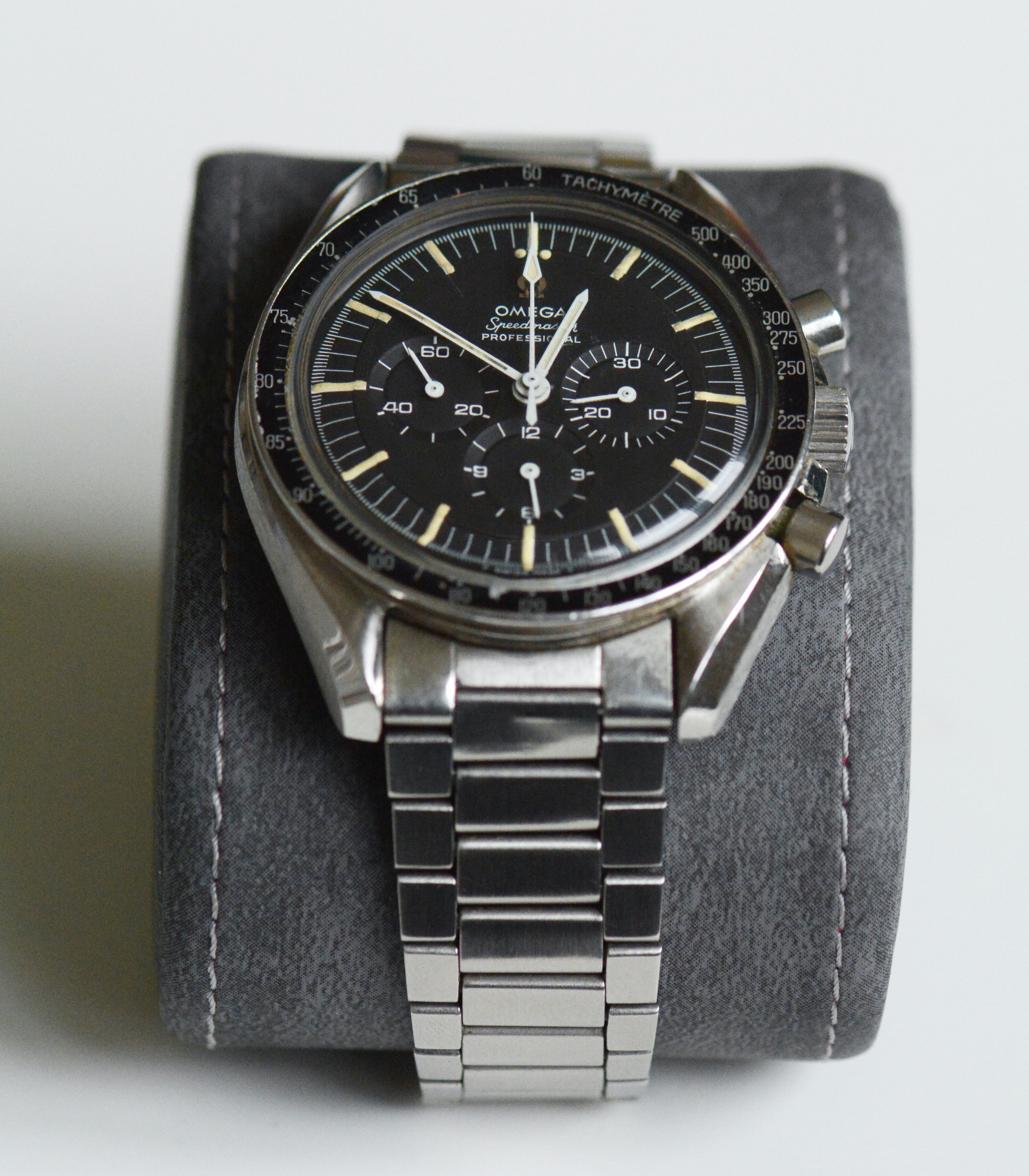

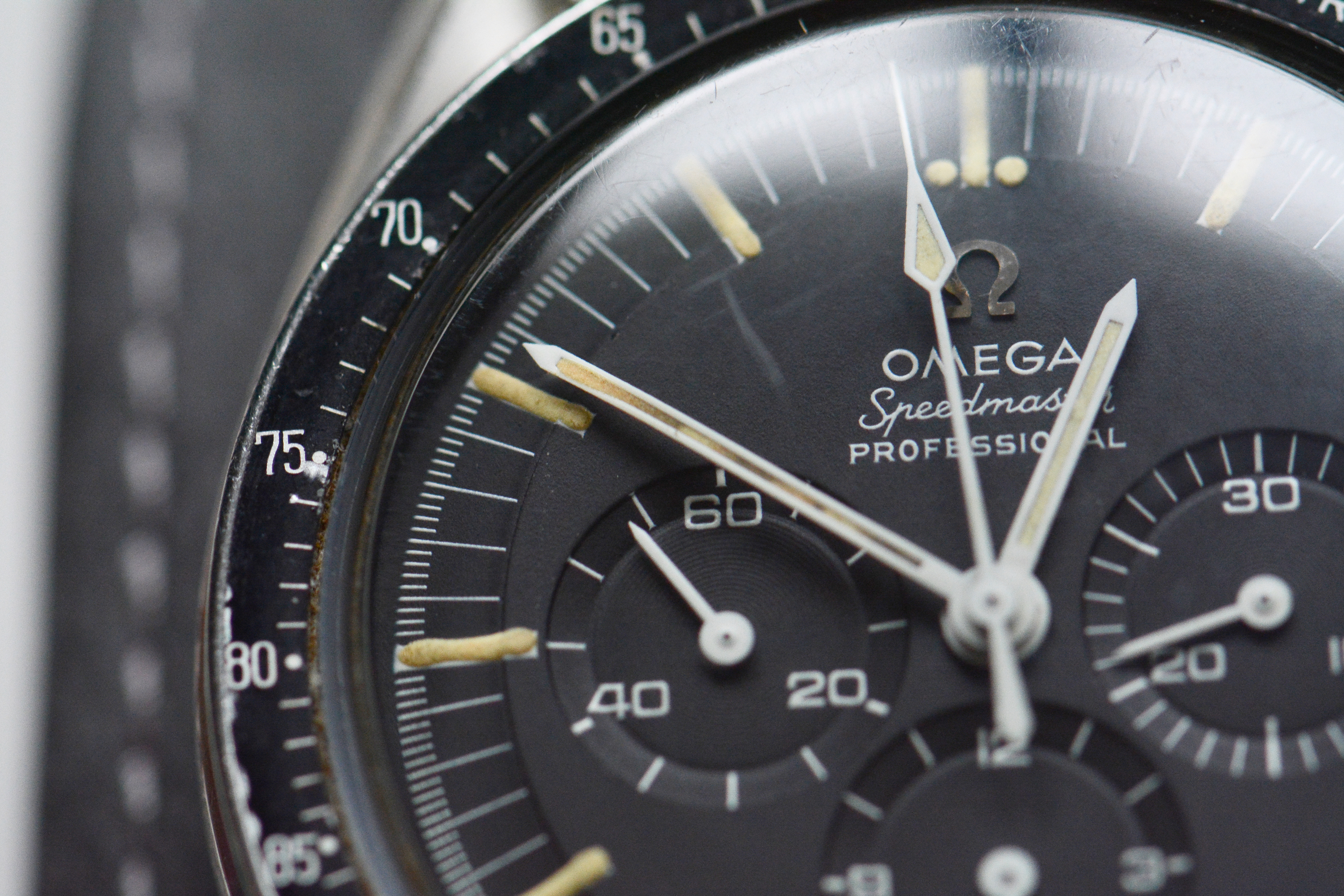

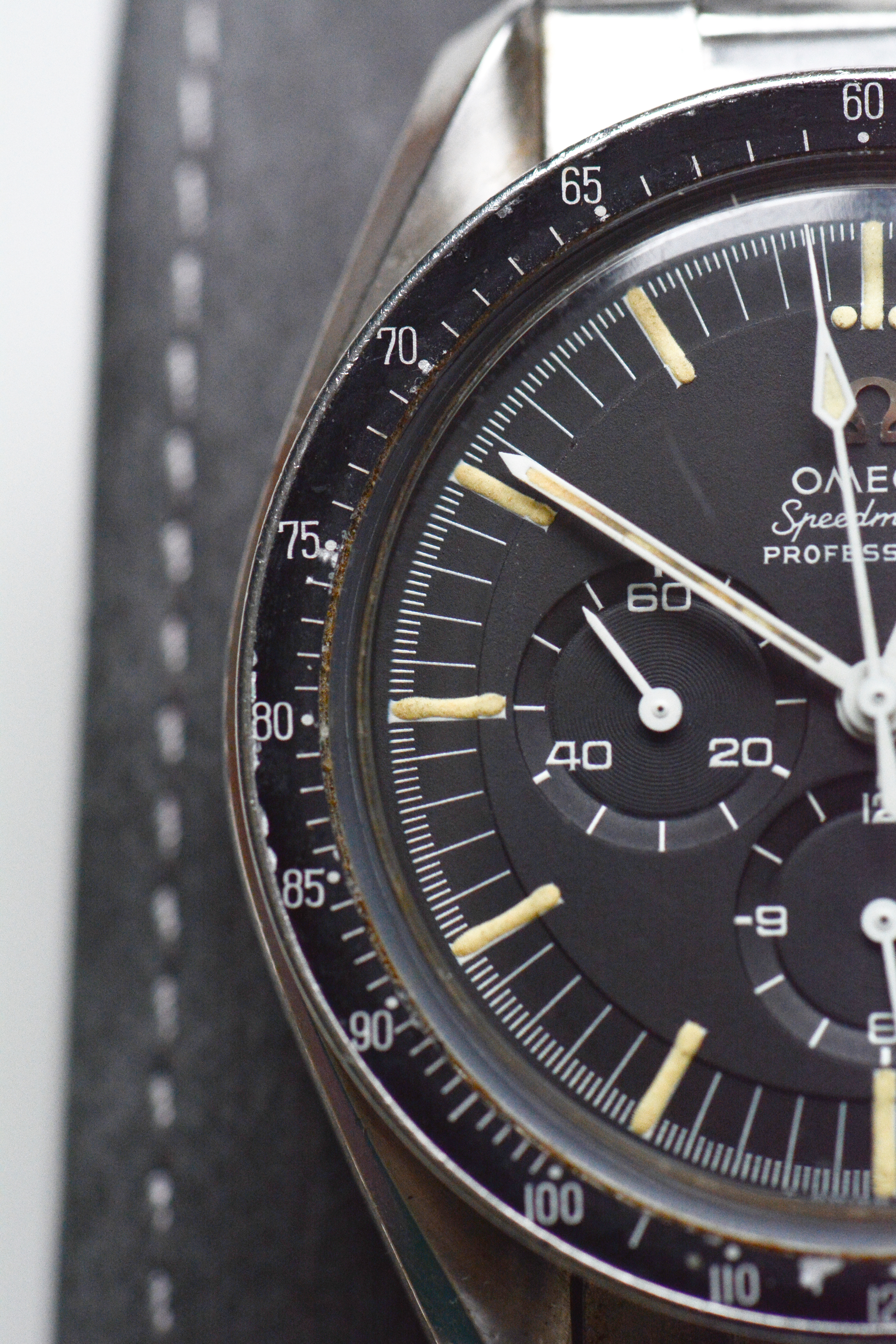

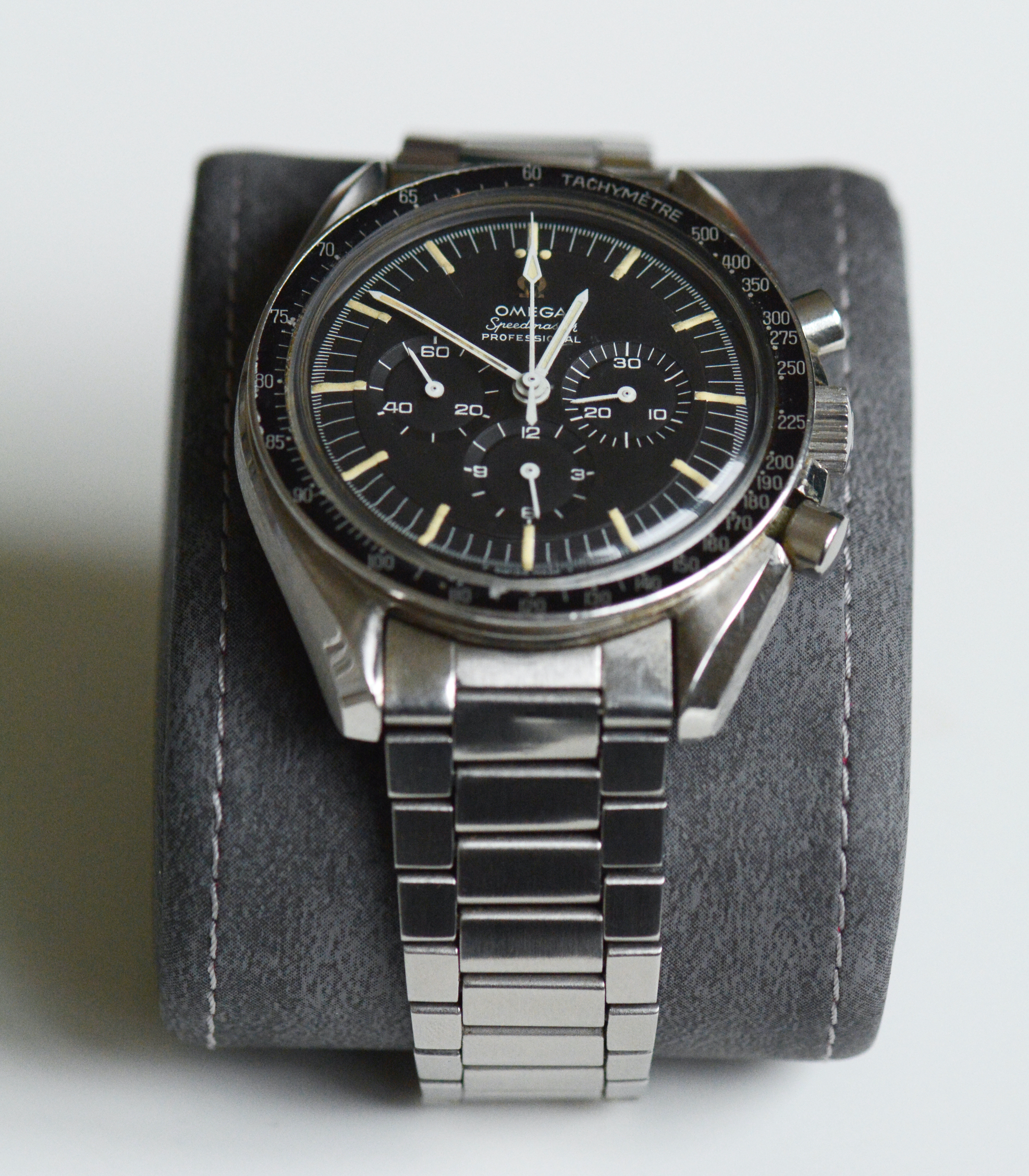

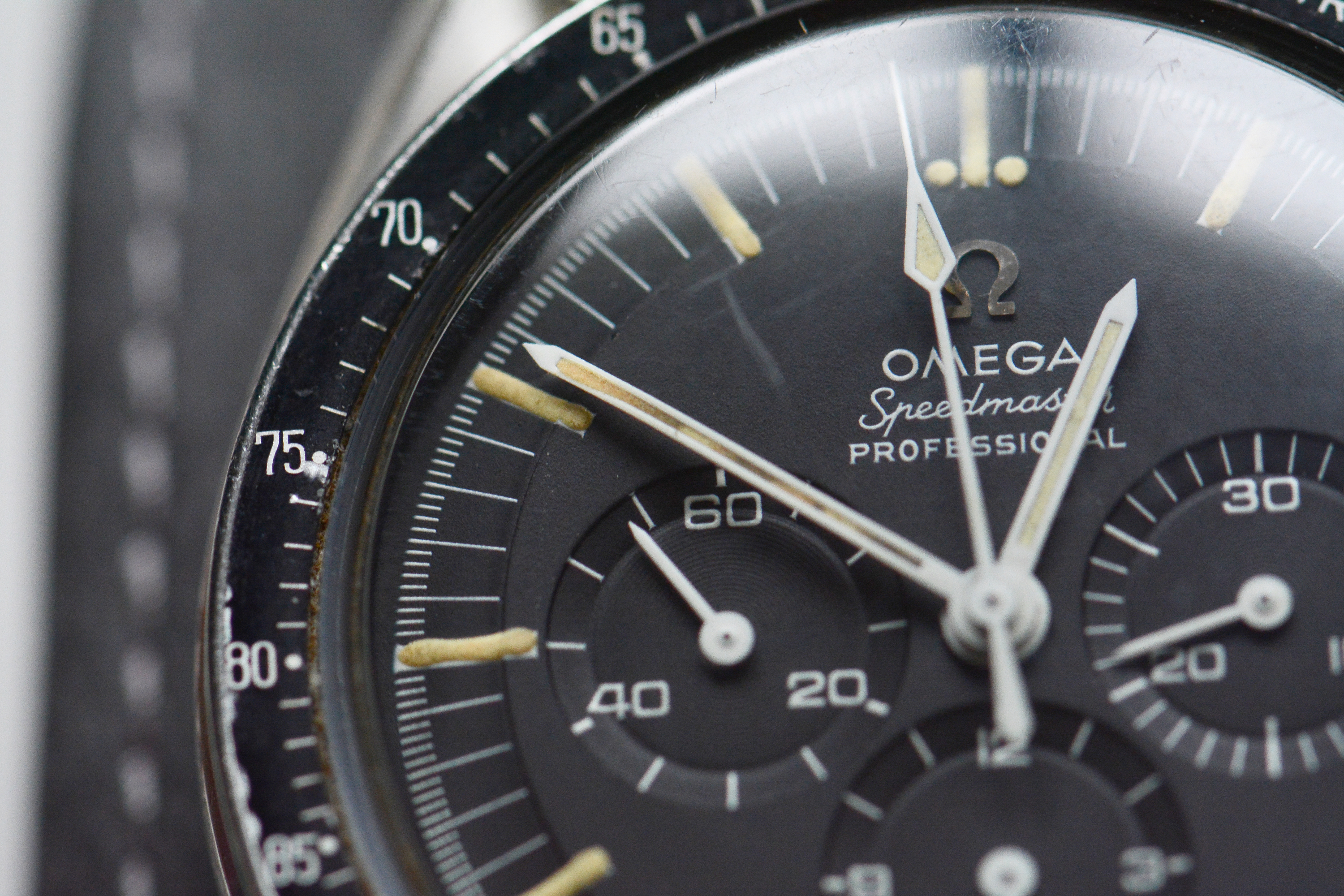

Here are the pictures of the watch after arrival:

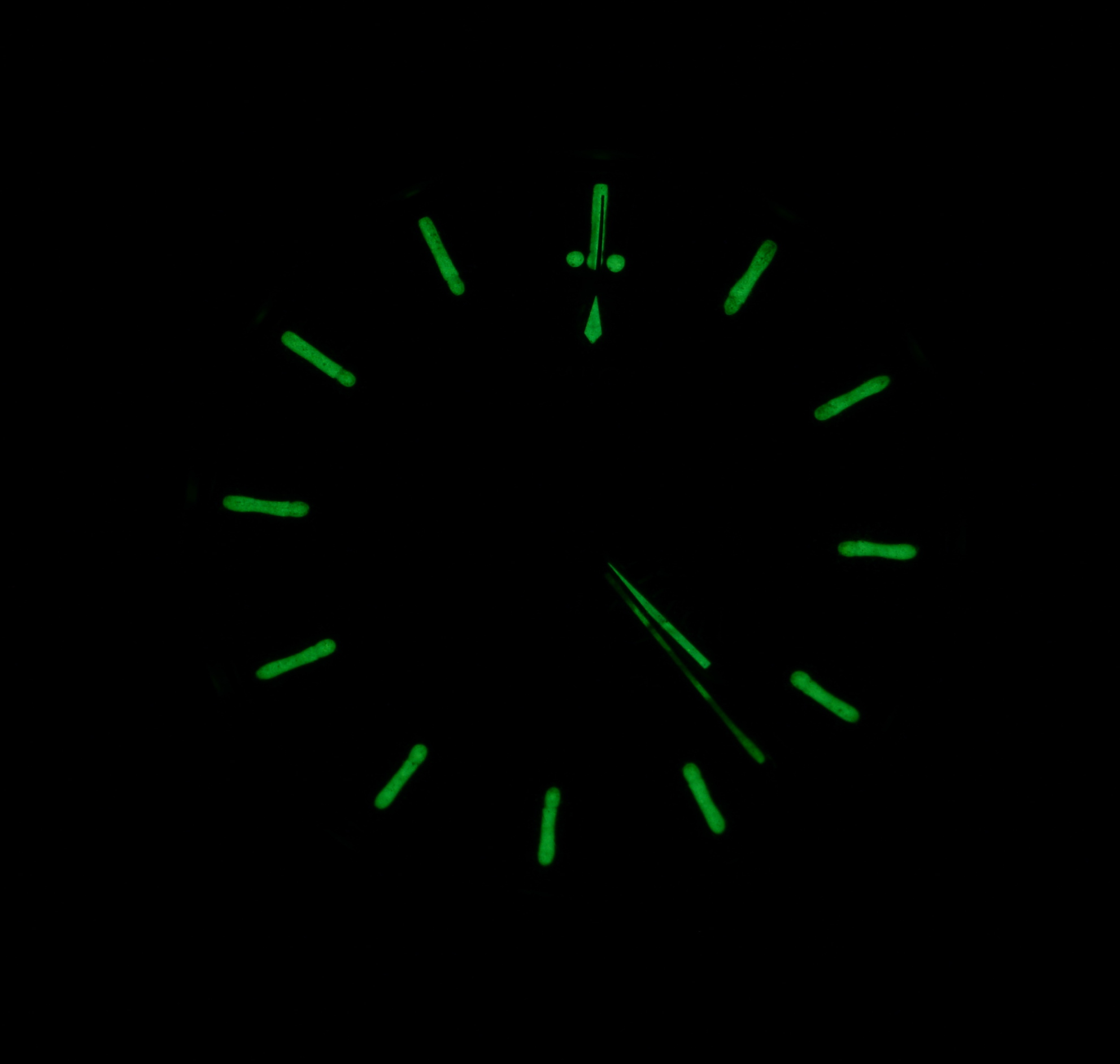

The color of the lume looks even better in real life. Under the loupe it was clear that not only the 9 o'clock marker is "wobbly" but several. They all have the same amount of dirt covering them. And thanks to @Aludic pointing out that there are no obvious traces of binding agents or other traces typically left after a lume job. And finally the UV shot removed any remaining doubts for me.

Thanks for sharing your experience and congrats on the new vintage Speedy! As someone who is new and also interested in vintage Speedmasters, I certainly appreciate threads like this one. Most importantly, it looks like you are satisfied with your decision, and it seems that you are happy with the watch's condition and appearance.
FWIW, my 145.022-69 also has slightly "wobbly" lume which is original, and it lights up just like in your lume shot so to me yours is original. I'm not experienced enough to say anything about the hand lume, but at the very least it is attractive even with some of it missing on the minute hand. I think I see what you are saying though; the chrono sweep and hour hand lume seems a bit brighter. Again, it's an attractive shade and the hands are correct and its part of your watch's story.
One question, is that a bit of dirt (or possibly some corrosion) in the 75-85 on the bezel?
Enjoy your new Speedy and thanks again for sharing. Lovely watch.
If you mean in the space between the bezel and the cristal, it's dirt to me.
1,306
5,828
Yes, I'm also positive that's only dirt. There's quite some dirt all around the case, particularly below the case. I was most concerned about a dark spot around the crown, but it was easily removed by just rubbing it with my finger. I showed pictures to my watchmaker who also thinks it's just dirt.
Sounds good then! I always worry when I see brownish/reddish flaky/dusty looking stuff on any kind of metal. Of course things get a bit distorted when you're taking macro shots.

Congratulations to the OP. My early 145.012-67 also has similar wobbly or recessed lume plots. Wear it in good health!

Are you going to keep it on the 1039? Mine is very worn and feels feeble, so I鈥檓 going to put it on an Uncle Seiko or Forstner flat link.

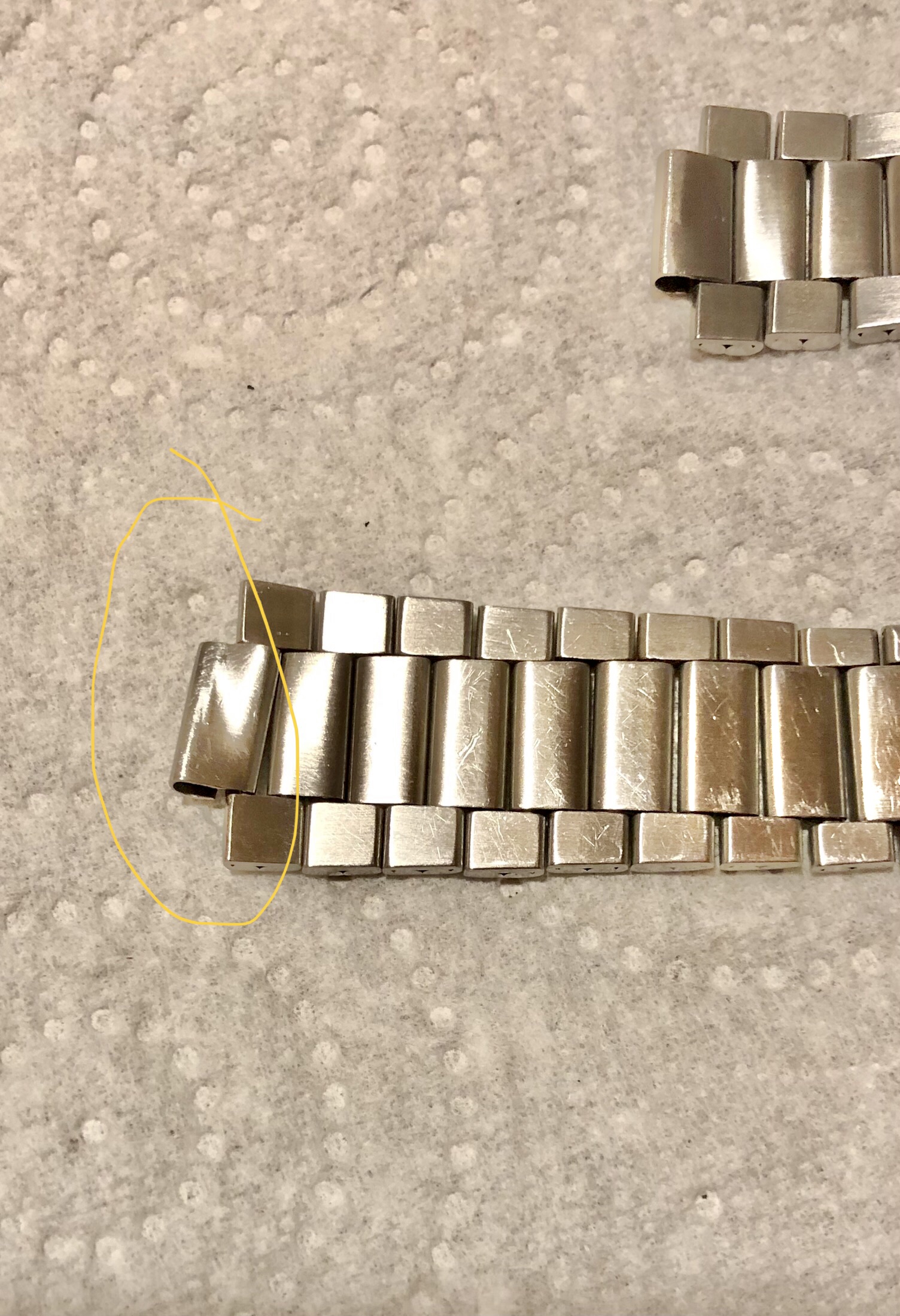

I actually haven't worn it since arrival, waiting for it to be serviced first.
As for the 1039, good question. I do intend to wear it, but need to have the link connecting the bracelet to one of the end links bent back into shape first. In in particular is twisted. Or I will have to reach out to @mcgyver to ask whether he produces the fixed links as well. In the meantime I'll probably wear on a strap. So many options there.
