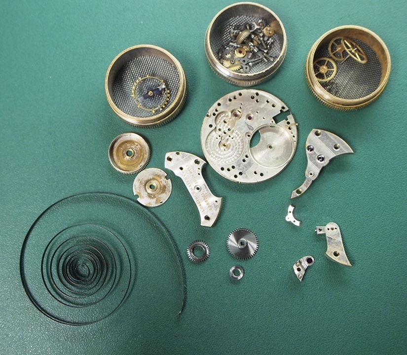

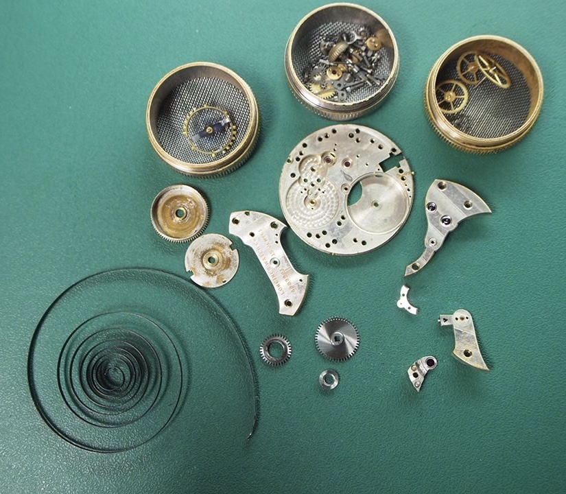

The attached picture is of a relatively simple, manual wind watch. A 90 year old Longines. Is this how far you want to get into your collection regarding cleaning of your watches? The on line training course you linked to would be useful if it happens to be that he is working on a watch that you happen to be servicing. But it will be years before you will be up to speed to do some of the watches he does! He makes the repair of watches seem very simple. But for a newbie, repairing watches is not that simple! I think you need a training course that is a whole lot more basic than the one he gives. And I would seriously recommend that you build up to servicing the watches in your collection that you wish to retain. Newbies make all kinds of mistakes, and wreck lots of parts. So if servicing your own stuff is how you plan on saving money, I suggest you start on scrap watches that don’t matter. And plan on spending much moolah on materials and equipment.
