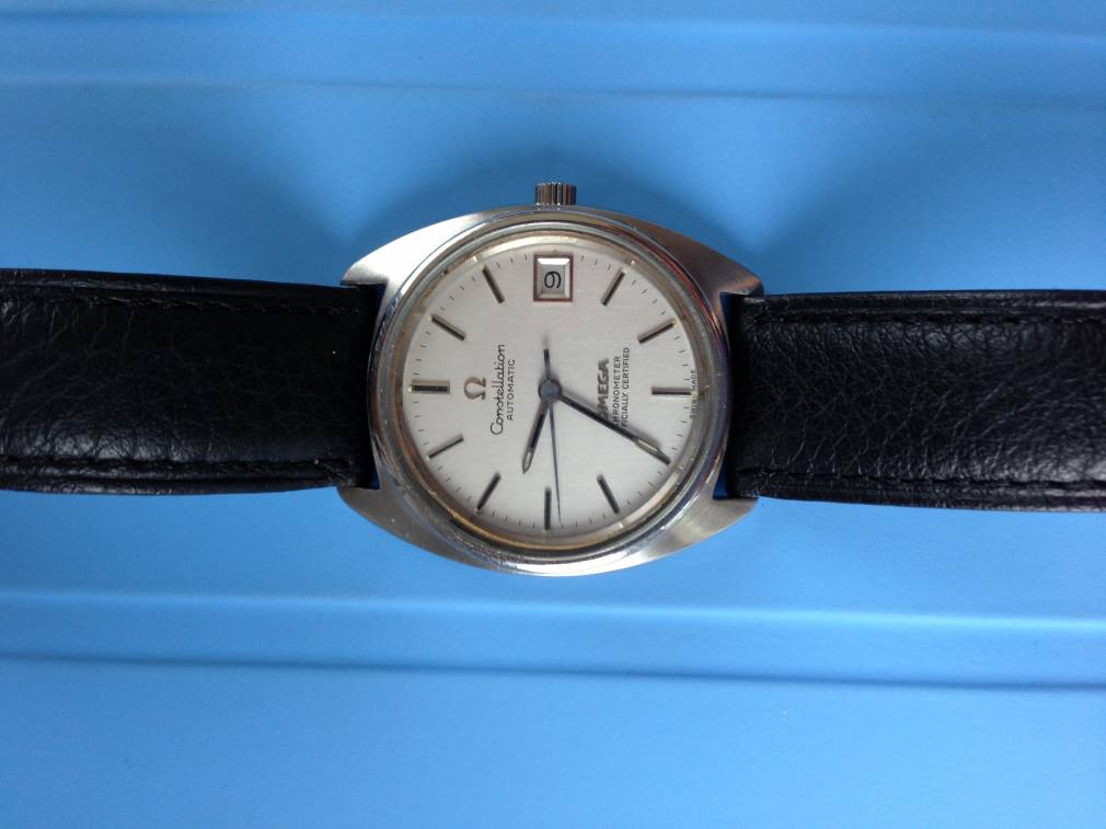

    I love my '73 Connie, (which for the eagle eyed is resting on my iPad cover) but I'm not going to be wearing it every day, probably 3 days a weeks and not necessarily consecutively. What I'm not sure about is whether it is better to try and keep the watch running (in which case I'd probably need a winder) or whether it is perfectly okay for it to stop and be wound as and when required. It's possible but unlikely that it could be left for up to a week or two without wearing, and I'm hoping that wouldn't cause the movement any problems.
    I know the watch was serviced when I was given it as a birthday gift from colleagues at the end of January this year, given the usage as described above, how long before it should be serviced again?
    I appreciate any input you learned collectors can give me.

    It is perfectly OK to let it stop between wearing. To steal an oft used analogy, "I turn my car off too when I'm not driving".
    Seriously, it will not hurt it at all and in fact you are only adding wear keeping it on the winder. The convenience is of course it is ready to wear and go at moments notice. With date watches this makes it simple.

    Sure you had your connie only sitting on the pad for a short while but I have read that prolonged contact can lead to irregular timekeeping - an urban myth ?

    72
    37
    Sorry I may have given the wrong impression when I mentioned the iPad cover. The iPad was detached from it at the time of taking the photo. Thank you for pointing it out though.

    With the longer life of modern lubricants, you should be able to go 5 - 8 years before your next service. If your watch starts keeping erratic time then you know it's asking for a cleaning & lubrication.
    And keep your watch away from any magnetic source. I've heard of watches getting magnetized from repeatedly sitting on an iPhone overnight.

    I think the problem with the iPad cover is the magnets that they contain. It's how they attach to the iPad and also stay closed. Exposing a mechanical watch to these magnets can result in the watch becoming magnetised. I would not place any watch on a iPad cover.
