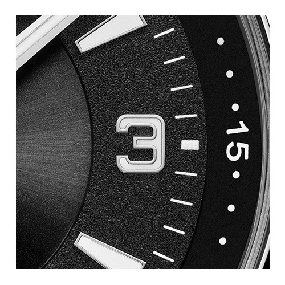

I am really surprised this is that complicated. Funny thing is, this makes things even more interesting to me imo.
A lot of the recent dials like the new Aquaterras or the JLC Polaris must use very specialized equipment to get the mutile textures, etc.
In 50 years collectors are going to have a hard time reproducing or redialing these types of dials 😉

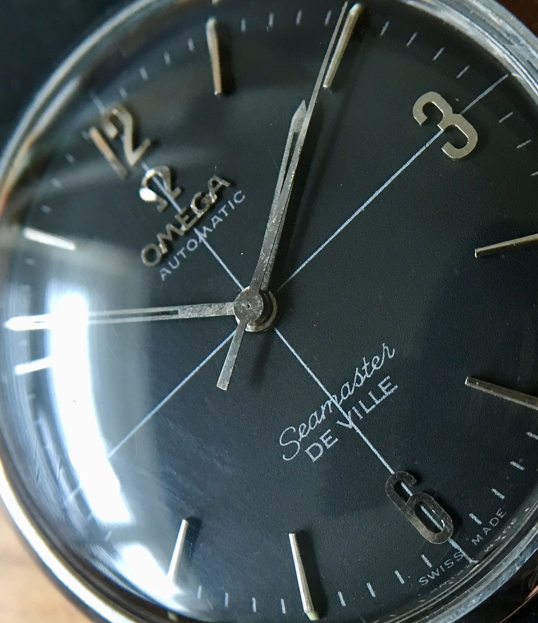

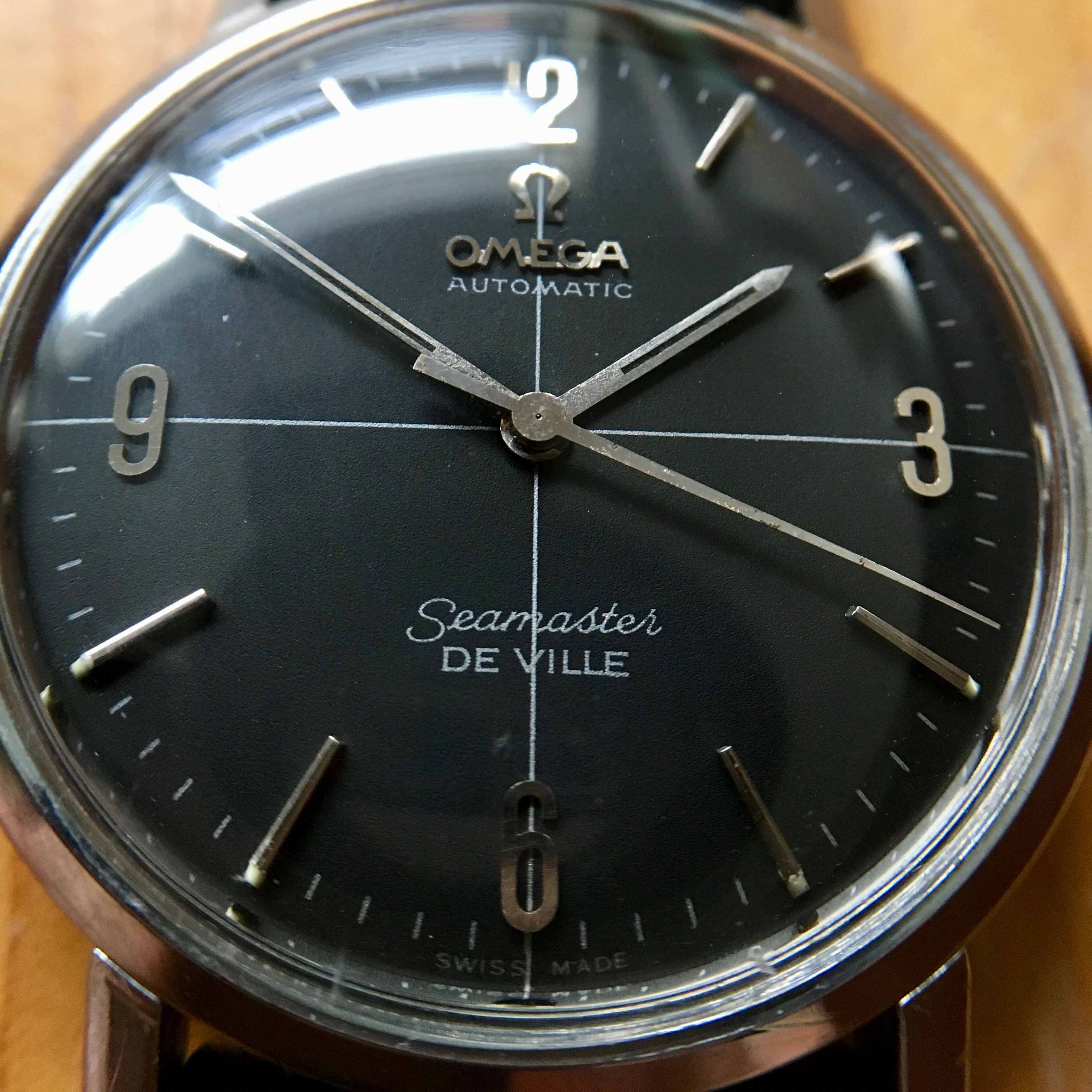

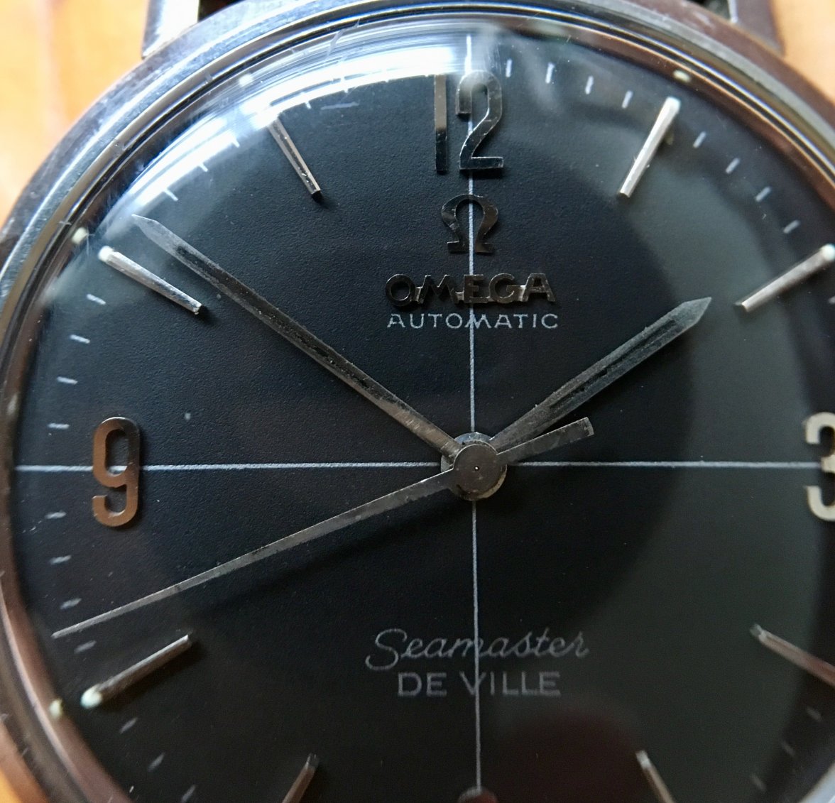

The refinished dial is back from Dial Craft. Overall, I’m pleasantly surprised with how it turned out. This was somewhat of a custom job as I don’t believe this dial variation existed (black dial with Roman numerals and crosshairs). The crosshairs are a bit thick and there are some minor alignment issues that are visible when looking at macro photos but the watch looks quite nice on the wrist.

Sorry, cross hairs are a mess.
They look fuzzy, but we're looking at them at nearly 10x magnification. Maybe a wrist shot would bring us peace of mind, @Vanallard ?

I'll post a wrist shot in a few hours. I would agree with you, macro photos tend to highlight even the slightest imperfection. This could have turned out so much worse.

It's good... the question is not whether it's better than an original dial on a watch that's been living in a safe deposit box for 50 years, the question is whether it's better than what was there before and looks good on the wrist.

next time , you use them, tell them to print in white. not silver. and center the swiss made. kind regards. achim

Swiss Made is positioned correctly. The centered version is one of the classic redial giveaways 😉

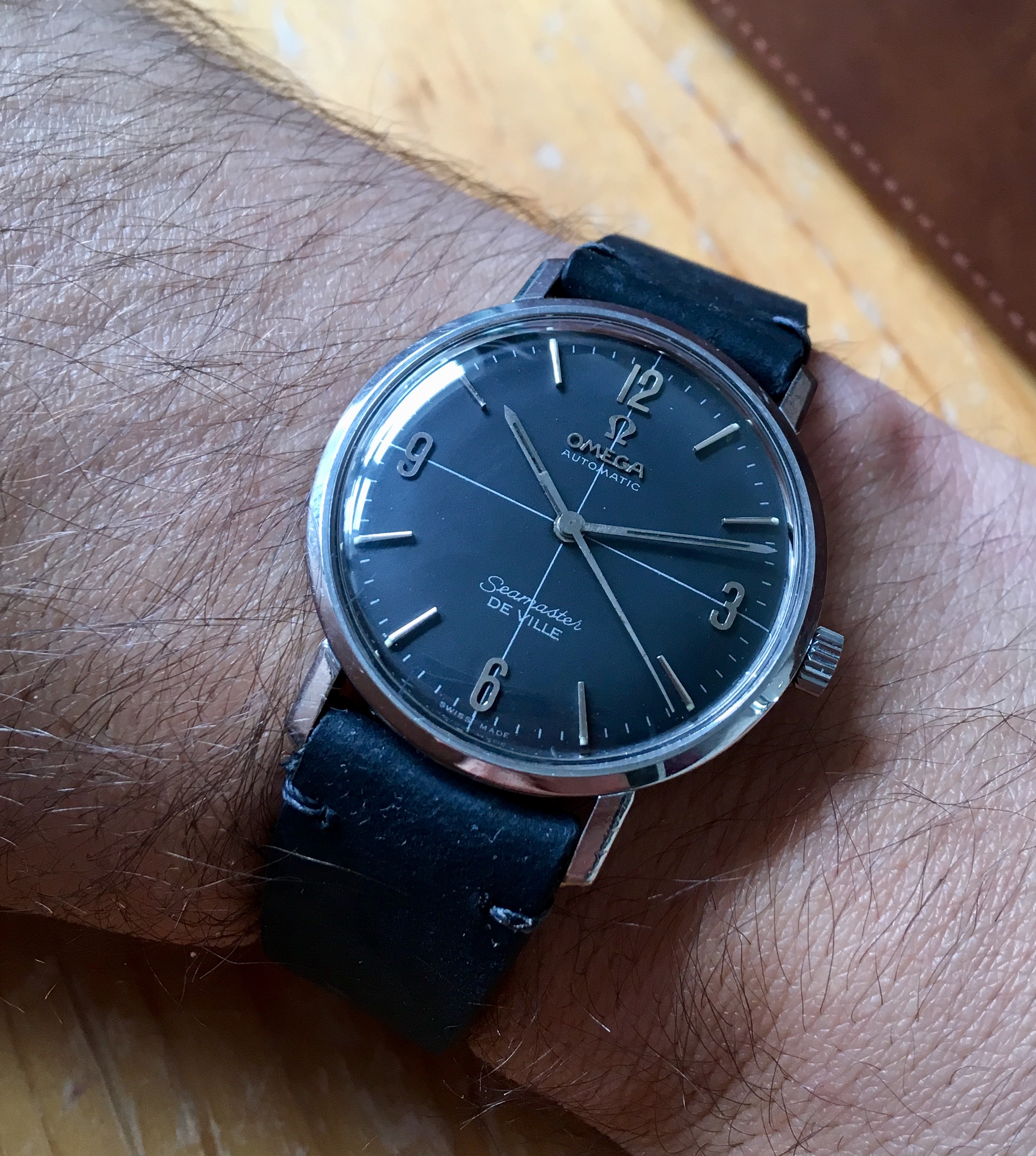

Wrist shot
Nice. I wouldn't mind that watch on my wrist.

Same! I bought the watch with the intention of giving it to my sister after having the dial refinished but I’m tempted to keep it for myself 😁
