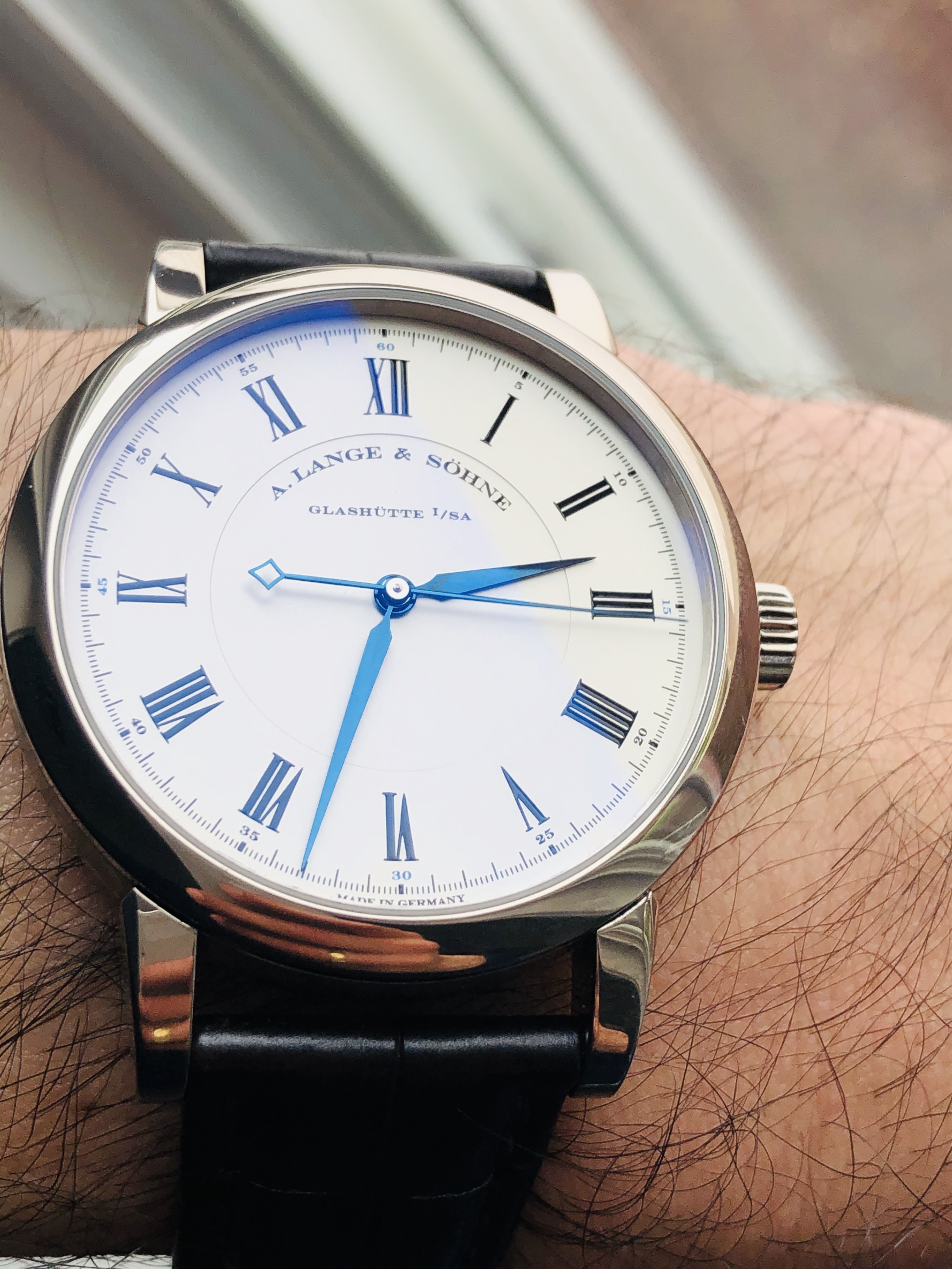

And you pointed out one thing that I absolutely love about Lange: that durable feel. These things feel like they can stop a bullet. Part of the reason why I went in this direction:

That is a stunner! The Richard Lange collection is amazing (as are the 1815 chronograph and Dato lines). Those three collections are always worth a deep consideration and opening of the wallet.

To me, this boutique edition white gold Richard Lange with those exquisite blue hands is just spectacular. Elegant simplicity, beautifully executed.
The only other Lange that I would want now would be the Zeitwerk, which is at the opposite end of the aesthetic spectrum.

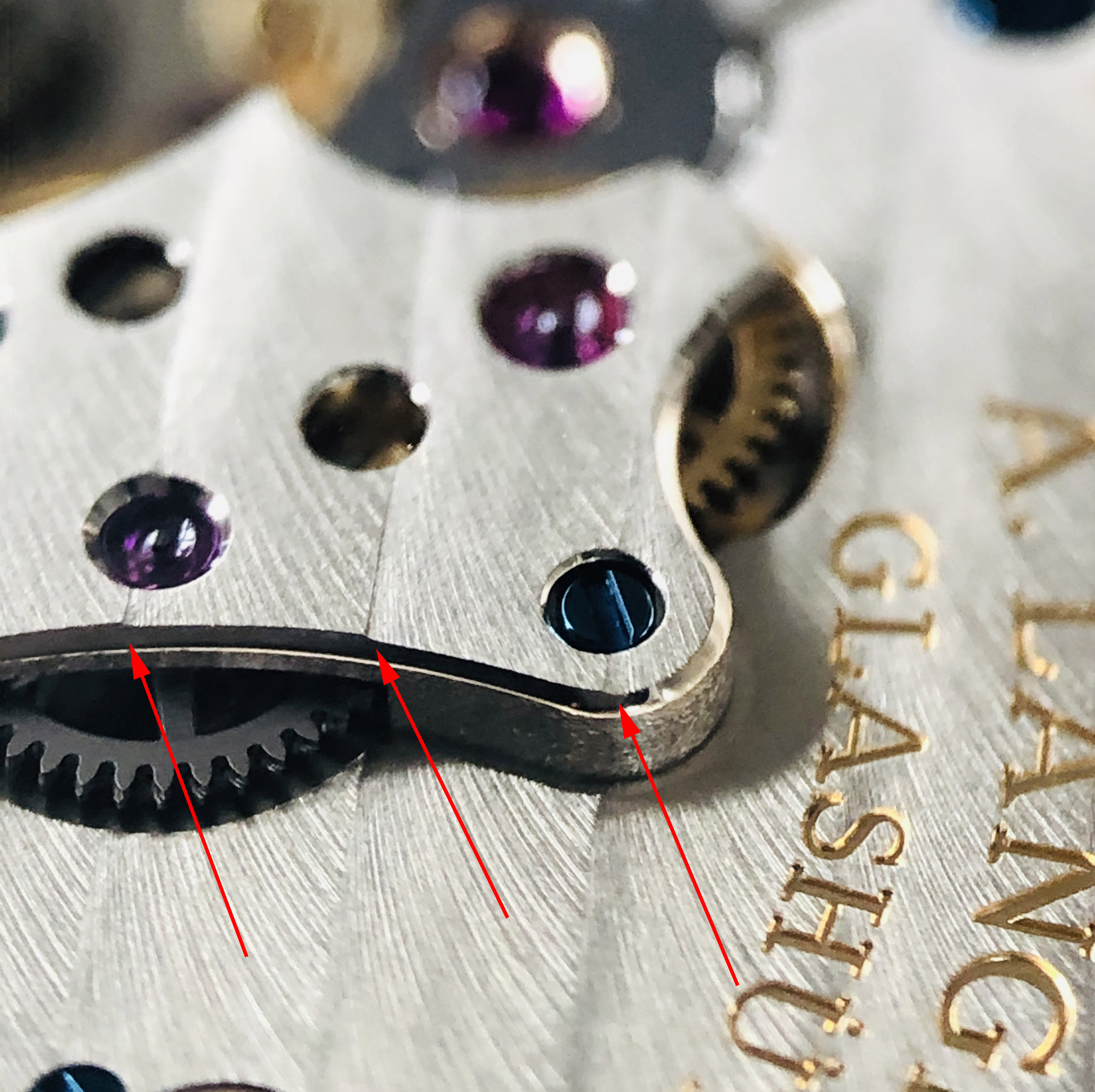

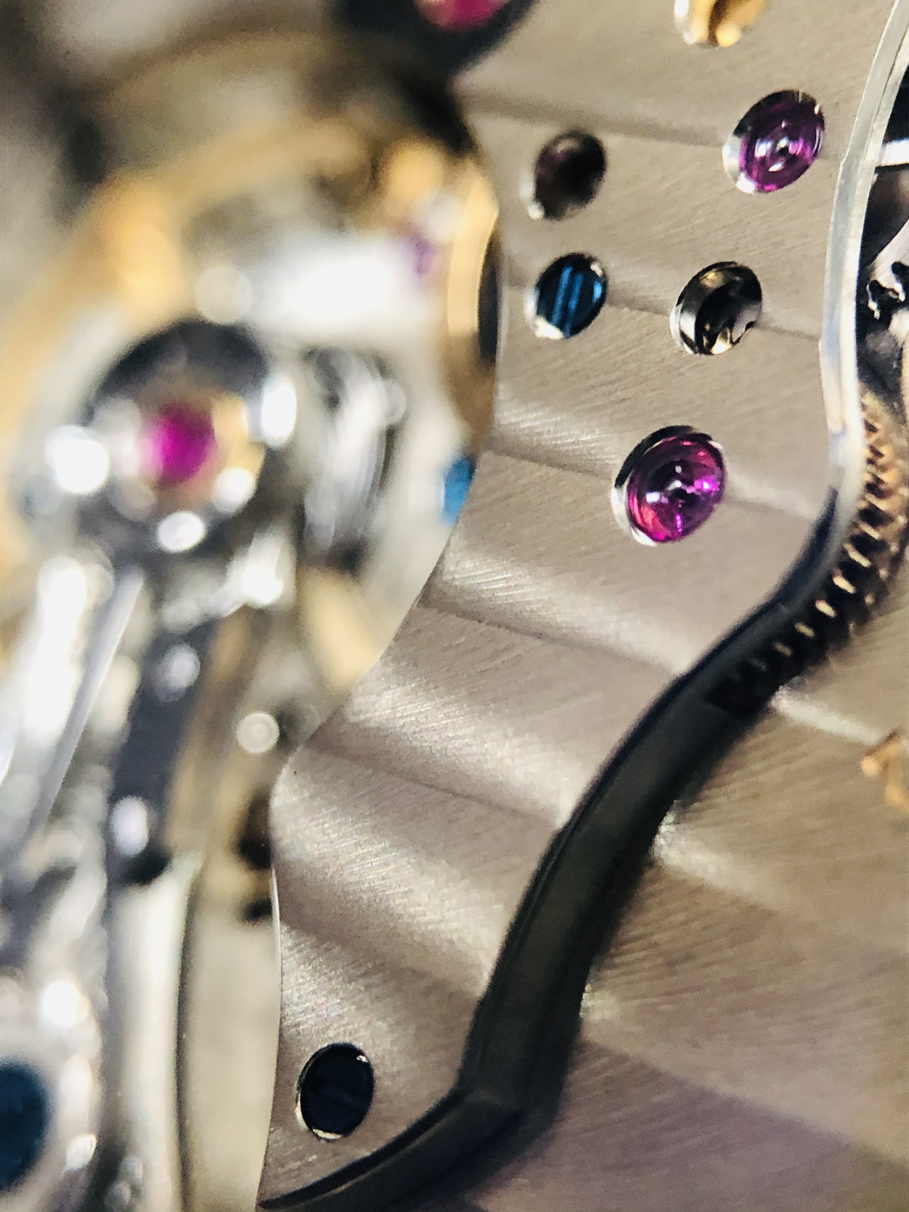

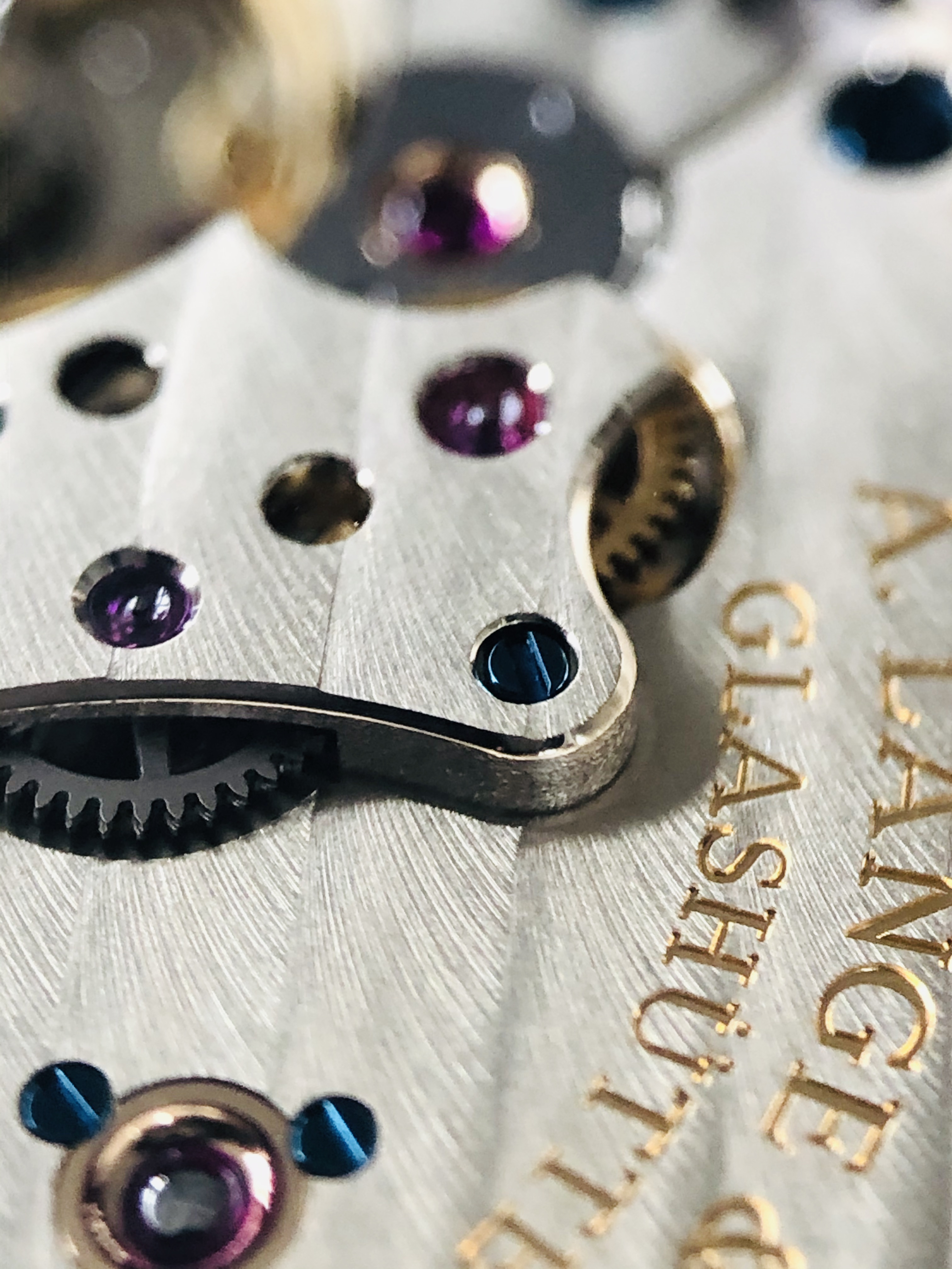

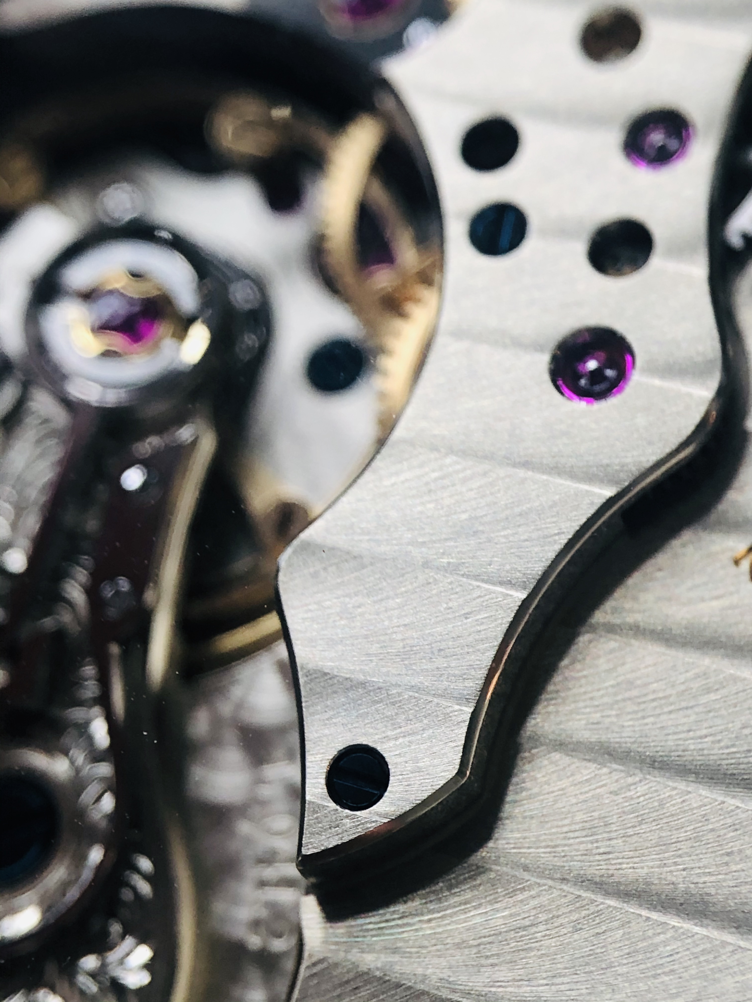

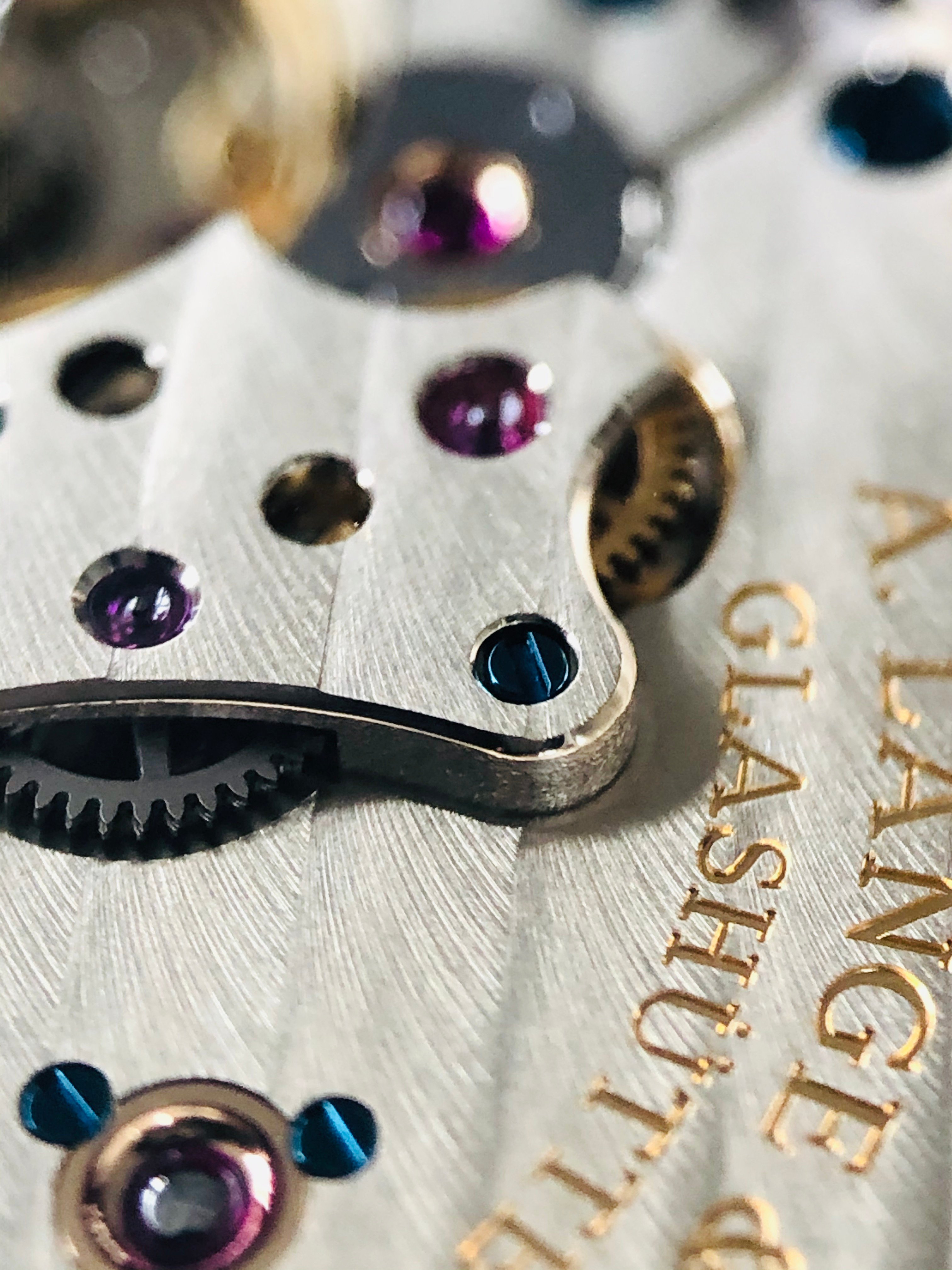

Functional? No not really. Aesthetic? Yes, if you know what to look for, you can't "unsee" it when it's there.
Not picking on anyone's watch here (it's a lovely watch as an overall package, and one that I would be happy to own), but just to illustrate the point from one of the above photos...
The most perfectly executed stripes are done in a way that the stripes can be seen, but if you were to rub your finger across them, the surface would feel perfectly flat. That is how Mr. Dufour executes his Côtes de Genève for example. Here there are very obvious peaks and troughs made in the material, so it is a sure sign of the manner in which this was done. This goes to the idea that ALS takes no short cuts - this is most certainly a short cut in the sense that doing these using the traditional methods is very time comsuming, and requires detailed set-ups of the angles on the machine that Mr. Dufour uses. He charges the ebony cupped disk with abrasive powder and lavender oil, and manually moves the work under the spindle so that the eveness of the circular marks in the finish are directly impacted by how evenly he moves the work. It's not completely by "hand" but there is an element of hand work involved that takes time and dedication to master.
These are made on an automated machine that indexes the work for each stripe, and moves the work under the spindle (that again has some abrasive paper attached to it) using a slide and ball screw - only hand work is loading and unodaing the parts. The result still looks good, but again it can be distinguished by the physical waves created from the rather severe angles used between the spindle and work. This is a common method of finishing watch bridges with Côtes de Genève, and can be found from ALS to JLC, all the way down to the ETA 6497's I buy in bulk for a couple of hundred dollars each.
There are a number of ways to make these stripes, but at the highest level of work, they are very fine and they are just on the surface.
Cheers, Al
