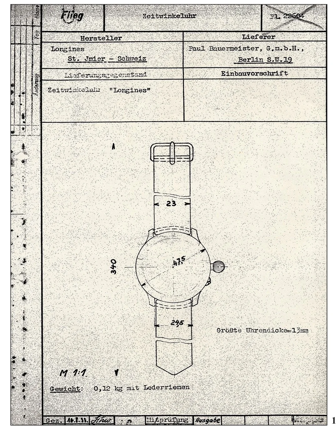

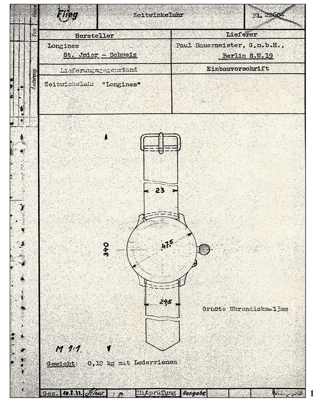

In 1933 the technical department of the German Aviation Ministry (RLM: Reichs-Luftfahrtministerium) tested the hour angle watch of Longines based on developments by Weems and Lindbergh.
See the att. spec Luftwaffe document of the 'Zeitwinkeluhr' with 180° dial and 47,5 mm diameter (Fl 22604 of 1933) imported by Paul Baumeister Berlin.

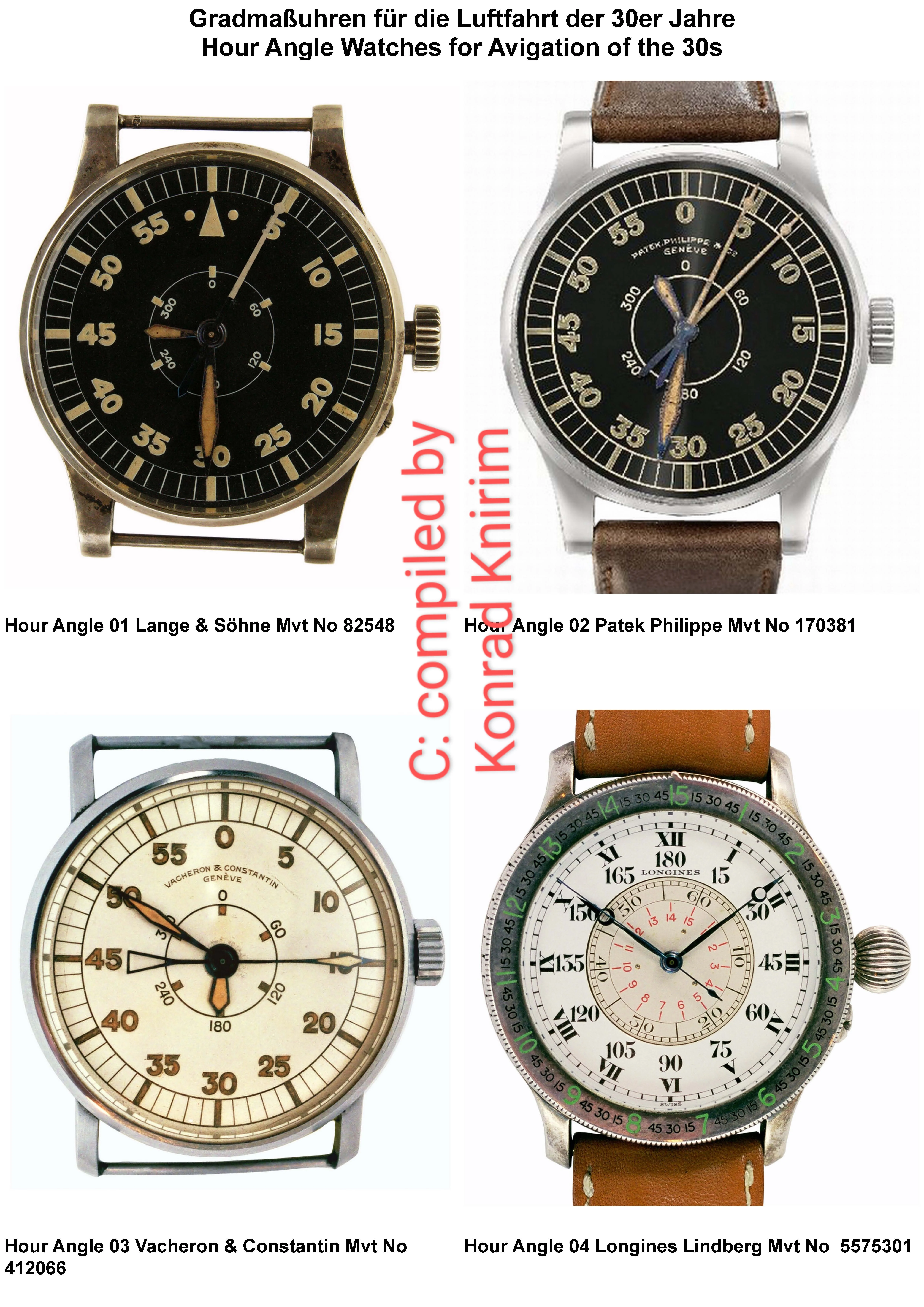

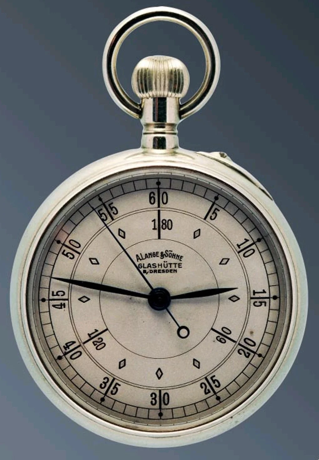

So in 1934 they gave orders for prototype wrist watch developments directly to A. Lange & Söhne and additionally by private importers to two Swiss manufacturers Patek Philippe and Vacheron & Constantin.
These three companies should develop two alternative models, one standard hour angle watch and one with addional rattrapante ‚second‘ hand.
A. Lange & Söhne shipped the first watch in silver case early in 1935.
Description of function:
The little hand makes 360 degrees in twenty-four hours, the big hand shows the angle minutes, the ‚second‘ hand rotates in 4 min.
See attached the Luftwaffe spec sheet for the Longines and the standard prototypes of the three manufacturers. The prototypes with the additional 4 min hand do exist and the Patek Philippe from 1936 was sold by Cristie's in 2009 for 1,8 mCHF.

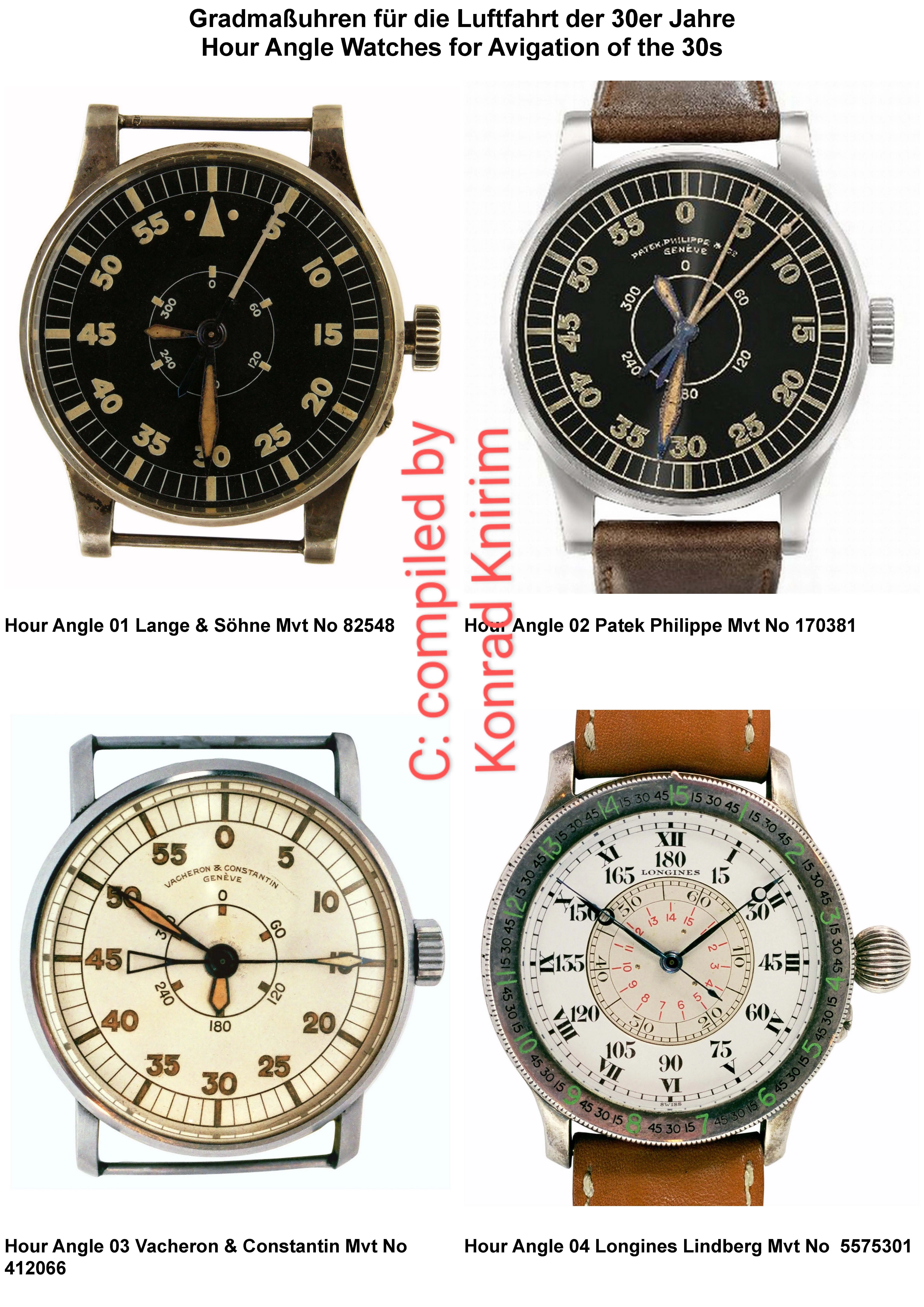

Thank you Konrad @kfranzk ,
for this very interesting information. So the dial lay-out ( minutes on the outside ring etc ) chosen by the RLM was based on the Longines watch and later put into the delivery specifications for manufacturers ?

@kfranzk So the dial lay-out ( minutes on the outside ring etc ) chosen by the RLM was based on the Longines watch and later put into the delivery specifications for manufacturers ?
Thats what is obvious. There were long discussions together with the Deutsche Seewarte (the German Naval Observatory in Hamburg), for ships chronometers as well, even to use 400° dials, at least this design with 360° lead to prototype developments of the Luftwaffe and for the Kriegsmarine with 180° dials. As a lot of tables, manuals and trainings would have to be changed, at least the start of WWII endet these developments and standard dial design was used.

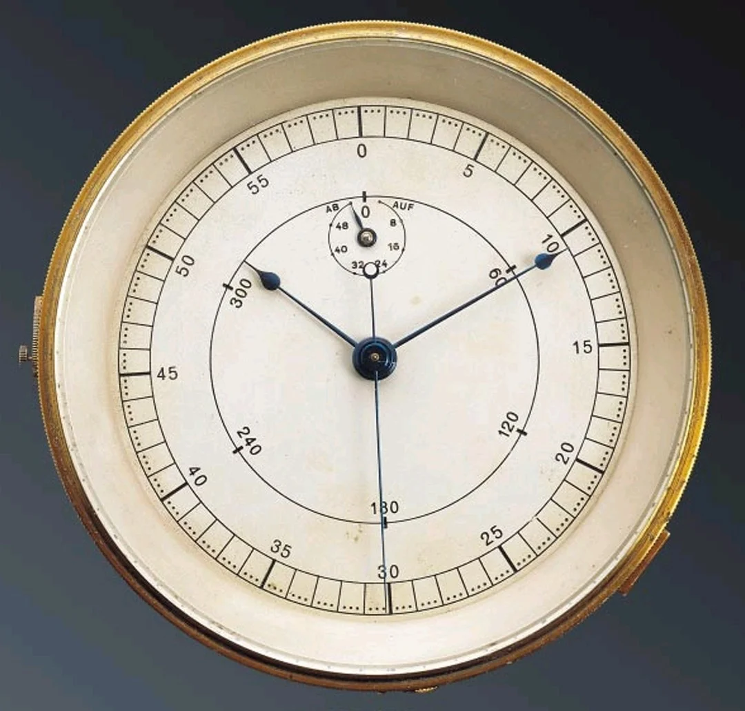

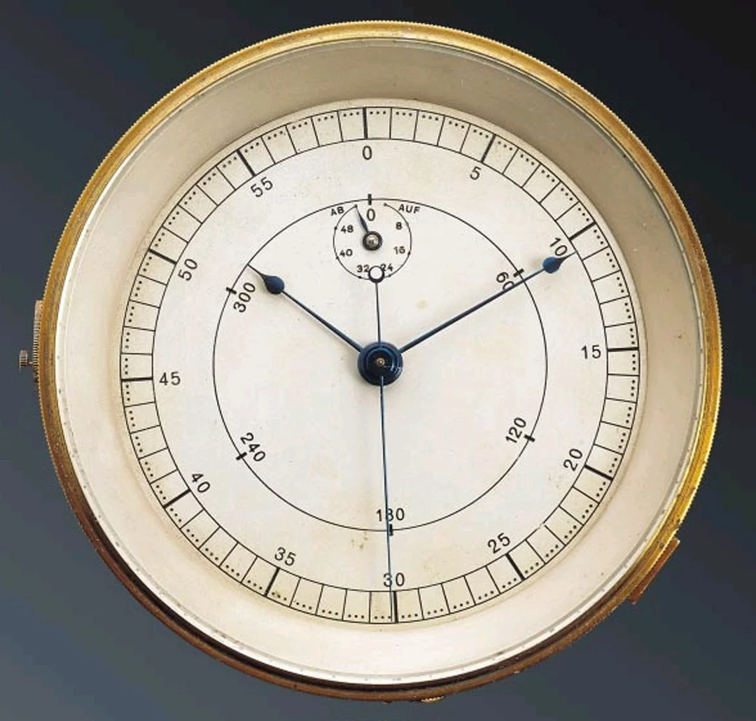

Hour angle watch Kriegsmarine:

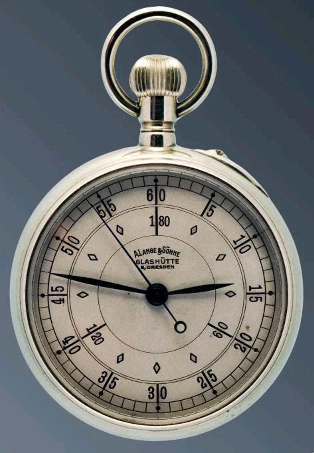

Hour angle chronometer Luftwaffe:

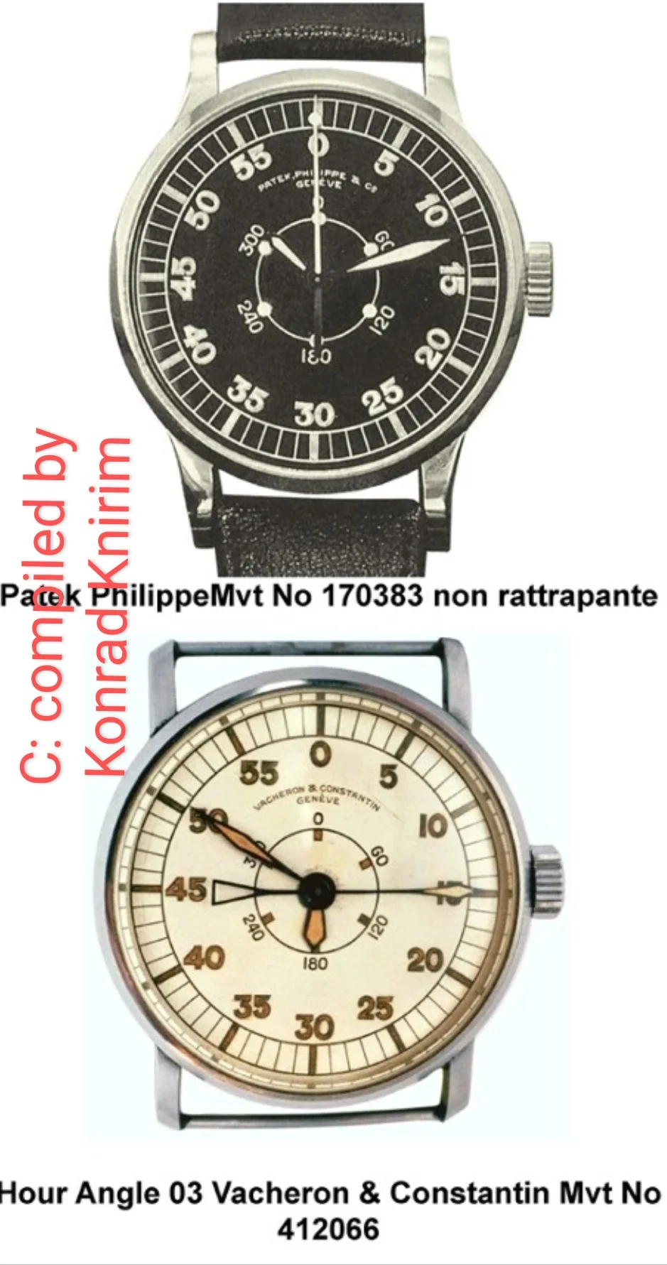

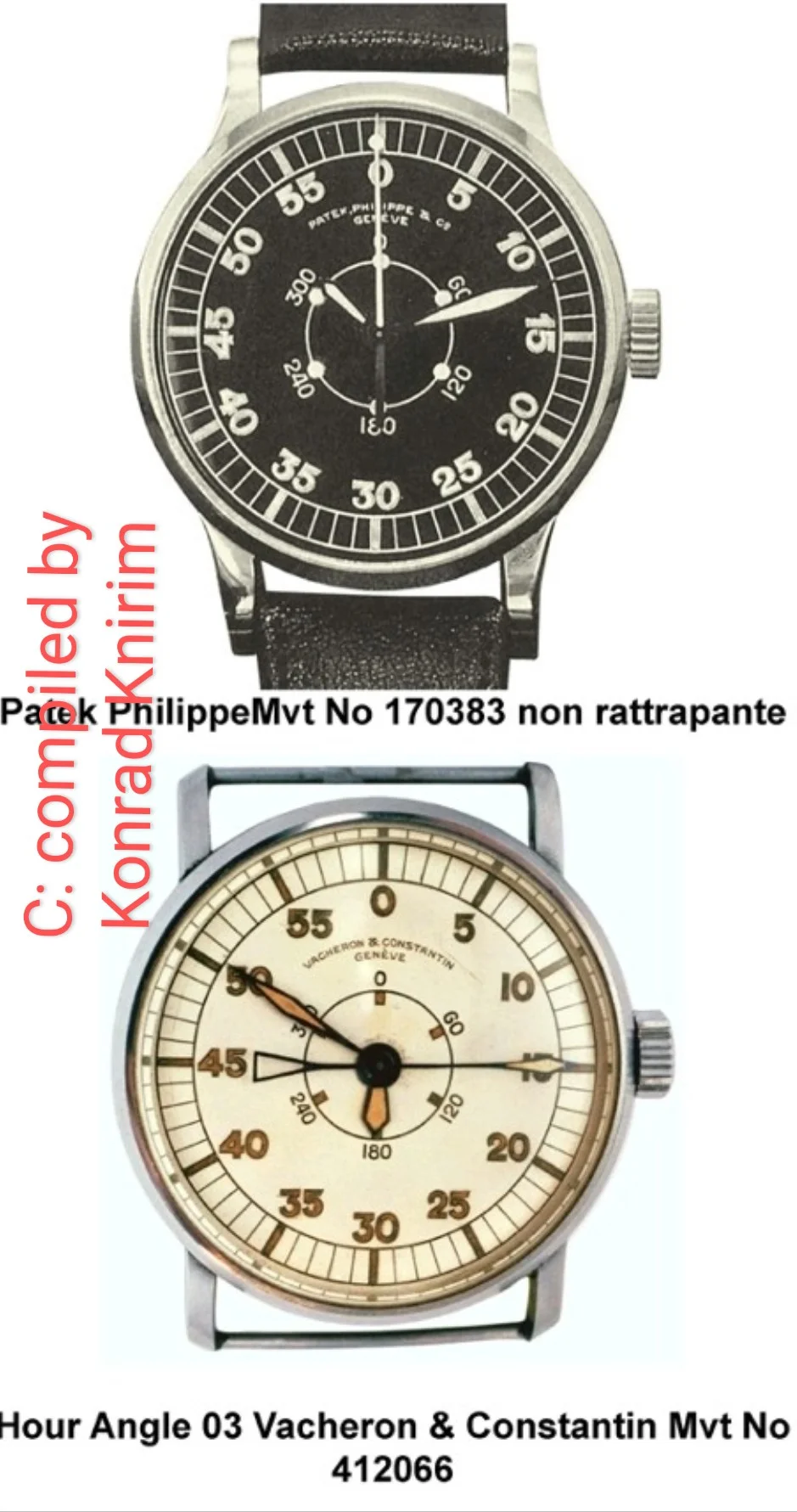

Hallo friends,
I have no contact to the Patek Philippe archive and my good relations to Vacheron & Constantin were cut, as Richemont took over.
But maybe someone here can get the information:
  • To whom did Patek Philippe deliver the watch with the movement no 170.383?
  • To whom did Vacheron & Constantin deliver the watch with the movement no 412.066?
It was in or around 1936, though the movements were produced far earlier, and I expect a German importer.
Konrad

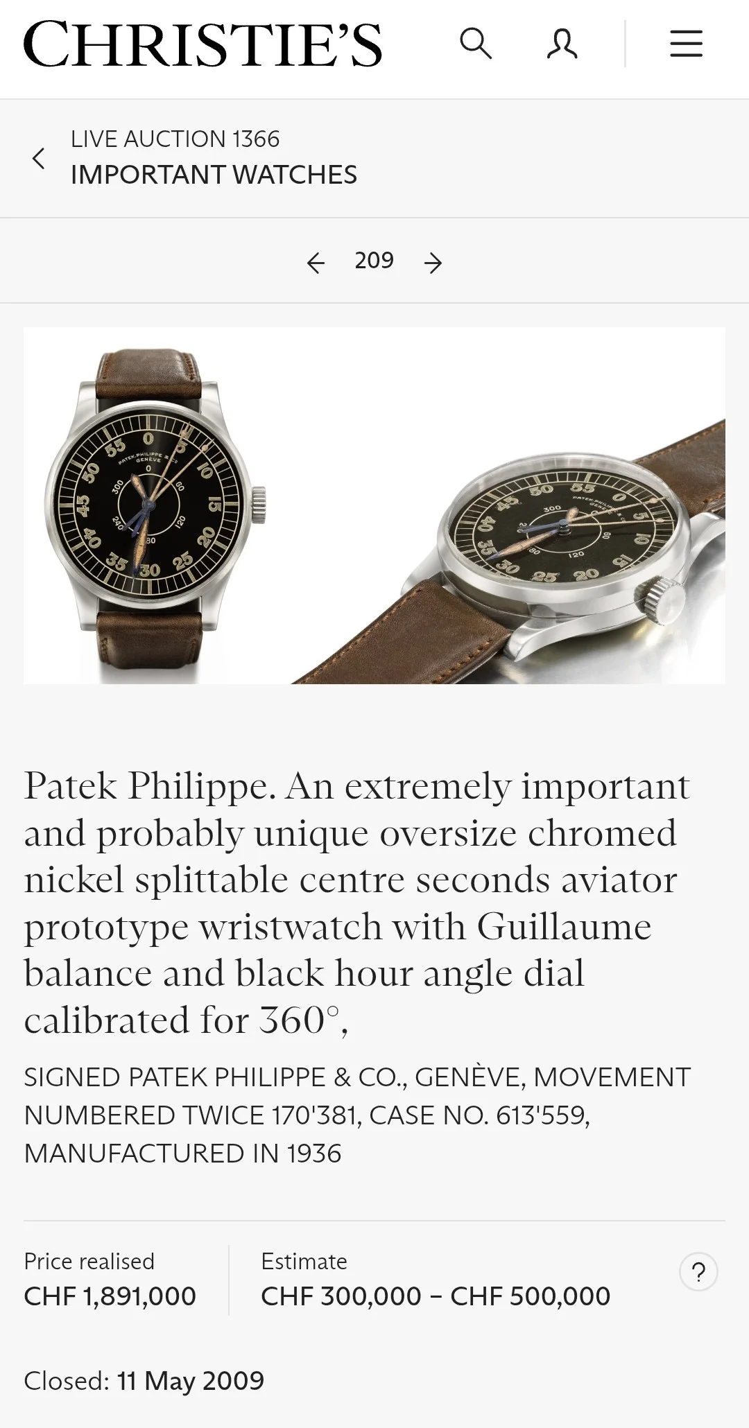

I add the sale in 2009 of the Patek Philippe by Christies for 1.89 mio CHF, see case and mvt.-no:
