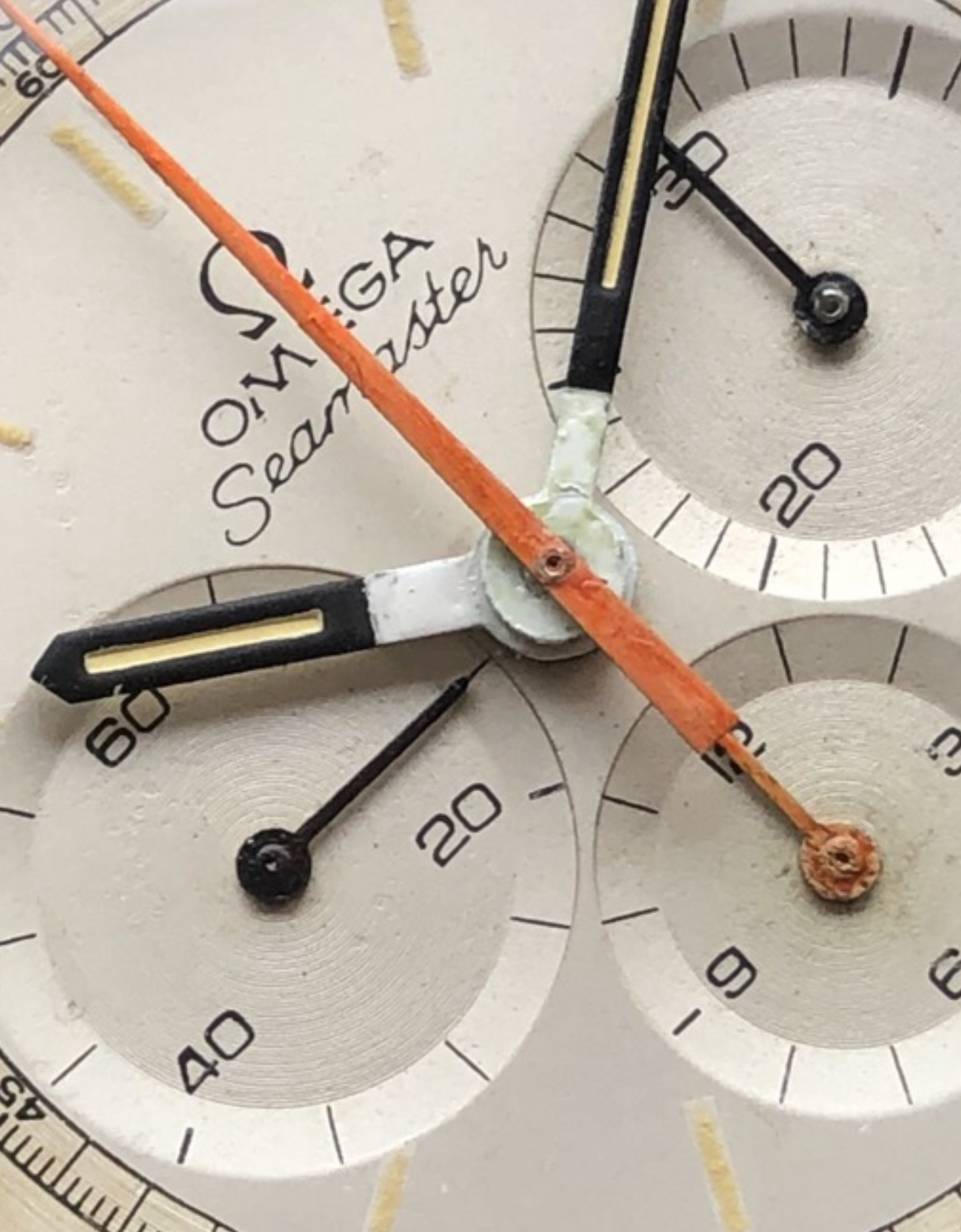

Landed a (special) Vintage Seamaster Chronograph
13,668
19,037

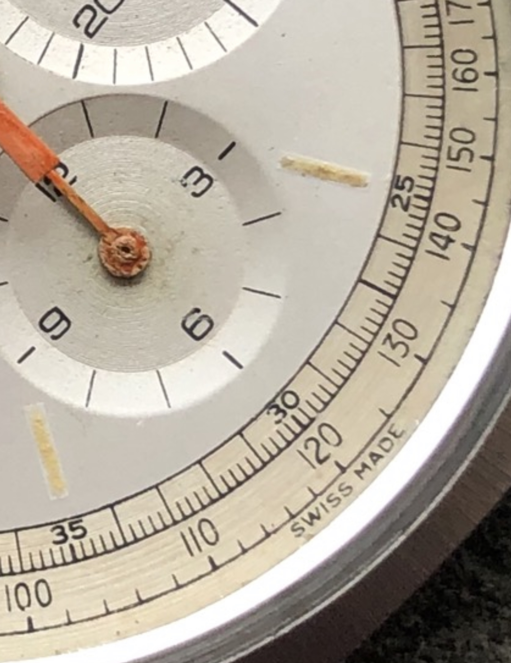

You mean a new dial configuration than the original one?
Yes.
you wipe everything but you don’t change the size of the subdials, do you?
Not on a dial like that. However, a good redial company might have several dies that can recreate a similar look, but they may never have been used together. A quick (but not definitive) look at other Omega cal. 861 chronographs show that the Omega versions tend to have only one specialty register outside of the hour markers. Either Tachymetre, Pulsations or numbered seconds, but not a combination. Please see your research thread: https://omegaforums.net/threads/145-006-145-016-seamaster-chronograph-research-thread.77145/.
It is possible that a die for the multiple outside registers was used by a related brand, but I haven't seen an Omega that uses such a combination. Plenty more to look at here: https://www.google.com/search?q=Omega 861 chronograph 145.016&source=lnms&tbm=isch&sa=X&ved=2ahUKEwj0l-GfuL3mAhWyV98KHTmqBqkQ_AUoAnoECAsQBA&biw=1920&bih=937

Interesting.
A quick look will only allow to compare with models that made it into production. No surprise if nothing comparable shows up, the outcome is in line with my sample theory so far.
My next step will be to bring it to Omega and see what they think 😀 Will for sure share the news, whatever they are 😉

I like putting something up and getting these guys to analyze any faults. I’ve done it once or twice. Either way imo that is an excellent looking watch that is a great addition to the box.
13,668
19,037
IMO, that is not a "prototype". But that is just my opinion.
I've not seen a single example of this reference without raised hour markers of some kind.
gatorcpa
2,519
17,845
Hmm...
I want to be okay with it
but I can’t. I don’t think that’s factory.
Just my, not in-hand, opinion. I’m less knowledgeable than many who have already weighed in and I usually place complete reliance on @kov ’s research.
But, that’s what my eyes see...
I look forward to hearing what Bienne says.
Btw, it is beautiful!

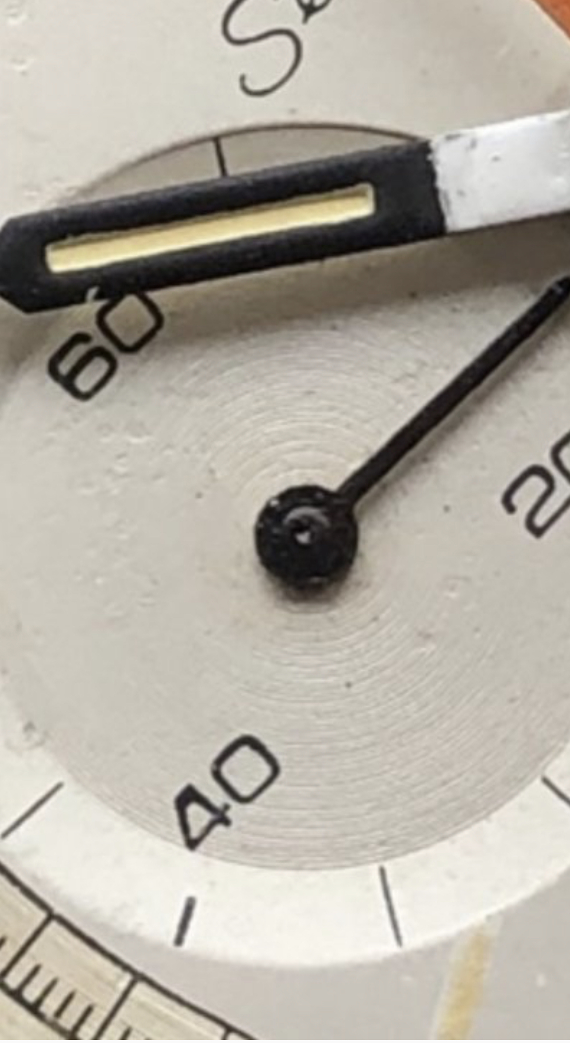

Blow-up of a blow-up.
You can see the remnants of the original guilloche inside the sub-dial.

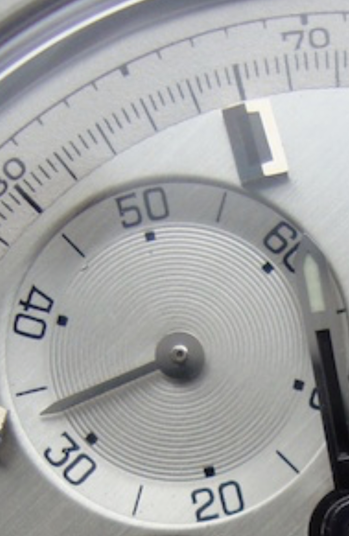

Compare with this original dial:
No way the OP’s dial is original, “prototype”, or another brand’s dial.
It is a redial.

No way the OP’s dial is original, “prototype”, or another brand’ dial.
It is a redial.
gatorcpa
Why not another brand’s dial redialed?
The subdials tell that story.
That could very well be true.
However, my point was that it is not any brand's original dial.
gatorcpa
1,174
7,602
Also, the Mark's at 5 and 15 on the minutes subdial bleed into the sundial quite a bit.

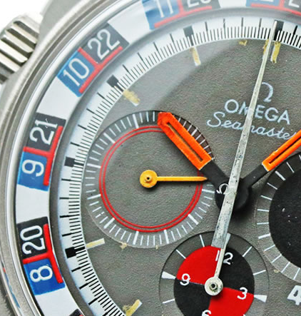

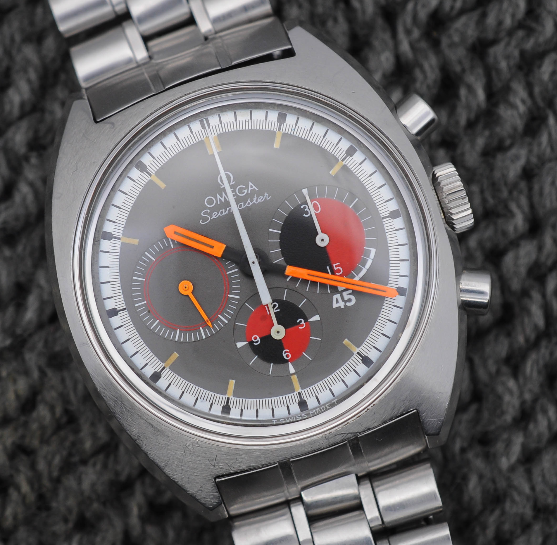

Could it be a soccer time dial redial? In my eyes, the soccer time dial has the big eye 3 and 9 with a smaller 6. 👎
2,845
9,198
I think the concentric circles being filled in somewhat is a good giveaway that this dial was tampered with. The marks on subdials also seem uneven, as others have said.
16,908
48,120
Bingo.....
4,106
16,320
Bingo.....
Interesting path. But the soccer time dial has no concentric circles 😀 why the remnants as @gatorcpa suggested above?
This is an original Omega Seamaster dial yes, but this is not the dial that could have served as a base for an eventual redial. The subdial you showed is much smaller, not a big eye 😉
Very interesting to get (totally) different opinions from different people and places. Keep them coming. Looking fwd to get some time to talk to the Heritage Team.

Circles on the left sub dial
( b
ut as you say mystery on which dial but at least two models with sub dial lay out )
And again we learn something new 👍 I have never noticed concentric circles on some Soccer Time dials, yet. Great !

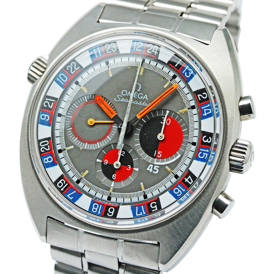

Note that I saw somewhere a dial comparison between the SoccerTime 145.016 and the 145.019 and it looked like the dials are different. (If I remember well, the minute track is slightly different) Maybe the 019 had the circles, which would be in line with your example.
@gatorcpa these concentric circles don't look very sharp as well, your comments on that? 😀
4,106
16,320
Just a quick comparison :
( http://www.luxuwrist.com/uploads/2/7/7/6/27766927/s490097580971589483_p263_i33_w2560.jpeg )
No concentric circles here.
( https://shop.r10s.jp/auc-kyotoya-shop/cabinet/tokei/01623868/06262056/imgrc0074961677.jpg )
Concentric (uneven) circles are present.
Definitely a different dial. The minute track is much closer to the subdials on the 019 to allow space for inner bezel. Indeed it even overrides the subdial at 9.
Both watches have the same calibre (861).
--> so I believe we can exclude the Soccer Time 145.016 from the possible base for redial.
