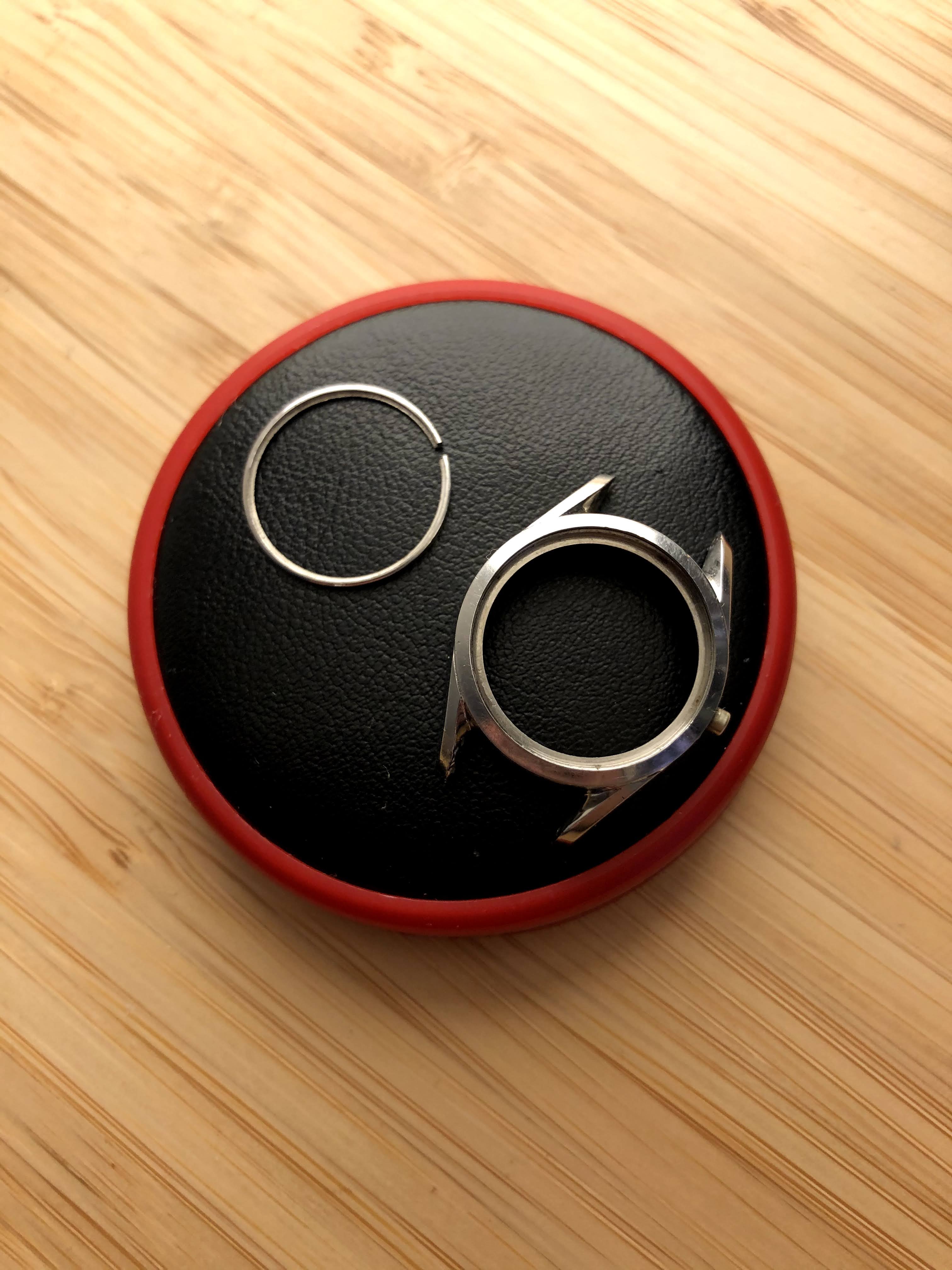

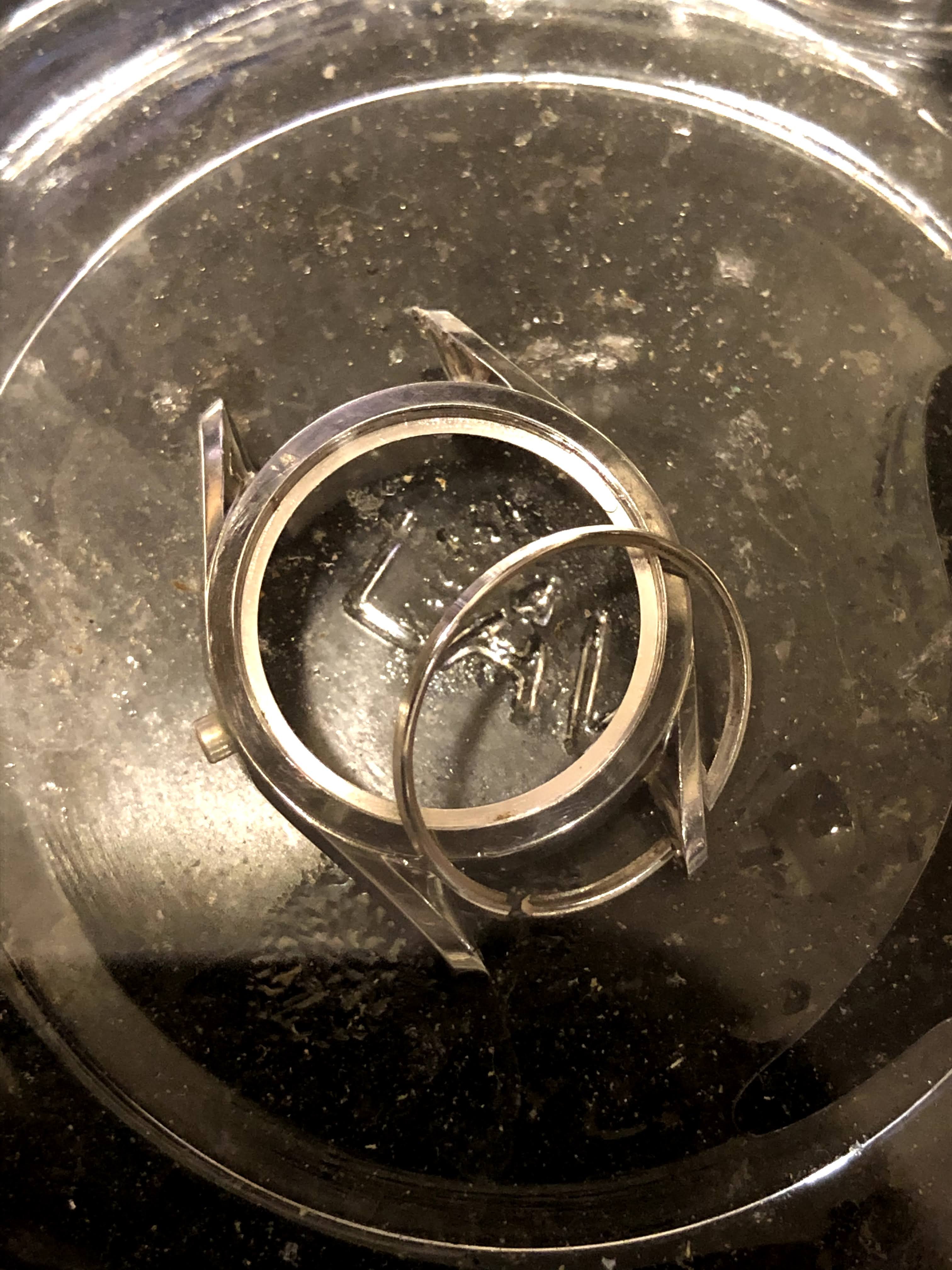

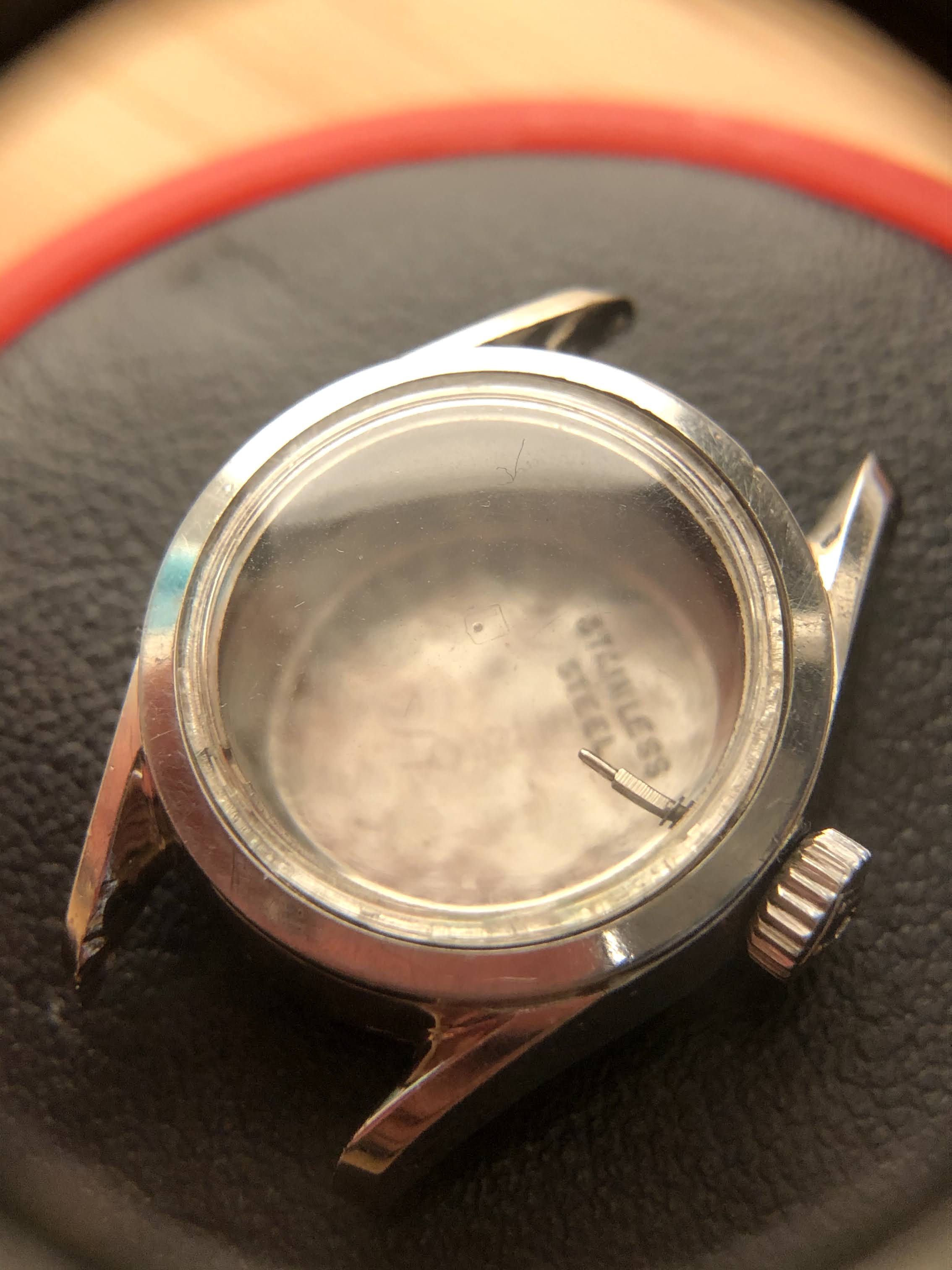

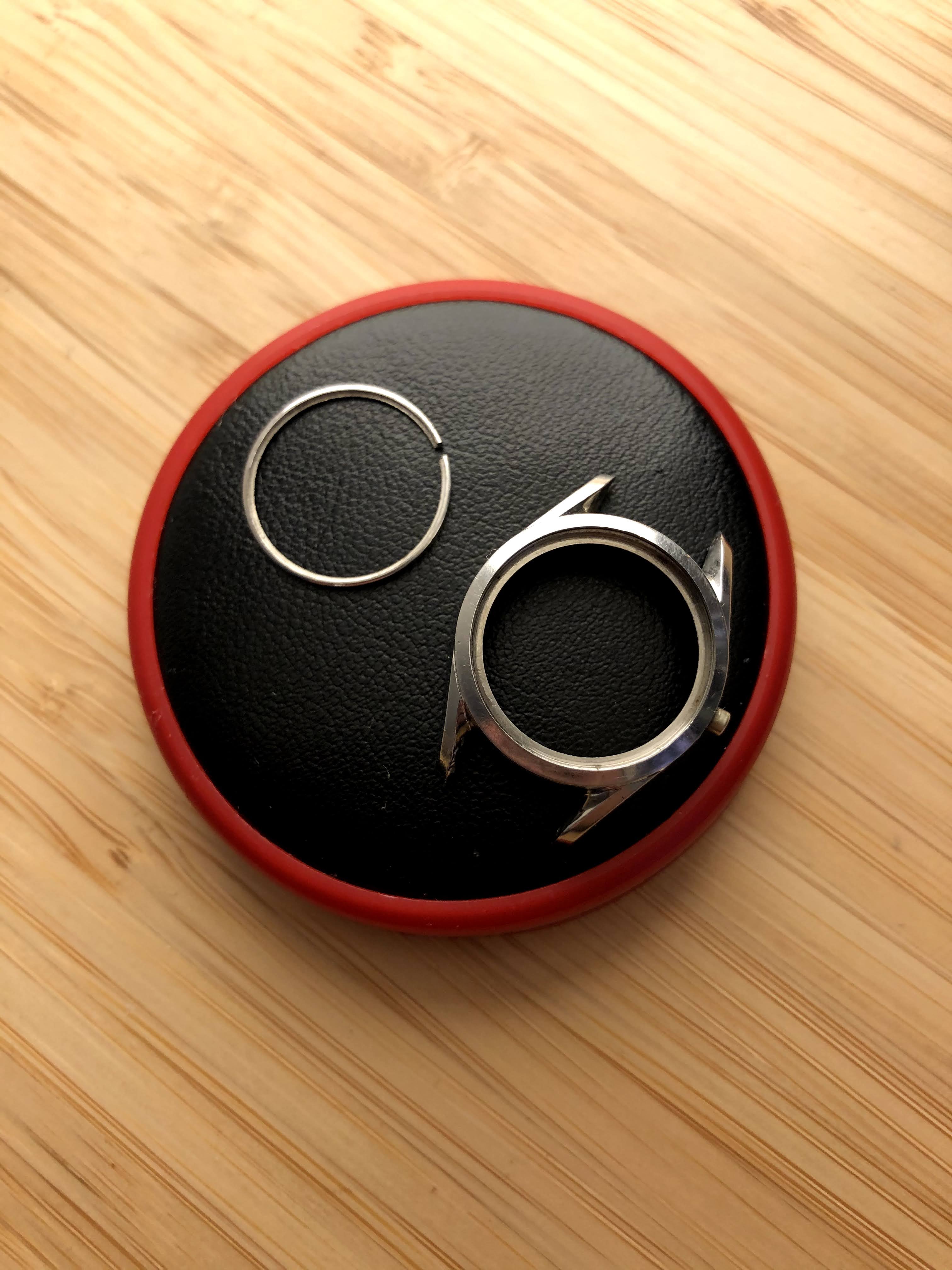

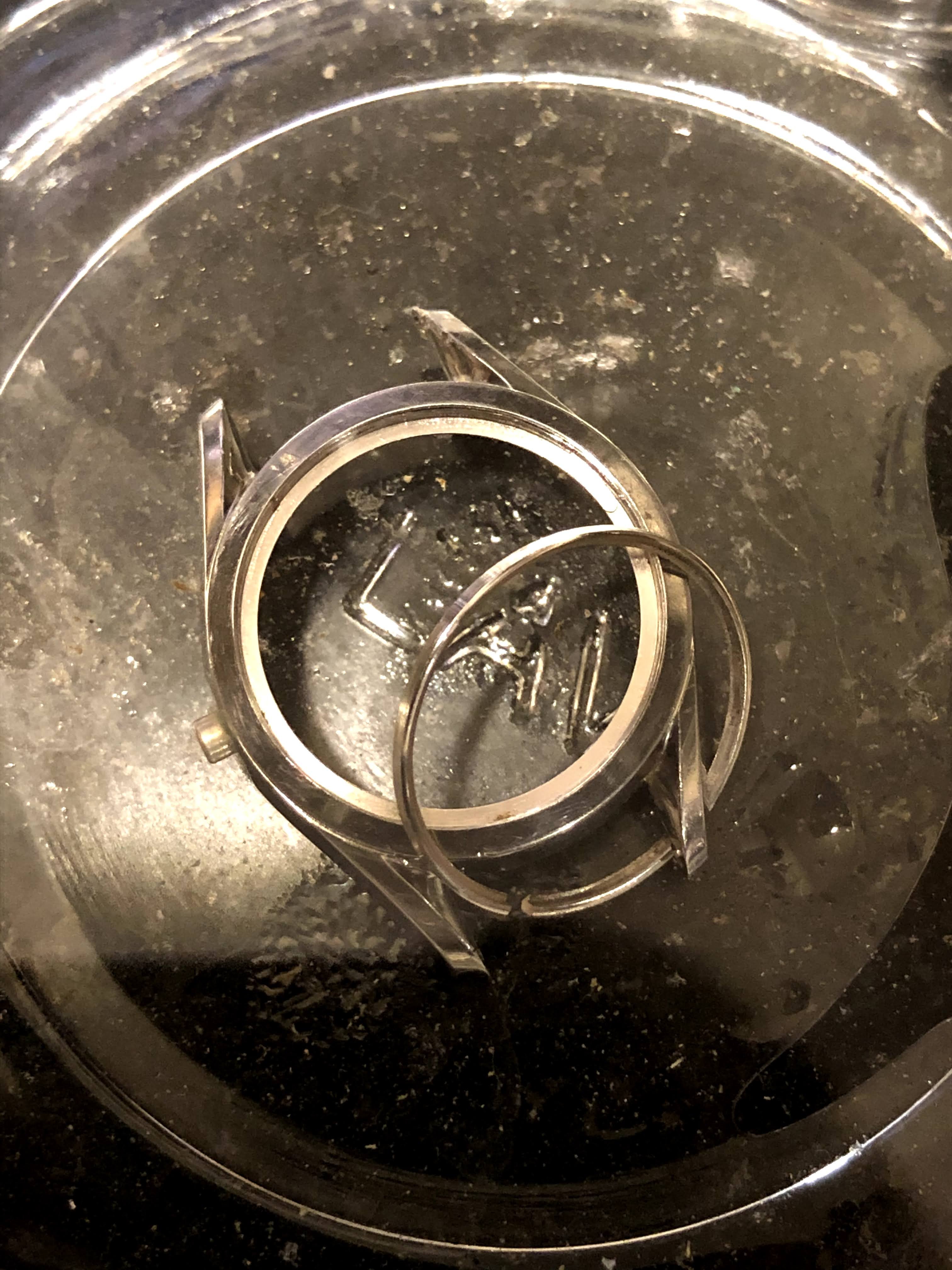

Update:

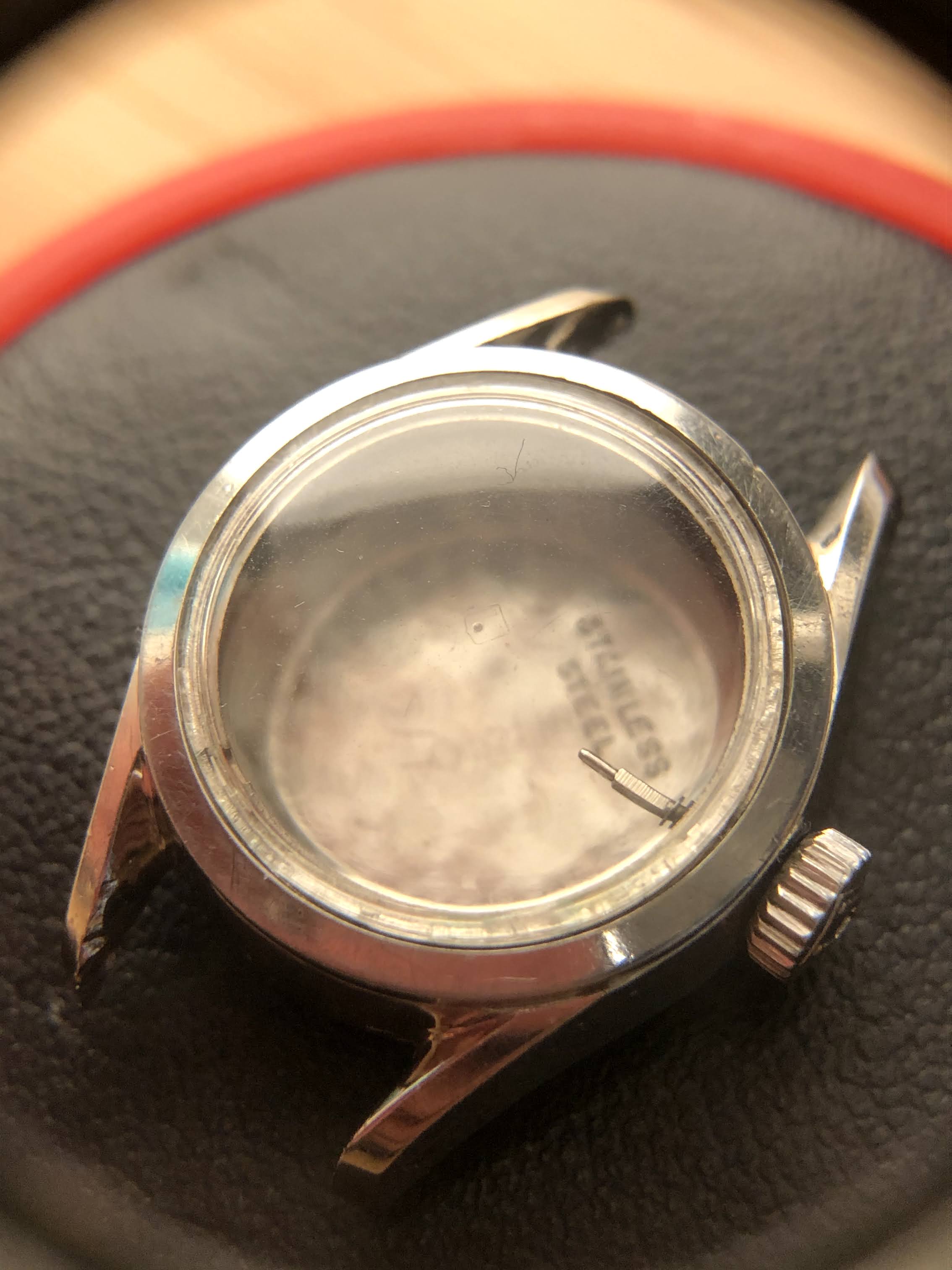

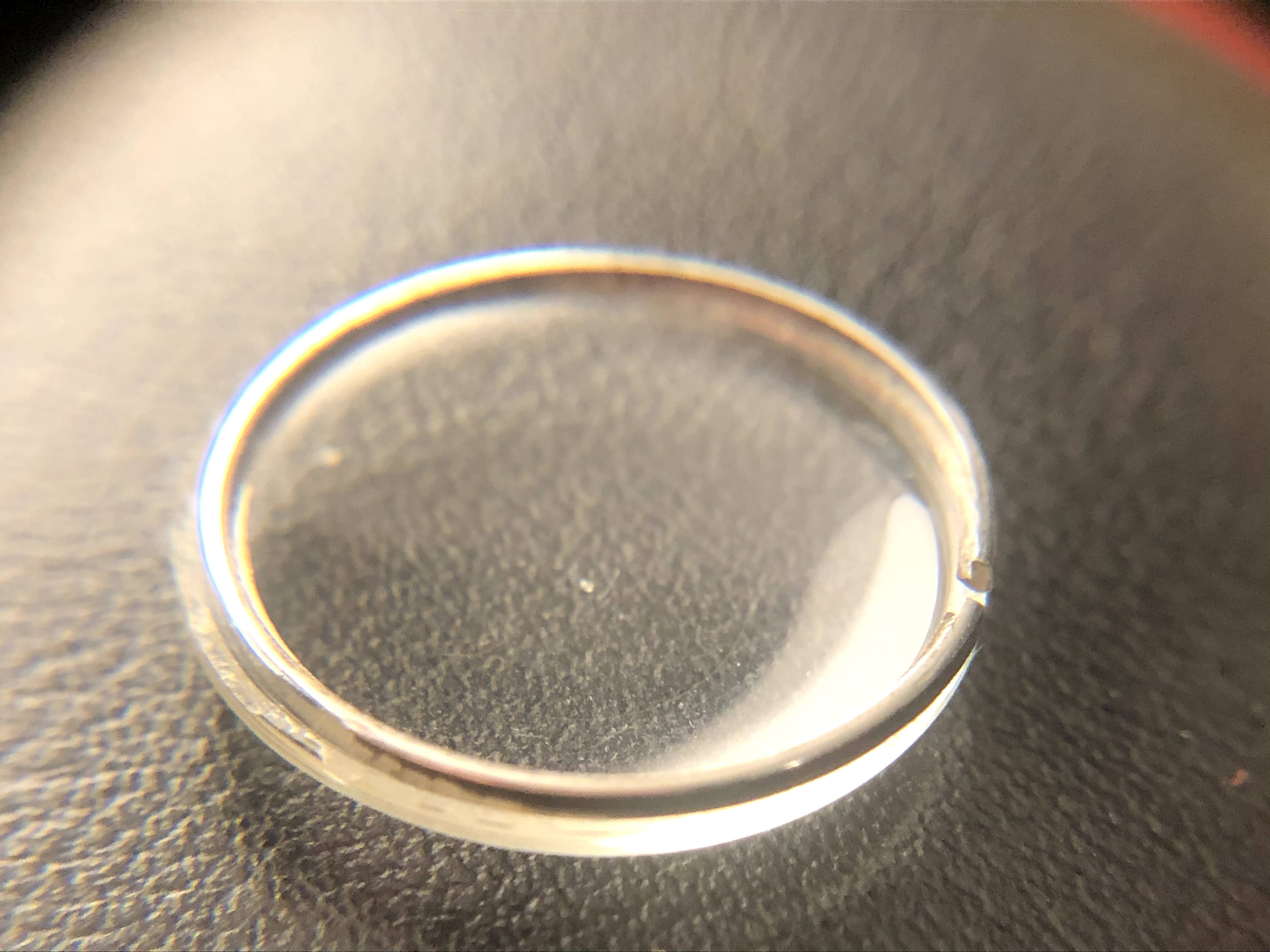

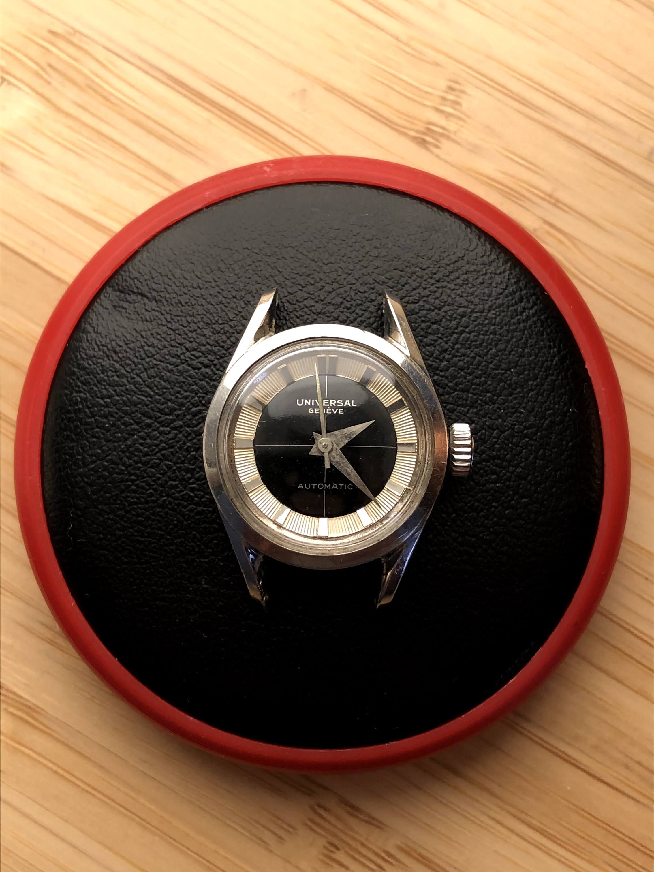

After leaving the case in acetone for a few hours and much scrubbing it turns out there was a tension ring buried under all of the glue!
270
624
Next step is to remove the glue residue from the plexi. Per the suggestions above I'm going to avoid using acetone since it'll probably dissolve the plexi altogether.
I did some research and I think vinegar is the best option. Will post an update with the results

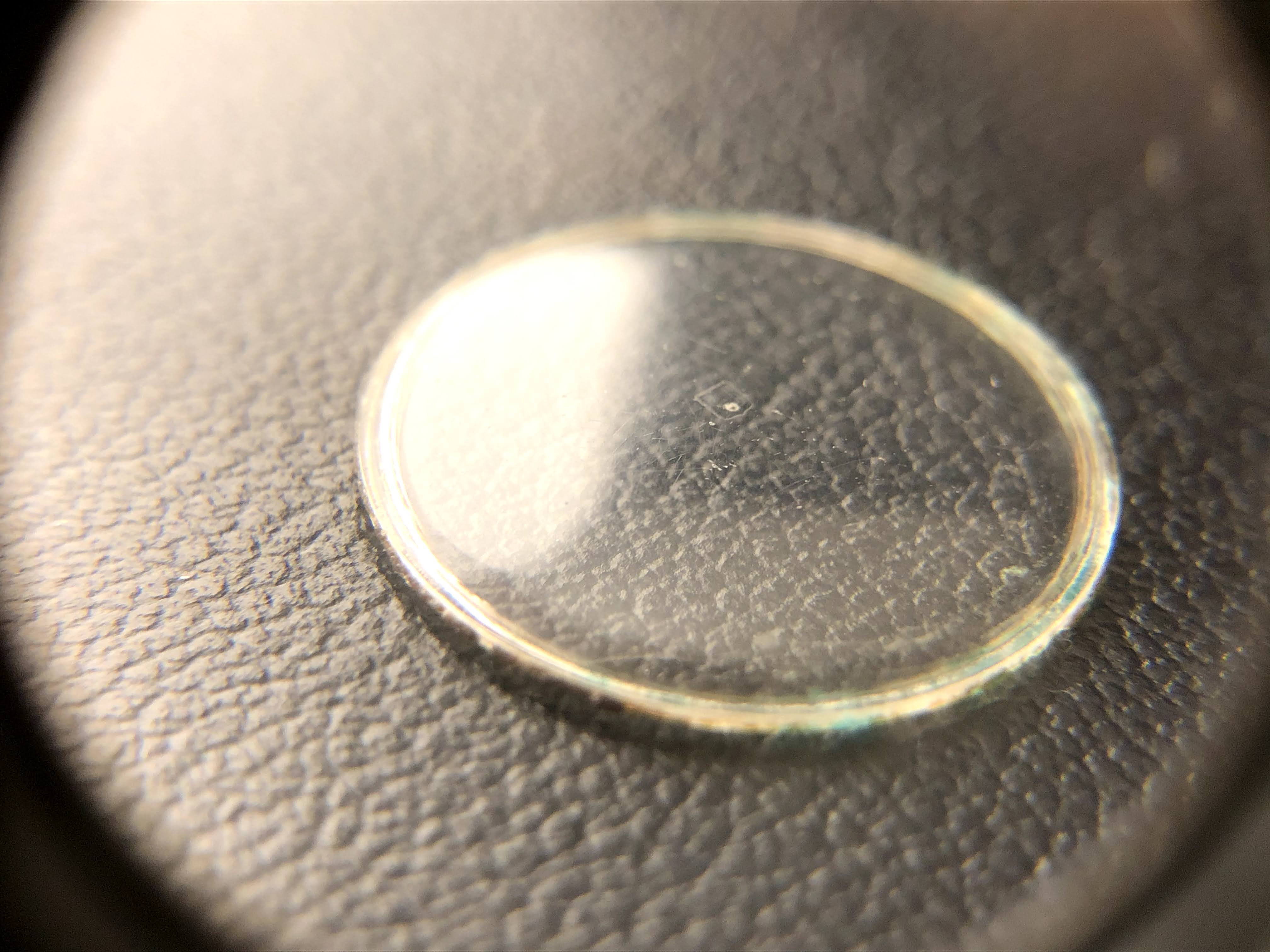

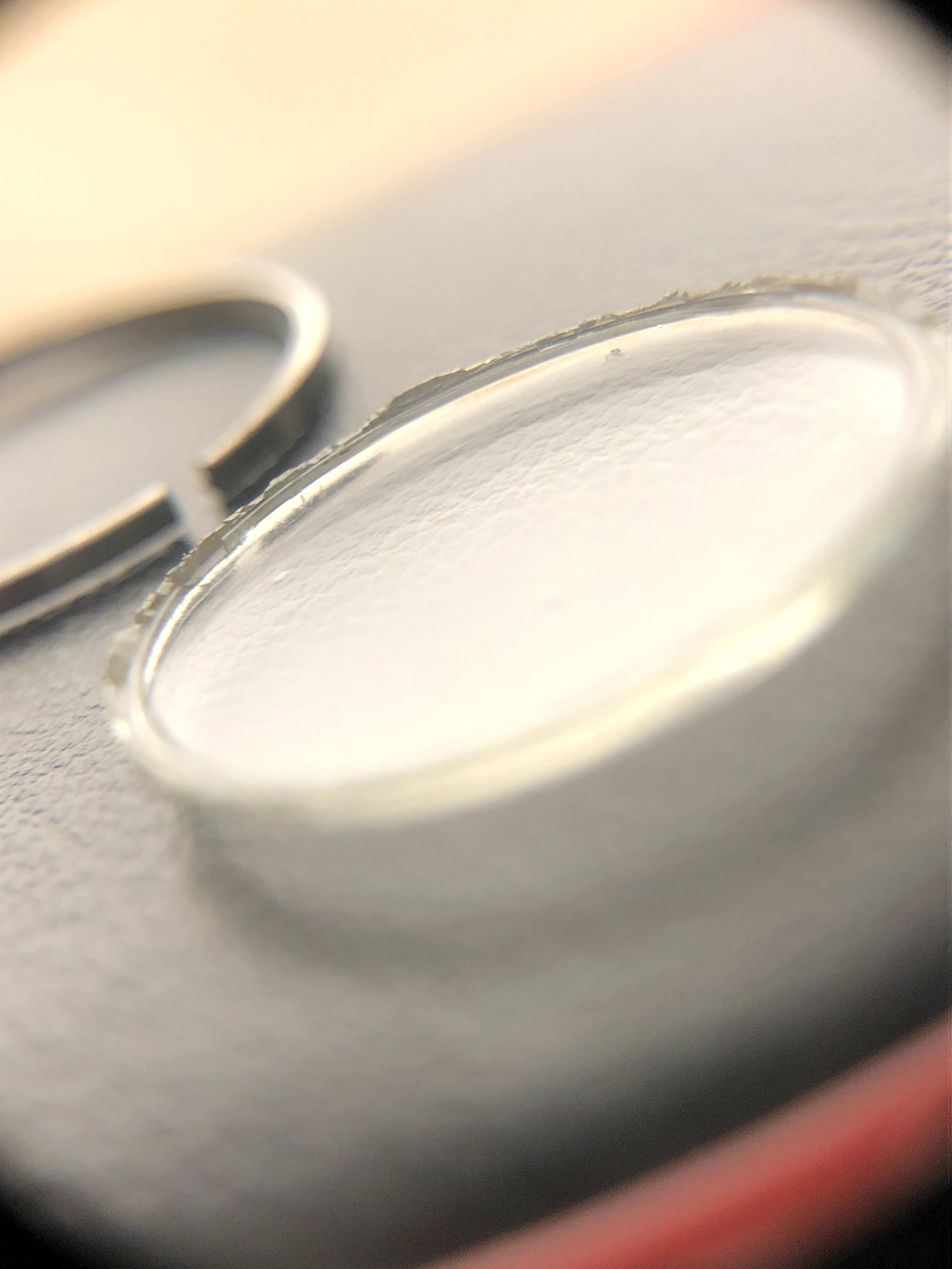

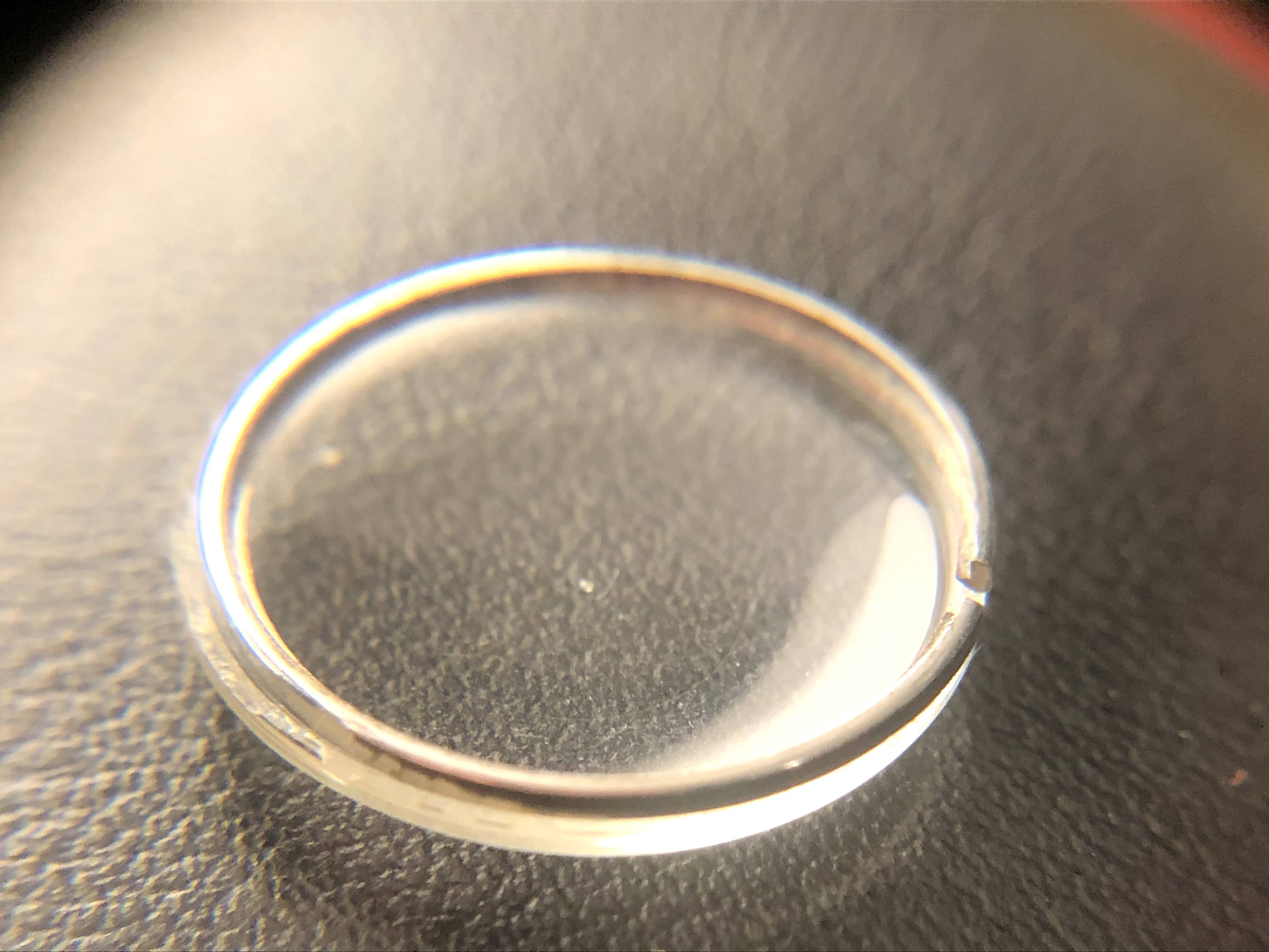

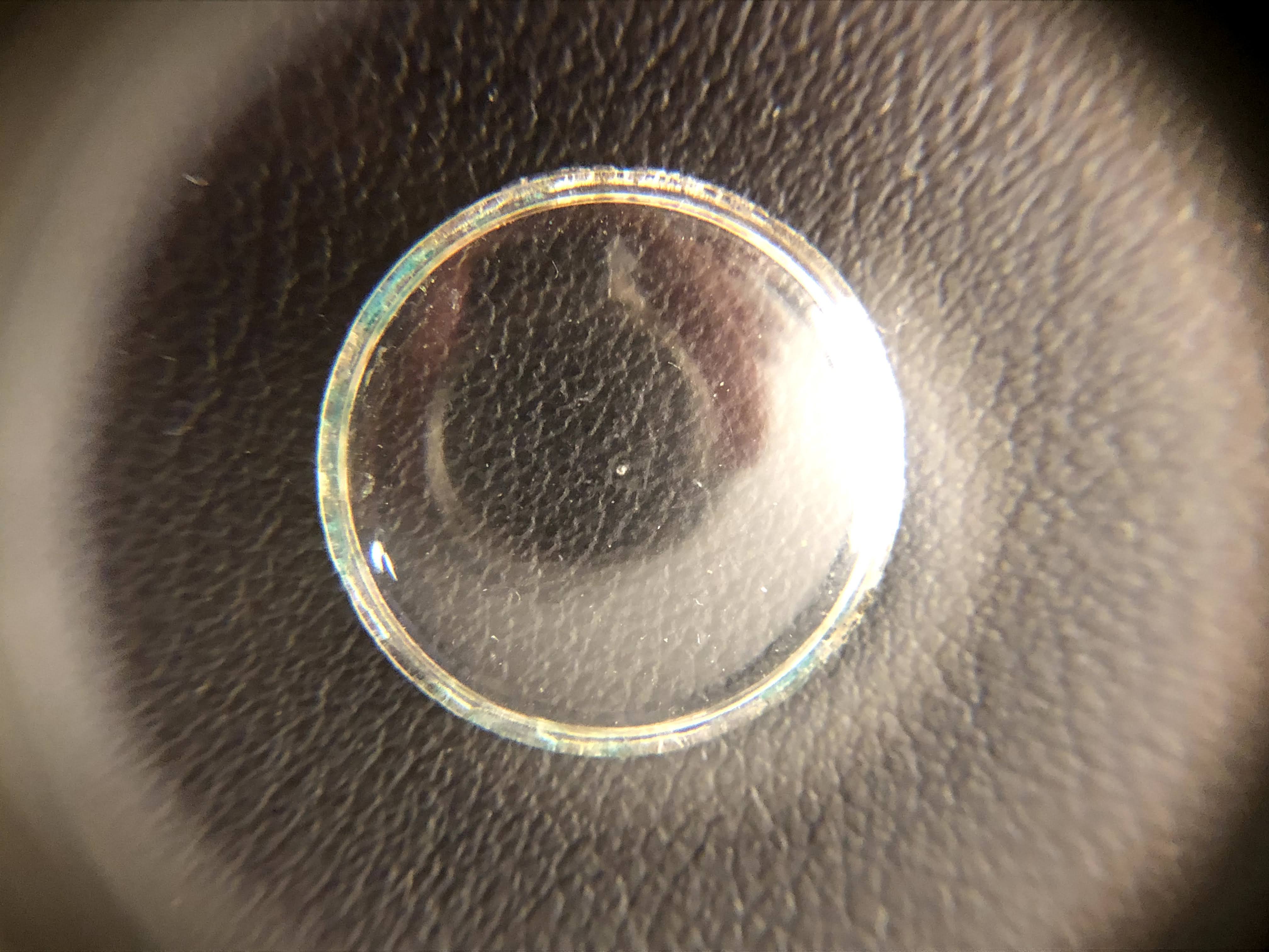

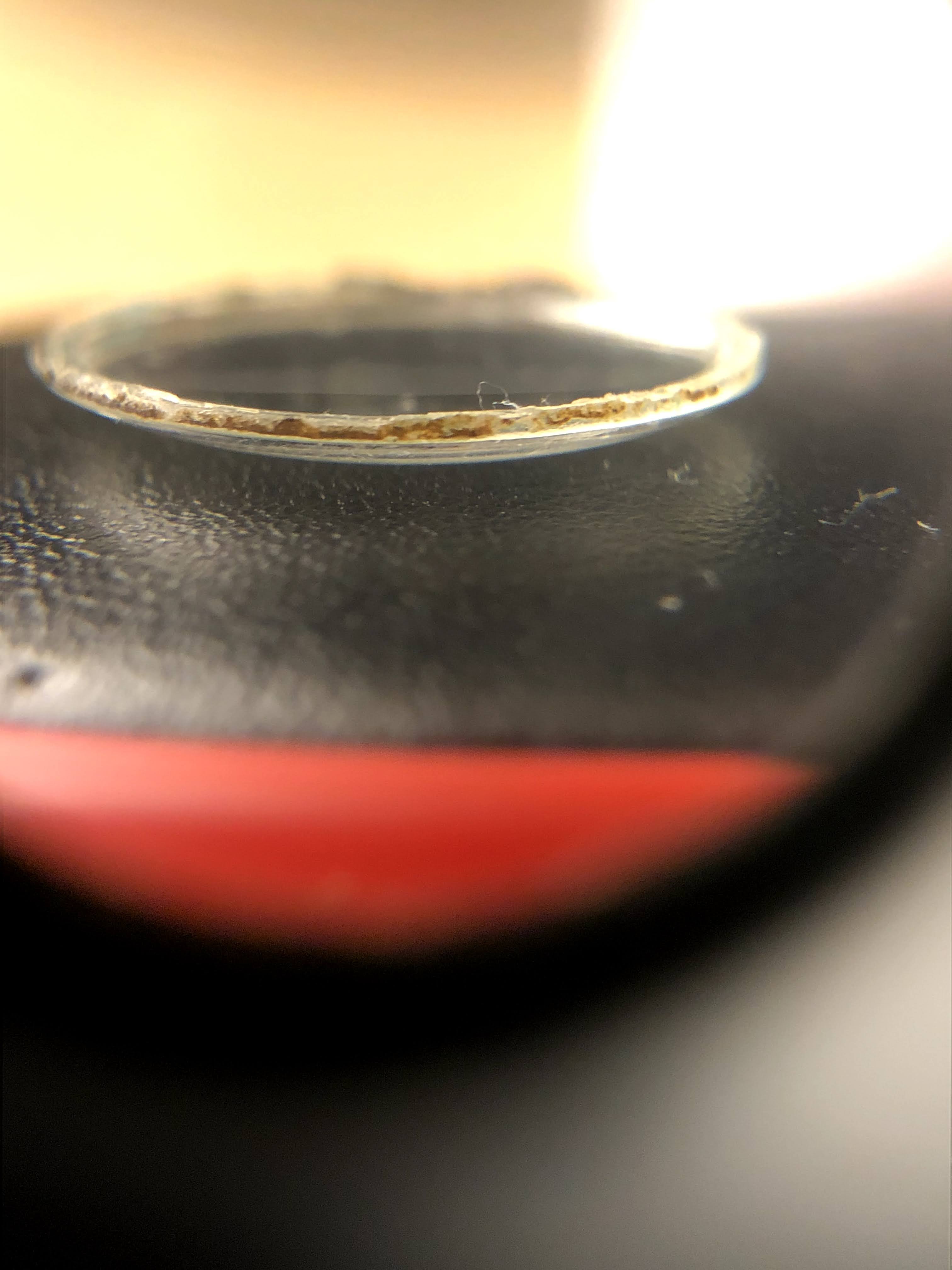

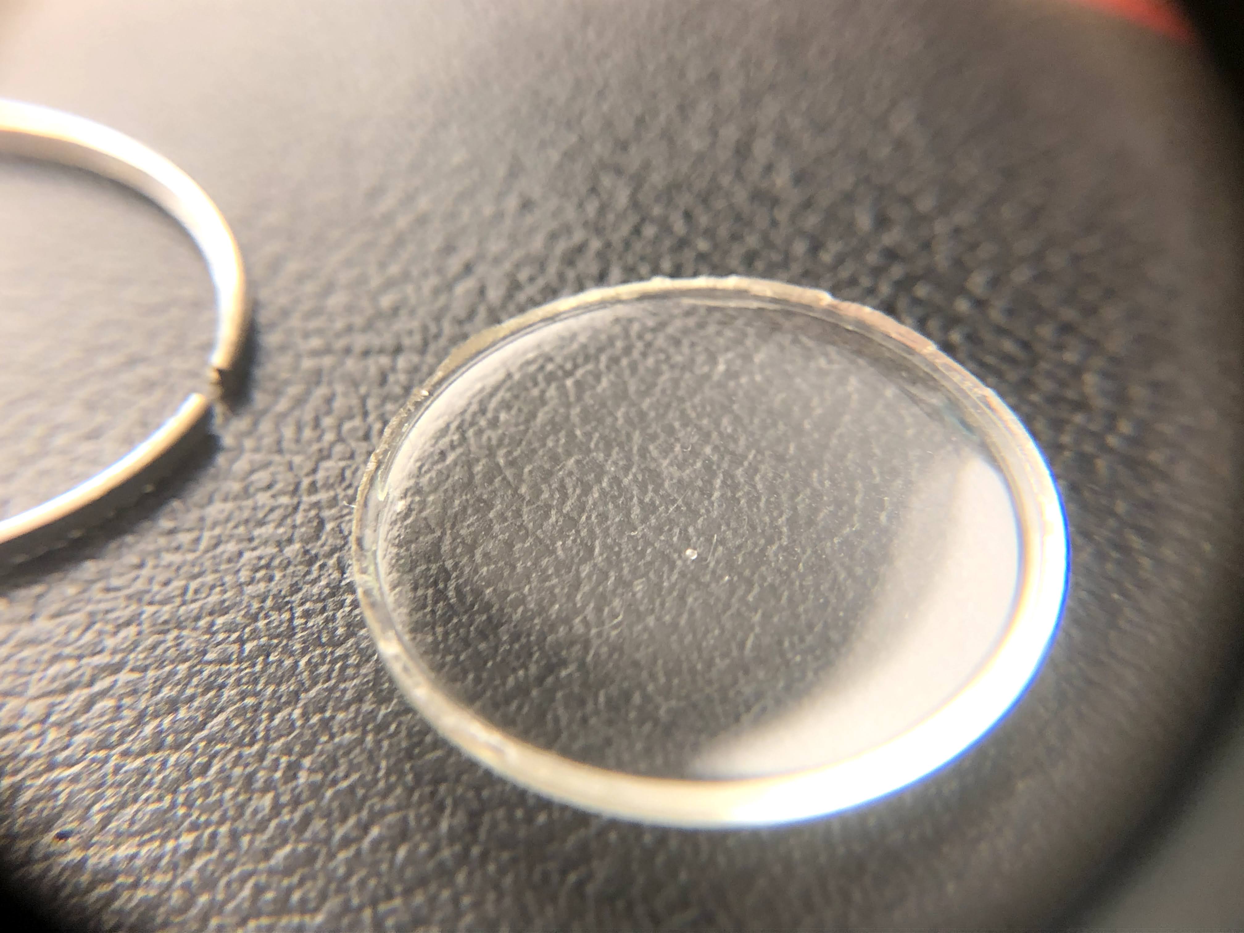

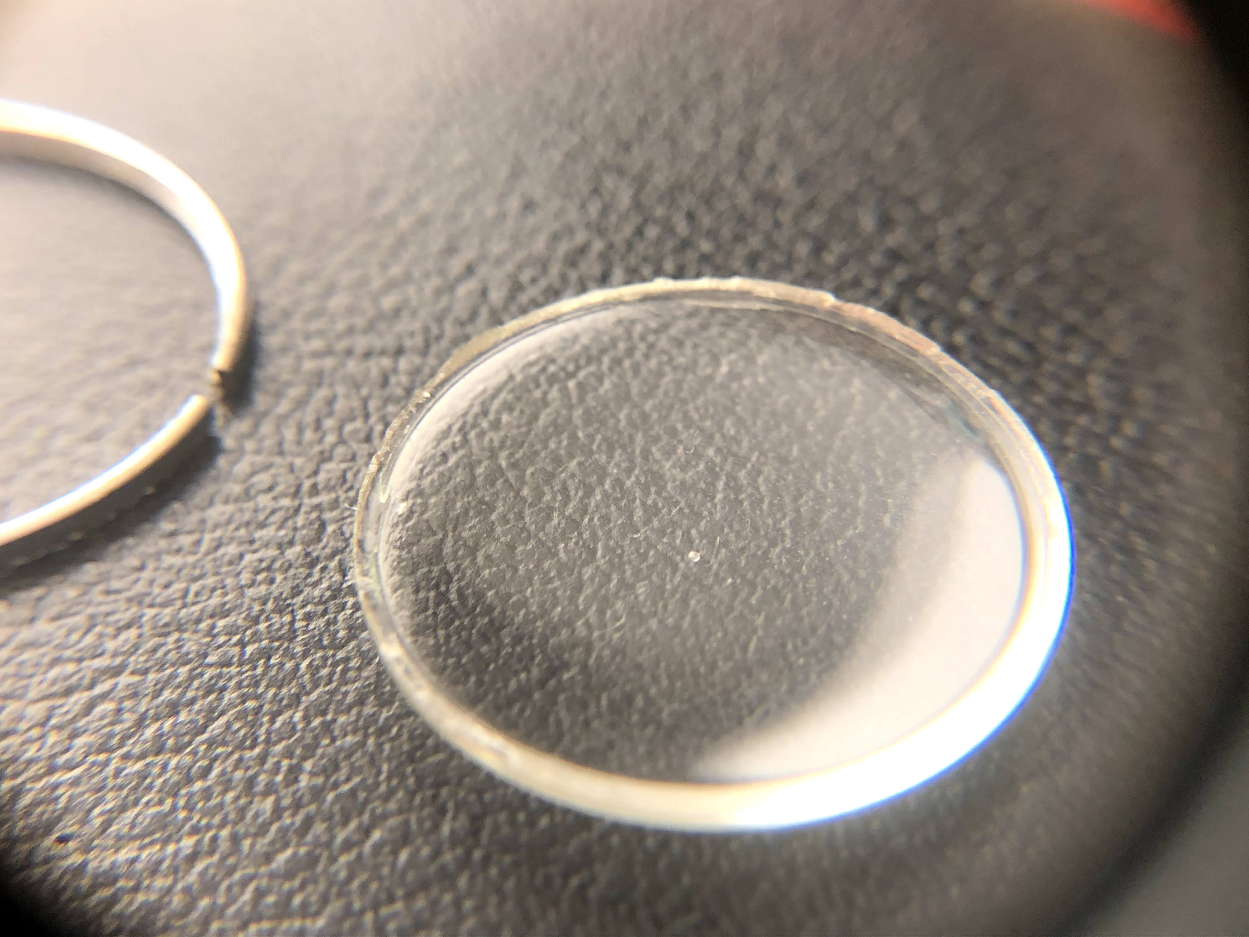

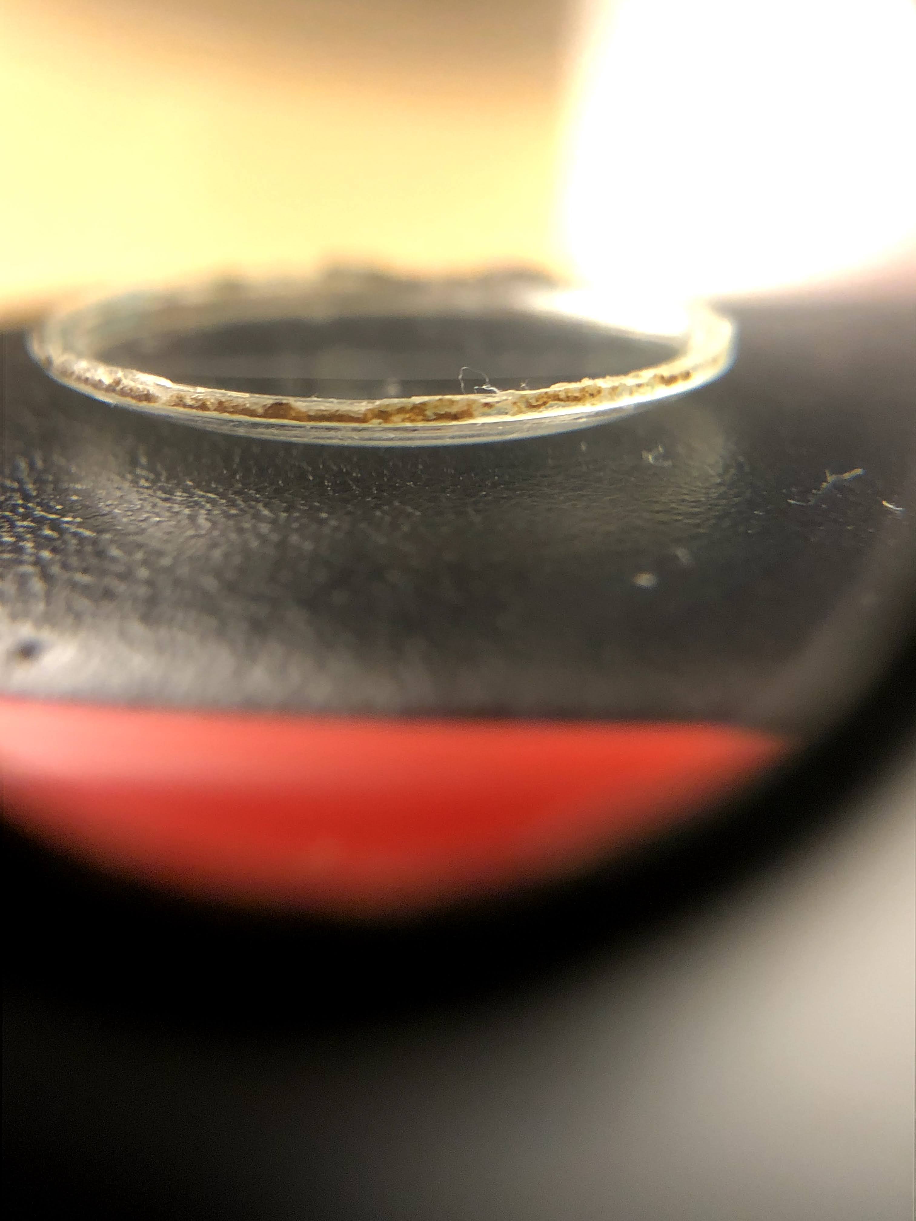

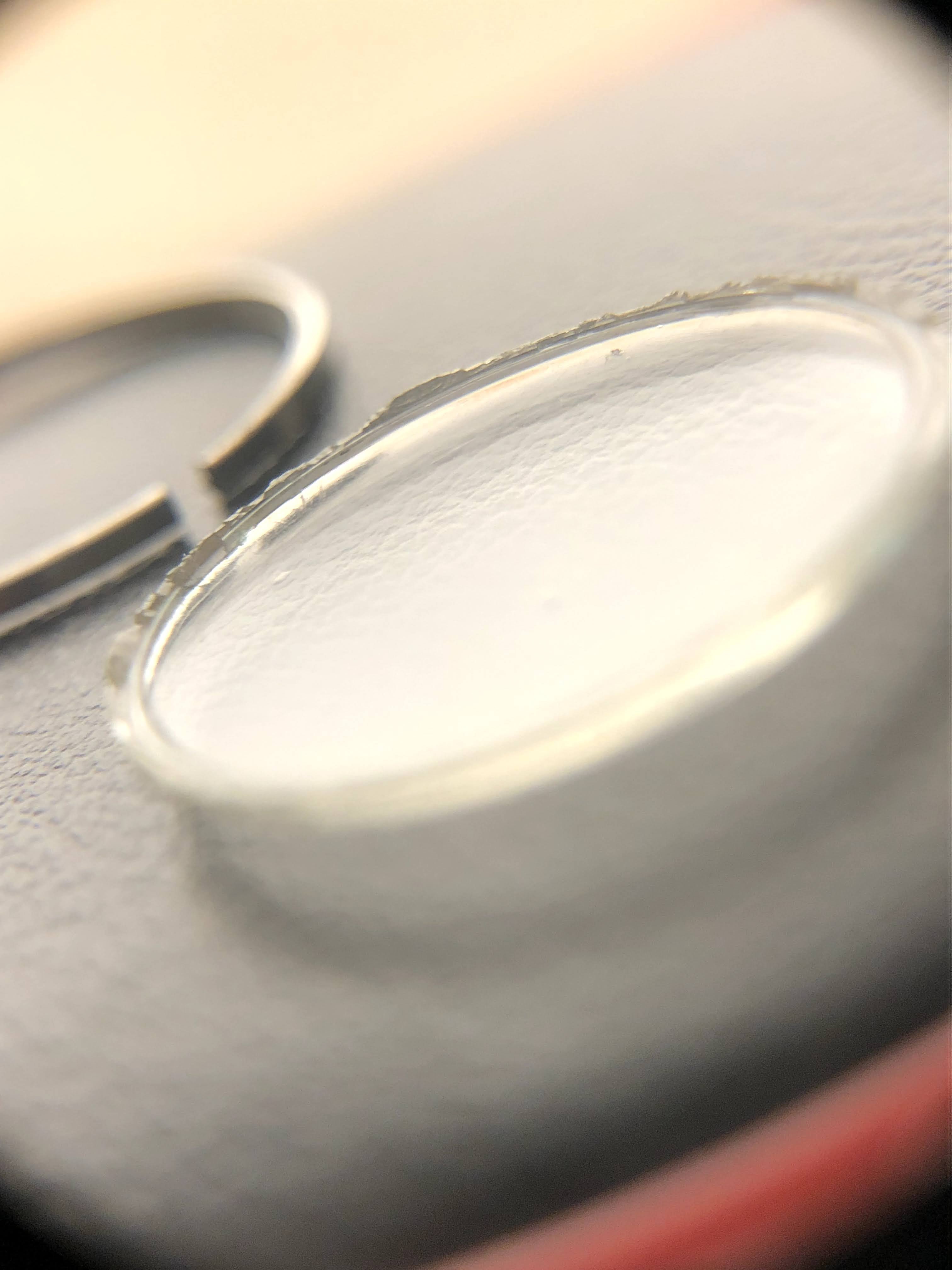

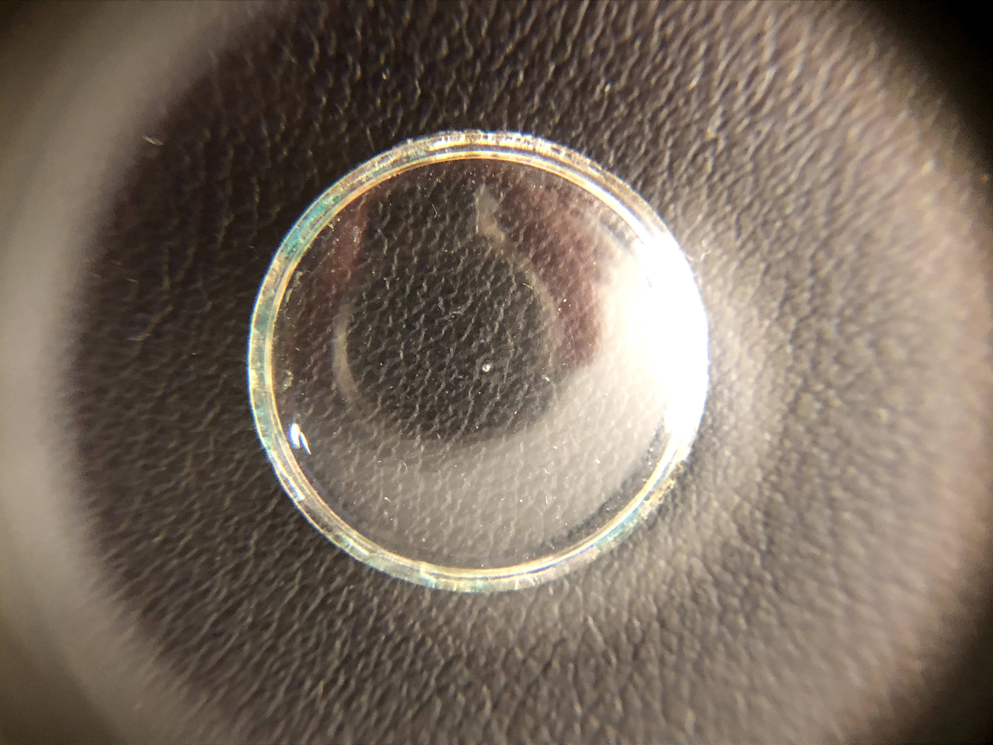

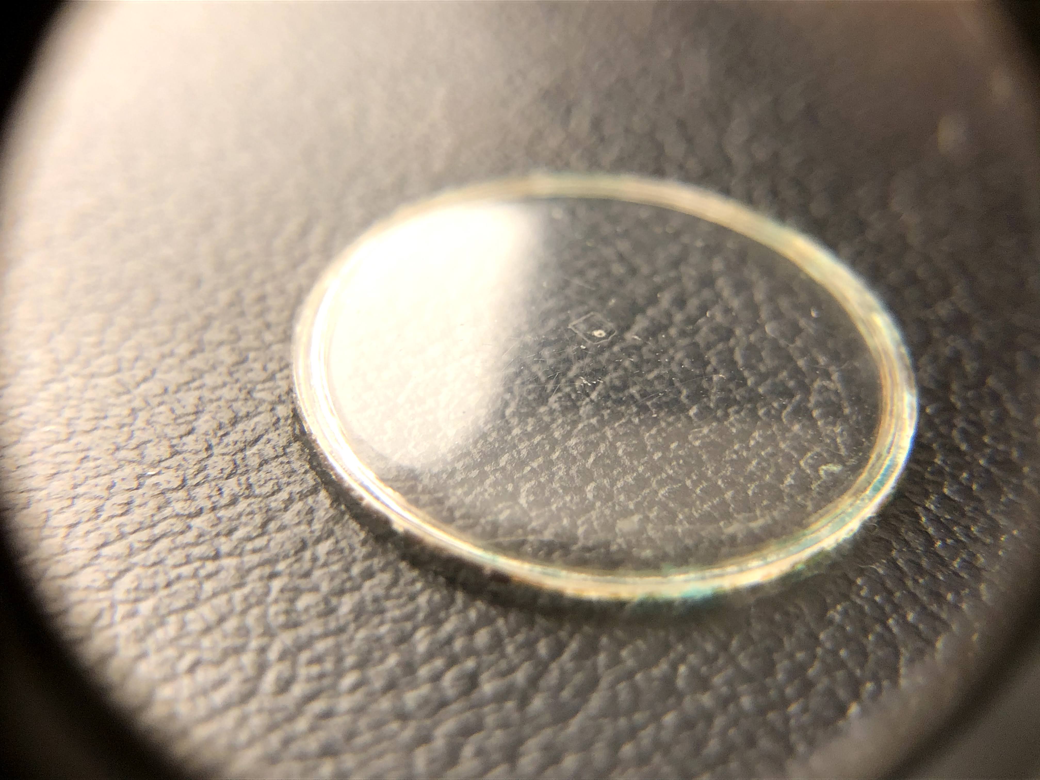

Good news:
Vinegar worked its magic without dissolving the plexi!
Bad news:
I think the edges of the plexi are broken in places. I guess this was the reason it was glued in the first place.
Given that, I'm not sure what's the best course of action forward. There's the tension ring, but with the edges of plexi chipped off I'm not sure if it can hold the plexi in place.
-So I guess I can glue the plexi to the case again but use proper glue like @Radiumpassion suggested.
-Or find a replacement (likely generic) plexi
But maybe I'm wrong and the tension ring can still hold the plexi without glue.

I’m sure there is a GS or divertite with the same profile- I would rather use a generic that fits properly than a damaged factory crystal.
4,856
12,281
Wow, I thought you were crazy to try and revive that hot mess of a watch. It looks like it is starting to come togehter.
1,145
5,651
It would be cool to salvage the original crystal, but I think a generic is the
way to go to make a usable watch.
270
624
Yeah I think I'm convinced a new plexi is the way to go. Thanks for the feedback.
I'll post an update when it's finished.
1,241
3,840
Better to go with the generic crystal in this case. Just dont throw the original away!

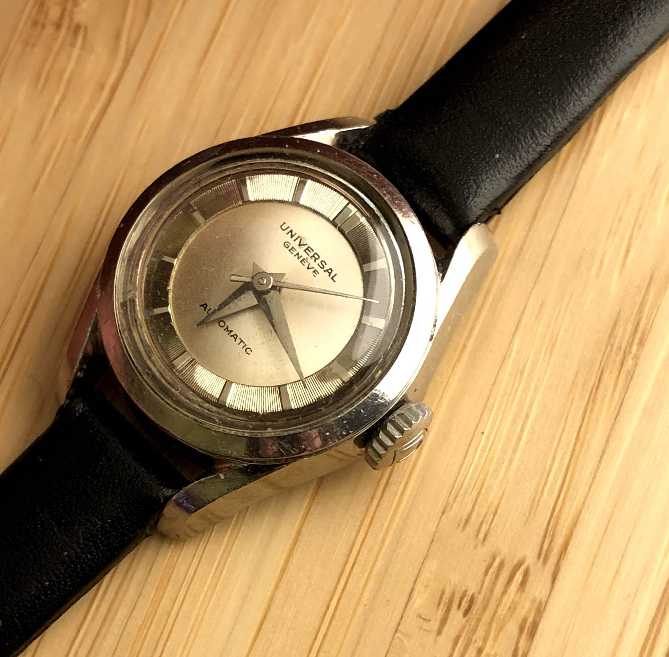

270
624

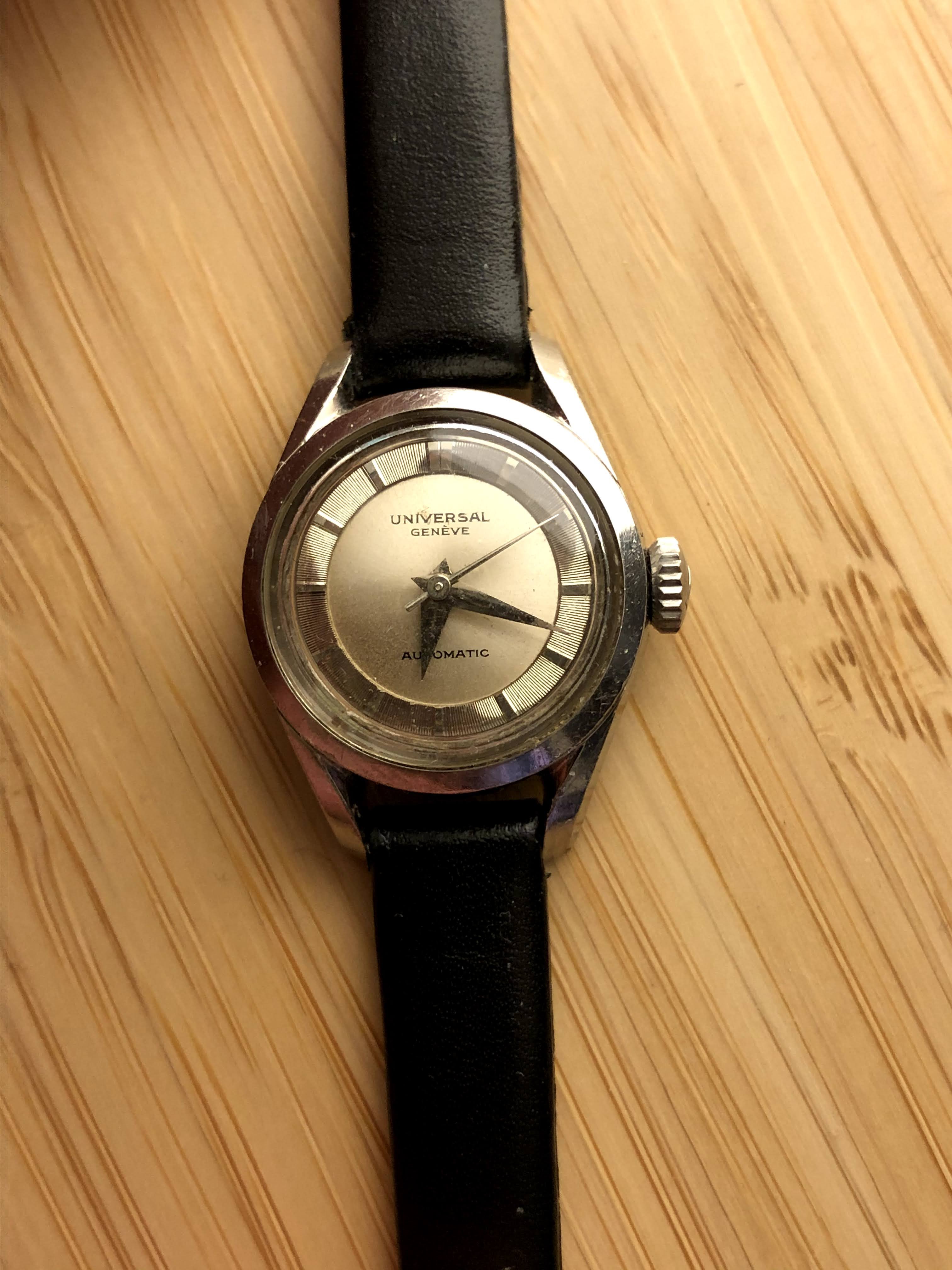

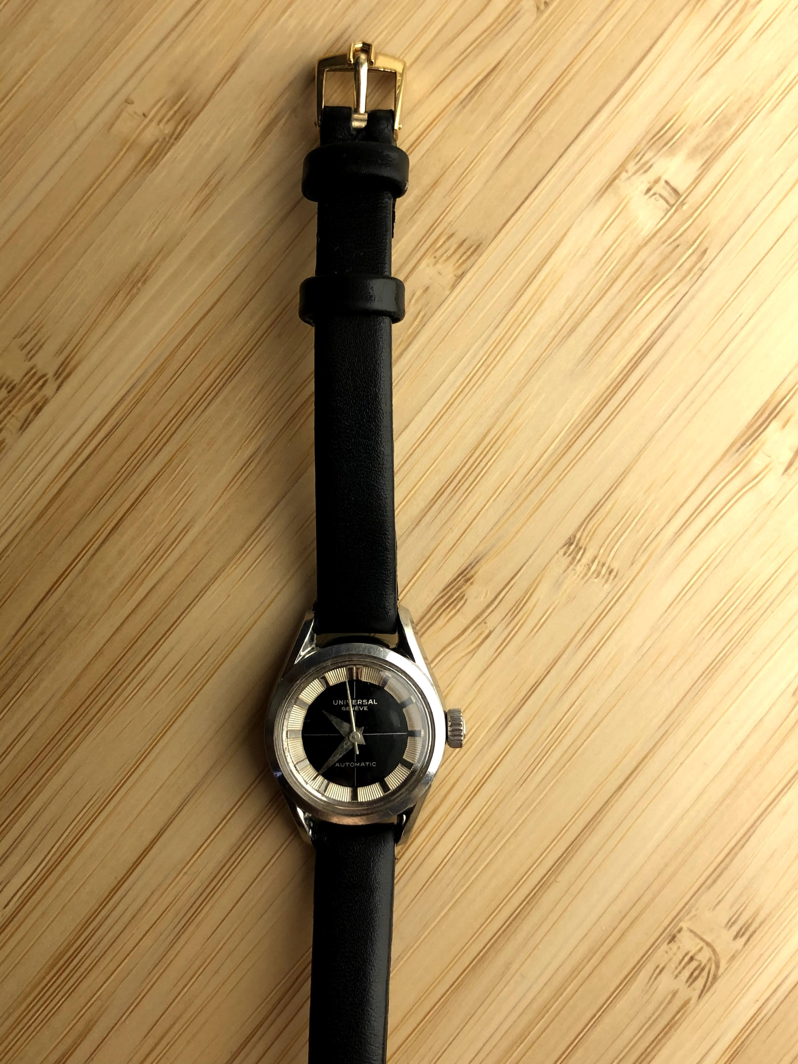

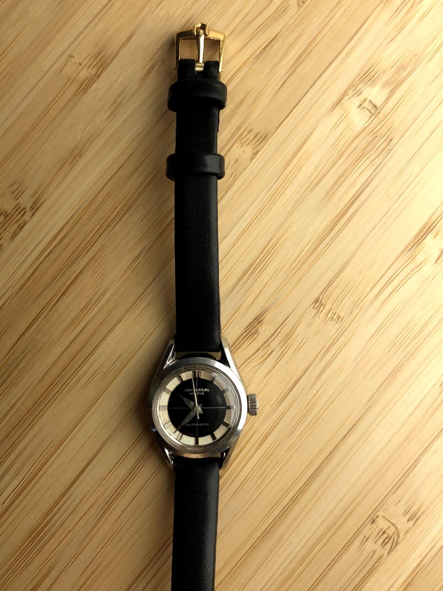

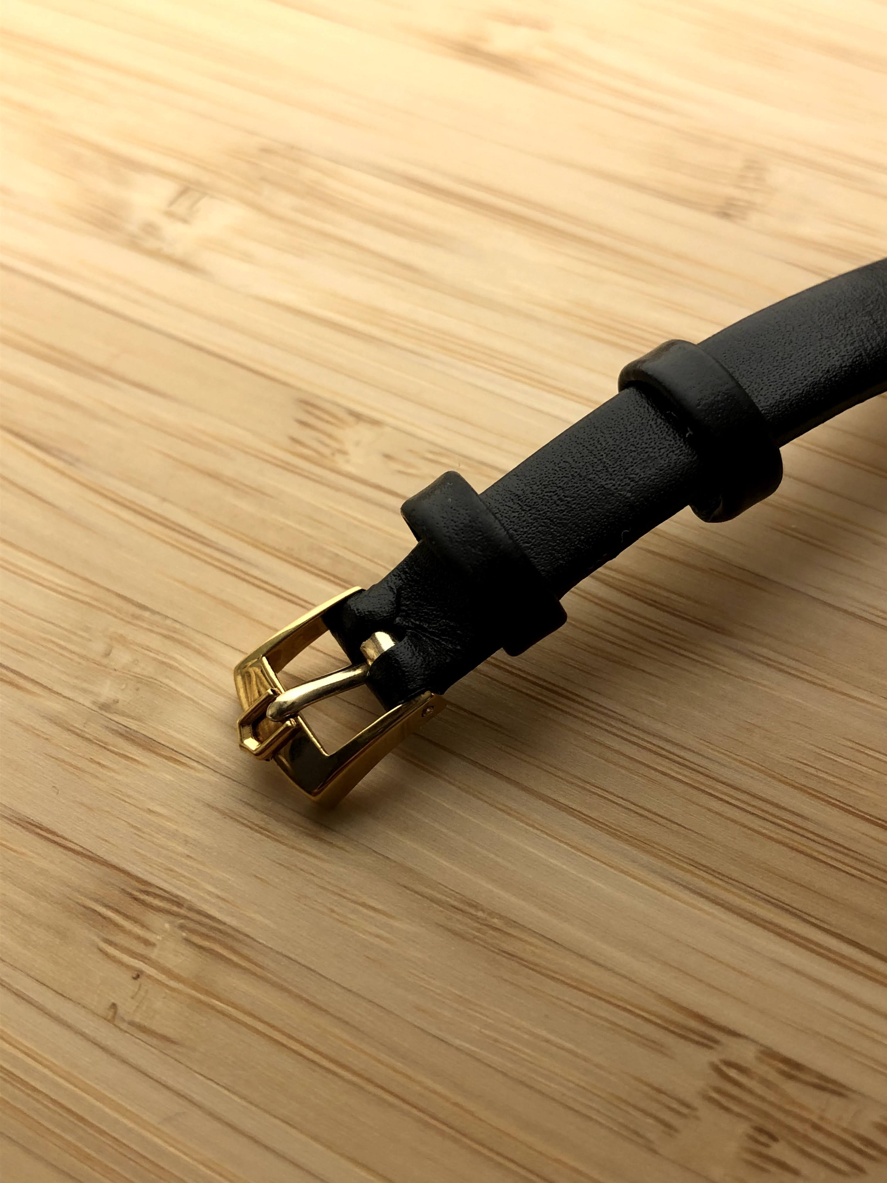

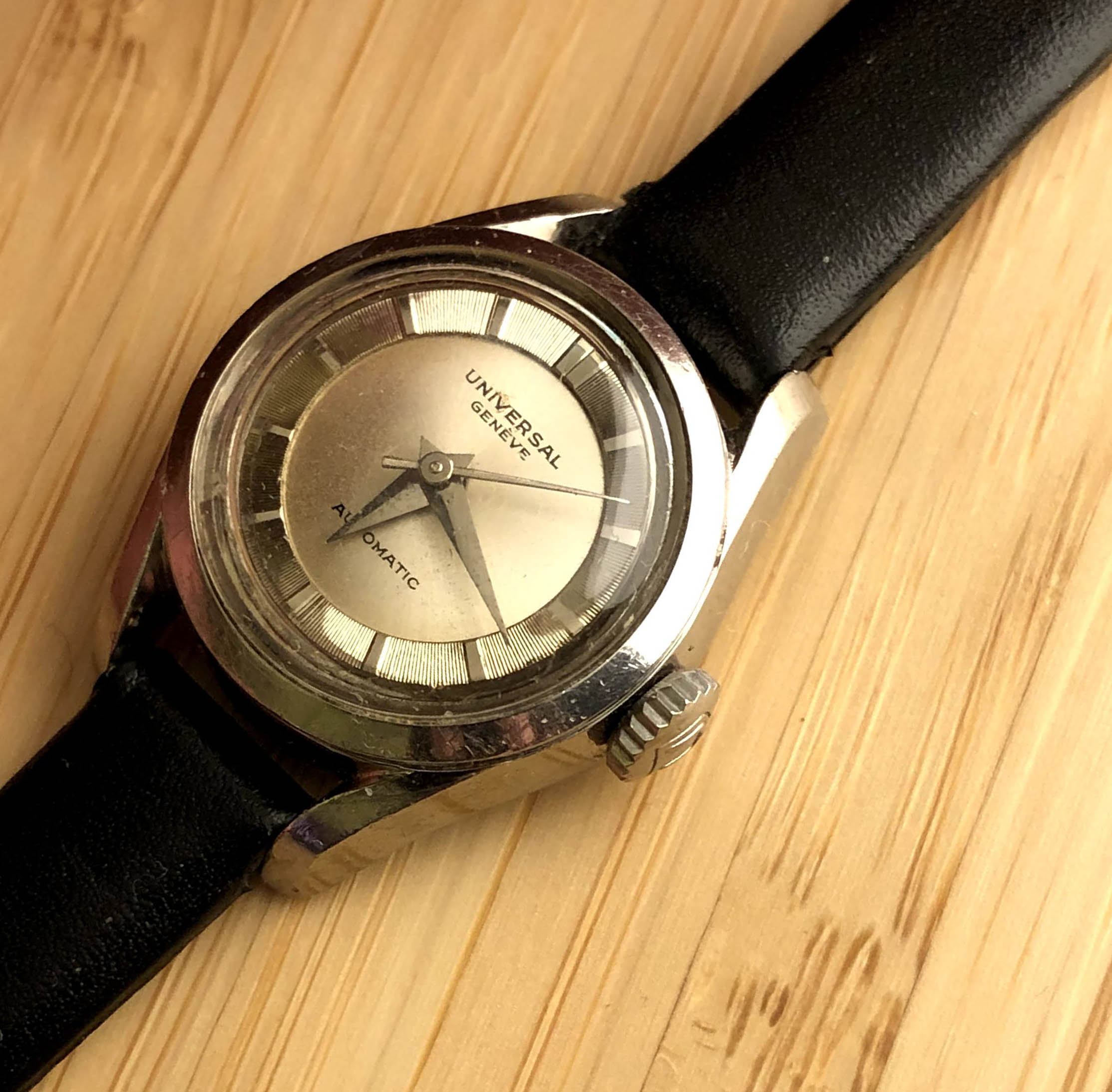

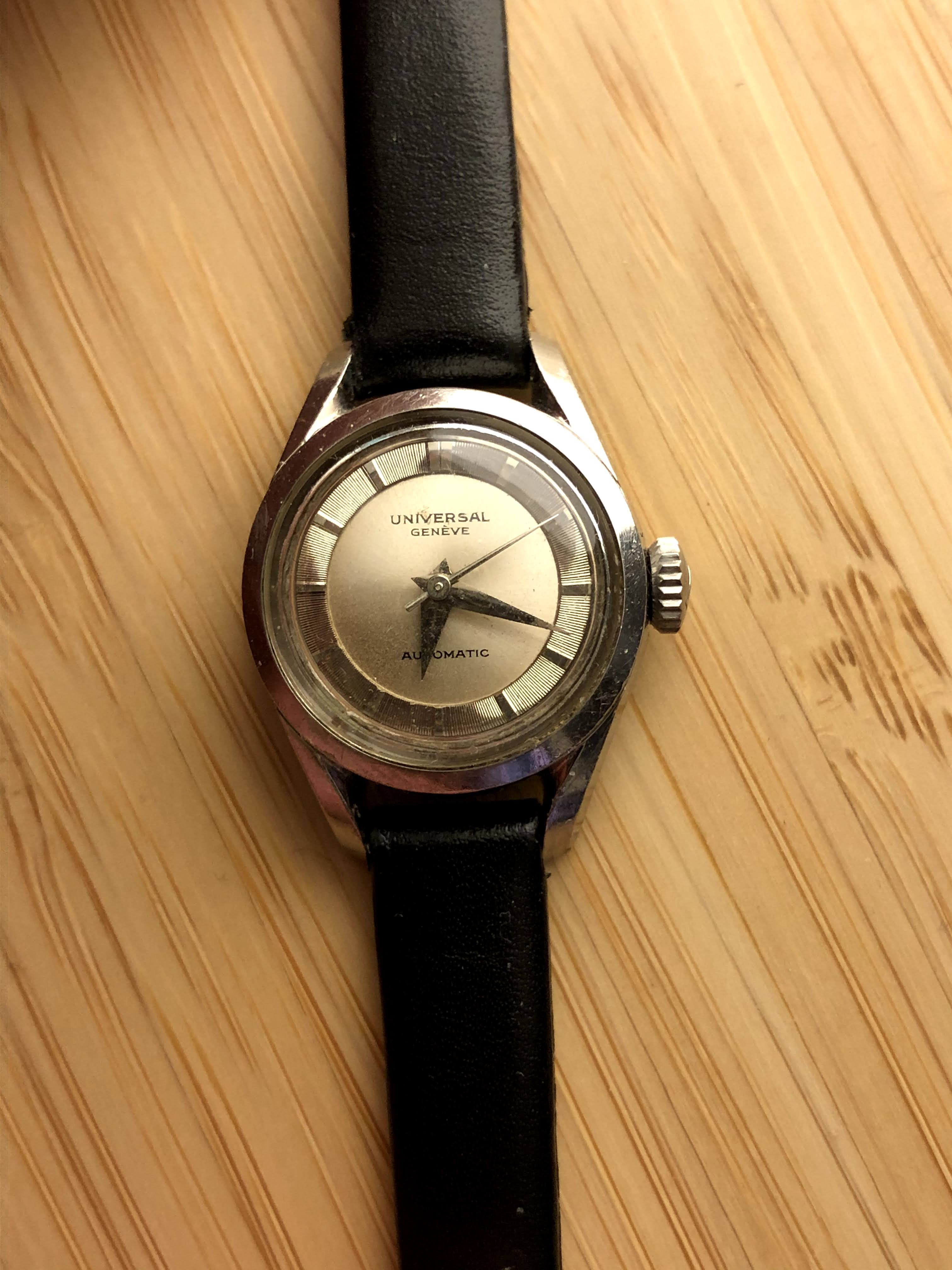

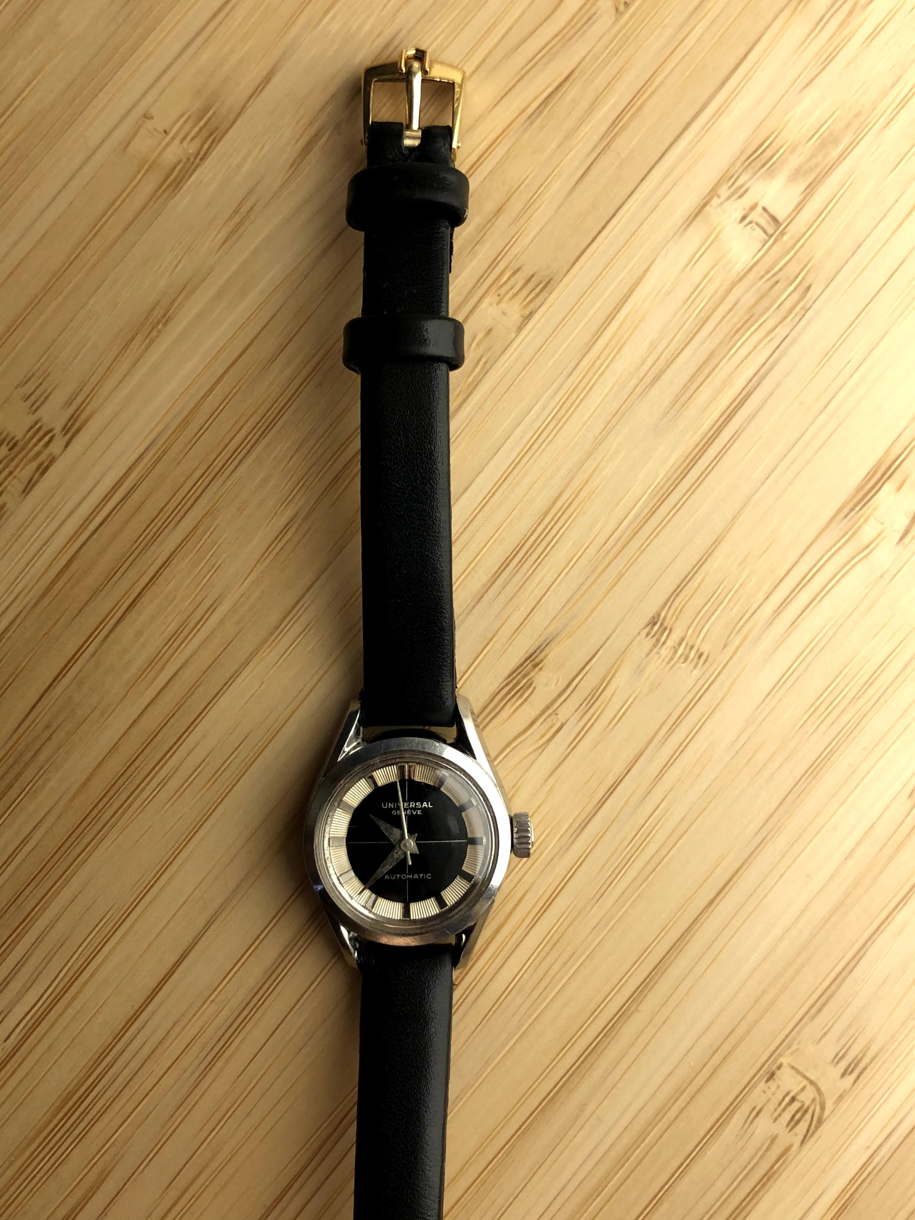

congratulations, looks fantastic

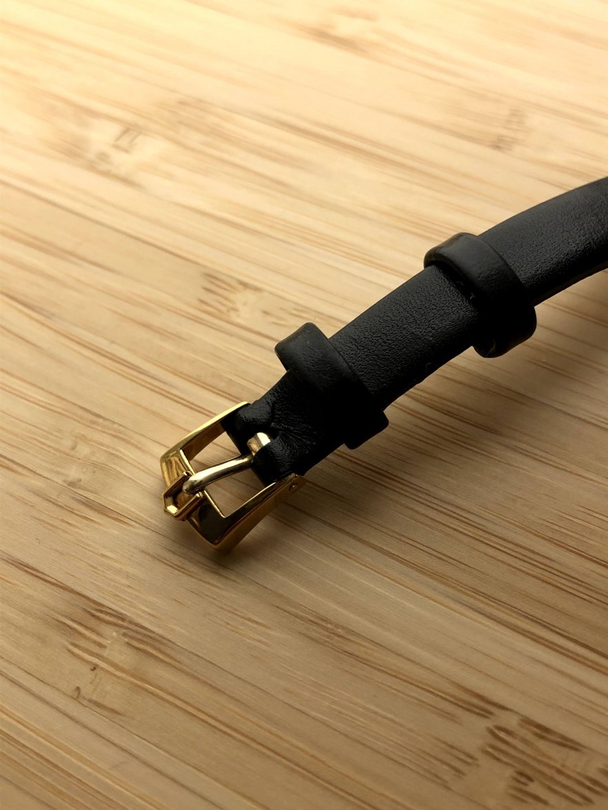

Thanks Ben, I feel like it was a collaborative project with all the help I got.
I also paired it with the 6mm buckle I got from you!

Congrats. Persistence pays!
3,687
8,498
looks good, I will keep an eye out for a SS one as well
270
624
That'll be great! I got a SS buckle in 9mm which can work with a non tapering strap, but smaller definitely would be nicer.

Really great job! If your lady wouldn’t mind would really be interested in wrist shots.
7,689
22,049
Really great job! I go your lady wouldn’t mind would really be interested in wrist shots.
Agree, I would love to see one too!👍
