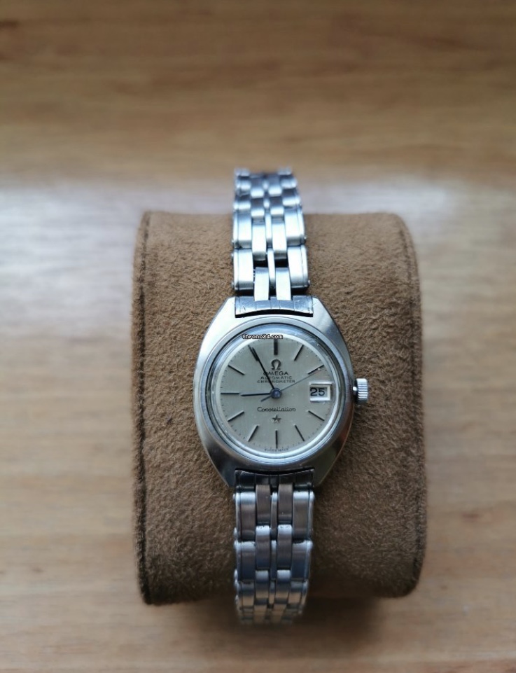

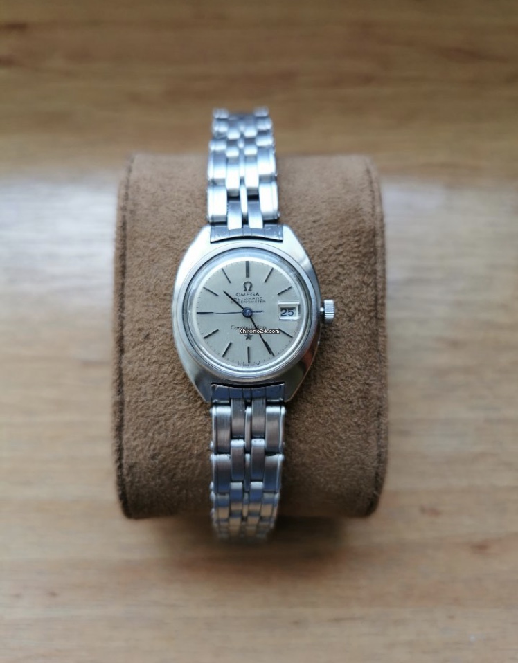

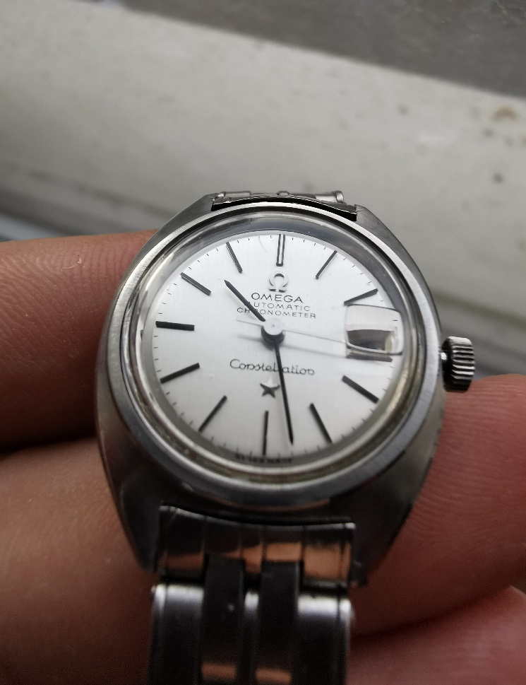

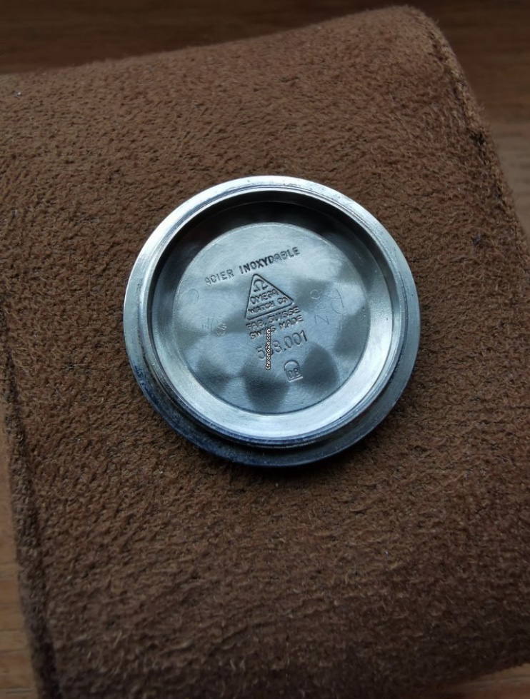

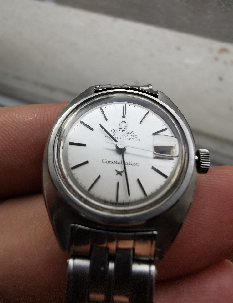

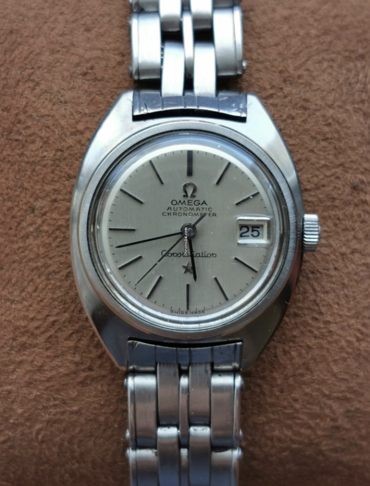

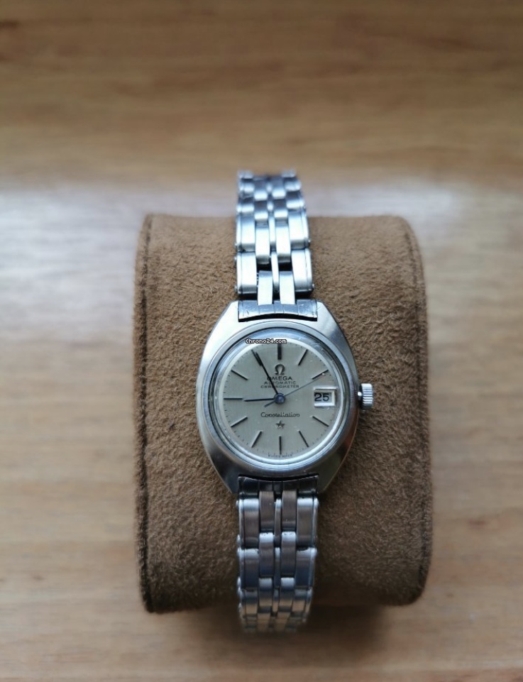

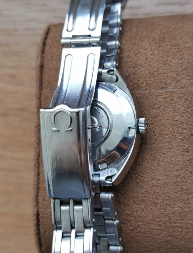

Having viewed a few ‘tarted up’ examples, I came across a not so tarted up example, from a private seller on Chrono24. Now I know I have to be a little careful on there, but as I have said, these watches aren’t that common! Ideally I’d purchase one from here.

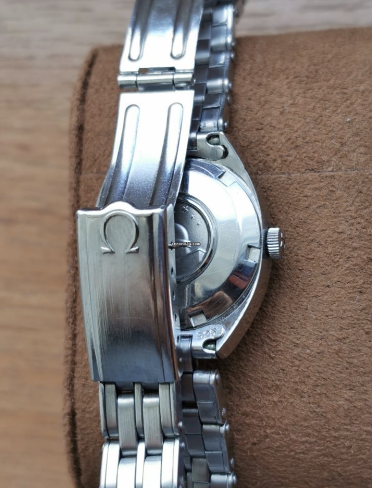

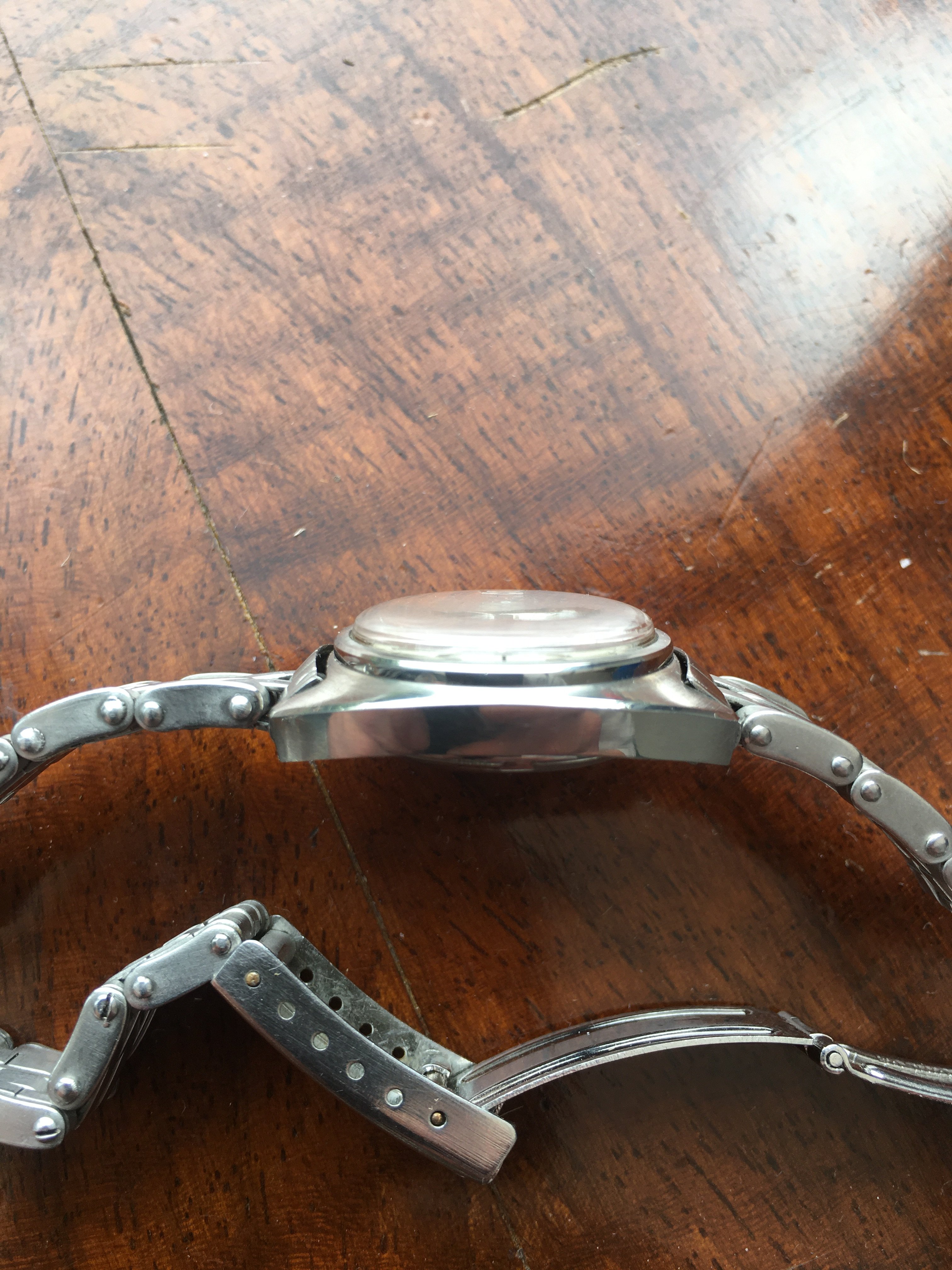

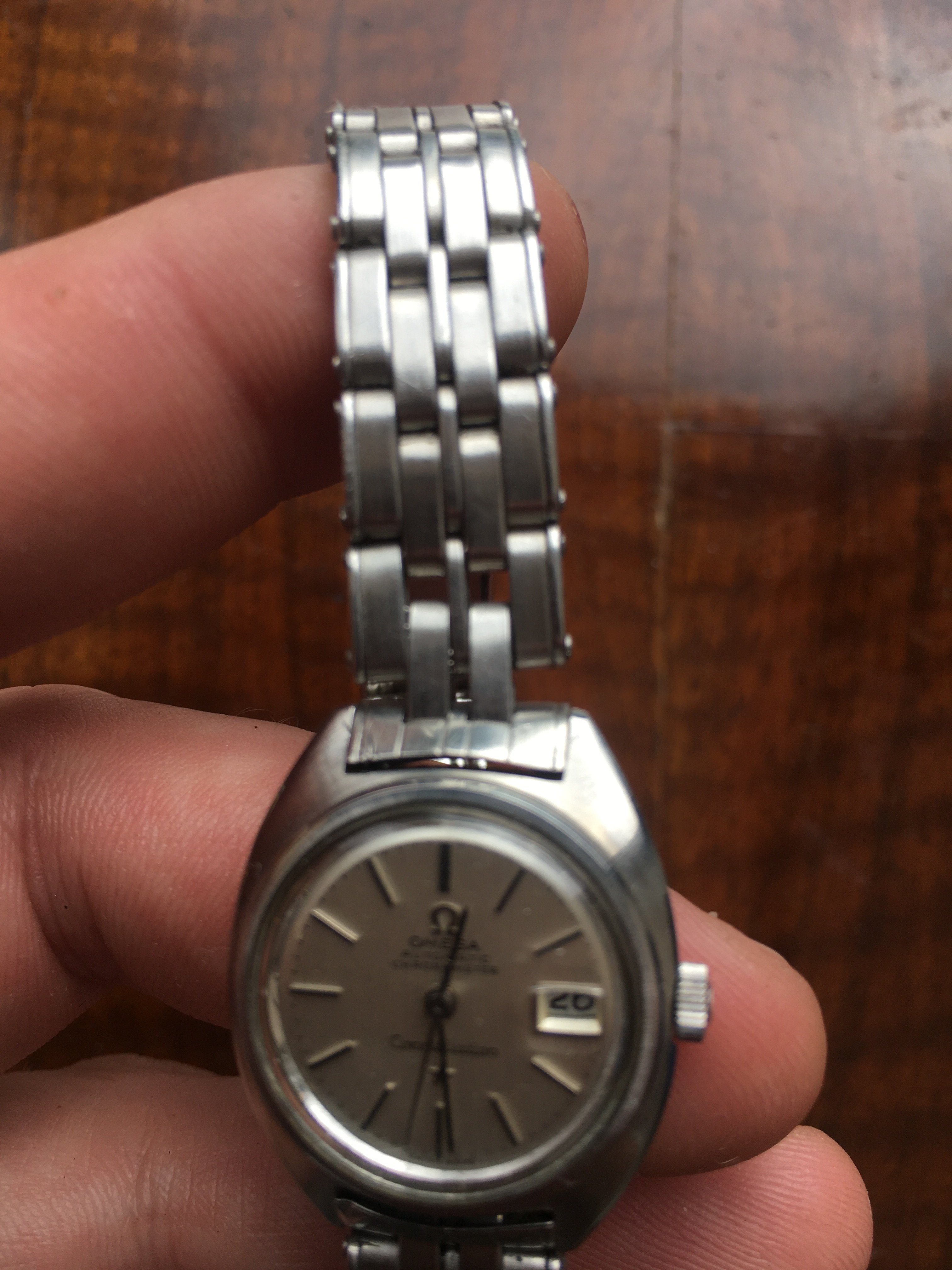

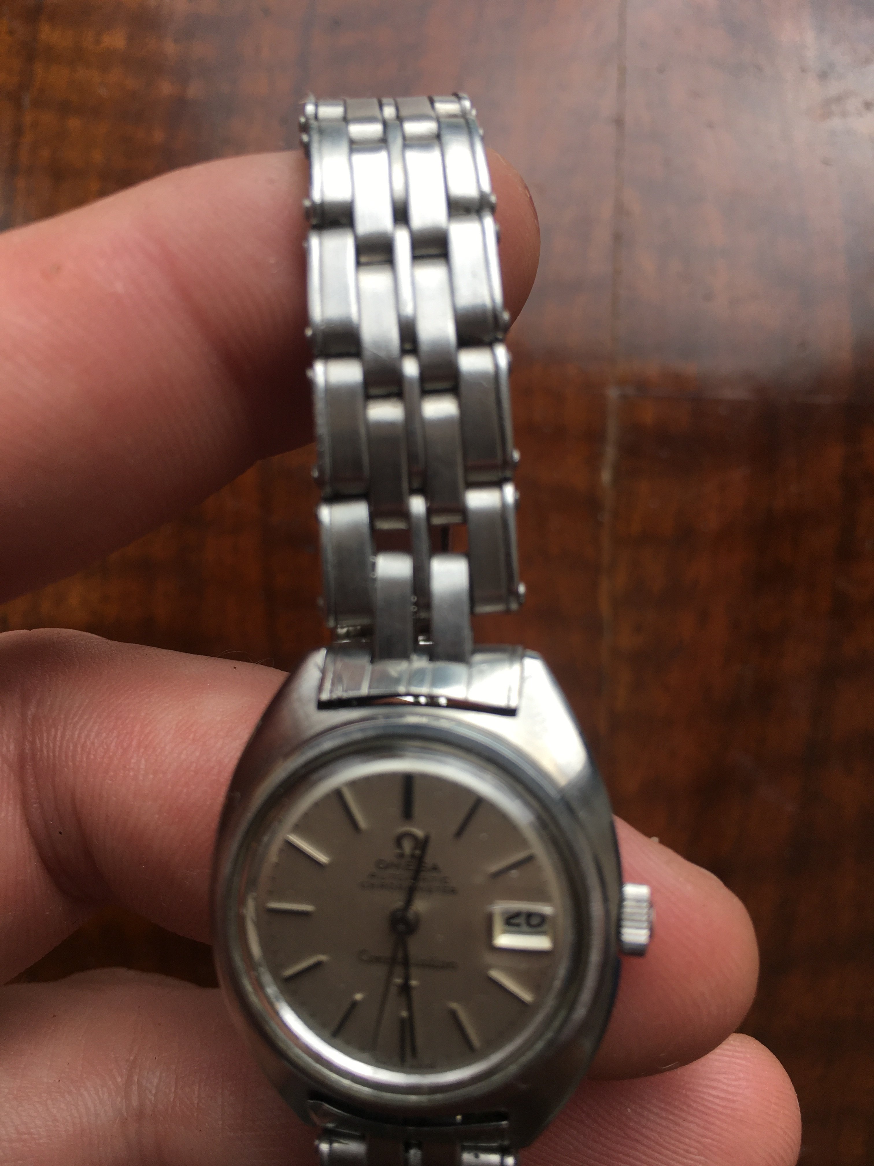

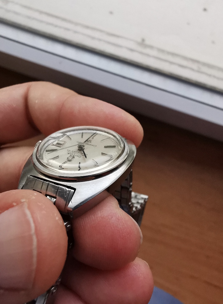

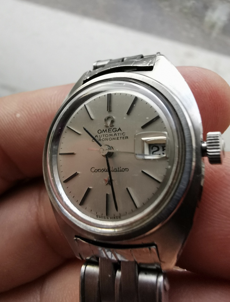

The watch in question is a 568.001 and is circa £300. The seller will accept offers. To my eye, It looks all original, and on closer inspection really doesn’t look too bad. It had a stretched bracelet, but I would swap that out for a nice leather number and re use the clasp if possible?

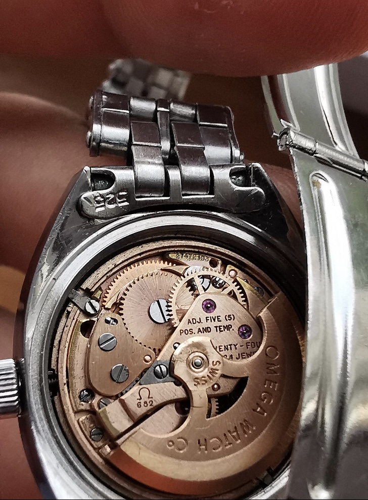

The movement runs, but will need a service, which I will have to factor in. The serial dates it to 1968. The case has sharp edges and chamfers, and the original brushing can be seen on the bezel. The crystal is signed and doesn’t look like it’s in bad shape.
The dial looks clean and original, the fonts look factory correct, and it doesn’t have T Swiss made T, which appears to match up with the non lume hands, which again I think are correct? The crown is signed, but I’m not sure about whether it is original.
photos are below, but I would appreciate any info or advice/opinions from the forum! Is it worth a punt? Or do I keep on searching?
Thanks for reading!

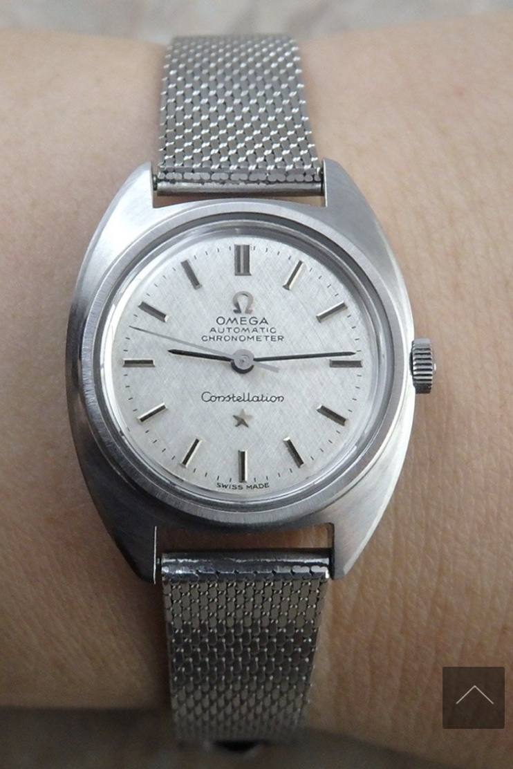

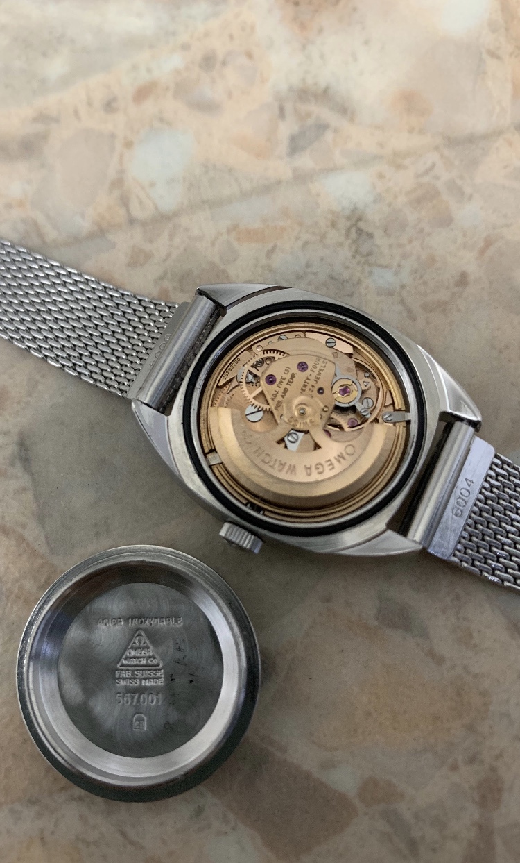

For comparison, below is a similar watch for sale in Japan, for approx £800. It looks nice, has a linen dial, nice bracelet, but I suspect it has a refinished case and will need a service.. would be expensive by the time it lands in the U.K.
1,372
2,001
I (personally) don't think that the case on the Japanese one has been touched, but I only have my own Connie to go by in that regard. I've bought a couple of Dynamics from Japanese sellers that looked brand new but case measurements showed that they had not been refinished.
Given that both watches will need a service before regular use, I'm not certain the linen dial is worth *that* much extra money. If the bracelet clasp is like any other Omega clasp from that era, it would take some doing to adapt for reuse on a leather strap. I'd probably see the bracelet could be tightened up a bit if the intended recipient wants a tighter fit.
As an FYI, the 568.xxxx models are ones with dates, 567.xxxx are time only.

I don’t think the Japanese one will be worth the £, once I factor in shipping, taxes and a service. In fact, I’m pretty sure it won’t, hence me considering the first option. I can’t see any obvious alarm bells, but I’d interested to hear what others think. I’m also open to other options, I may not have considered.

No obvious alarm bells on the first one to my eye. Looks like an honest example of a daily wearer. You'd be shocked at what a round through an ultrasonic cleaner can do for a case and bracelet, and hopefully the crystal can be saved (as I'm not certain if the cyclops version is available anymore).

First watch looks good to me and is not outrageously expensive. My wife owns this ref, although hers has tritium dial + hands. I guess this is somewhat obvious but these watches are very petite and look more like jewelry when on a bracelet.

I think the first one looks very good. If my one (mis)adventure on Chrono24 is anything to go by, they do make returns and refunds quite easy. Personally, I would prefer this one on a black leather strap. Let us know what you decide!

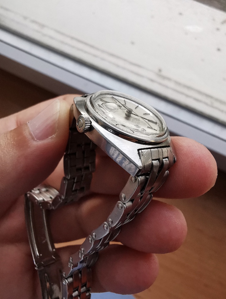

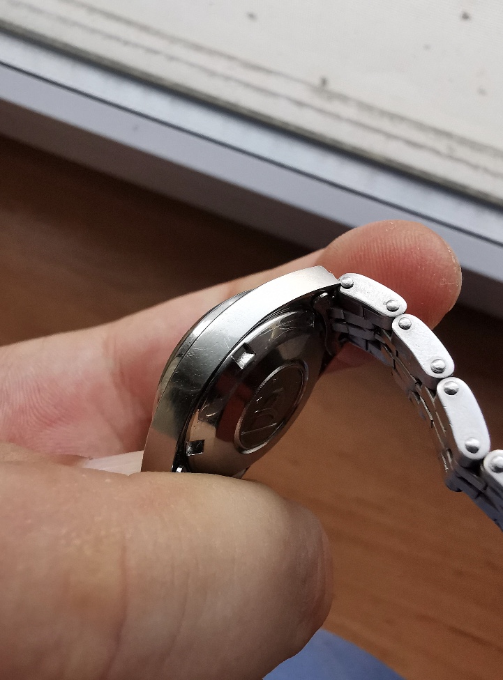

I don’t suppose anyone knows the lug width for these? I’m just considering strap options.

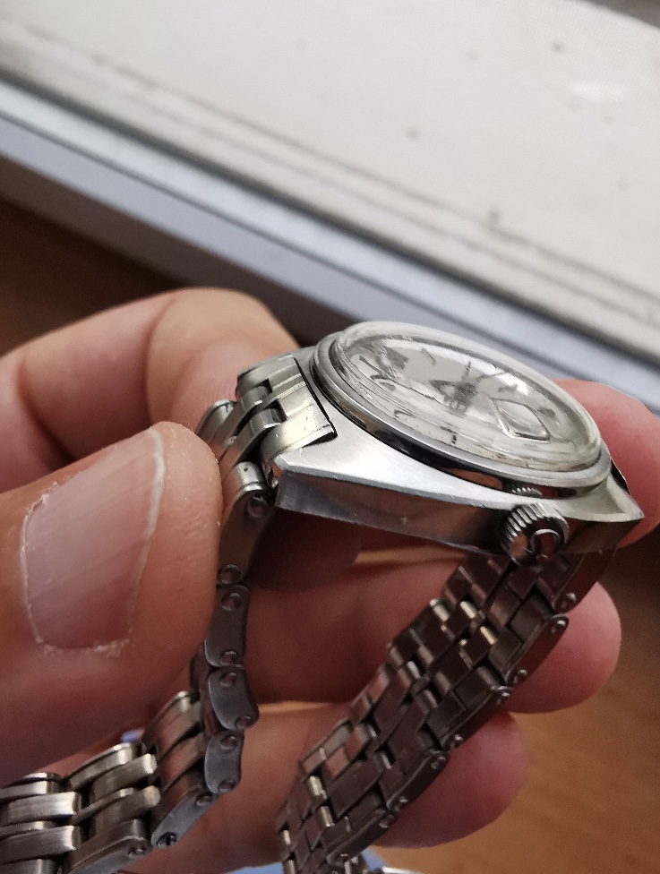

Regarding the stretched bracelet links on the first watch posted, what are my options regarding repair? It looks like it’s only the links nearest the case, in which case, could I remove said links and shorten the bracelet? The links look riveted in, rather than held with pins that could push out?
Thanks for any help.

Well, I submitted a cheeky offer to the seller, and accepted his counter offer. I shall keep you all posted once it has arrived and I’ve assessed it.

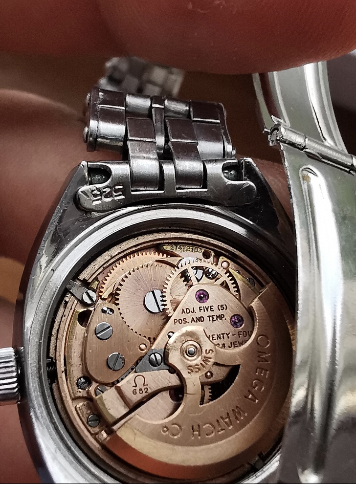

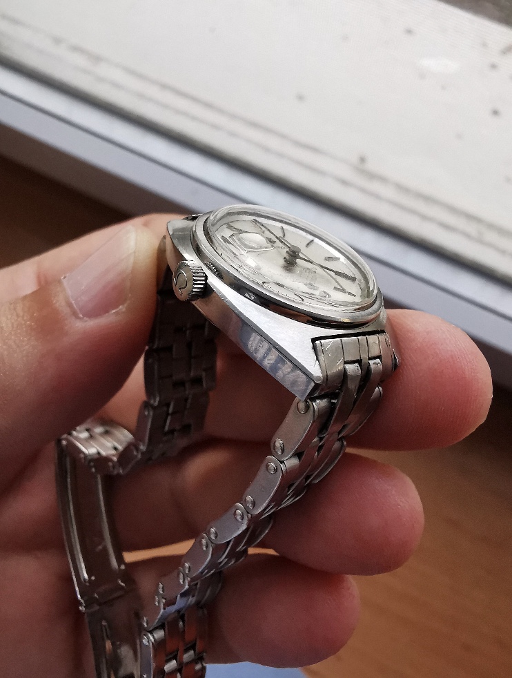

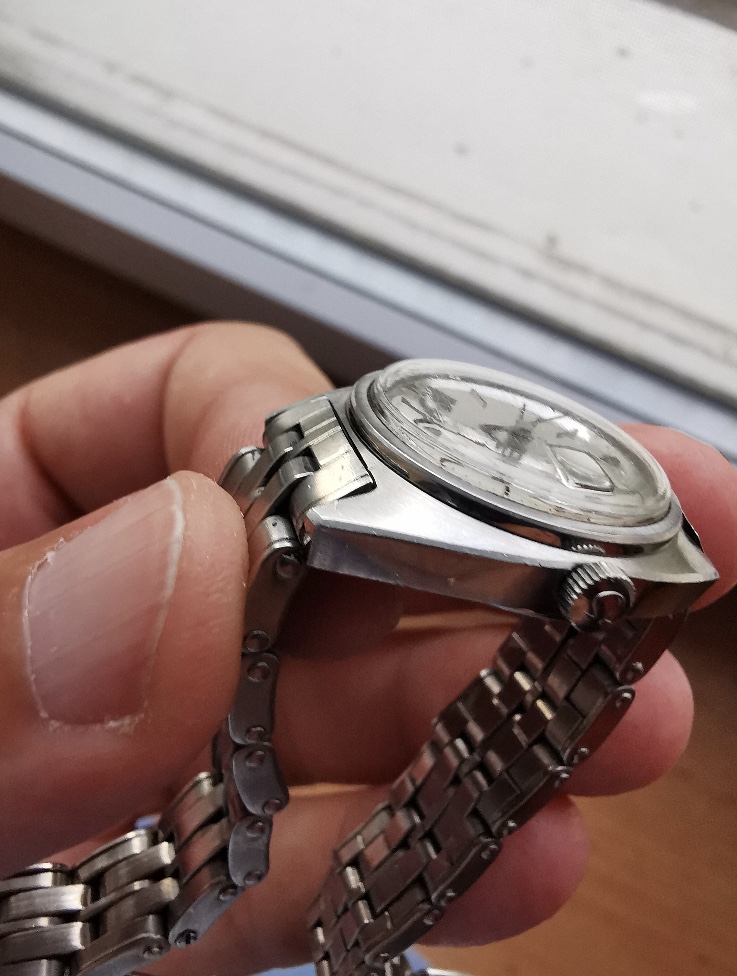

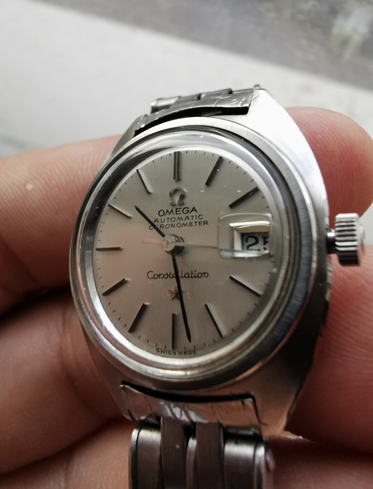

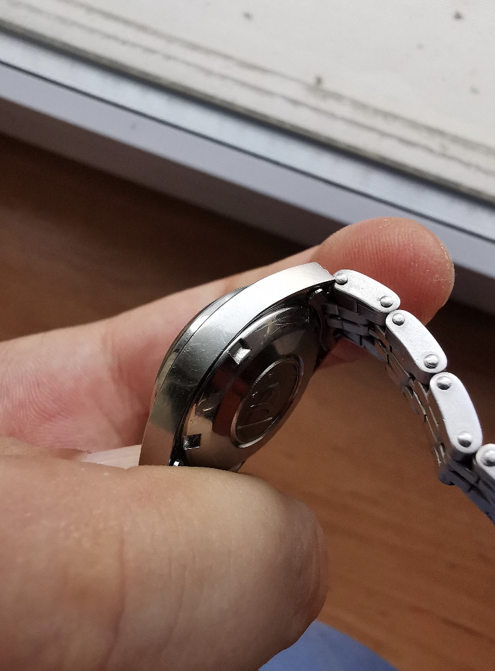

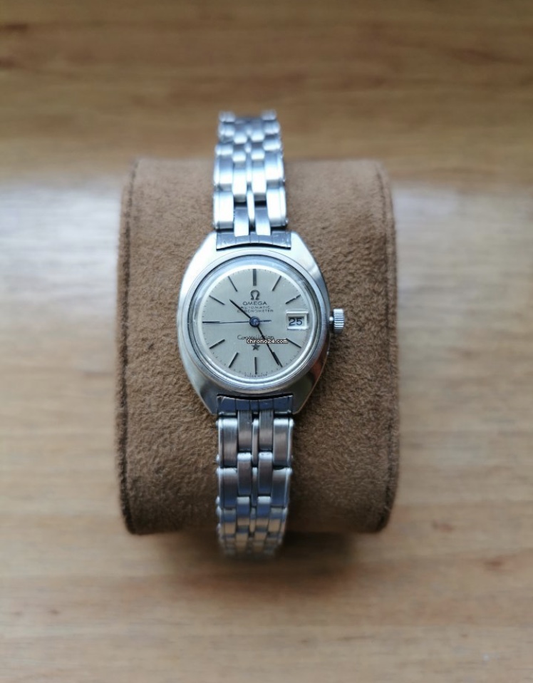

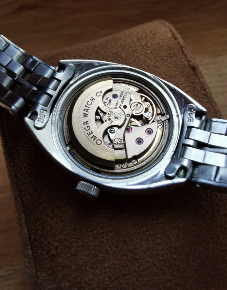

Well...it arrived today! And no customs fees, which a result!
I took a gamble, and I think it paid off. The watch is far nicer than I thought it would be. Case and dial are excellent for their age, movement looks clean, and seems to run well. I shall get it in for a service soon. The only issue is the stretched links near the end links, but it looks like it could be an easy fix. I’ll let the photos do the talking...
