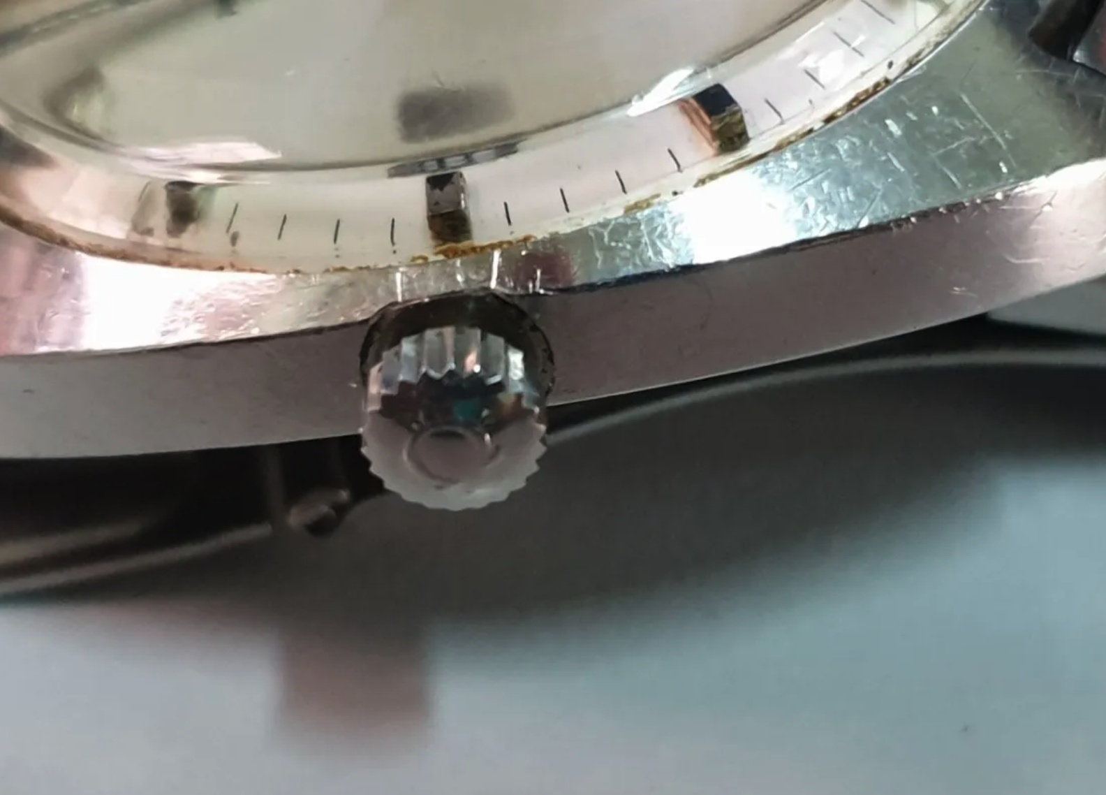

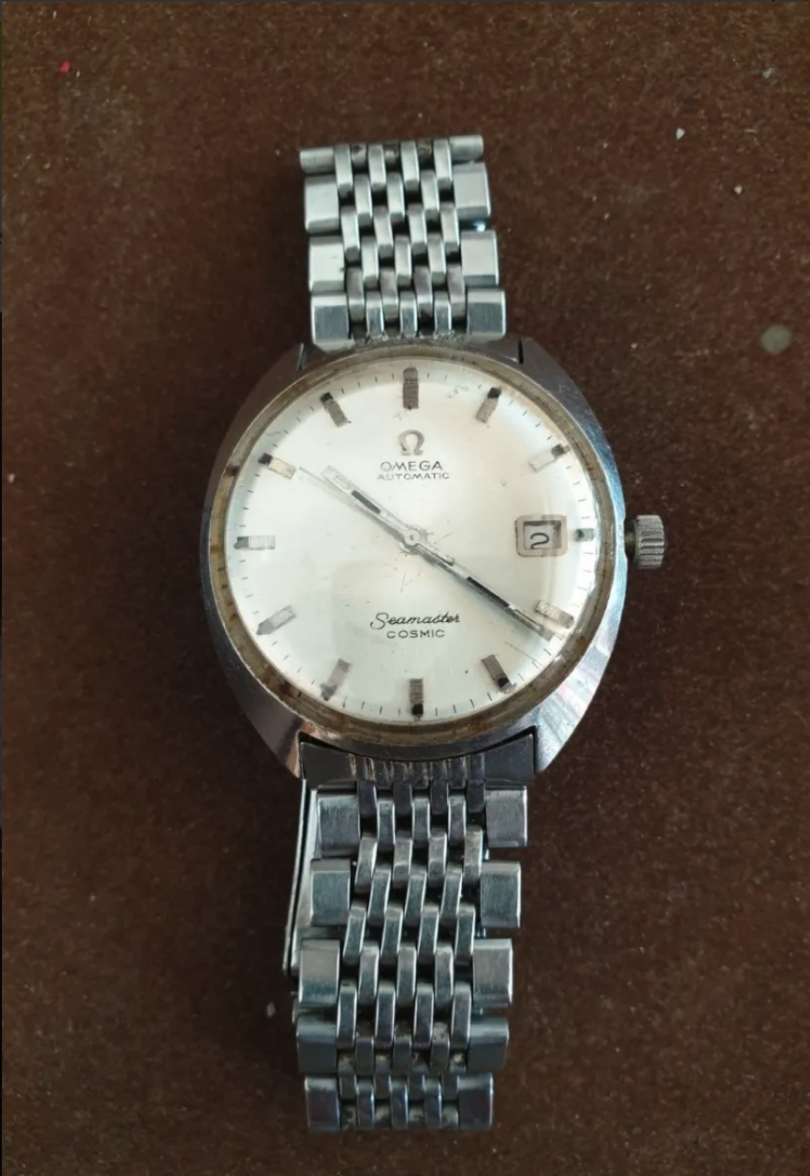

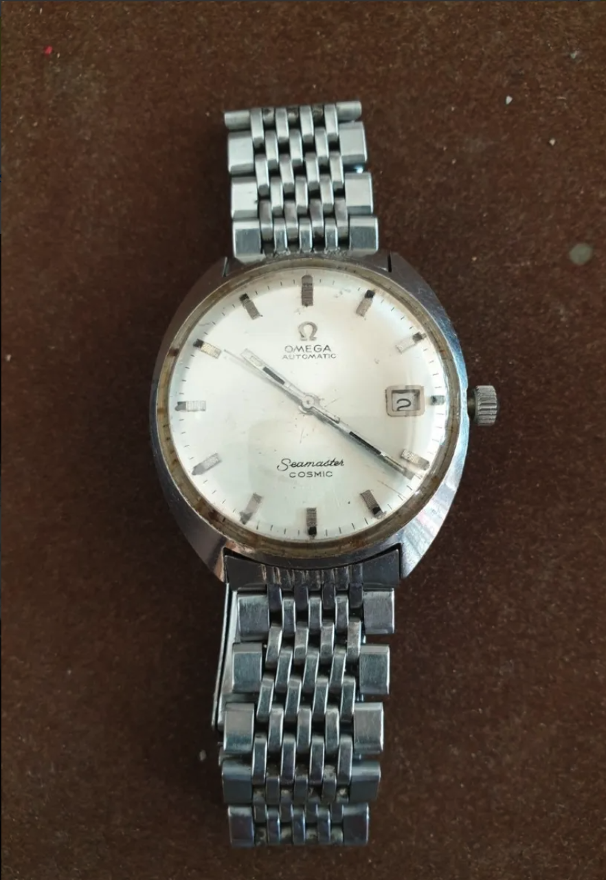

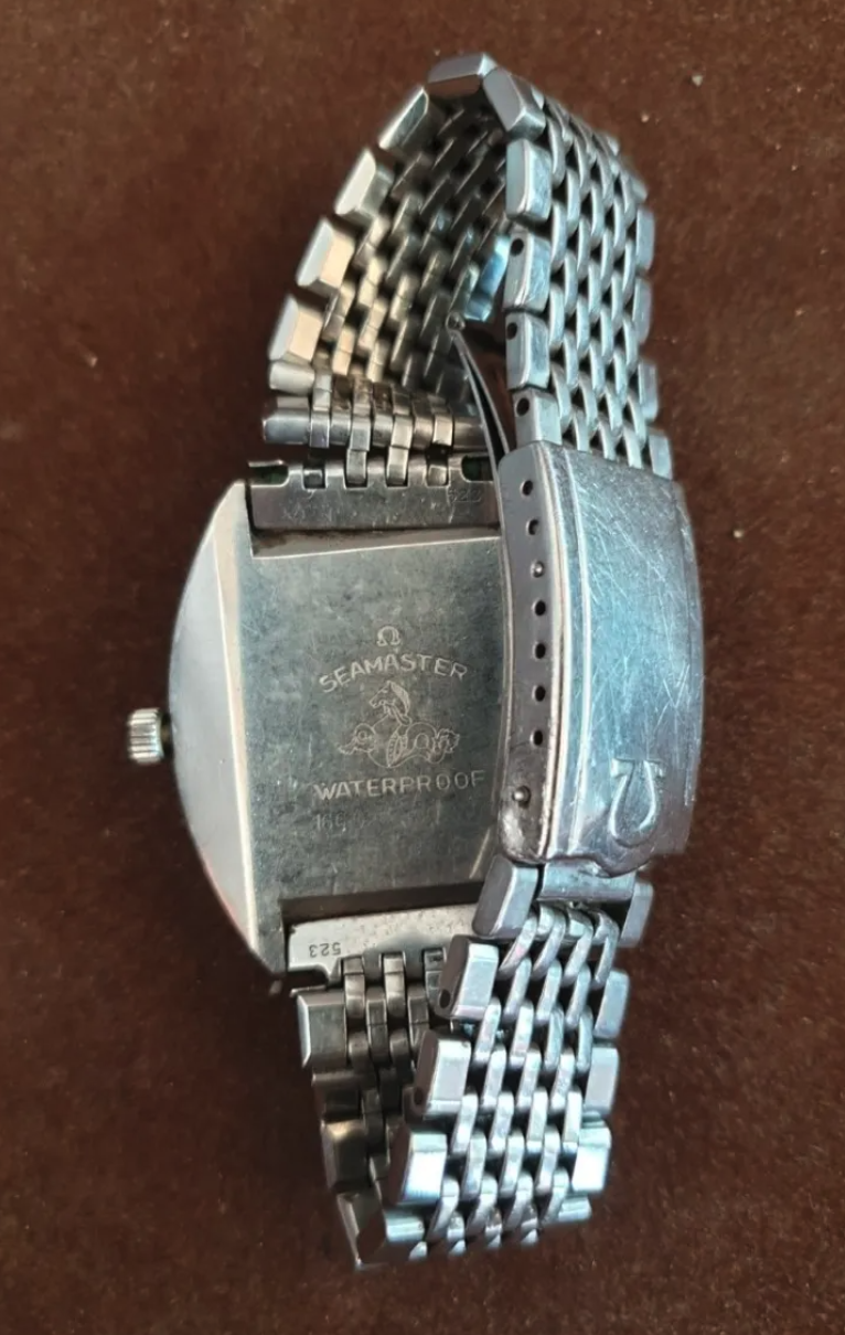

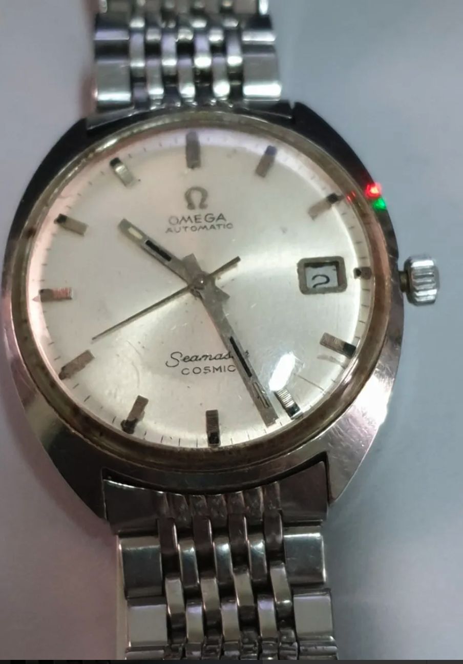

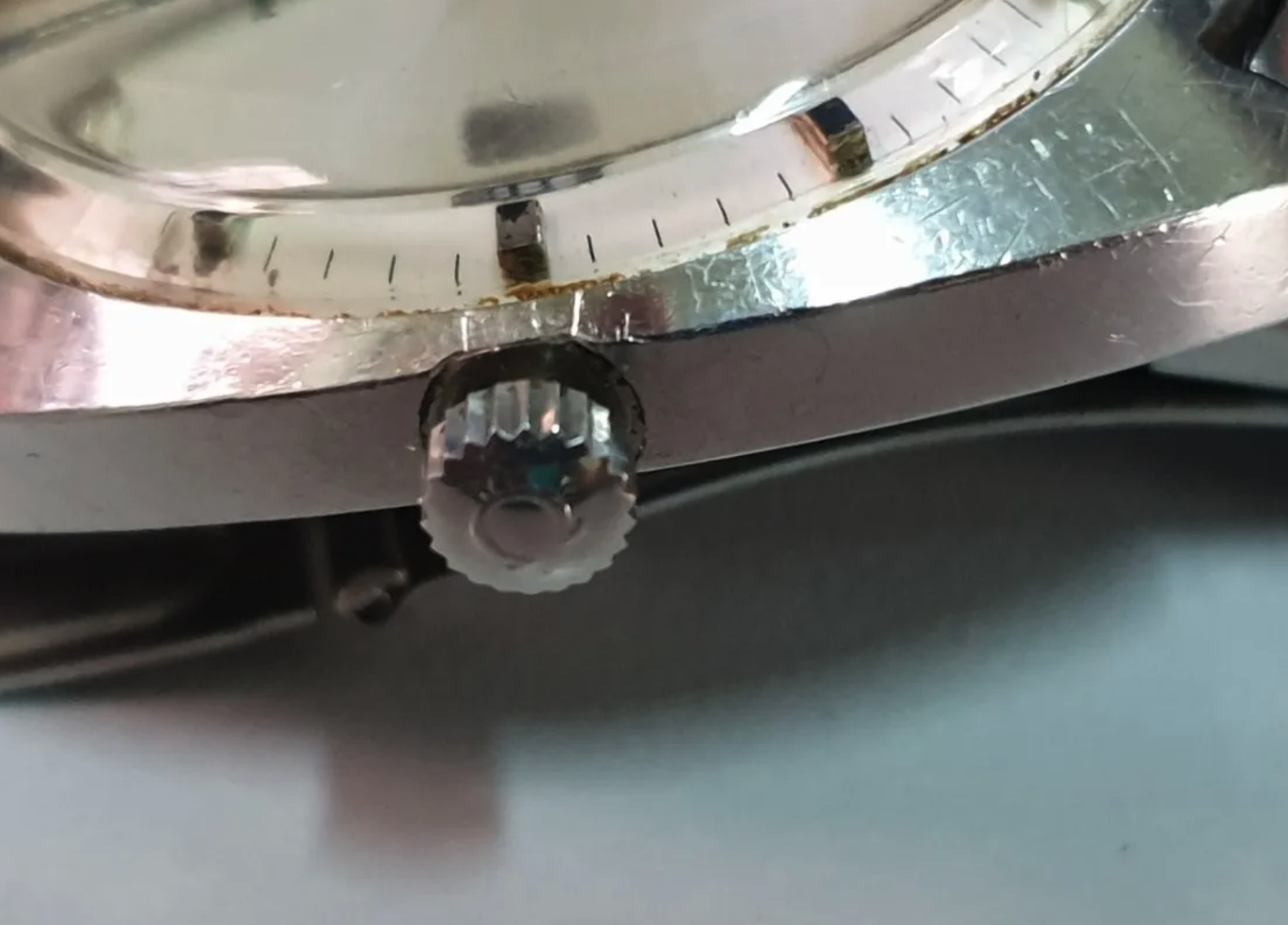

I am a total newcomer to this forum so apologies for my complete lack of knowledge. I own an early 2000 rolex submariner and a late 90s seamaster. I have wanted a really vintage seamaster for a while now as a project and i found this today. It seems legit, the crown seems original, although looks a bit loose. The strap is original, however the face looks a bit off, I cant see the swiss made text at the bottom of the face. (is this always on all omegas?). The second hand also looks a bit short. I wondered if anyone would have some insight on what vintage and what kind of price I should be paying for a watch in this state. Apparently it is fine mechanically. The back is worn, but I can just make out 166.026.
Due to lack of experience I don't know if it has been repaired badly, or something else.
Looking forwards to hearing from you and becoming part of this group.

I am going to leave as is. I am a little concerned about the state of the watch and if it is a a reasonable project for a complete novice. Also what cosmetically needs to be done. Ie is the second hand non original, and does the lack of Swiss made on the face an issue. All guidence in this would be very gratefully accepted.

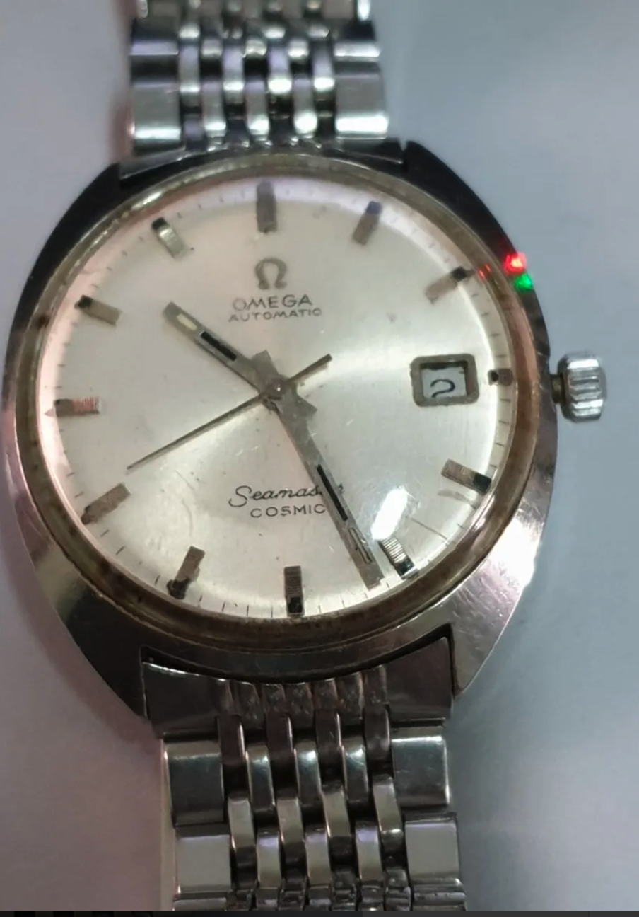

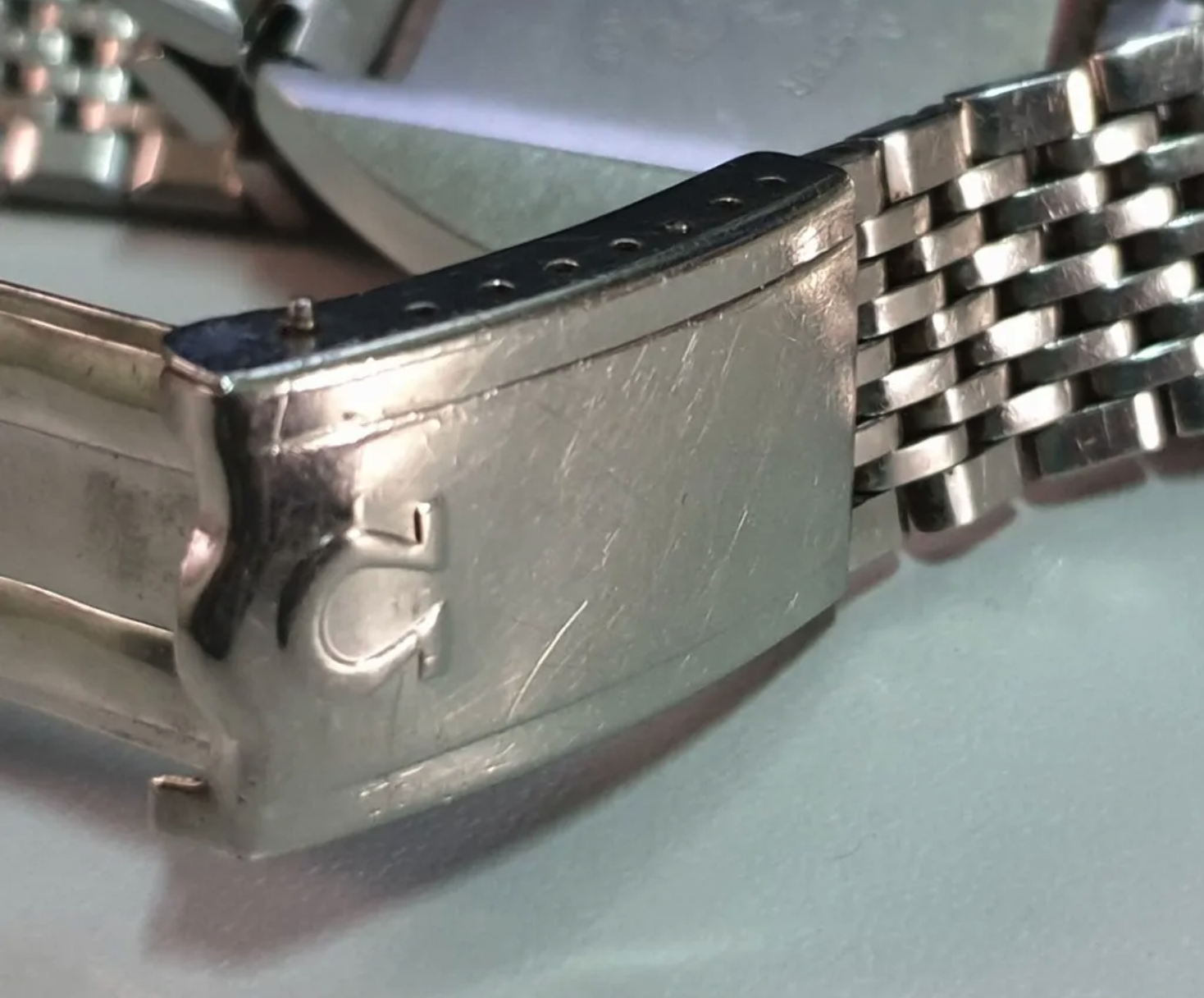

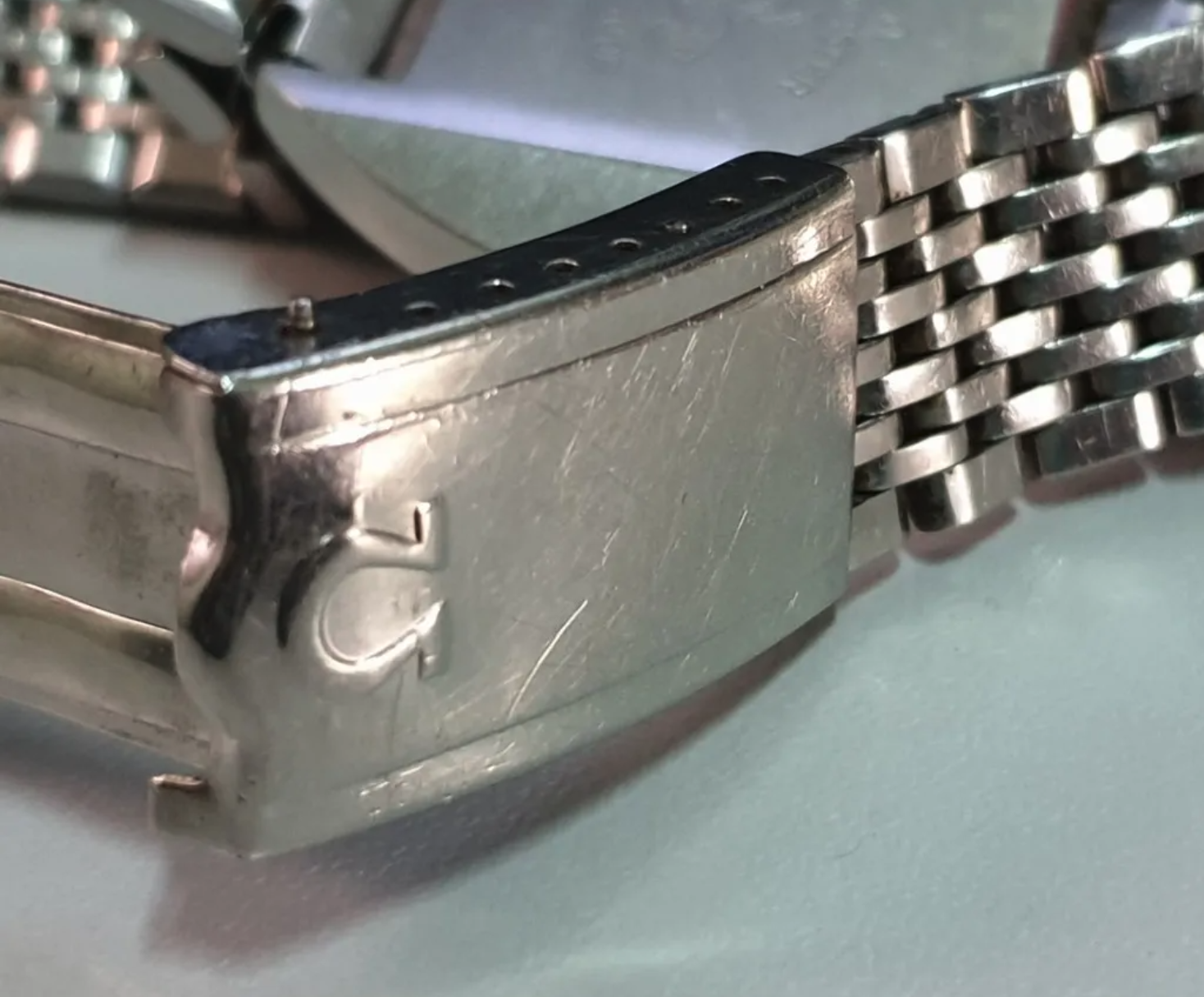

I thought that the second hand seemed a bit short, but looking at some other watches of a similar model it seems like this is correct. My main concerns would be the fact the watch seems to have had a hard life. It needs a good clean and a service. Is there a problem with the crown as to why its sticking out or it just hasn't been pushed in correctly? Also things like they haven't bothered to fit the correct length spring bar on the clasp and that the bracelet has been stretched around the end links at the top makes me think it's been roughly treated.
That said my main concern would be the dial. Potentially a new cyrstal/repolished crystal would only add to highlighting any flaws with the dial. Its a bit difficult to see from the pictures but it does look as though there's quite a few small scratches etc. on the dial. If you're OK with that I'm sure it could clean up OK, but the faults on the dial would certainly bug me and reduce my joy of looking at the watch.
What's the asking price?

Thank you for your insight. The asking price is a little under $200. Considering the condition, and the amount of work needed is this reasonable?

I would say it's reasonable for this watch with the original bracelet, although by the time a service is factored in you'll probably looking at having spent the best part of $500(perhaps more, as I've recently seen some very high service quotes from the US). Once you start getting into it for that kind of money you should be able to pick up a much nicer cosmic that I'm sure you'll be much happier with in the long run.
To cut to the chase, I would pass on it purely because of the issues with dial. Had the dial been in really nice condition but the watch still had the other issues it has, I would have said go for it. For me it all comes down to the condition of the dial on this one.
I'm sure there are other members that may disagree, and would perhaps view this as a reasonable parts watch(especially for the bracelet), but that's my opinion on the watch.
Best og luck whatever you decide.

For just under $200 I would snap that up just for the bracelet 😉
Just buy It before someone else does.
A service and you have a nice Seamaster on bracelet for $500 👍
2,346
1,475
For $200. Flip the average bracelet for $125 and watch costs $75.00. Flip the watch for $250 and let someone else worry about it.

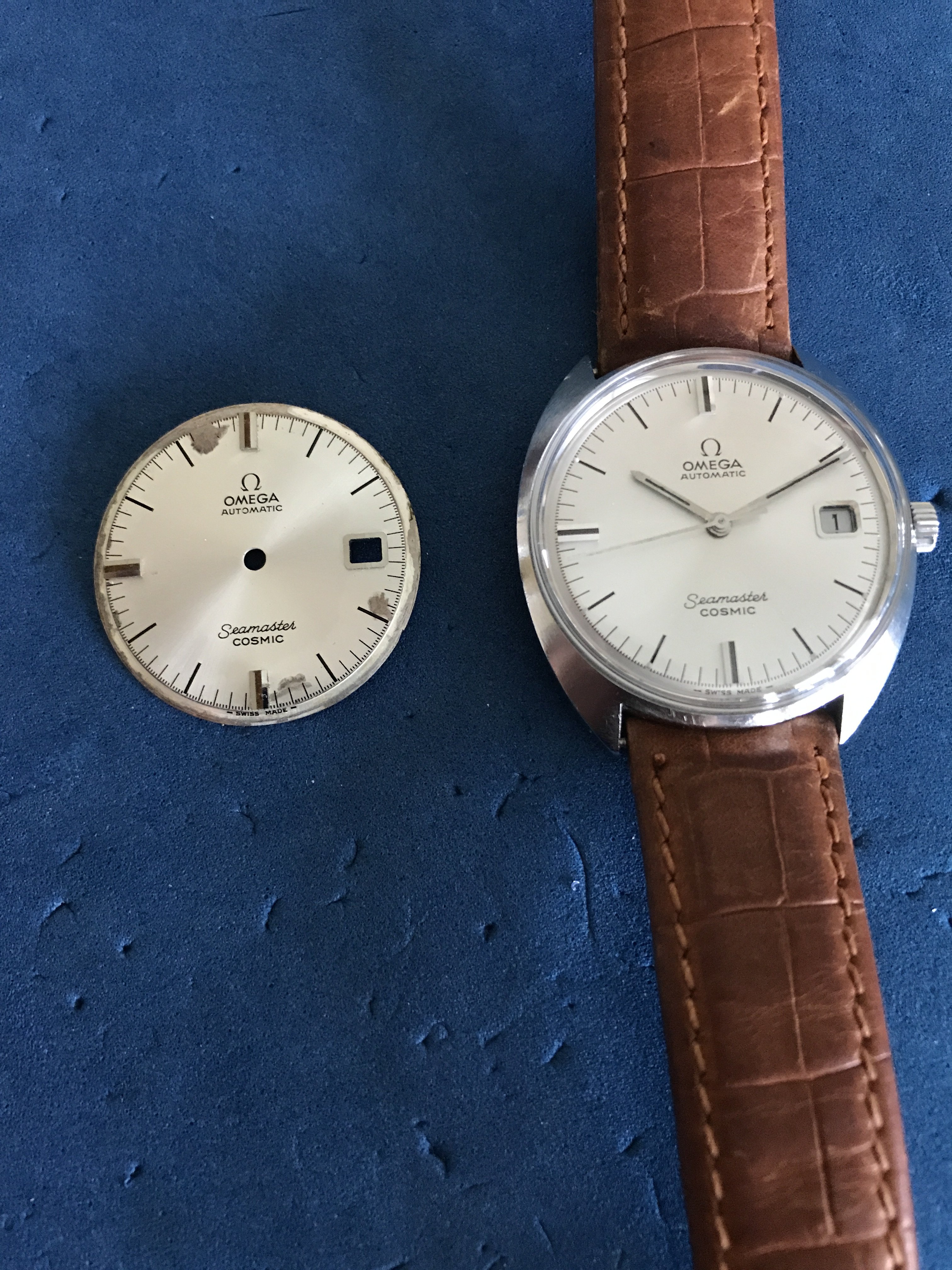

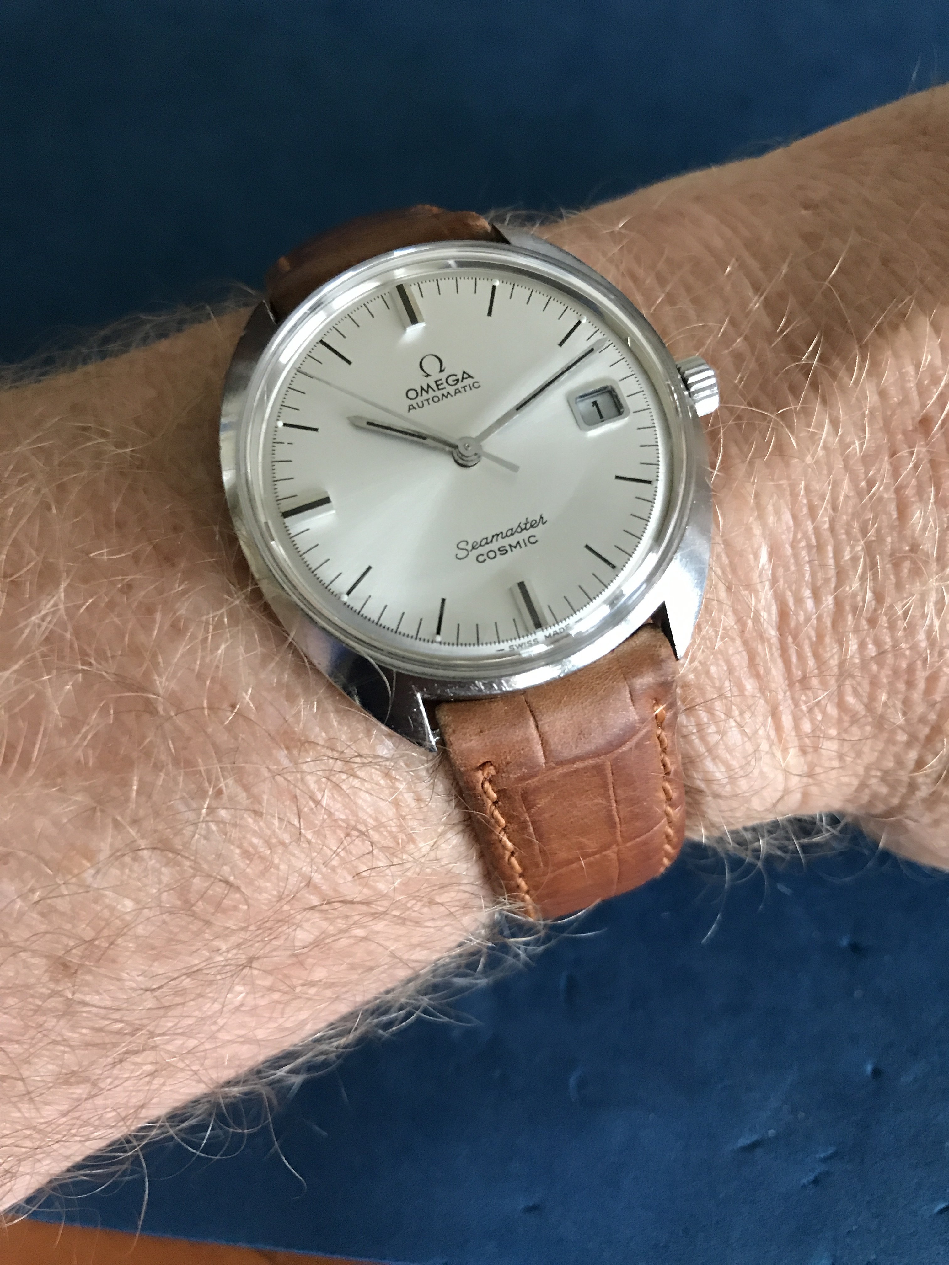

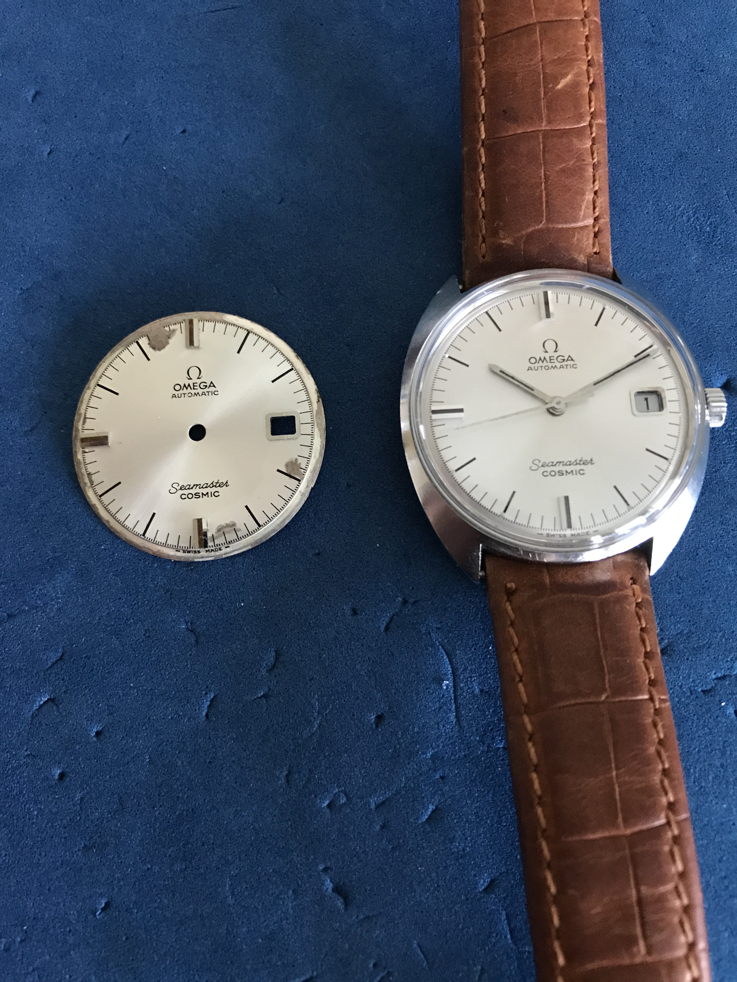

My second Vintage Omega was a Seamaster Cosmic. Only cost £100, but the dial had to be changed at a service about 8 years ago now - i think the replacement dial cost £120 from Omega. Certainly looks nicer, but looking at the photos i took recently, i notice that one of the lume plots is missing ( didnt spot this in 2012 after the service - doh!)
Nice watches to wear, and i certainly think the second hand should be longer

200 with original Omega brick bracelet? a barjin! great starter watch....very under appreciated...
