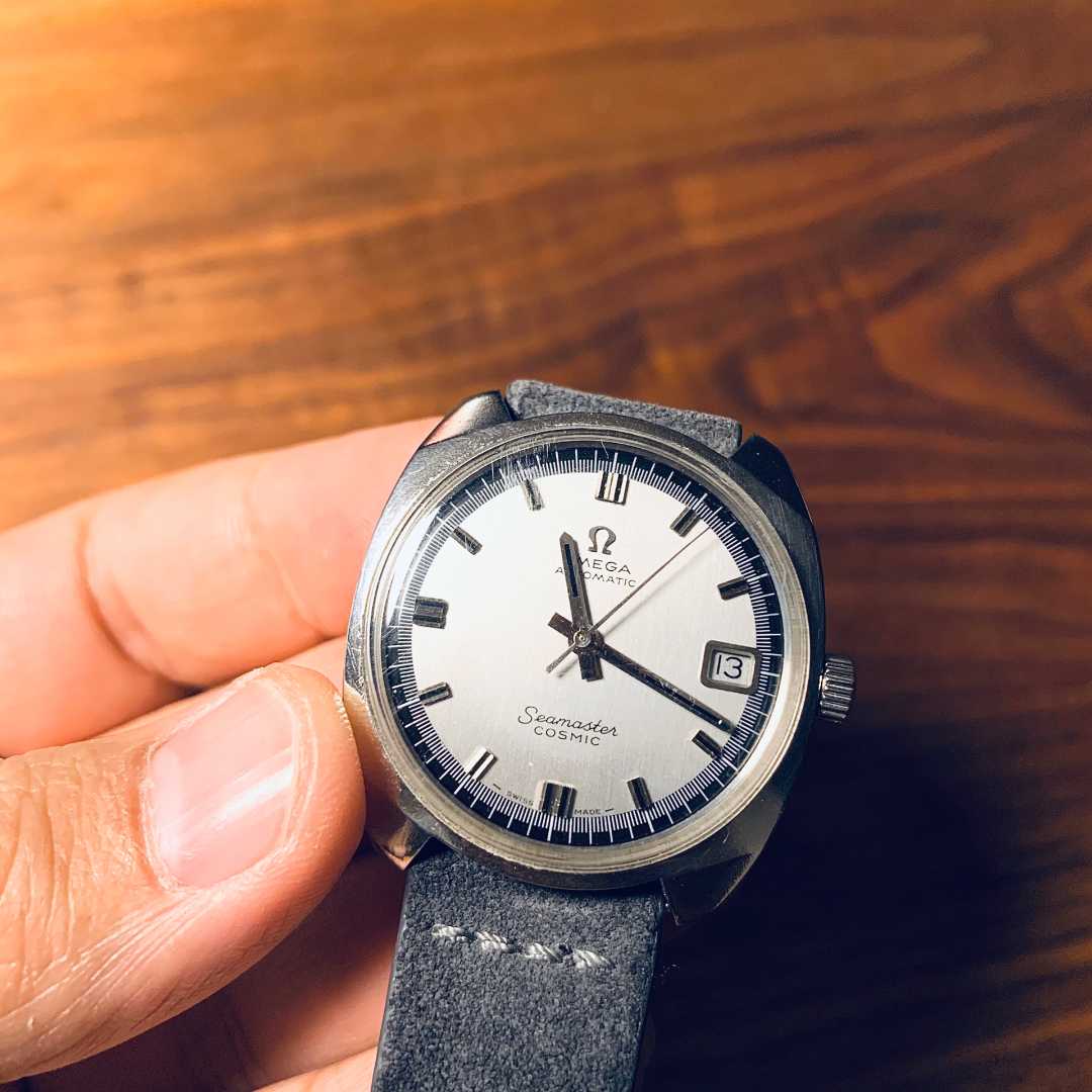

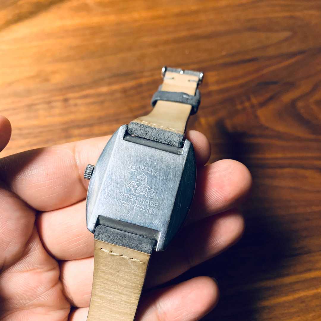

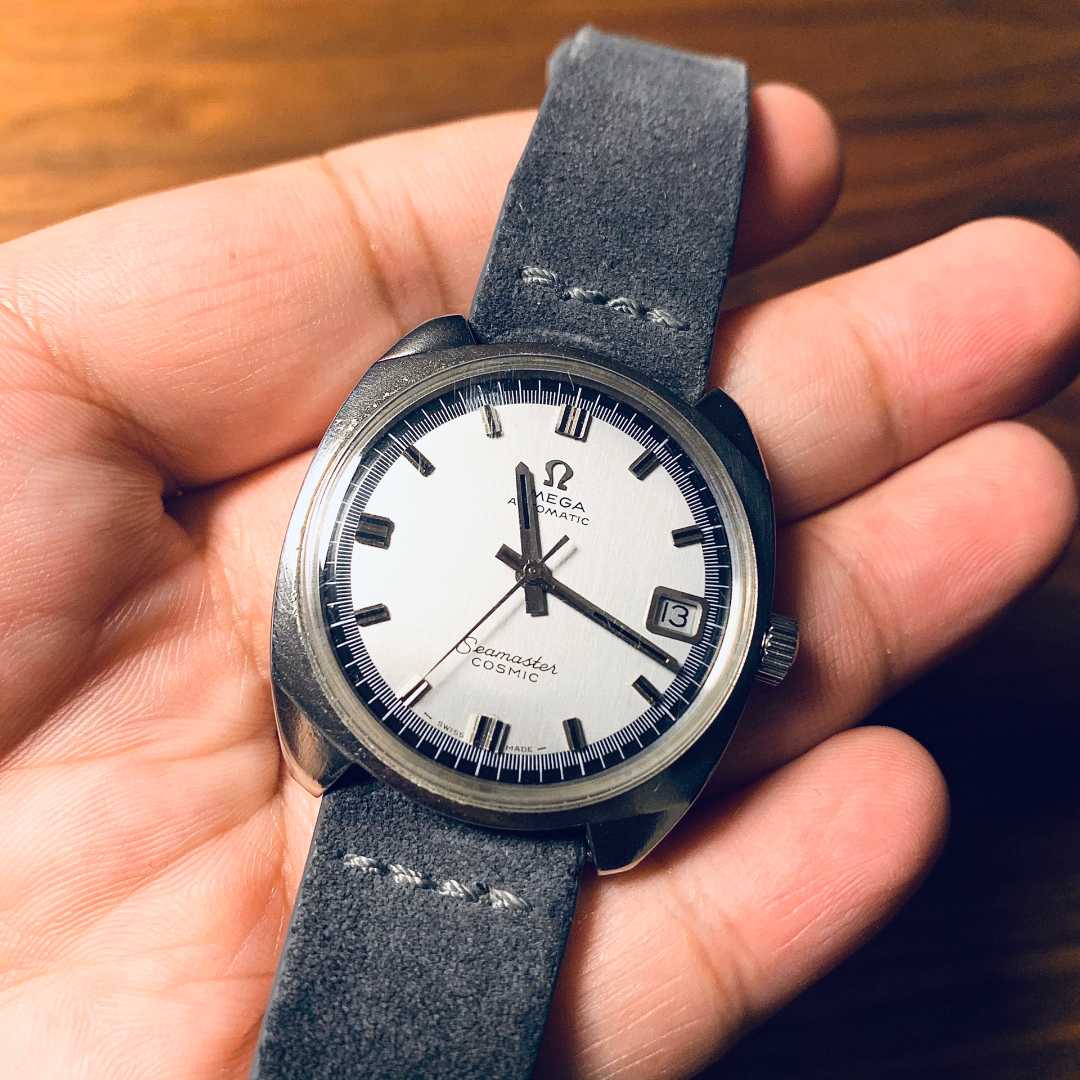

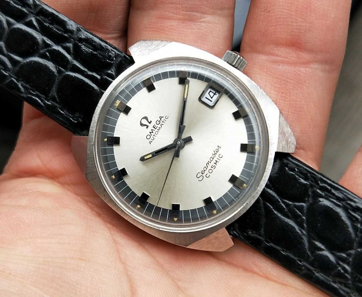

Hello, another piece I'm following is this Seamaster Cosmic, two tone. I guess the caliber is 565. Do you think the dial and case is original? Thanks.
BTW, is this old piece 30m waterproof?
13,492
31,811
Polished to death, dial is OK, but it'd be a pass on the case condition.
This is what that case should look like.

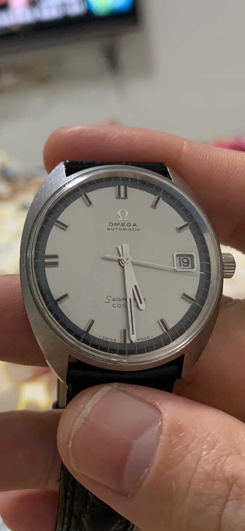

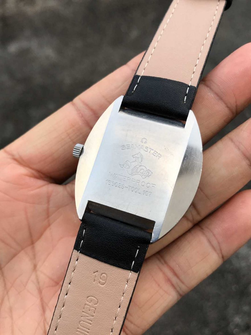

How about this one?
BTW, what's the right attitude on the expired luminous paints on the dial?
13,492
31,811
Looks much better. Old lume is old lume, part of the character of the dial. As long as it hasn’t been redone all is generally good.
