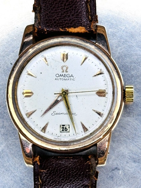

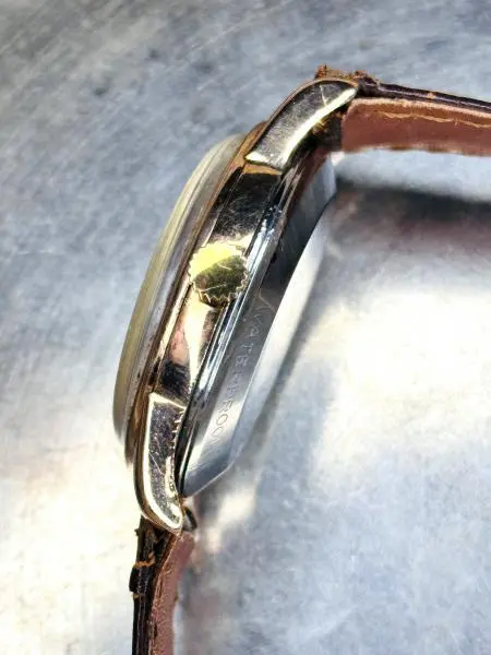

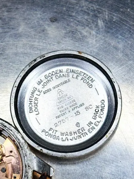

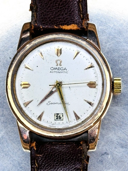

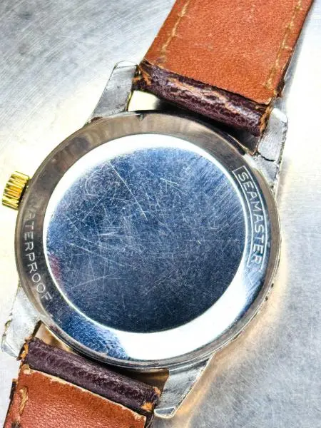

Found this SeaMaster 2627 for around 40 dollars. Should I go for it?
9
According to the seller, is currently working. Probably got a re dial in the past.

Wow, that poor thing has had a rough life- I think I even see a stainless hand and a gold one! Talk about keeping it alive out of the parts bin.
Of course first instinct at $40 is to say yes, but what do you plan to do with it?

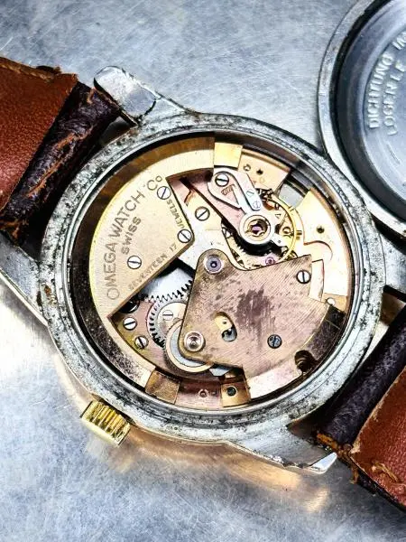

As far as usable parts….the back look nice.

just want a automatic watch with date to use in a corporate ambient, and i found this in a auction site. Looking at past auctions, will be very hard to pass the 80 dollars mark, and no one bided for it.
How useful this would be? I probably will change the dial and the bracelet.

I don’t think that you’re going to impress too many people in a corporate environment with that watch. Rehabilitating its appearance and movement will cost you significantly more than you think. I think that you would be better served by purchasing an entry level Omega in the private watch sales forum on OF or buying an entry level Omega on eBay from those recommended in the “recommended eBay vintage Omegas” thread.

I see this as either hassle or a money pit. Either way it’s going to cost me more in time or money than the enjoyment or financial value I’d get out of it so I wouldn’t buy it for $40.

Theoretically, how much probably I will end spending on it to get it back running?

Depends how far you want to go.
Full service $300-800
Bracelet $250-300
Crown $75
Dial ???? And it might take years to find one.
Case. You could leave it as is or get it refinished if the gold cap is thick enough or get a donor case.
But if you’re going to buy this, and spend over a grand getting the poor movement parts replaced and getting it serviced, along with sourcing the correct crown and possibly the dial, why not just be patient and buy a better one to start with.
At the budget end of the spectrum, you could maybe find someone to service it around $250, hope few movement parts are needed and leave it there. But that watch would give me little joy for wearing it.

found a really reputable watch maker in my city with years of experience, and he asked 90$ USD for a full service, plus parts cost if needed.
If this SeaMaster stay under 50$, I will probably get it and give it a little restoration or just re-sell it.

Please don't pay to have this watch serviced. If you buy it, and it's running, just wear it for a while until you eventually understand how ugly it is. That will be a good lesson for $50.

Missing date window bezel too, this thing is a complete mess but it's your money.
