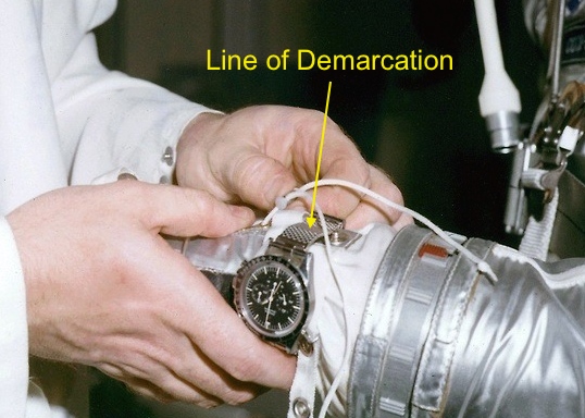

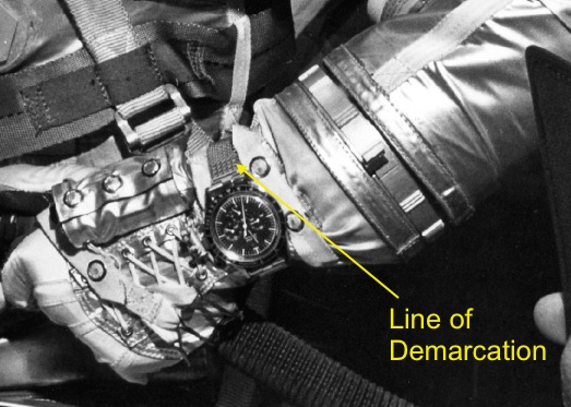

In doing a bit of research on the Gordon Cooper watch along with the JB Champion bracelet that is installed on it, it appears that both of the JB Champions he wore on his Mercury mission were surgically lengthened.
Thanks to @SpeedyPhill and some of his scanned images I noticed an odd looking line running across the bracelet about 3/4" below the end piece. In comparing the bracelet stored at the NASM and the scanned images I can now see where the additional length was added to Cooper's Bracelet.
Here is one of the images @SpeedyPhill posted of Cooper wearing two JB Champion bracelets with the odd lines running across the bracelets.
Here are two enlarged images showing the lines. The second one is credited to @SpeedyPhill as well.

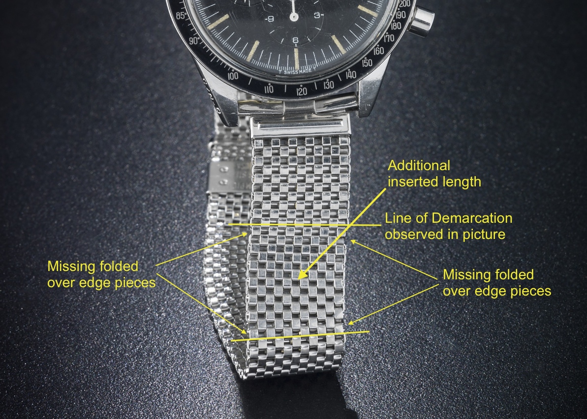

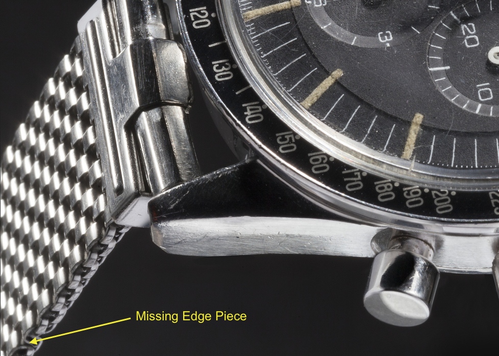

Now looking closely at the original JB Champion bracelet in the possession of the NASM you can see where the length was added creating the line observed in the original image. While the inserted bracelet mesh is the same there must have been some difference on the finished surface that caused the light from above to reflect the light differently creating the appearance of a line across the surface.
The following images are credited to the NASM.
I know this is more than anyone needs to know about the Cooper JB Champion bracelet but there you have it.

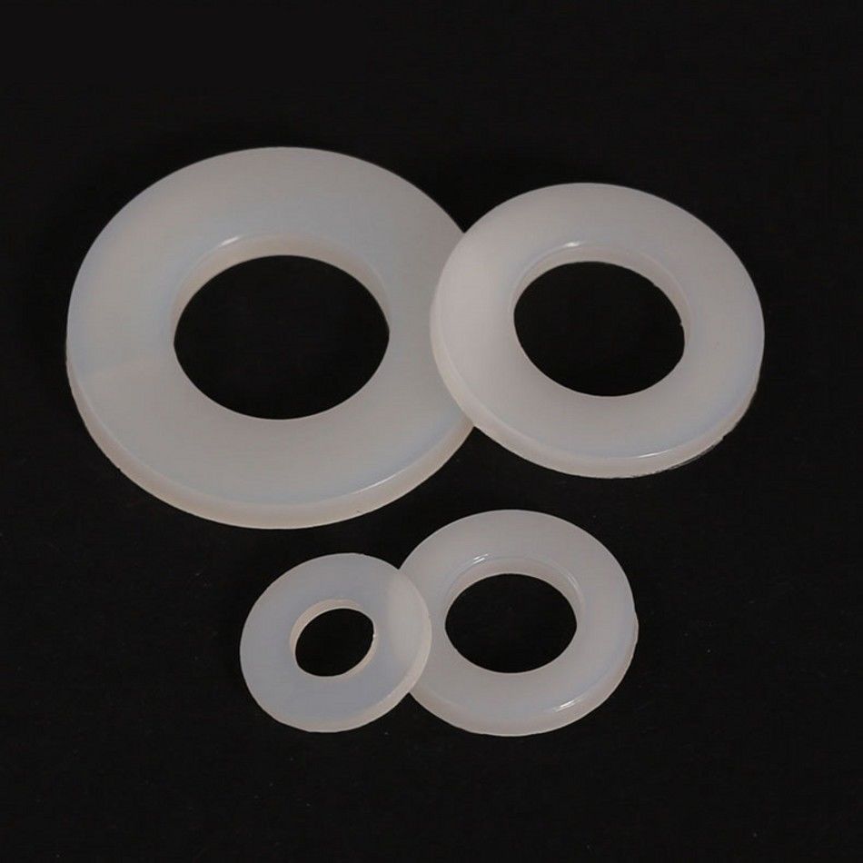

So, O- rings reign.
Not yet, but looking more and more like it. The thrust roller bearing looks good but I can't find a 1x3x1mm. 😗 🍿
15,046
24,049
1mm hole in bearing seems awful thin for a spring bar especially one with a gap. Also it seems to me you are trying to keep the outer edge of the end link from rubbing on the lug. Bronze bushing or o - ring seems to me what you want. Roller bearing is to isolate outer race from inner race ie rotation along the length of the spring bar. For side to side isolation roller bearing seems useless.
4,093
7,040

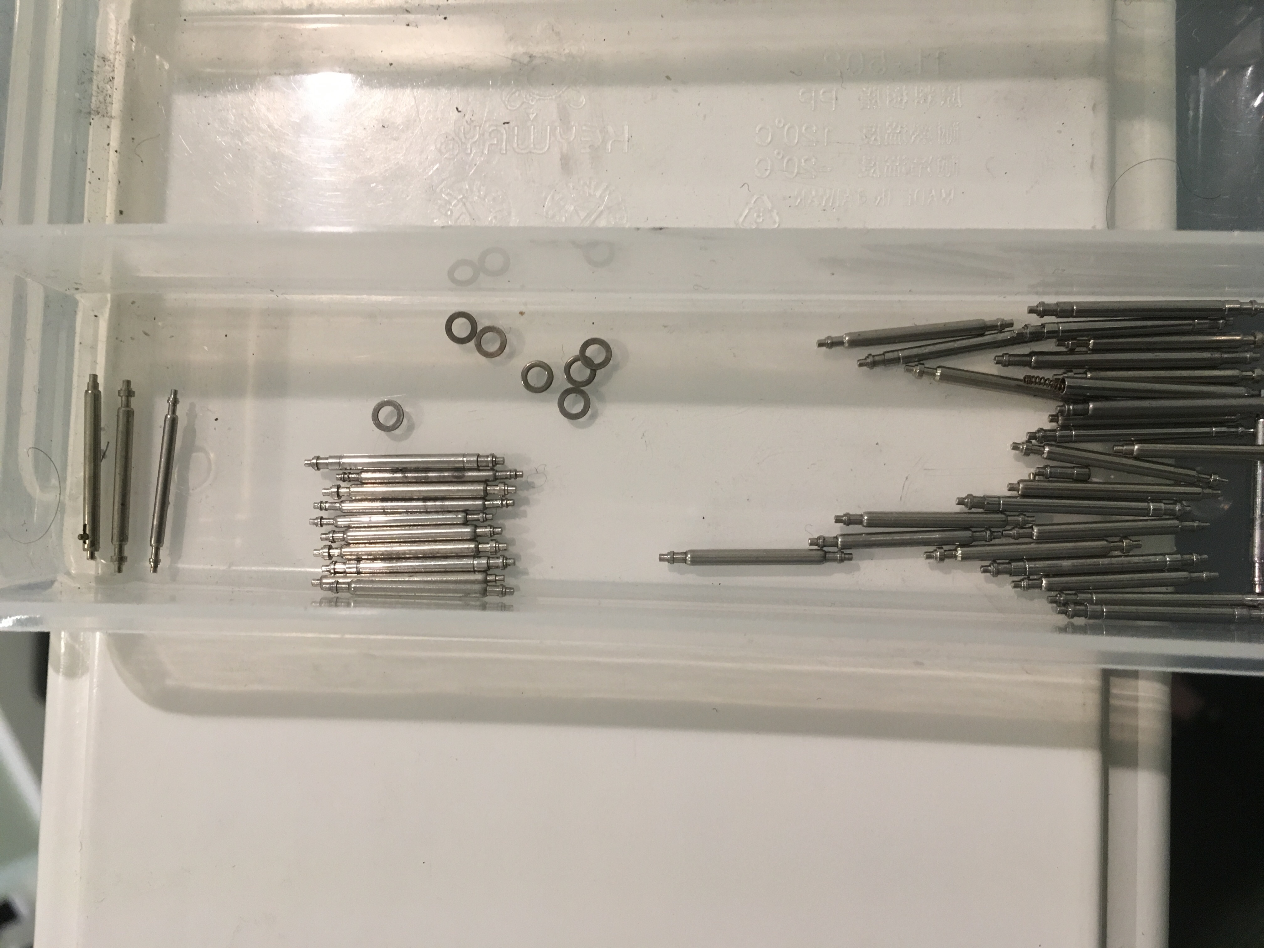

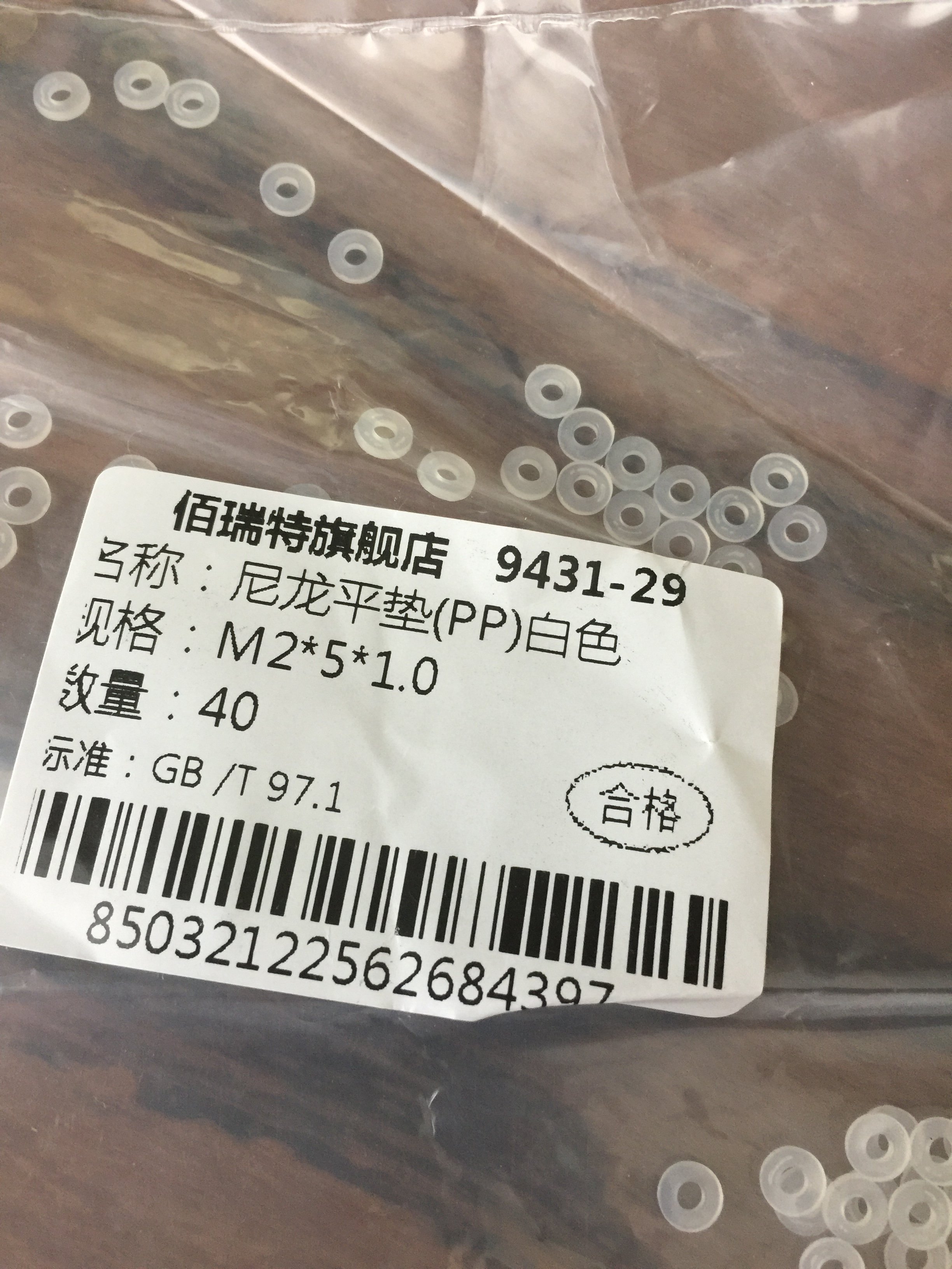

I bought several years ago on a bunch of Omega, parts new old stock constellation cases, bracelets, spring bars and washers. I have always thought that these washers were for the exact purpose being discussed in this thread if anybody wants them pay for postage and they are yours .
3,966
8,980
🙄 might as well. PMd you.
3,966
8,980
Unsold - cost of shipping to Australia didn't excite me 🙁 so up for grabs again.
Thanks Vercingetorix for the generous attempt though. Much appreciated.
3,966
8,980
any result yet ?
Onto it tomorrow downunder time. but on first glance looks good. Certainly wont stand out like the proverbial dog's spheres as the black rubber seals do.
