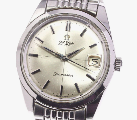

I'm jumping the gun a little bit, but this has been catching my eye lately. Your thoughts gents?

Some dotting on dial, wrong crown and hands a bit dirty. Beside a nice crosshair dial and onyx markers and BoR. Surely wearable and nice but not a perfect one. Depends on how much condition matters to you.

Thanks. I can live with some patina, but are the original crowns hard to source?
Is it difficult to source links (I have an 8" wrist) for BOR bracelets?
Also, should the seconds hard reach the minute track?

They are not easy to find, but sometimes appear. You can find links for BOR but mostly quite expensive. Seconds hand could be a service part.

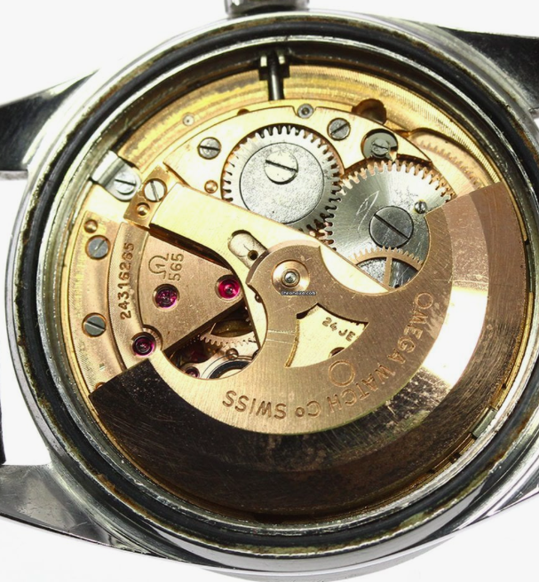

Movement picture. On the left, bottom half of the image, I see a bit of rust... you may not want that, speaking as someone who committed this mistake on a 166.009.
Also, as usual with JPN listings, there is a LOT of light on that watch... and I can spot some blemishes on the case and legs. Make your choise wisely 😀

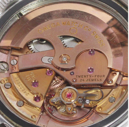

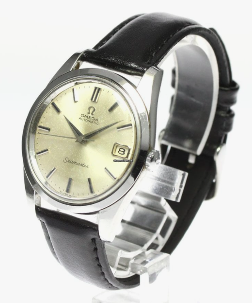

Gents,
May I paddle my feet in your pools of wisdom? Can you cast a flinty eye over these pics and advise pls?
I understand a service will be required (fingerprints on the rotor, etc). While the dial is not perfect, some patina is tolerable.
Thanks in anticipation.

Hard to say without a clear photo of the dial. Looks like an original crown but I have recently learned the hard way how compromised these can be. There is a disturbing mark on the largest gear visible in that movement photo.

Looks like there’s spotting on the dial and some corrosion inside the case threads.
This is not a rare model and I see no reason to compromise on condition. Ideally you’ll find a good condition one at a good price, but failing that, it’s better to pay slightly more for one in good condition. Paying a low (or worse, a high) price for an average example is the worst thing to do.

They won’t sort condition issues such as dial spotting/staining and case corrosion. They’ll just say return it at your cost.
I wouldn’t buy this watch. I’d keep looking for a better example at a similar price or add a bit to my budget and buy one of their better examples.
