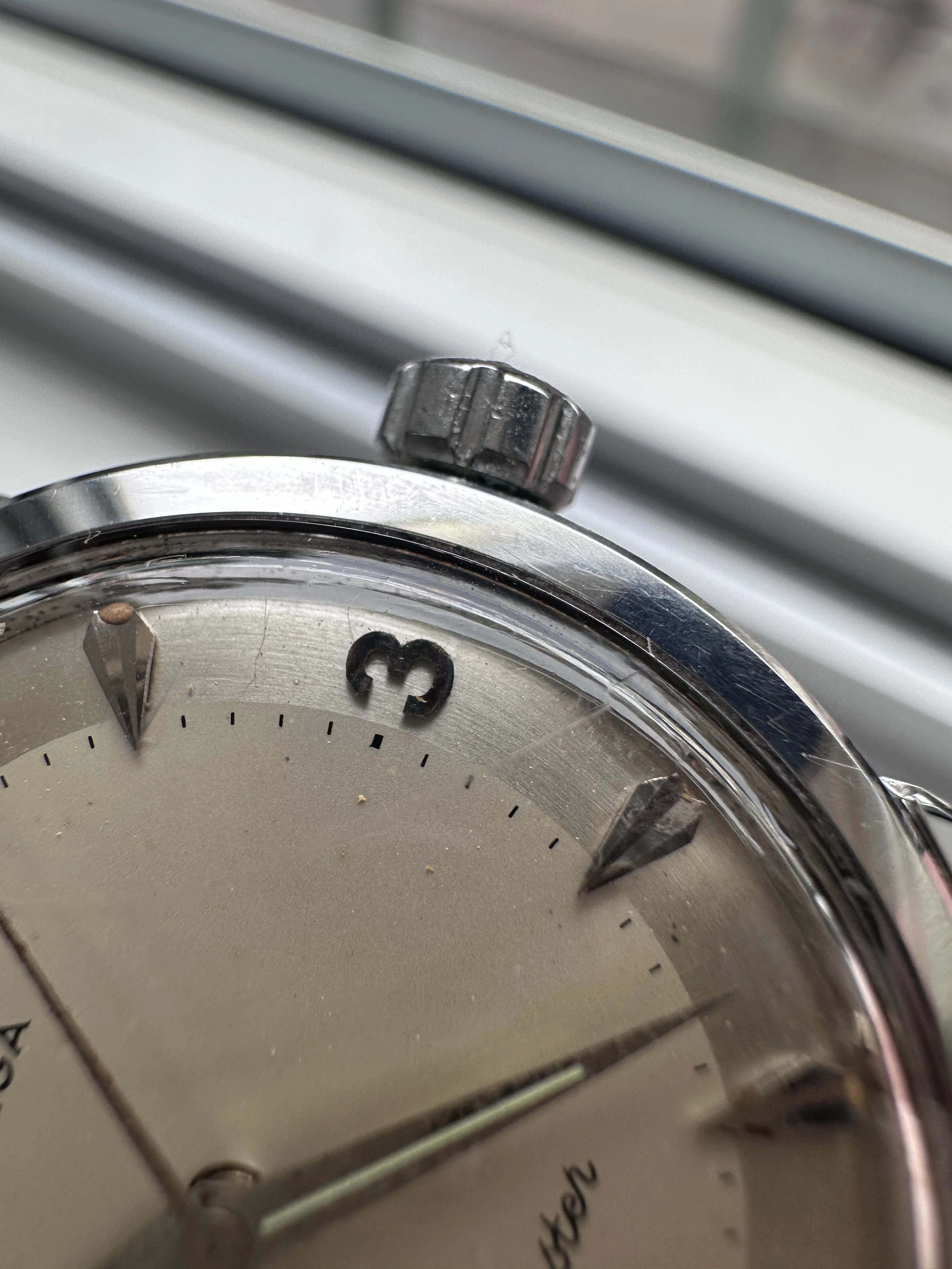

J ai besoin d’aide pour identifier cette montre

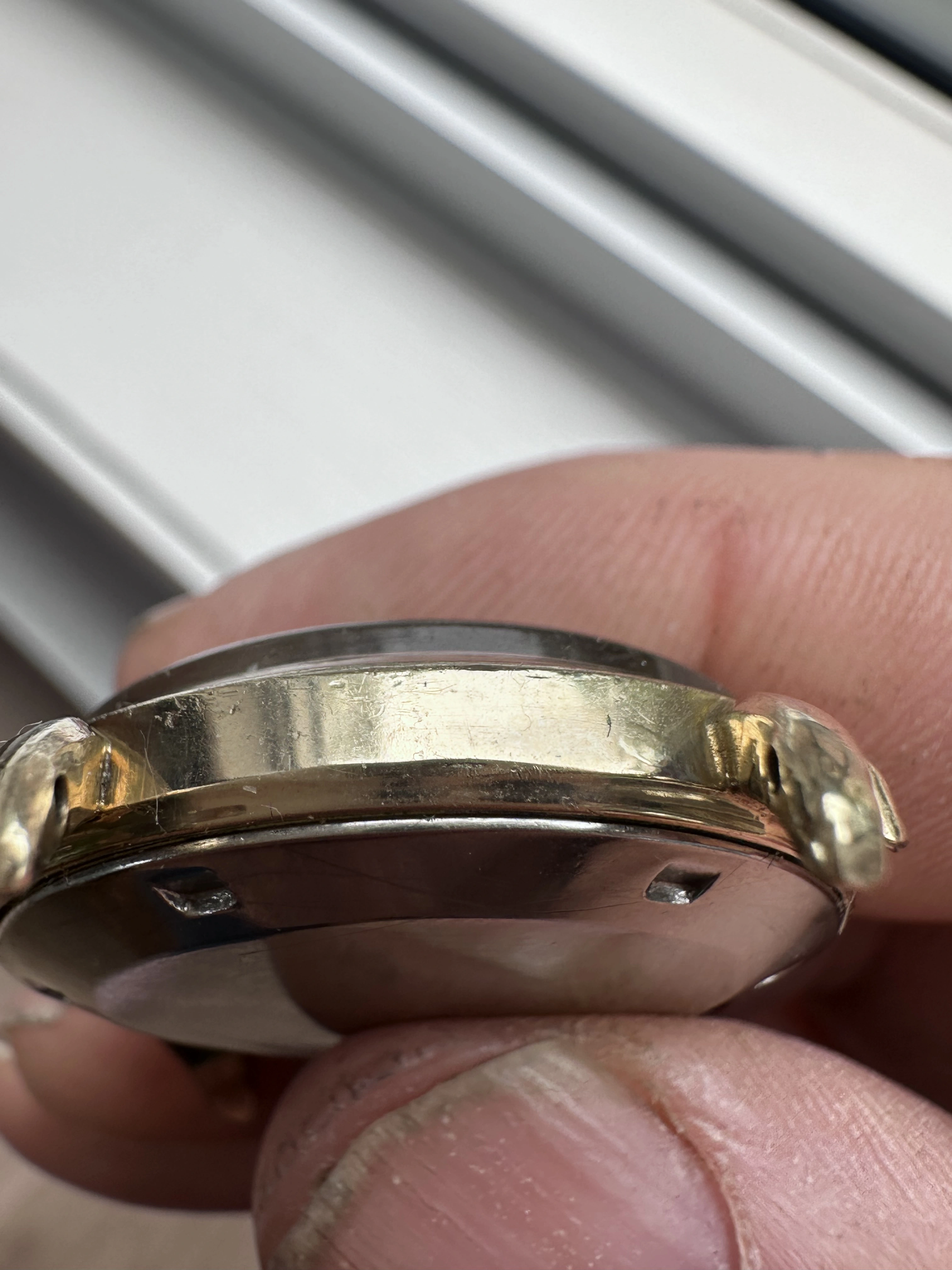

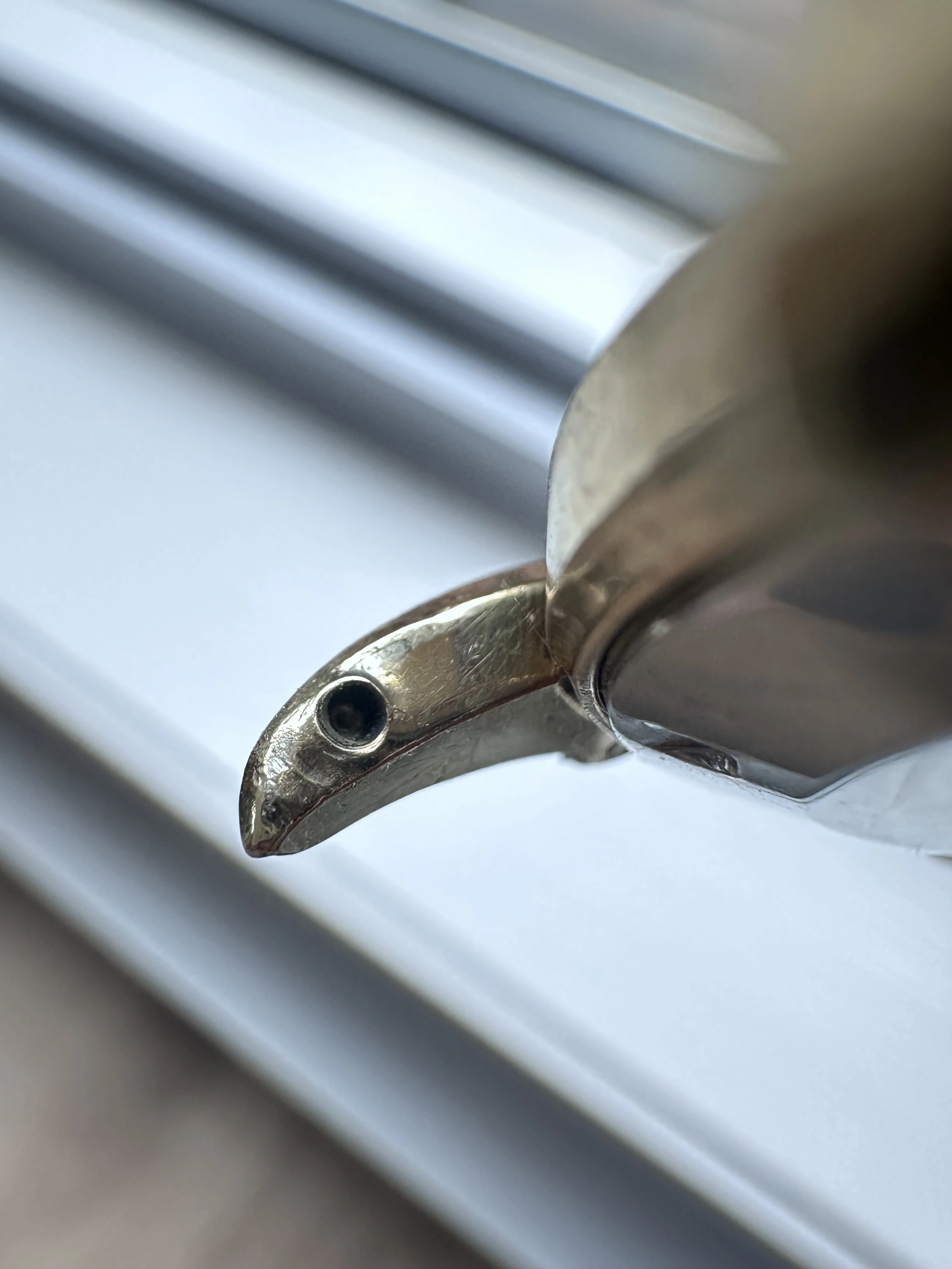

Il a remarqué la minuscule rainure sur le verre et m'a dit qu'elle était d'origine, c'est-à-dire qu'elle n'avait jamais été retirée… Bref… je ne suis certainement pas expert, mais son raisonnement me semble logique.

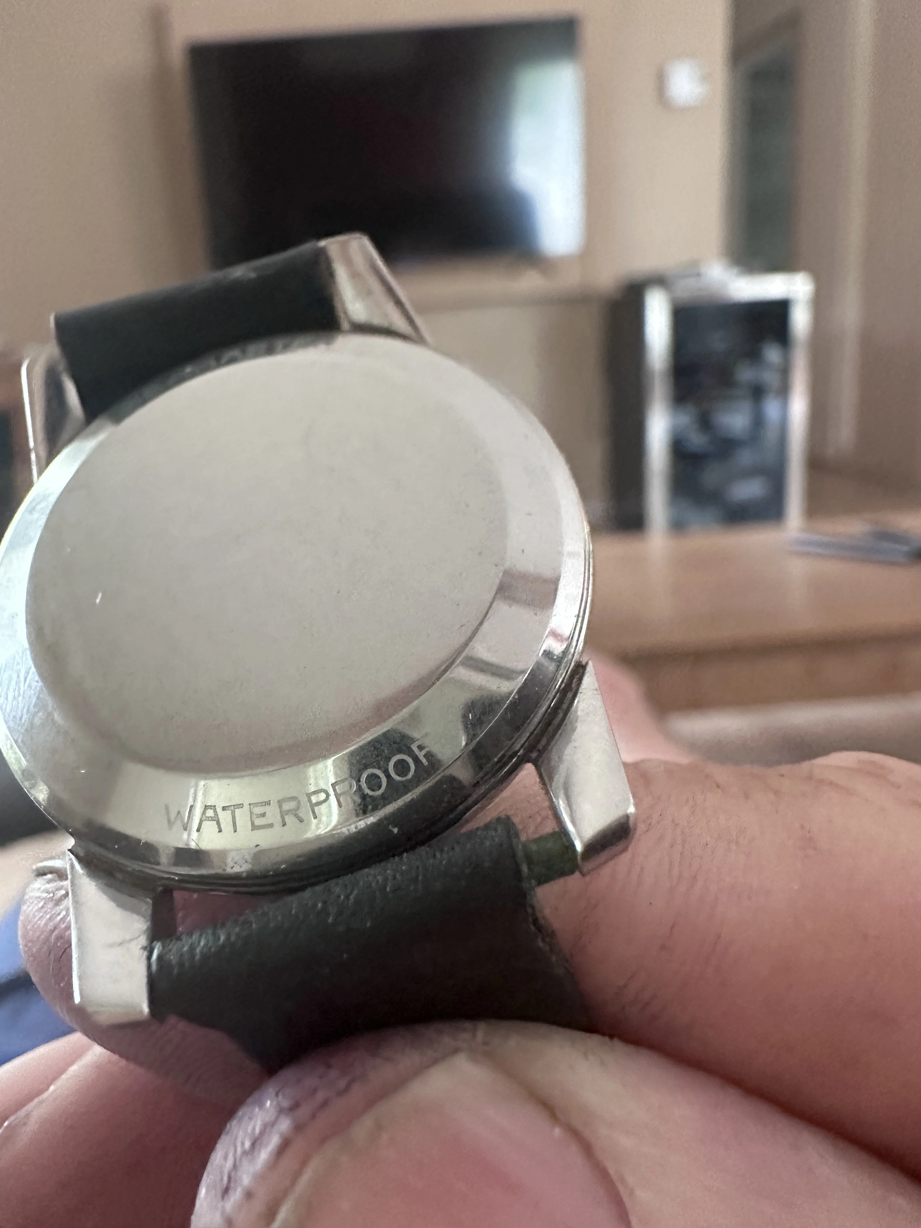

It is very possible that the crystal is original still, while the dial has been re-touched during one of the times when the watch was serviced

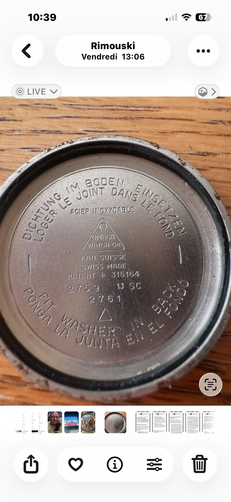

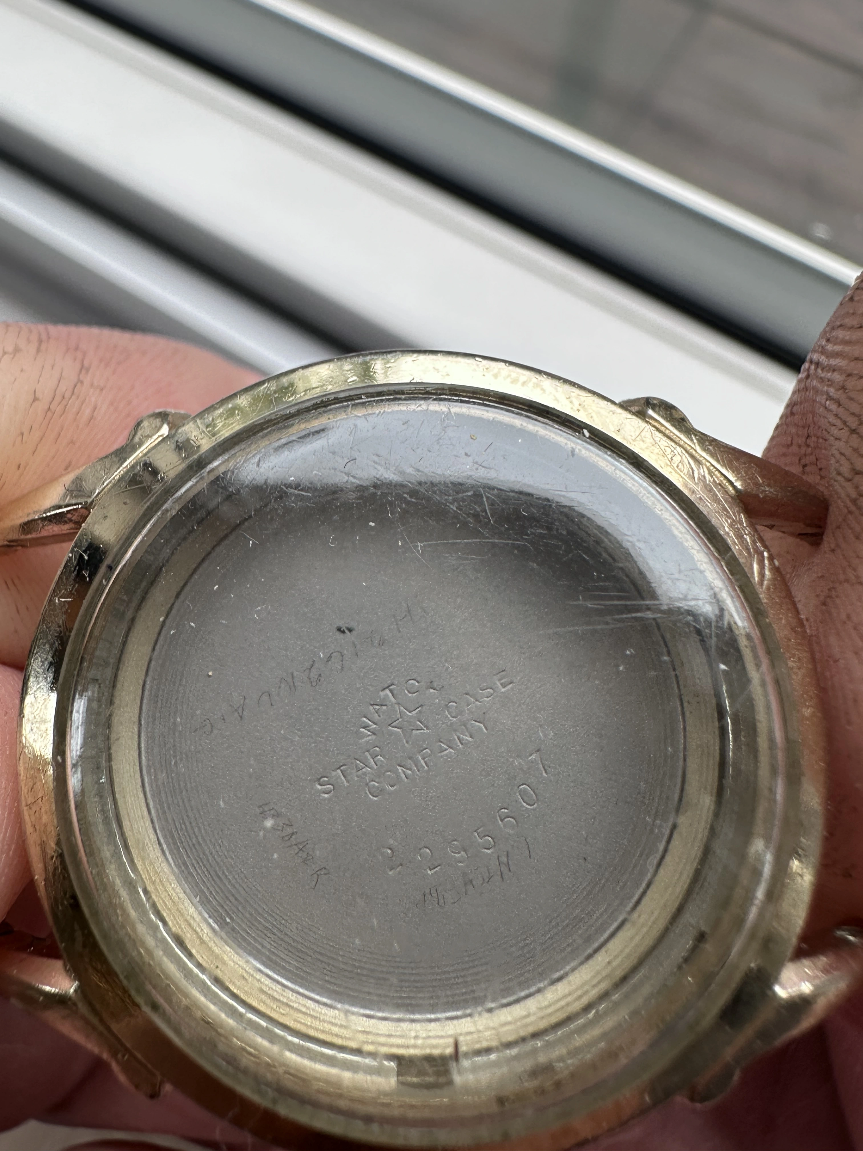

The marks on the case-back here suggest the watch has been serviced at least three times:

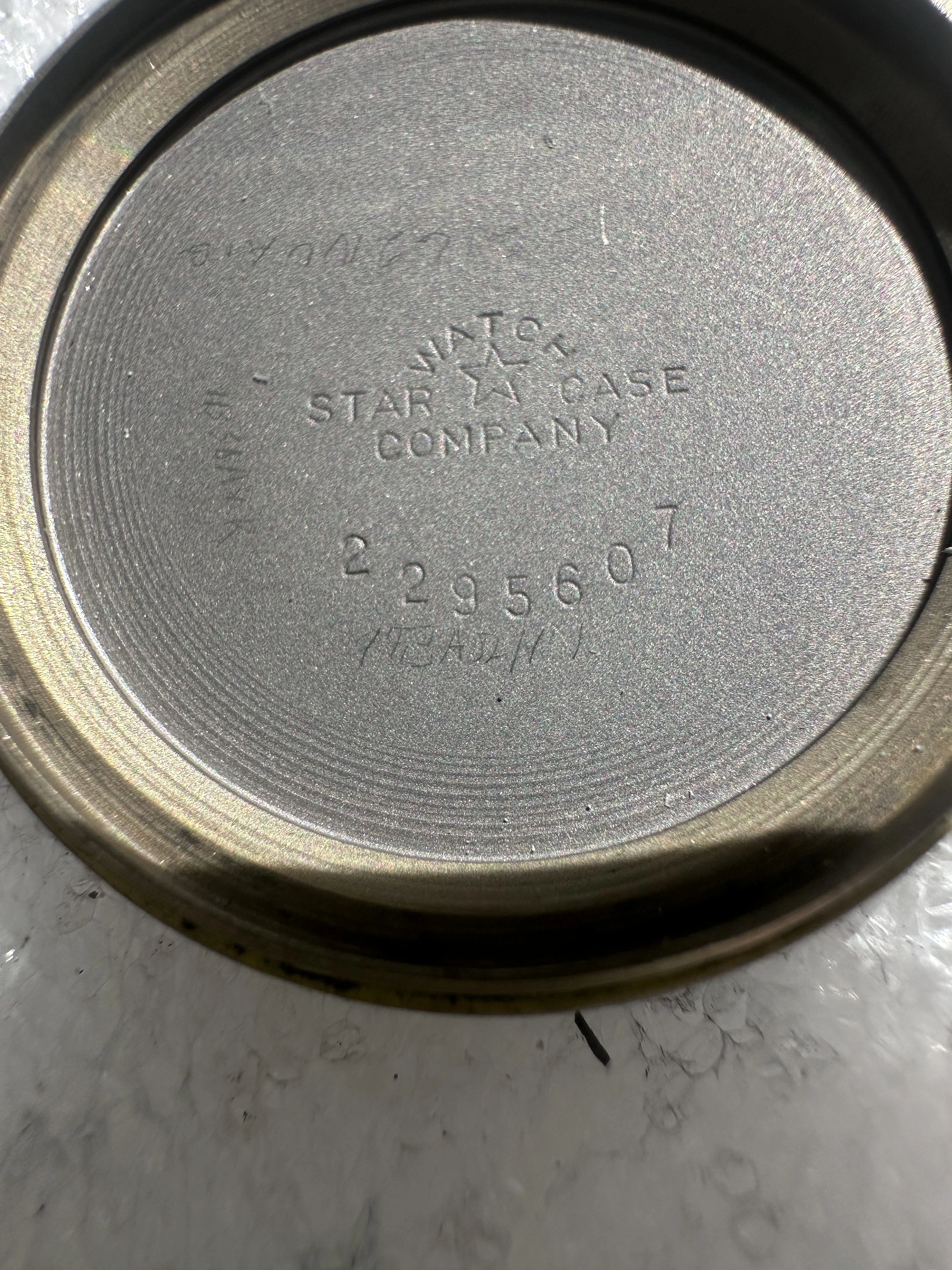

Notez également qu'il s'agit d'un boîtier de montre de fabrication américaine, ce qui est intéressant.
voir info gravure pour info j ai deux boîtier or et argent

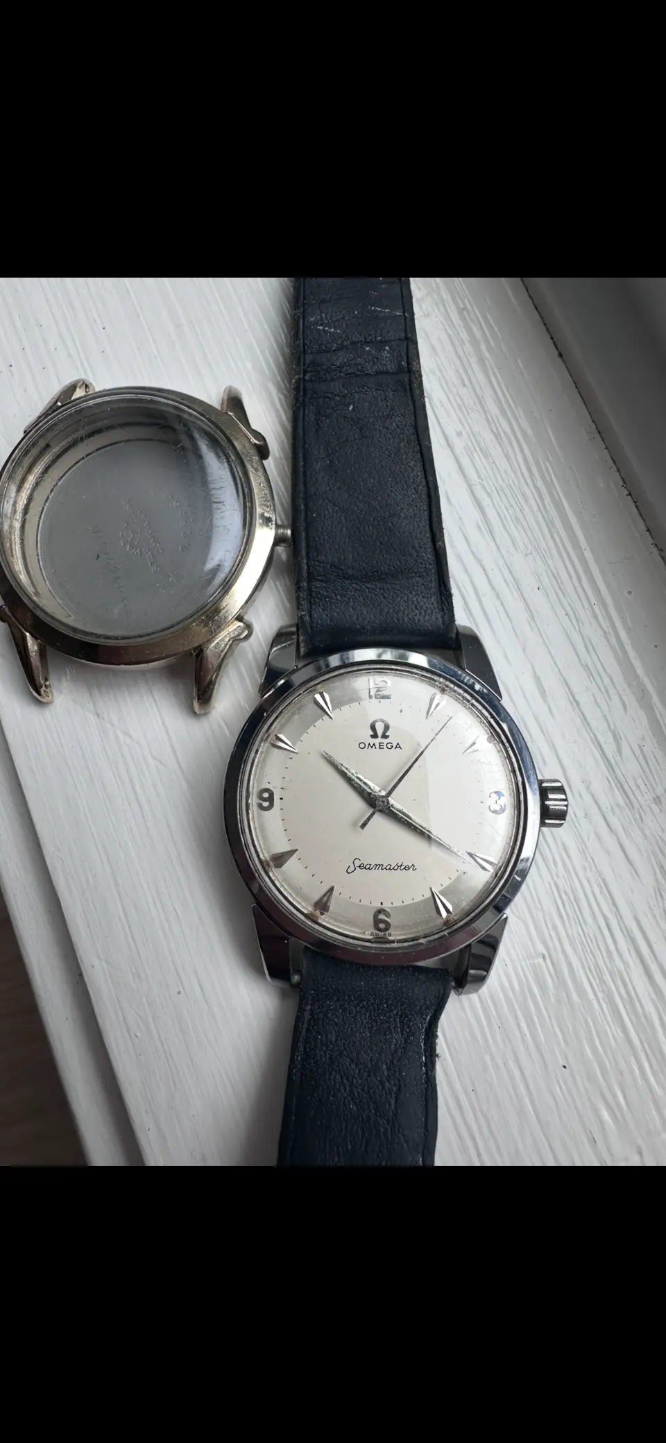

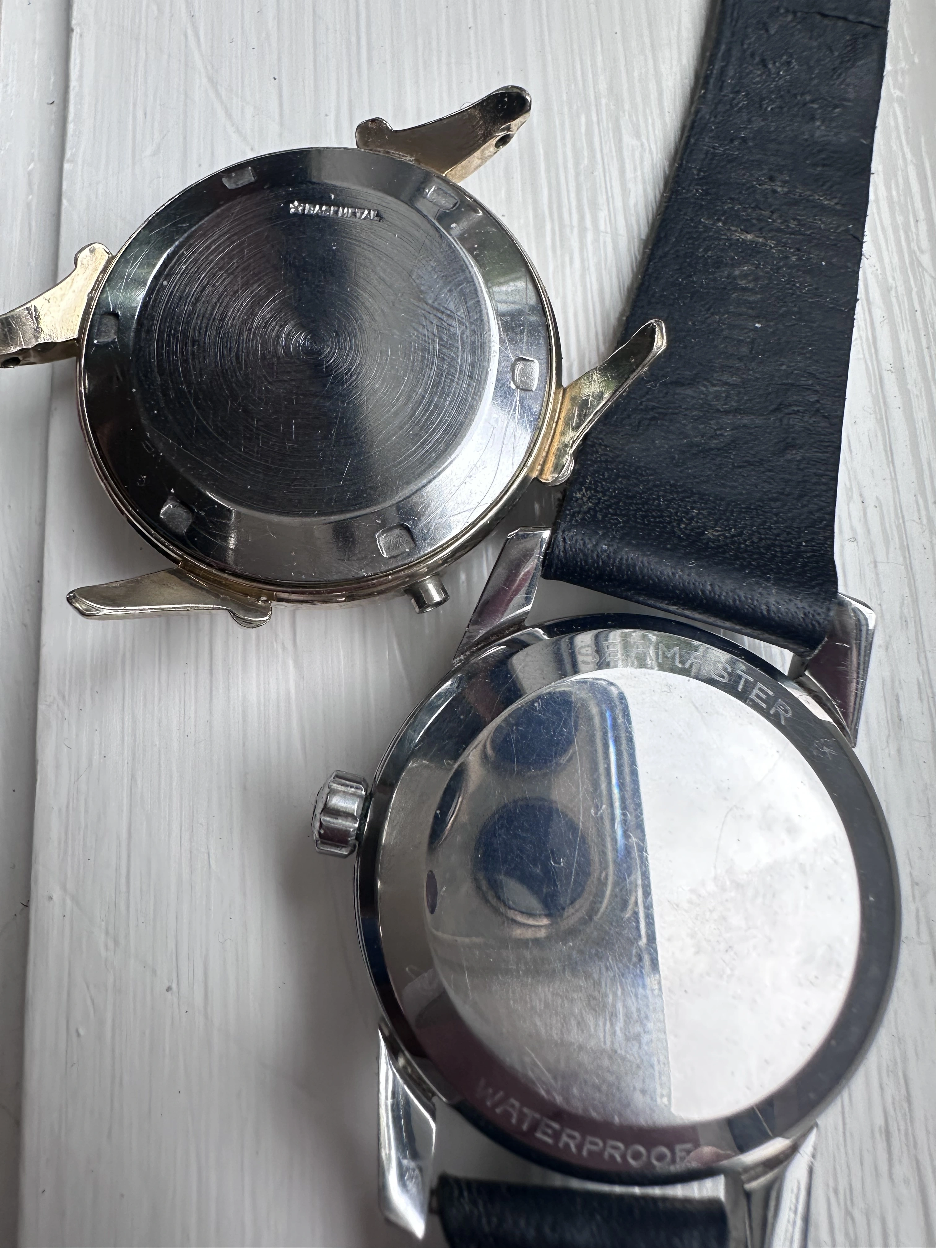

• Bonus: Included is a spare vintage US-market empty case
(Star Watch Case
Co., Starbrite screw-back / Gold-filled case).

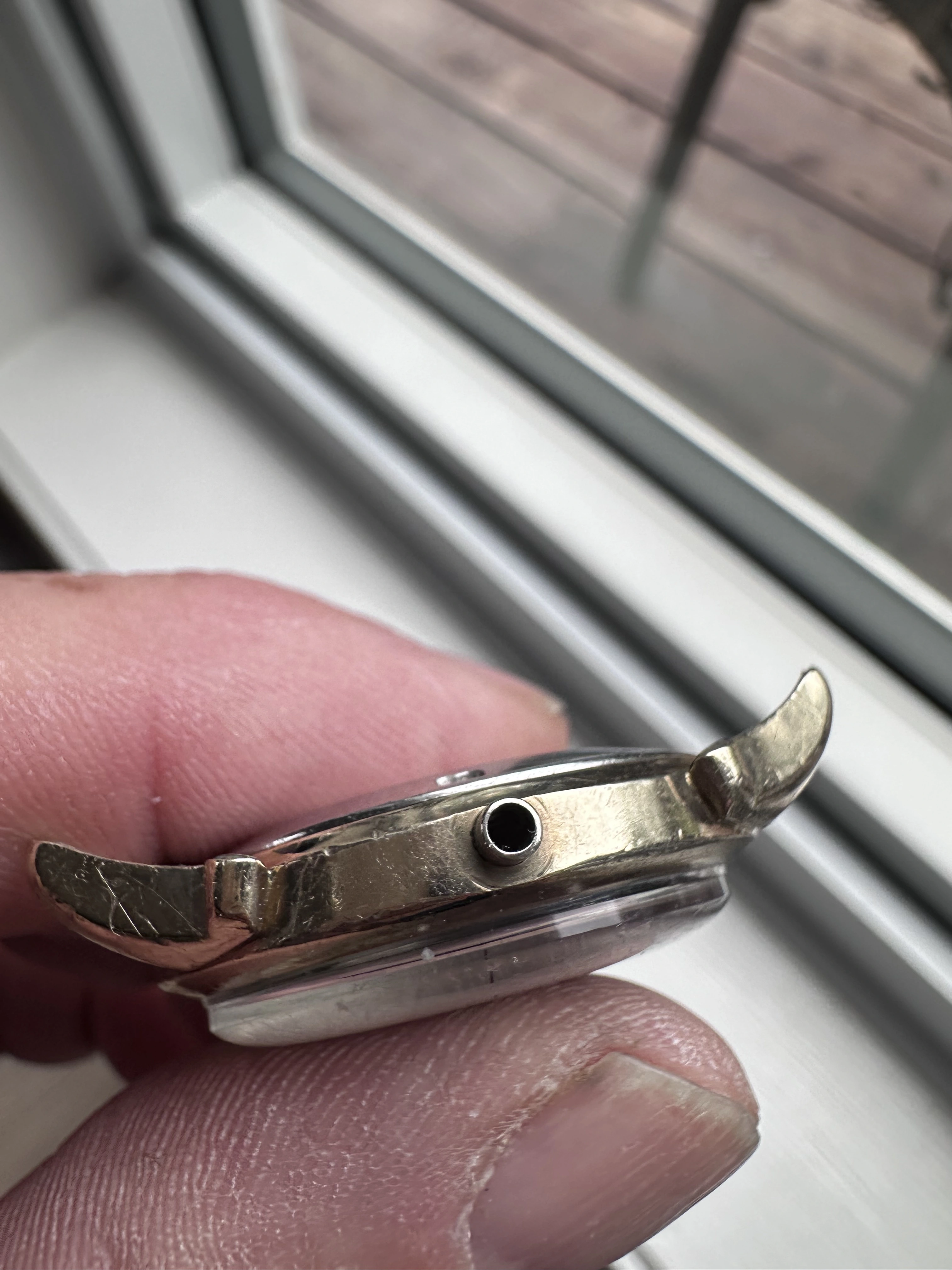

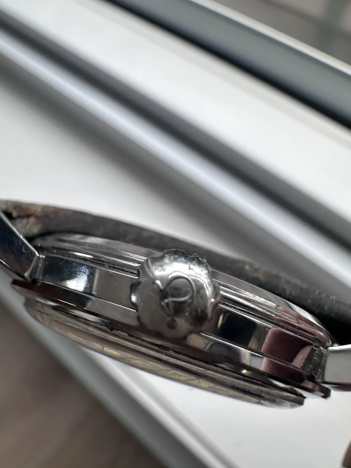

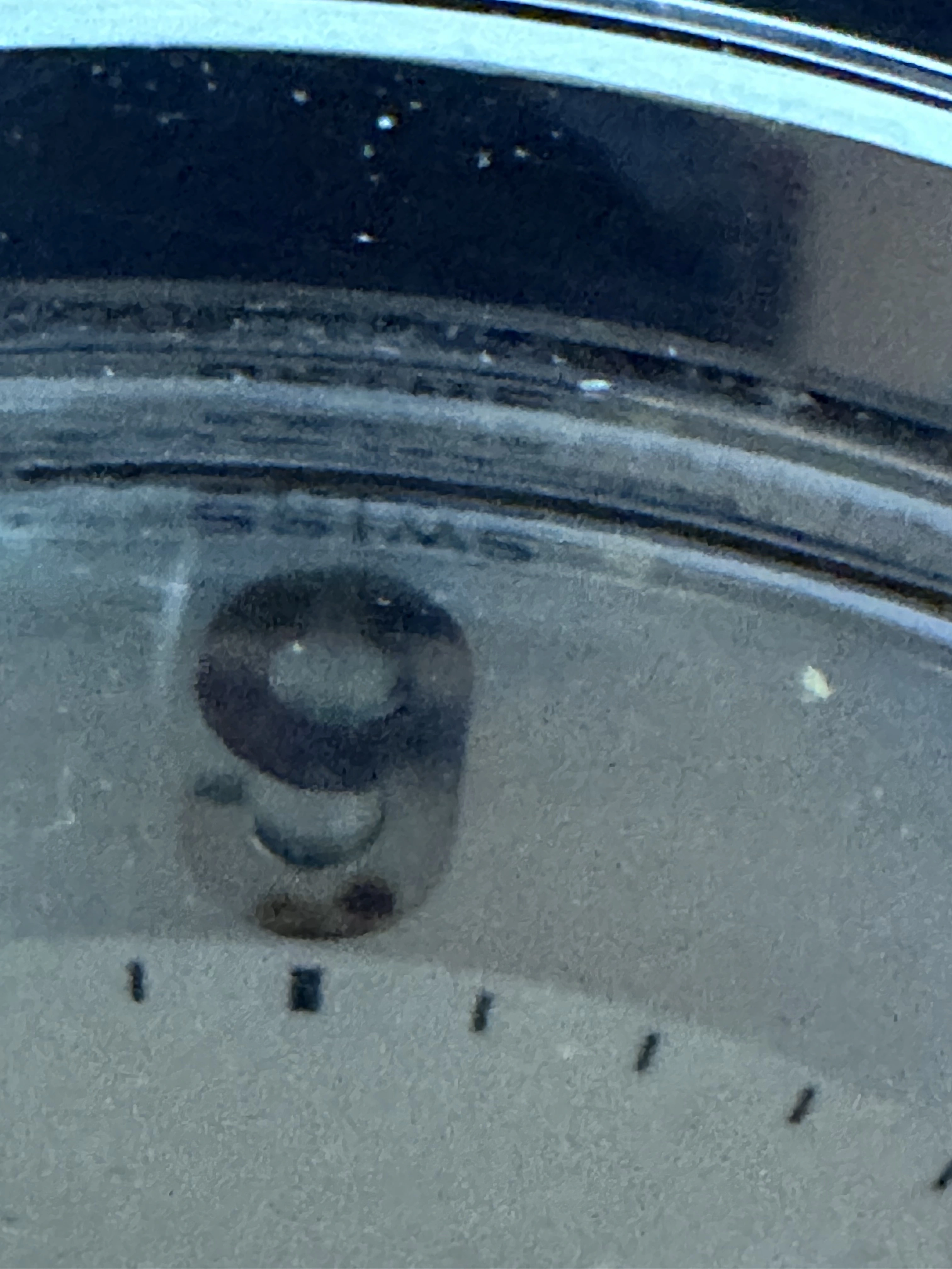

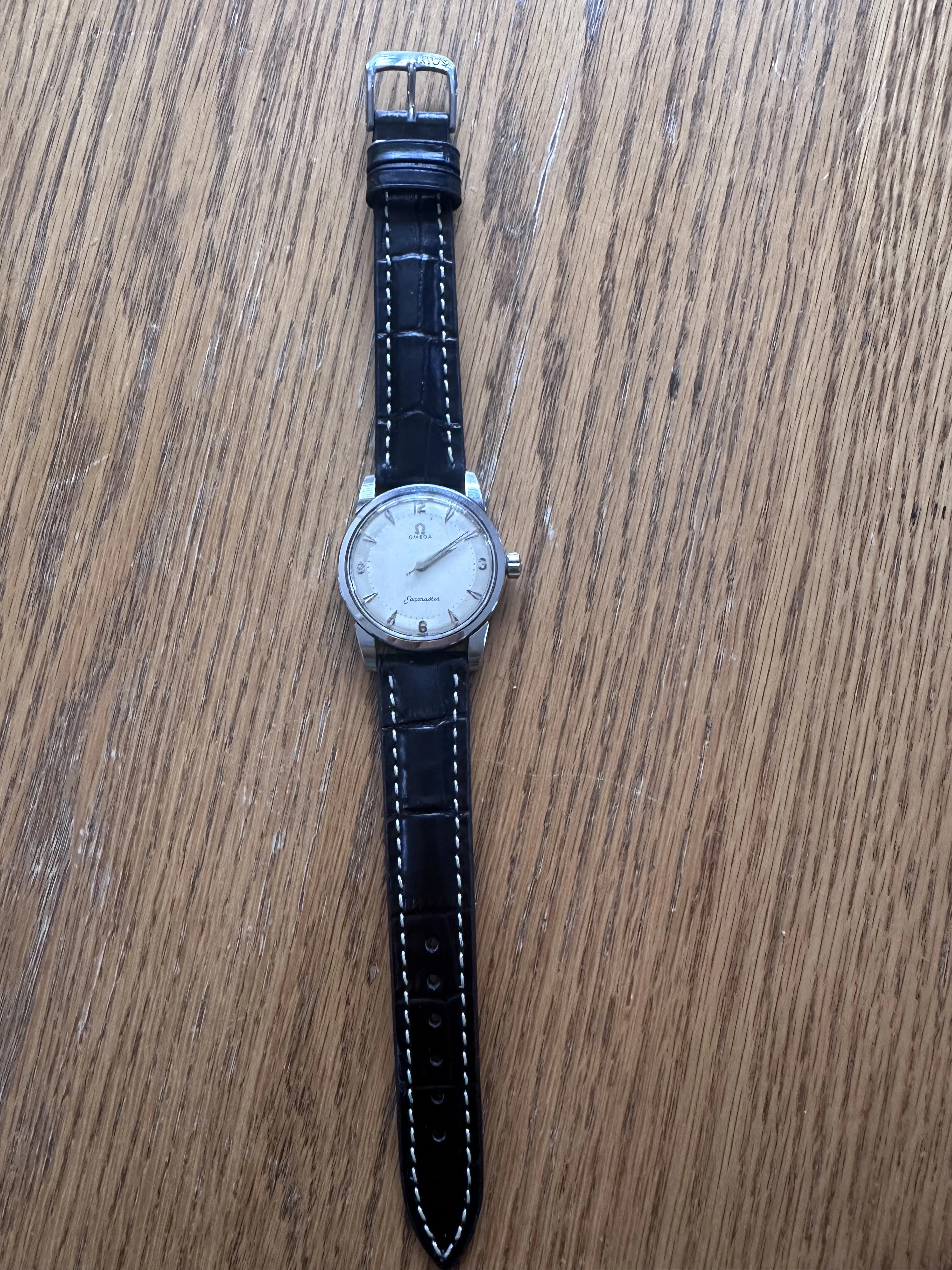

Hello again, I can't help but notice that this watch has been painted. Looking very closely at the lettering and under the 6 marker, you'll see the Swiss markings. Also, check the inside of the case and the movement, which is remarkably clean. I've found many watches with both styles of E

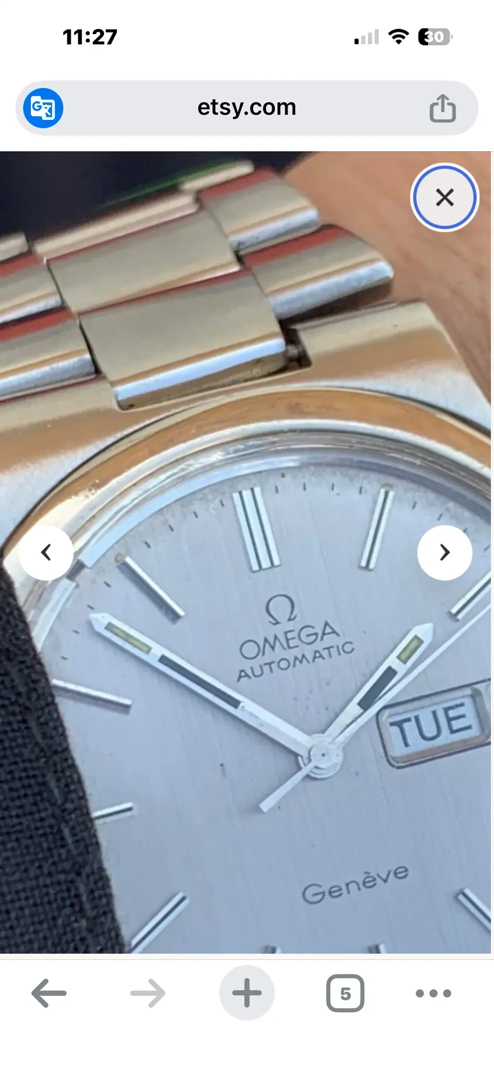

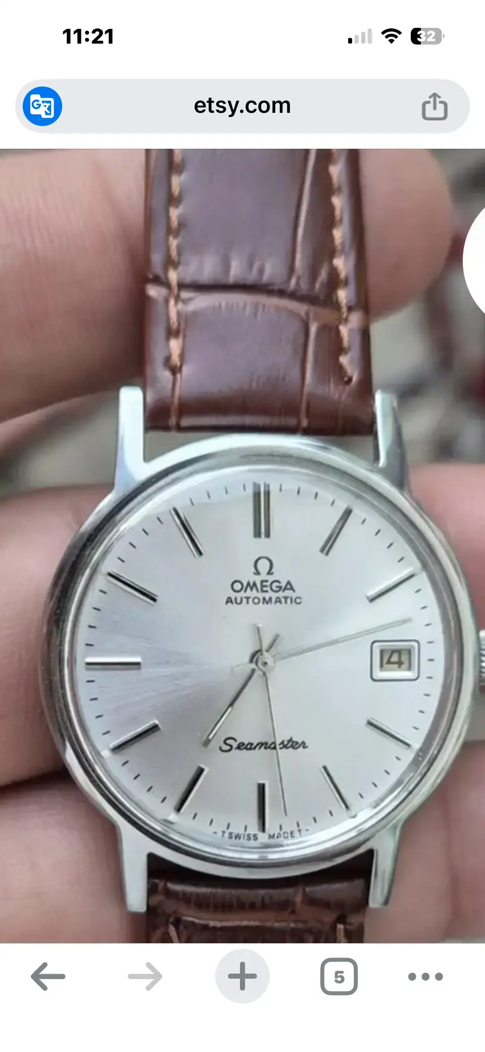

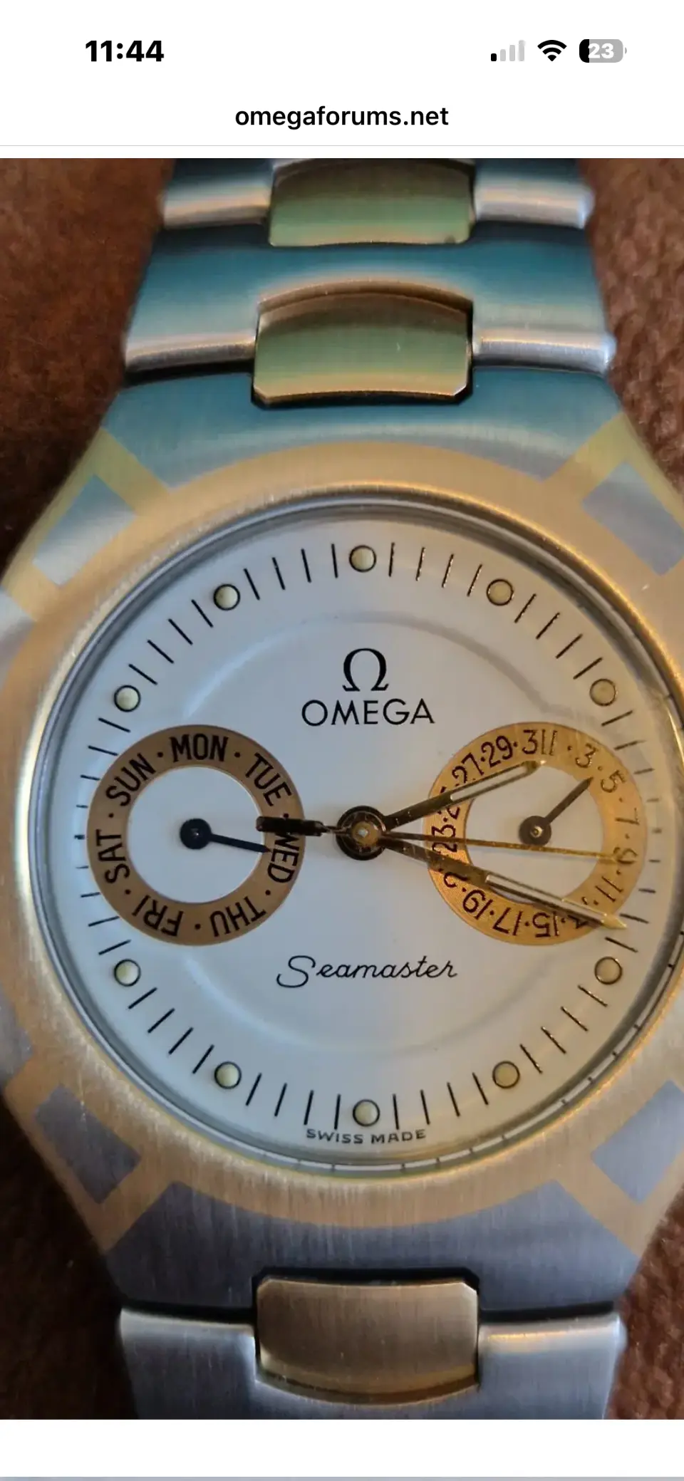

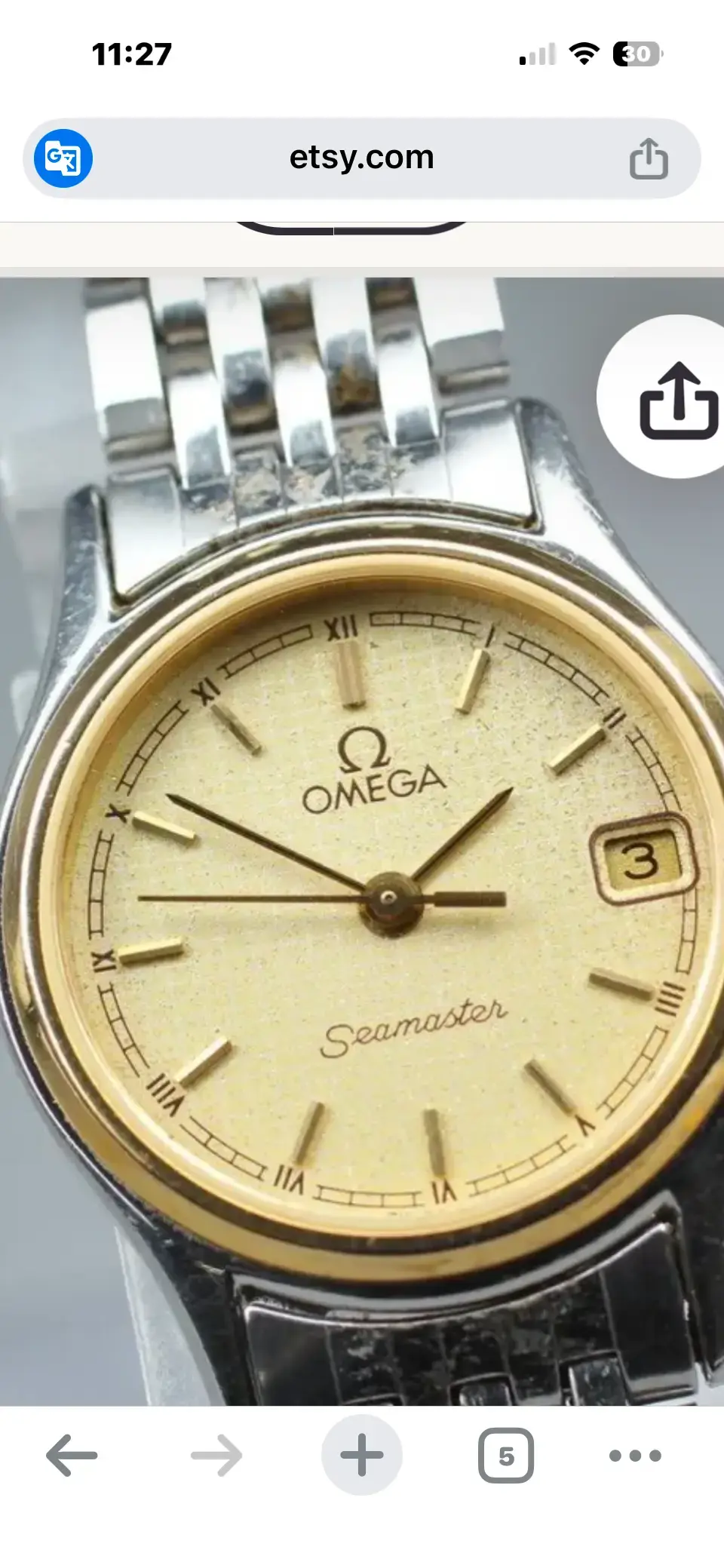

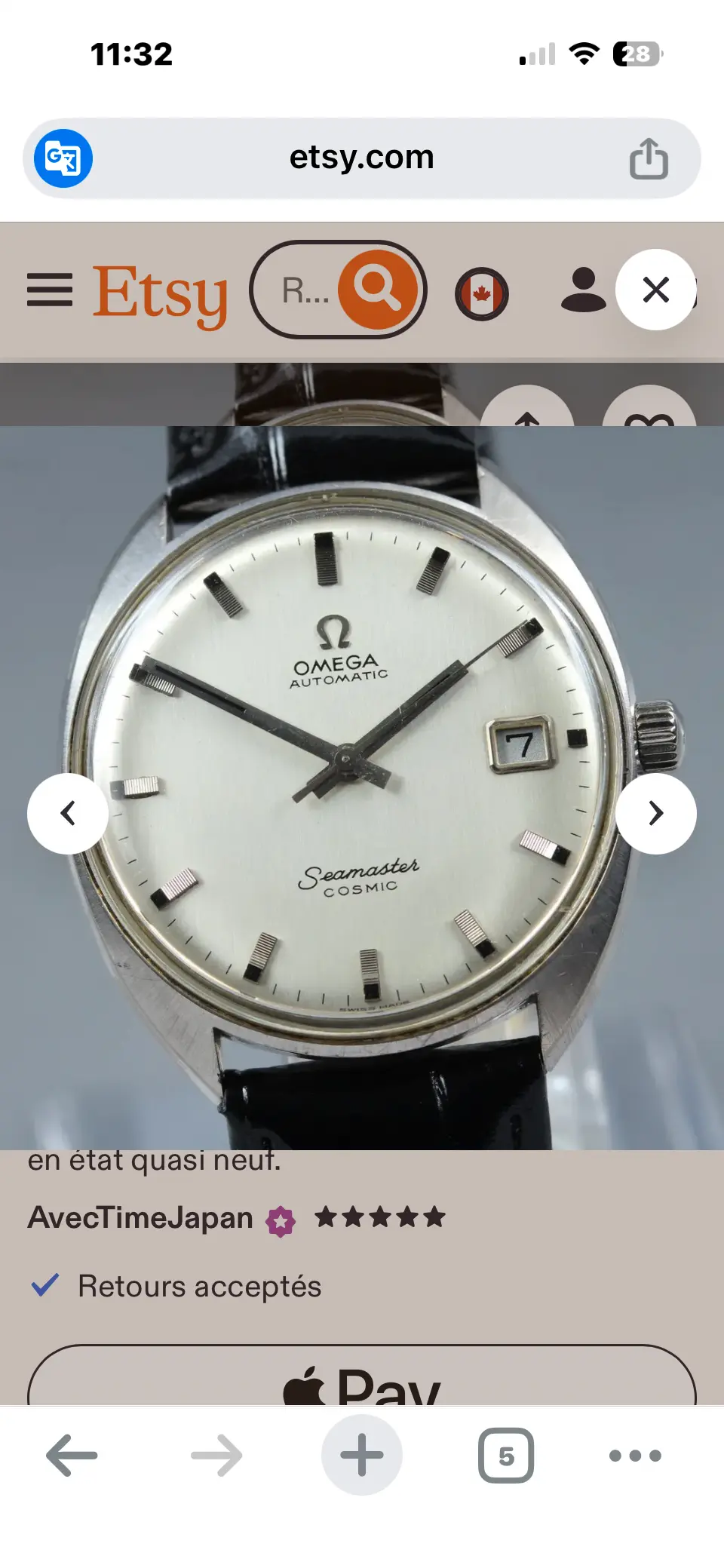

You are the experts, but I am trying to understand: here are some Omega watches with different "E"s that are being sold as authentic—see the photo
13,521
23,458
You cannot compare the font from the late 50’s to the 80’s. It changed several times.
Also, the crystal being original doesn’t mean the watch was never opened. It’s common for vintage watches to reuse the crystal unless it’s damaged.
I agree the dial is not original and has been repainted. Your close up pictures show the quality it not there for an original Omega dial.
242
700

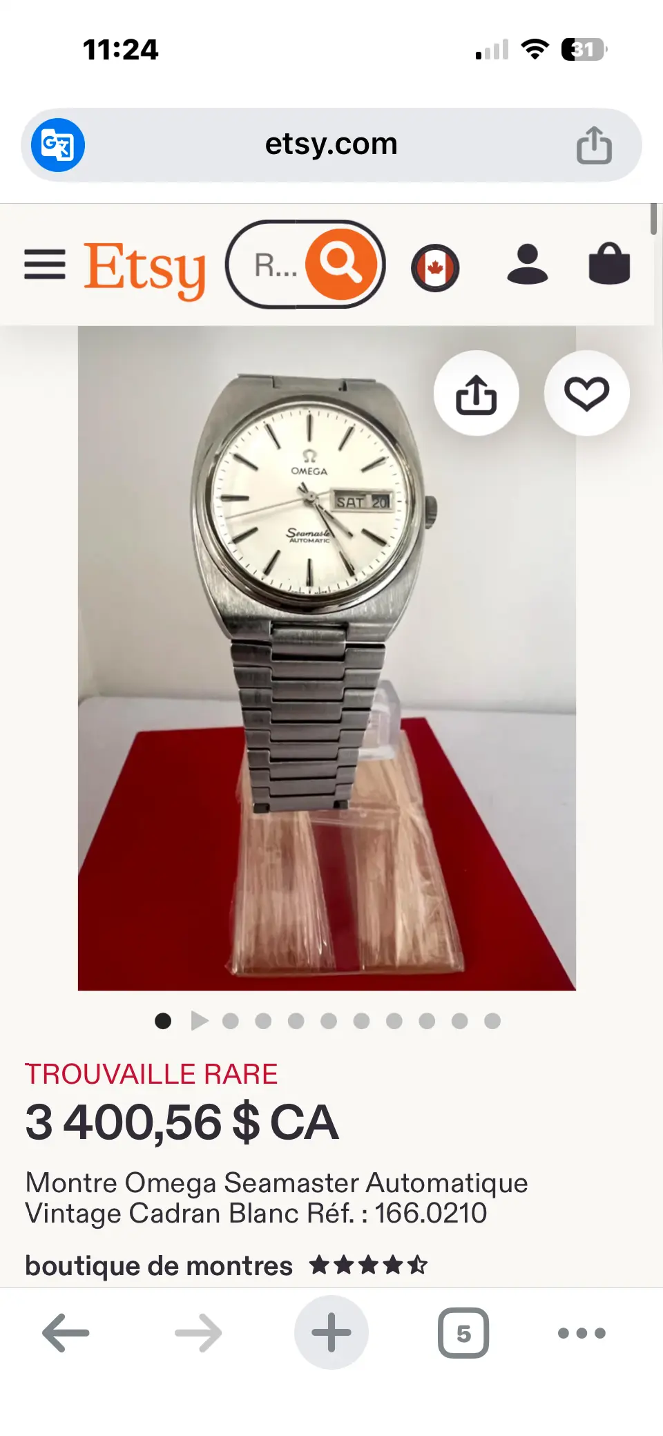

Several of these are redials as well ...

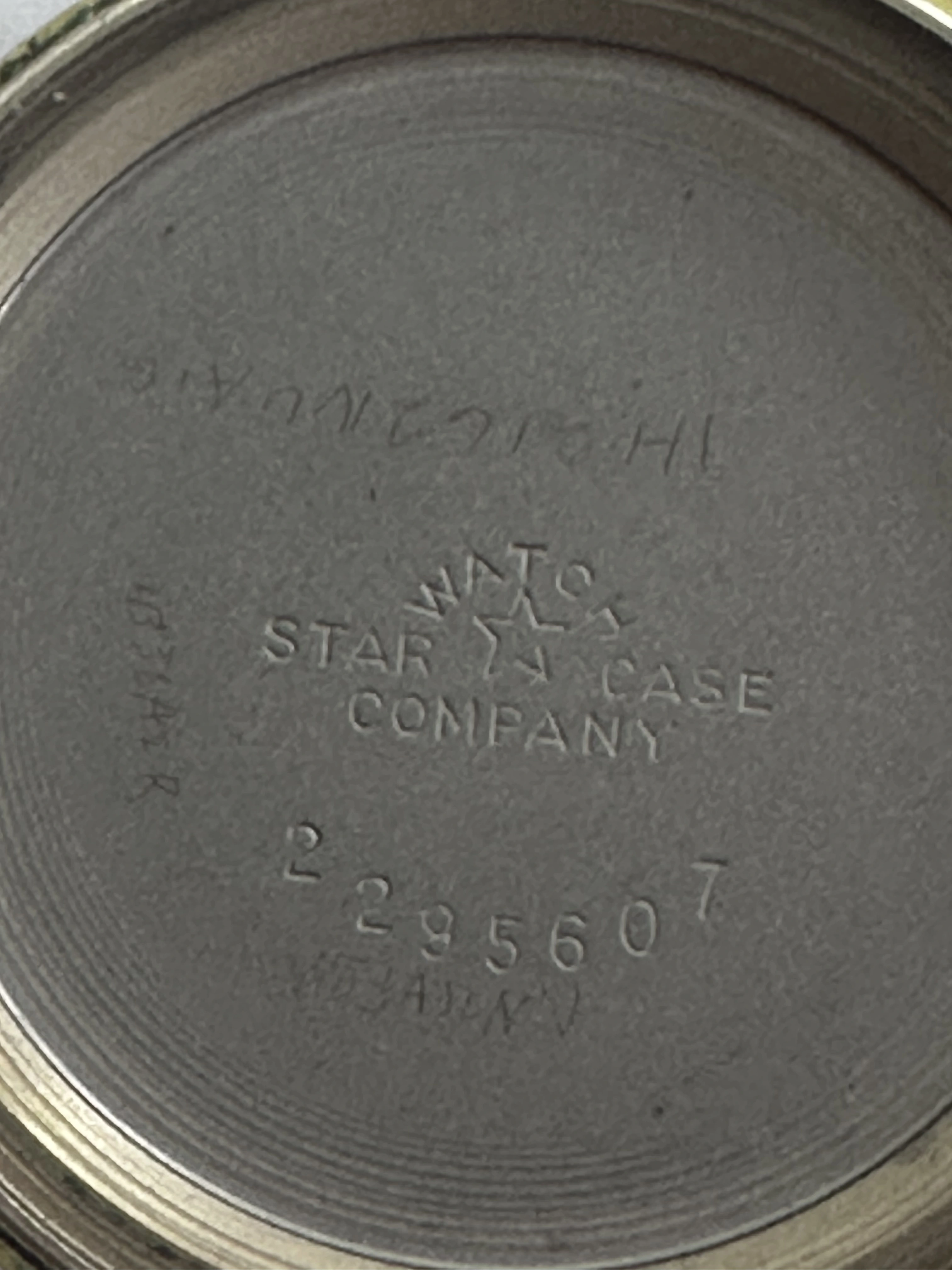

Thank you for your help. I plan to visit a vintage watch specialist in person and show them this beautiful watch—along with its two original cases—to confirm whether or not the dial has been repainted (Ref. No. 2759/2761). The movement inside is very clean, suggesting it was well maintained; my father told me before he passed away that he was leaving me this valuable watch—an heirloom from my grandfather, who was very proud of it. I am grateful today for this wonderful gift, which I received in 2011 and have kept carefully stored ever since.
Thank you for taking the time to assist me; please let me know if you notice anything else. The American origin of the case: Star Watch Case Company
The inscription in the center reads "STAR WATCH CASE COMPANY" and features their star-shaped logo. It was a case manufacturer based in Michigan, USA.
In the 1940s and 1950s, Omega shipped its uncased movements from Switzerland to America, and companies like Star manufactured the cases locally. This made it possible to avoid the exorbitant import duties levied on complete watches. It serves as indisputable proof of historical authenticity.
