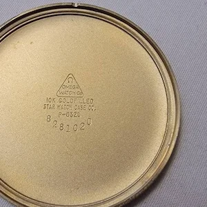

I think that the general consensus here is that the Omega Seamaster is in its original Swiss made steel case. The other case you have is an American made gold-filled watch case from the Star Watch Case Co.
However, Omega licensed cases in the US were generally dual branded. In other words, they would have both the Omega trademark and the name of the US company who made it inside. Here is a typical example from Star:
In my opinion, it is highly unlikely that the other case would fit the Seamaster movement or dial. It is what it is, a spare wrist watch case. If the watchmaker can determine the dimensions of what originally fit in there, you could seek out a movement and dial combination that would fit.
