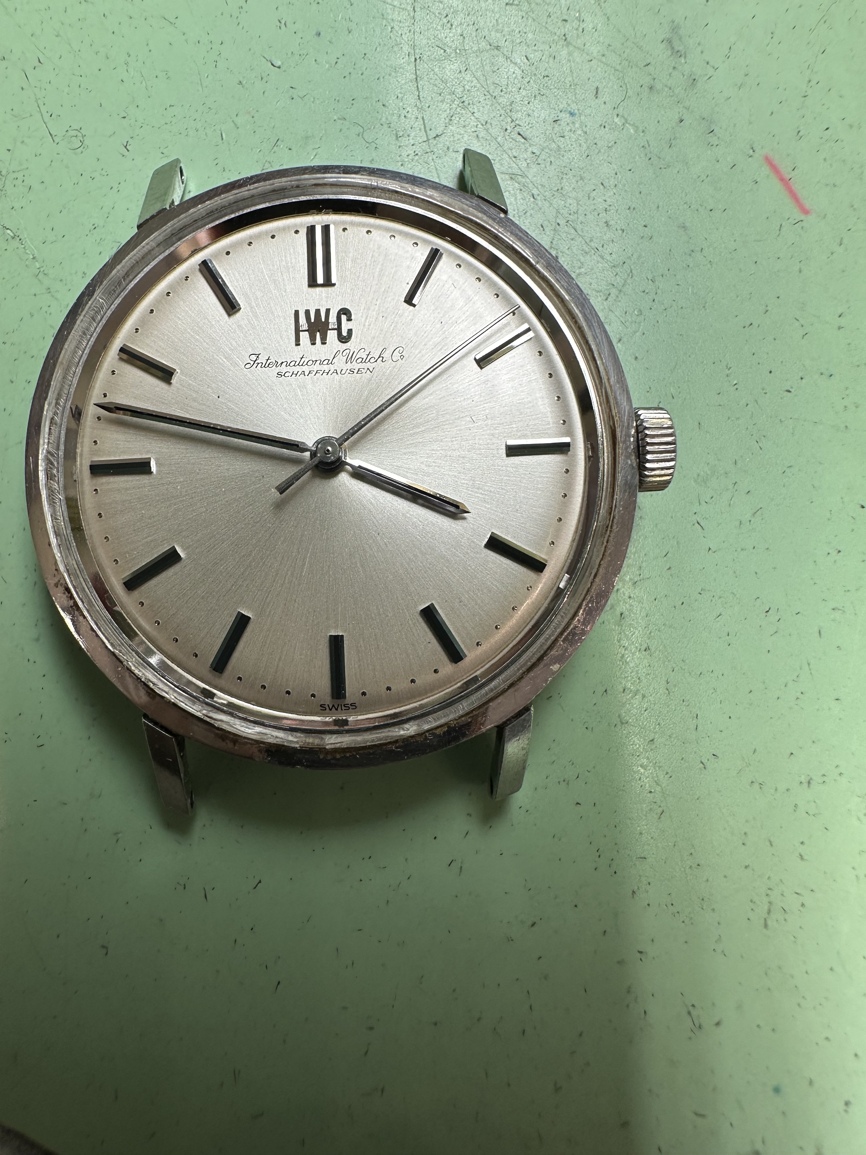

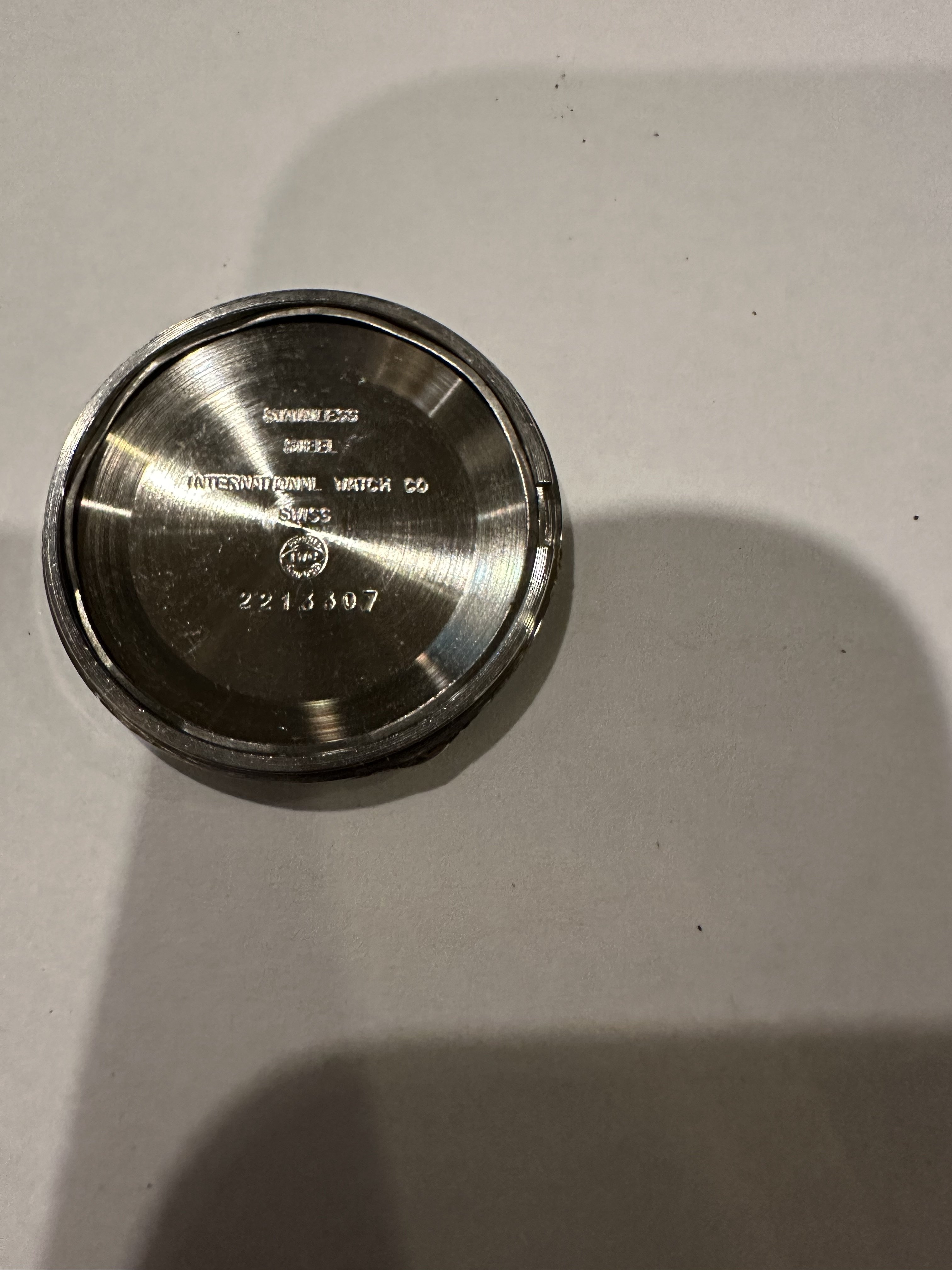

Hi,
I have an IWC with serial number on case and movement, but no ref number stamped.
Is it possible to determine the ref number without looking through age appropriate catalogs?
Thanks!

Pictures always helps. Someone might have something similar.

Looks Ok.
Likely no ref. #, though there were always internal numbers.

Thanks, trying to source a correct crystal, was thinking a ref no would help.

From looking at the case, especially the lugs, this looks like a Ref. 1410.
https://antique-watchlife.com/31773.html
However, the movement would be a cal. 402, not a cal. 89. Similar, but not the same.
Hope this helps,
