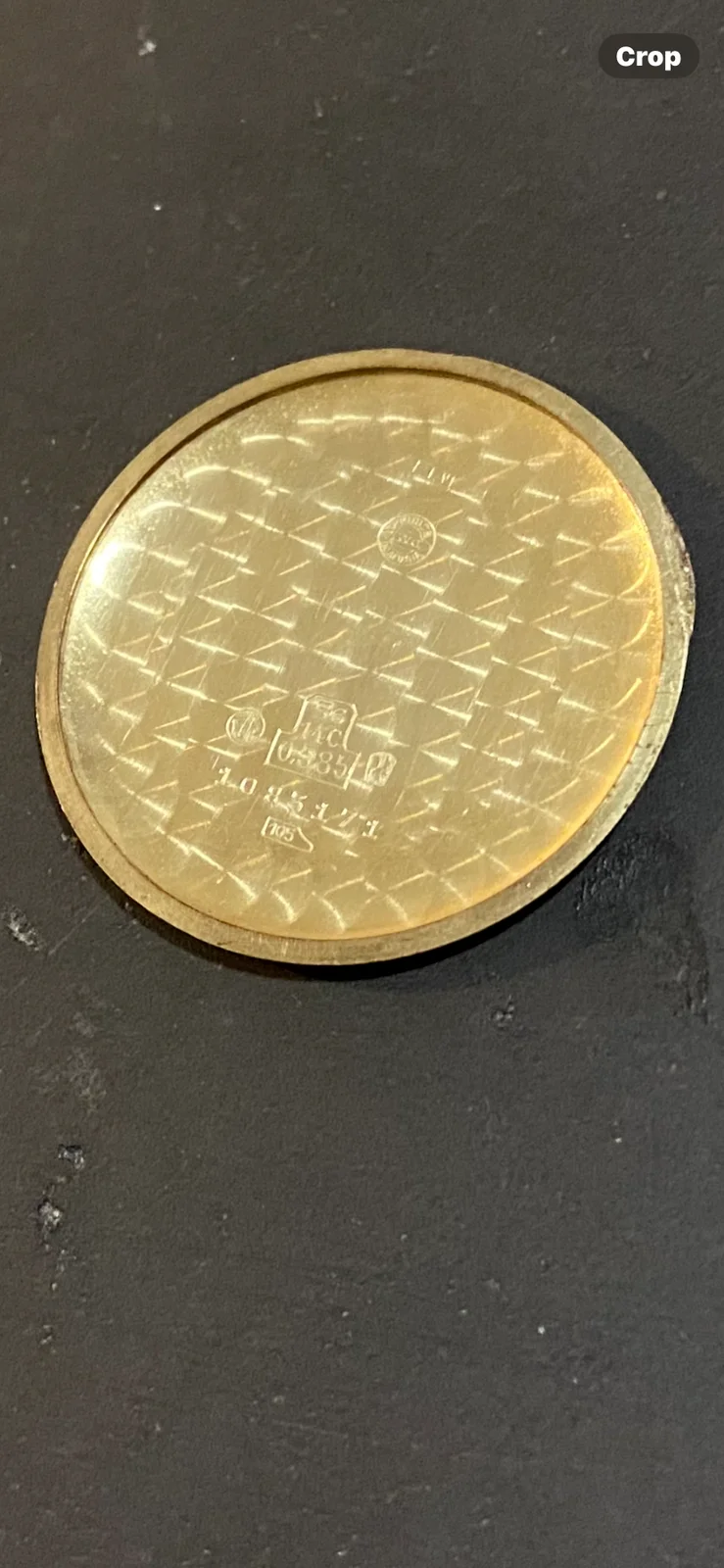

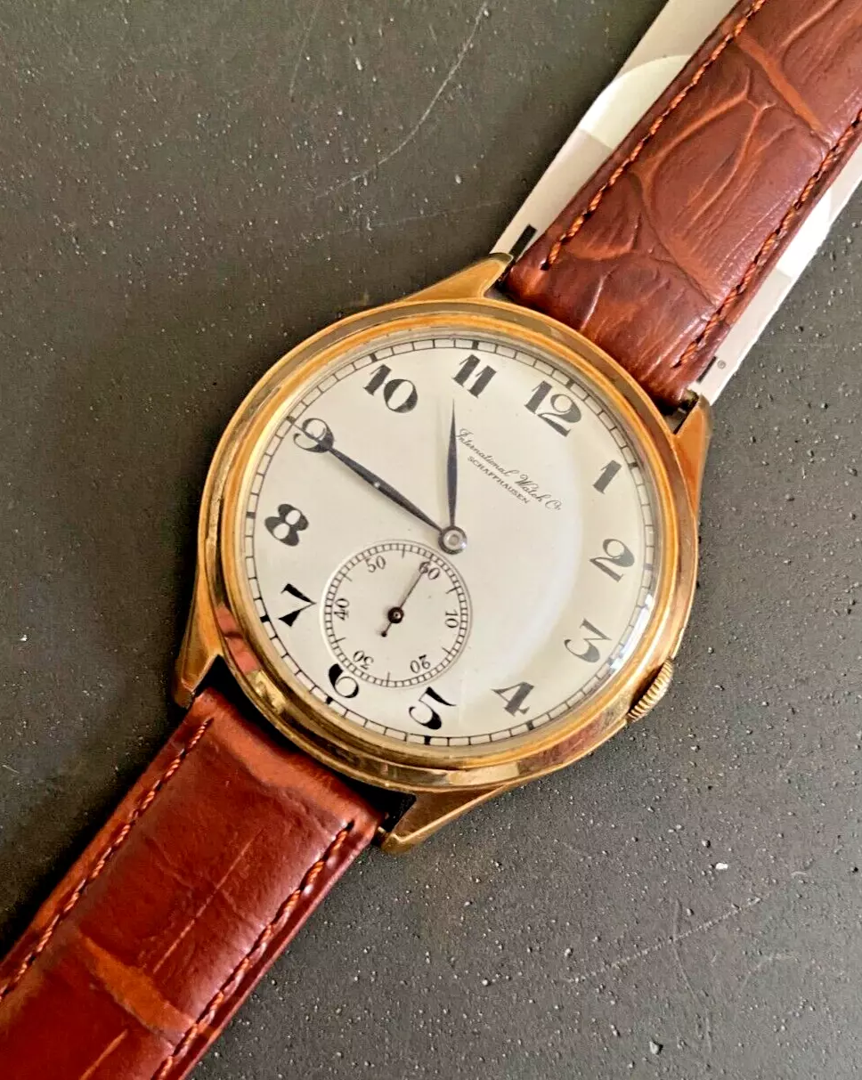

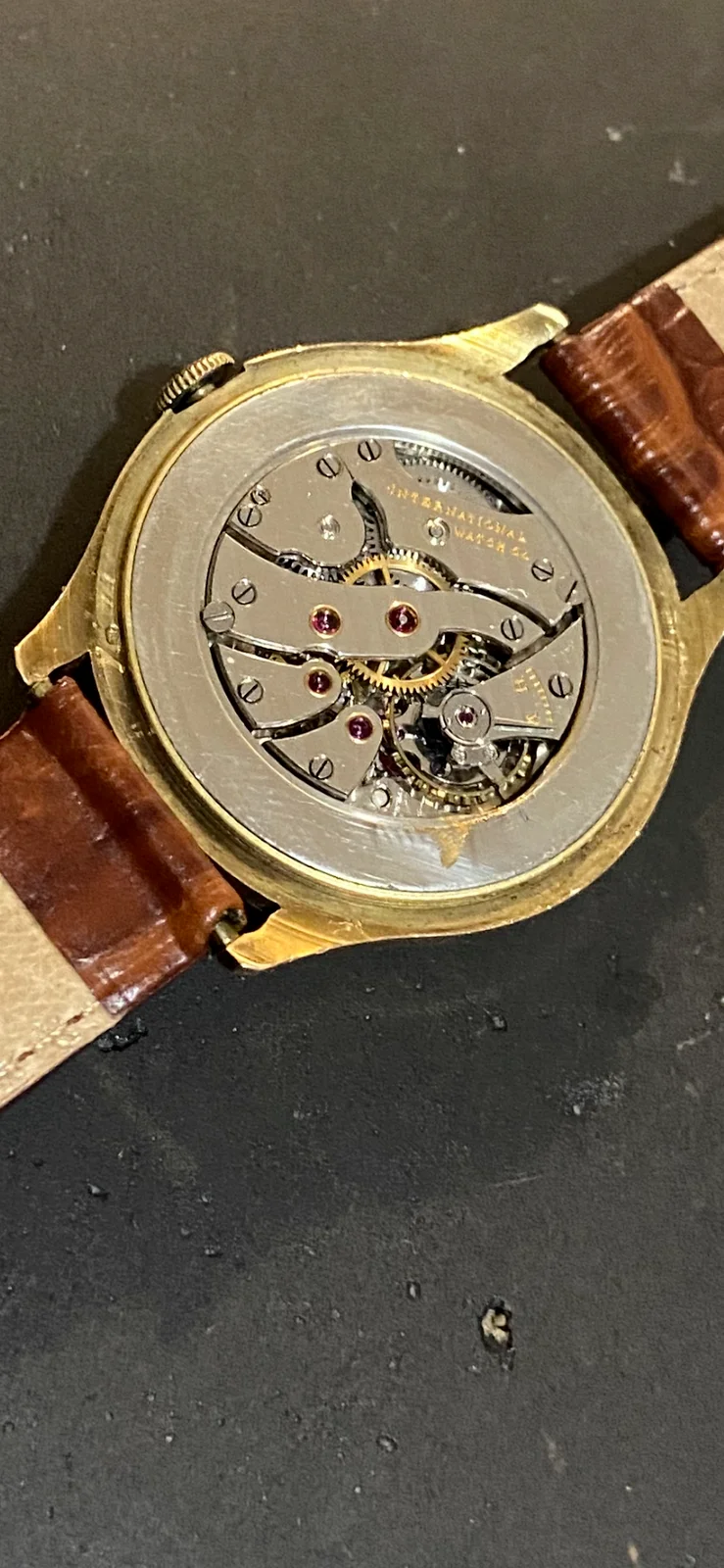

Posts 32 Likes 81 dirtydata ·Dec 7, 2024 hello of, just wondering if the Hermet only came with the Cal 83 movement and with 37 or 38mm case. Is there a 36mm version with a Cal 62? See photos below for the version seen in 36mm with Cal 62. Also is this dial redone?
Posts 1,922 Likes 3,699 Ron_W ·Dec 7, 2024 I think this dial is to large for this case as the minute track is to close/almost under the case edge, so this is not how it left the factory.
Posts 1,922 Likes 3,699 Ron_W ·Dec 7, 2024 I did see some Hermet with cal 89 and 61, but not with a 62.
