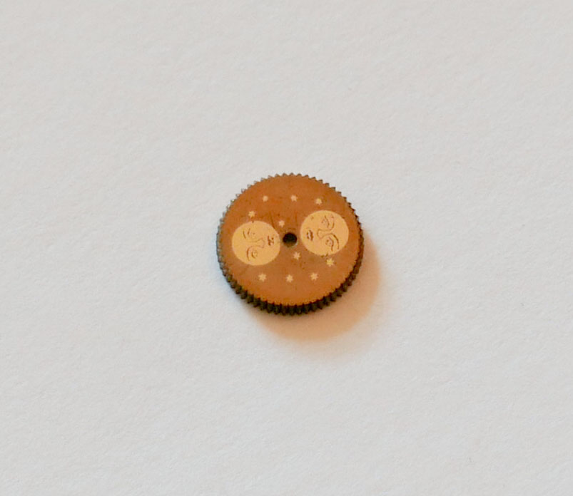

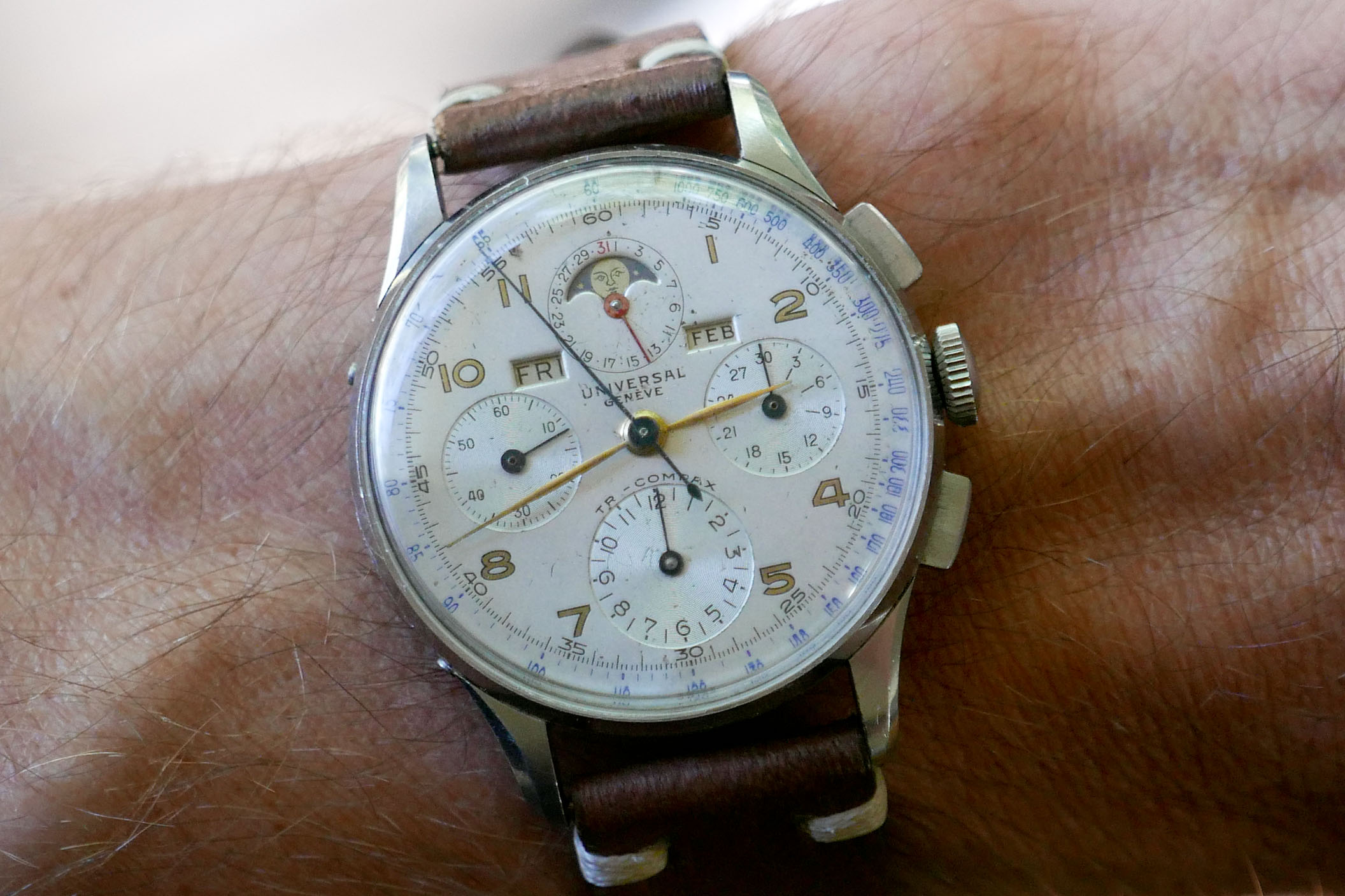

Others have already pointed out most of what there is to say. But just to record things visually...

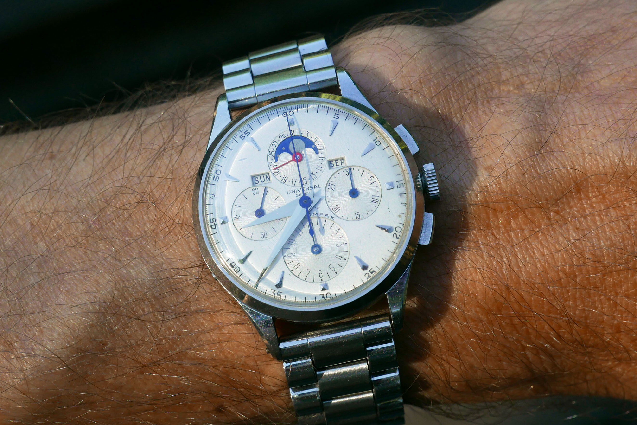

Below is a moonphase disc with face and blue paint intact:

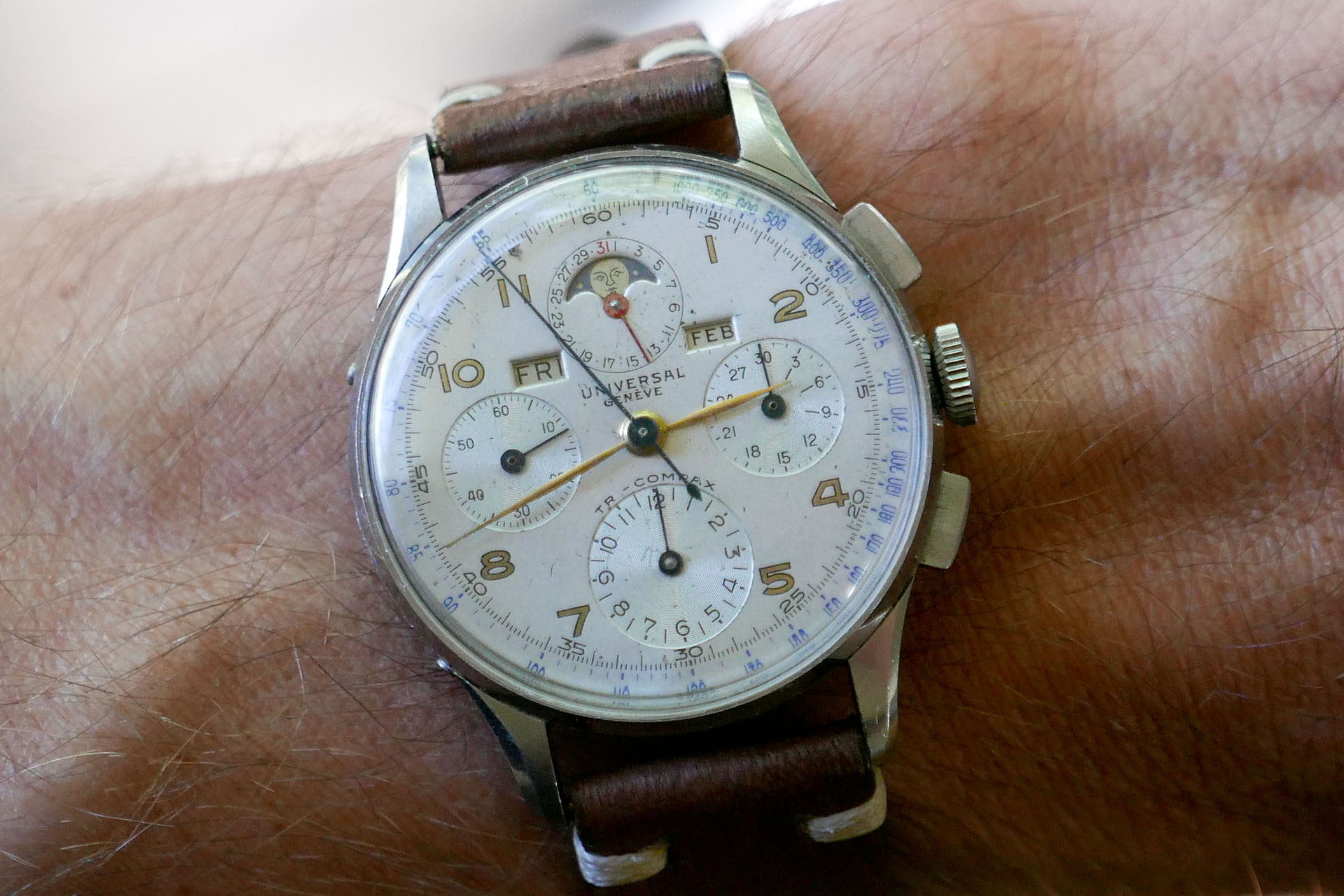

Below is a moonphase disc with face with blue paint faded to brown/gold, as the majority of them all have:

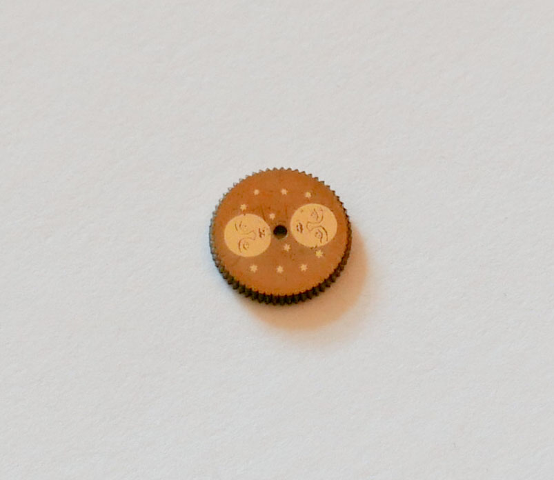

Below is a photo of the disc only, showing how the blue paint fades to gold/brown:
Below is a photo showing a moonphase disc with face with the blue paint in the PROCESS of fading to gold/brown:
Below is a photo of a moonphase disc without face (and correctly so I believe based on serial), the blue paint on faceless discs has not generally faded:
Here is another even later example, also correct with faceless moonphase disc:
As Larry already pointed out, while we don't have an exact serial range nailed down for the transition from face to faceless, the OP example is clearly in a range that should have a face. So it's been replaced. That could be because the paint faded, or perhaps the dial and moonphase were replaced together due to condition issues, it's impossible to know.
My PERSONAL approach to valuation regarding moonphase discs is that I place a premium on original, unfaded blue moonphase discs with face where they are expected by date. Slight less value to faded examples. Slightly less value to faceless examples where face is expected, as in the case of the OP watch.
However, in this particular example, because the dial and case are so clean, I actually prefer the faceless disc, even though not original, because the blue accent really makes things pop. So for me, I would not hesitate to buy this example due to the non original moonphase disc, if I loved the watch otherwise and the price was acceptable. I think the OP example is extremely attractive, I would want to see a movement shot. If the movement is pristine as the rest of the watch, that would be nice. If not, I might wonder a bit how much it's been "prepped", but this still would not put me off if the price was OK. But I will go out on a limb and say that I already suspect the price is probably beyond what I would consider acceptable, FOR ME.

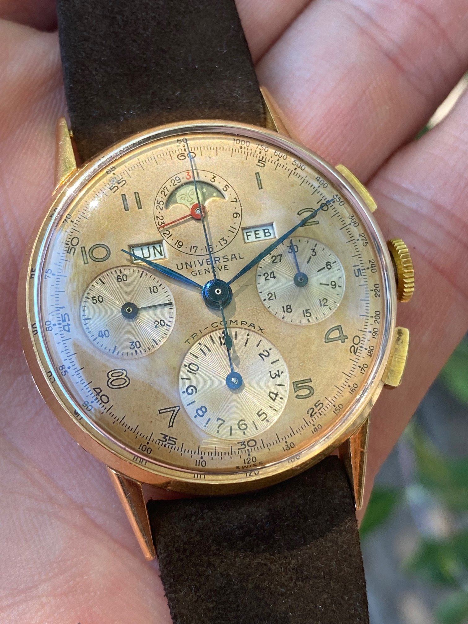

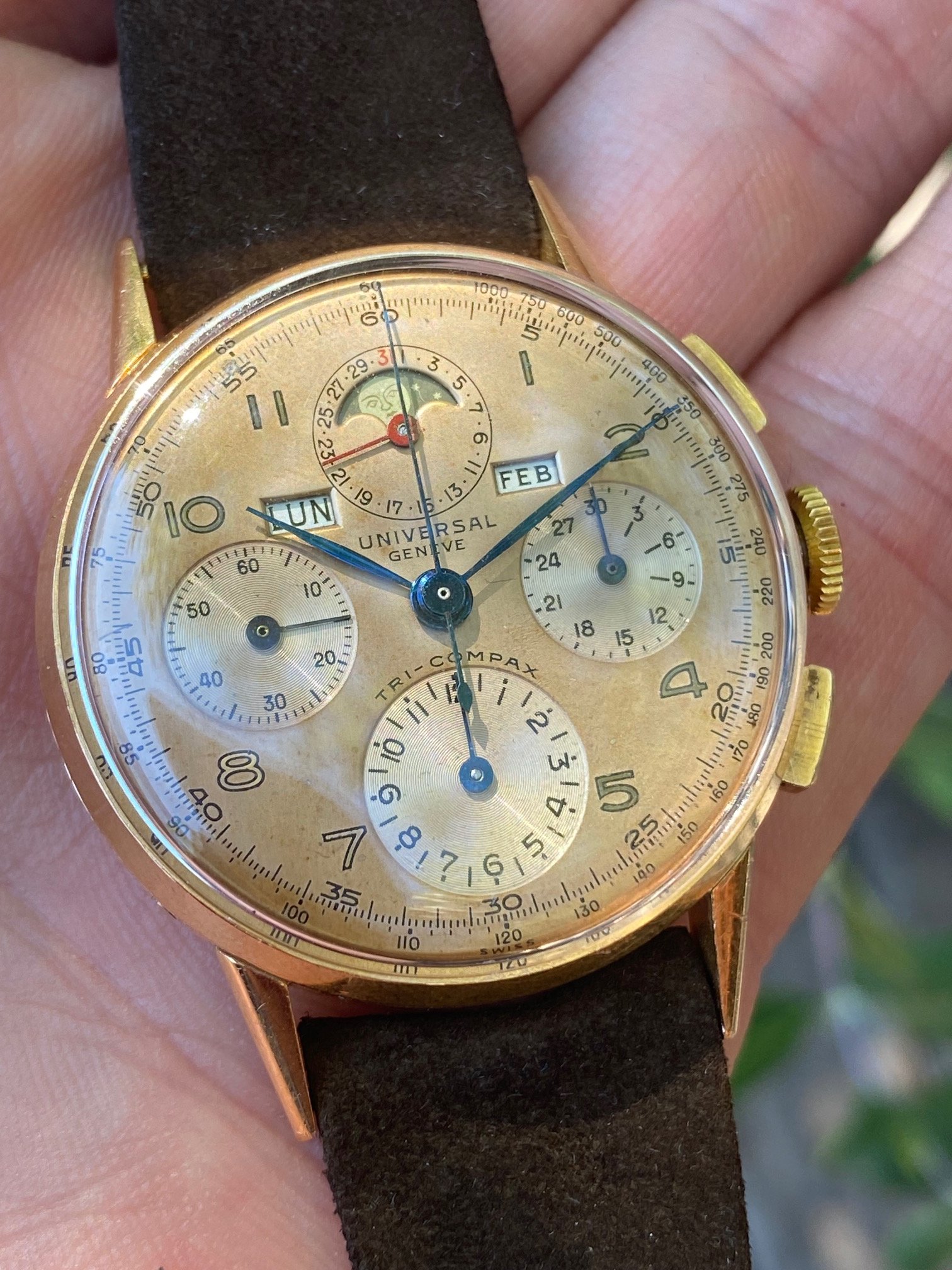

Thanks so much everyone for all your input!
I brought up a few of your points to the salesman
- Is the original moon phase disc still around?
- Is the dial a service dial?
- Was the crown ever replaced?
- Why are the reference/serial numbers stamped twice on the back?
- I asked if I could open the case back and take some pictures and he said he didn't know how to open the case back safely. He said he could ask about getting pictures for me
He was pretty clueless about everything I asked. He clearly did not have a lot of experience selling vintage watches. For context, this watch is at a store selling lots of luxury goods and he was definitely not a watch specialist. He said he'd pass my questions on and get back to me.
I'll give an update once I hear back. Hopefully everything checks out and we can agree on a price. Very excited

Went back in today to ask if they'd had a chance to get answers for my questions and take pictures of the movement. They didn't have any new answers or pictures.
However, they did say they have a 7 day return policy as well as a 1 year warranty. So theoretically I would have plenty of time to inspect the open case back and return it if anything was suspicious.
I am very tempted to buy it. Now my biggest hesitation is price.
It is listed at $19,400 and they are not willing to negotiate. Based on what I've seen on Chrono24, this is quite high. Here is a somewhat similar tri compax (with an original moon phase disc) on Chrono24 for $16,000
It is a very beautiful watch and the most aesthetically pleasing tri compax i've seen (to my eye, at least)
Is it crazy to pay $19,400? I think I would do it if $19,400 is actually close to the value of the watch.

It's a lovely watch, but that is completely and utterly batshit crazy insane pricing. Don't even give it another thought.

Roger that haha, guess this isn't the one for me. What do you think is an acceptable value range for this?

UG pricing is tough because it's so low volume, market comps are hard to find. I doubt you could find another watch like this one right now for sale, to compare. So it tends to be all over the map, and comes down to what a buyer is willing to pay. But setting all that aside and just going with my gut, taking into account the watch is supposed to be serviced, with 1 year warranty, from a dealer, I would say 10-12K USD. I'm not saying I would be in love with that price as a buyer, but it's I think in the realm of reason. As I buyer I would hope to get it maybe at 8K.
