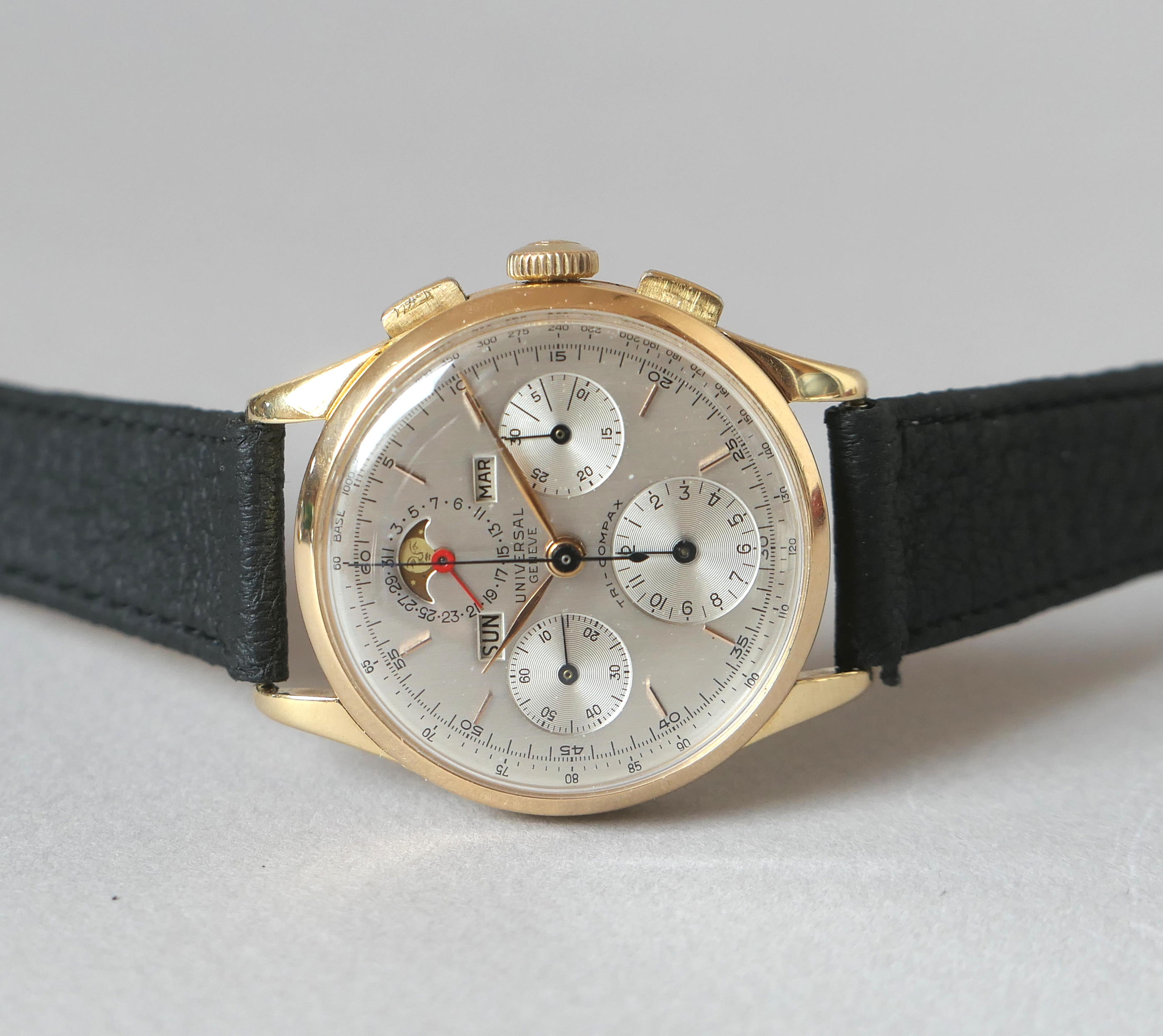

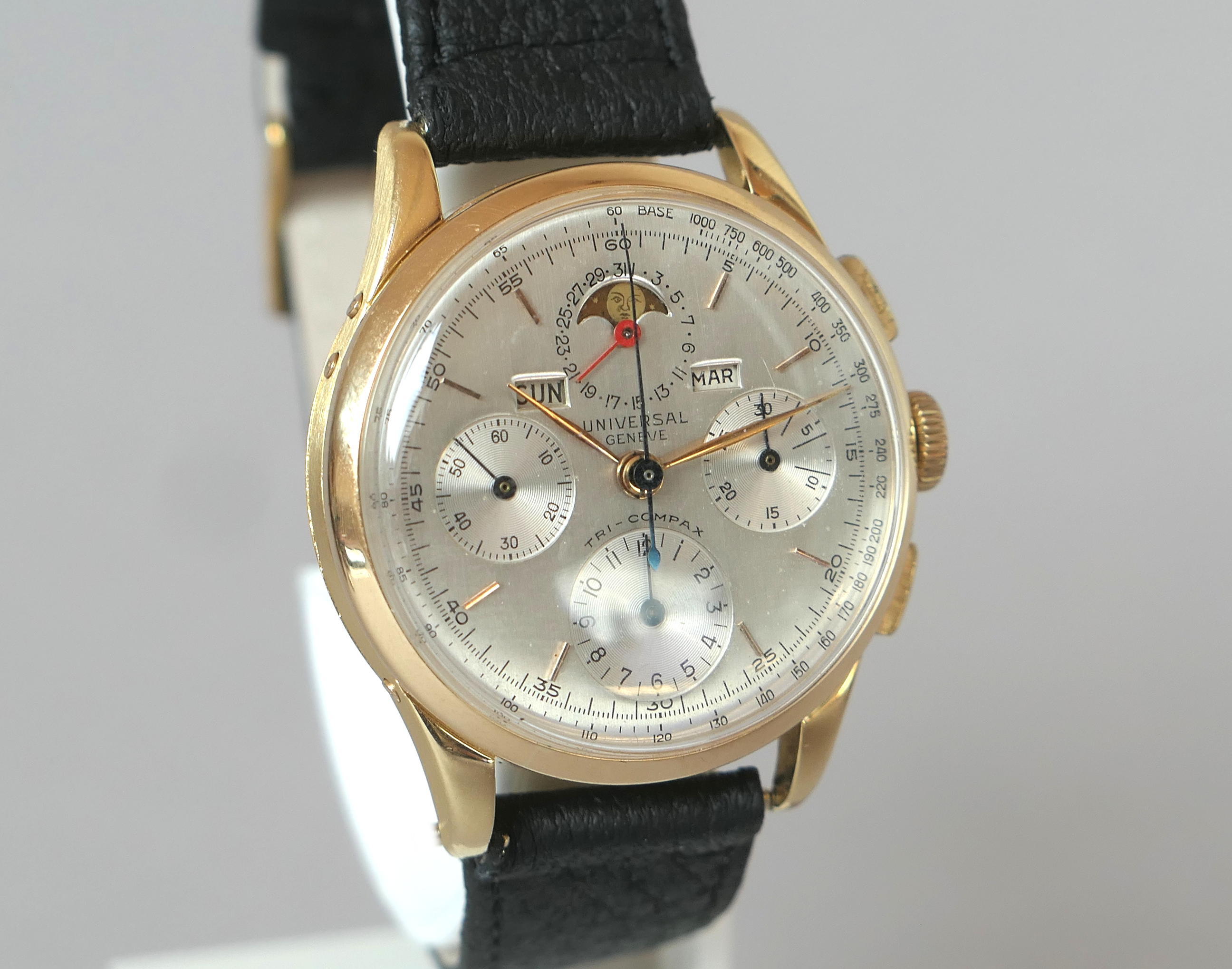

Hi everyone,
I posted a beautiful tri-compax here several months ago I was thinking of buying. Among lots of interesting things, I learned from this community that the price was too ridiculous to actually buy it.
Anyways, I've found a new example I'm considering buying. The price is higher than I'd like but I'm willing to pay it because it's so hard to find a good example.

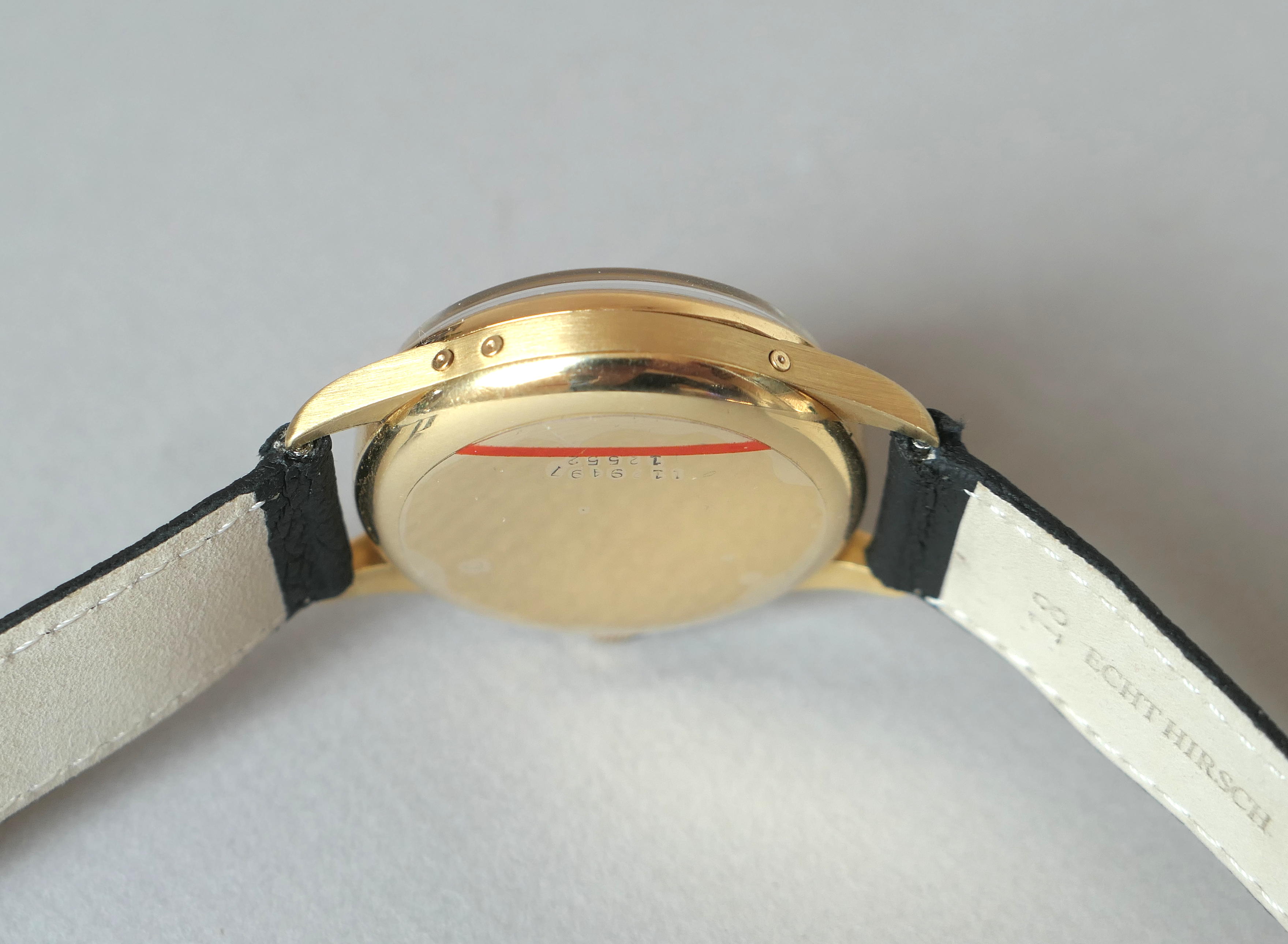

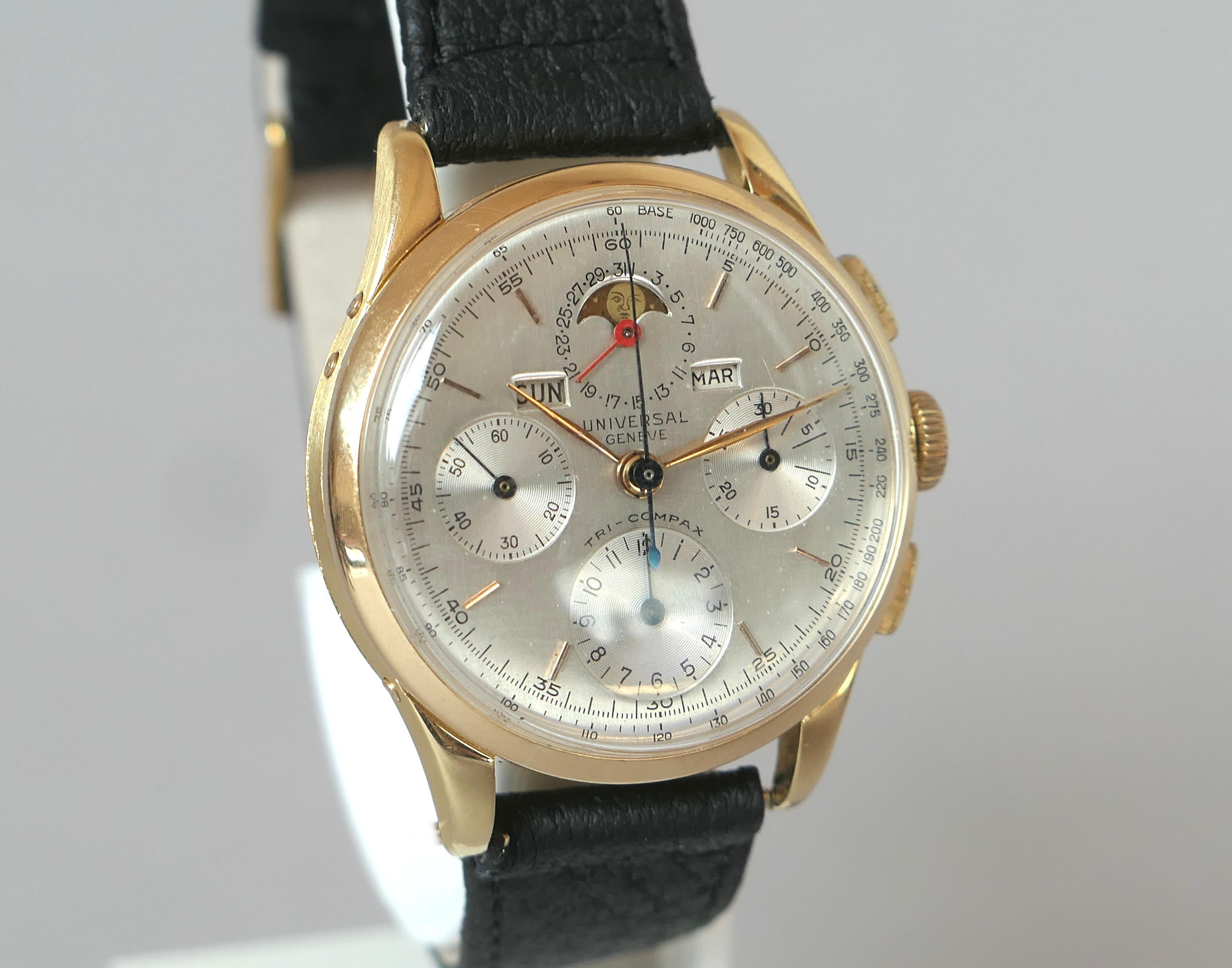

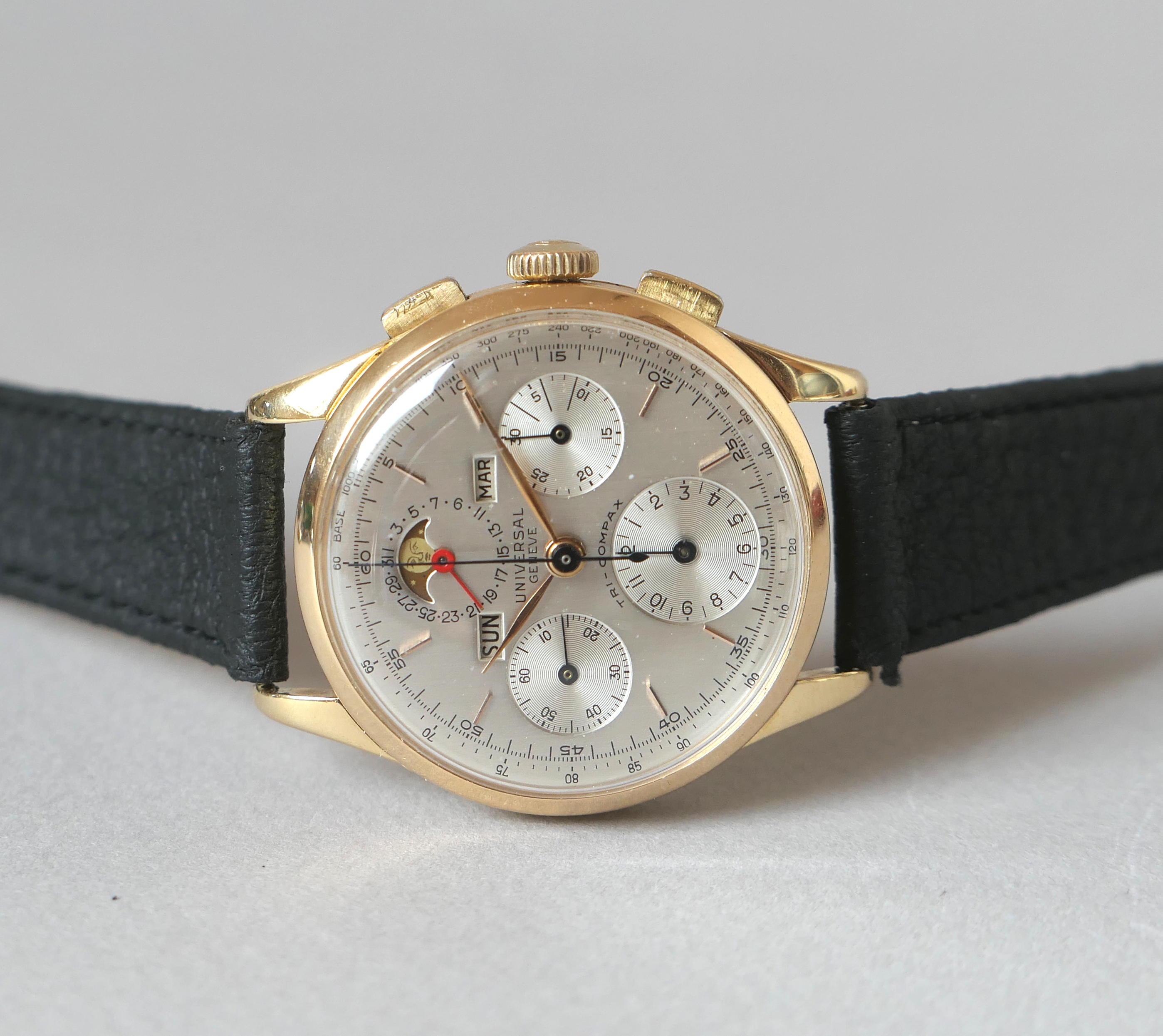

I would like to know if you have any insights about this watch or see any red flags before I purchase it.

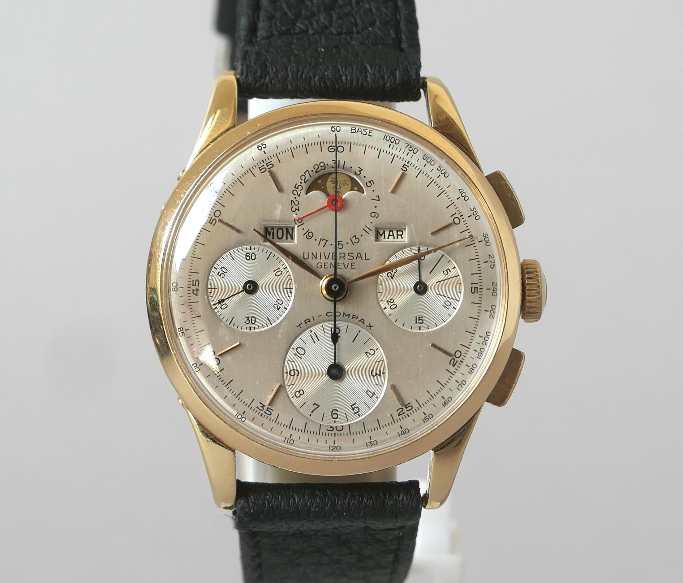

- is the dial original/is it a service dial?
- is the crown original?

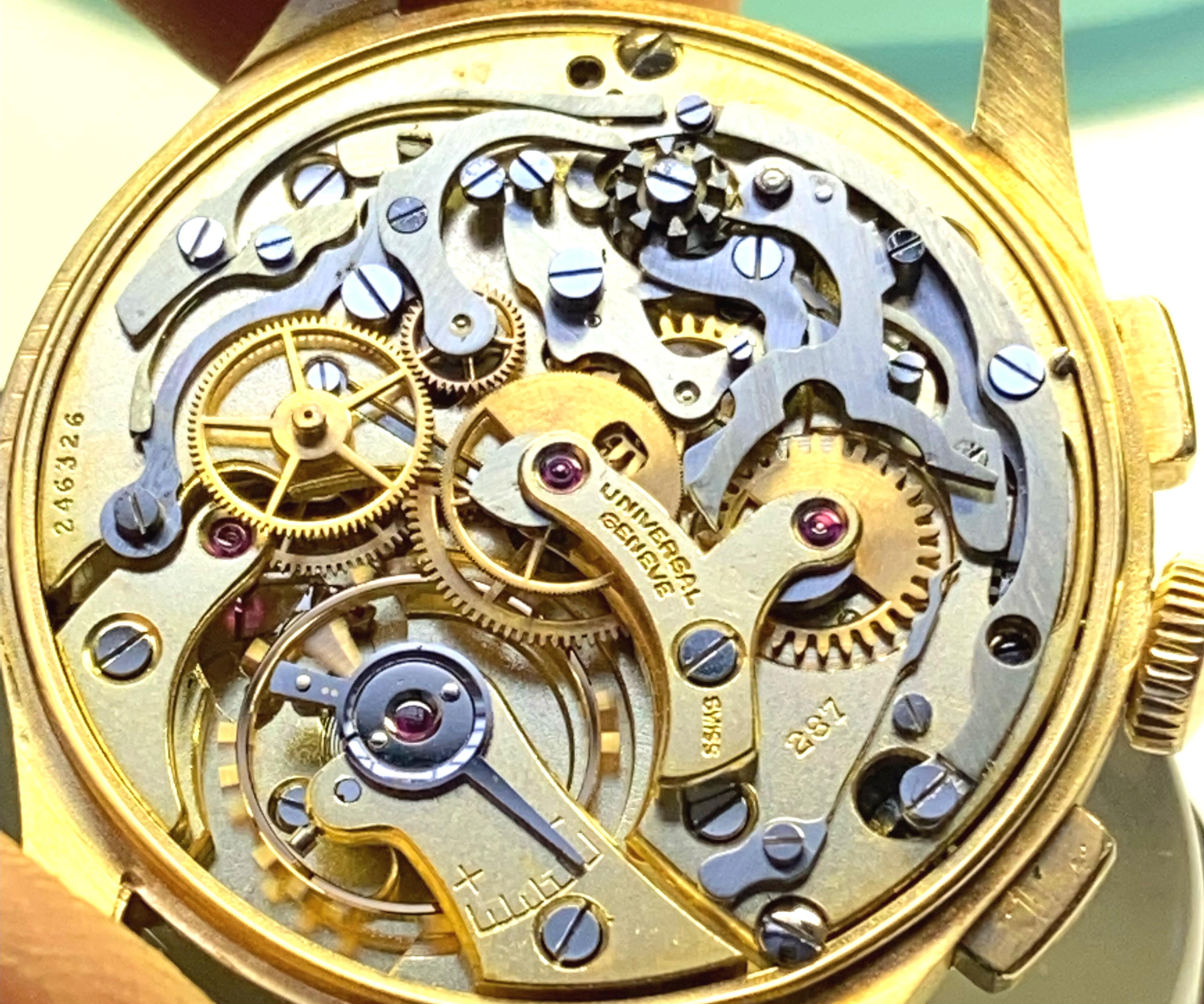

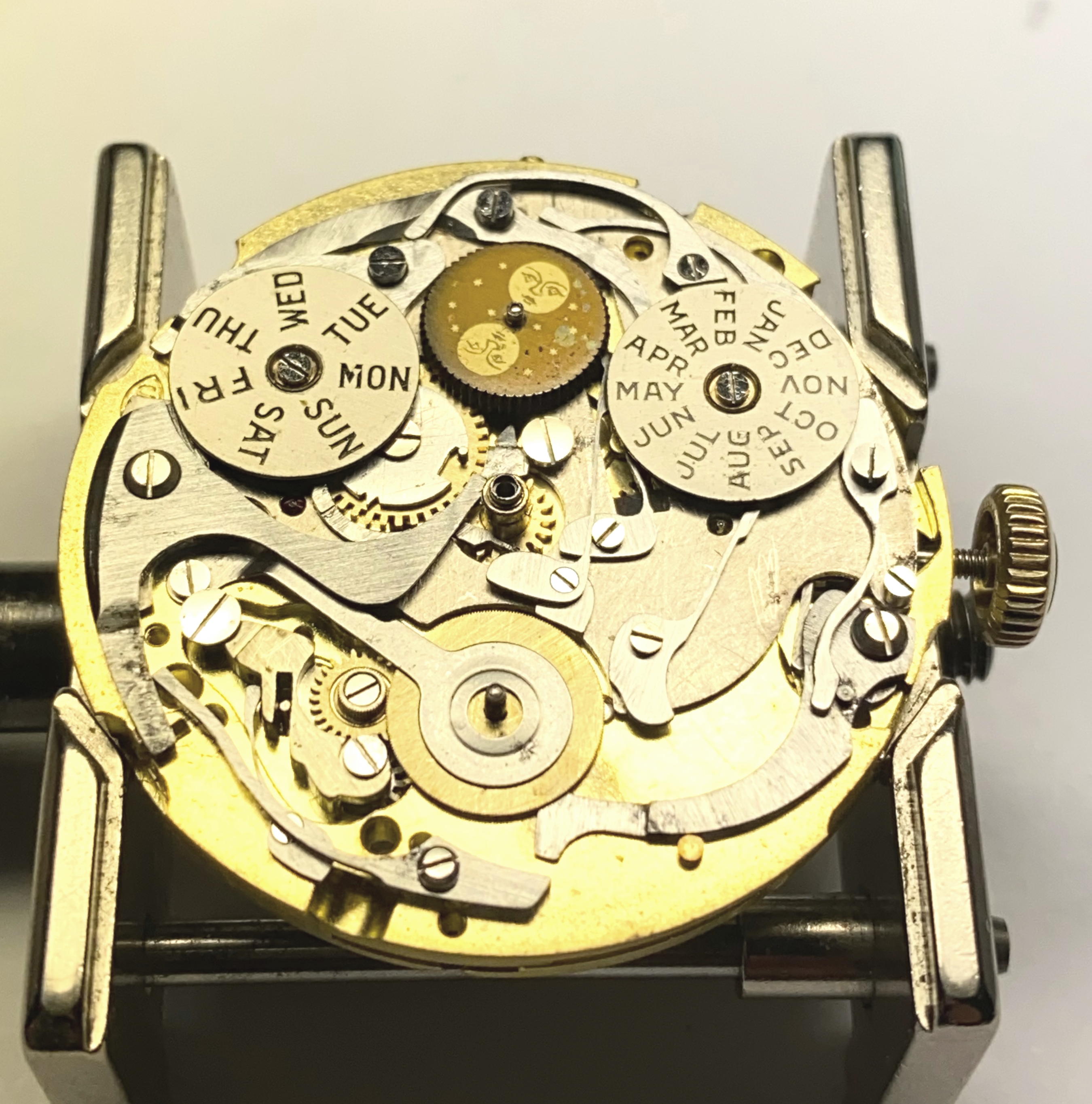

- anything notable about the movement?
I appreciate any feedback!

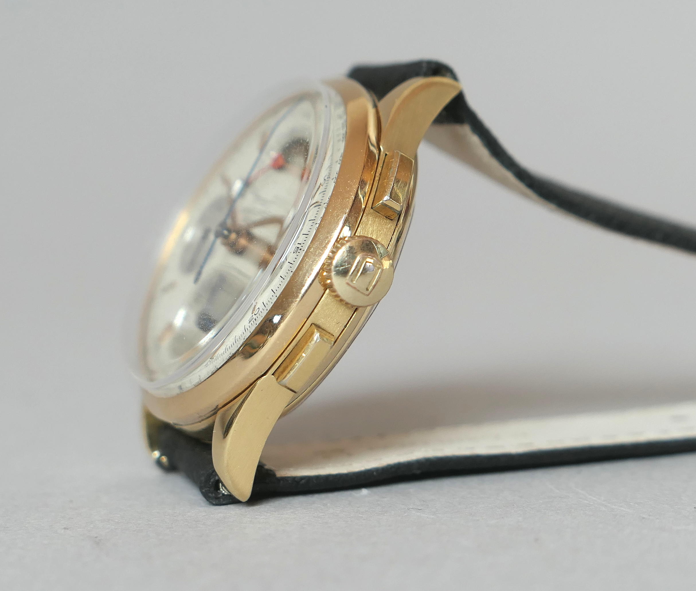

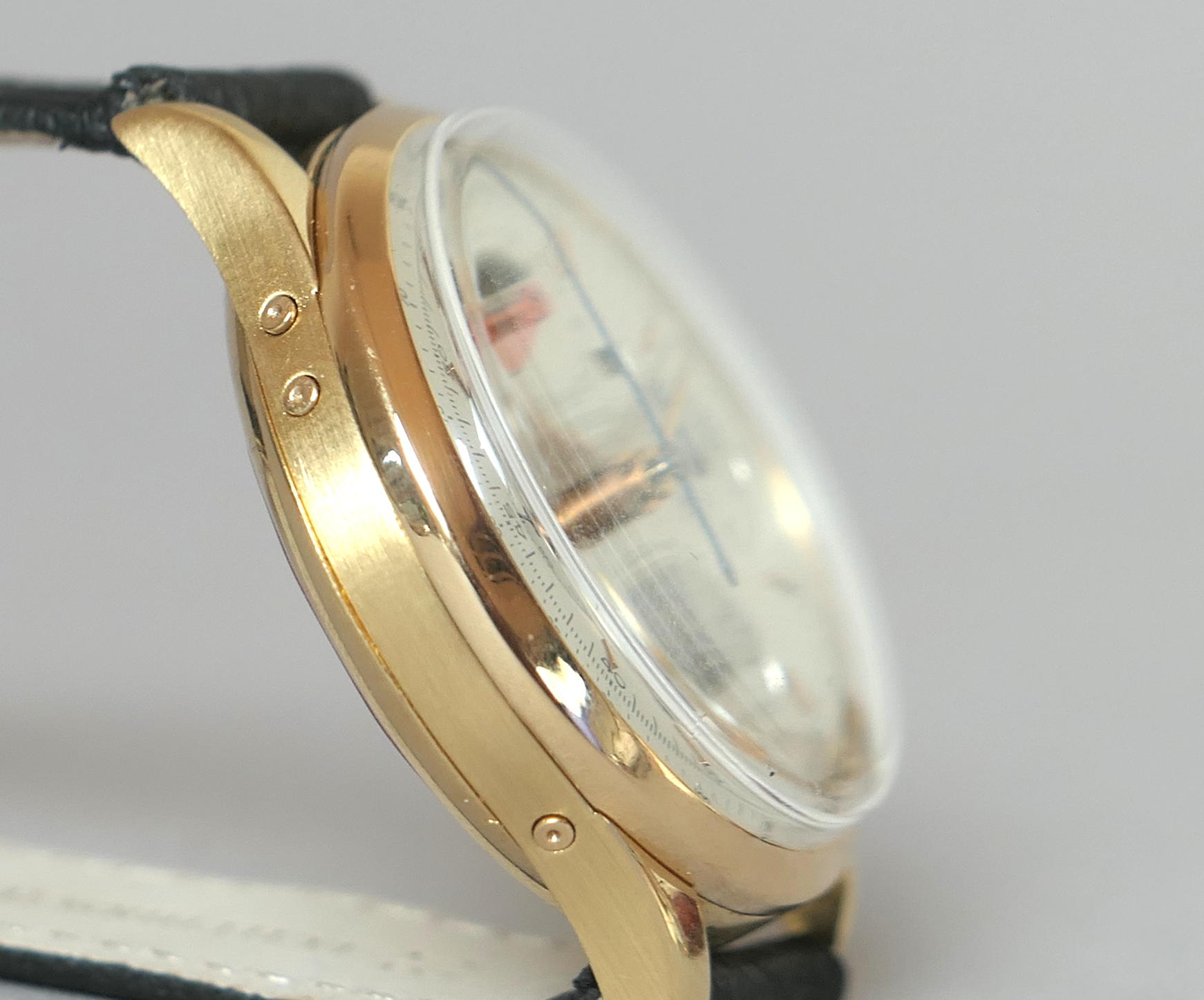

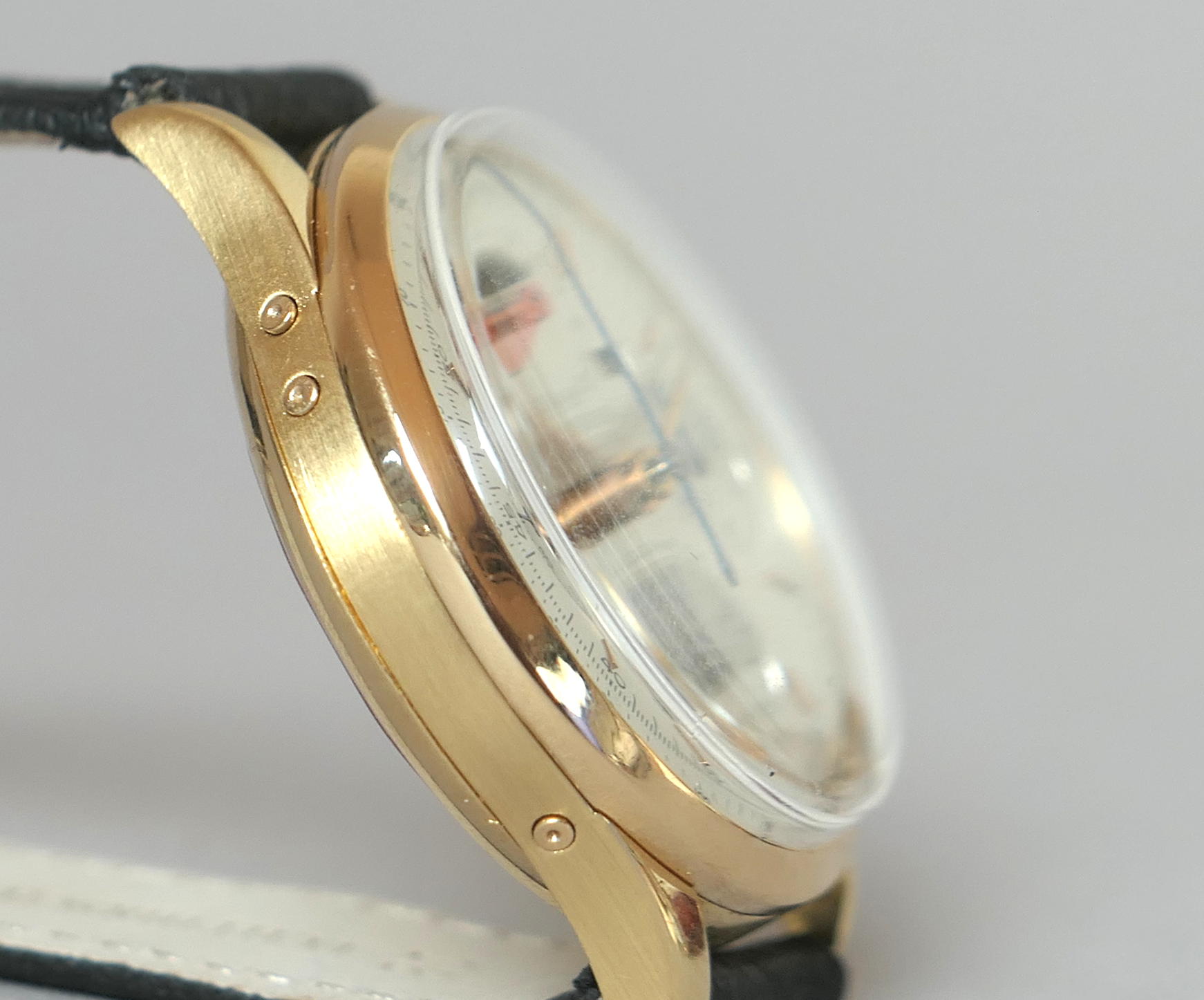

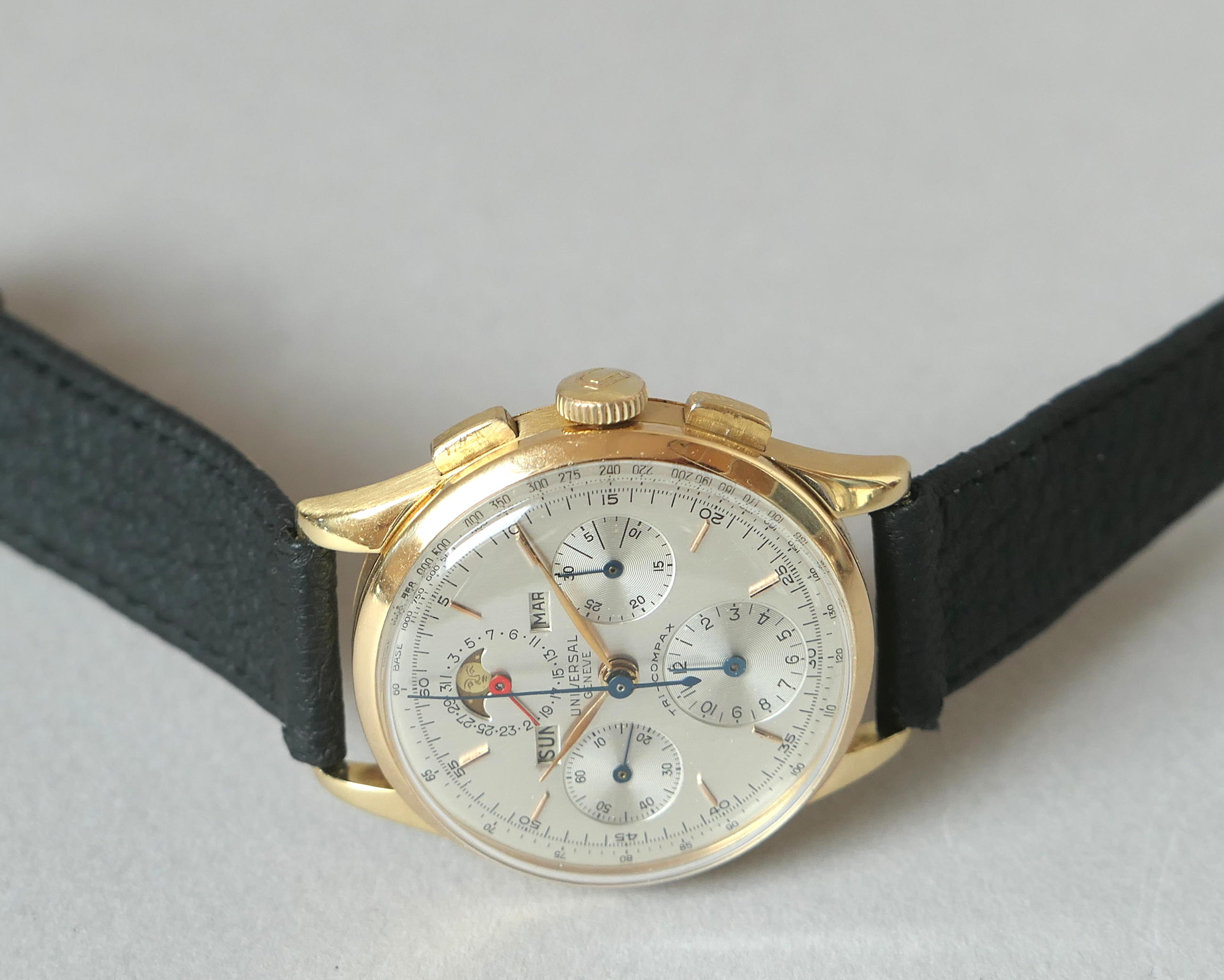

It looks quite nice in general, I think the main question is probably price. If I were to have any complaints the case looks a bit polished and the crown is later replacement, but that would not put me off if the price was right. If the price was quite high, I might not want such a polished case.

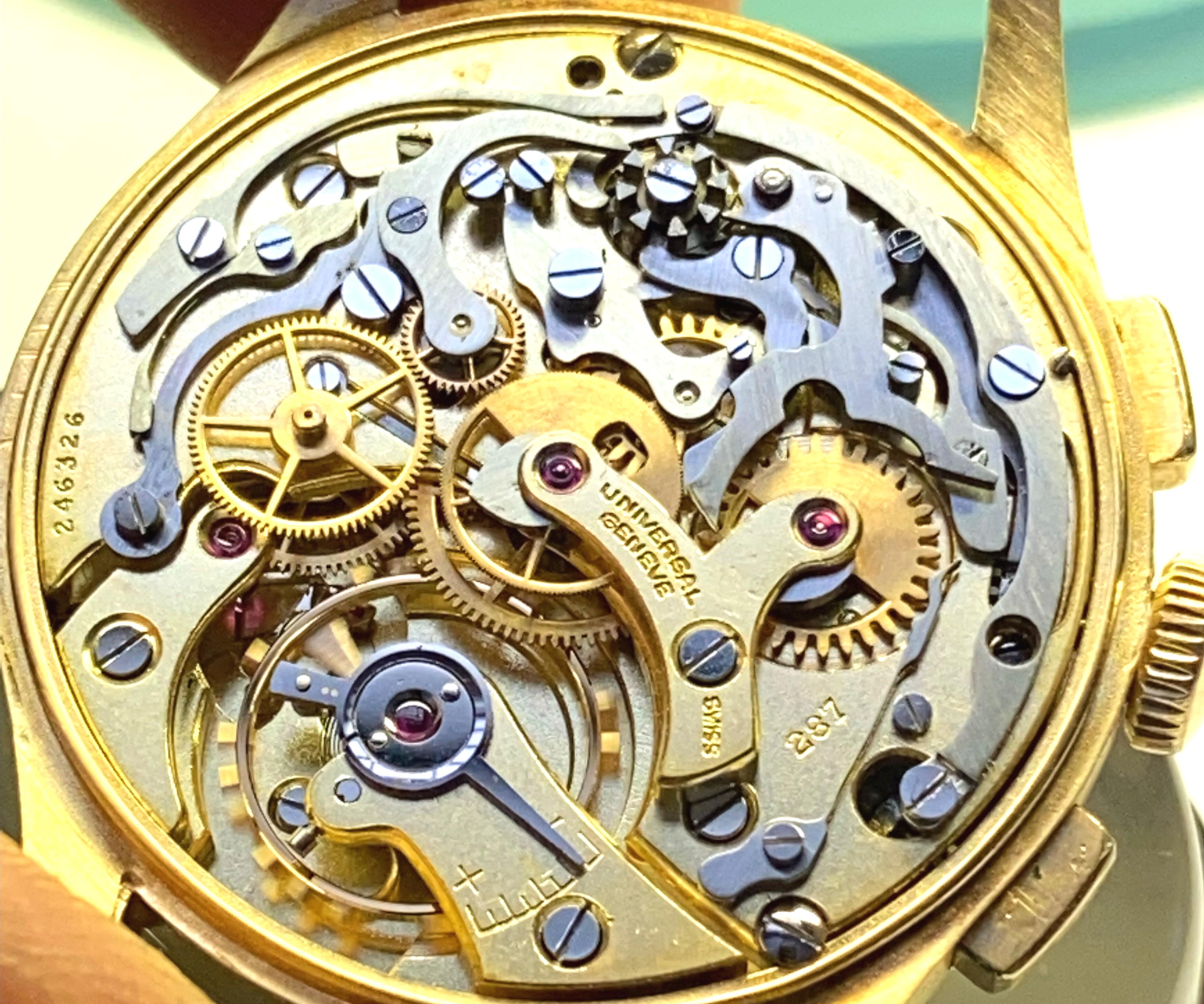

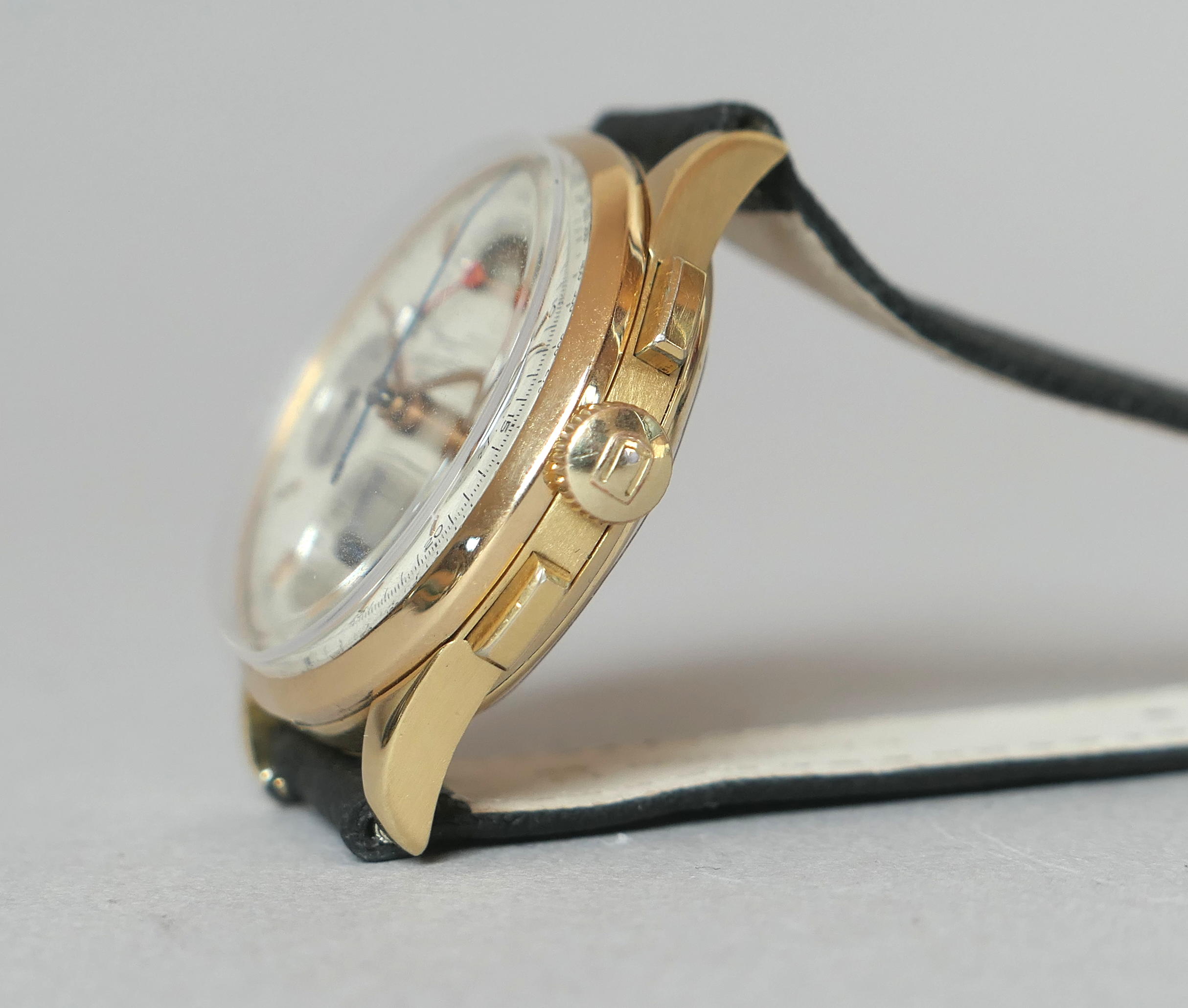

Great original dial, original moon disc. Clean movement. Crown is to be expected in a watch this old … overall the only issue is the high polish ….that said, there is so much crap out there. This is a good watch but would be great if not for the buffing wheel. The original spring bar studs are there so the case is still relatively unmolested.

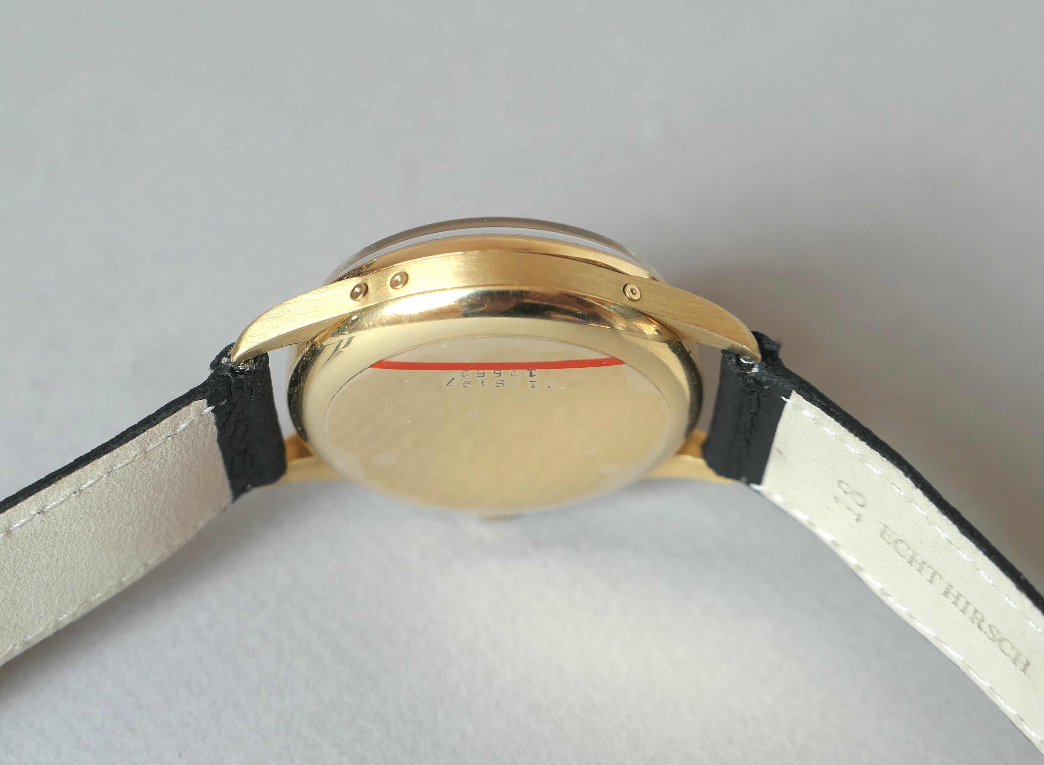

What indicates the level of polish in these pictures? Still learning this stuff

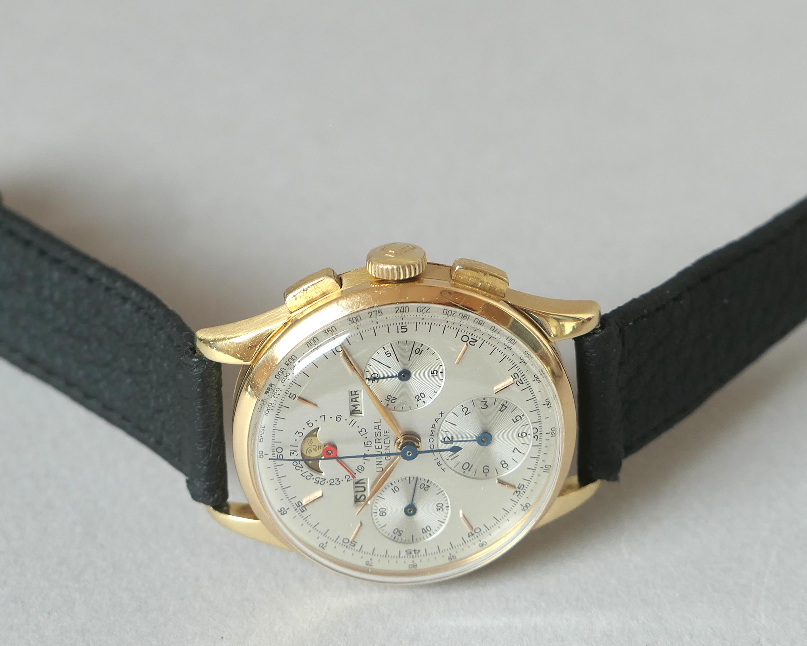

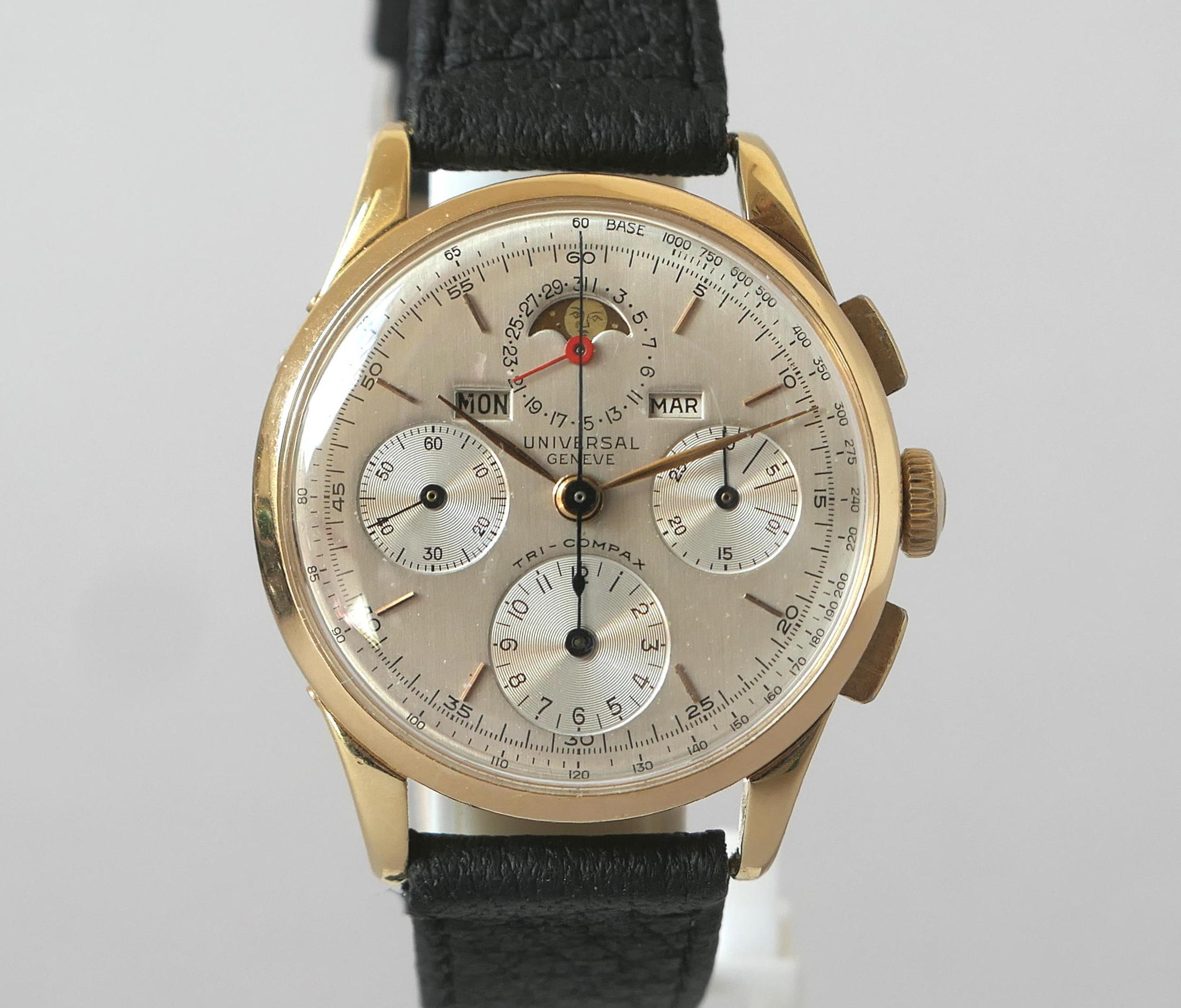

I don't know anything about these watches, but I notice that the day and month wheels have different fonts. Is this typical?
1,161
6,815

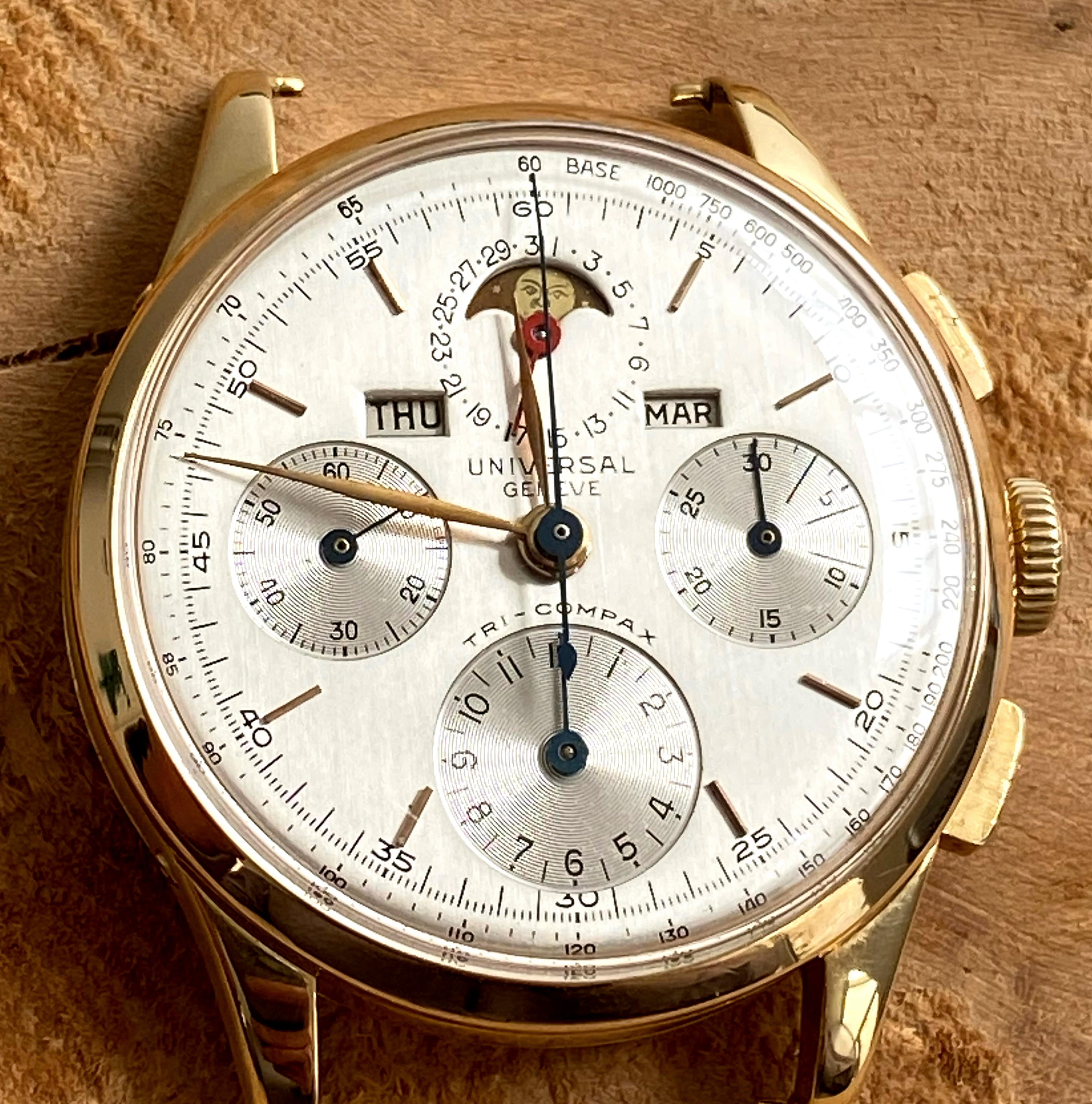

Am I the only one who thinks there might be something off about the date ring? I’d expect it to be smaller - the 21 is hanging over the day window - and either recessed or with a circle round it.
and the minute hand extends all the way into the tachy ring…

287, dial outstanding, MrMoon original, case 8/10 & extremely clean movement
what not to like? Hand? Maybe just right. How mine is.
Oh yeah, 10k.............you won't care 12months from now, or 5years from now.
Lugs are very shiny and a bit rounded off. Caseback is also very buffed. That said the overall package is very nice.
Not unusual.
Nothing odd here.

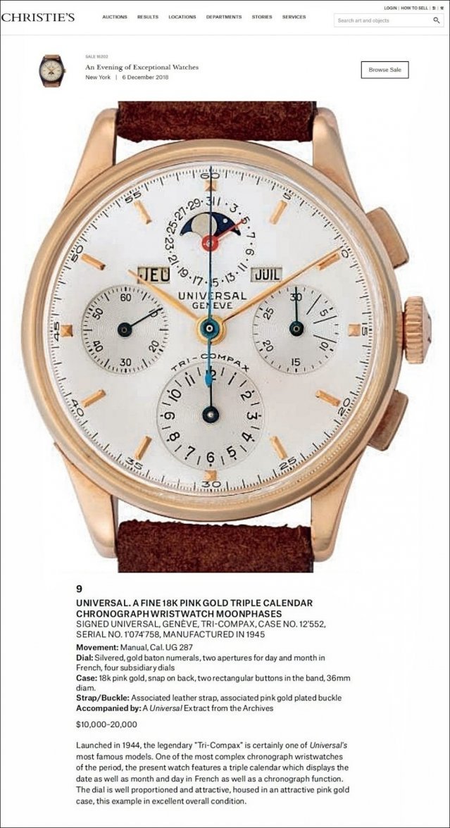

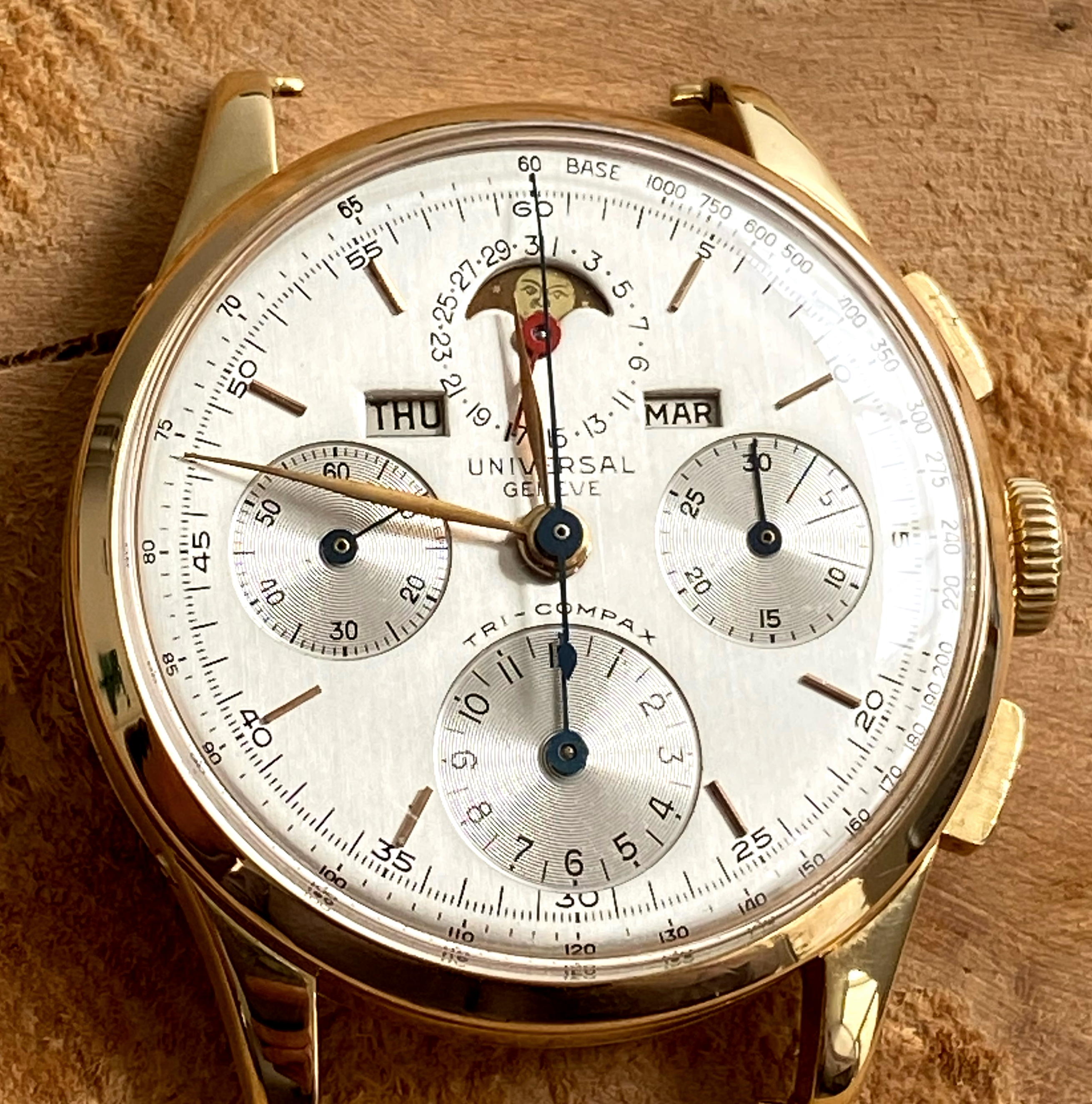

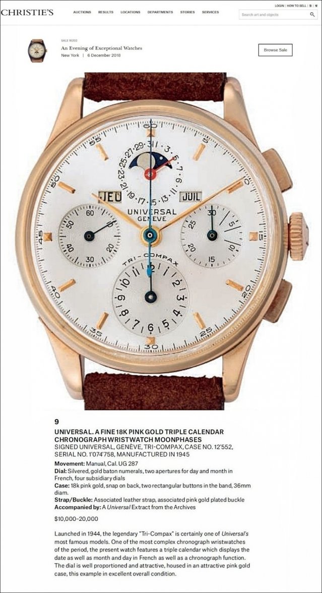

this example was posted in the long reference thread about UG Tri dials. On the example below the moon phase disc and crown are replaced. It’s possible on both examples the dial is not original to the watch, but still original UG. But to determine that would require a lot of research and guesswork. I do tend to associate the non outlined non recessed date subdial examples as “later” in my mind, but I’m not sure why.
anyhow in short I think both dials are factory UG, but as always, determining if the dial started out it’s life in these particular cases is impossible.
https://www.christies.com/salelanding/index.aspx?intsaleid=27710&lid=1&saletitle=

Price is $10k btw
a bit on the high side to consider this a good buy...
(although, as a Tri-owner, I like these prices a lot...)

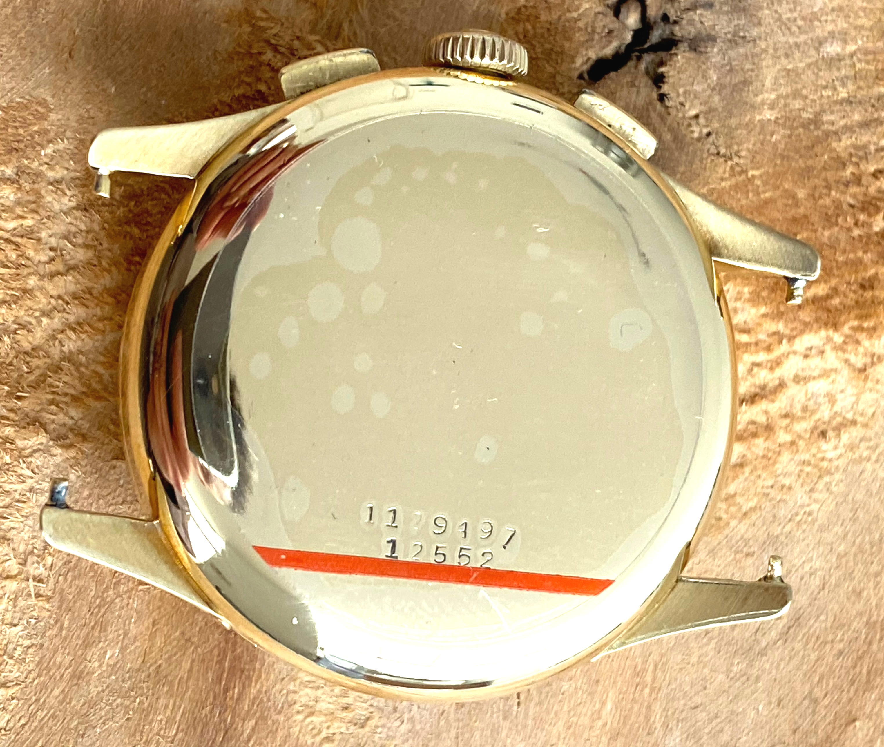

apart from that: The serial tells us that the watch is from approximately 1945. This is consistent with the moon disc. However, I believe the dial to be later, as it has no circle around the date.
spot on ...

Still a UG 40’s dial with the open 6.
40 to max 49 style (open 6) is common on re-issue dials. The tell tale sign is the minute counter is split in 5 min not the classic 3 mins (1/20th of an hour) as the were commonly found in the 30s and 40s. Almost all very early tri-compax moon models had minute counter split in 3 (ie 0, 3 (1/20), 6 (1/10th) etc). This dial is split in 5s which points to a later (60s) reissue. Check the "dial variats" thread ...

I’d still like to see the OP’s example with the date set to the 1st to make sure the date ring is centred. It maybe the photos, but it looks as if it is set lower than the Christie’s example
