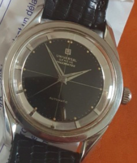

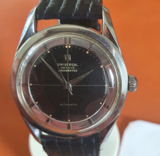

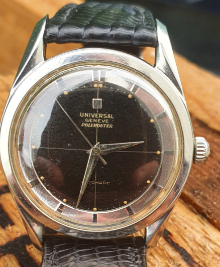

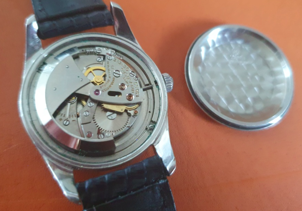

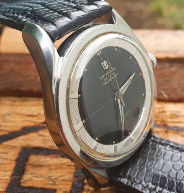

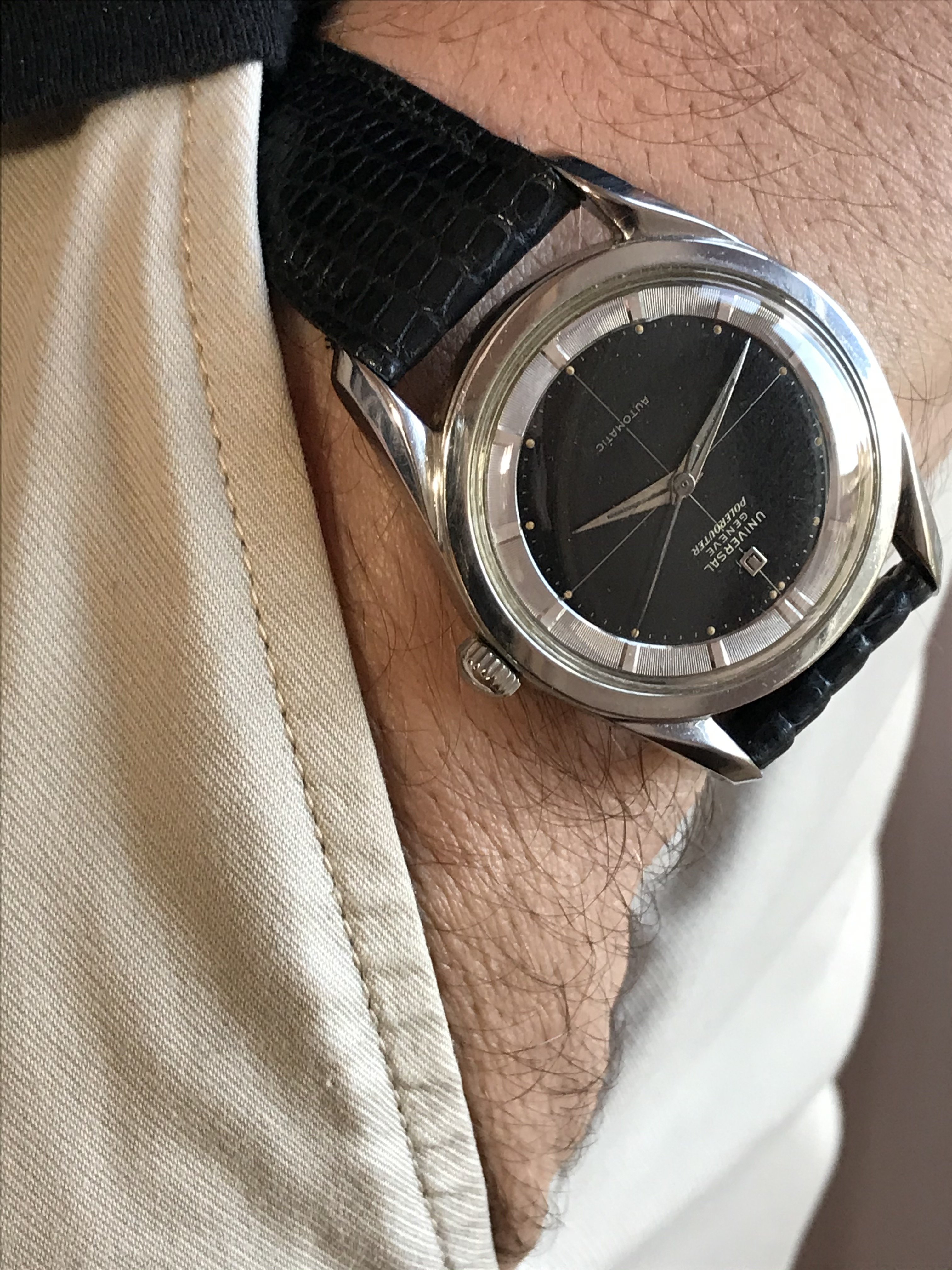

Hi everyone,
Still looking for my first polerouter. This one is equipped with a bumper 138 SS not a micro rotor (1st on my wishlist) but everything seems legit to me.
Can you confirm ? Any comment ?
13,671
19,041

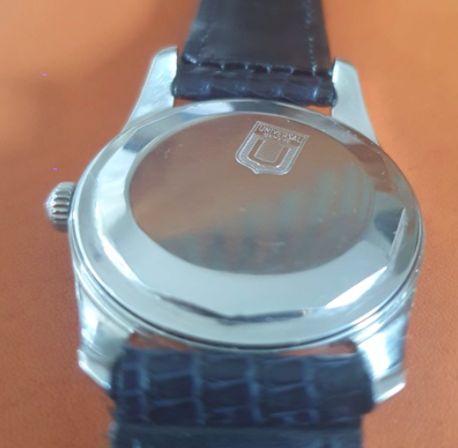

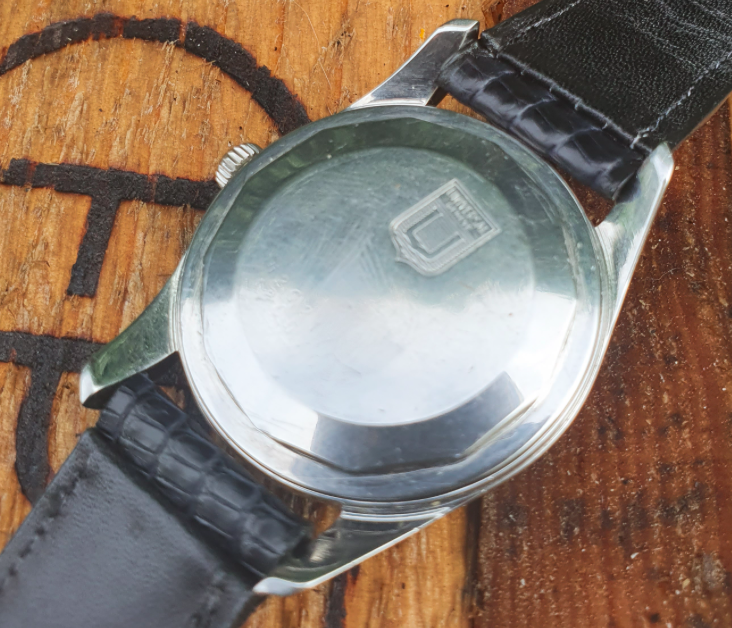

Dial, hands and case look OK to me. Maybe a little polished, but not too bad.
Seller needs to get rid of the flash when taking pictures. The glare has obscured the serial number and case reference number on the back. This is essential to determining if the dial and case should be together or were assembled from different watches.
In the end, it will come down to price vs. condition.

Thanks for answering @gatorcpa
Here are the model & ref number :
H 20217-4
1805XXX (I prefer not to put them here)
Seems all ok to me (except a small doubt on the hands : should they not be "big lume" ?
Asking price is 1350euros
What do you think ?
13,671
19,041

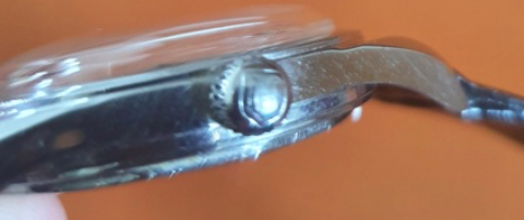

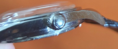

The prices on these have gone wild the last few years. I bought this reference with a silver dial for a little over $200 back in 2012.
From what I can tell, the crown is from a later model but at least it is signed.
IDK, I think it’s too much money for this watch, but others will differ.

Great question re big lume hands.
I believe the later the serial then the more likely it is to have had the hands with the large triangular lumed sections.
I owned an H20217-4 with big lume hands with serial 1'827'xxx. Had yours had a later serial then that might have been a concern.
You could look for more examples but @CafeRacer might be able to save you the time as I imagine he will have seen a decent sample size.
I suspect yours is correct based on that serial and it also strikes me as unlikely that the hands would have been swapped.

Oh my... 200 !! Thanks @gatorcpa for sharing facts & thoughts.
I'm actually willing to discuss this price further (I am a little unsure about the polishing of the case/lugs) but that's right that for the last 3 years I've seen the prices rising a bit and even more I don't see often a black dial, lyre lugs, legit coming out...
Regarding the big lume hands, I wish this model would have come with them but I agree it seems unlikely the ones from this watch would have been swapped. Thanks @Mazoue for this reassurance.
The owner said it is his dad's watch and that his dad was the sole owner of it.

I saw it too (I'm also looking at one, but prolly later during the year) and it looks nice, as previously said, a bit polished but not dramatically.
I'd go down in price, that said. Plus vers les milles-deux, si possible.
What does the seller means by "only one owner". Is he/she the only one or only owner before him?
Either way, does it mean he has more information on the services etc ...
Edit: didn't read the last sentence of your previous post... Does the father has any paper/box?

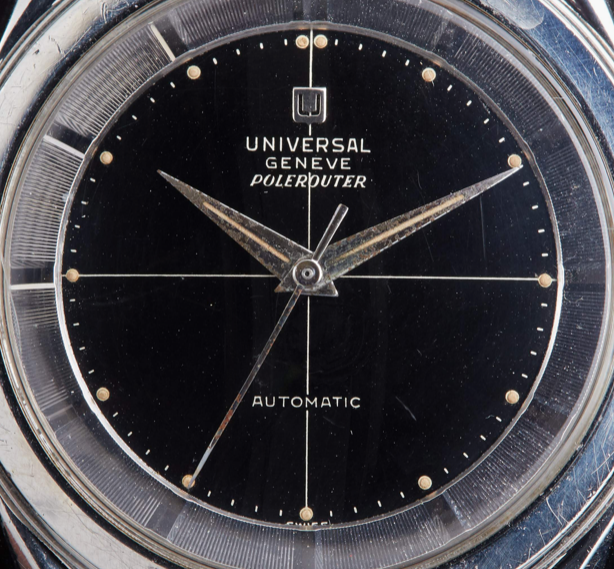

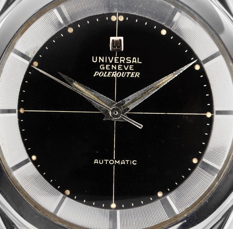

411
1,076

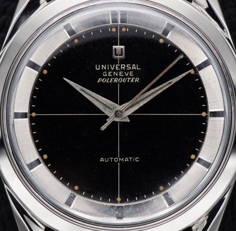

The parts all look genuine to me, but the lume plots are the type usually seen on the earlier 173-177 serials.
Add the difference in lume colour, and there might be something worth investigating...
I recommend you search for more 180 serial H20217-4 and compare.
For reference, the "big lume" versions only seem to appear in 182 serial range, both silver and black dial variants.

Hi @CafeRacer
Thanks : the hands were puzzling me but with your comment and the one from Mazoue, this part seems cleared.
I've PMed you with some H20217-4 references I've found. Including one in C24 for the question of the lume plots and color. It all seems ok to me but I do not have your eyesight 😀

411
1,076
Regarding the difference in lume plots, it is most notable at 12 - larger with white ring edges.
The 12 plots are close together.
On the 18xxxxx dials these plots seem to be the wide type, and smaller.
Theres a difference in lines/crosshairs intersecting text, but its not quite unique to this case and gets a bit more complicated with smaller ranges.

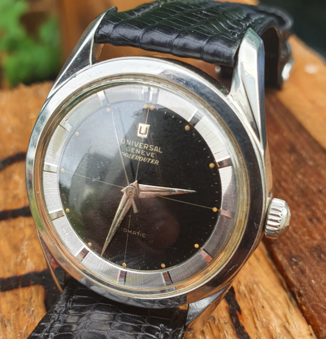

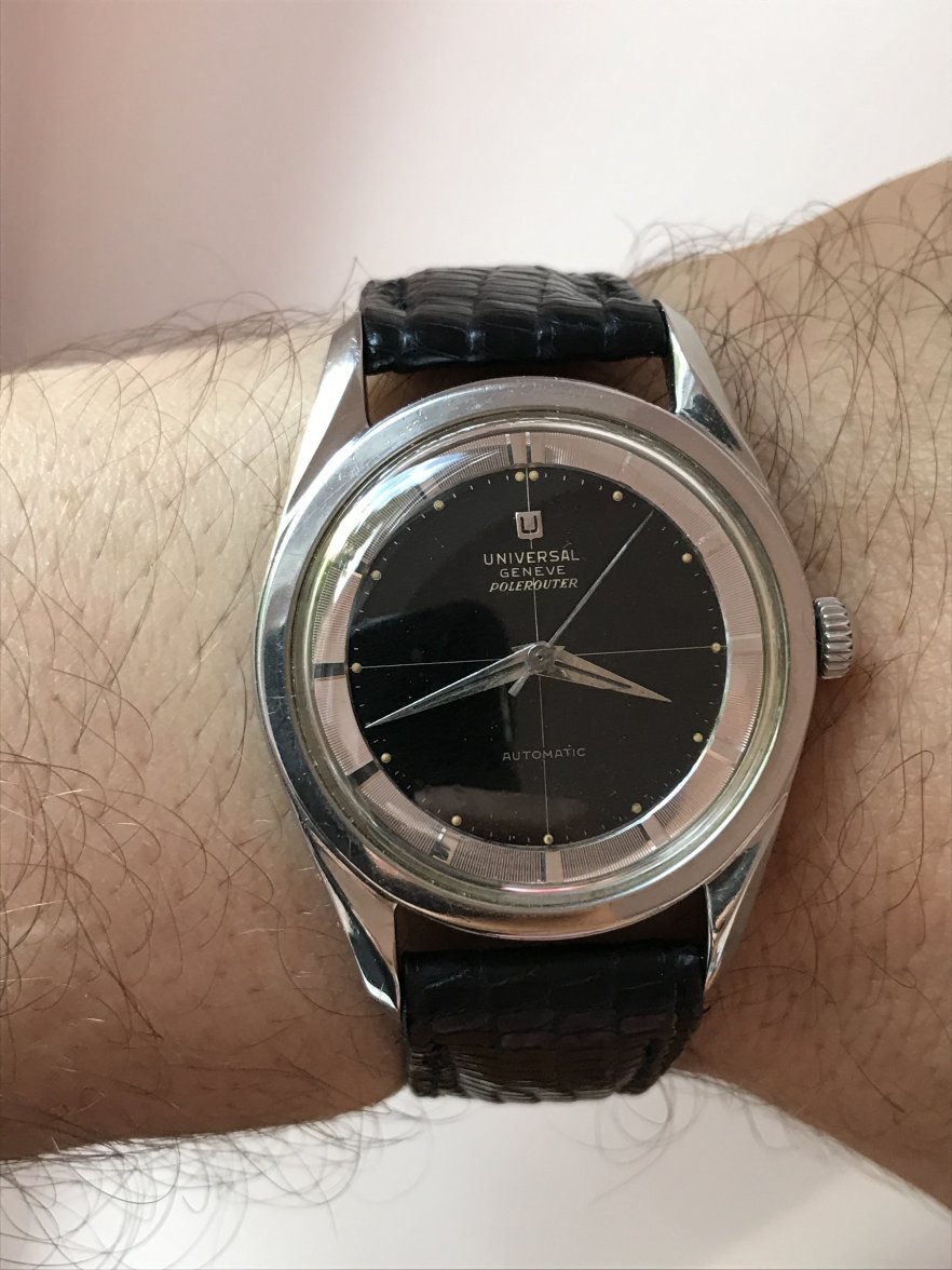

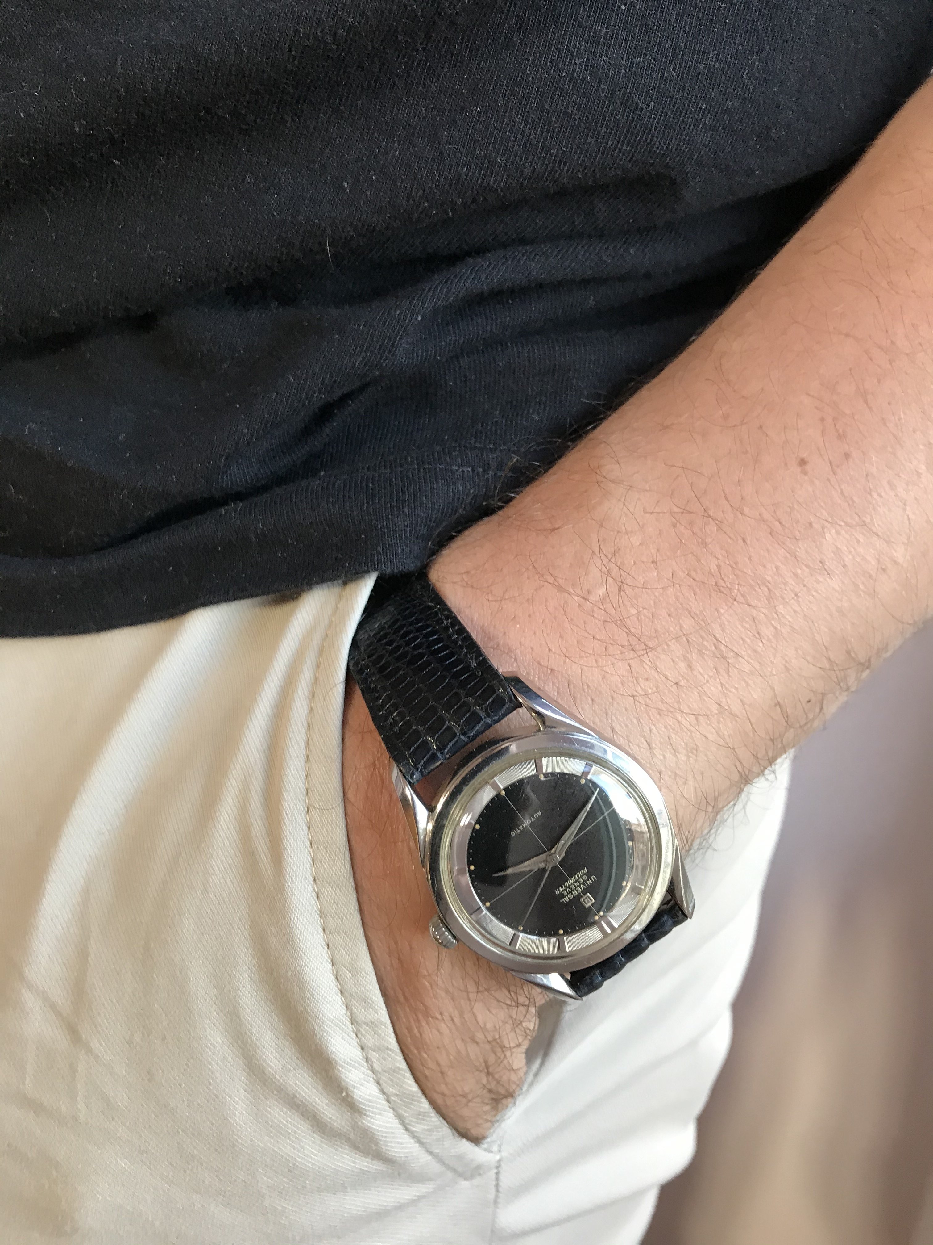

Hi Everyone,
Thanks for all the comments and helps here.
The pole router arrived and I'm happy to see that it looks better in flesh than in the pictures I shared.
4,043
45,695
Je suis jaloux!! Félicitations, elle est canon.
Indeed, looks better than on the seller pictures! Enjoy and wear it in good health.
Does it run smoothly?
1,413
13,630
Merci bien 👍
Indeed it seems to run smoothly : 2nd day on my wrist and everything is fine.
Anyway as usual I'll go to pay a visit to my watchmaker to have a look 😀
1,413
13,630

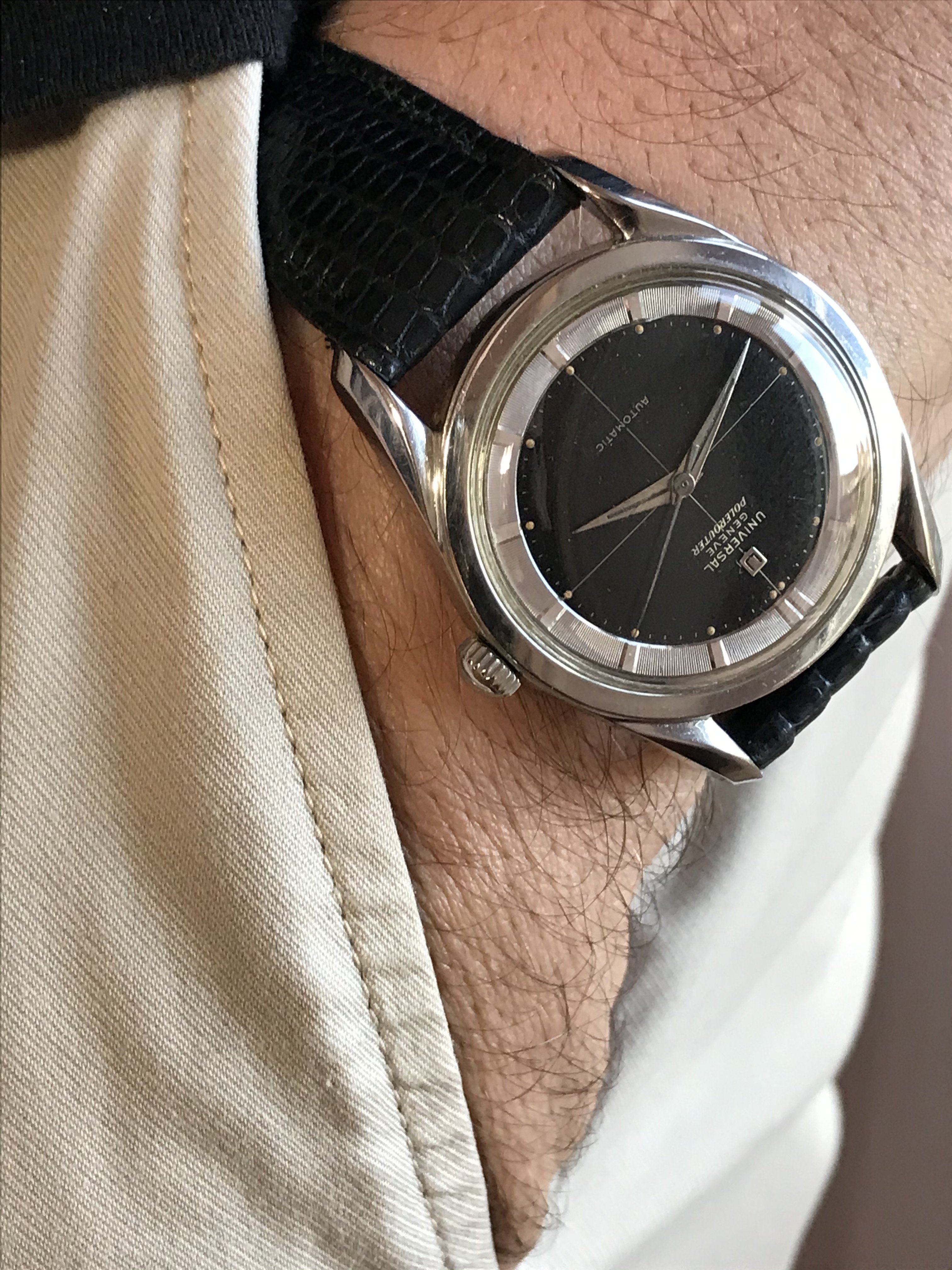

Lugs look a bit sharper than in the initial pictures.
Yes. Thanks to notice : that was the very good surprise when I opened the box ::psy:: as I feared, from the seller pictures, that they were too much polished. They are not the sharpest I have seen in picture but it does its effect on my wrist.
