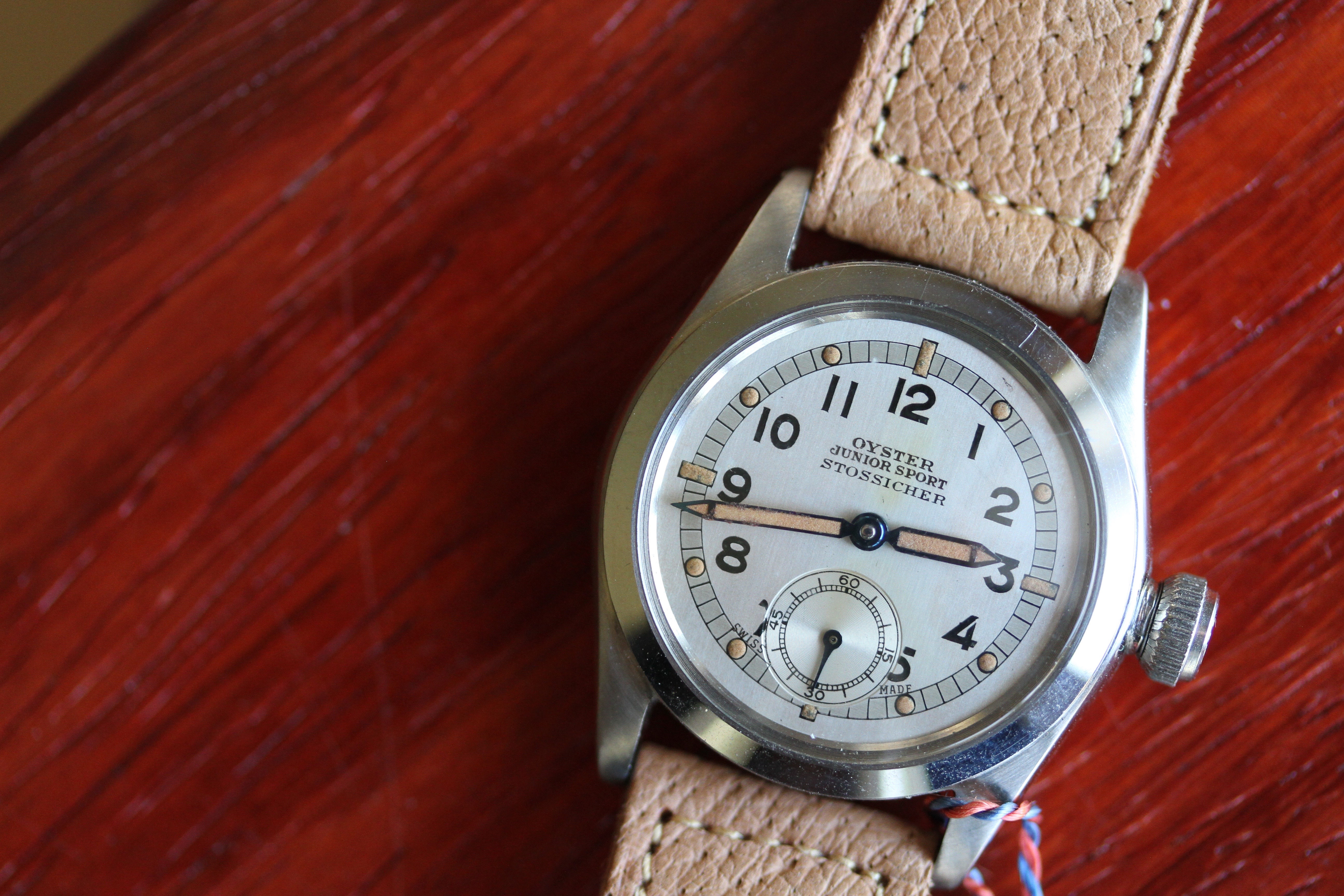

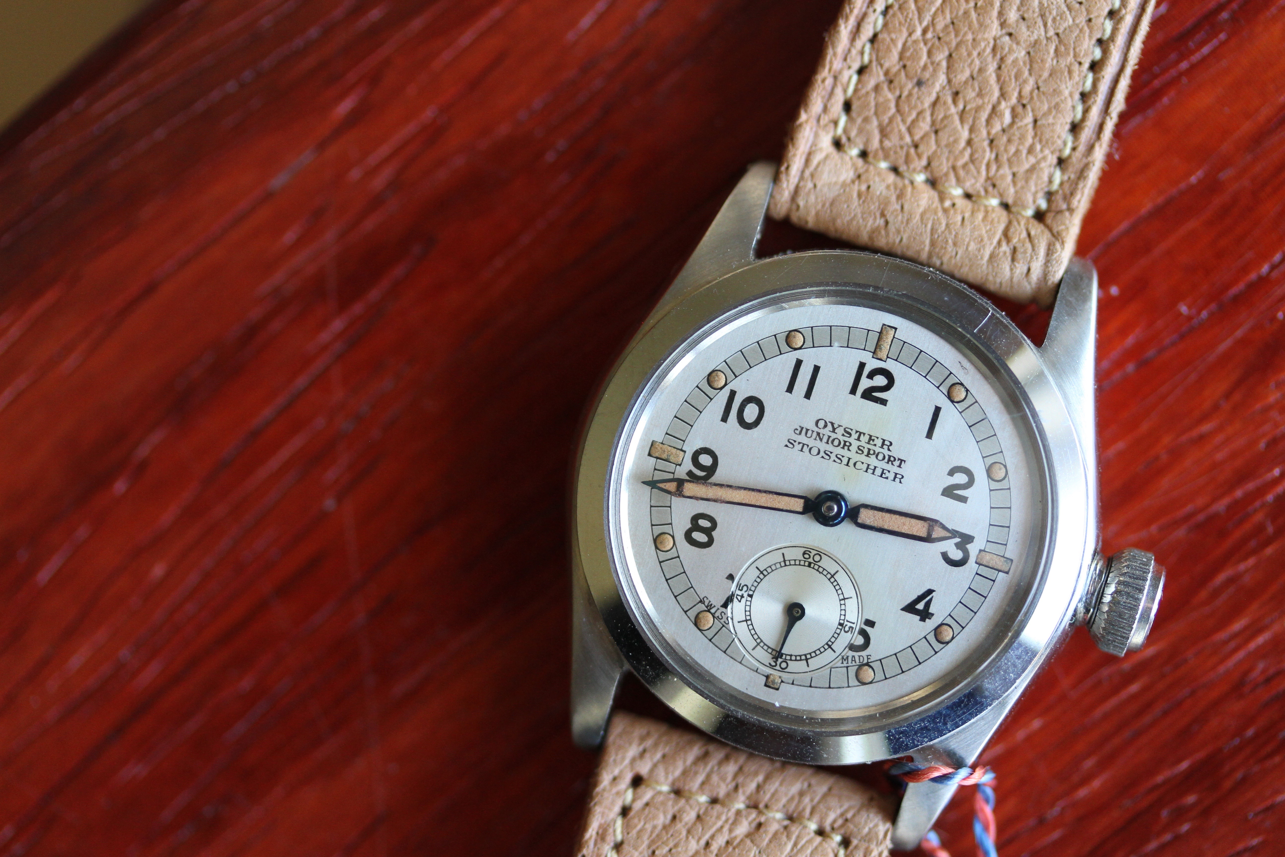

Is this Oyster dial original? Hmmm

That’s a good point, I see it too. Of course, that doesn’t mean somebody didn’t knock the radium out and replace it.
None of the radium watches I have show this color and none have such nicely matching hands and dial lume. But, I suspect radium lume formulas from back in the day varied somewhat, producing different aged colors.
I’ve never seen in-hand any radium Rolex that was in mint condition, so I can’t be sure.

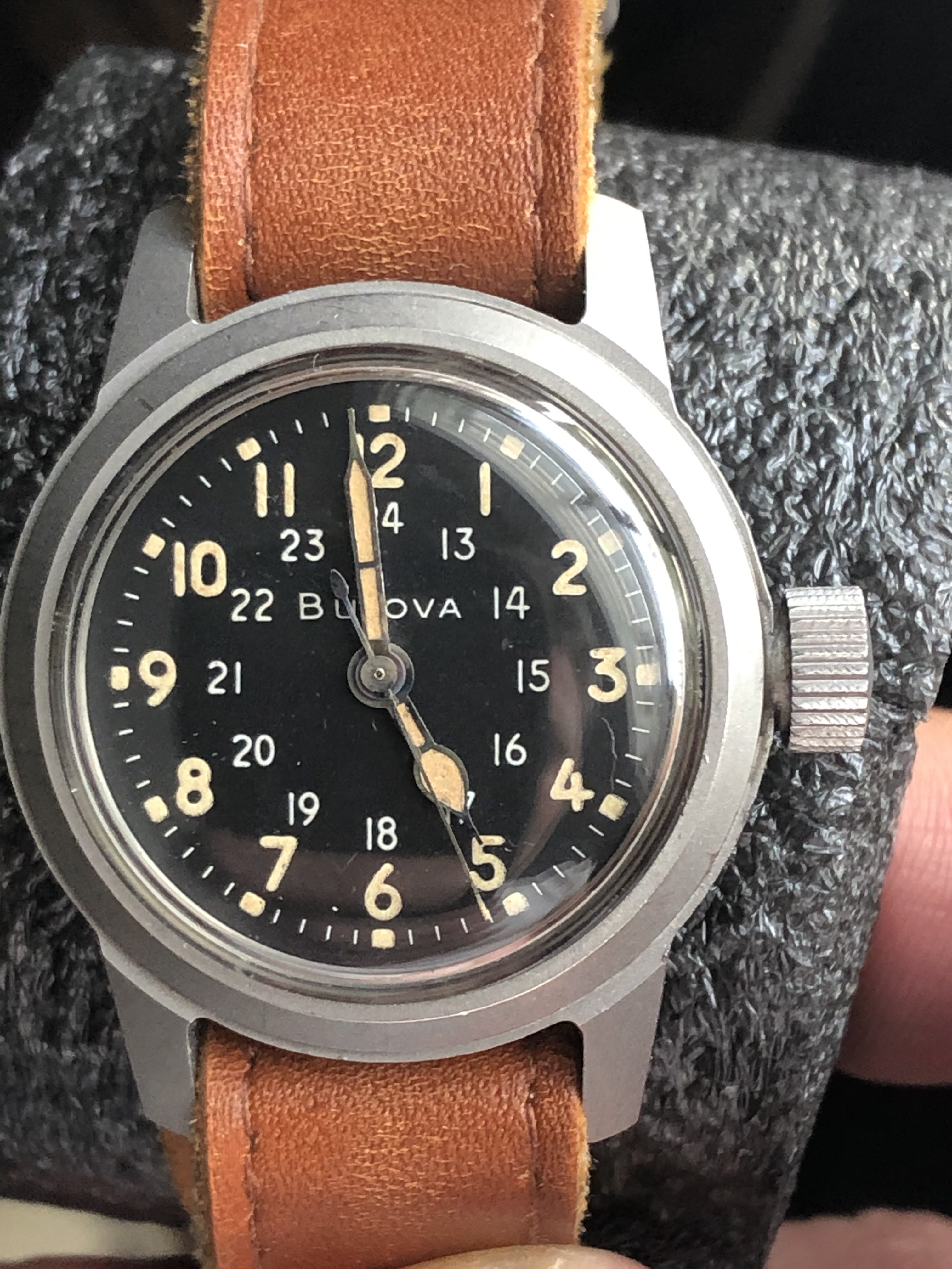

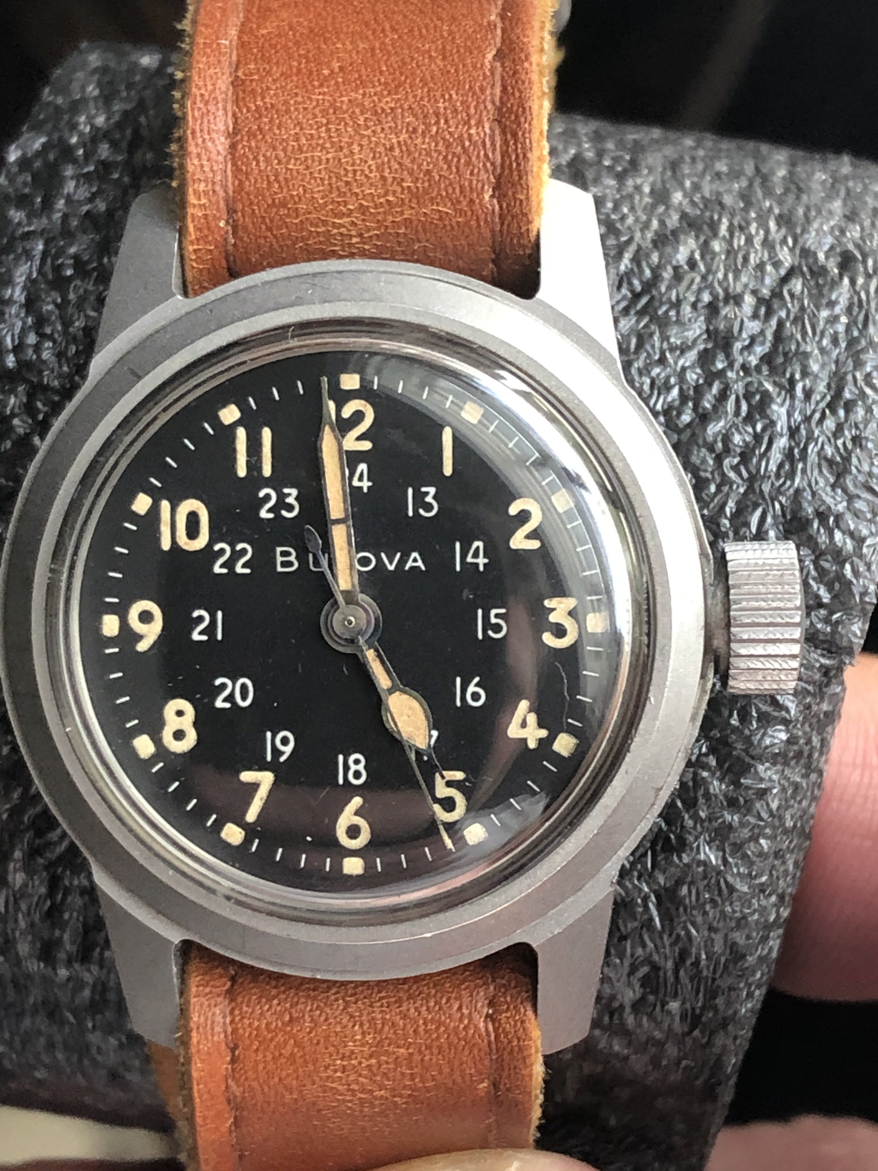

Just for counterpoint- period radium.

I just can't wrap my head around the quality of the dial printing. You can have pin pallet watches in tin metal that have better printed dials... so a Rolex, stainless steel, shockproof, waterproof, screwed crown (advanced features back in the day, and costly!) can have a dial printed like this? Seriously? Where is the QC? 😲
The only explanation (barring later redial, old or new) that makes some sense to me is that they were exported to Germany with some other dial (or in spare parts to avoid customs tariffs) and reassembled with locally produced or reprinted dials, of lesser quality, and not marked Rolex btw.

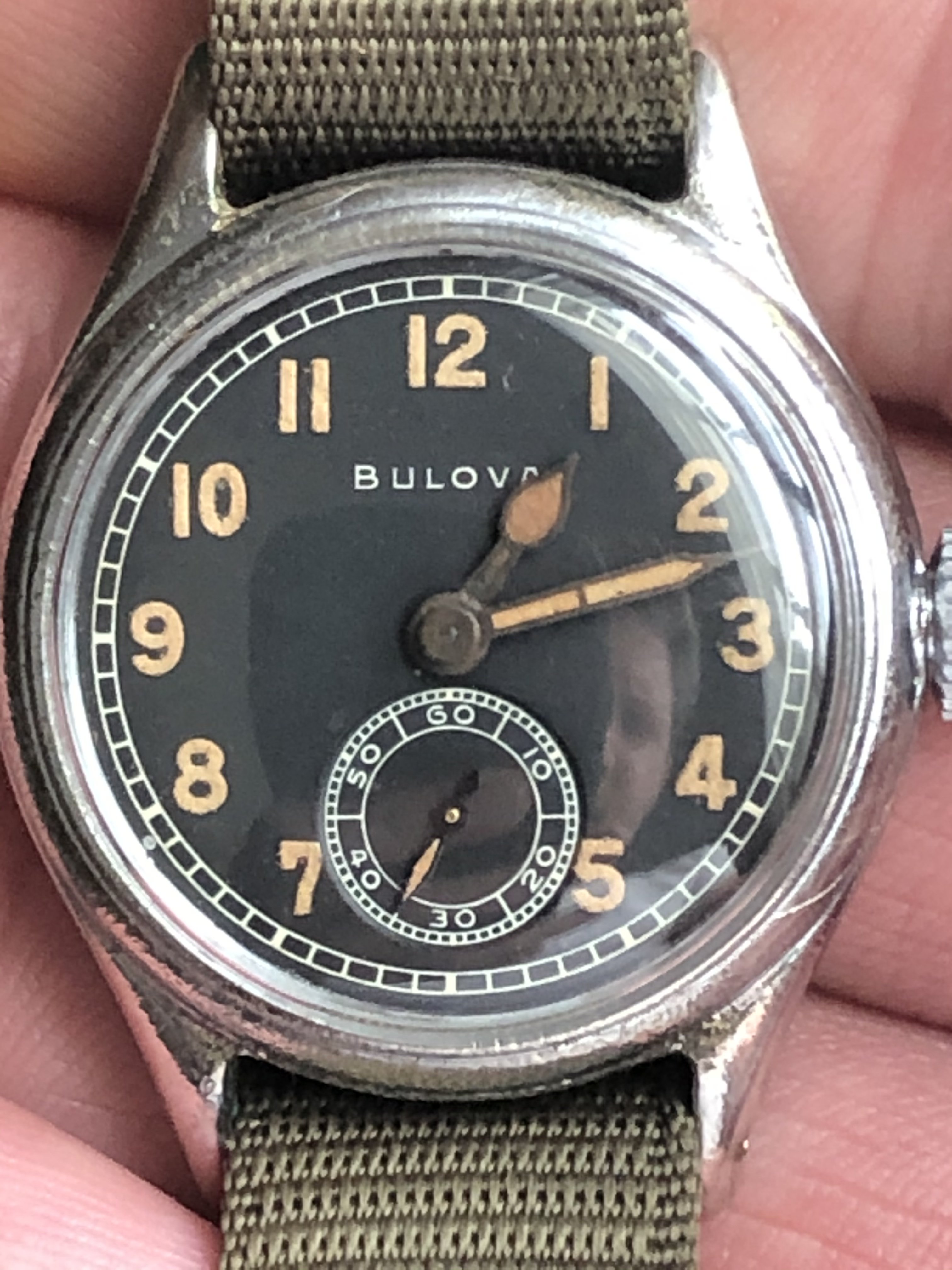

not trying to up anyone- just trying to share collective knowledge. When people say a dial/Lume looks “too good”, they haven’t seen good ones.
that said, the OP watch has a lot of unanswered questions

Interesting to hear it means shock resisting, thank you for that.
As for the lume - as others have pointed out, there is radium burn on the dial. Also, check below for a watch with similar lume color.

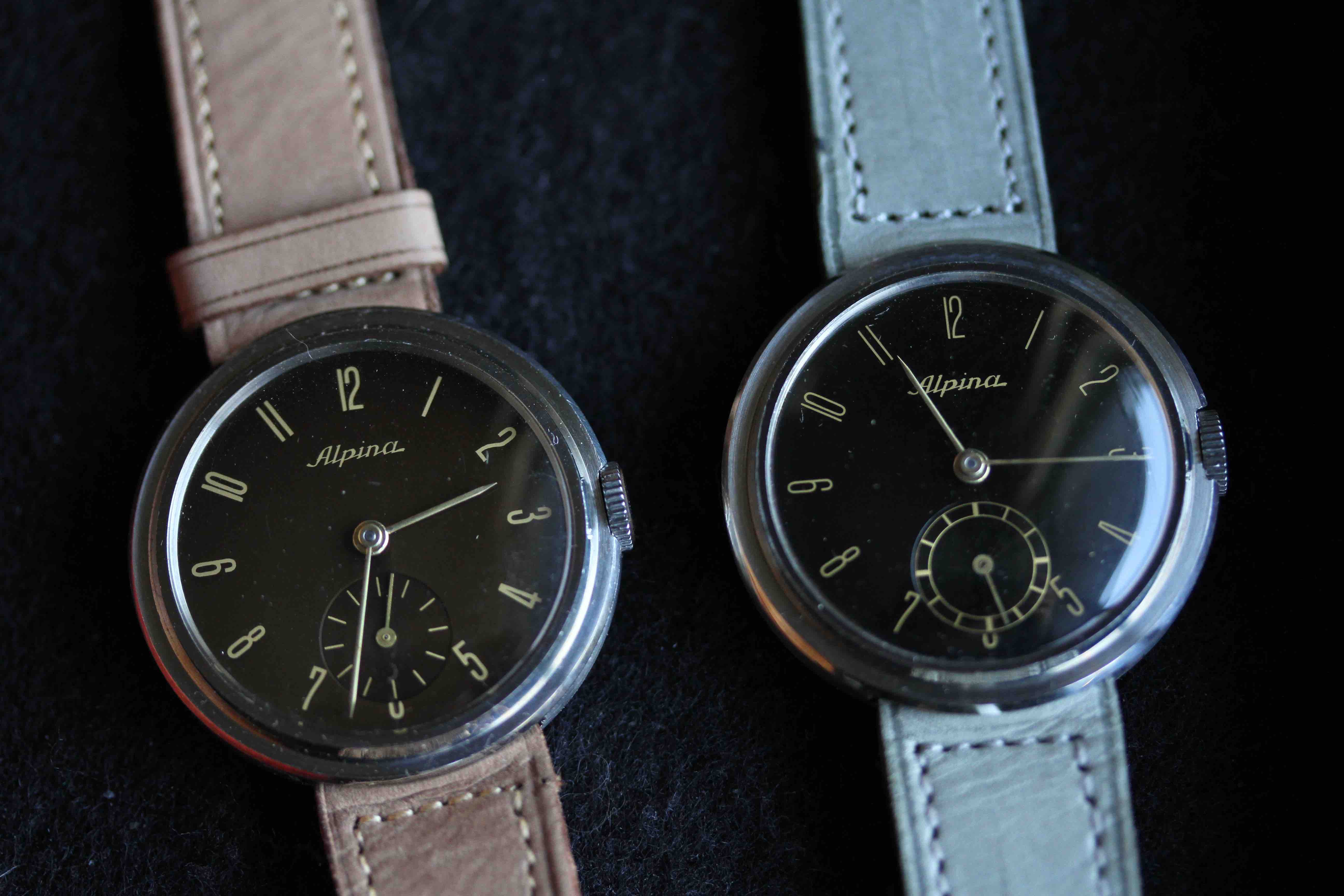

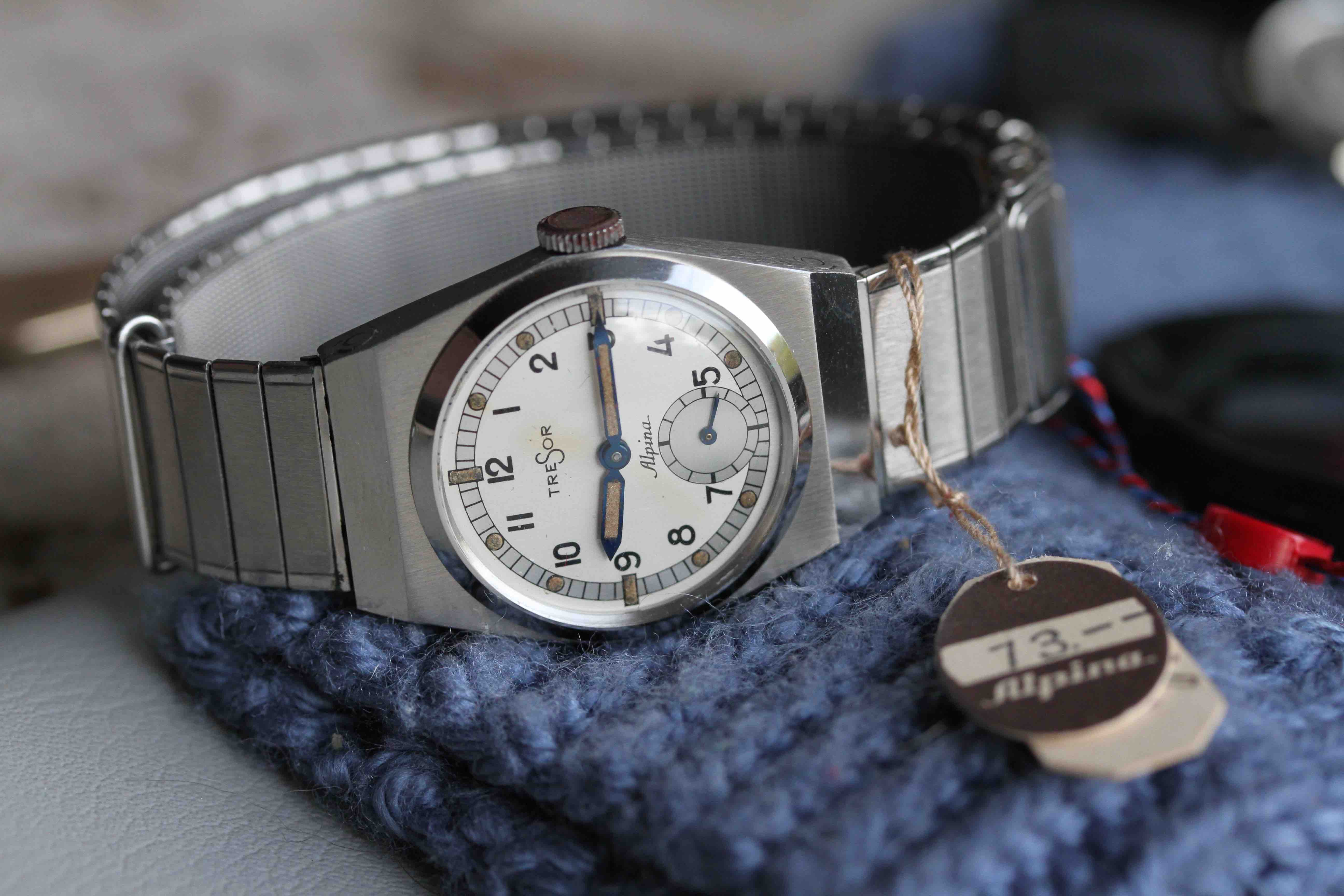

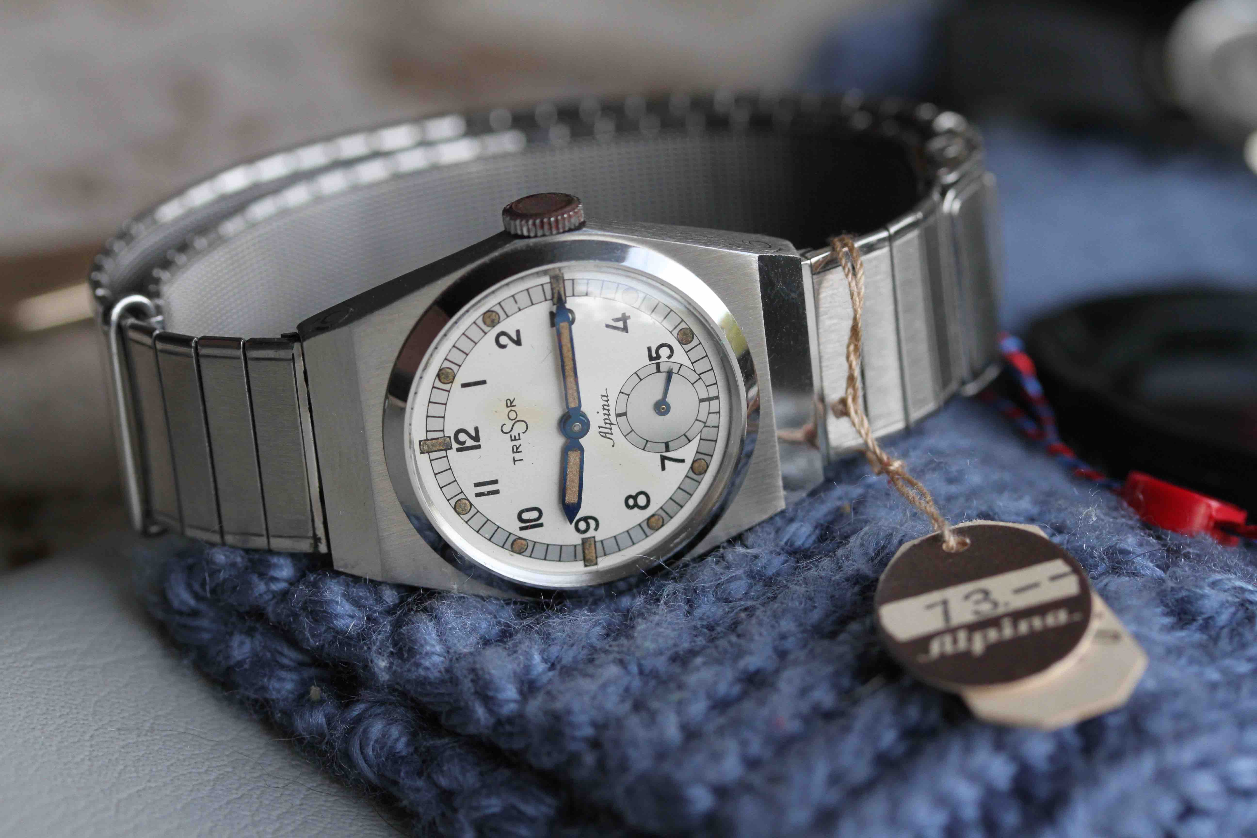

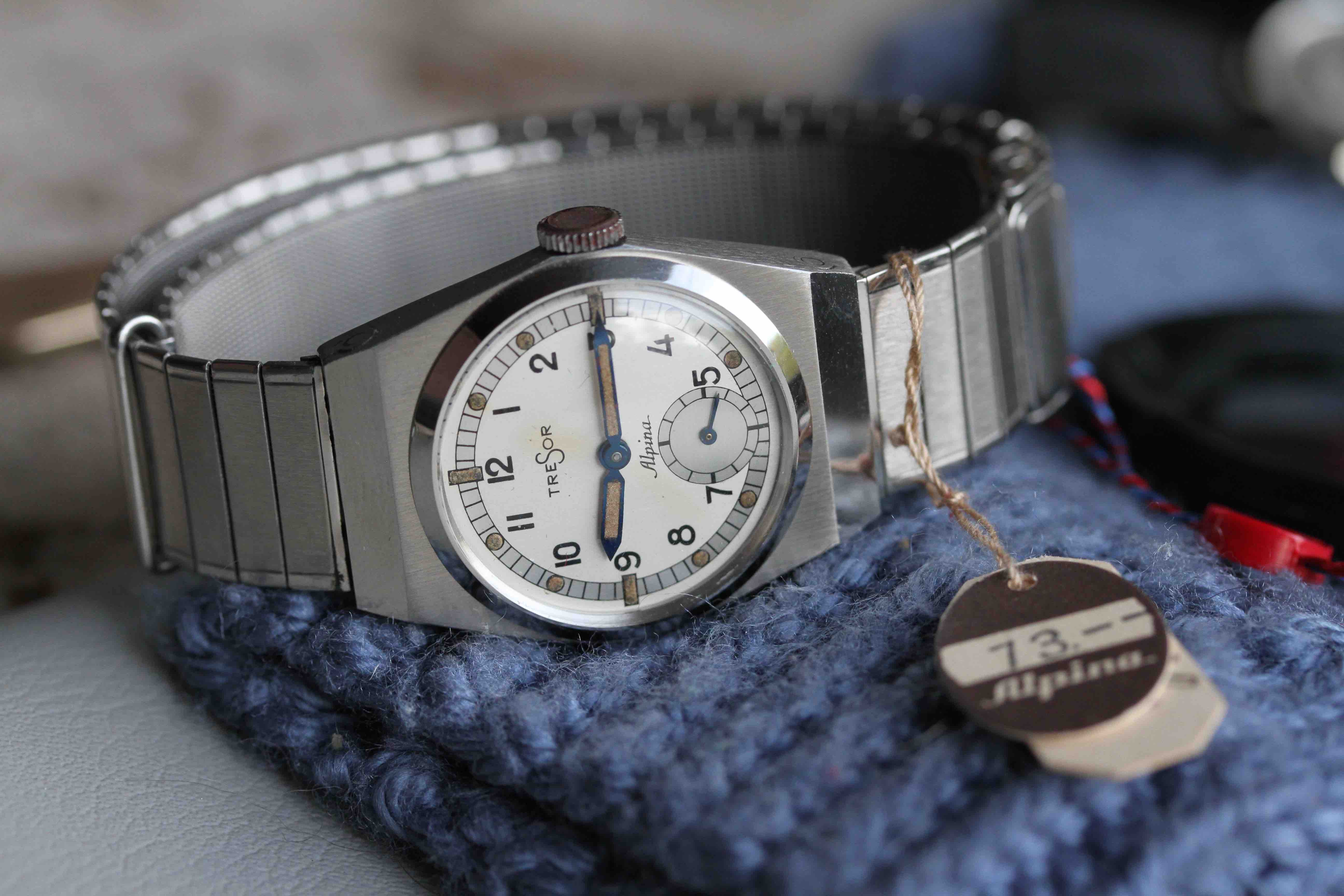

I should say that I bought the watch with other NOS watches, including these:
I'm not saying this proves the Oyster is original. Only that it came with watches I think are original and which are NOS.
8,248
29,147
The Tresor/Alpina looks fine, and suggests further that the Oyster dial is also original.
