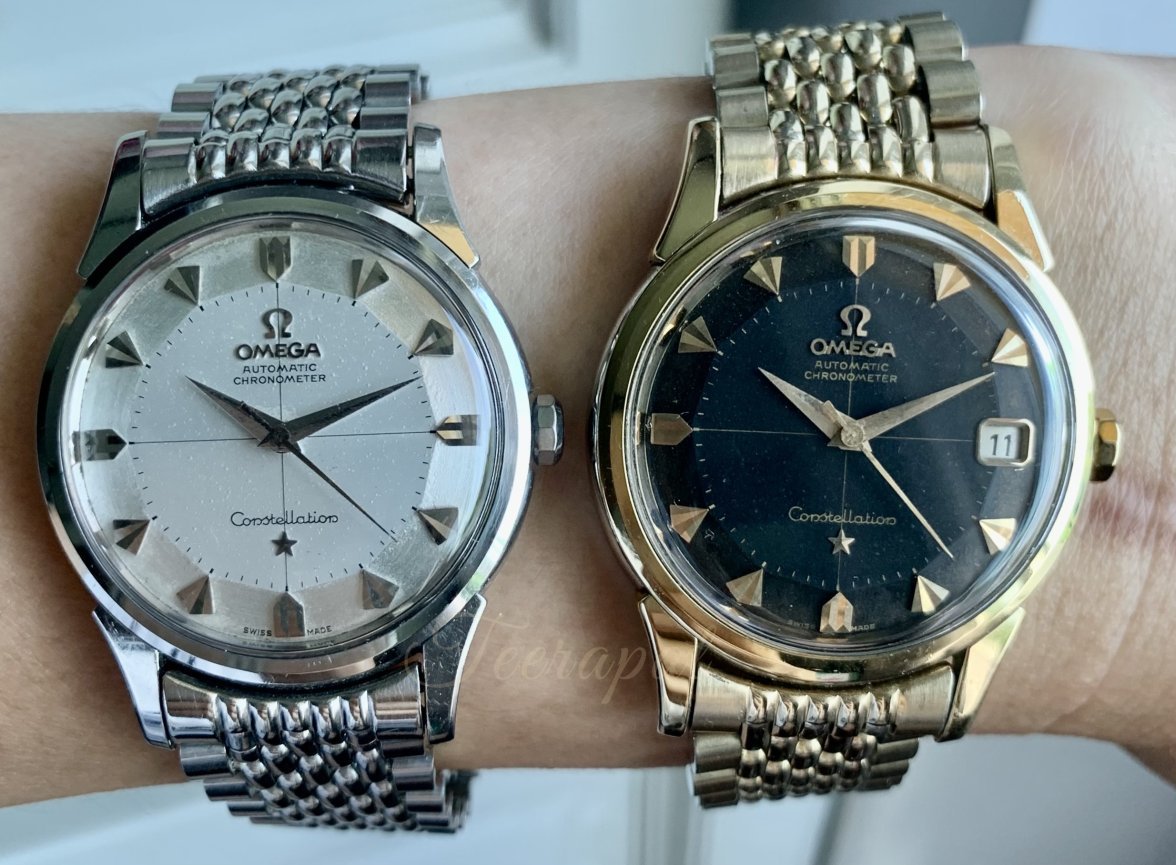

1,024
4,126
„Transitional“ 14381/14393/14900/14902s with arrowheads are a thing and legit, not 100% sure on later 167.005/168.005. This one, though, doesn’t exactly give me a good feeling in the belly.
These are just some examples of my 14381 and 14393 with arrowheads.
Best,
Teerapat
1,024
4,126
