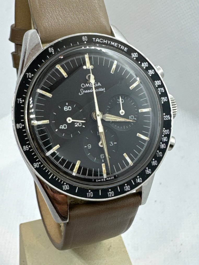

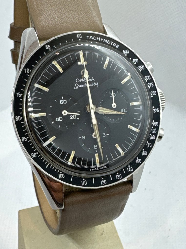

I normally post my Speedy auctions after the sale, but this watch is so weird and a true Frankenwatch,
so I wanted to warn some potential novice buyer (that hopefully reads this…),
and also share with the rest of you of course!
It is stated as a 2998-1, with 100% original parts….🙁

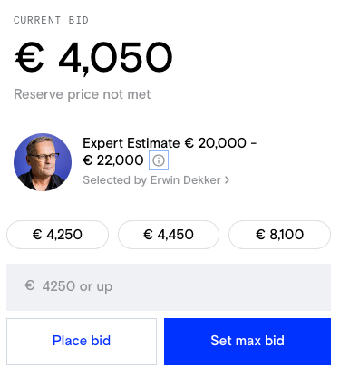

Here is a link to the auction:
https://www.catawiki.com/en/l/88529321-omega-speedmaster-2998-1-unisex-1960-1969

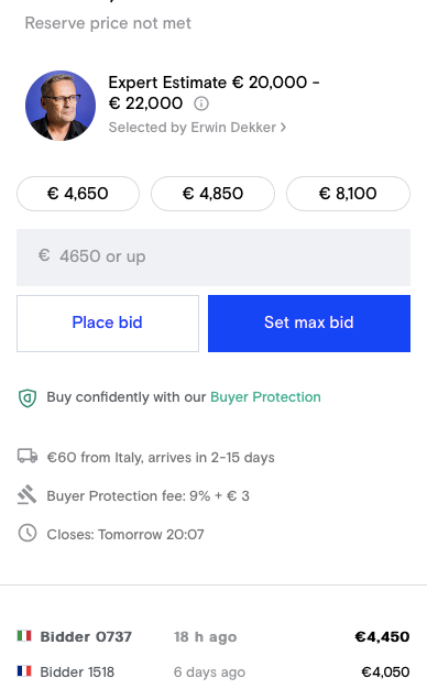

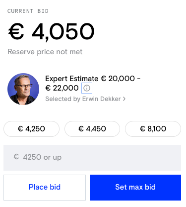

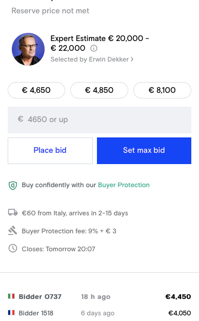

The ”Expert” has an estimate of 20000-22000 €!
And somebody has already placed a bid.

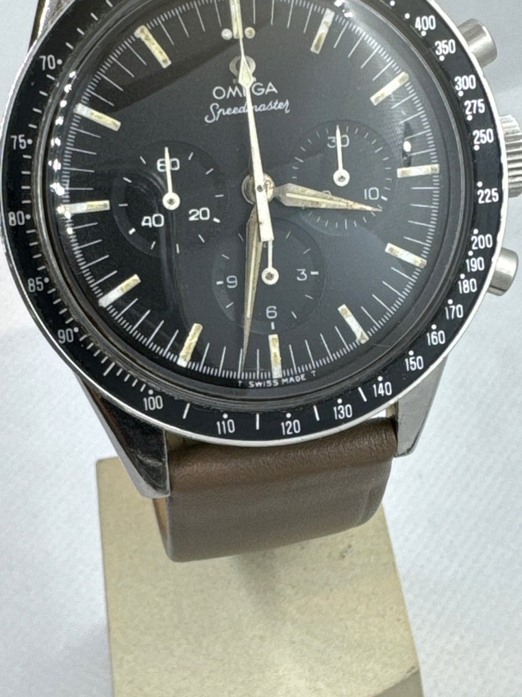

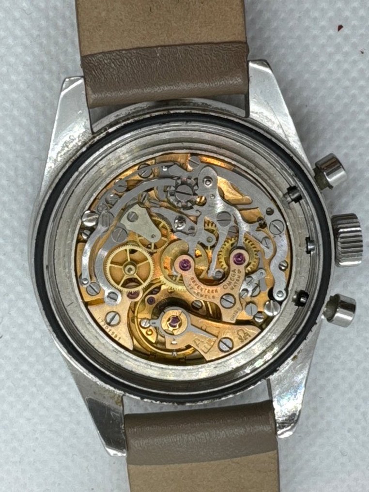

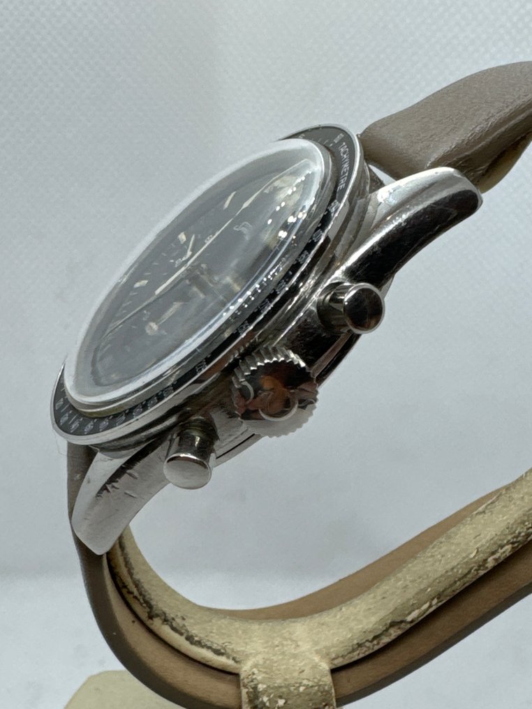

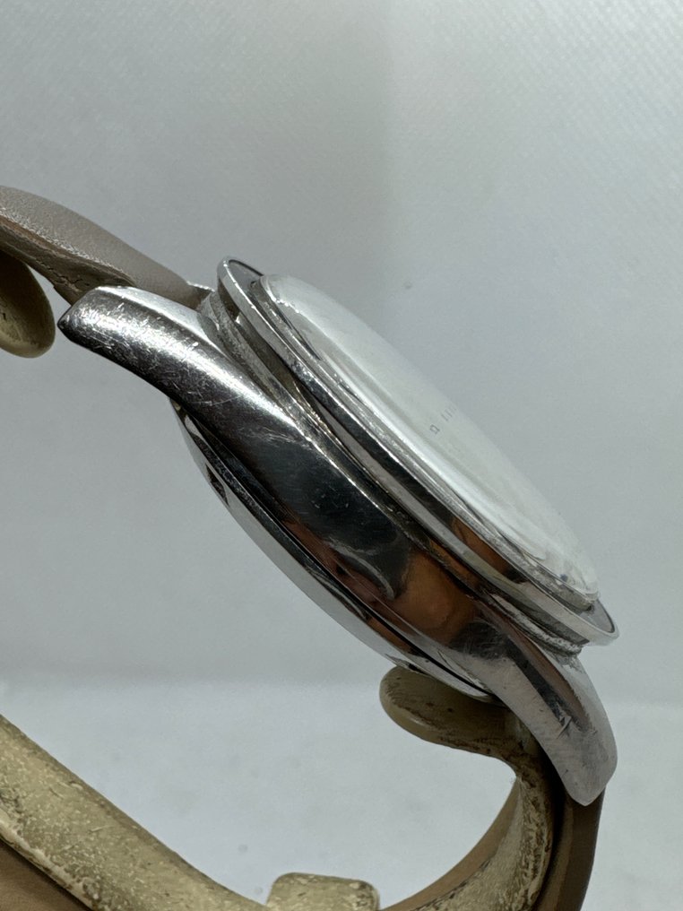

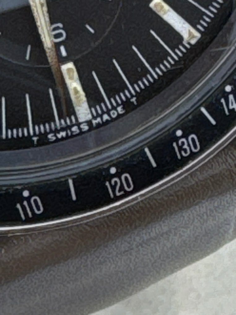

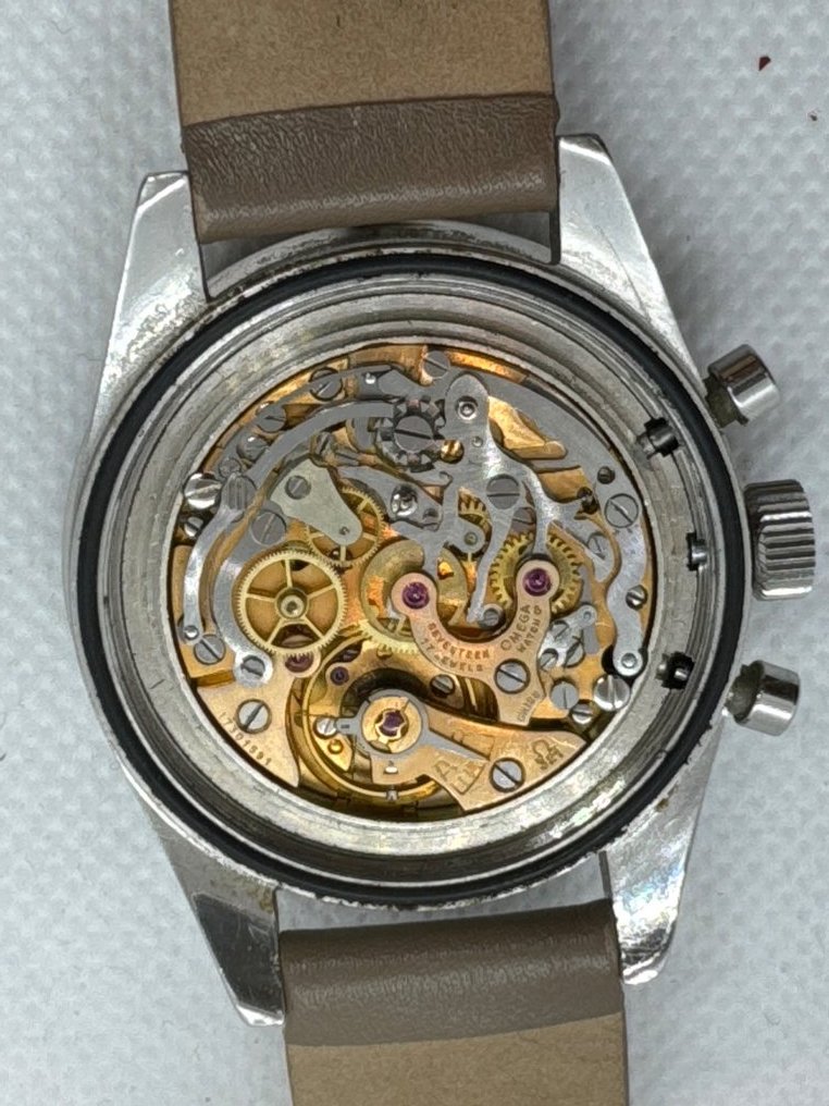

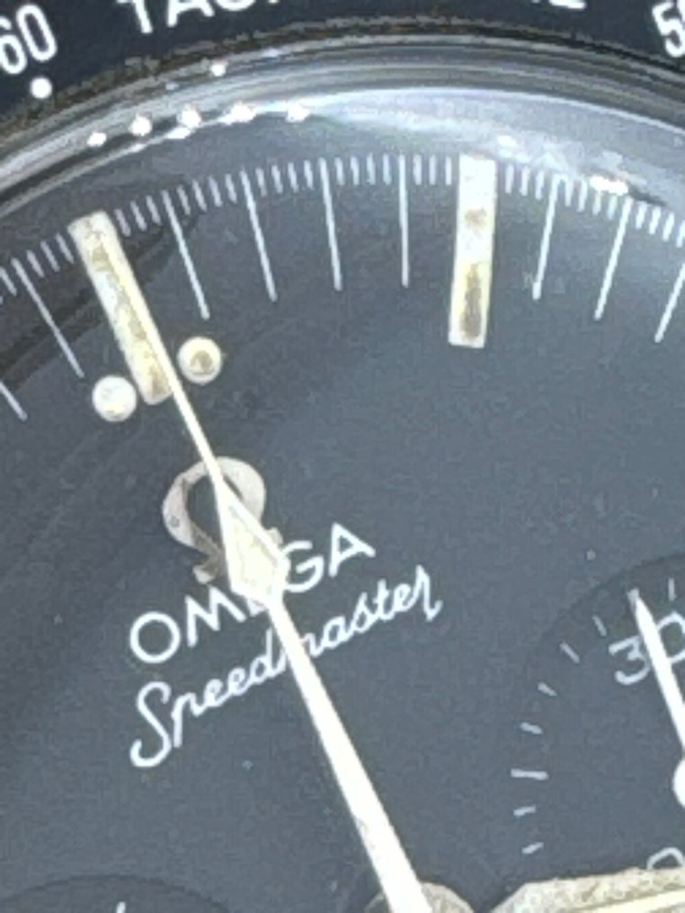

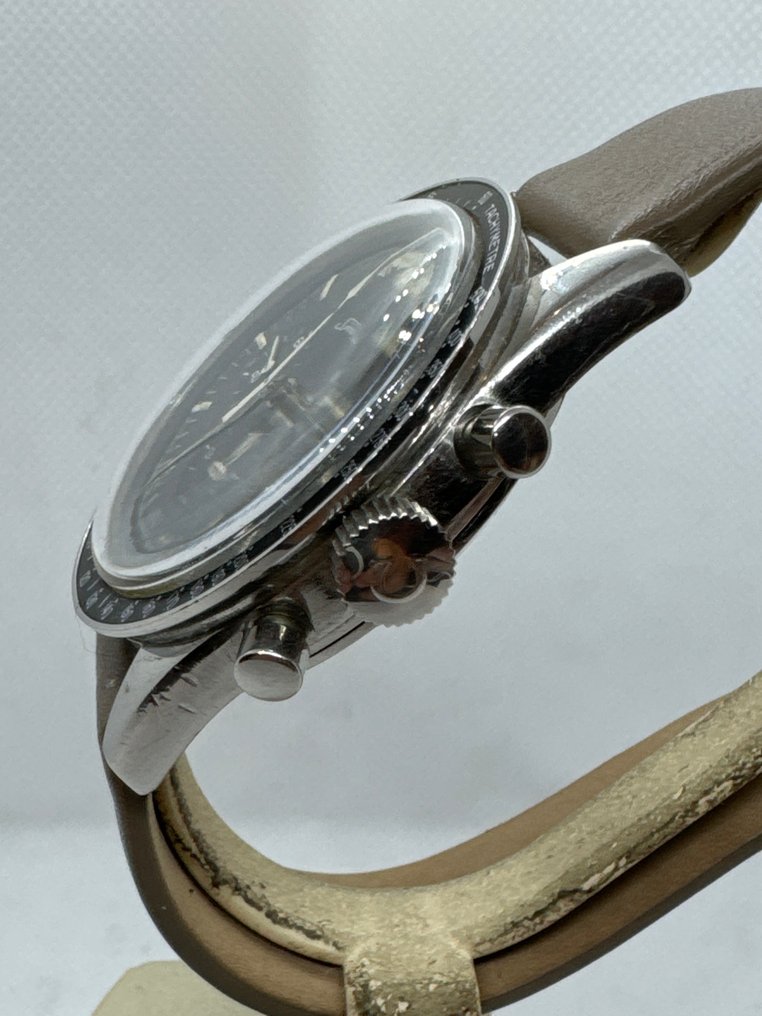

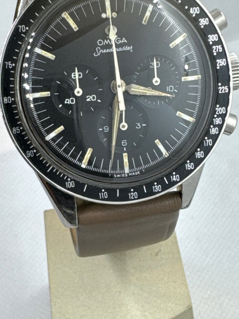

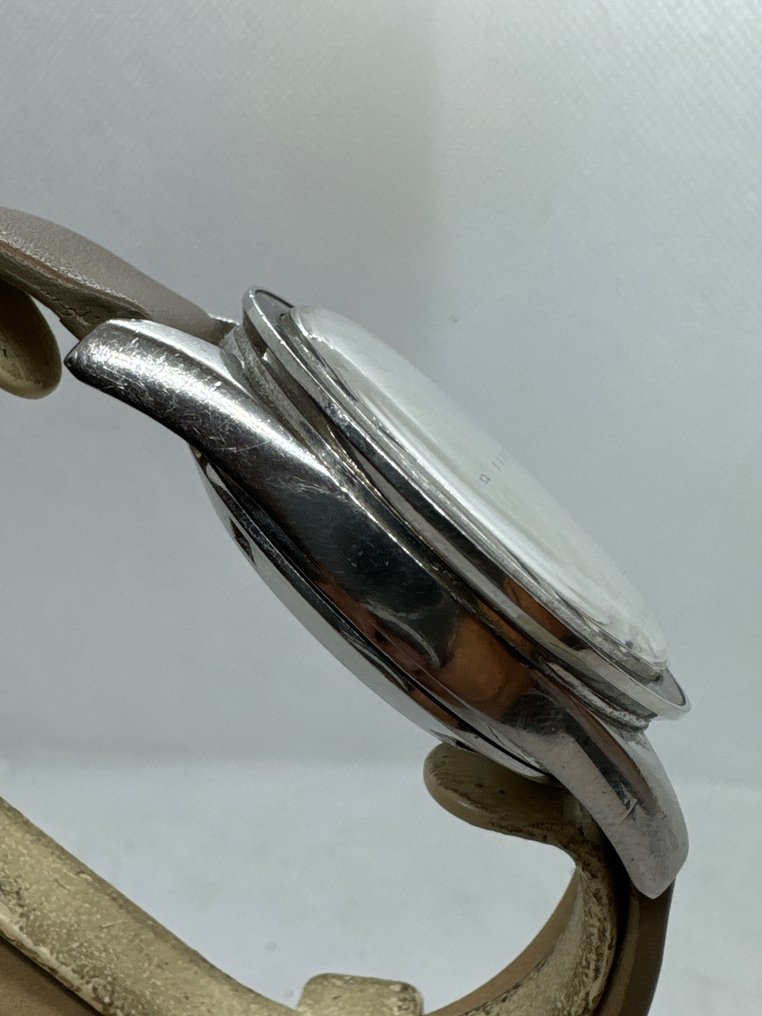

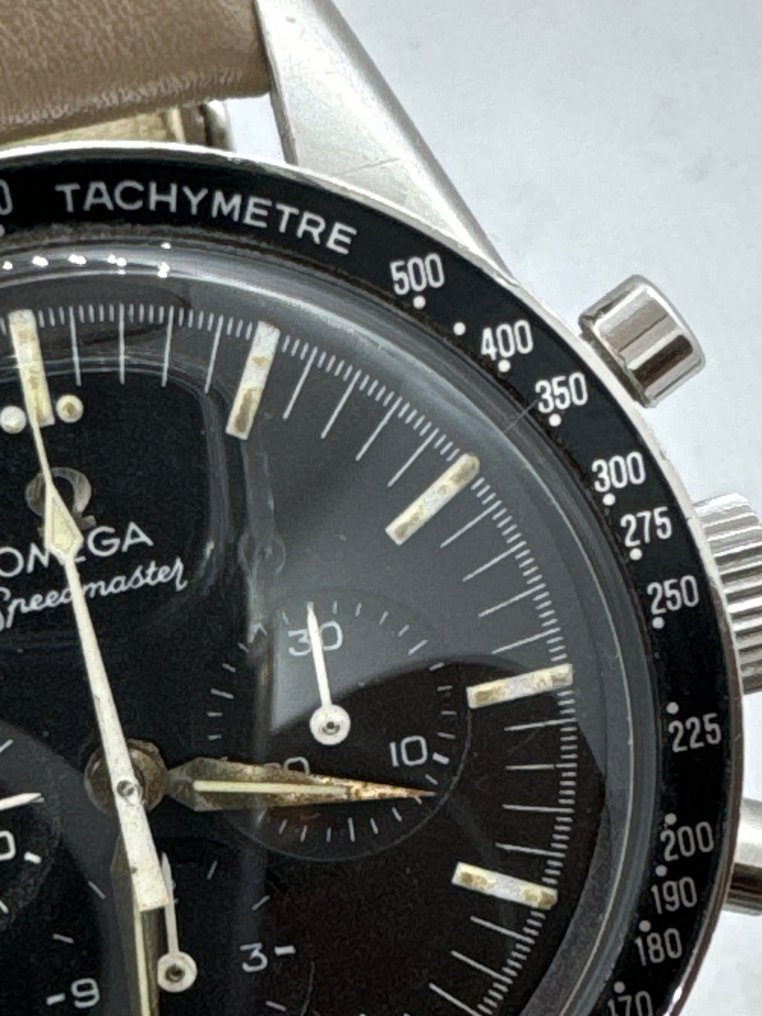

Looking at the pictures, there could not be many original 2998-1 parts.
The movement could be for a 2998-1, but the rest??

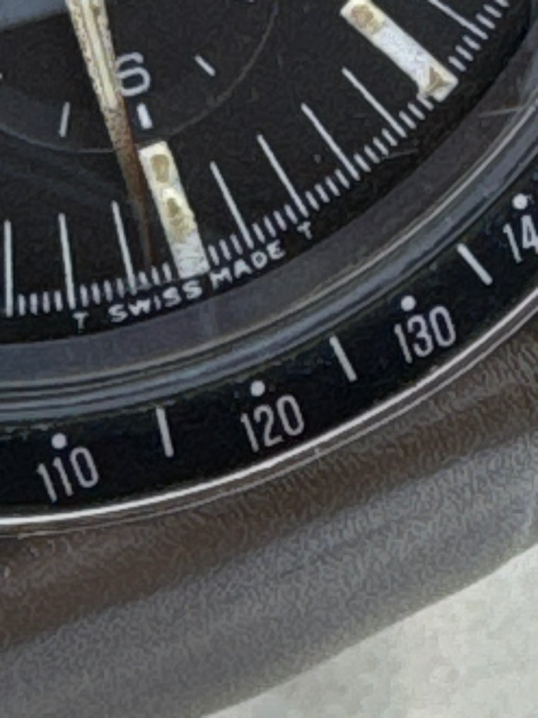

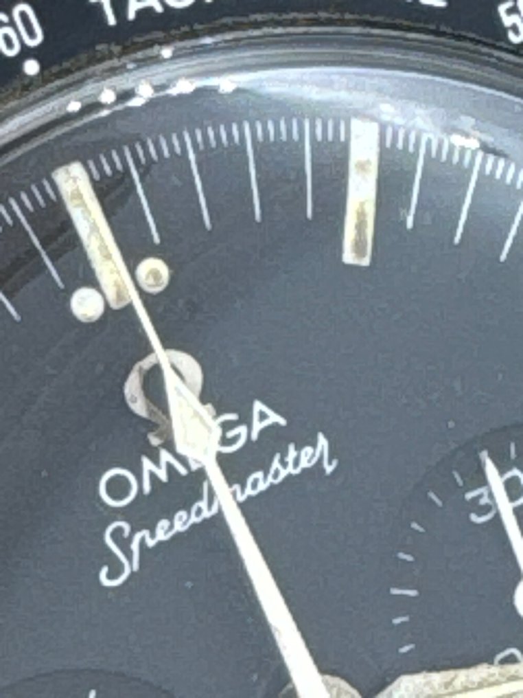

I found at least 6 parts (the hands count as one…) that are not correct for this reference, but the most obvious one is the dial.

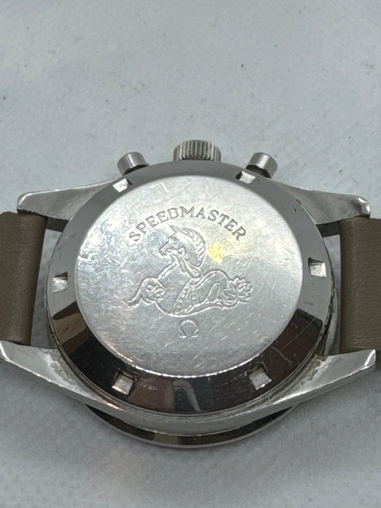

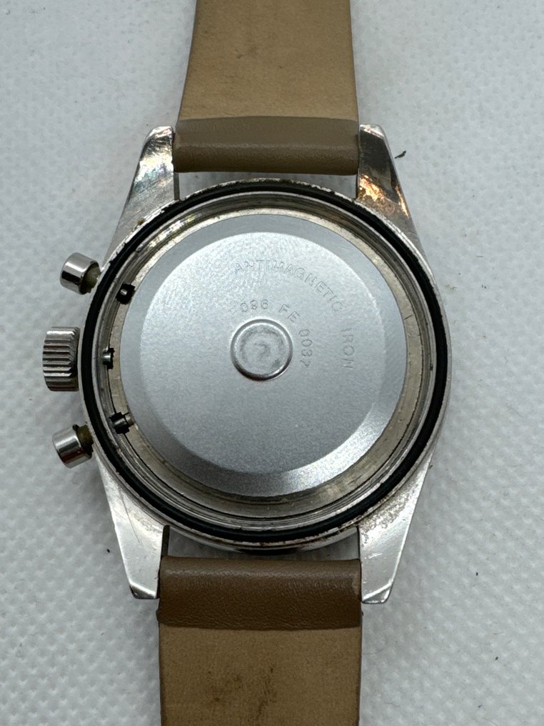

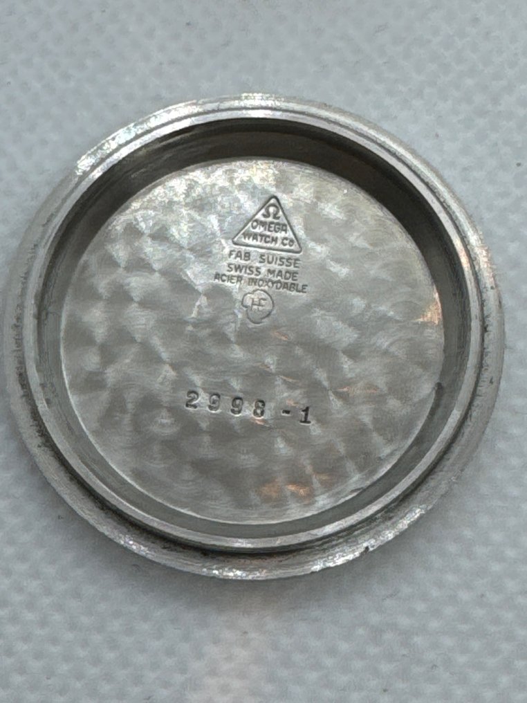

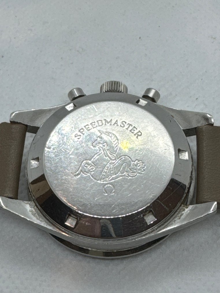

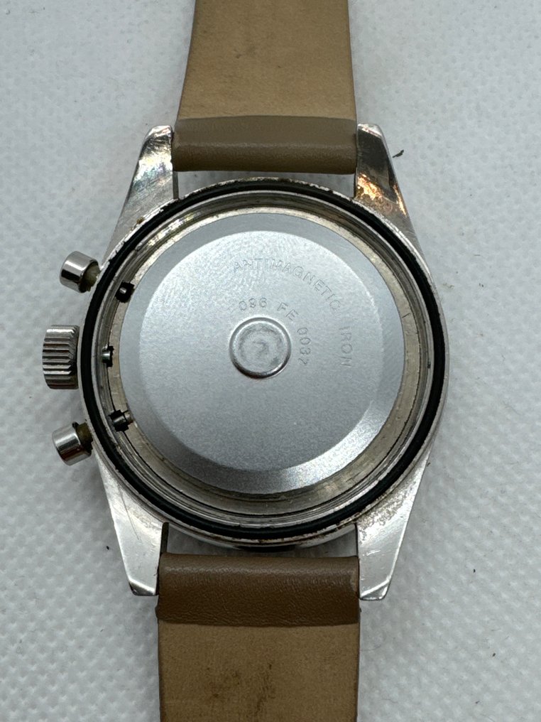

And the caseback must be a fake/rebranded one!
Enjoy the pictures, and please do comment!

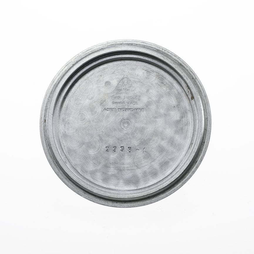

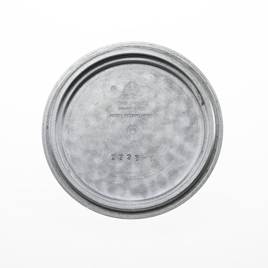

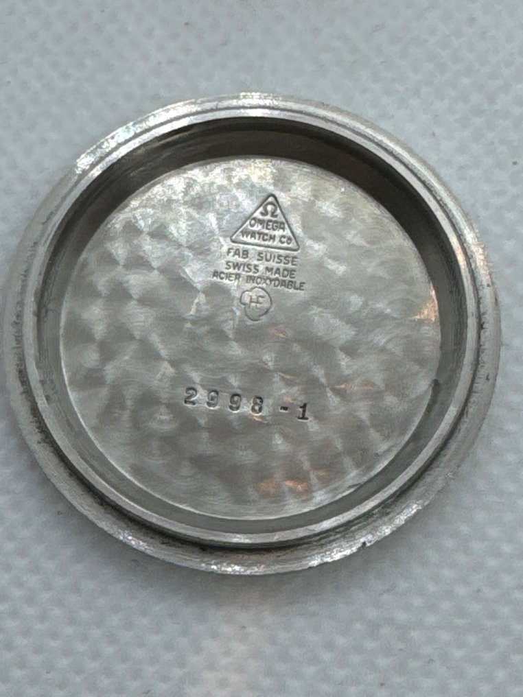

The caseback is especially weird. How was that done?
2,629
5,912
They must have polished down the original ref, and then stamped a new one?
Comparing to a true original, there are som difference in the "polish paterns".
I think they would have filled in the old stamping, turned or machined that area and then stamped. The stamping are quite deep, and that would be a lot of material to remove.
Or is that what you meant?

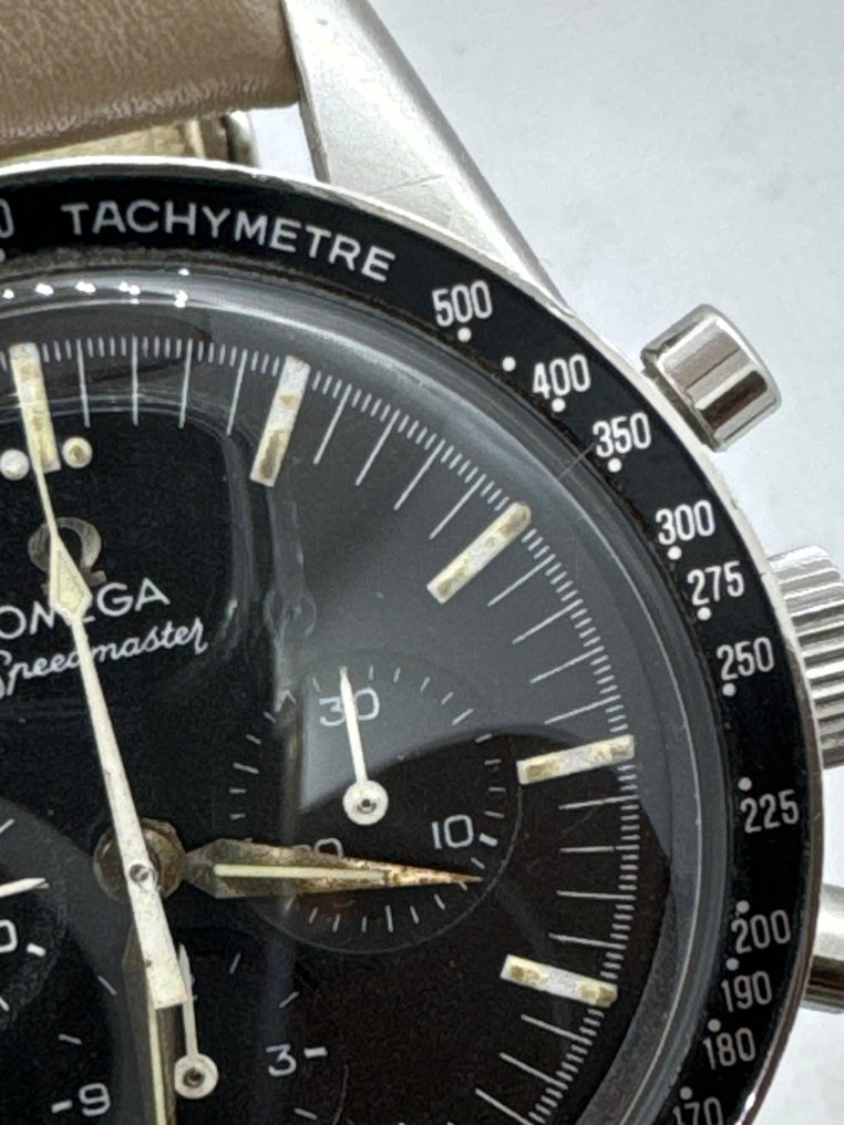

Looks like one of the rare occasions or see a repainted speedmaster dial

I guess the question is, what is the value of the parts?
6,908
10,769
Factoring in the 9% buyer protection 😀:facepalm1:😀 I assume we are already beyond that
