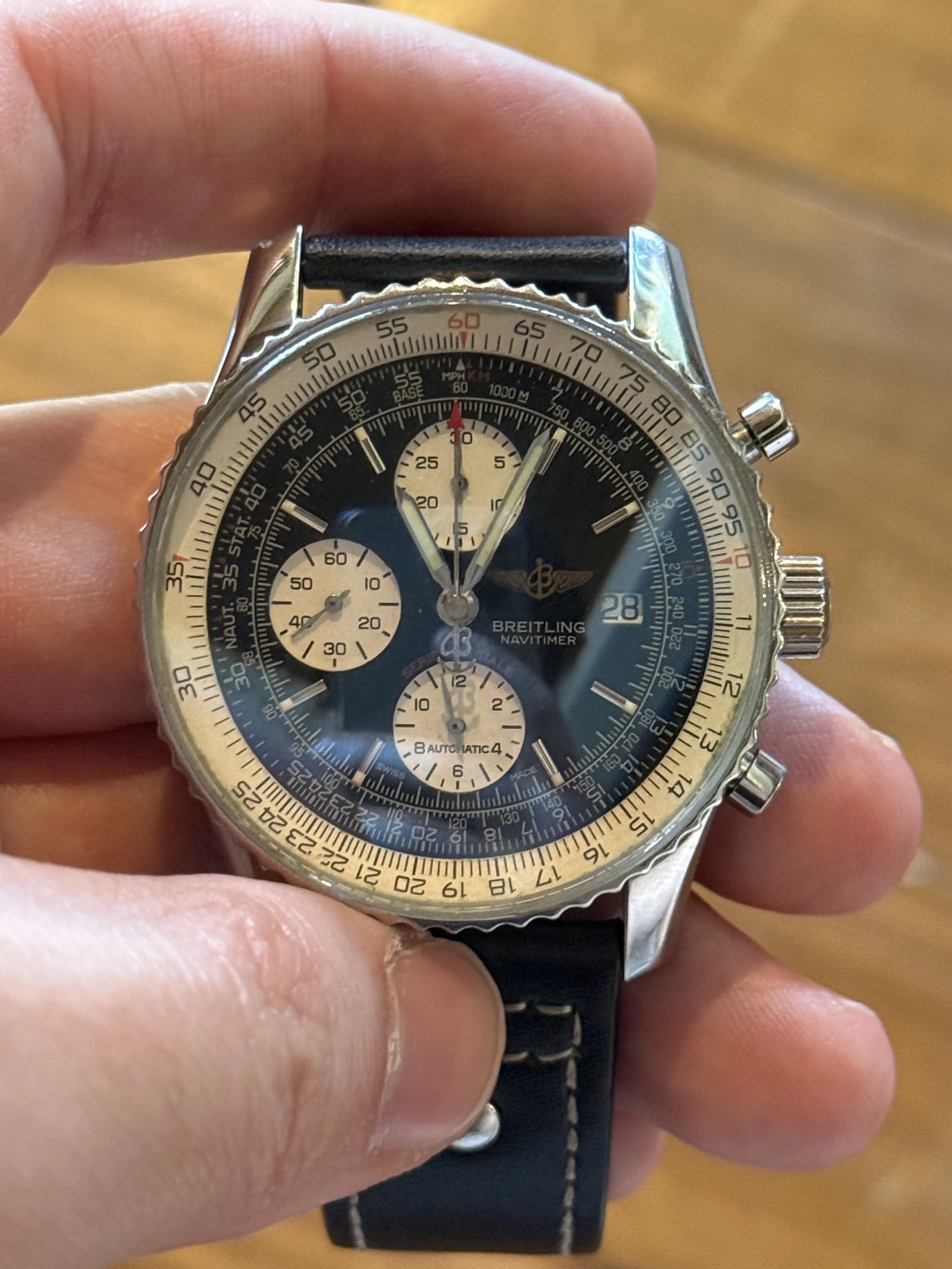

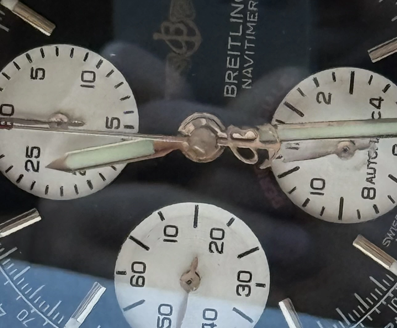

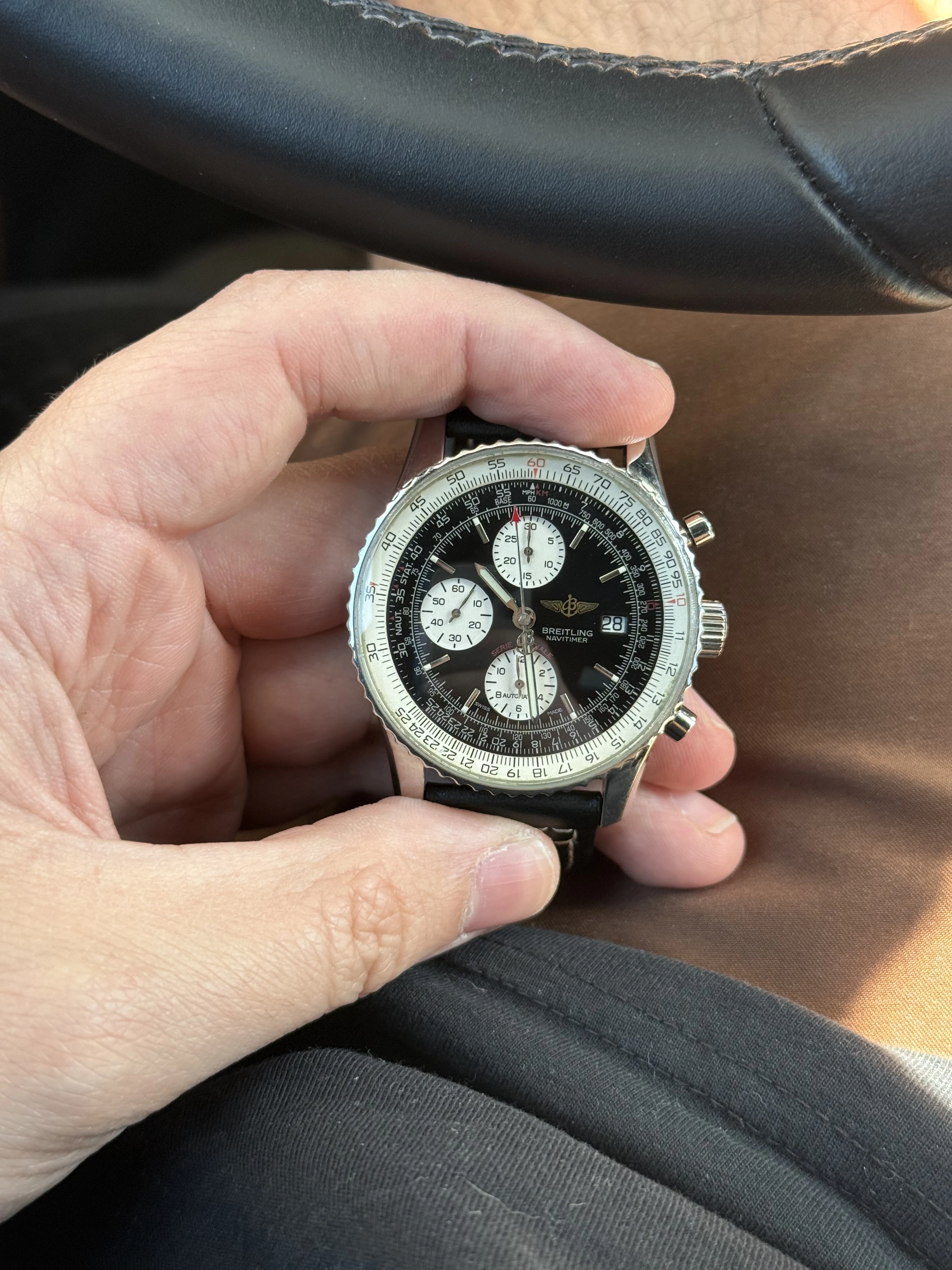

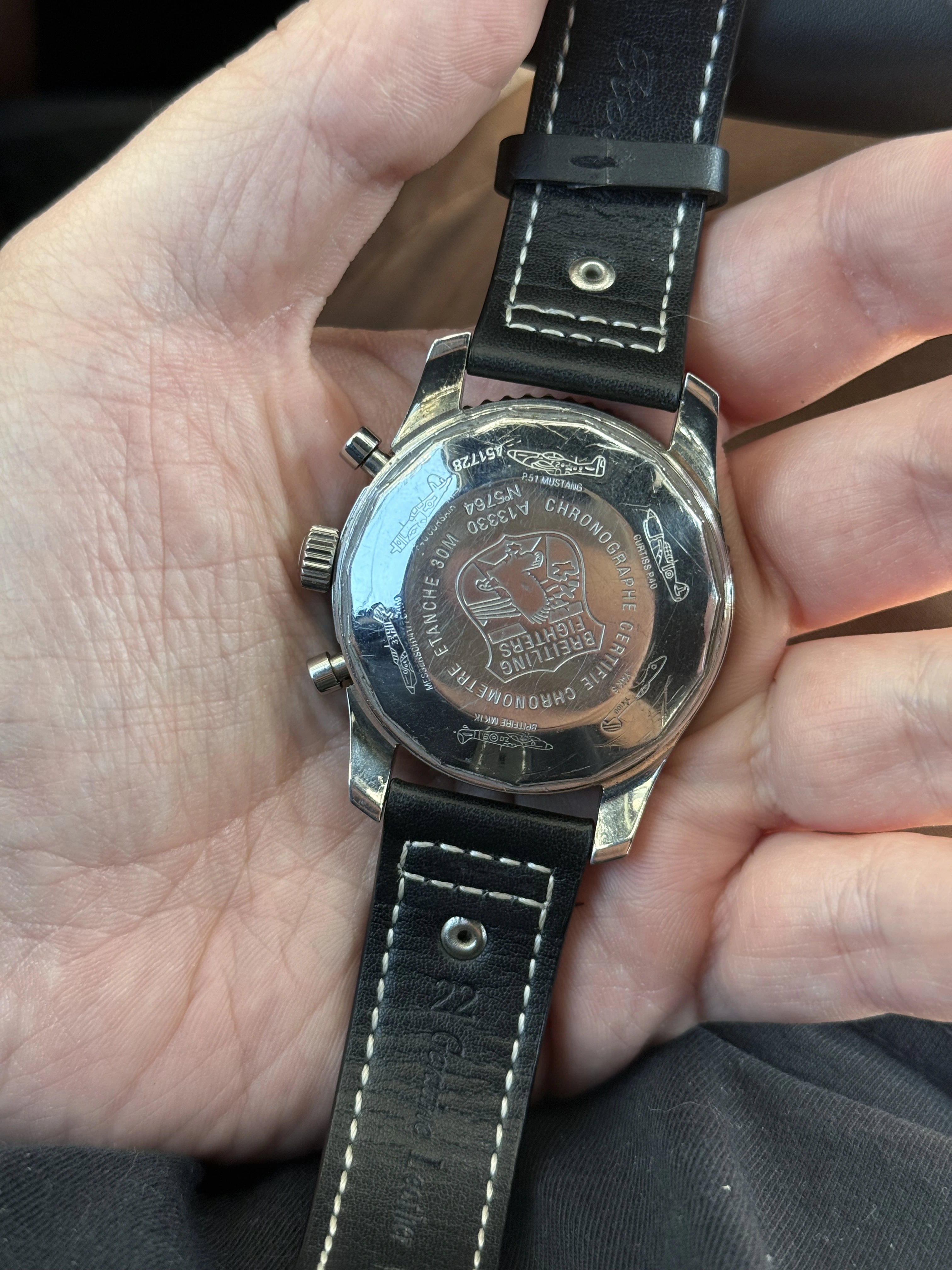

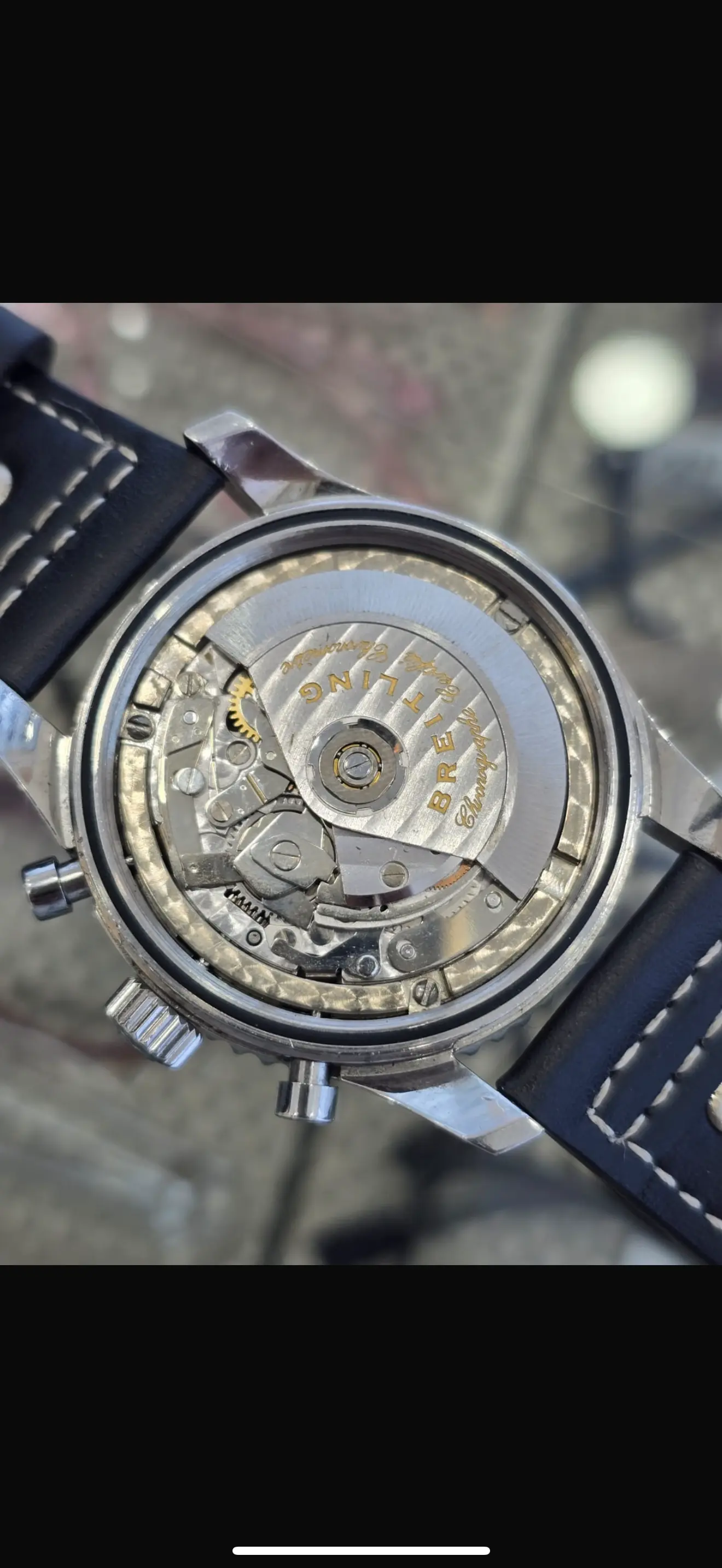

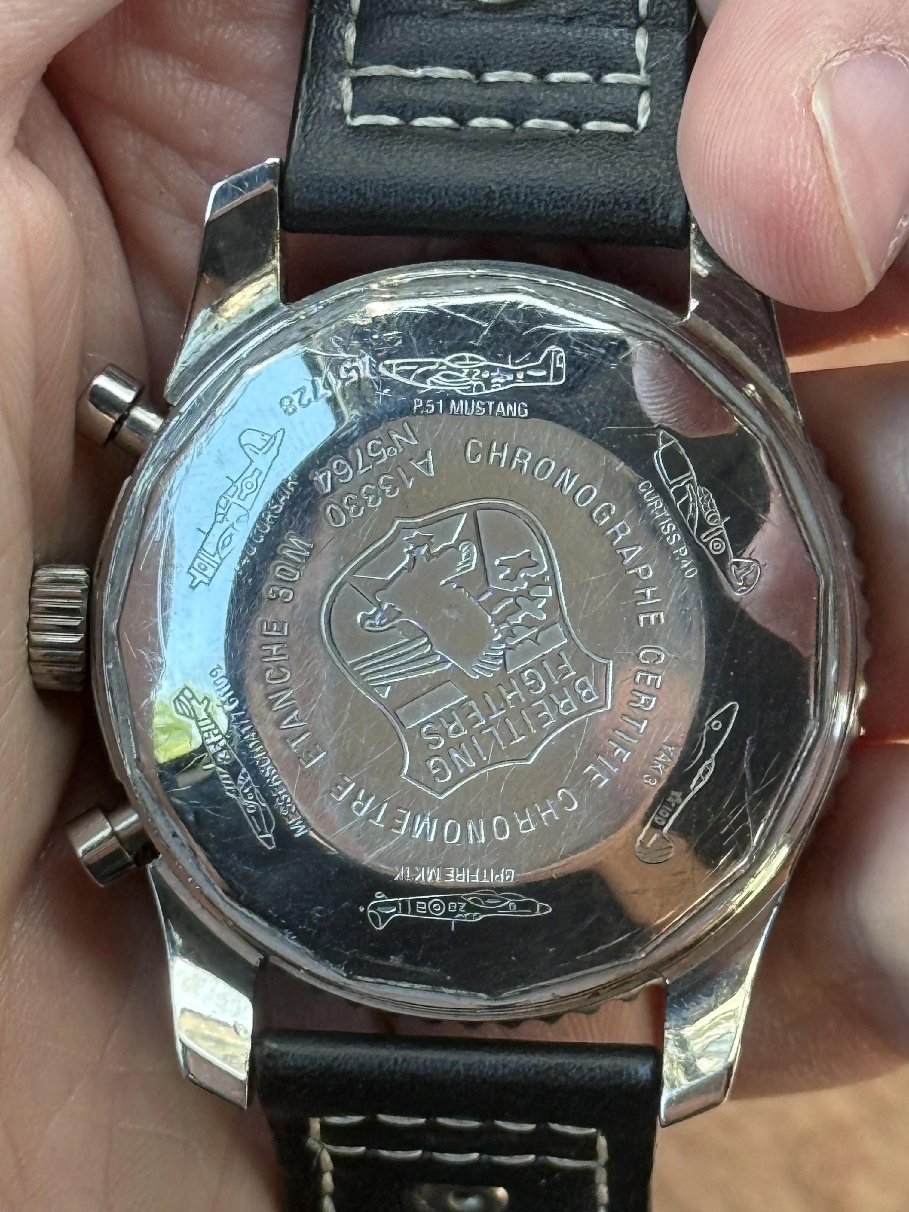

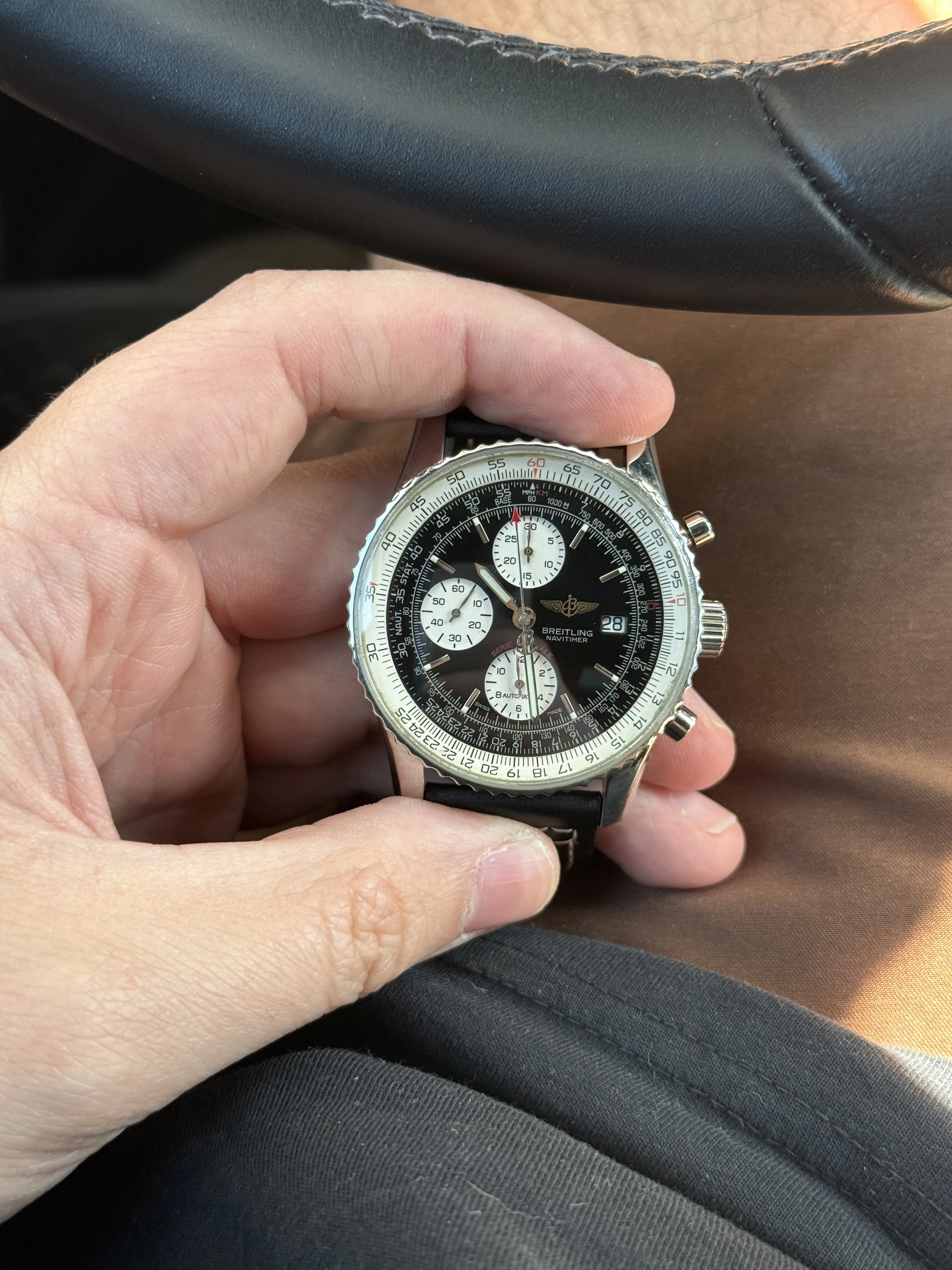

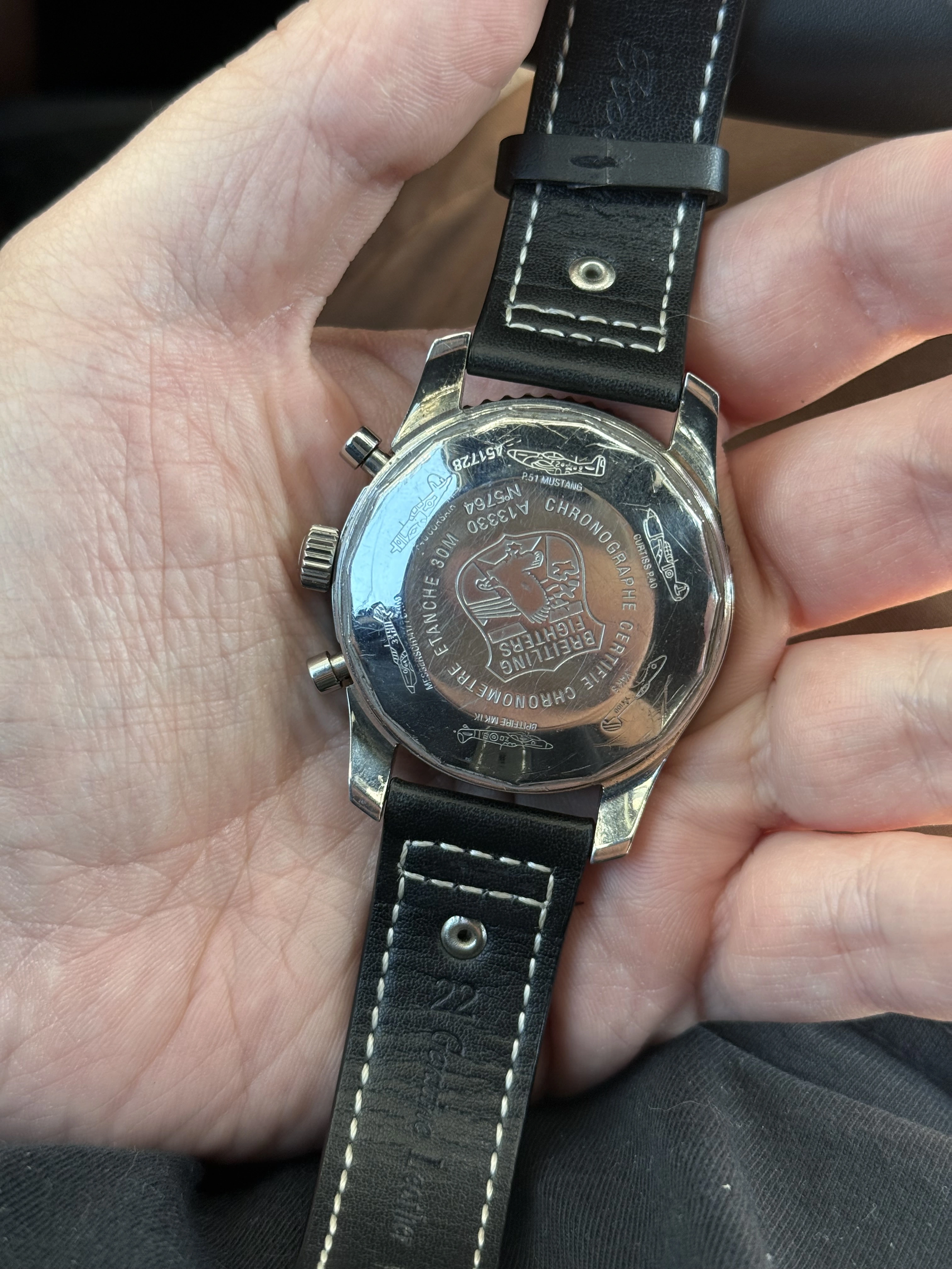

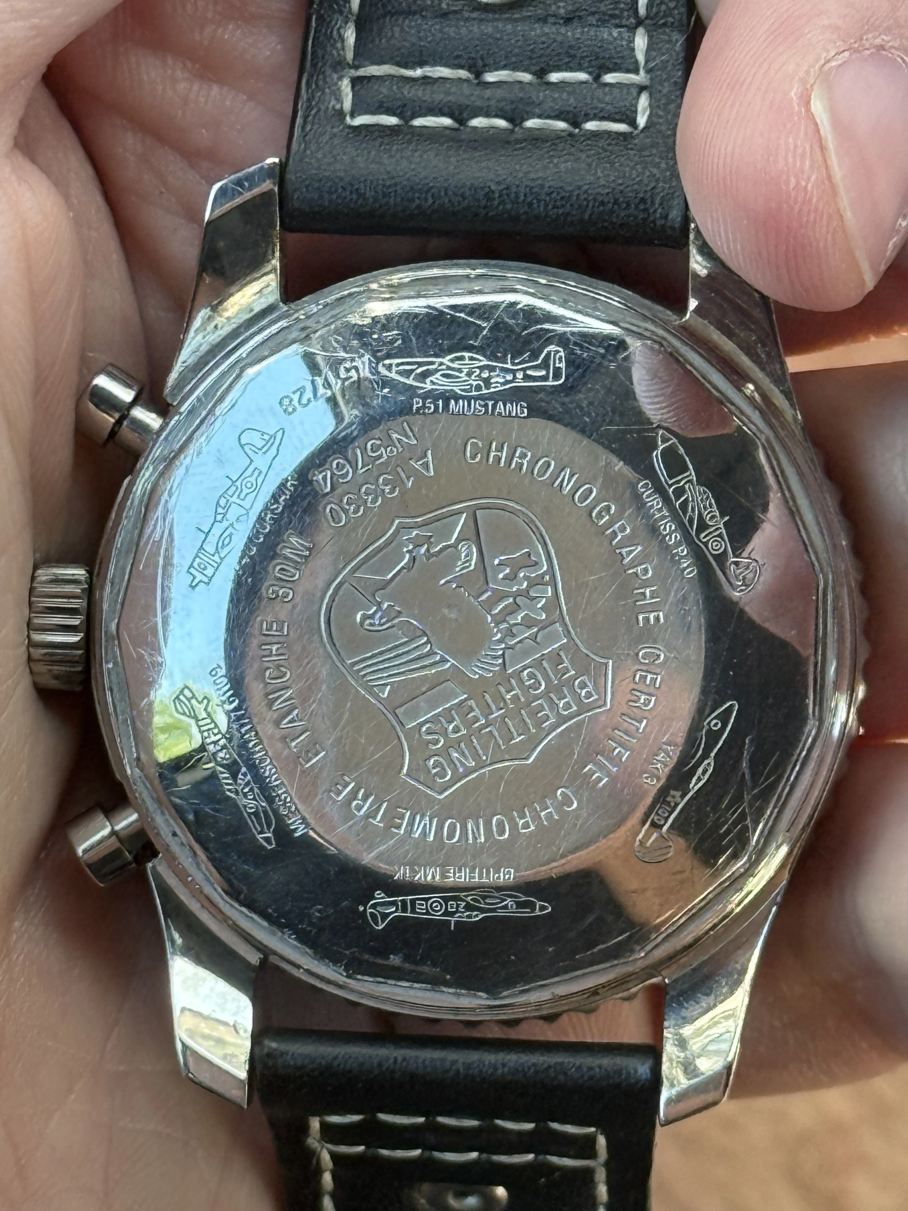

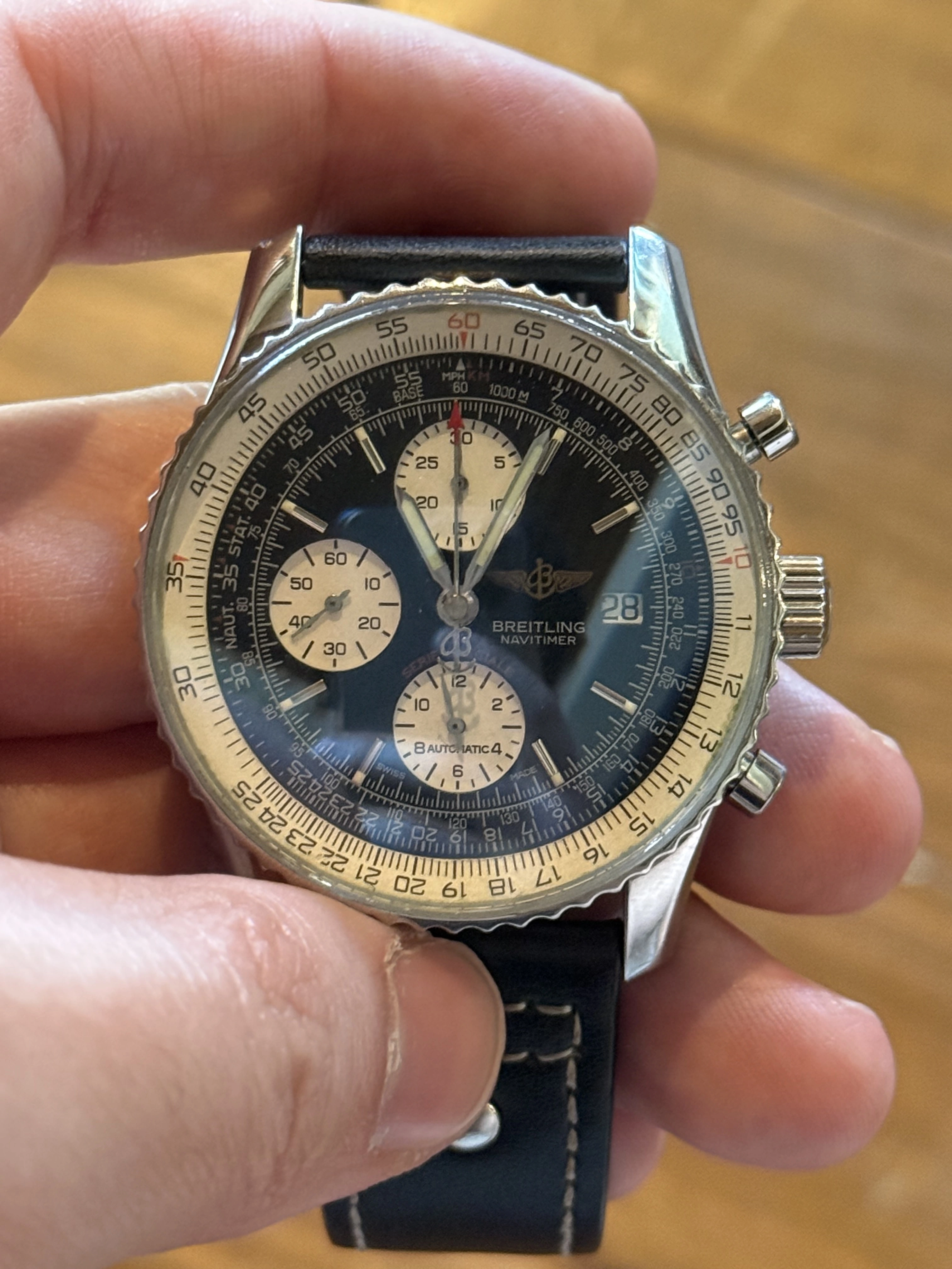

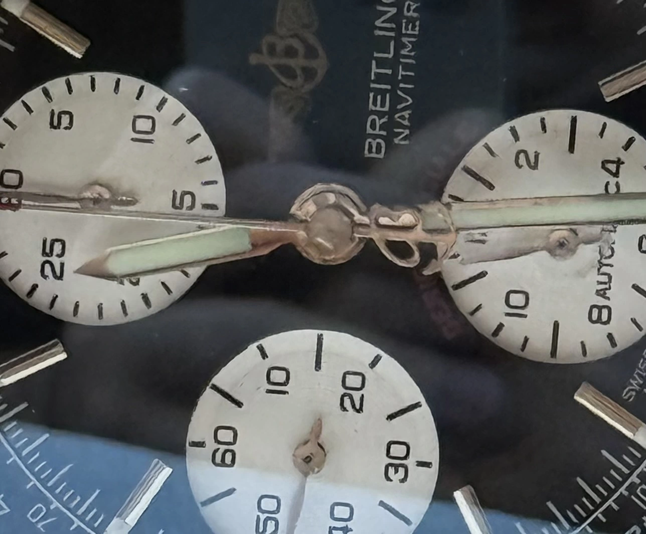

Hey gentlemen, I bought this Navitimer A13330 but have worries it is not authentic, I am checking every little detail and my anxiety is kicking in. Could you help ?

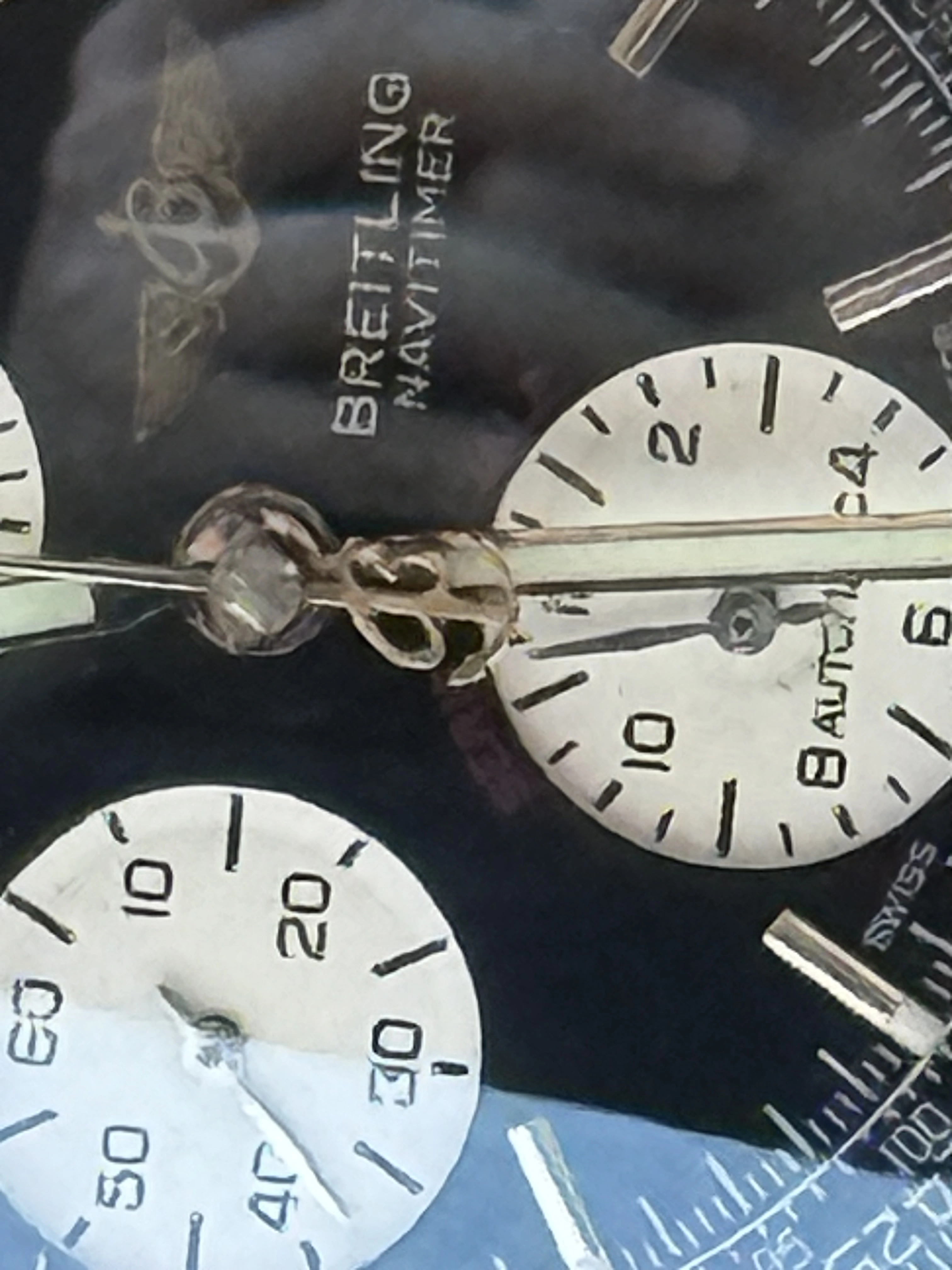

Date window horrible, every single font is wrong when compared to genuine versions of the A13330, slide rule bezel numbers are printed in the wrong location (especially the 40), caseback planes are too close to the center and they use "." instead of "-" for the plane names.... all signs pointing to fake. You should open the caseback to confirm, but it's not looking good for you.

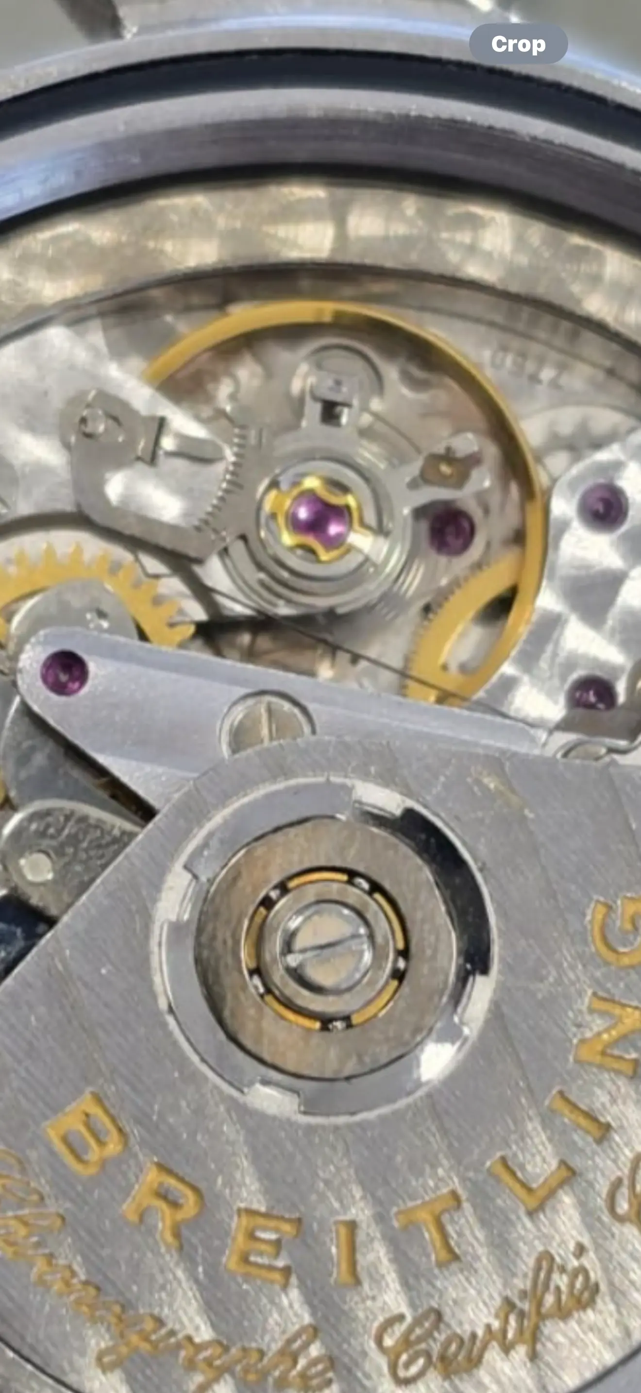

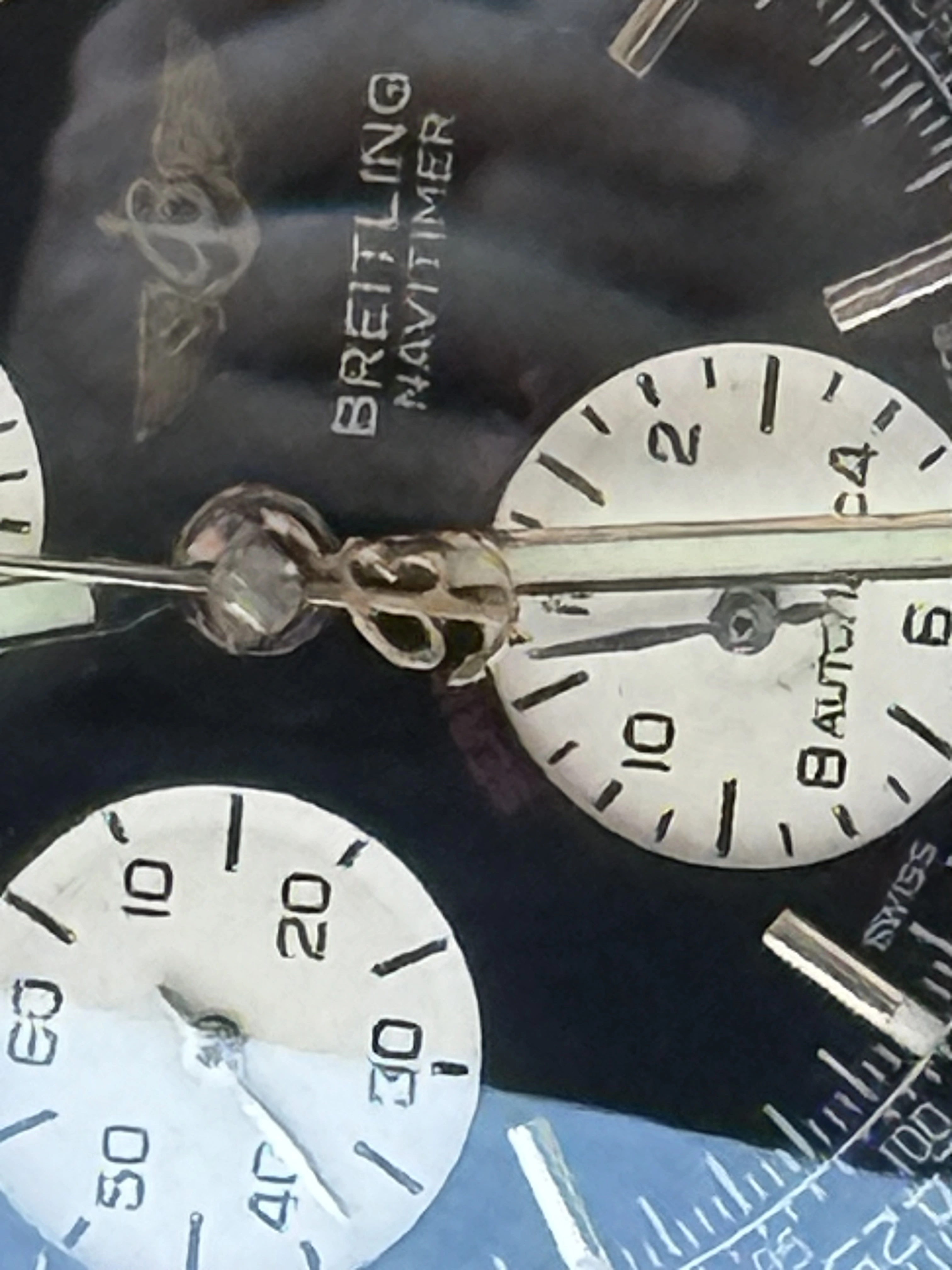

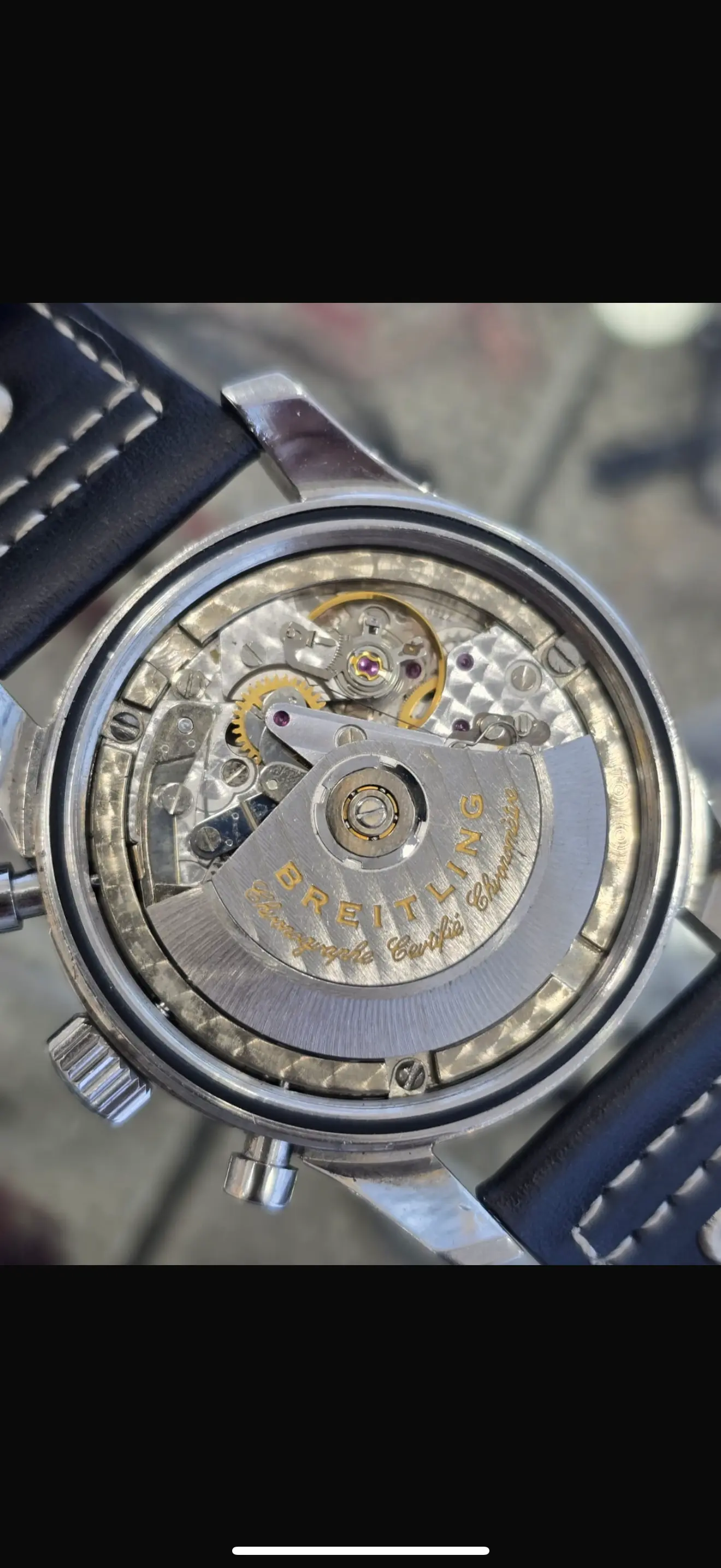

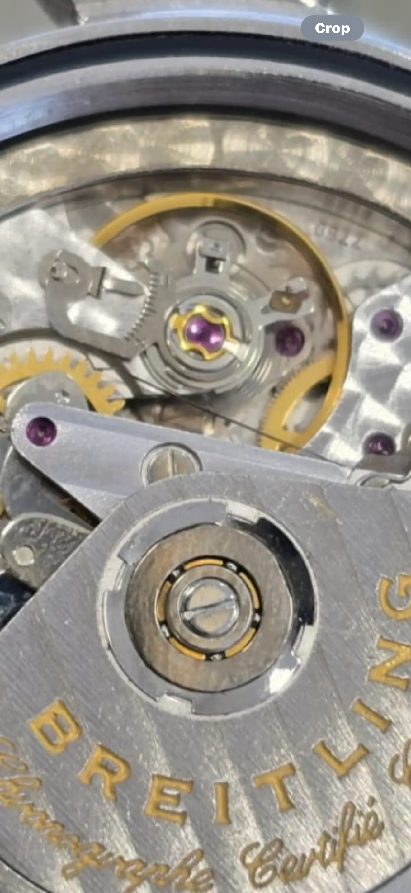

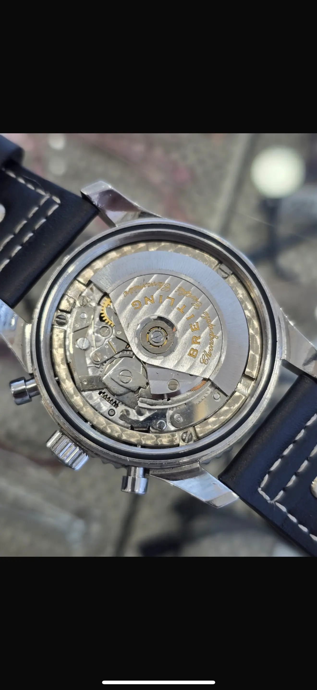

Here is the movement
2,477
3,867

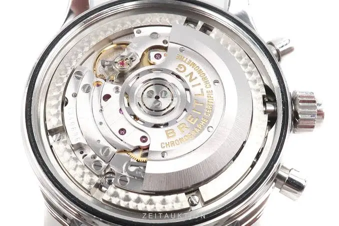

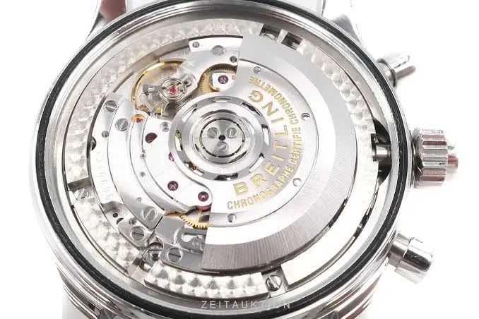

OK, so the problem is the real thing uses basically an ETA Valjoux 7750, which is a common chronograph movement, so it's a little harder to verify if the watch is legit from looking at the movement. The only obvious weird thing is the the movement spacer is supposed to have a plain brushed finishing. This one seems to have a perlage finish for some reason.
34

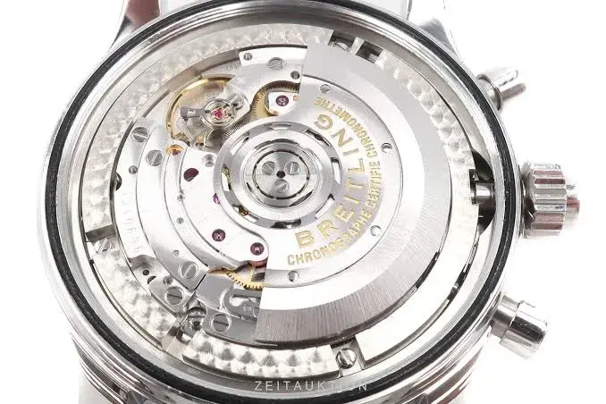

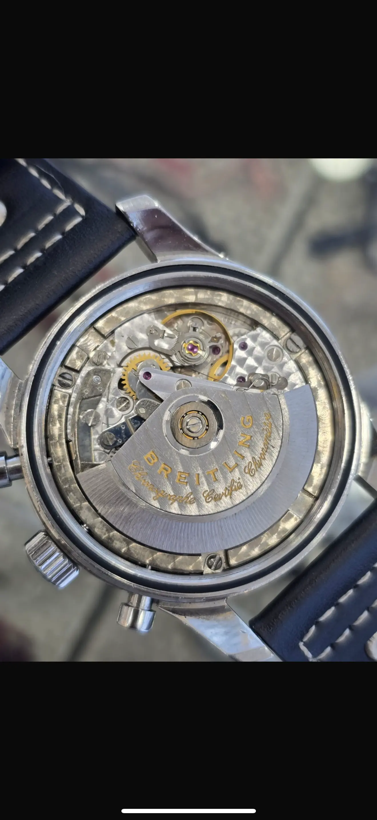

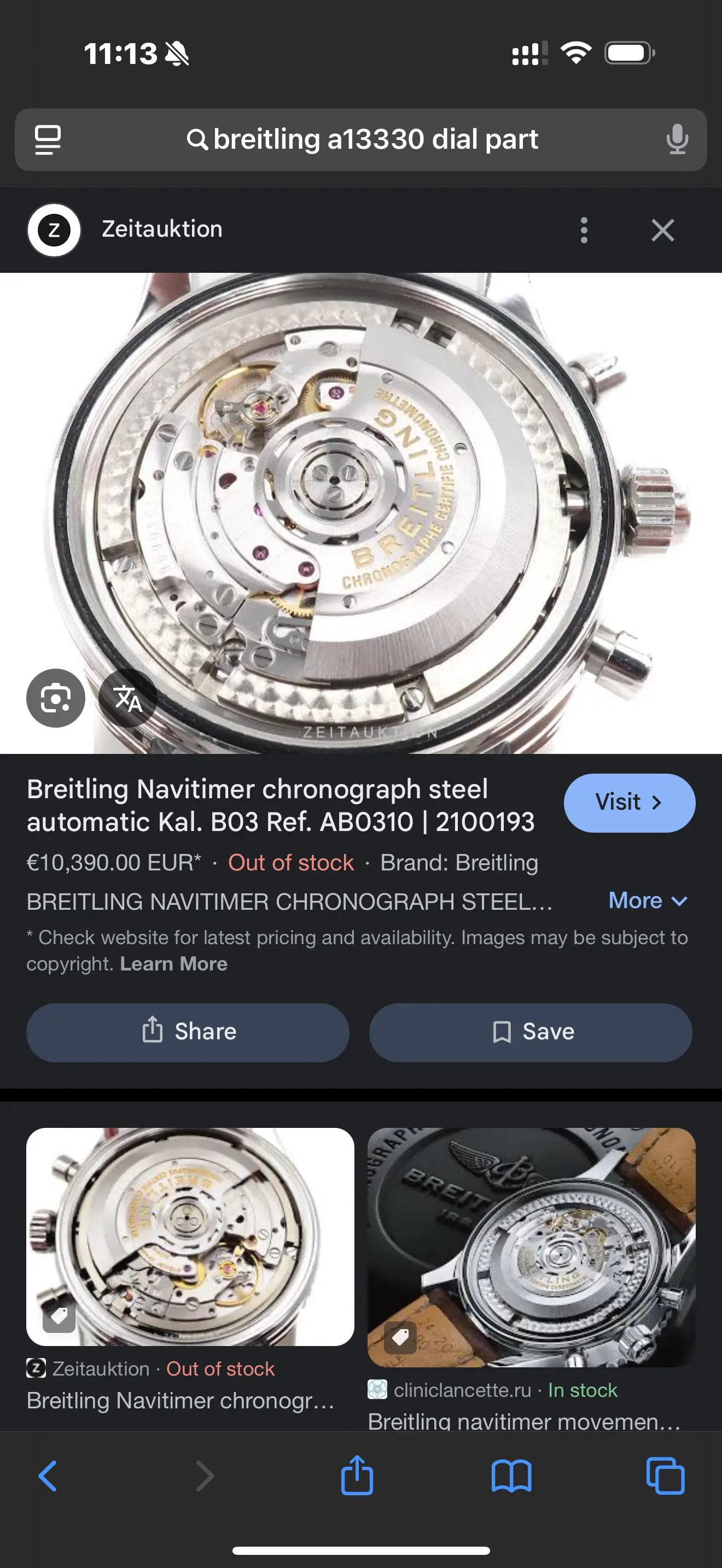

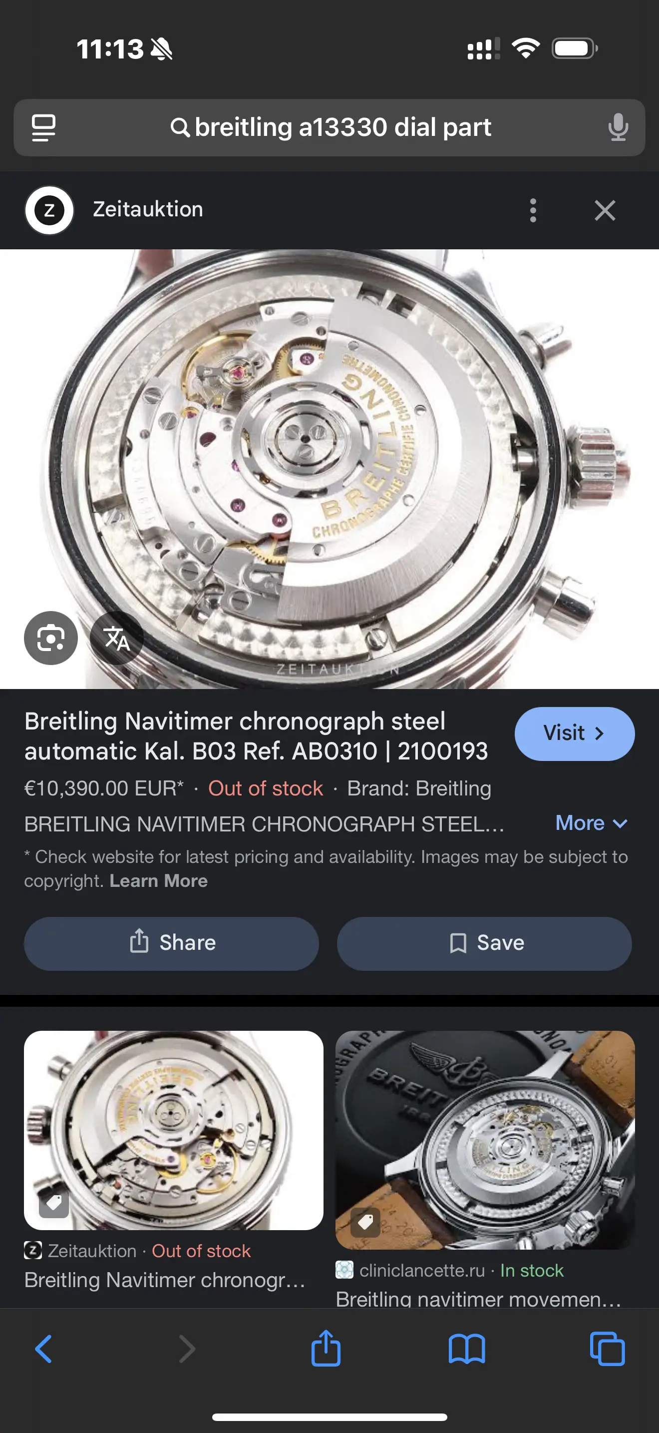

My thoughts exactly.. i found this which uses the perlage, and the hands are the same as a B01 as well.. this is getting weirder by the minute.

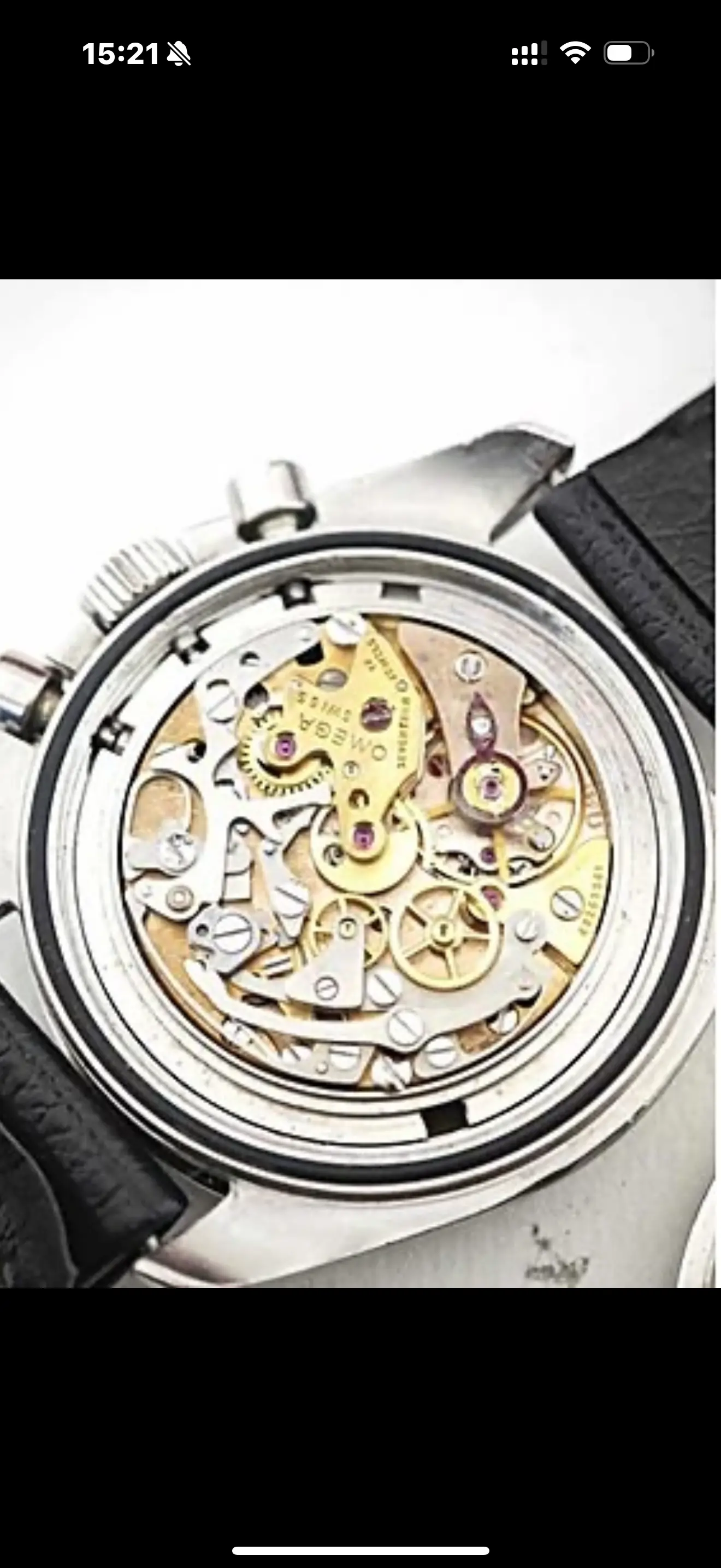

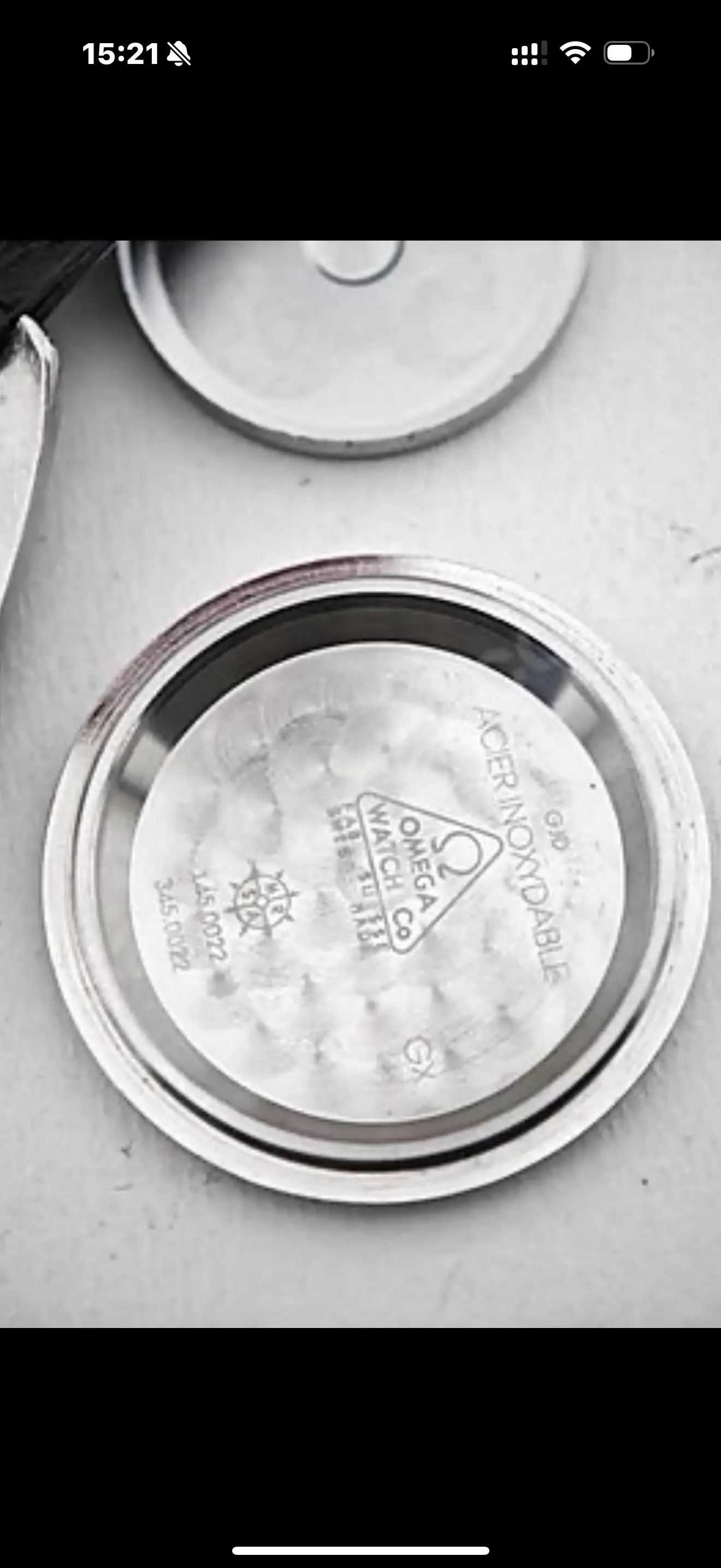

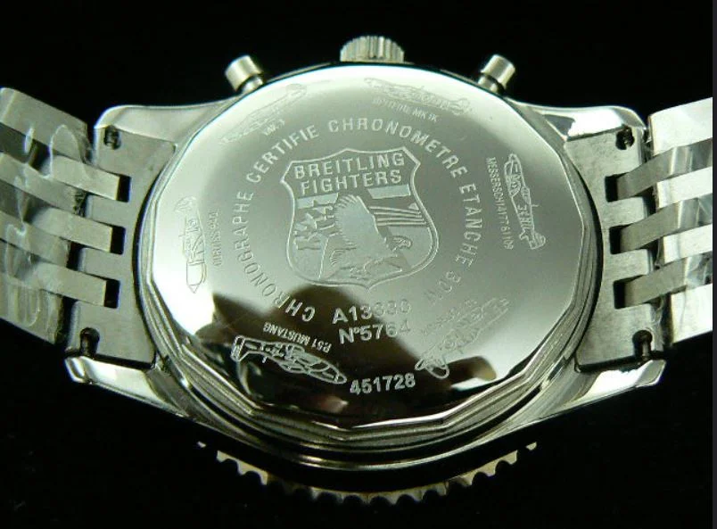

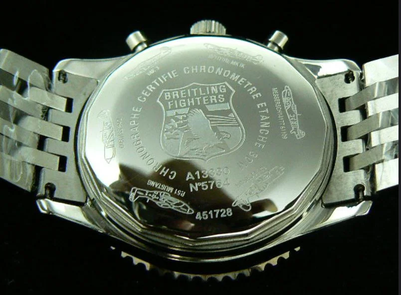

It's fake. I just found a completely different watch with the same "451728" serial number as yours.
Hope you get your money back.
Thank you ! What is this watch ? Can you send the link ??
