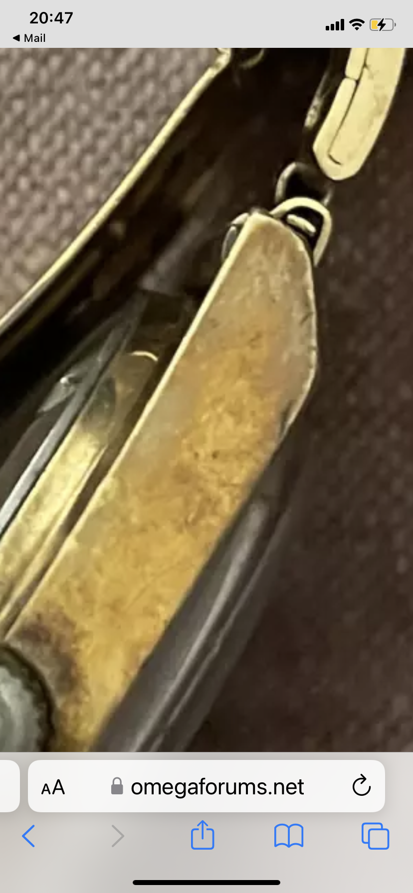

is this authentic?

The band is not original, and from the little I've seen, this reference usually (always?) came on a strap, so that's a good choice.

I'd just have it serviced and have nothing done cosmetically except for a new crystal. The wear was put there by your father and would be a nice way to remember him (I could personally even live with the cracked crystal for that reason). The dial looks pretty nice, and that's most of what you see.
Also, it's authentic. It starts working when you move because there is a rotor that rotates with your movement and winds the watch.

Thank you all. So sounds like some think it's authentic, some not? the watch band - the folded part - says Speidel. I read about how the second hand should stop - but I can't pull up the crown. It's stuck. I chipped two fingernails trying. Makes since it would be 70s or 80s. it was my dad's. he died in 2015 and it's been sitting in my drawer. He was 6'2," and I'm 5'3" and have a tiny wrist compared to his. I'd like to change the watch band, have it cleaned up and wear it. It's still running. I know nothing about watches, but it surprised me that it's still going without being "wound" - but I realize I may be lacking a lot of information! I know nothing about watches. How do you find a good person to take it to? I live in Colorado, btw.

The watch is an automatic, which means there is a spinning weight called a rotor that winds the watch when you move it. The watch should be serviced if you plan to wear it. During the service the watchmaker will completely take apart the watch, clean and inspect each part, and replace those that need it. This will resolve the stuck crown and make sure everything is in good working order. The movement looks something like the one in the picture below, the big half disk is the rotor.

Sorry guys - I don't really understand how to quote the way you guys do - with the little window boxes, etc. Yes - I don't mind the little imperfections. The wear and tear. My dad was very active. A business man but also a hunter and fisher. I'll just chose a nice leather band and wear it.

No one has said it’s not authentic.
It’s 100% genuine, just low value. You can hear all vintage omegas from this period if you hold them to your ear.

intersting. I have no desire to sell it but why is it low value? I'm very sentimental and even the dings and wear is important to me. but just trying to learn everything about it that I can.

Everyone says that it's authentic, including me. The watch can benefit from manual winding to get it going, but will get some power from the motion of your wrist, that's what "AUTOMATIC" means.

I don't think the difference in those certifications is really important here. I would ask if the watchmaker has an Omega parts account. Omega will only sell parts to watchmakers that meet their standards, others will have to use generic parts or parts from a donor watch. A service is likely to cost $200-$400 or possibly more if a significant number of parts need replaced.
Keep and mind when members here give you an assessment of value, they approach it from a collectors point of view. The value to a collector is low because the design is from an era that is less popular these days, and the gold plating has worn through in places like the corners. Collectors generally prefer stainless steal or solid gold with crisp corners. However, this is the only watch that your dad wore for years and that makes it priceless to you. I wear my Dad's old Omega and it is a great memento. The 700 series movements (mechanics) are very well-designed and are top quality. It is a solid watch and will give you many more years of use. Don't worry about the value, because I doubt you plan to ever sell it.

Because of the specific style and the condition.

I would submit it’s not a « problem » because the watch had no value to begin with as a collectable. The only value is sentimental, so the only thing that matters is whether it can be worn to tell the time.

Regarding value, 1970s watches that are gold color are currently not fashionable - so their price tends to be low.
also this one is not solid gold, it is gold plated, it’s a fragile material which is less desirable to collectors because it can wear off, as on the sides of the lugs of this watch.
The crown is probably a “screw down crown” which is why it seems stuck. First, unscrew the crown (turn counter clockwise) and it should pop out a little. You will then be able to wind it manually. Pull out the crown a little more and you should be able to set the time. When finished, push the crown all the way in, and screw it back I’m while continuing to push in it. It will catch on threads and be screwed back in.
It’s a great heirloom: have it serviced by a competent watchmaker and have the crystal replaced. You’ll be good for the next 5-10 years. Wear it in good health.

Well obviously sentimental value doesn’t translate into monetary value. As described above, it’s an entry level piece from a period when Omega weren’t at their best and the condition is average at best.
However, if it has sentimental value none of this matters. I wish I had a couple of watches with more sentimental value.

thank you. I can't turn it any direction. I'll leave it to the watchmaker.

These don’t have screw down crowns. It’s likely gunk or a deteriorated seal that have caused it to seize
