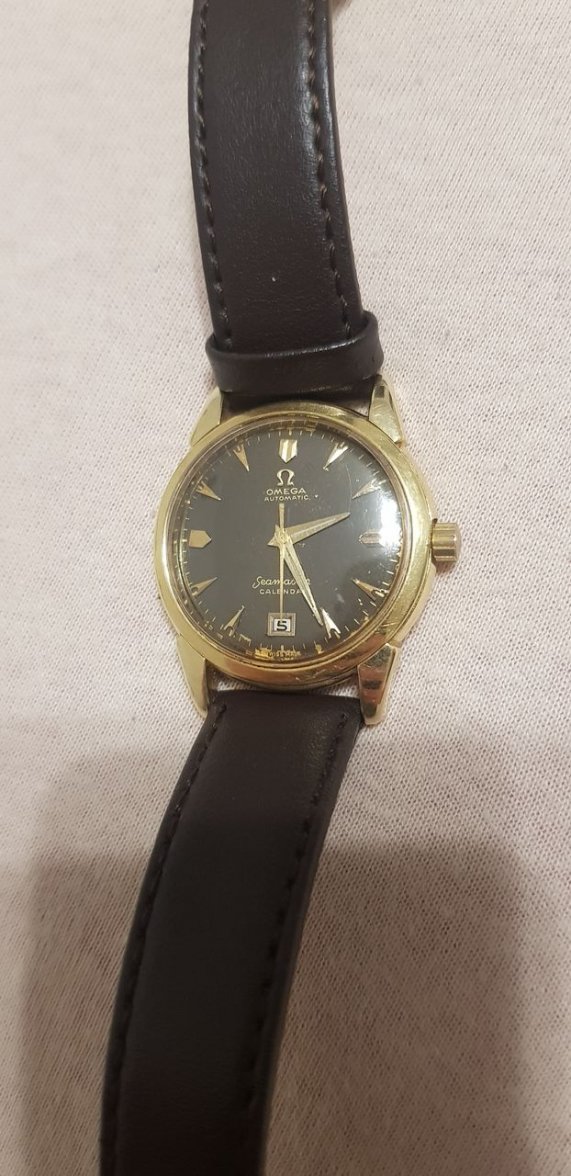

Hi all!
Couple days ago found a guy who wants to sell his Omega knowing nothing about that watch. As to my research results this is a 1950's Omega 2627 (solid gold) cal.353 with a bumper rotor. The crown is not original, the authentic one has a clober form. I will be able to examine this beauty next week, but a have some doubts on this dial, seems like it was repainted. The seller asks 900 Euro or 990 USD - is that a fair price for that watch?
Can you please help me?
Thank you!
Best regards.

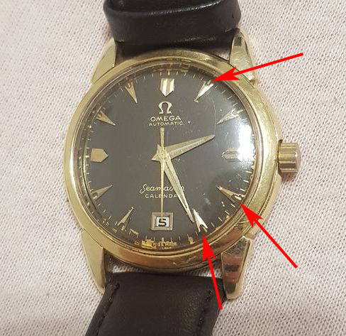

I am pretty certain it is a repainted dial. The 12 o'clock marker is crooked and the 9 o'clock marker is completely different from the rest. Several of the arrow markers are also crooked. It is a mess.

Yes it is authentic but the dial may be repainted. Better pictures of the dial would be helpful, at the very least the dial has been taken apart and poorly resembled.

From this angle, it looks like the 9:00 is taking a right turn 😉
A straight on shot of the dial would help things.

Dial is a horrible mess. There should be luminous material where these misaligned markings are, actually they shouldn't be there at all.
It will be very hard finding an original dial.

Thank you all for help! I think I will try to find an authentic dial for that watch and get the price down. Hope to find smth in nice condition.
Thanks again!
