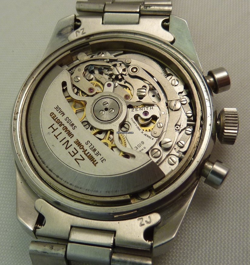

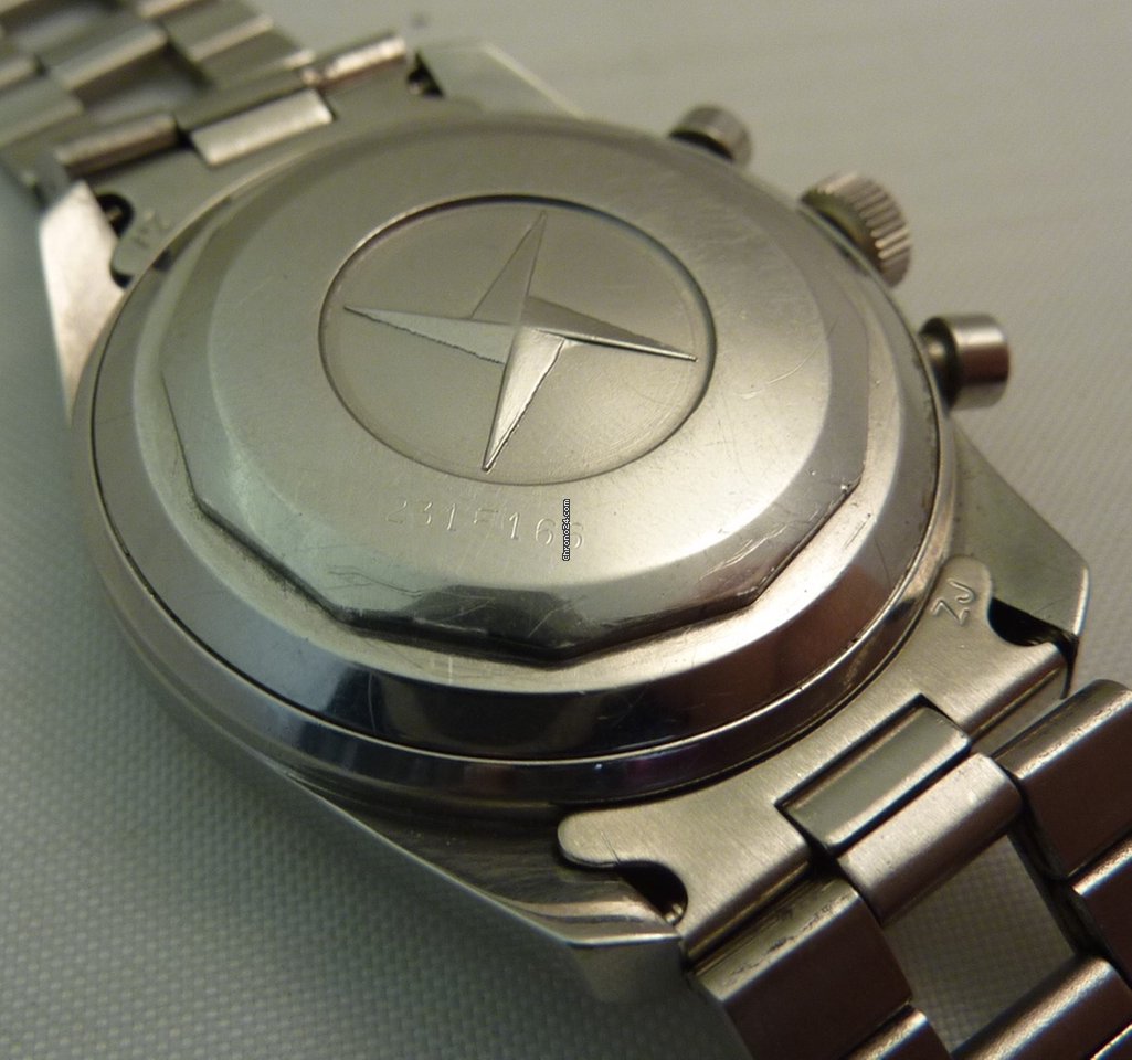

    I allow myself to add some pictures for illustration purpose:
    Looking at its caseback it seems to be a mark III but ref number seems quite strange: 231E(F?)166?
    It is not easy to see on the picture but it does not seem to start by 8 or 9...
    Any thoughts?
  7. haga888 May 27, 2015
    443
    1,598
    My Mark III starts with 923D...
    Could just be the photo but the 1's look like they are hand-engraved. And the E or F actually looks like a 5 to me.
    nicolas07 likes this.
  8. nicolas07 May 27, 2015
    197
    238
    So quite strange...
    Maybe an overpolishing makes the serial numbers disappear...?
    Anyway, at such price, I would not continue with this one with such uncertainty

    Per LouS in an old post the 5th series of the A386 would begin with 231E. It could have been polished and they tried to highlight the serial afterwards.
