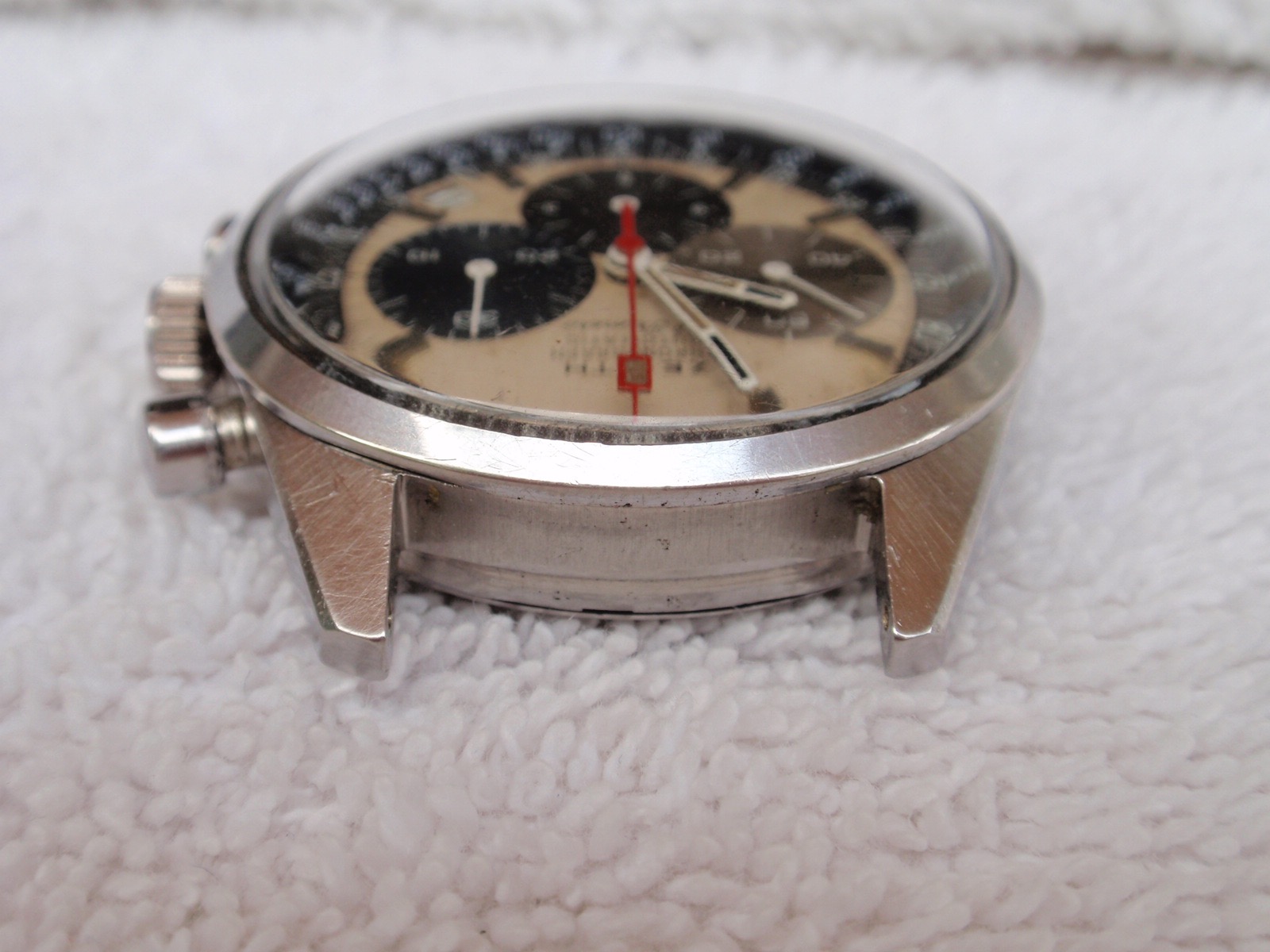

Is this A386 too polished?

how much/where can you get the correct tachy?
That tachy ring is advertised on eBay if you bother to do your own research. Even adding a service tachy ring, the watch will still be a "confection".

Mark I case is indeed the rarest of the 3.
Too bad that this one is clearly a mix of different parts, the dial is in good condition.

Can someone clarify the mix? I am not clear

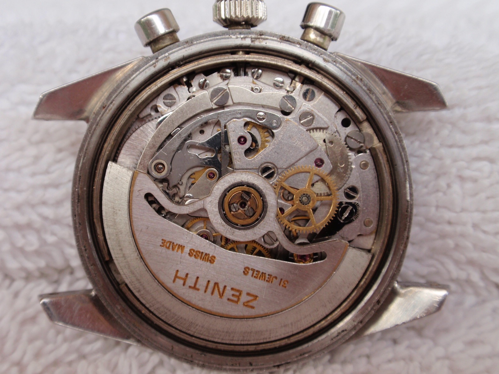

Case, chrono hand, tachy ring, crown -- all should be changed. I would wonder if the movement is genuine.

Case, Tachy, Crown, Yellow/Gold Dial..... really a bargain ! ::facepalm1::
Yes for the seller.....

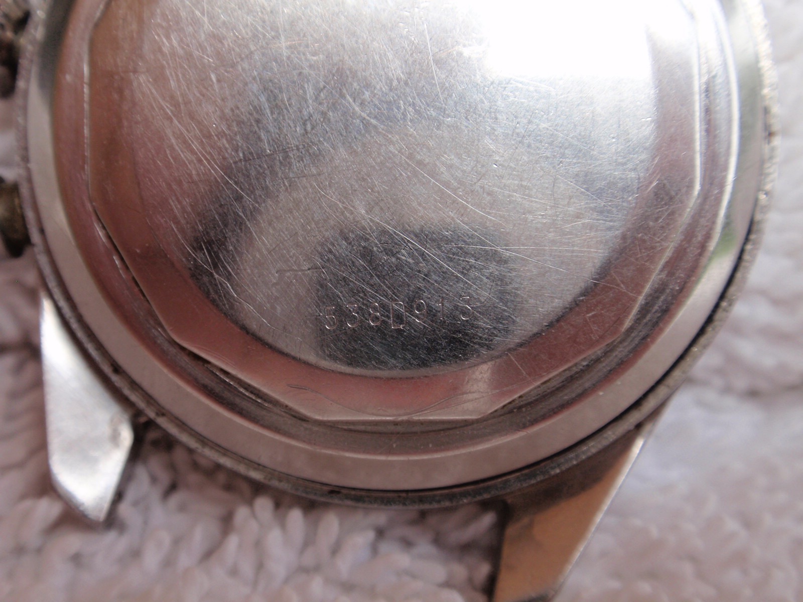

can you tell me what case this is from?
No idea. Looks off. The lugs should have more bend...

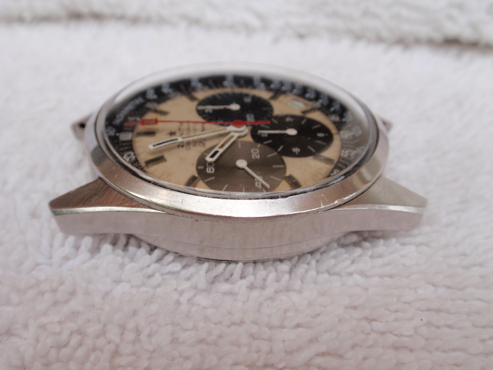

Not even a mark II or III from what I saw.
For me it should not have this difference of level between lugs and case: both should be on the same level with a groove in between
So phony?

So phony?
right. everyone is saying this is not like an Mark1, 2 or 3 seen.
