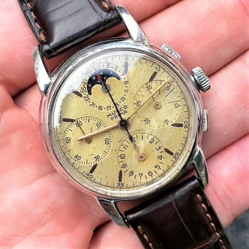

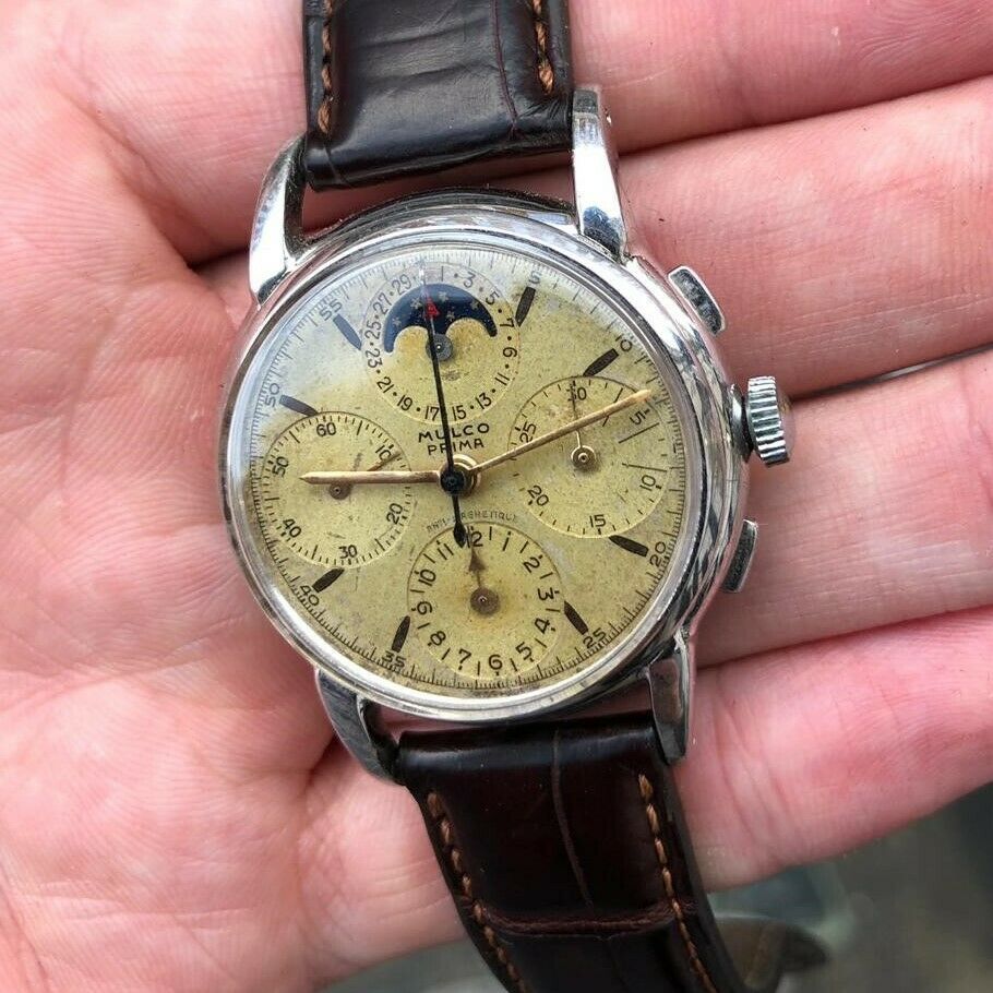

Is this a UG and if so is the dial original?
1,532
3,174
Dial is as original as you get them. Looks like a 1950s design. More info needed! Hands look a little odd but could well be original to the watch. I don't think they do it any favors. Case is nice and clean but looks as though it may have been polished. Movement is likely to be a 481 or maybe the later 281.
28
9
Case is chrome so I doubt it would be polished because it would have eaten through the case. And yeah I don't know much about it I just know it is awesome.
1,127
3,952
looks more like a rebranded Breitling Datora, not a UG.
1,532
3,174
Case is chrome ? difficult to tell but looks to be in good condition ...
