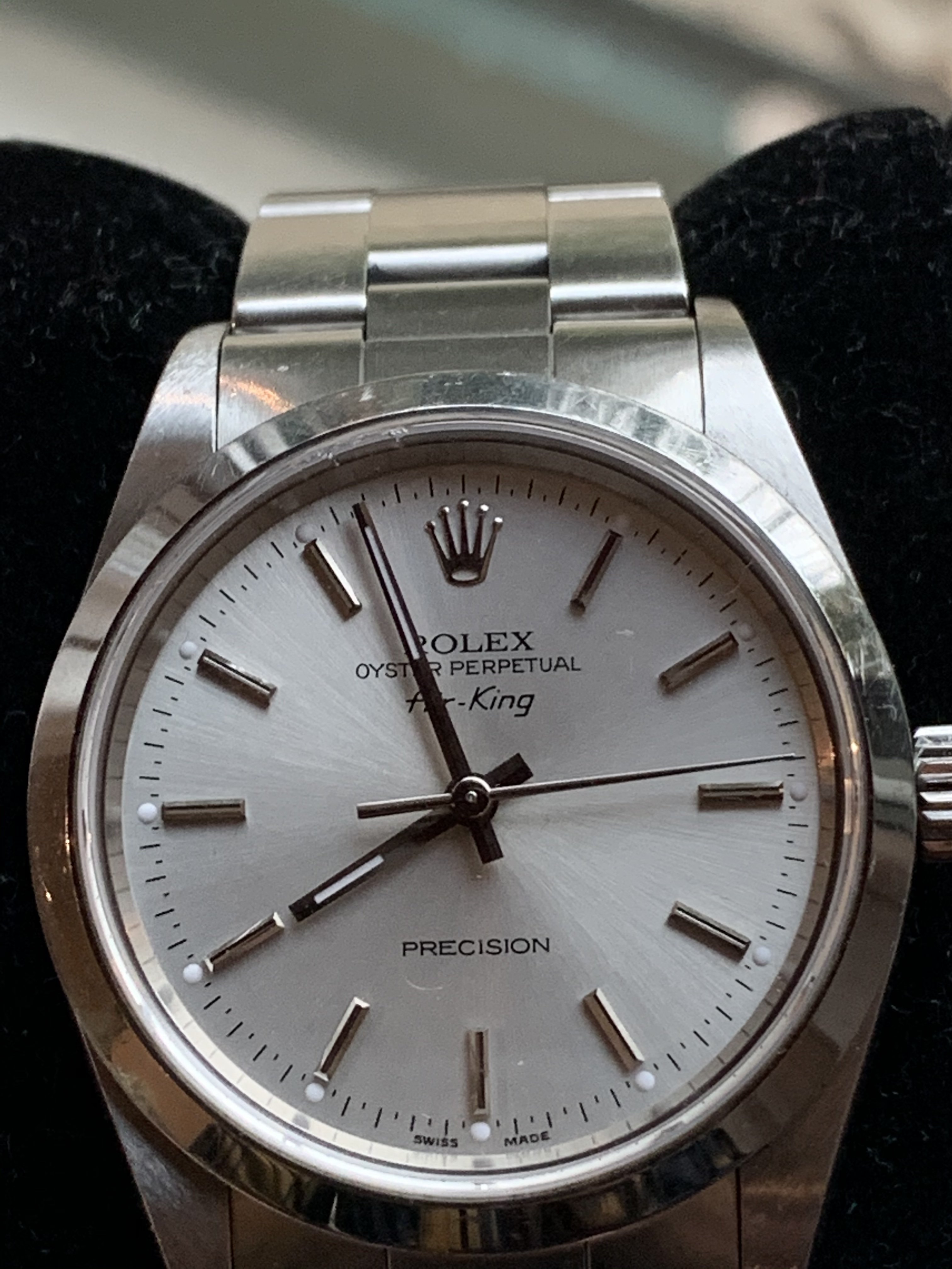

Is this a replacement dial
113
355

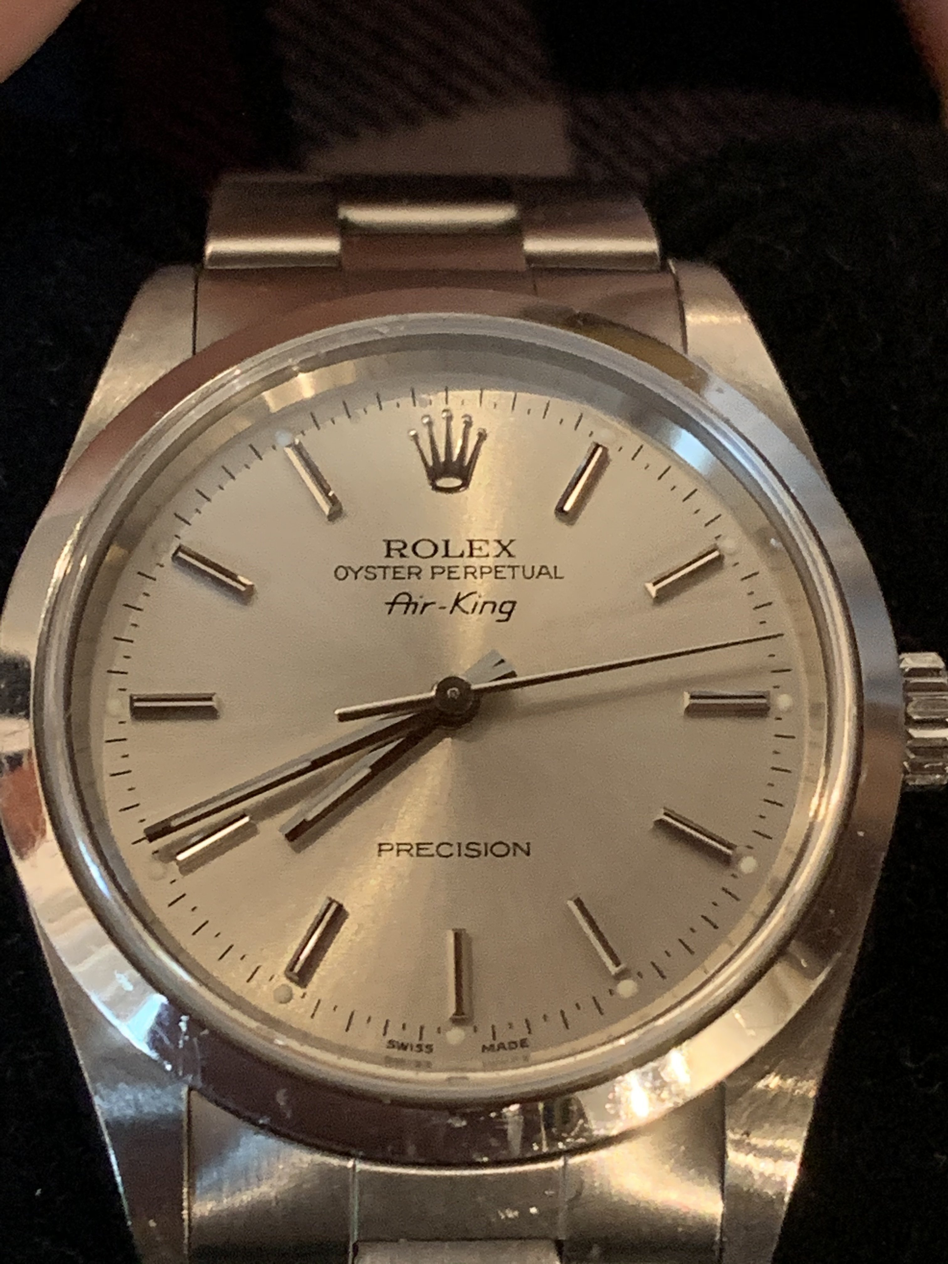

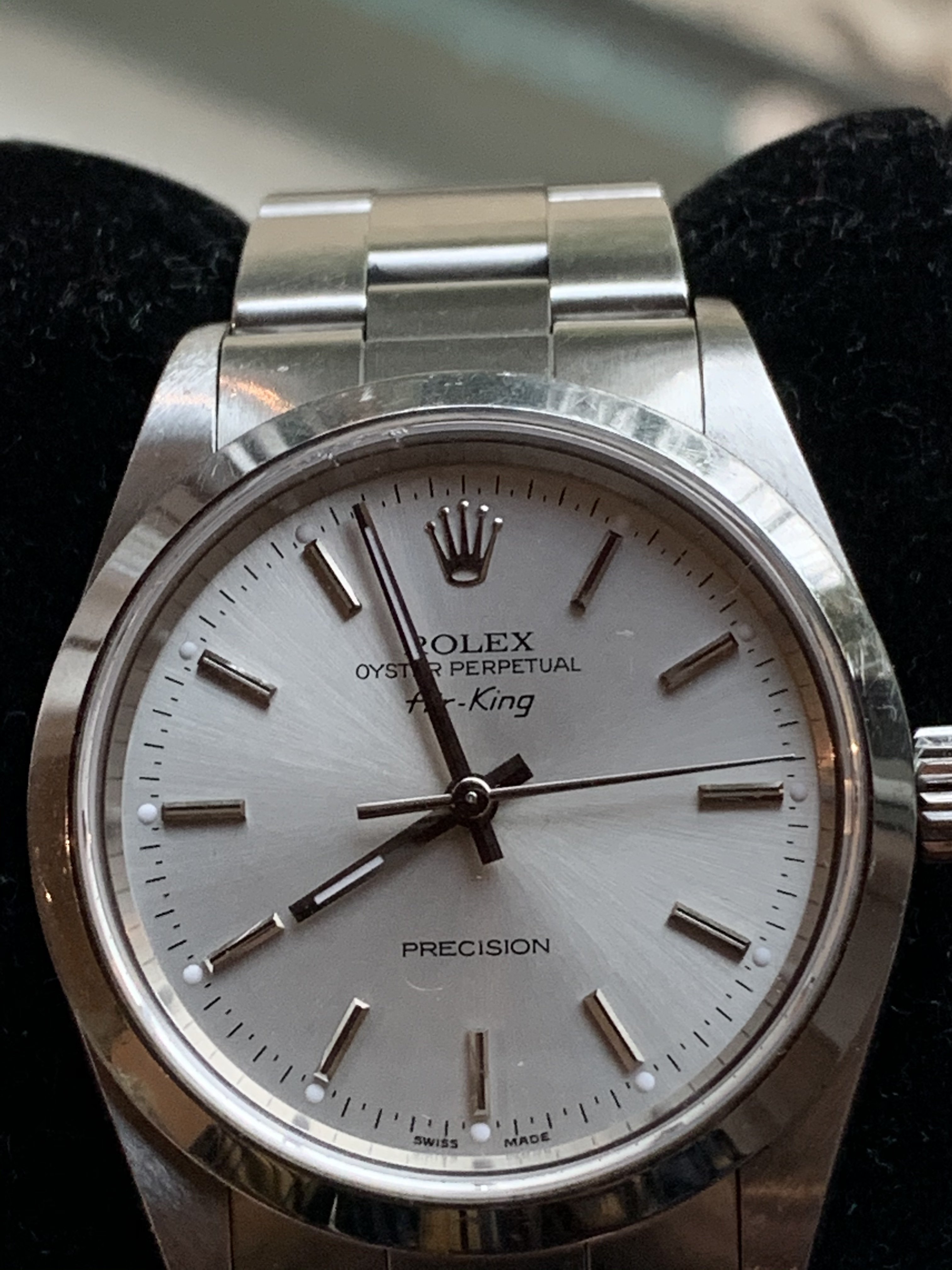

Hey everybody! I have a question concerning a Rolex air king that my girlfriend received a few years ago. We are concerned because we can’t find a Rolex air king that hasn’t got « T Swiss made T » on the bottom of the watch. So would this mean the dial doesn’t have tritium and is a later replacement? Sorry if this appears as a stupid question but to be honest I know nothing about Rolex..
Here are the pics :
Thanks in advance for your precious opinions! 👍
209
478
Let's wait for the opinion of people with actually knowledge about the topic. In addition to your concern, itt seems to me that the lume both on the dial and in the hands is too white for a watch of that age.

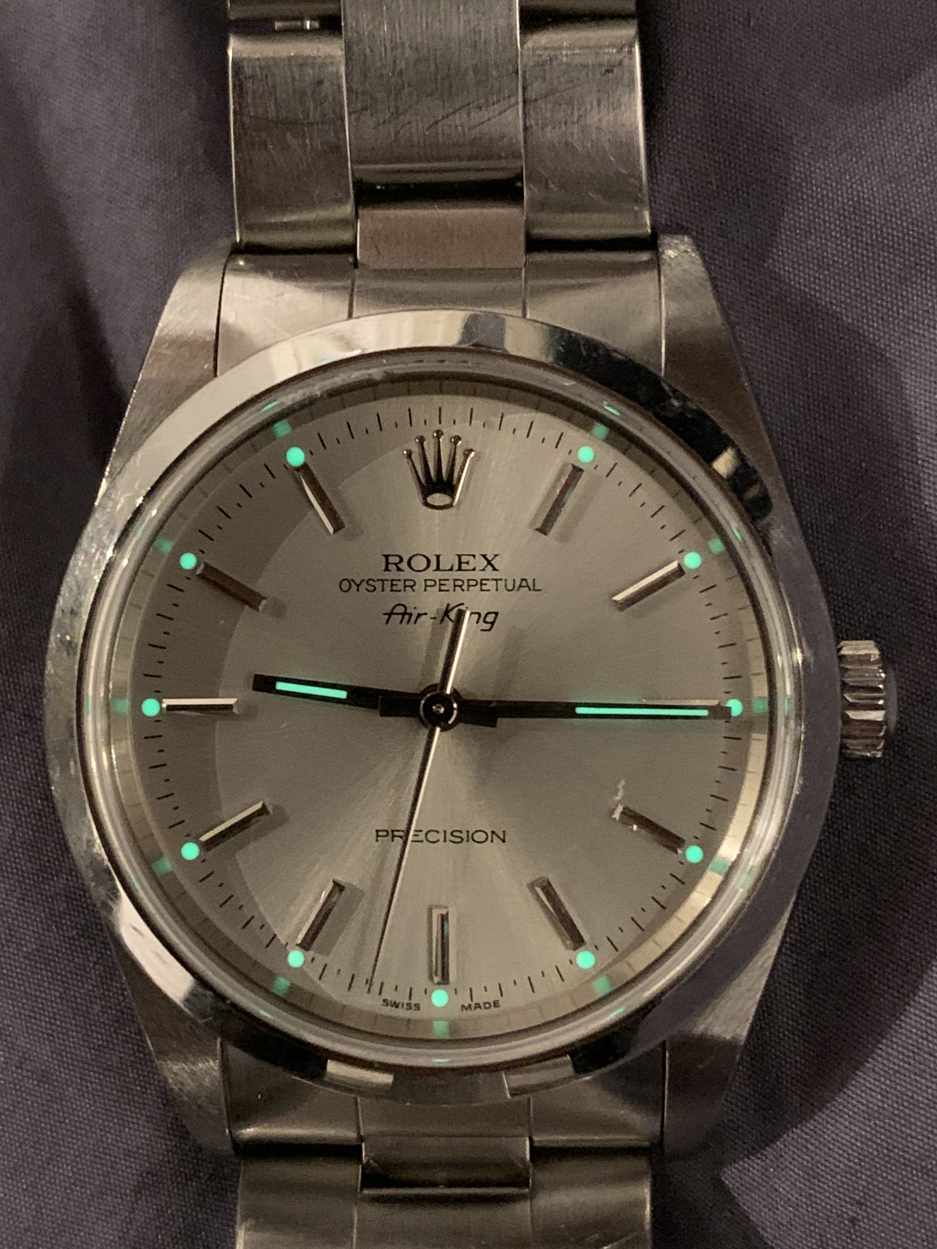

It is a luminova service dial and hands. Yours may actually have oyster perpetual hands though. Here is mine

Well , depending what year is your watch from..
imho,
from mid 60ies till around 1980 -TSWISST-
after early 80ies T SWISS MADE T to 1999/2000
after 2000 SWISS MADE (luminova)
Also to note that there are dials with T Swiss made T with luminova
so yours look luminova , but to be sure is to use the UV light to see if it is glowing super strong . Tritium lume with your dial configuration should be inert to light source
best
Ara M
944
2,450
Actually, is it a reference 14000? If so they are most likely original, does it have a sapphire crystal?
29
91
What year is the watch? Or do you have the first digits of the serial? So we can tell you, if the dial is original or a service dial!

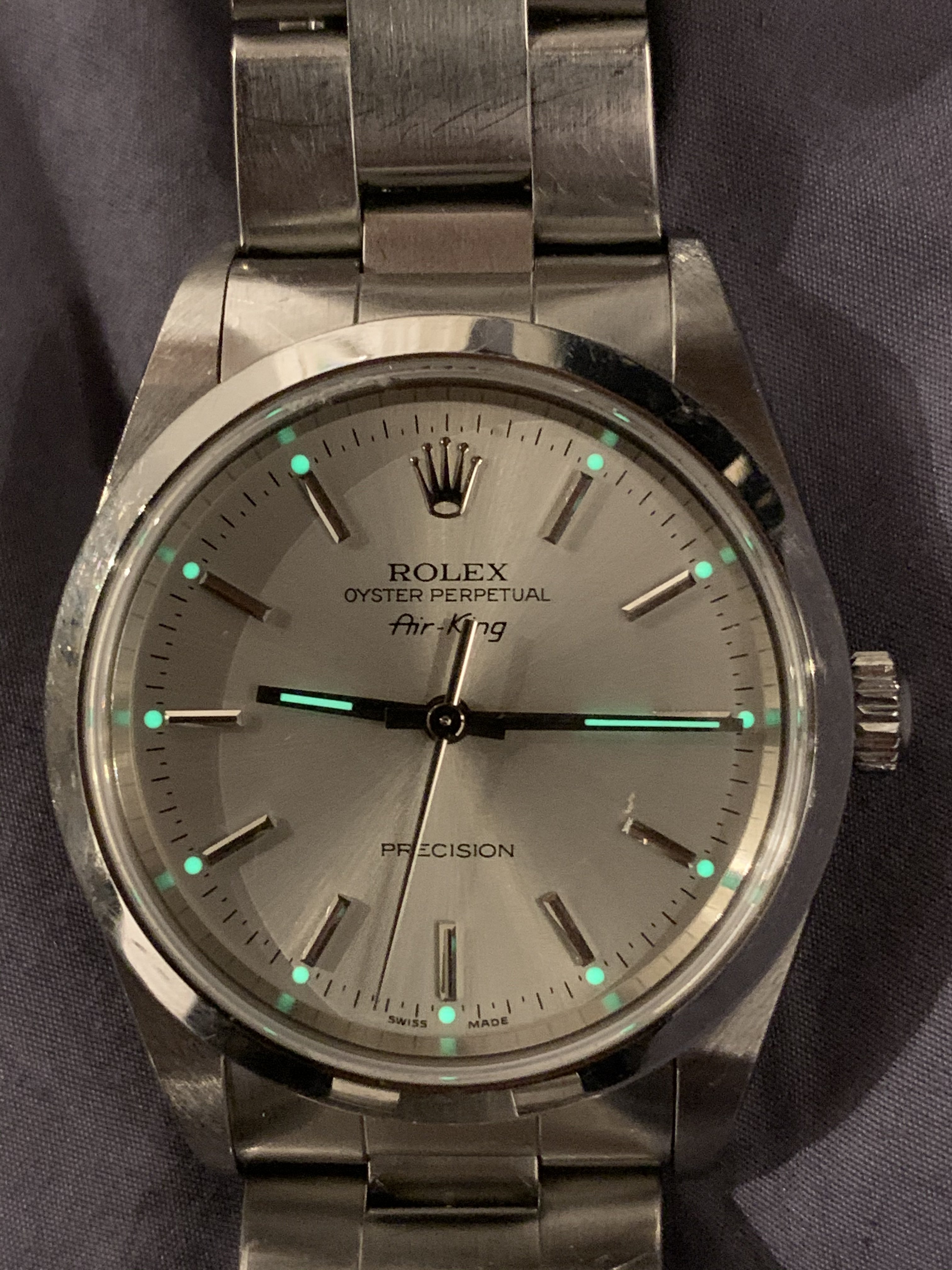

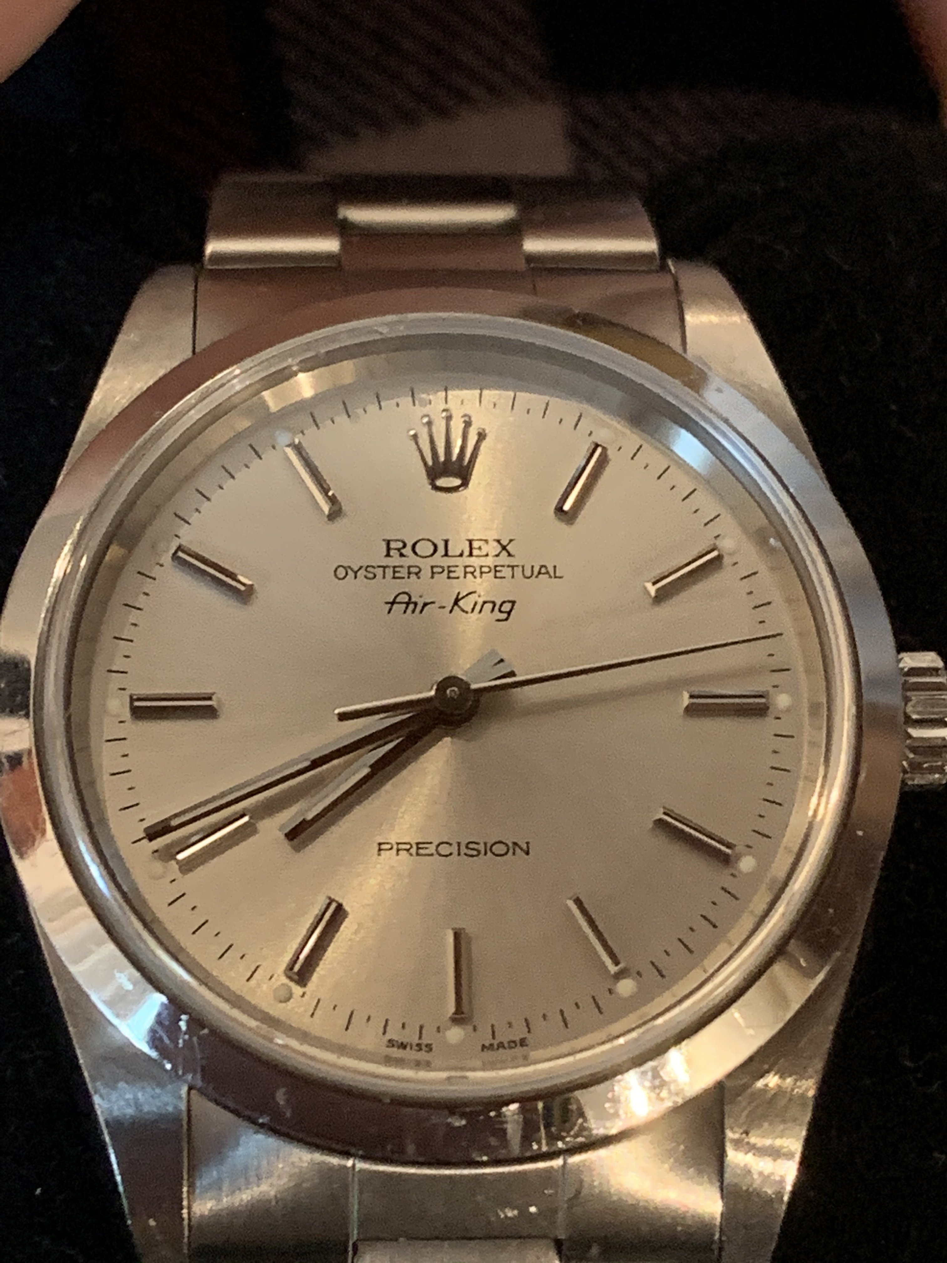

I do not have a UV light but for sure the lume is still active so it’s luminova.
Here’s a pic :
Unfortunately I do not know the reference because I don’t have the tools to open the watch, but it has a sapphire crystal for sure.
The only thing that I know is that the bracelet reference is 78350, but I don’t think this will help 👎
Thank you so much for your help, you guys are awesome 👍

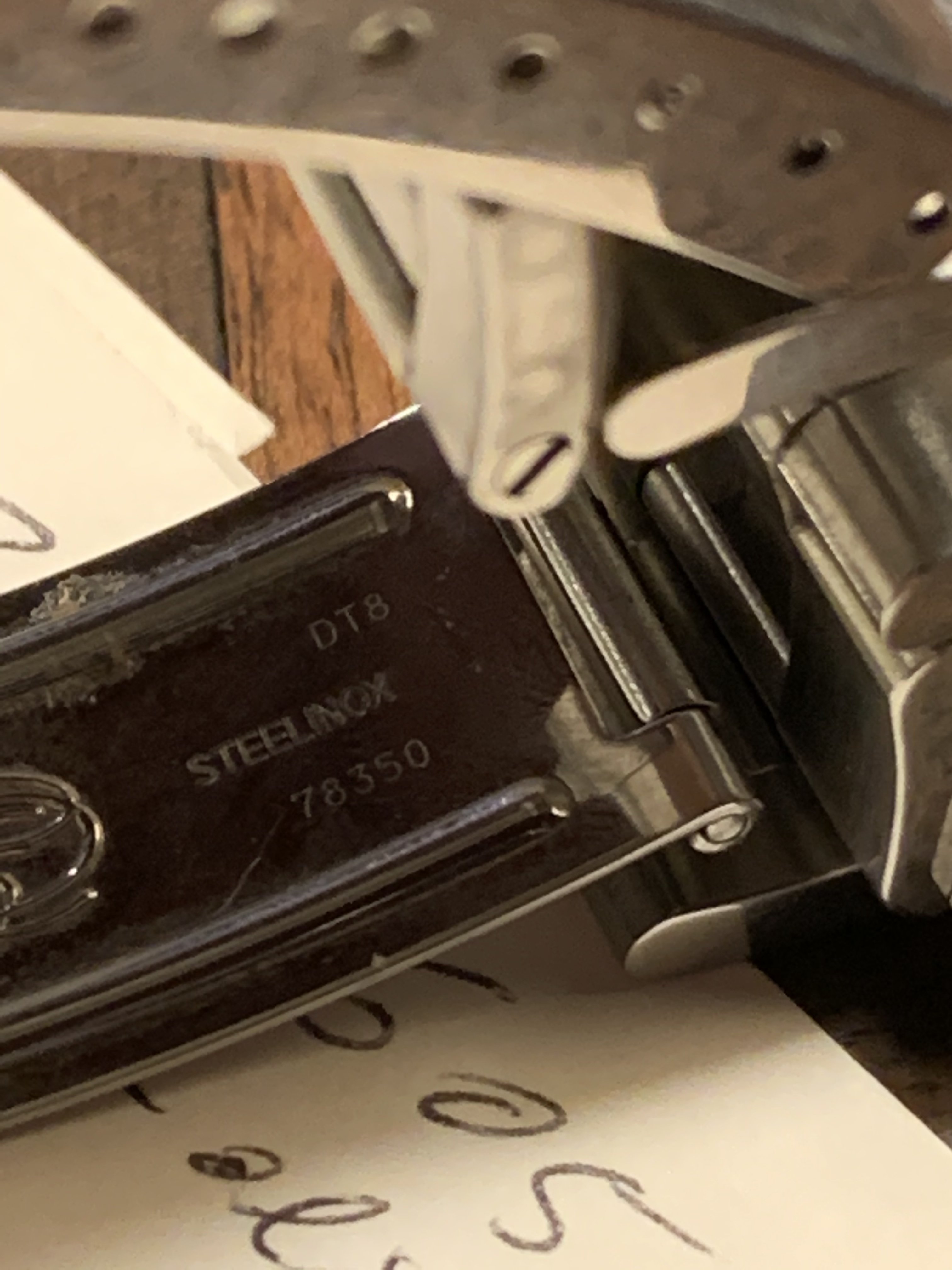

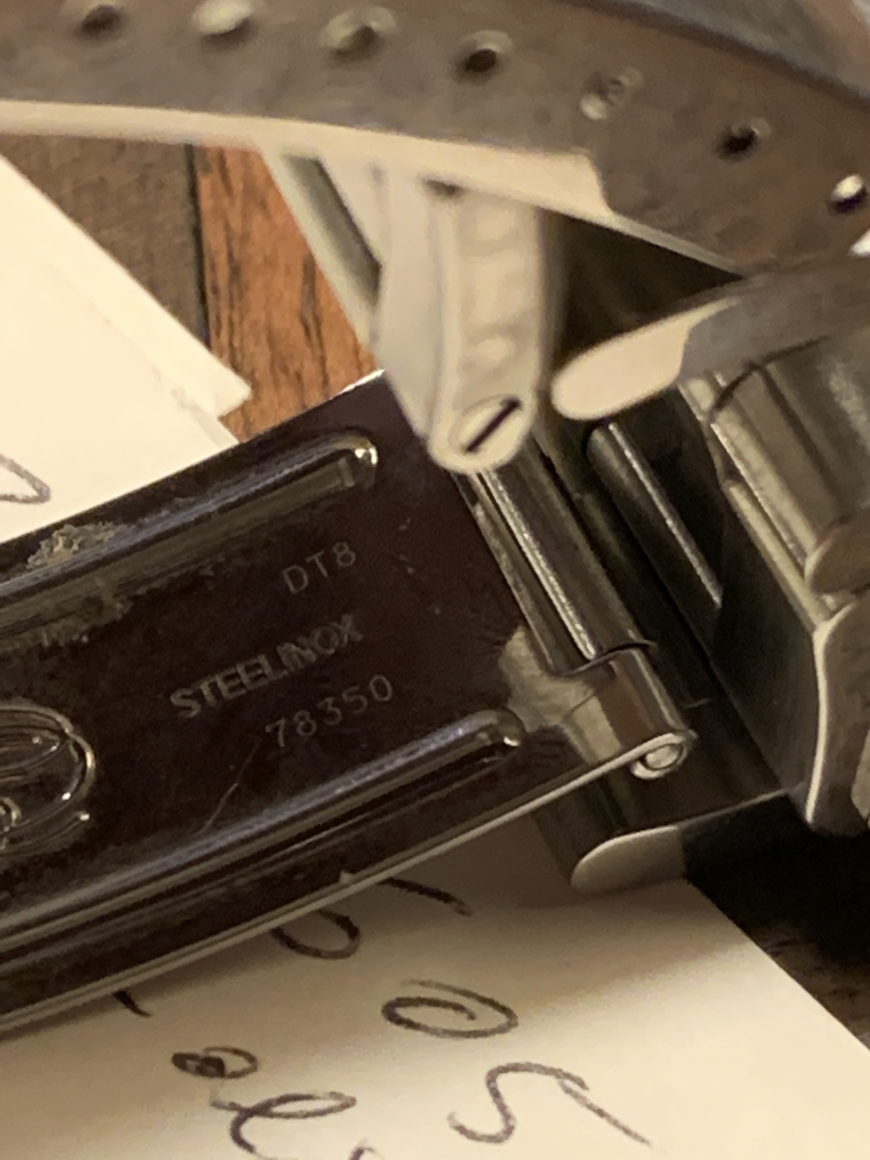

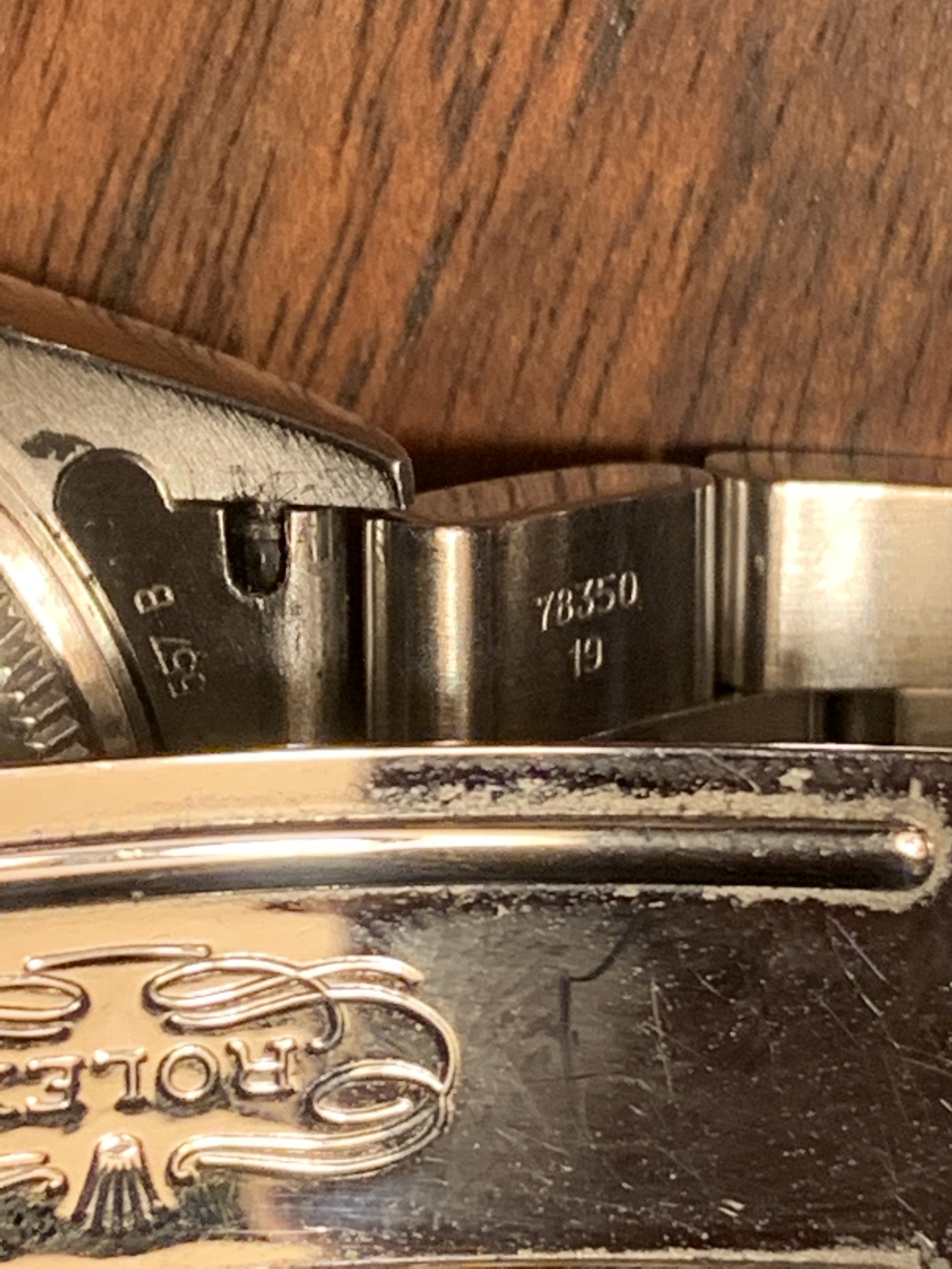

These are the only references that I can see on the bracelet :

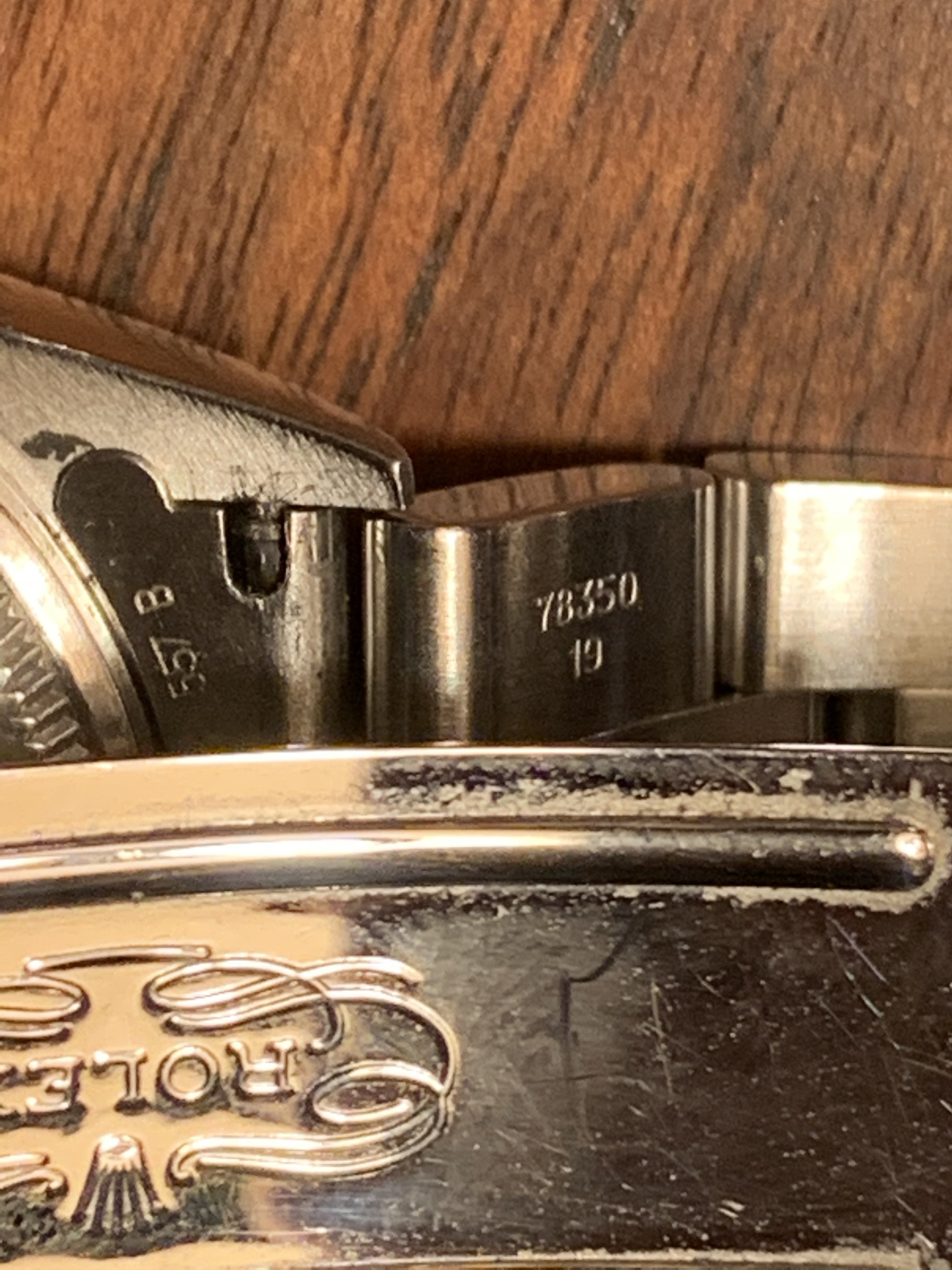

So the bracelet is from August 2002... If the watch comes originally with this bracelet, the dial should carry luminova 👍

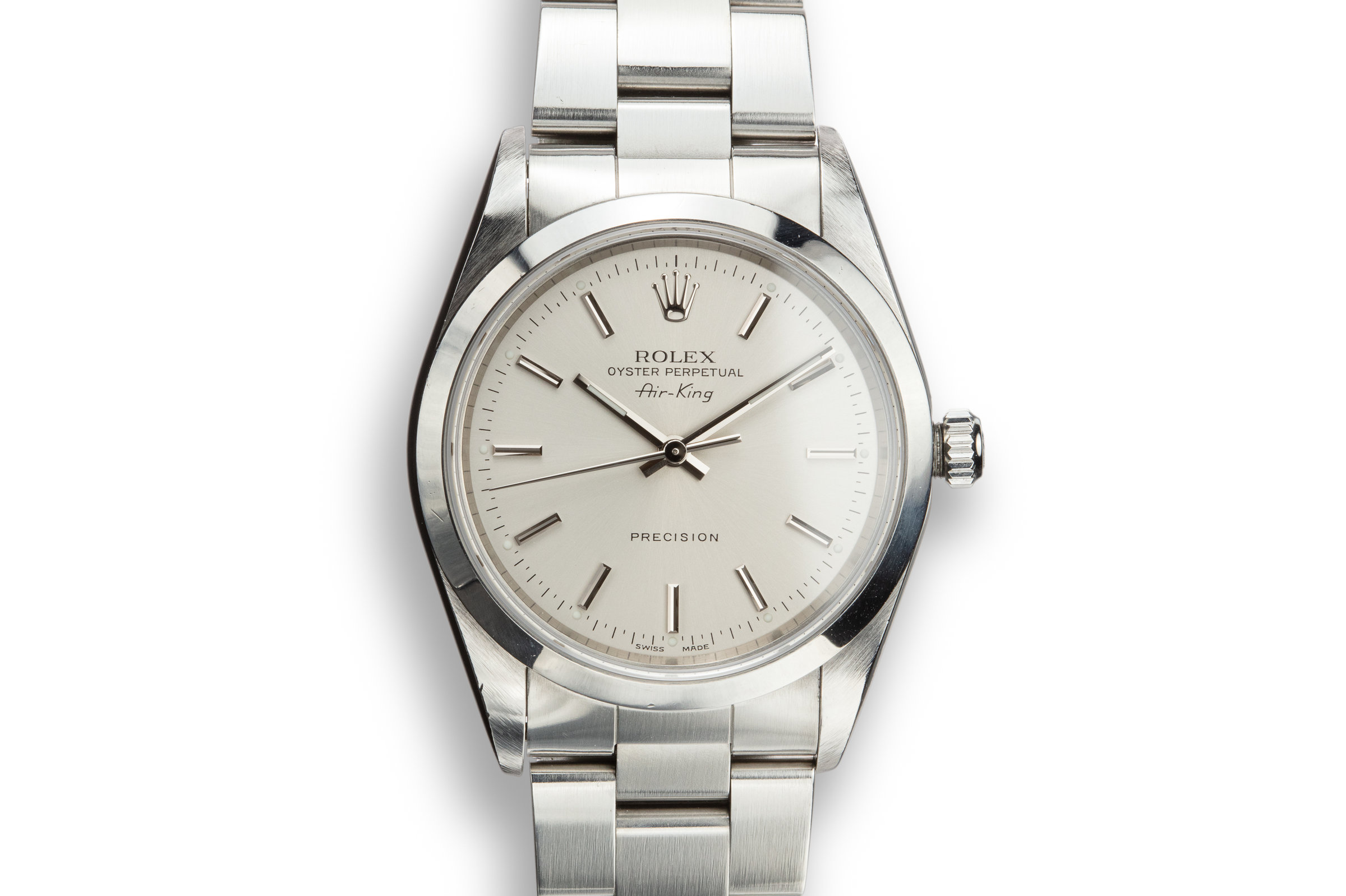

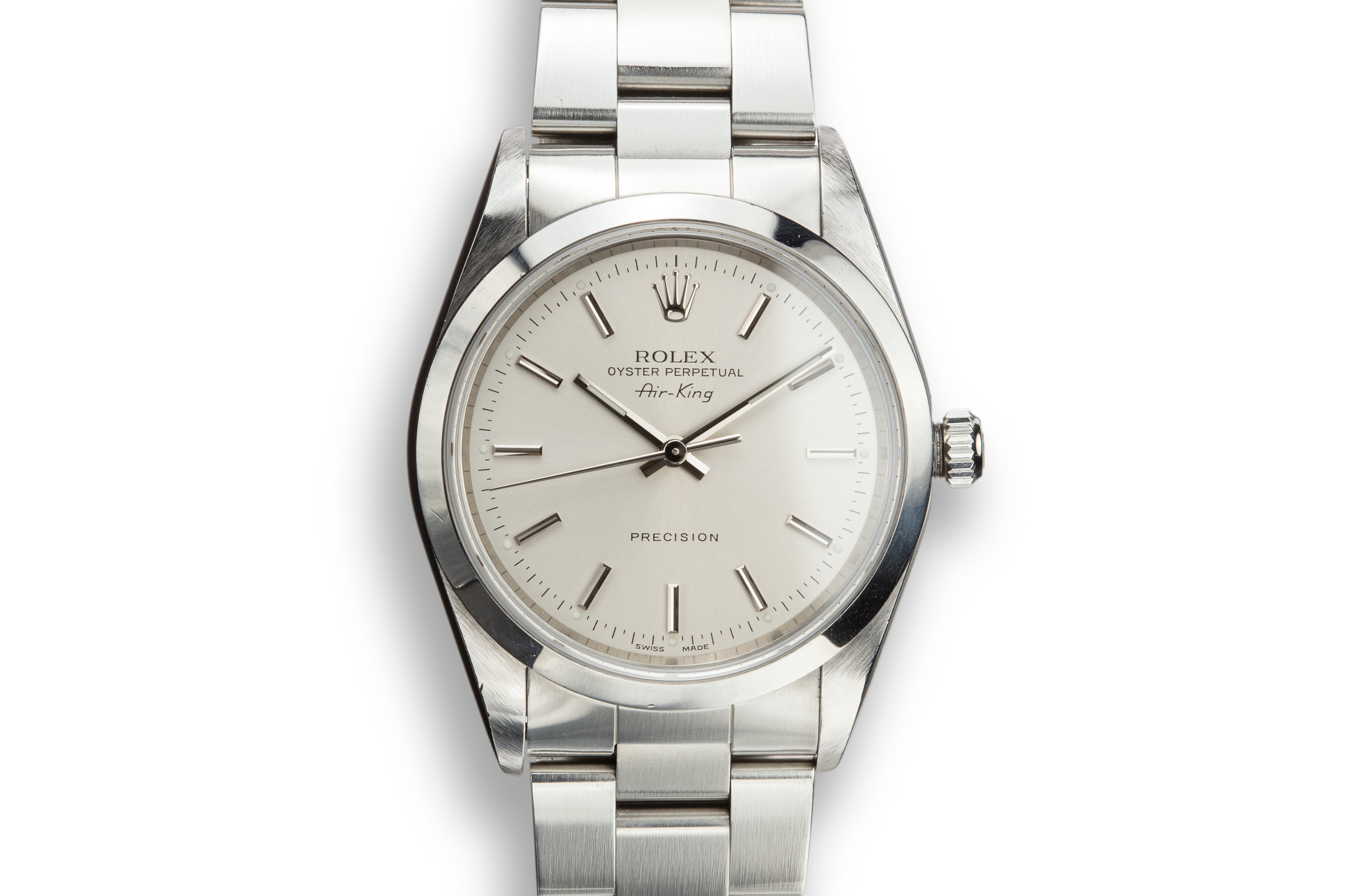

It looks like your girlfriend received a nice looking 14000 series Air-King! If the bracelet is original to the watch then it's from 2002, which suggests a luminova dial (as Servius said). The sapphire crystal also suggests the 14000 series (Davidt). The serial number will tell you for sure (hopefully it starts with a "Y"). There are a few of these 14000s for sale with "Swiss Made" dials (same color too) at a couple of reputable online dealers to take a closer look at for comparison. Here's a pick of one that was sold recently from one of them. This was a 1999 model 14000:
