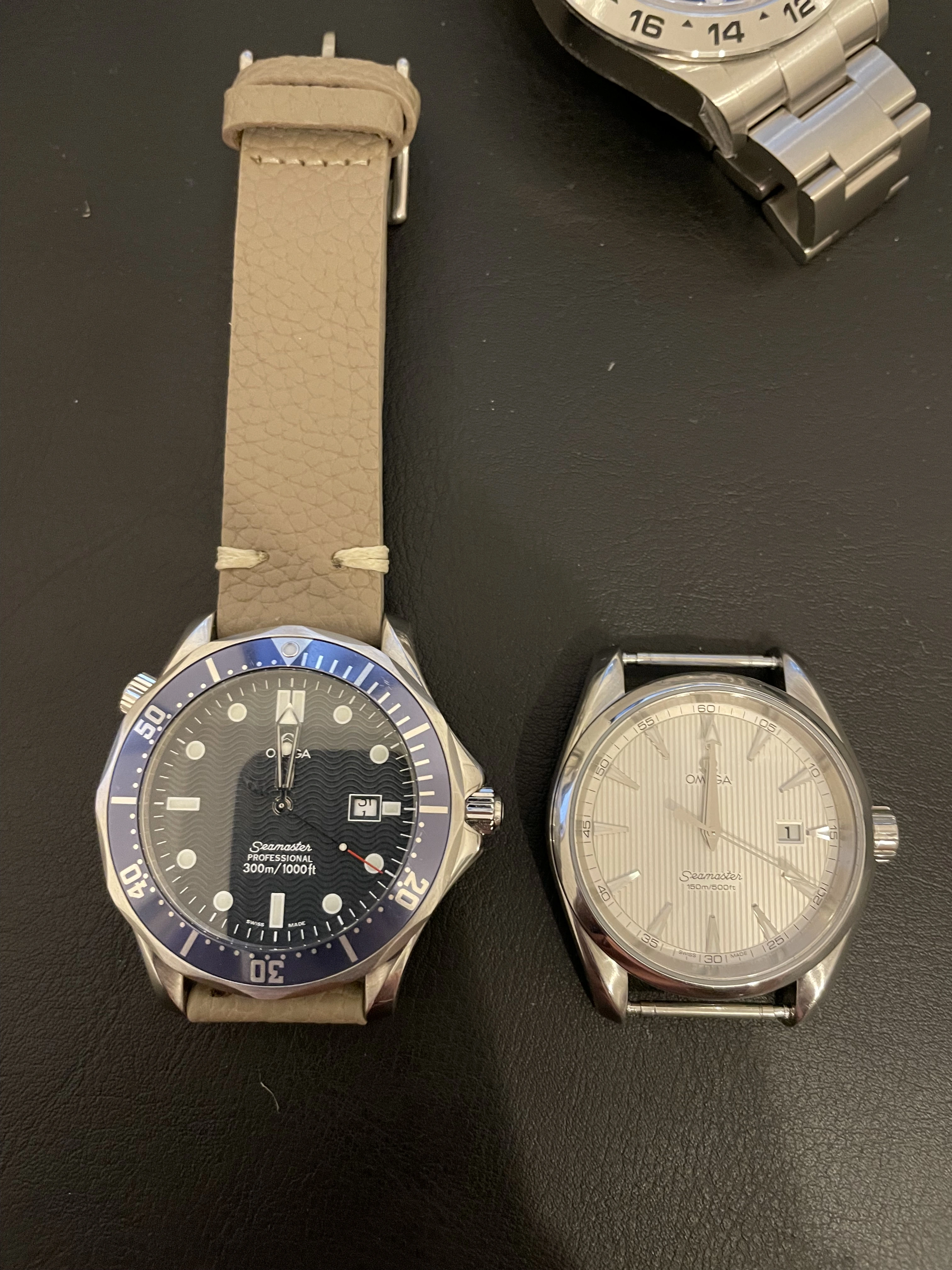

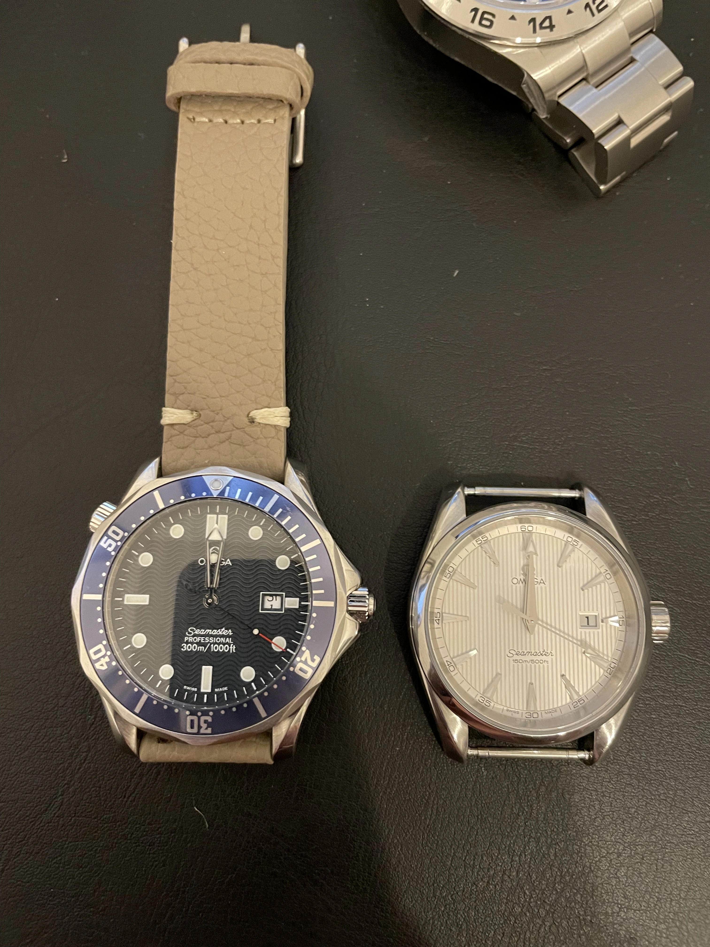

I did get my hands on 2 omega watches with the ETA based cal. 1538. Both are of great sentimental value to me.
One is the SMP 300 - first gen. BOND watch, the second is an 2. gen. Aqua Terra quartz 38,5mm

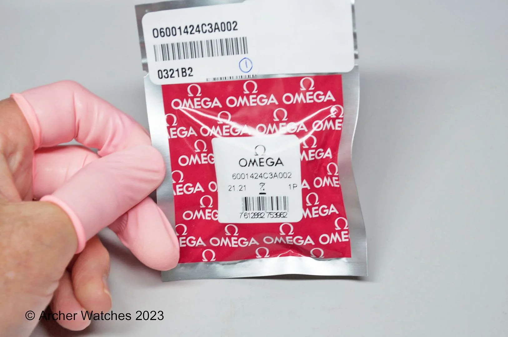

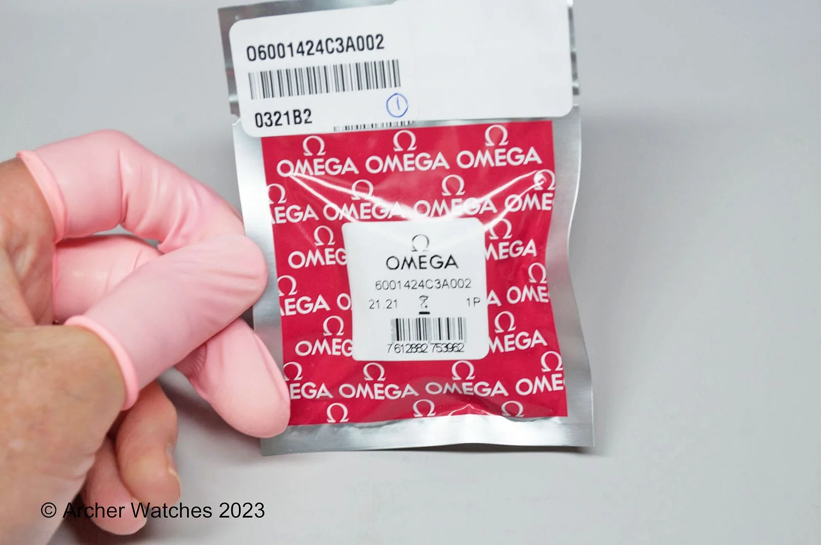

I can't answer your question, because when one of these needs a new movement I simply order it from Omega. This is a 1424 but you get the idea:
If your watchmaker was Omega certified they could do the same. So to keep your watch original and keep the costs down if you don't want all that other work done, you could always try an independent watchmaker with an Omega certification, who can just do the work that you want and not all the other things.
