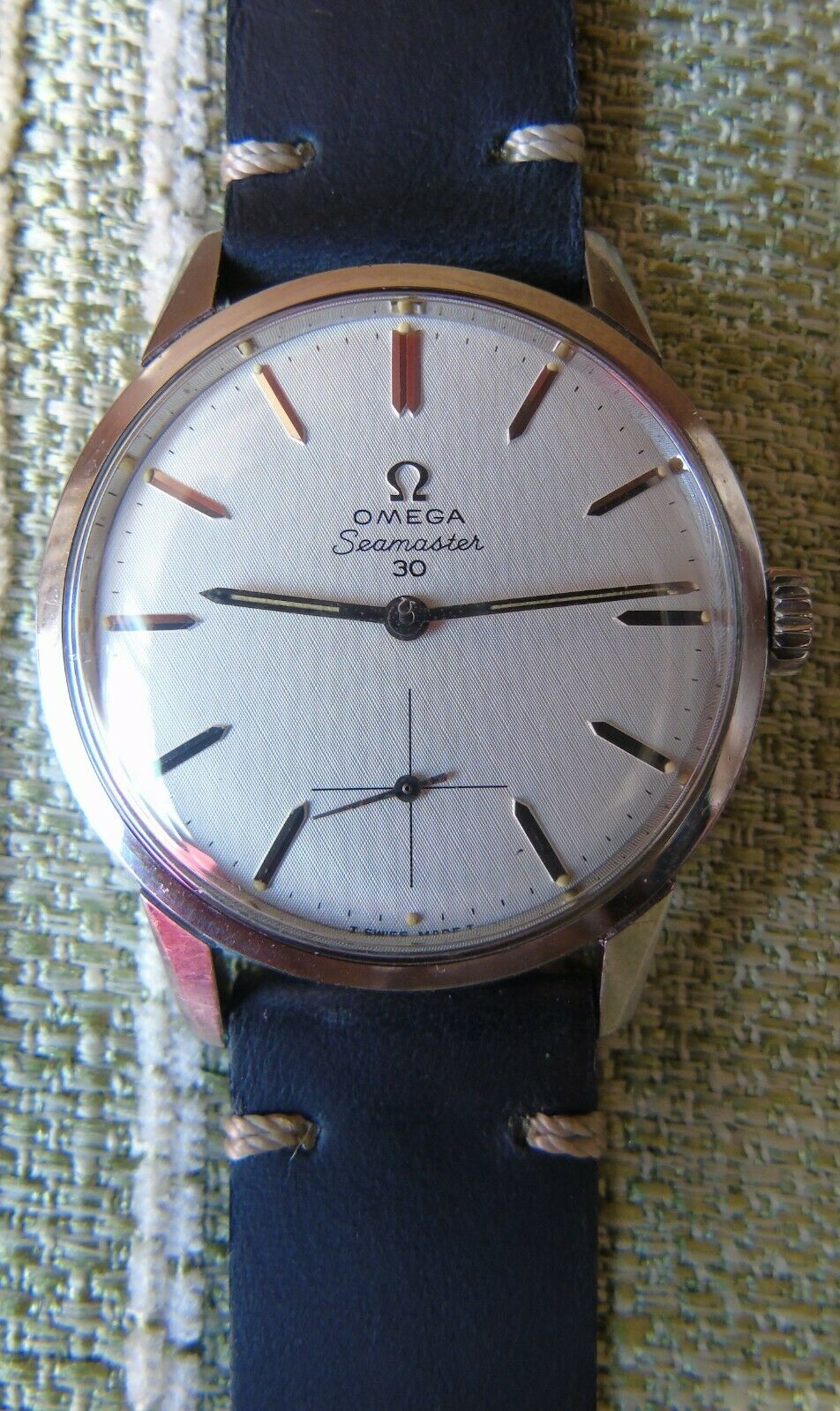

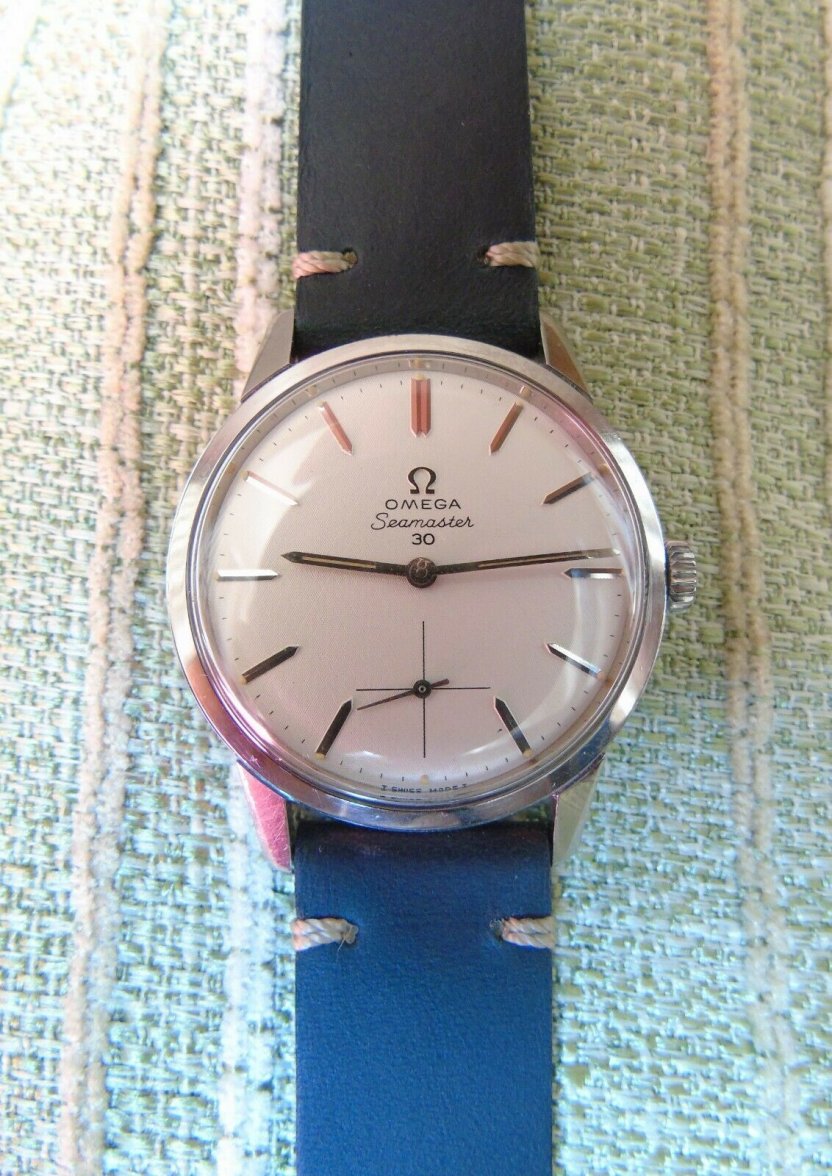

Does tis look like a redial, the movement is very clean and the crystal appears original.
Seller says its a 1963 watch but I have read that omega only started using the T on the dials in 1964.
As usual I require the help of those much more experienced.
Thanks
Tim

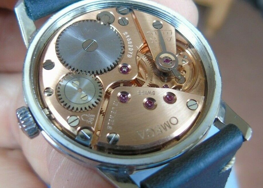

Serial number on movement suggests 1964, but that dial looks too good ?

Might be a service dial but I bet a donut it's not refnished.

Very nice watch with an original dial.

Ref 125.007. I've seen grey florentine dials before, but not white until now.
The speck to the left of the 5 o'clock marker is interesting.

I think it's a piece of lint.
I think when you see a sea of crap it’s hard to tell the good ones- this is one of them. I have a couple that look like this- and it’s what we all want.
We can all guess at what it’s “worth” but 60’s Seamaster’s in this shape are not as common as many would have you think- some kind of “patina” (aka damage) is the norm. I would put a premium of 20-30% over average sales prices just for the dial condition and if you really want it- do another 10%. I have gotten some great deals during my collecting, but the best of the best I have paid more than I thought was sane and never regretted it.

Have a watchmaker look at the movement to see if it needs anything and enjoy that lovely watch
