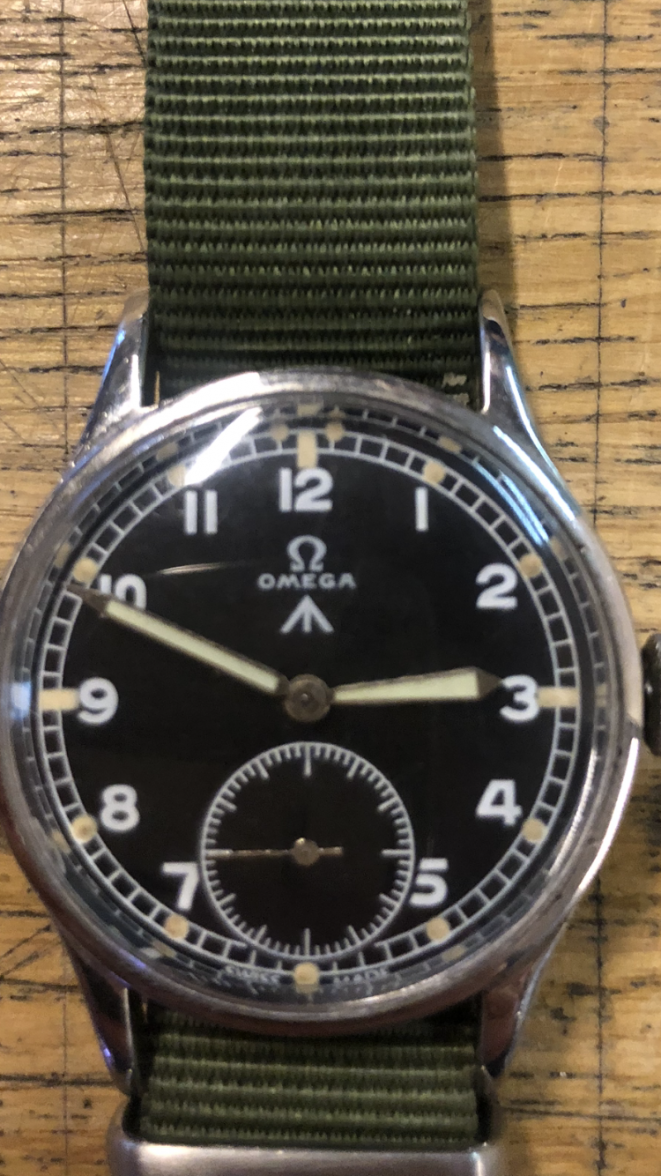

Sf4Wqct Dear all, do you know the feeling when you have a watch in your hands - it looks right, but the Weight and feeling just makes you think that it is a false watch?
Im unsure if this watch is right. Is it a redial? And if so - what should the price be?
Thanks to you all.

Hard to tell with the kinda blurry photo. I will say the dial looks a little "too" clean at first glance. I know the feeling though. Here's some good examples for comparison.

Blurry photo or not. Looking at the details, I vote for redial.

The lume dots look a bit too inconsistent, maybe?

Omega font is too heavy, should be thinner. The dial should have crisper markings.

The lume encroaches too much on the 9-12-3 and seems inconsistent on the rest. The color doesnt match the lume on the hands as well. I vote relume, but maybe not a redial.

Look at the spacing of the eleven, the ones are too close together.
