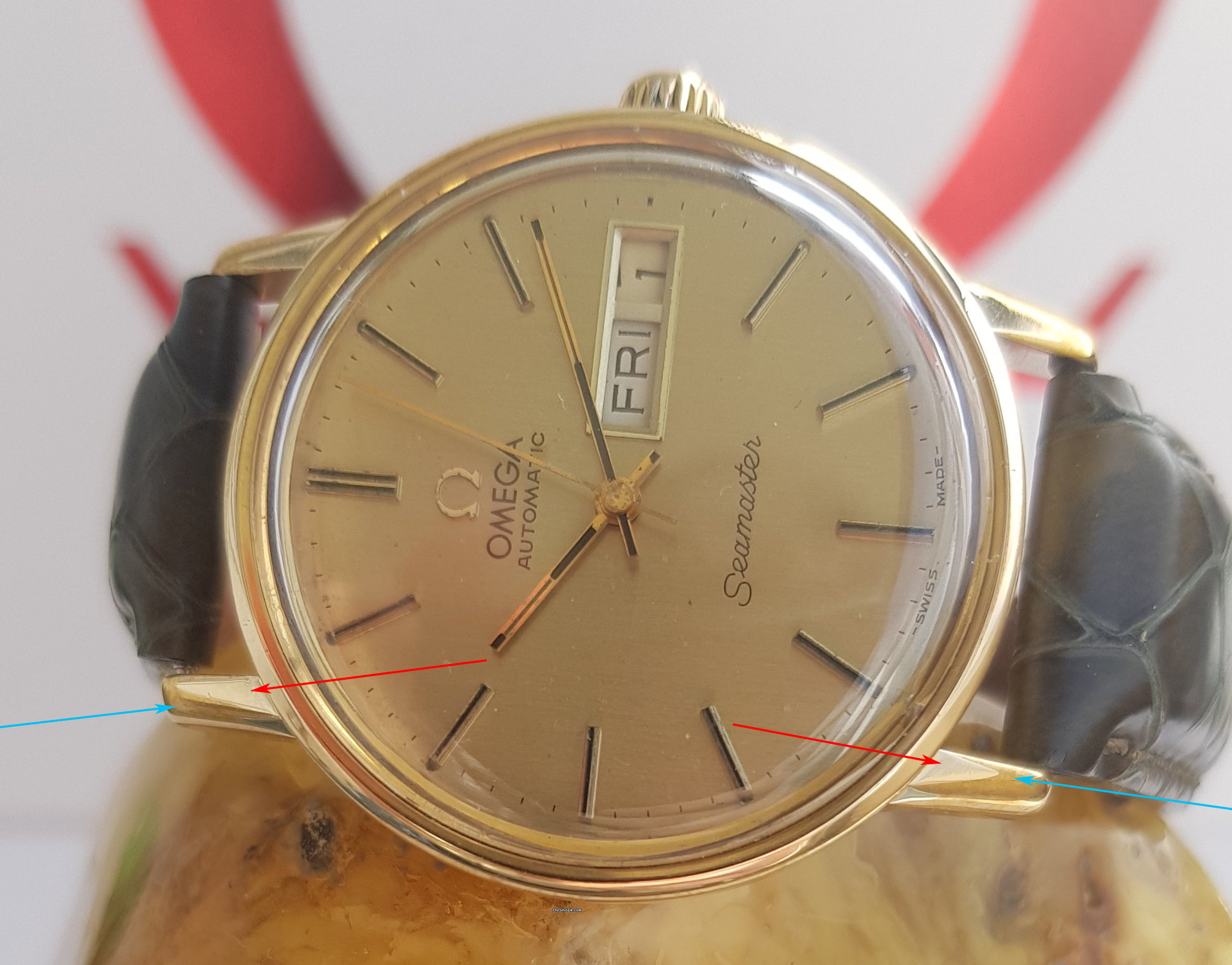

Is this a good Seamaster?
19
I found a 166.0209 example that I quite like. I have read up on the 1020 movement, and saw some mixed reception (that Omega cut corners, not as collectible as the 60s' movements, fragile... etc). I would like to wear this watch, so collector's value isn't as important to me. What I would like to know is whether this particular watch is worth $700, barring collector's value. Durability, accuracy of the movement, ease of use, and serviceability are my main priorities.
Thanks for your help!

You cannot evaluate an item like objectively. The only market it occupies is that of the collector's as it would fail on all other parameters.
No, it isn't worth $700.

It's so horribly over polished and worn I can't imagine even wanting to own it even at less than half the price.

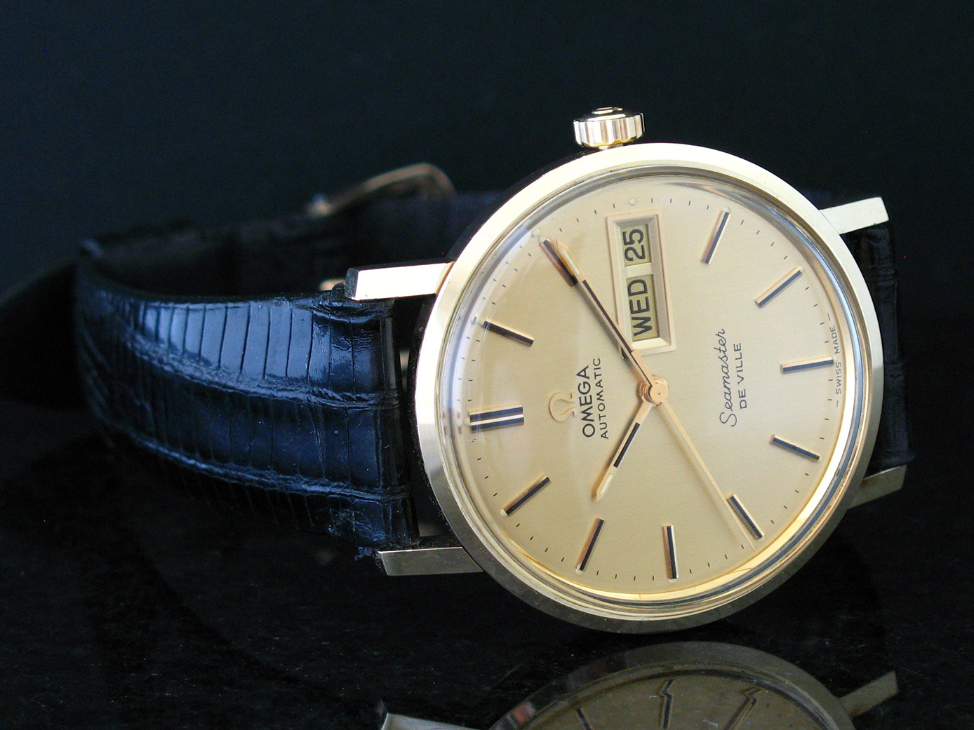

This is what the case on one of these should look like.
Note the severe wear on OPs watch. Blue arrows show where the gold plating has been worn/polished away down to the brass base.
19
They almost seem like two different watches. Polishing can take that much of the edge away? One seems to have round edges and one seems flat. To alter that much character of watch is unthinkable.
