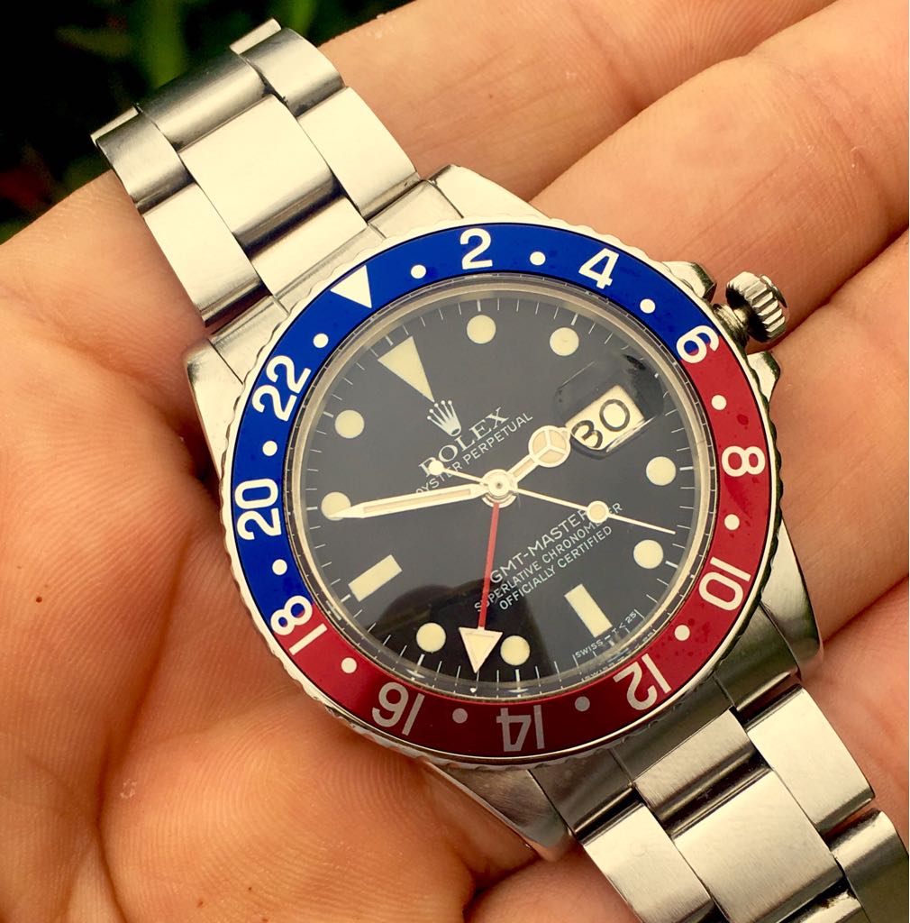

Posts 359 Likes 648 JACK G ·Apr 26, 2018 I'm usually pretty good with detail but despite looking at lots of pics I am still not 100% confident in identifying genuine Rolex inserts!!!! What do you think guys - does this one look OK?
Posts 2,058 Likes 4,635 77deluxe ·Apr 26, 2018 I think it looks legit. Where is @watchknut? He is an expert in these.
Posts 1,063 Likes 1,390 southtexas ·May 2, 2018 Yes, and the flatter 4 and oval 8 means it’s late 70s, early 80s. Looks sharp!
Posts 563 Likes 1,356 chows99 ·May 9, 2018 It looks redback to me based on the flattened 8. Otherwise its very fat for a blueback. Nice watch pal!

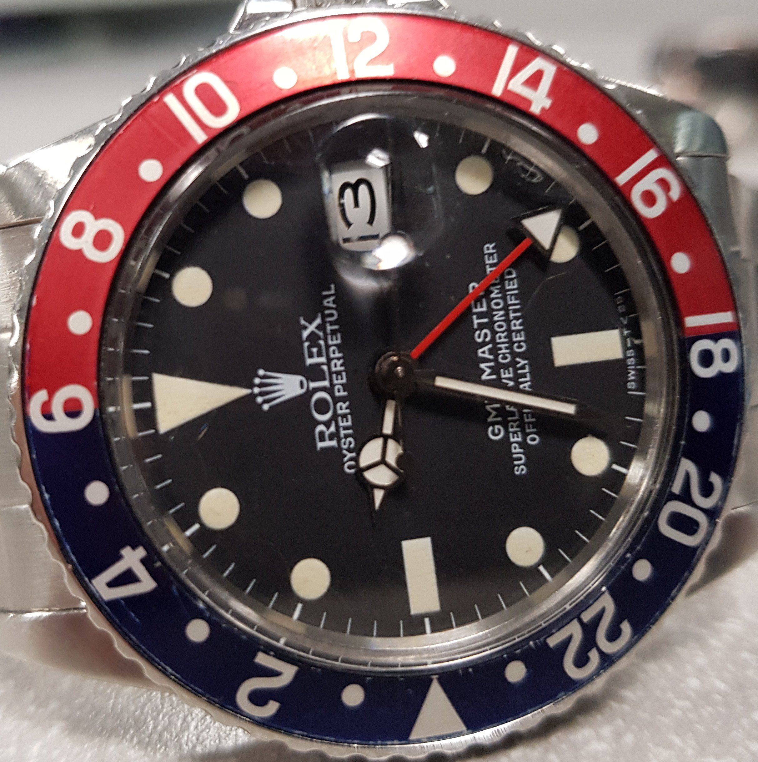

Posts 2,052 Likes 5,993 Fost ·May 9, 2018 Looks really fat ! Mine for comparison ... MK1 dial on yours , really nice !
Posts 359 Likes 648 JACK G ·May 9, 2018 Thanks for all the identification comments guys. Just to clarify this is not my watch but one that I was considering buying when I first posted. I didn't buy it in the end.
Posts 359 Likes 648 JACK G ·May 9, 2018 I already have a 16750........................ but am looking for another and the one at top of this post did not fit the criteria. The following WTB I have on another forum best explains what I am after...... http://forum.tz-uk.com/showthread.p...-16750-or-trade-for-my-vintage-Rolex-or-Omega
