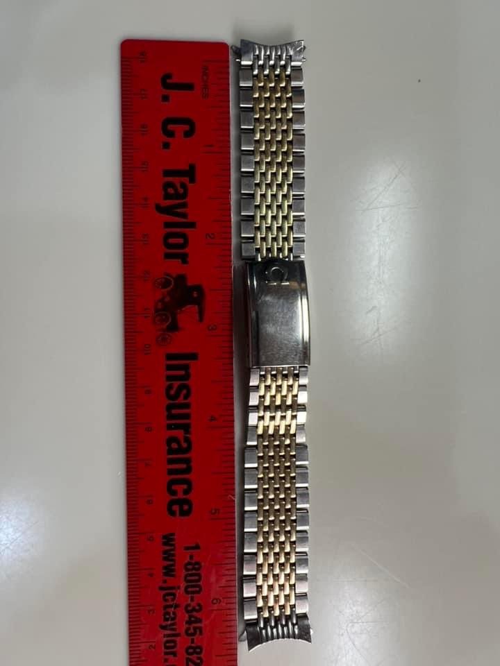

Hello - This is a new arena for me and I'm looking for some assurance/guidance on fitting the right size beads of rice bracelet to my vintage Omega Constellation. Reference #2852-5 SC. I was told this bracelet will fit my model. Can anyone confirm and/or provide insight into how or how not? I'd like to know before I purchase. Pictures attached. Thank you!

Are there more photos of the inside clasp- should have some numbers identifying the bracelet- also photos of backside of endlinks should have numbers- then you can look it up
But more importantly, the top endlink in your photo looks badly damaged and bent- I would pass on that basis alone.

That bracelet was not designed for that Constellation. It’s at least ten years newer.
I’m sure it could be adapted to fit, but the styles don’t really align and it won’t be ‘correct’

That bracelet was designed for later 60s De Ville styled cases with straight lugs
