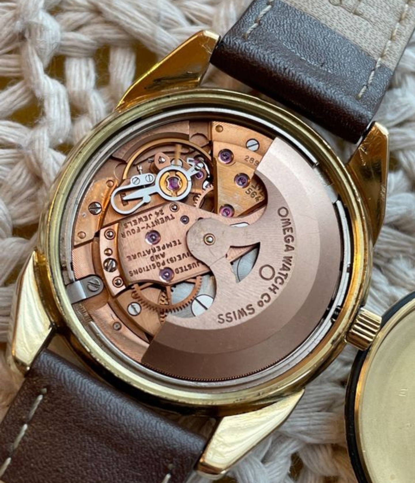

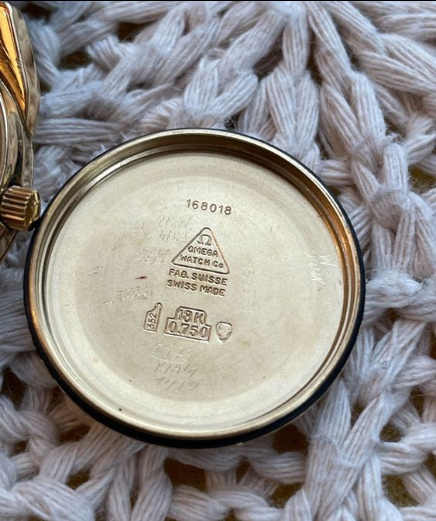

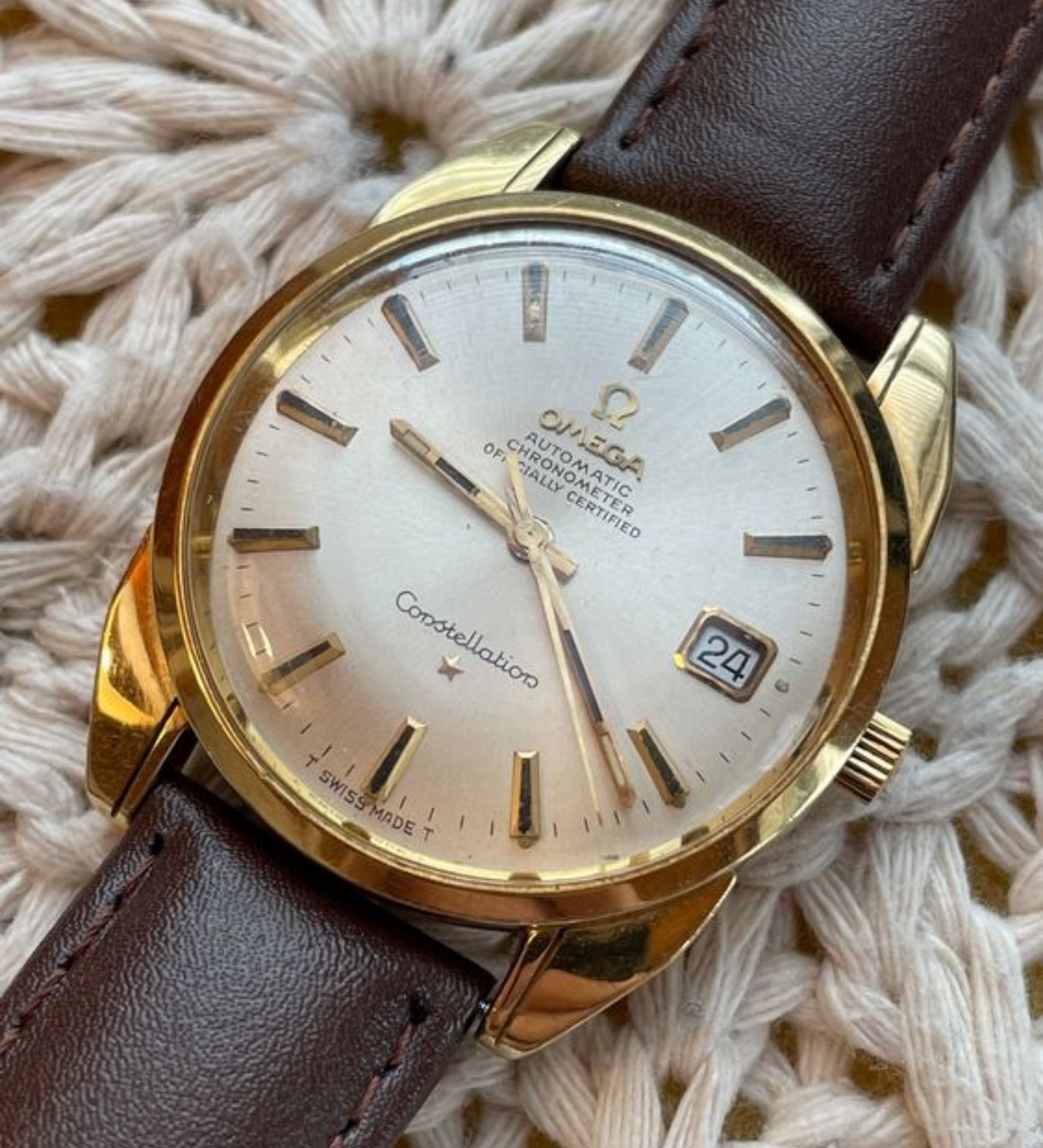

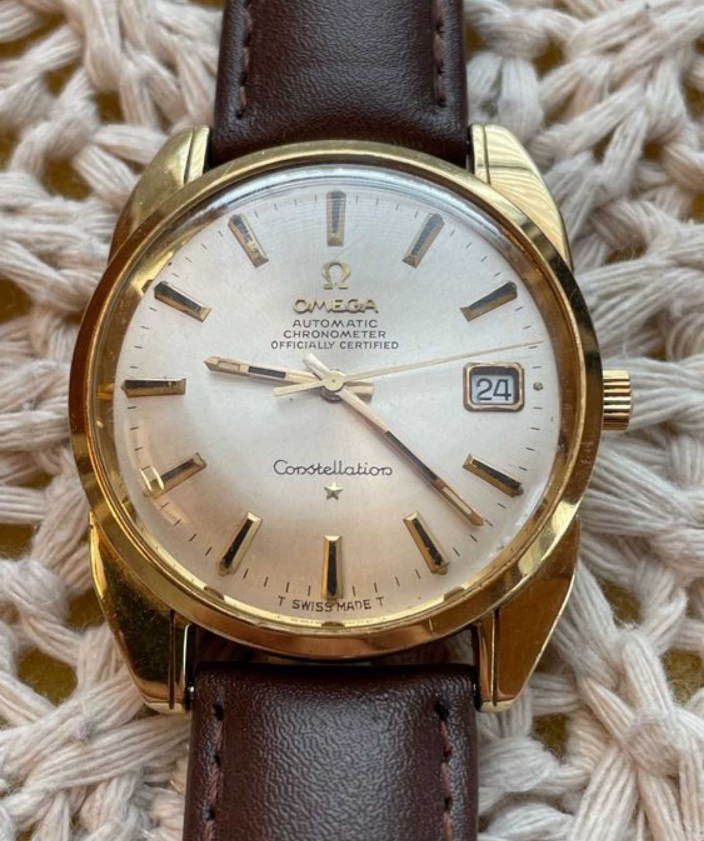

Is this 18ct omega constellation legit?
1,325
1,872

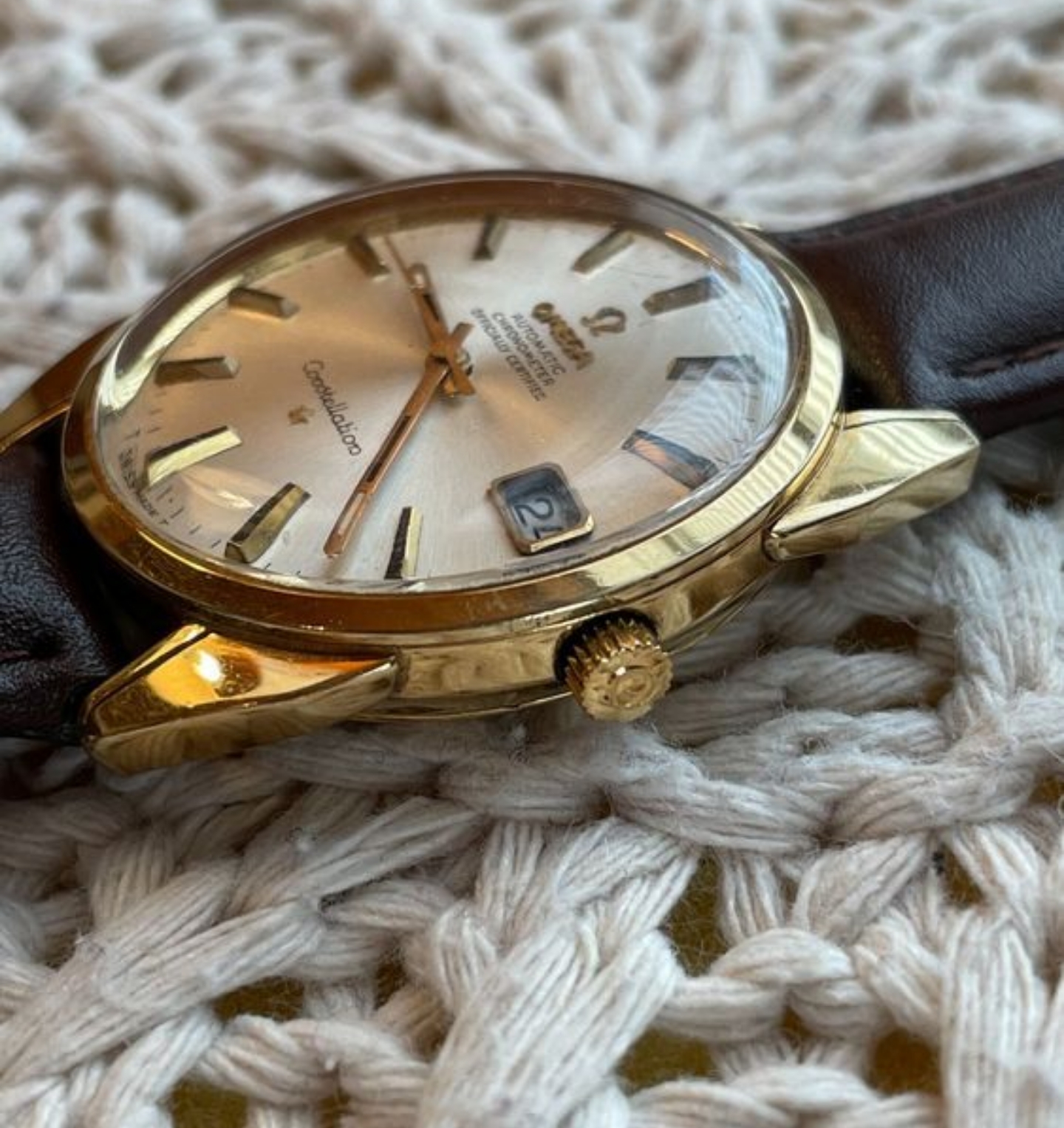

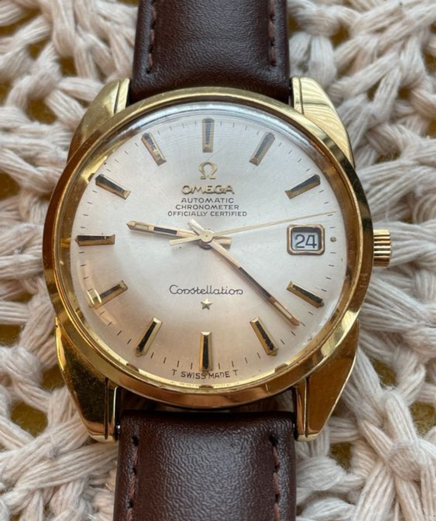

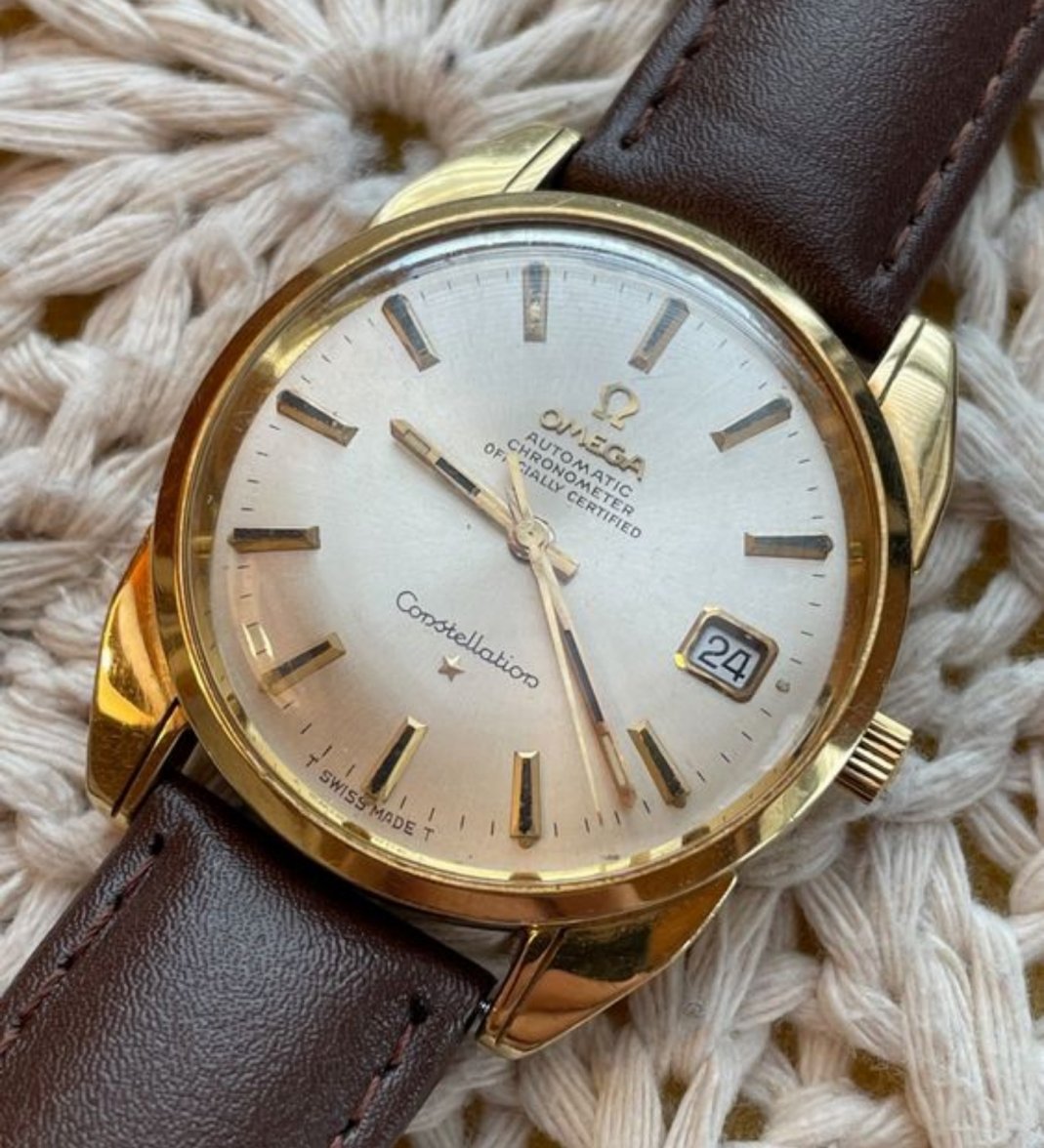

Don’t recall ever seeing those lugs before

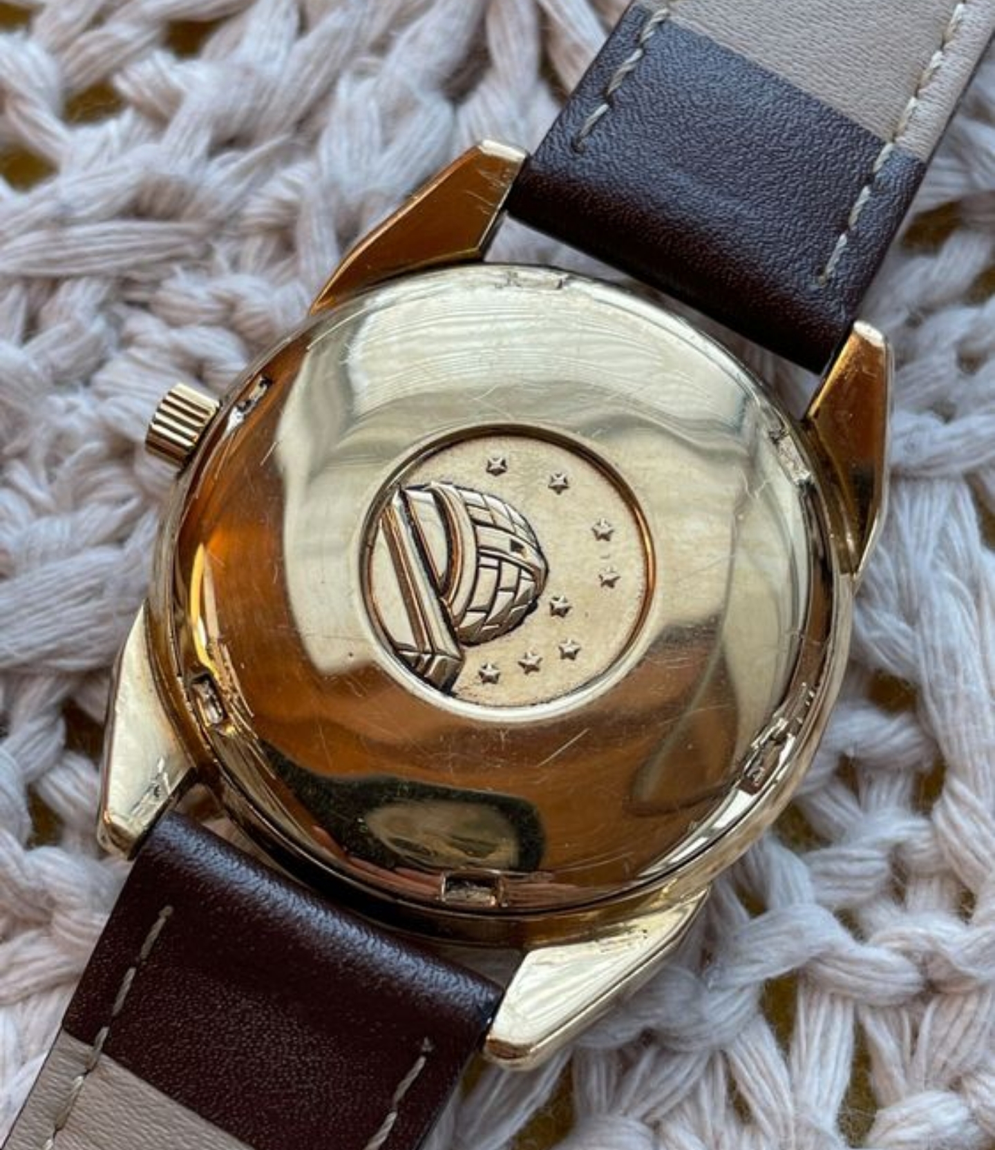

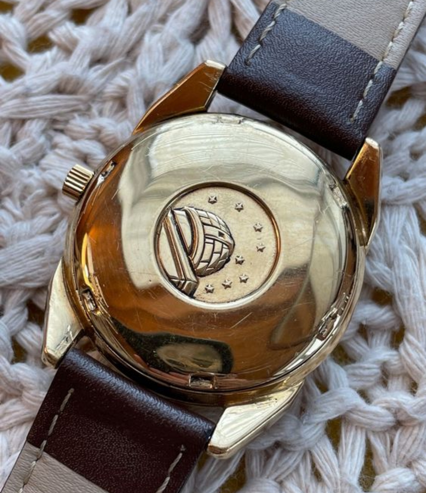

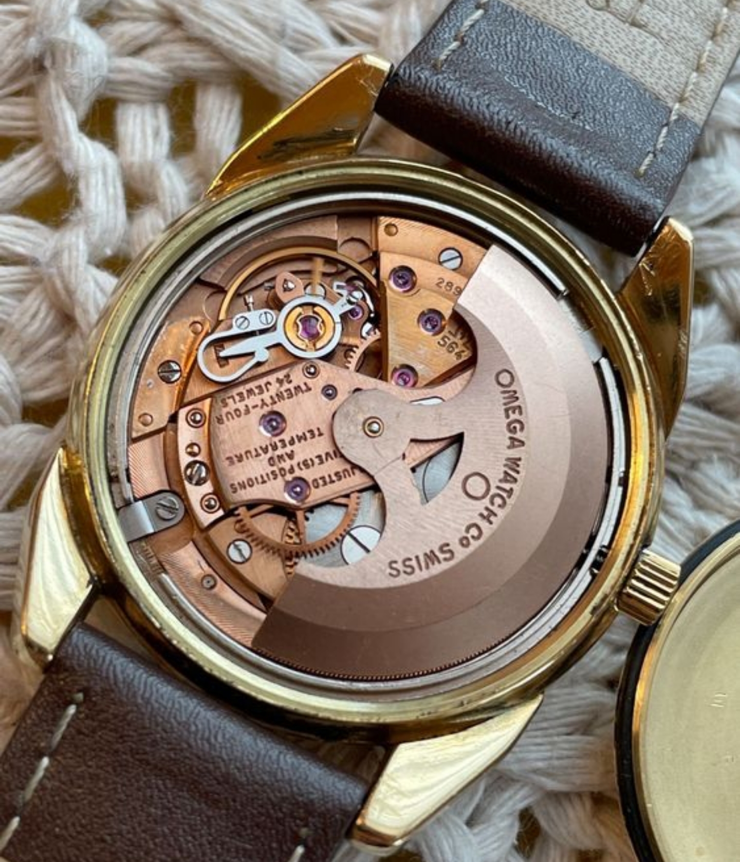

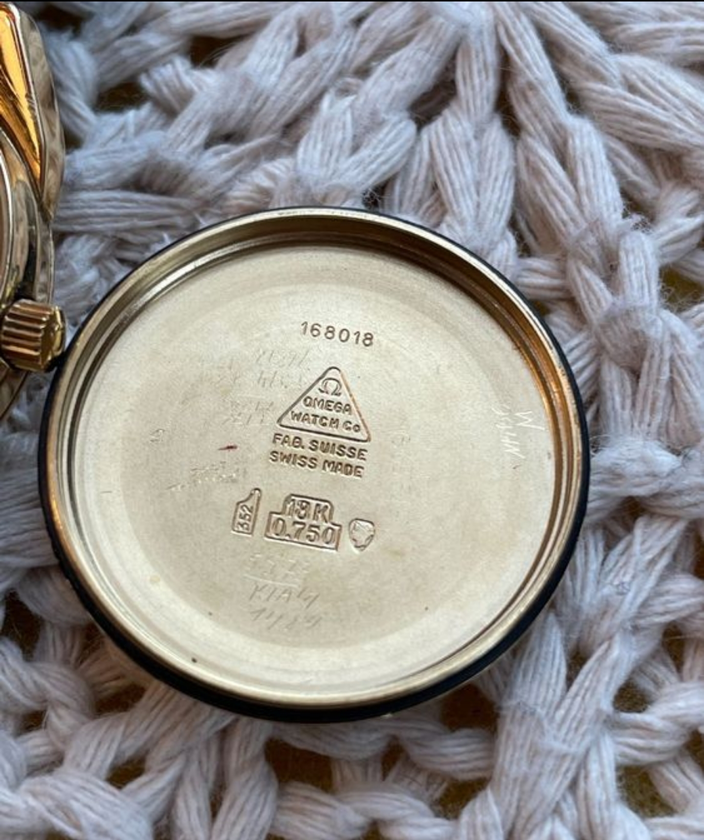

Is there a shot of the inside case back?
343
840
There we are - Accidentally uploaded 2 times same pic in post 1 instead of this
1,325
1,872
Ref 168.018 is completely different -
so this is a fraud
Someone, somehow, has fitted the dial, movement and case back onto a completely fraken non-Omega mid case (edit - which may or may not be 18k gold, of course)
Hope you haven’t bought this?
1,325
1,872
LOL - if on eBay, report it
If a dealer, please expose

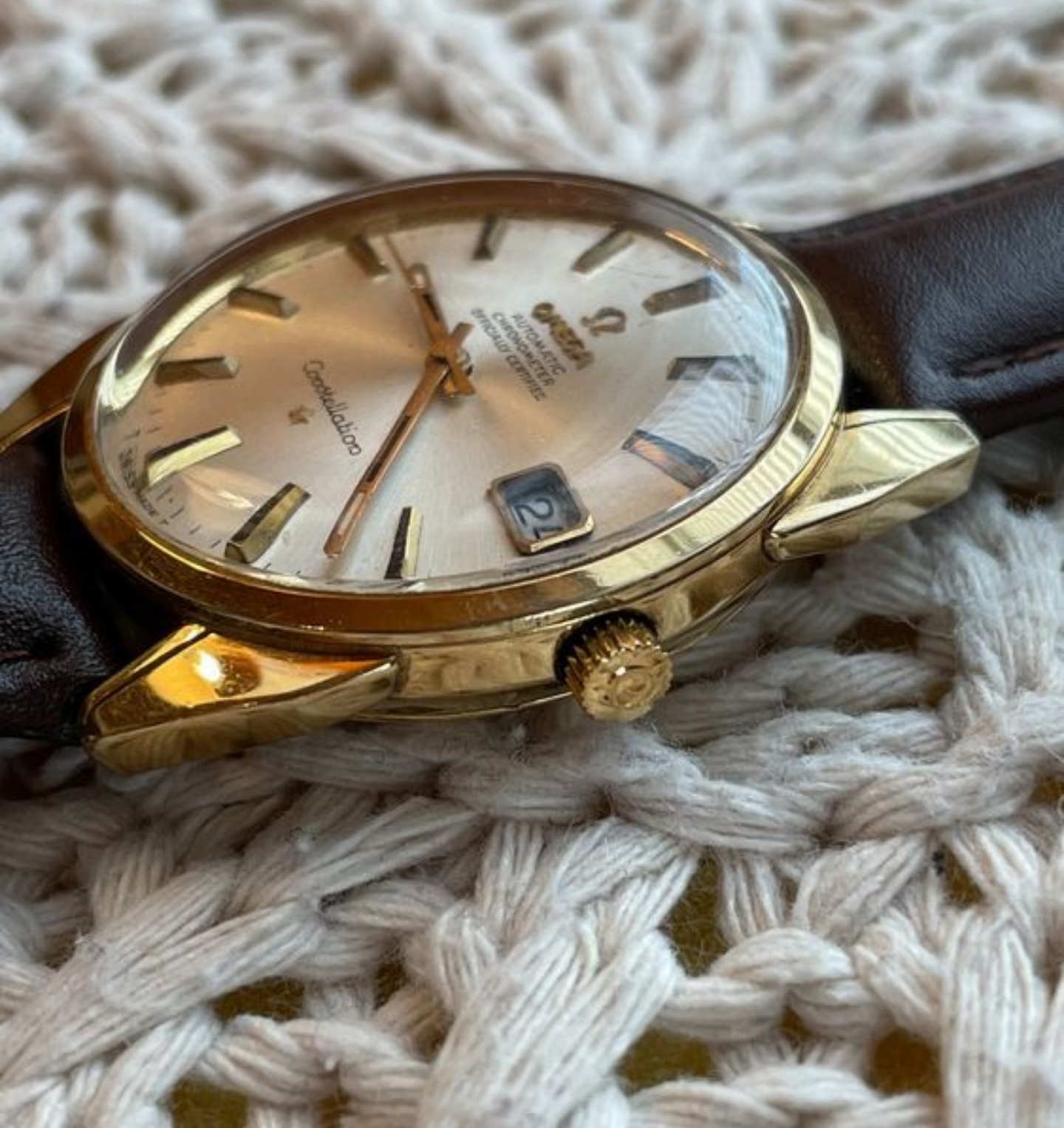

BTW - in this era, Omega would have stamped hallmarks into the back of 2 of the 4 lugs - note there are none on the watch above
343
840
No dealer and not on ebay
Also the dial is not really fitting in the case - if omega prototype I would assume it would fit better..
Seller anyhow stating watch is solid gold.
Haven't either seen any case/lugs like this in omega so far...
10,804
16,814
Prototype when used for watches like this is usually another word for bullshit.
