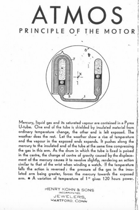

............ the mecury tube was shaped like an "s" with a rod in the center .......
I have to correct you there Bill, it's actually "U" shaped.
From the site you posted the link to.
So, as far as I can establish, the function of the clock has always been controlled by temperature, not barometric pressure.
18,202
27,529
Yes and no... as both are in play and depending on how you look at it your both right and wrong. Pv=Nrt

"barometric pressure"
2,446
7,040
The early mecury tubes atmos also used change in temp to wind the clock... not pressure change..
Thanks, now I understand (with the help of @JimInOz scan). Indeed it is ambient temperature changes that winds the mercury version of the clock.
This is splitting hairs. As @JimInOz said, the barometric pressure doesn't wind either version of the clock.

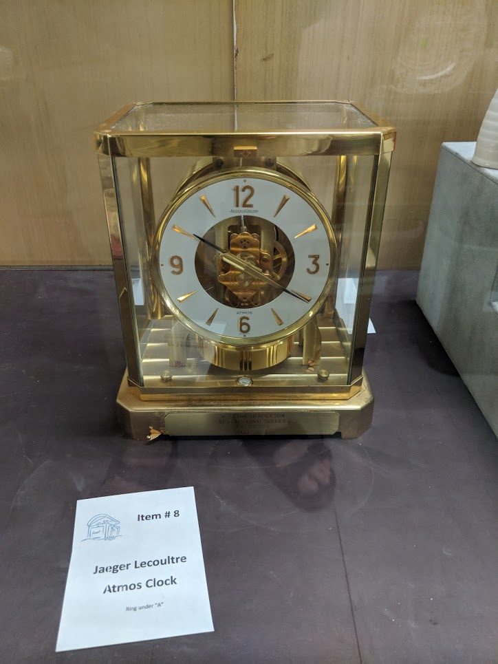

Well to bring an old thread back to life, if there is anyone in the Chandler AZ area interested in one of these, in apparently working condition, there is one at the "Hidden Treasures" thrift shop on Alma School Rd. They run it as a silent auction that runs for 8 days after someone makes an opening bid. Opening is $225 - I'd love to have it, but just not in a position to have "yet more stuff" at this point. Considering it is an award clock with a plaque on it, I'm assuming value is less than usual, but $225 for one working should be a decent deal. Date on the plaque is 1973.
I was just thumbing through my copy of The Theory of Horology and it states that changes in barometric pressure do indeed wind the clock.
“Variations in atmospheric pressure can have a considerable effect: a change of 26 mbar has the same effect as a change of 1°C and can provide the necessary energy to drive the clock for three days.”
